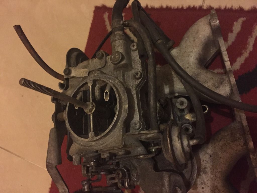

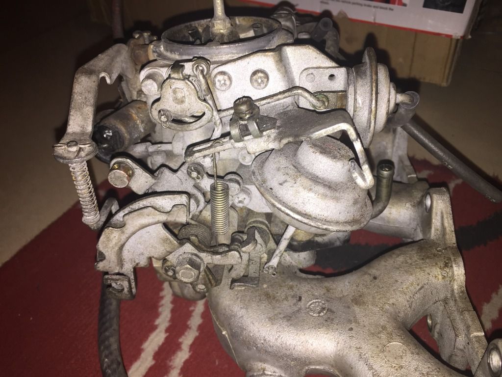

There are two different carbs used - one is the slide type which is a pain in the ass, the other is the standard venturi type which is only a mild pain in the ass. Can you post up a photo of yours with the air filter off? With the slide type there is a cold start valve on the drivers side that green and black and has a couple of vac lines to it. When this fails it can cause all sorts of issues like the above and hard starting. Might be worth seeing if you can clean it out and/or replace it.
I think thats the standard type one as it doesnt seem to have the cold start valve that I can see.
