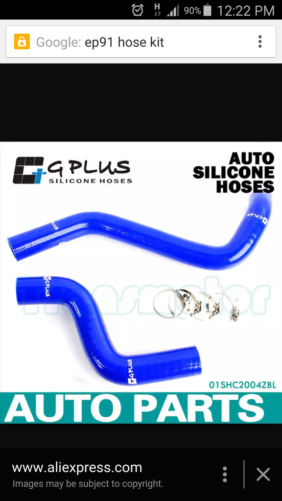

Turbo Goose Posted April 8, 2015 Posted April 8, 2015 (edited) Hi guys, does anyone have a decent picture of their bottom rad hose fitted?I have a civic rad and ordered this kit and cant figure out how the bottom hose fits! Its like its too shortMy civic rads bottom outlet is on the left hand side at the bottom. Are others on the right? Thats the only thing i can think of Edited April 8, 2015 by Turbo Goose Quote
Ollieh17 Posted April 8, 2015 Posted April 8, 2015 I had an issue with japspeed ones where they were missing a bend on the end so wouldnt fit Quote
Turbo Goose Posted April 8, 2015 Author Posted April 8, 2015 Ye im having that same problem i reckon Quote
Ollieh17 Posted April 8, 2015 Posted April 8, 2015 Compare it to your standard hose if you still have it? Quote
Gainzy Posted April 8, 2015 Posted April 8, 2015 Had the same problem the image's don't match what you get! Quote
Turbo Goose Posted April 8, 2015 Author Posted April 8, 2015 ollie ive literally got everything apart from that old hose. No idea whats happened to it! Quote
Glanza-Ben Posted April 10, 2015 Posted April 10, 2015 Its because there for a non turbo so thermestat housing is different had this issue before so had my own made Quote
Bug679 Posted April 21, 2015 Posted April 21, 2015 Don't wanna tread hog or anything but where did u get them made Ben ? Quote
Glanza-Ben Posted April 21, 2015 Posted April 21, 2015 Don't wanna tread hog or anything but where did u get them made Ben ?This is who make alk my hoseshttp://www.boostjunkies.co.uk Quote
