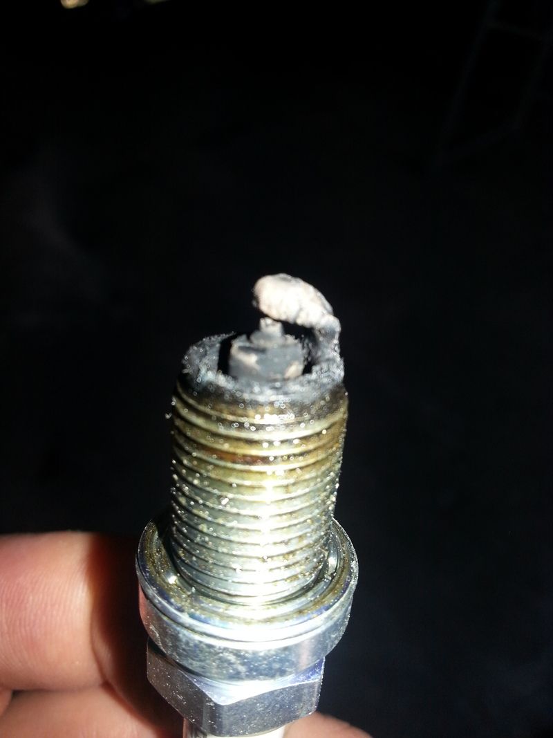

turbominicooper Posted May 20, 2015 Share Posted May 20, 2015 doing a health check today and noticed my no.1 plug was fooked. they are ngk iridium heat 7 Quote Link to post Share on other sites

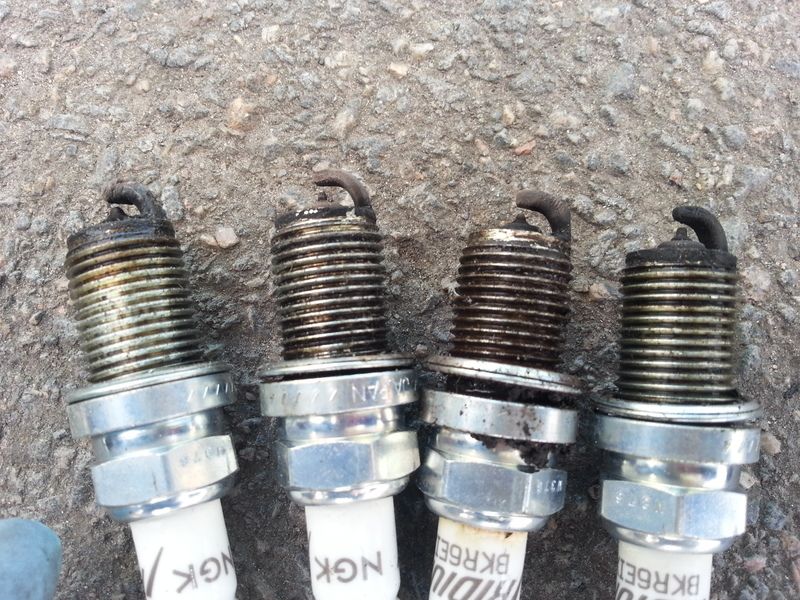

5e colin Posted May 20, 2015 Share Posted May 20, 2015 (edited) wow amigo is that on the 5e ???? only the 2nd plug looks normal ish 3 and 4 are off to lots of carbon build up >>> lots of oil burning Edited May 20, 2015 by 5e colin Quote Link to post Share on other sites
turbominicooper Posted May 20, 2015 Author Share Posted May 20, 2015 No on the 4e which I ran a smokey ct9 followed by a smokey td04 Quote Link to post Share on other sites
5e colin Posted May 21, 2015 Share Posted May 21, 2015 fuck them in the bin and buy some ngk bkr7e instead there like 22/24 euros for 4 Quote Link to post Share on other sites
turbominicooper Posted May 21, 2015 Author Share Posted May 21, 2015 On it mate. on some ngk-r at mo Quote Link to post Share on other sites
sosolid Posted May 23, 2015 Share Posted May 23, 2015 how much power you running mate? if its standard power its too cold to run 7. If standard power use 6. Quote Link to post Share on other sites
5e colin Posted May 23, 2015 Share Posted May 23, 2015 them plugs are 6 !!!! have a look Quote Link to post Share on other sites
sosolid Posted May 23, 2015 Share Posted May 23, 2015 your right. he wrote there 6. Quote Link to post Share on other sites
