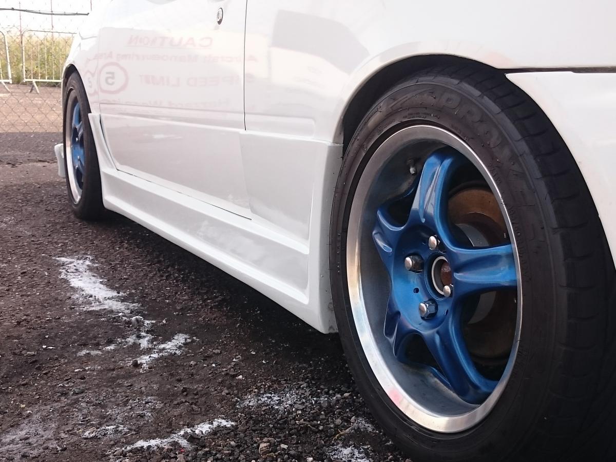

akyakapotter Posted July 14, 2015 Posted July 14, 2015 (edited) I run 20mm front and 25mm rear they are hubcentric. Edited July 14, 2015 by akyakapotter Quote
Di_Bodi Posted July 14, 2015 Author Posted July 14, 2015 (edited) akyakapotterTHANKS FOR YOUR PHOTO!!Your set up is similar so i that way that you brough both tracks to the same width as rear spacers are fatter 5mm then front ones...So have you noticed anything in relation to driveability? Maybe I should check with some tracking specialist? Your alloys must have different ET as I don't have that much space! By the way: the stock suspension is so ridiculously high! Looks so bad...Front:Rear: How much they'll go inside at the top I wonder after lowering on springs...hmm... Edited July 14, 2015 by Di_Bodi Quote

Di_Bodi Posted July 14, 2015 Author Posted July 14, 2015 (edited) I run 20mm front and 25mm rear they are hubcentric. It looks you've rolled the arches - am I right? Edited July 14, 2015 by Di_Bodi Quote
akyakapotter Posted July 14, 2015 Posted July 14, 2015 Yes mate I had to or it would have destroyed my tires. Quote
