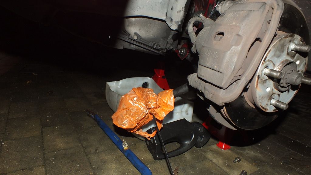

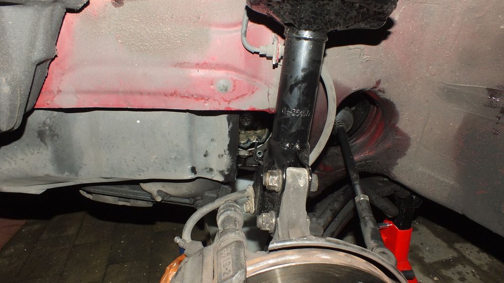

M-R-P Posted September 16, 2015 Posted September 16, 2015 Evenin' all Here's how my car looks now... Drive shaft out... Yep - water got into the inner CV - I'll be cleaning it all up and I've some nice, high-spec grease to go in but that's not for a while yet... Here's the story... Our little EP91 GLS Auto (N/A) has served us well for a few years now. A gift from relatives (rather than scrapping it) it's been a nice little daily hack for the school and work run. Uses very little fuel and is tough as old boots (I reversed the Volvo into it and the Volvo came off worse lol).Any way, after yet another surprising MOT pass, I started tarting it up a little. New brakes all round, new shocks all round, new bump stops, P/S flush, Coolant flush, service, a few geometry tweaks to make it a bit more fun around town etc etc. I noticed a few knocks while turning at low speed recently and I naturally presumed a CV was on it's way out. Well, on closer inspection, I've found the diff bearings are shot - the nearside driveshaft is flapping about like a mo-fo (see other thread). Here's where I get back on topic. With everything I've done to the car, it would be a shame to break it or scrap it, so I decided to rebuild the diff. How hard can it be? Now, the car isn't a Glanza. It's the daily work hack so I won't be slinging an LSD in there or anything, so don't flame me for keeping it stock, I have another toy for driving like a tit with Tonight, as you can see from the above pics, I started stripping things down to get at the diff. However, I've already encountered a problem... Well, rather a question. When I unbolted the plate that would give me access to the diff, I found what looks like a core plug, in the back of the gear box and it's stopping the housing from coming out. Here it is... Can anybody tell me if I can just undo the bolts and remove the cover? or will it do some horrific kind of damage to the autobox? I can get a replacement box and diff for £100 or so but I like a challenge and I'm a right tightarse (bearings I can get cheap ) Any advice I can get will be great. I'll update this thread with my progress if anybody's interested. Martin. Quote

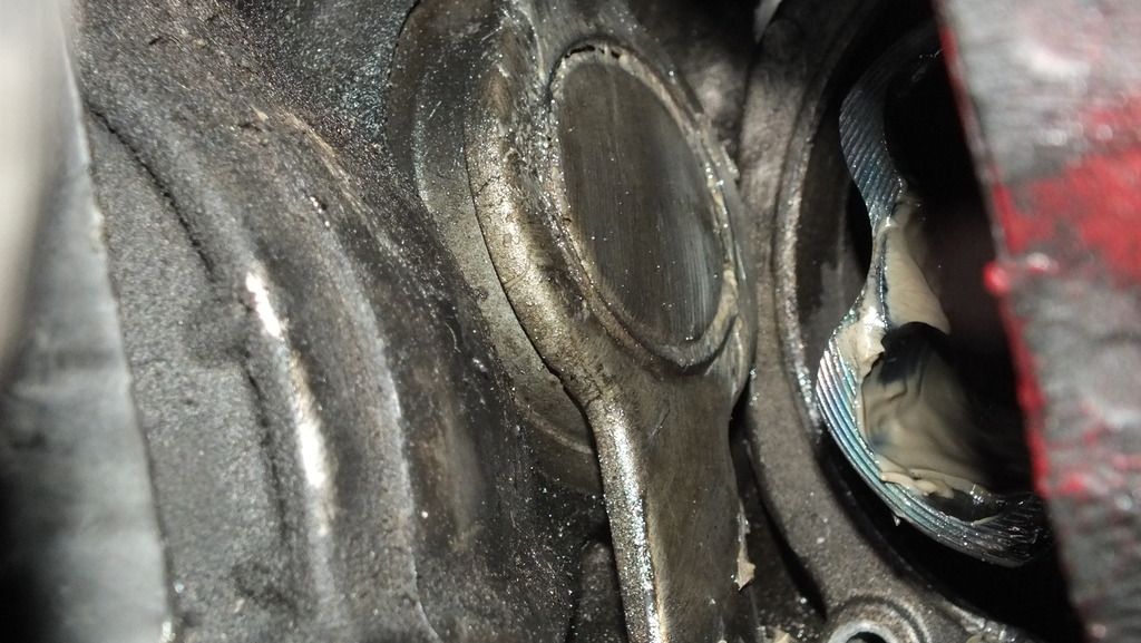

M-R-P Posted September 17, 2015 Author Posted September 17, 2015 Can anybody tell me if removing this bracket/plug is a risk? I repair industrial machinery for a living so I've no worries there, I'd just rather have some idea of what I'm letting myself into... Quote
Ep82gi Posted September 18, 2015 Posted September 18, 2015 I doubt anyone's repaired one before buddy only binned them n got a second hand one. If I was you I'd just pull it apart I mean if you can pull it apart it should go back together right? Just take pictures along the way please so some of the others can see if it's really worth the Agro or not. Plus I'd love to see the insides of the auto. Box Quote
M-R-P Posted September 18, 2015 Author Posted September 18, 2015 No need to pull the autobox apart, the diff is in its own little box at the back.I'll take plenty of pics and do a writeup etc.If I can help someone out that'll be great. I've done a little research and doing the diff bearings should be a doddle. It's getting it out without ruining something that's bothering me. Quote
M-R-P Posted September 27, 2015 Author Posted September 27, 2015 (edited) So, my first go at it since I started this thread.I've now realised that the diff housing won't come out with the driveshaft still in. I know this is a bit obvious but it wasn't having it the other day so I left it. Does anybody know if the shaft is locked in in Some way? I tried Colin's method (with a 2 foot wrecking bar) but it won't budge.Any tips? Edited September 27, 2015 by M-R-P Quote

M-R-P Posted October 1, 2015 Author Posted October 1, 2015 I'm not planning to go anywhere near the box. The diff is in its own little housing on the back. There's a removable plate that the n/s driveshaft goes through and a plate on the back allowing access to remove the diff.My problem, which is holding me up and could potentially be the end of the car, is removing the driveshaft. Quote
M-R-P Posted October 1, 2015 Author Posted October 1, 2015 (edited) Result!After propping the cv cup into position with an axle stand, the wrecking bar got the bugger out! Offside one came out with little fuss.I'm off to pick my kid up from school but later, I'll be getting stuck in and having the diff out.Stay tuned. Edited October 1, 2015 by M-R-P Quote
M-R-P Posted October 1, 2015 Author Posted October 1, 2015 And now I've got the engine and transmission propped on blocks as I had to drop it all enough to be able to get the diff out.It's gotten dark so I'll call it a day for now. Quote
