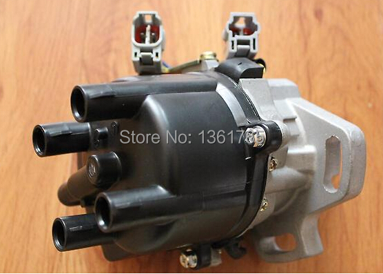

JDMfreak Posted October 6, 2015 Author Posted October 6, 2015 Well i cant get any spark and ive changed distributor.. a mate suggested theres a wire broke somewhere in the loom running from ecu to distributor but i dont wanna get into changing looms and stuff just get ot to run then im taking engine out as its sold of it ok The distrbutor is the same as a normal setup same as this one Quote
