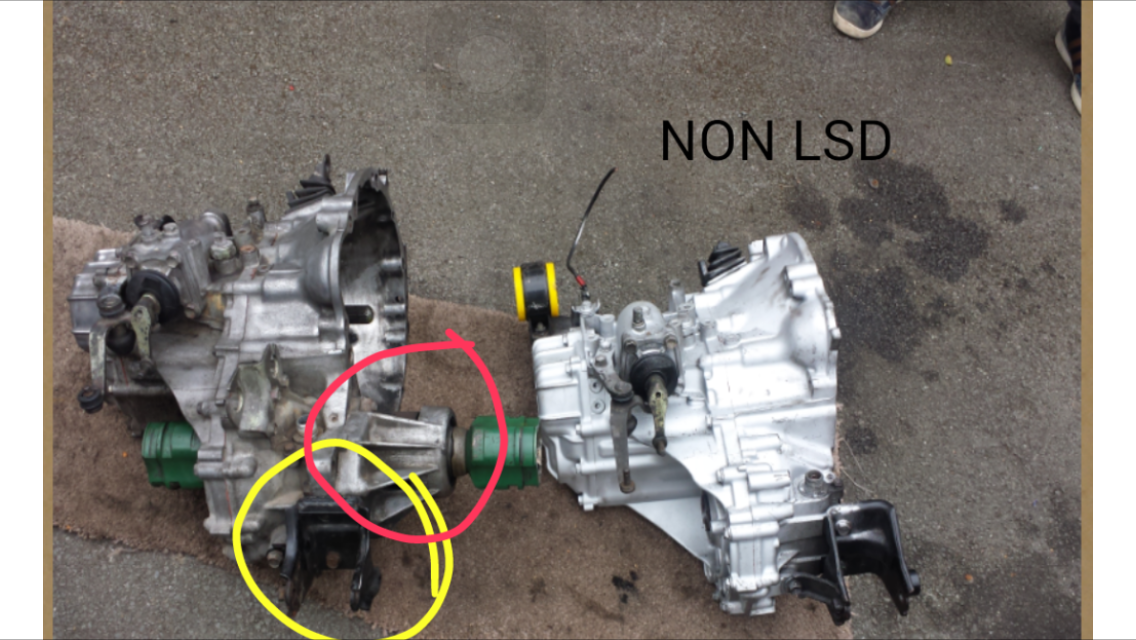

5e colin Posted October 31, 2015 Share Posted October 31, 2015 the 1 on the flywheel if so its for oem lsd box idrees sels them on his site Link to post Share on other sites
Maaximuus Posted October 31, 2015 Author Share Posted October 31, 2015 the 1 on the flywheel if so its for oem lsd box idrees sels them on his site Yeah I can see the flywheel from under the car and shit if I have an LSD that will be a bonus! This it? http://id-workz.co.uk/toyota/starlet/starlet-glanza-ep91/drivetrain/oe-genuine-gearbox-sandwich-plate-oem-lsd Link to post Share on other sites
5e colin Posted November 1, 2015 Share Posted November 1, 2015 thats it mate next time when you under your car look if there is a lump of metal bolted to the gearbox right hand side on a normal gearbox the shaft enters the gearbox at the lenght of the sandwish plate on a oem lsd the shaft is shorter and slots in to a lump of metal thats bolted there between the shaft and box ( viscous coupling ) if your unsure upload a pic of urs wel tel you Link to post Share on other sites
aleximport25 Posted November 1, 2015 Share Posted November 1, 2015 Here's the difference buddy Link to post Share on other sites
Maaximuus Posted November 1, 2015 Author Share Posted November 1, 2015 Here's the difference buddy thats it mate next time when you under your car look if there is a lump of metal bolted to the gearbox right hand side on a normal gearbox the shaft enters the gearbox at the lenght of the sandwish plate on a oem lsd the shaft is shorter and slots in to a lump of metal thats bolted there between the shaft and box ( viscous coupling ) if your unsure upload a pic of urs wel tel you Aaaah I see, thanks guys I'll have a look next time im underneath Link to post Share on other sites
