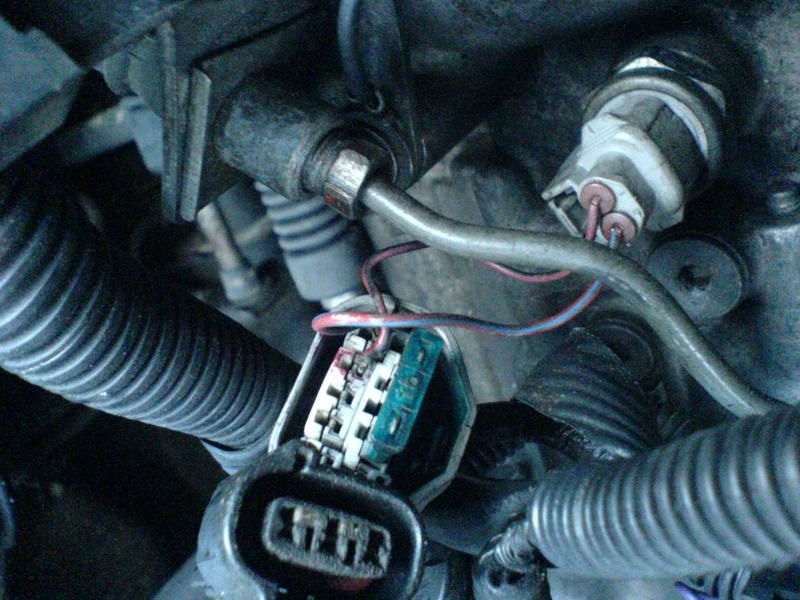

Madge1980 Posted January 13, 2016 Posted January 13, 2016 Hi I am just in tbe final stages of converting my auto glanza to manual and was wondering if anyone knew which wires in the loom I have to wire the manual rev light connector on the gearbox to? Quote
gorganl2000 Posted January 13, 2016 Posted January 13, 2016 i have some pics i could email you with the plug i used in the engine bay--connected to the reverse switch....you can post them here afterwards if they are what you need i dont know how to load pics on the site (or any site for that matter) Quote

Bean Posted January 16, 2016 Posted January 16, 2016 Here's the pics. Could you explain what you've done? Quote
gorganl2000 Posted January 17, 2016 Posted January 17, 2016 thanks beannow first off, this set up is on a 1998 ep91 glanza automatic which was converted to manual,,, i dont know if the other ep91 years (1996, 1997, 1999) and/or the auto ep82 has the same exact plug and/or harness/ecu wiring...my car was originally an automatic with ECT (electronic controlled transmission i think it meant)...i know my ecu has 3 plugs i have heard that the 1994/1995 ep82 automatic with round lights had a 3 plug ecu as well??!?!?...but i'm not sure if they had ECT and the same ecu/wiring as the glanza/ep91 the older model ep82s had 2 plugs ecus from what i remember again, it would be best to compare the ecu wiring diagrams as posted on this site,,,just to make sure regardless of whichever model you have...safety first always now from what i was told/learnedthe two wires going from the reverse switch to the harness/loom turn on the rear reverse lights, the reverse "beeper" in the car and the reverse dash light ® when you select reverse gear on the manual shifter/gearbox.....we soldered metal pins on the two reverse switch wires to allow them to be pushed/locked into the automatic wiring loom/harness plug in the engine bay.....this plug used to be connected to the ECT which was removed from the car the fuse is solely there to allow the car to start...i think its tricks the ecu somehow...it acts as a bridge for the two pins it connects.....a piece of wire would have done the same job or some people prefer to solder/connect the two actual wires on the harness itself or closer to the ecu i strictly opt never to touch my harness if i can avoid it----i've seen/heard some horror stories over the years with persons with electrical issues due to botched wiring hopefully this helps other members/users my recommendation is that you double check and triple check everything (wiring, ecu pinouts, diagrams, etc)...if you are not sure, take it to an electrician,,,as all risks are at you otherwise Quote
