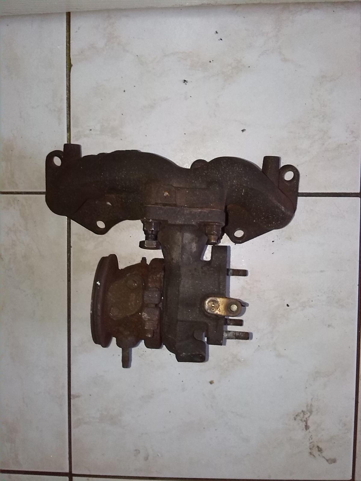

Gumball89 Posted February 1, 2016 Posted February 1, 2016 I need a manifold that's na but bolts to a glanza turbo system as I'm selling up and turbo is going onto a new project. Don't want to spend much just want it running na to sell it. What's about? Quote
5e colin Posted February 1, 2016 Posted February 1, 2016 custom job there is no manifold thats a strait fit as the connection flanges are in diferent spots/shape Quote

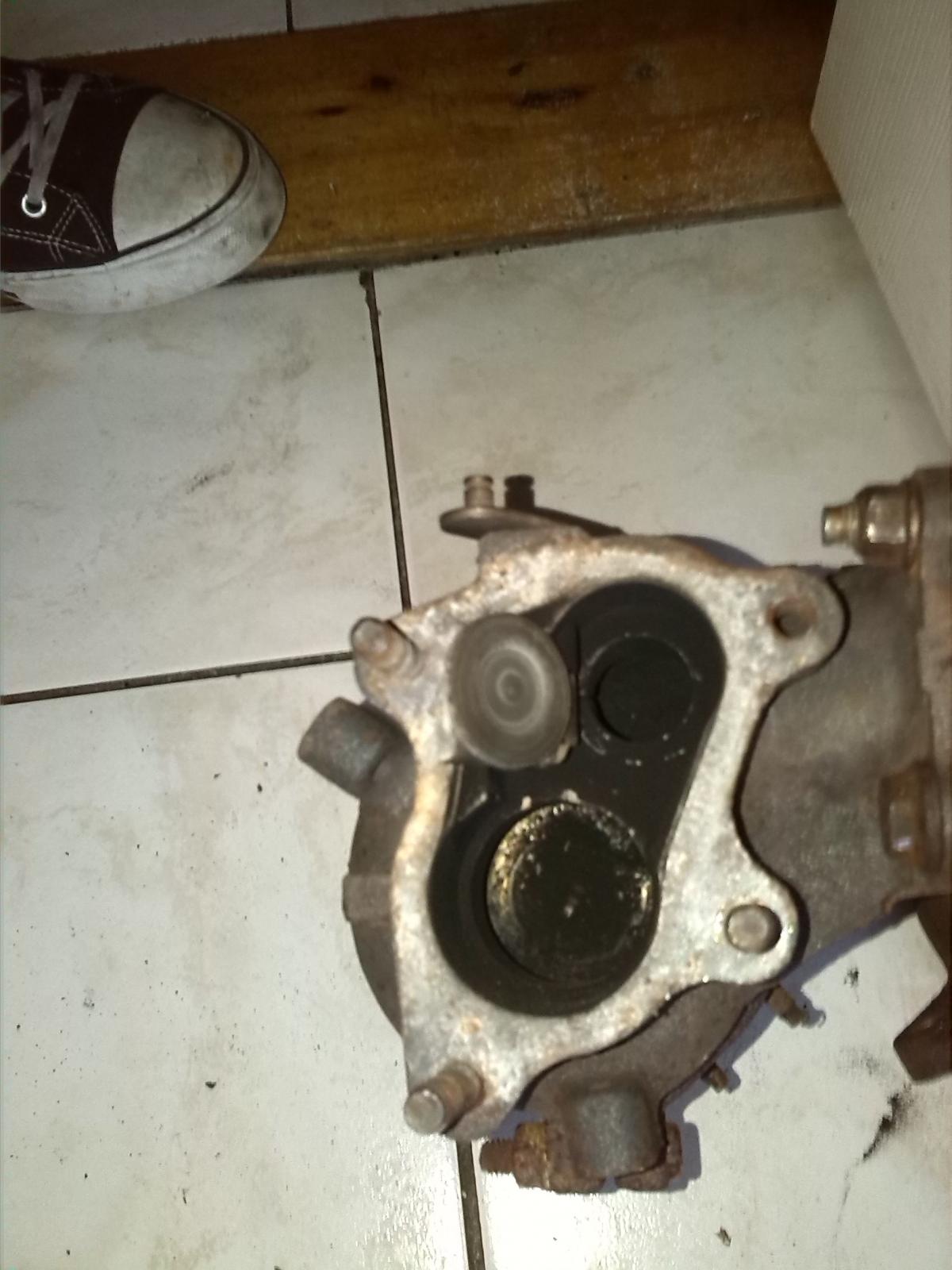

5e colin Posted February 1, 2016 Posted February 1, 2016 you can gut a fucked ct9 weld up the center hole ( only exhaust housing left ) with a stock mani and cat Quote
Gumball89 Posted February 3, 2016 Author Posted February 3, 2016 Colin can you elaborate please surly then I will have a turbo under the bonnet that doesn't work? Quote
5e colin Posted February 3, 2016 Posted February 3, 2016 (edited) only half a turbo the exhaust housing and center core welded up where the turbo shaft was so no exhaust gasses can escape and you just bolt the original cat or decat to that i use this as a emissions cheater Edited February 3, 2016 by 5e colin Quote
