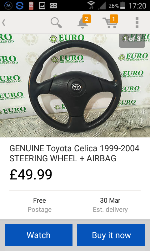

Dale SR Posted March 22, 2016 Posted March 22, 2016 Also I have heard that the Celica steering wheel is a straight swap on to a 98/99 starlet model. But I'm not 100% sure if that's true so best get a second opinion on the Celica wheel if you take that avenue.That's the Celica wheel ^^ Quote
