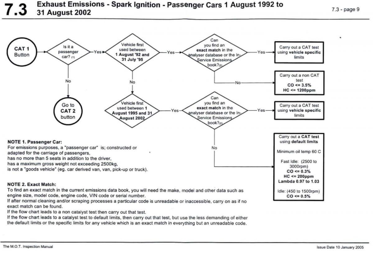

mart1 Posted May 6, 2016 Posted May 6, 2016 I have a 1998 Toyota caldina GT import, owned it for around 7 months now and it's booked in for mot next Wednesday, so when it comes to the emissions test should the mot tester only doing the basic emission test on it ?.Little worried about this lol apparently these cars chuck out more pollution lol even more so than the celica gt4 as the engine is a little different. Quote
jimmymac101 Posted May 6, 2016 Posted May 6, 2016 Find a friendly MOTer ;) your have no probs then lol Give it a decent service before the mot to help bring down the chance of it failing! James Quote
akyakapotter Posted May 6, 2016 Posted May 6, 2016 Should only be a basic emissions test I've had a fall out over this yesterday. Quote
russ78 Posted May 6, 2016 Posted May 6, 2016 The mot testers system has changed recently and it will now only allow the car to be tested as what's on the v5c so if it was imported as lets say for example a 1.5 corolla estate in your case its unlikely to pass emissions so a friendly tester is you best bet unless you have changed the v5c since import then disregard my comment Quote

mart1 Posted May 6, 2016 Author Posted May 6, 2016 Should only be a basic emissions test I've had a fall out over this yesterday. tmp_21433-received_1179251708766322-756372780.jpegcheers for that hopefully that will help if I have any problems lol plus I will take my boxing gloves with me:-) Quote
mart1 Posted May 6, 2016 Author Posted May 6, 2016 The mot testers system has changed recently and it will now only allow the car to be tested as what's on the v5c so if it was imported as lets say for example a 1.5 corolla estate in your case its unlikely to pass emissions so a friendly tester is you best bet unless you have changed the v5c since import then disregard my comment it just says Toyota on my v5, and when I did insurance quote with flux it was coming up as Carina till I explained what it was. I'm probs best to just mention all this before they do the mot rather than after, will take my v5 with me:-) hopefully they should do a basic test. Quote
