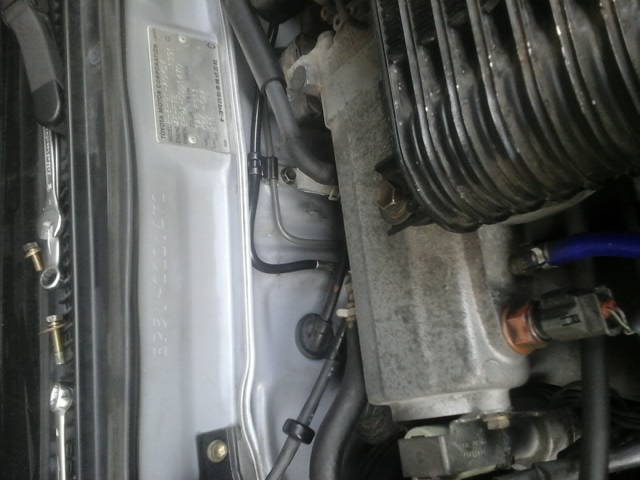

JamesD89 Posted June 12, 2016 Posted June 12, 2016 (edited) Bought the hel kit from TD, Can't get the line running to the front of the master cylinder to stop leaking, now looking at the Google images, this line appears to have a bend at both ends but mine doesn't. Could someone please confirm this for me as I think my kit is off, also the line running along the bulkhead to the n/s seems too long, Any one else had these problems?cheers Edited June 12, 2016 by JamesD89 Quote

JamesD89 Posted June 12, 2016 Author Posted June 12, 2016 Sorry about the pic, can't seem to rotate itI think the lines that go into the master cylinder are different threads than the ones elsewhere. I had one a leaking one and got another made up with a different threadedWas that the TD kit mate? Don't really wanna get another made up when it's supposed to be a factory fit, pissed off its a pig of a job with everything still in the bay. Quote
Ollieh17 Posted June 12, 2016 Posted June 12, 2016 Yeh think so, bought it second hand though. Just make sure you havent go on of the other hoses in the wrong place Quote
JamesD89 Posted June 12, 2016 Author Posted June 12, 2016 Downloaded the fitting guide and the line in question is indeed supposed to have a 90 degree bend at both ends which mine doesn't Quote
