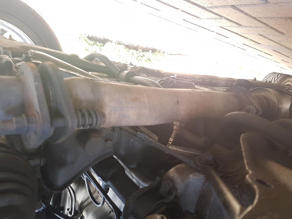

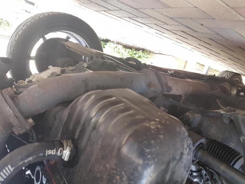

turbo-fever Posted June 27, 2016 Posted June 27, 2016 Does anyone have either of the sections of exhaust or the whole thing as I have just discovered a hole ! The black dot in second picture Quote

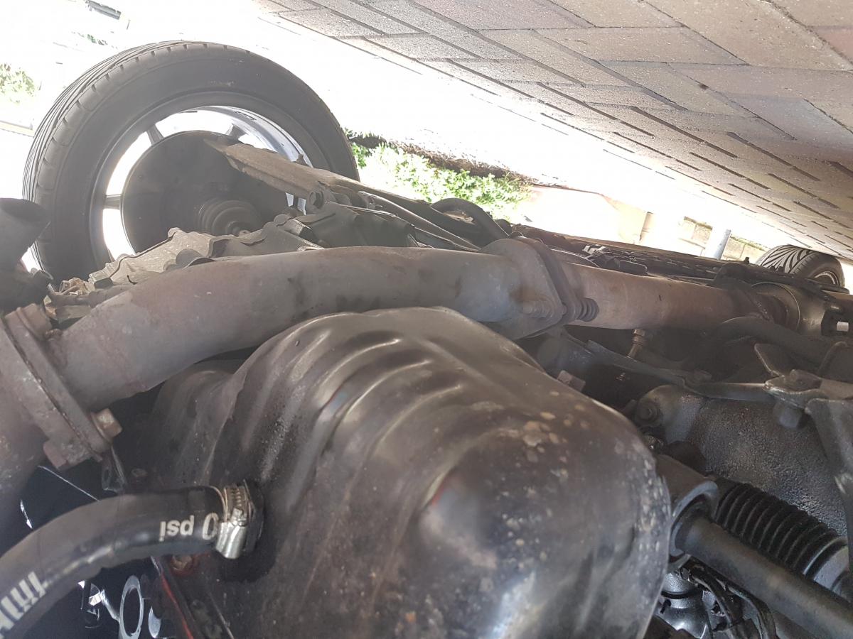

daniel_g Posted June 27, 2016 Posted June 27, 2016 That section looks a custom job.Would be getting that bottle neck taken out of that 1st section whilst youre at it. Quote
5e colin Posted June 27, 2016 Posted June 27, 2016 think thats just the stock section of the fijitsu exhaust system pretty scares they are Quote
turbo-fever Posted June 27, 2016 Author Posted June 27, 2016 Looks like a custom exhaust can't see any writing anywhere has no back box sort of like the buddyclub system Quote
turbo-fever Posted June 27, 2016 Author Posted June 27, 2016 I see what you mean just looked them sections look the same as power getter system Quote
turbo-fever Posted June 28, 2016 Author Posted June 28, 2016 Yes thinking weld a patch but the metal round it seems pretty weak and thin so reckon trying to weld would make more holes Quote
turbo-fever Posted June 28, 2016 Author Posted June 28, 2016 Would exhaust repair bandage hold up ? Or waste of time only temporarily till I get to exhaust place Quote
turbo-fever Posted June 28, 2016 Author Posted June 28, 2016 Need something that will hold up for northweald Quote
triple j Posted June 28, 2016 Posted June 28, 2016 Clean that back good and a few spots of weld from someone handy with one will hold up no problem, that little hole will give incorrect readings from the wideband sensor also. Quote
