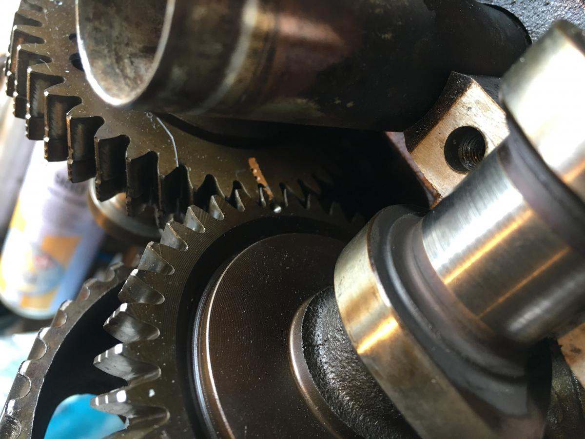

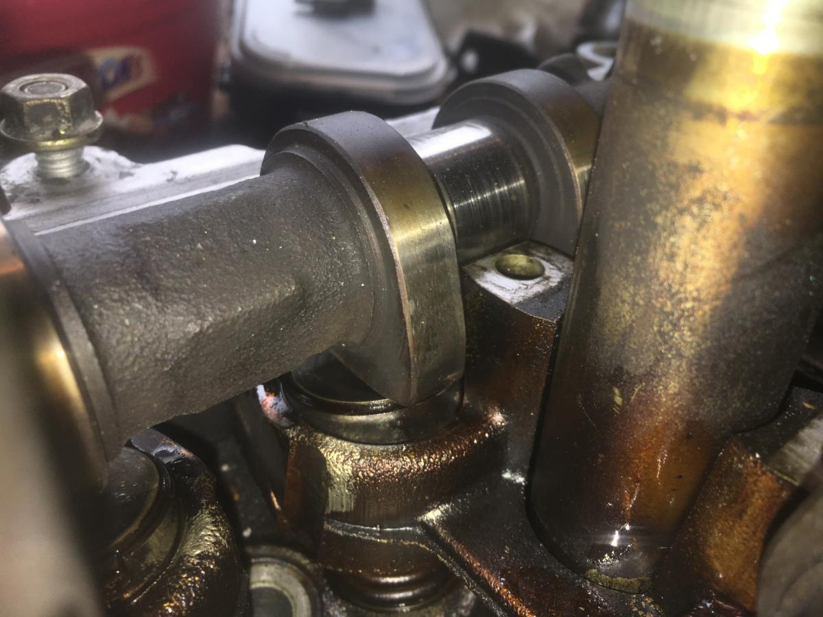

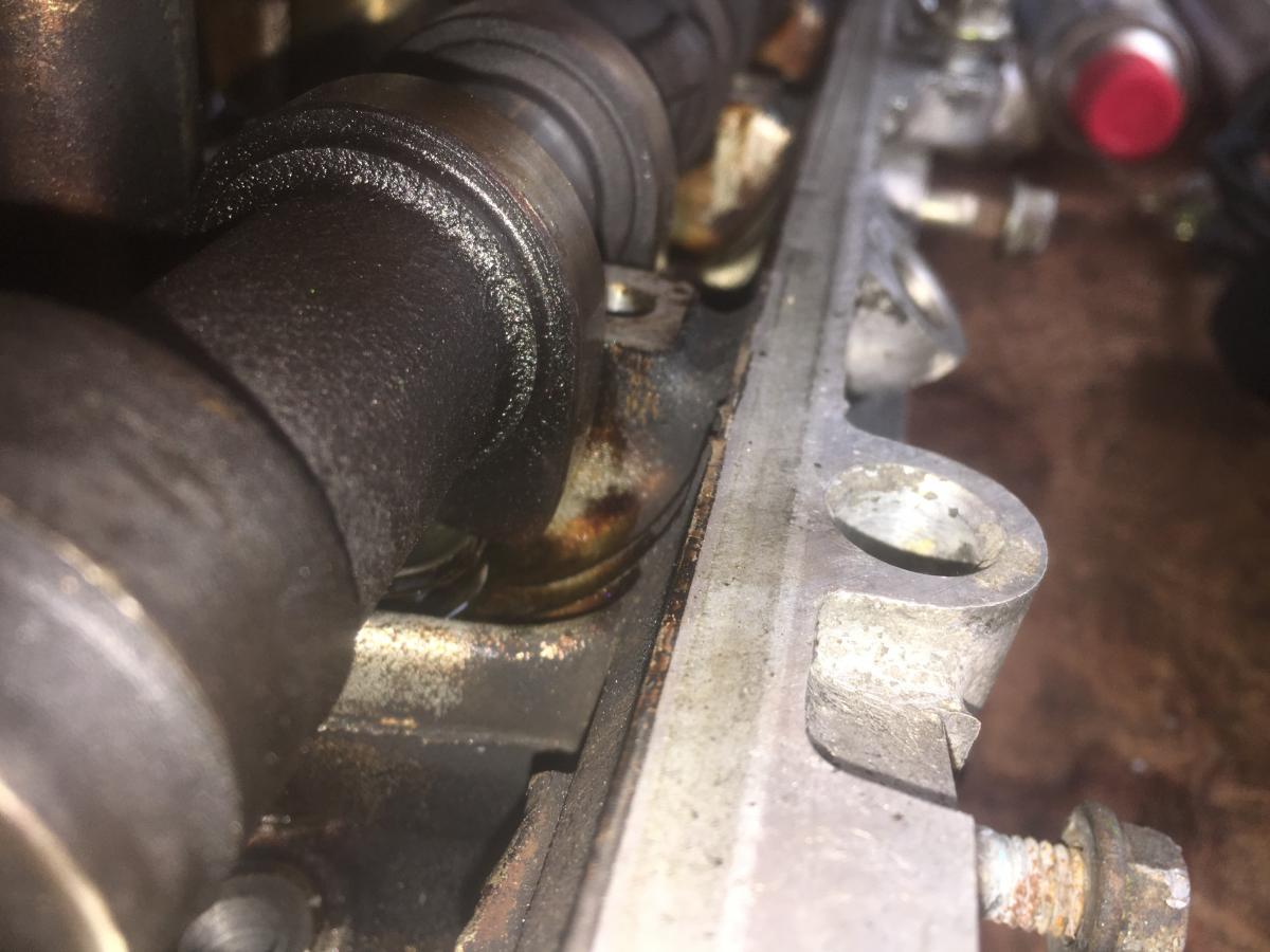

I'm putting the camshaft a back in my FTE head and wasn't sure if I've got it right and need to be 100% certain on my timing. I have all the timing marks lines up, and noticed inlet valves on cylinder number 3 are open slightly. Would this be correct ? No other valves are open. Need a 1/4" torque wrench as my 1/2" only goes as far down as 23 n.m not the 9ft-lbs (13 n.m) required.
I have read the guide on TGTT but couldn't comprehend it fully. See pictures below of timing.

post-12017-0-05696100-1467839394_thumb.j
These light up with the slant of the head.
post-12017-0-22483100-1467839436_thumb.j
Inlet lobes on cyl. 3 position
post-12017-0-21514800-1467839586_thumb.j
Inlet lobes on cyl. 4 position

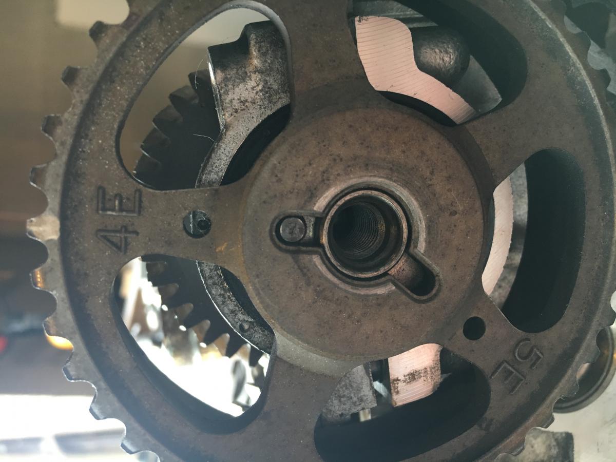

post-12017-0-08546400-1467839668_thumb.j

That bolt needs doing before the cams are removed if youve already done it you can retension it by hand and get a friend to put a bolt in for you. If you dont do it you'll have a lovely rattle from the top end lol

timing looks good to me kid
take out the in cam and use a flat head screwdriver to retension the cog and fit a matching drill bit in the service hole

Will retention the cog when I get a 1/4" torque wrench as my 1/2 inch only goes to 23n.m :(
