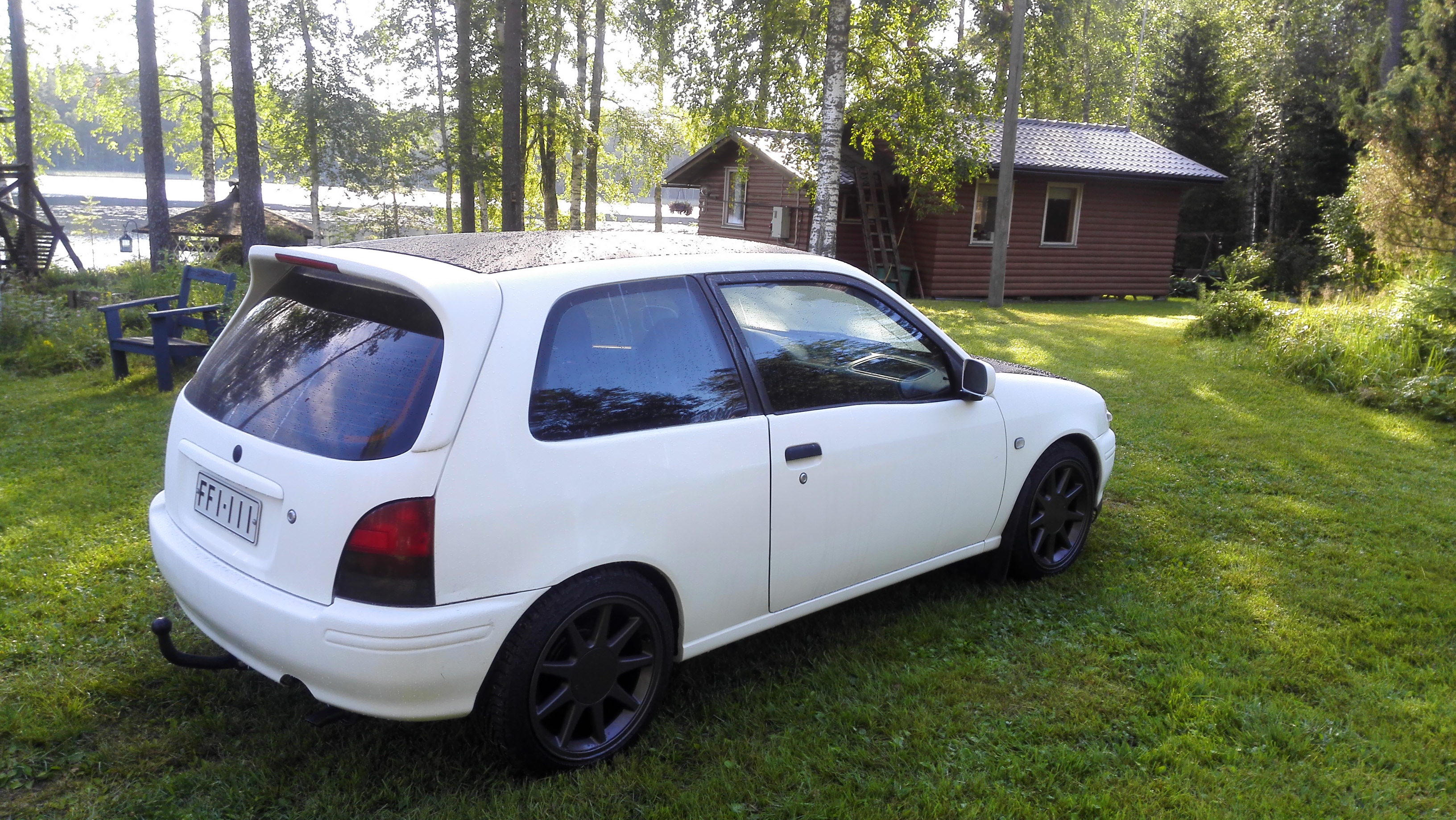

MR-2 Posted November 3, 2017 Author Posted November 3, 2017 11 hours ago, Mxdsnny said: Ya photo bucket mess everything up real good! What photo sharing site are you using now? Nothing new, pictures are still there, but links have maybe changed, horrible job to try change those. This is my EP91 old gallery http://s1378.photobucket.com/user/misterkaksi/library/EP91%20Starlet Lately have painted my hood oem white, little bit gunmetal painted front bumper and grill, made 2" exhaust with 4A-FE header and Honda Type-R rear silencer, new Apexi intake, VW front coilovers and Tein lowering springs rear, towing hitch, painted almost half of car underside, Gazoo Racing graphics, etc. Maybe I download few photos more... Quote

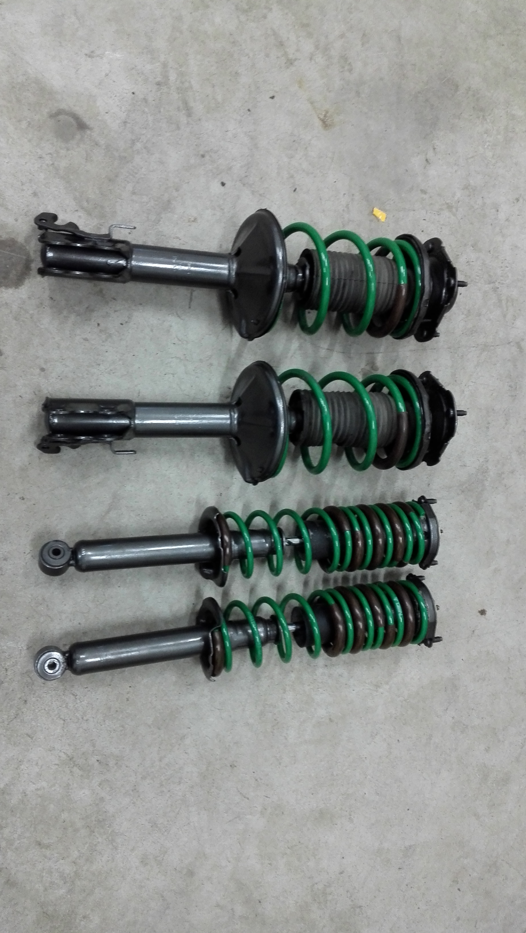

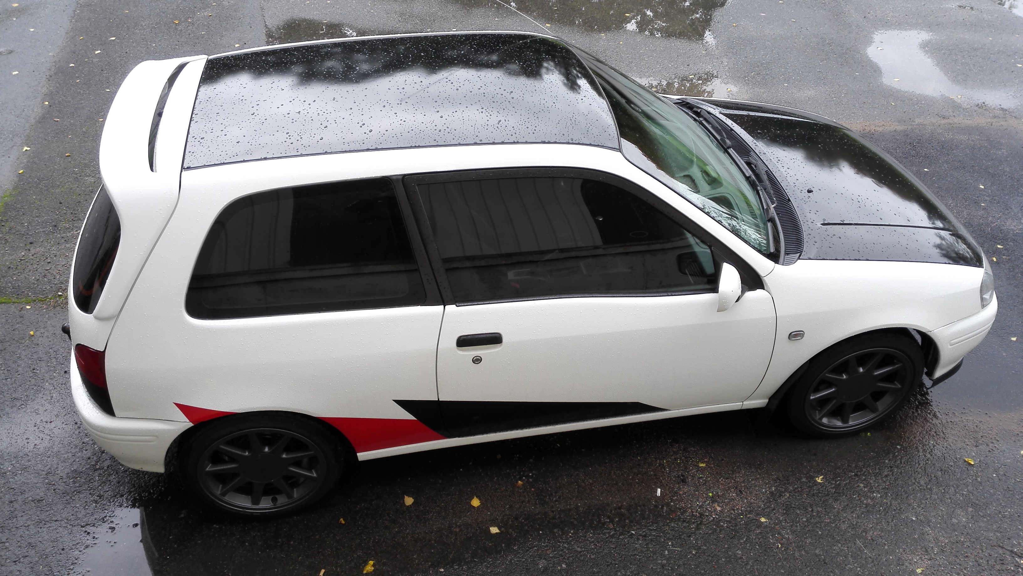

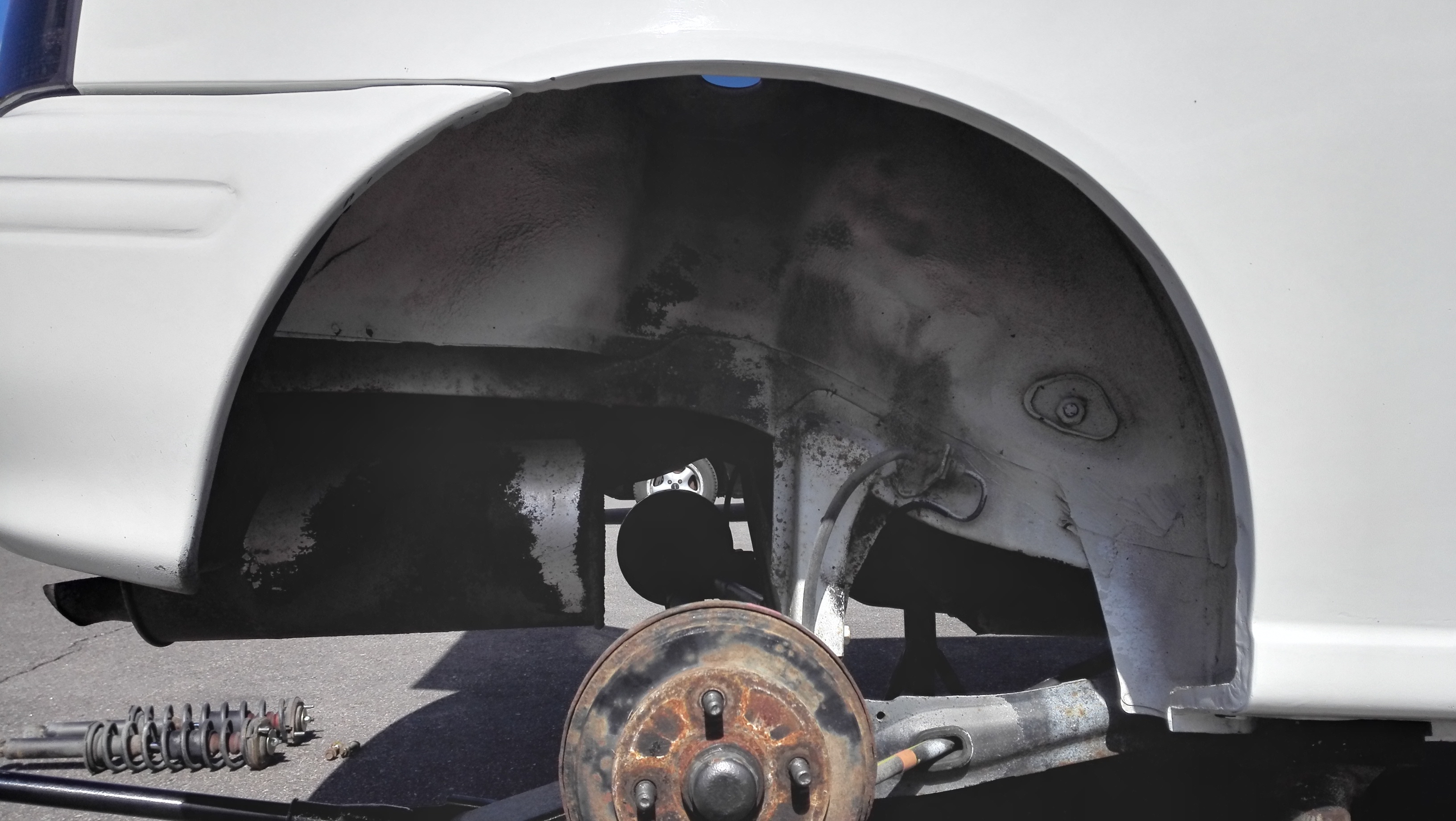

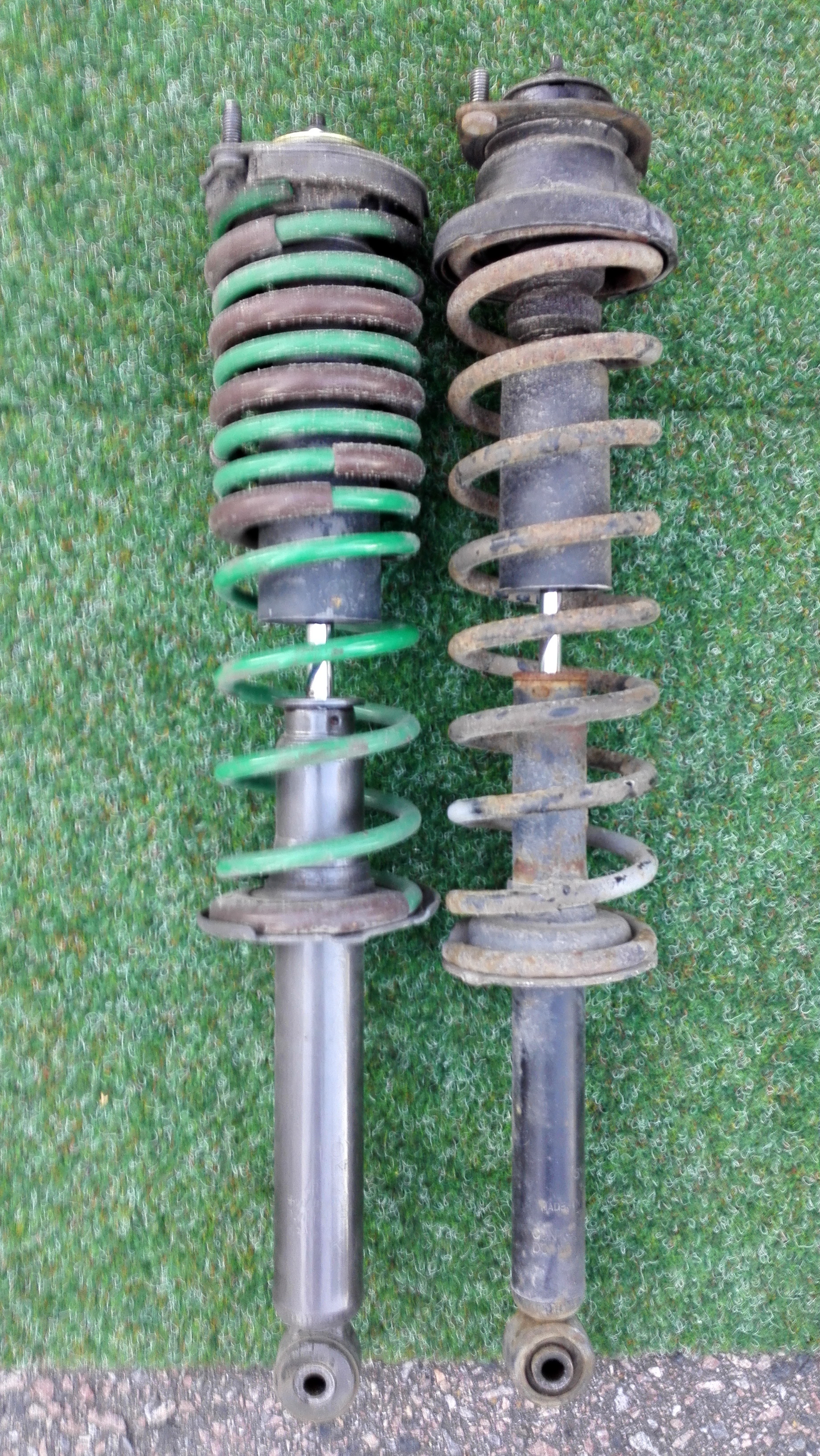

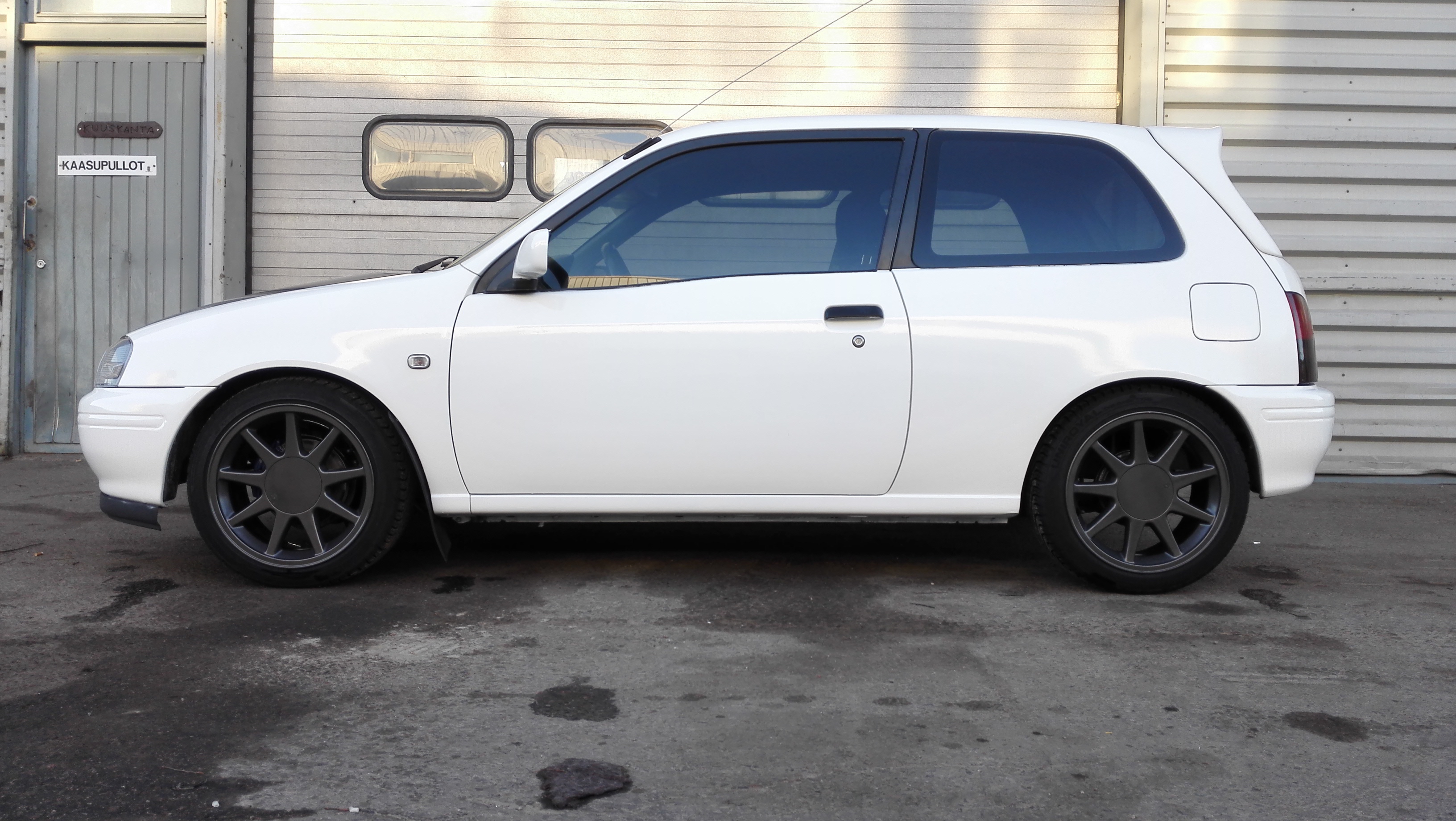

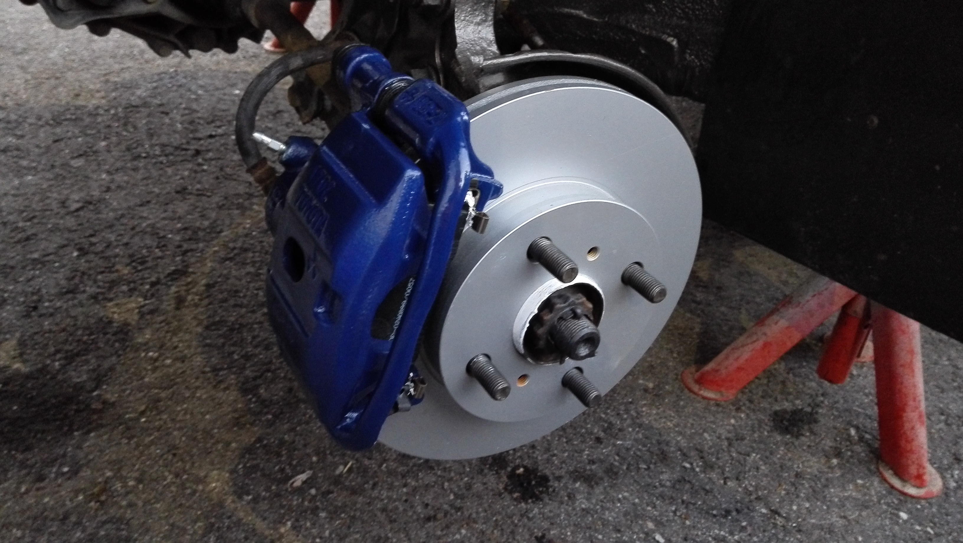

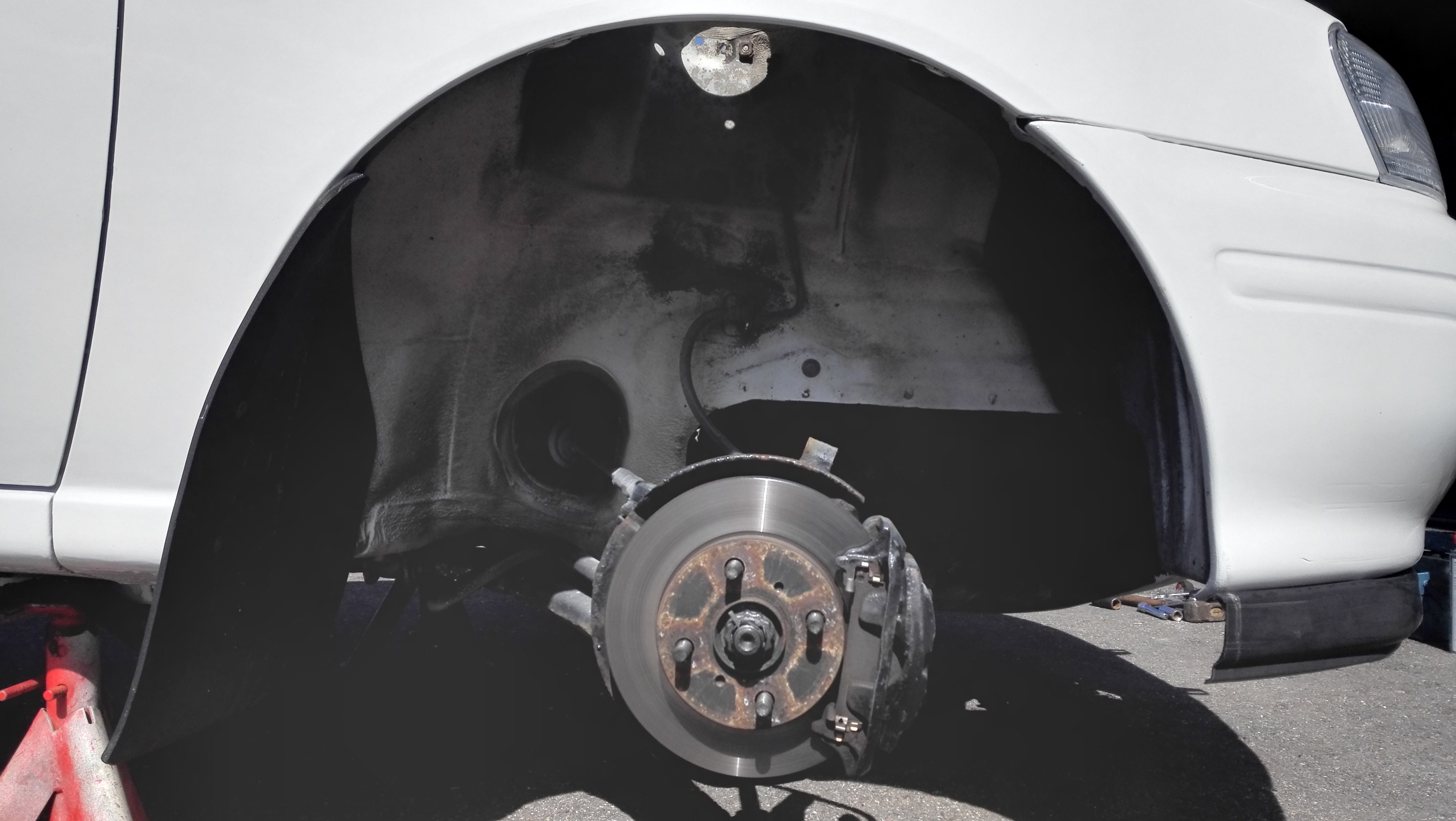

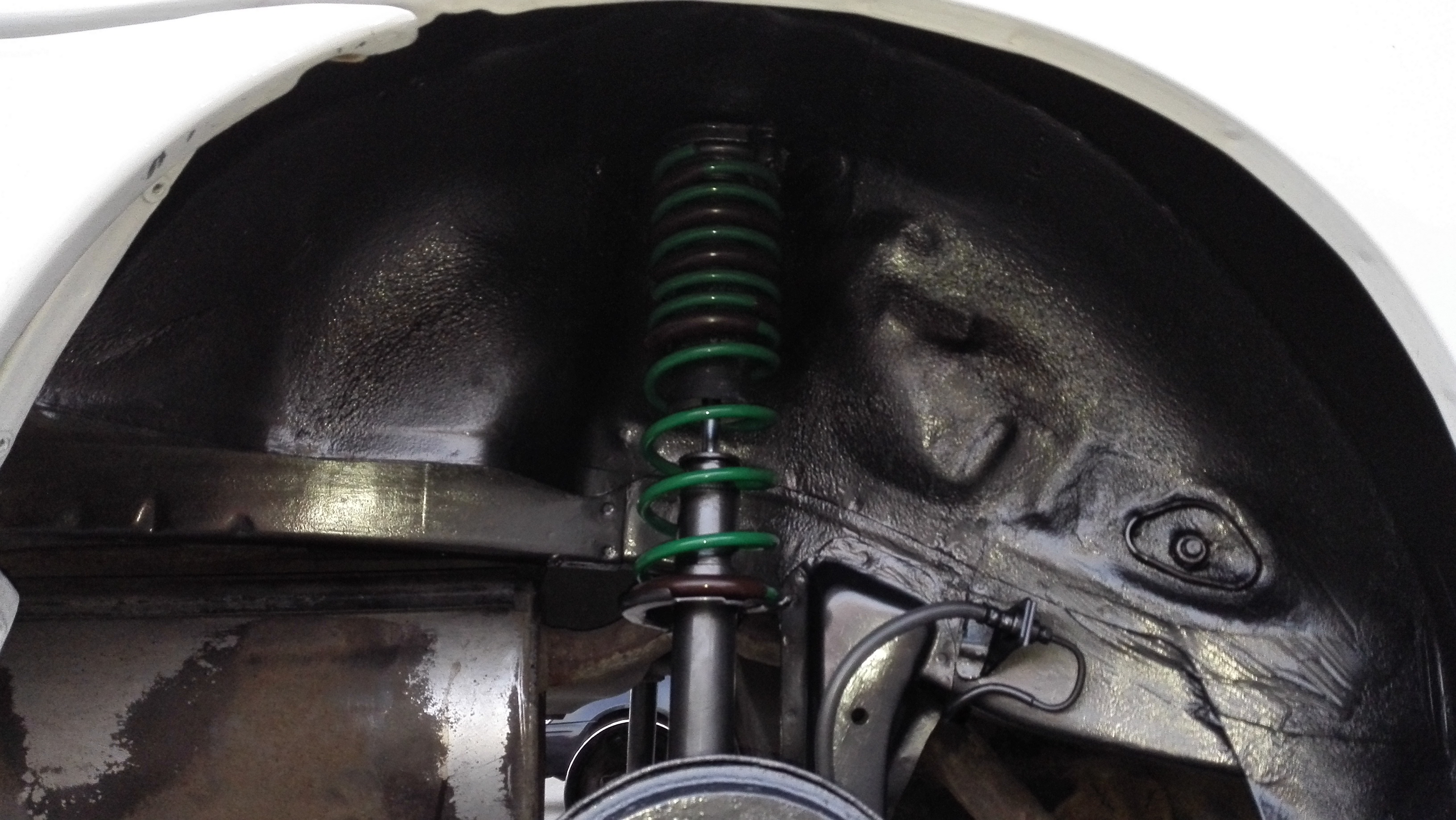

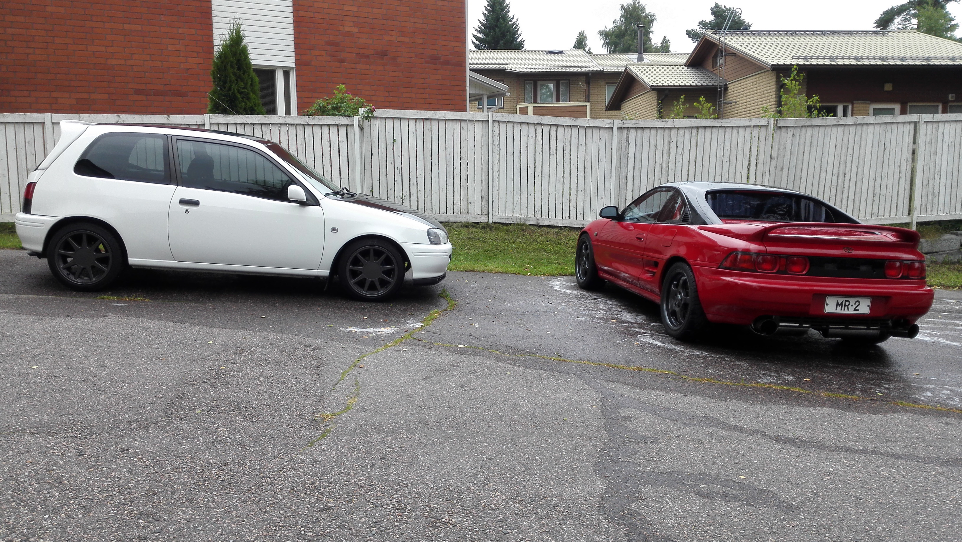

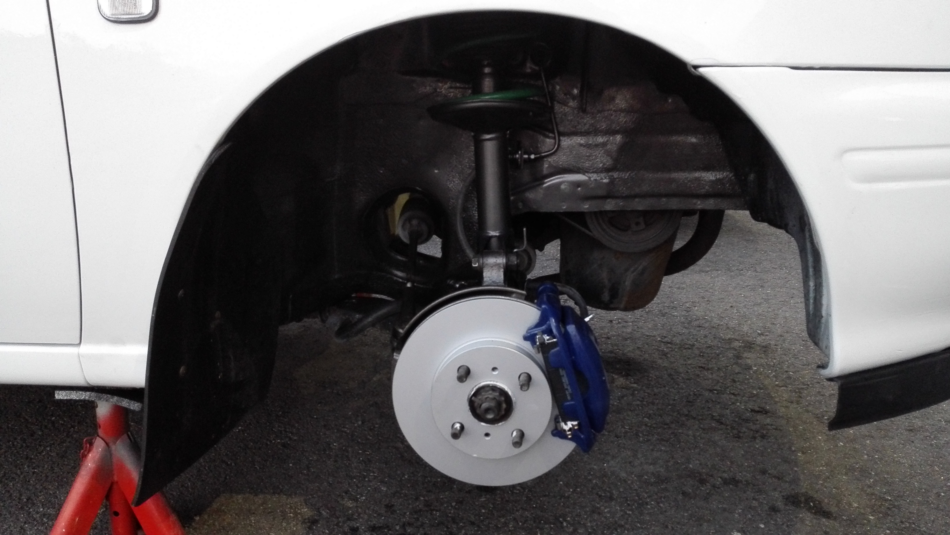

MR-2 Posted November 9, 2017 Author Posted November 9, 2017 Painted body, brakes and shocks little bit, new Tein lowering springs, rear eas ok, but front didn't went low enough :/ Quote
MR-2 Posted November 9, 2017 Author Posted November 9, 2017 Not proper progressive spring, cutted 3/4 round away, little bit better, don't buy this shit, too soft also. I post front VW coilover pictures later... Quote

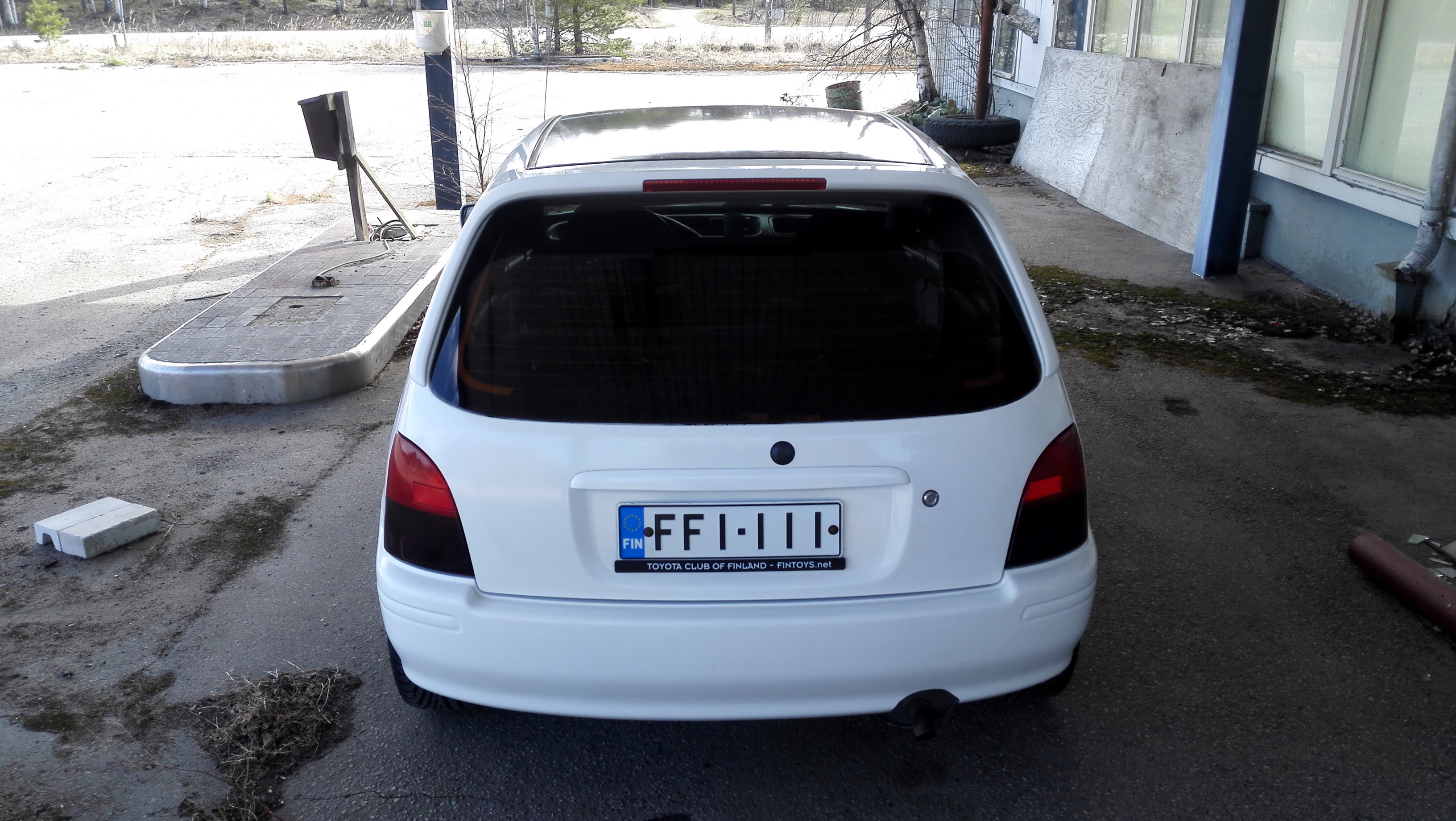

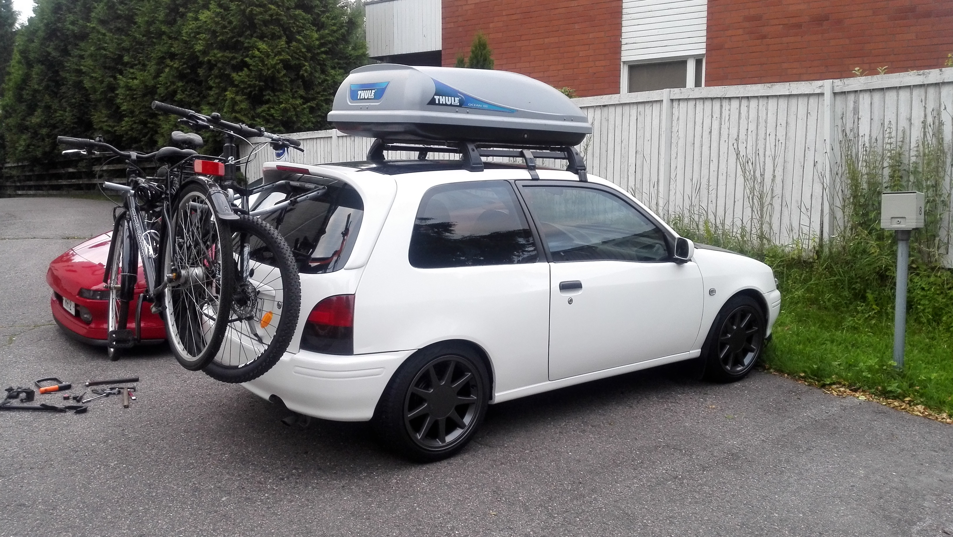

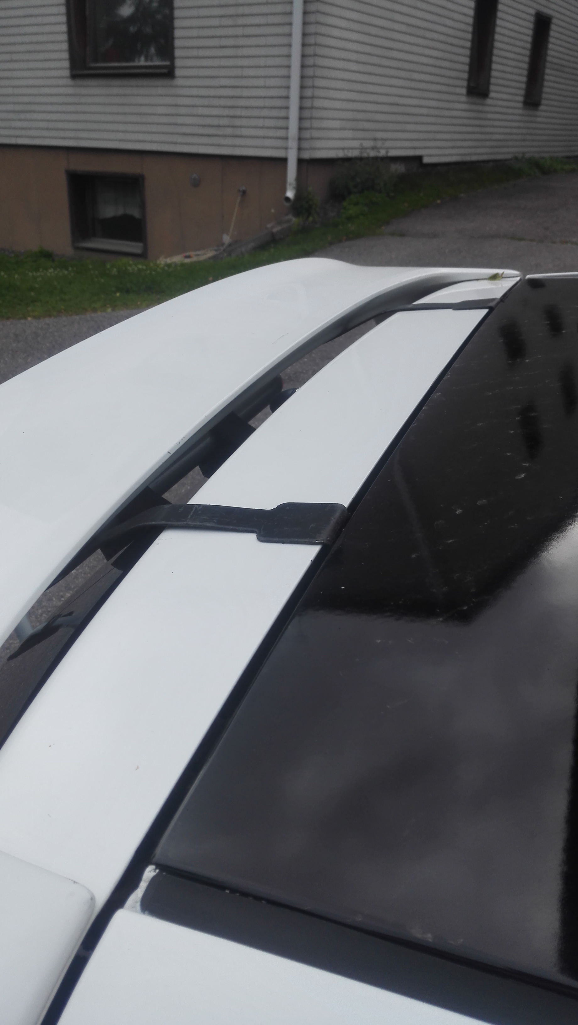

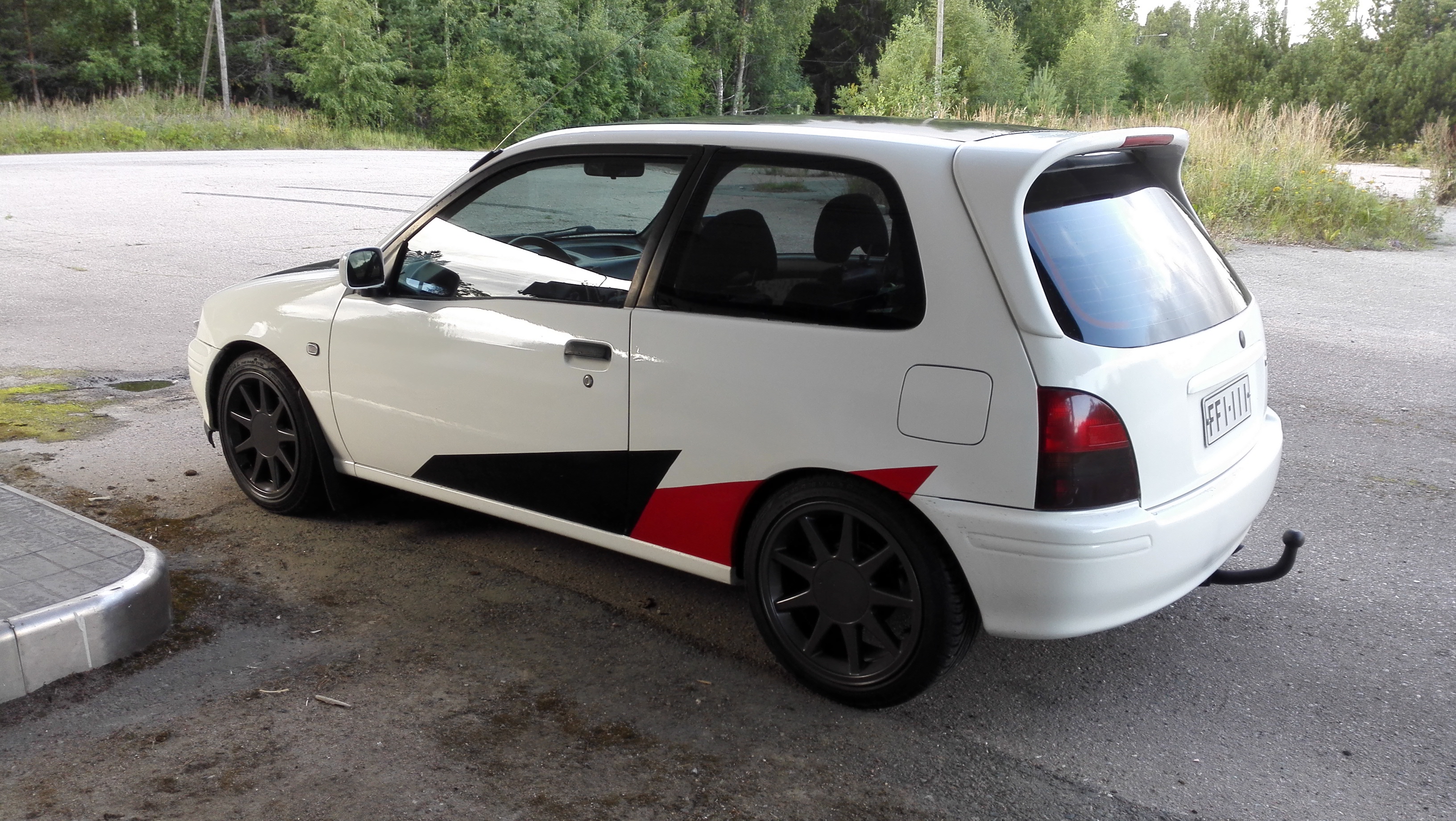

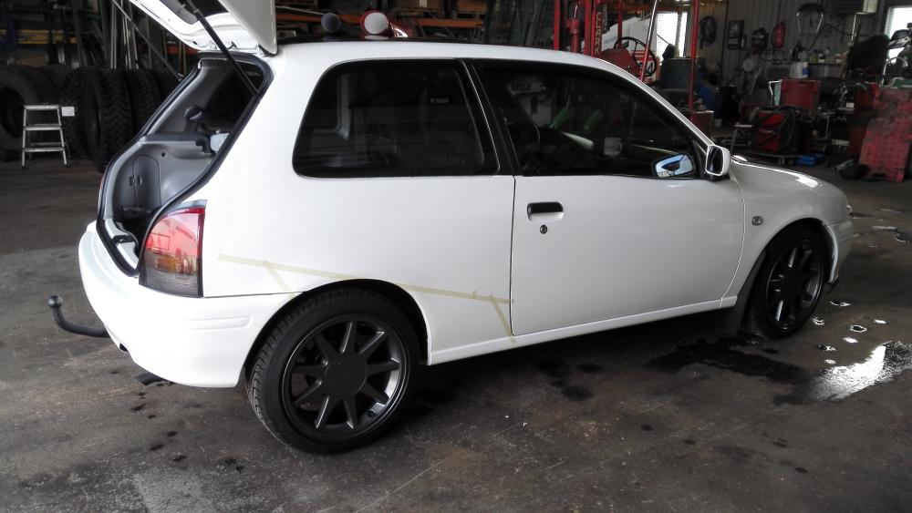

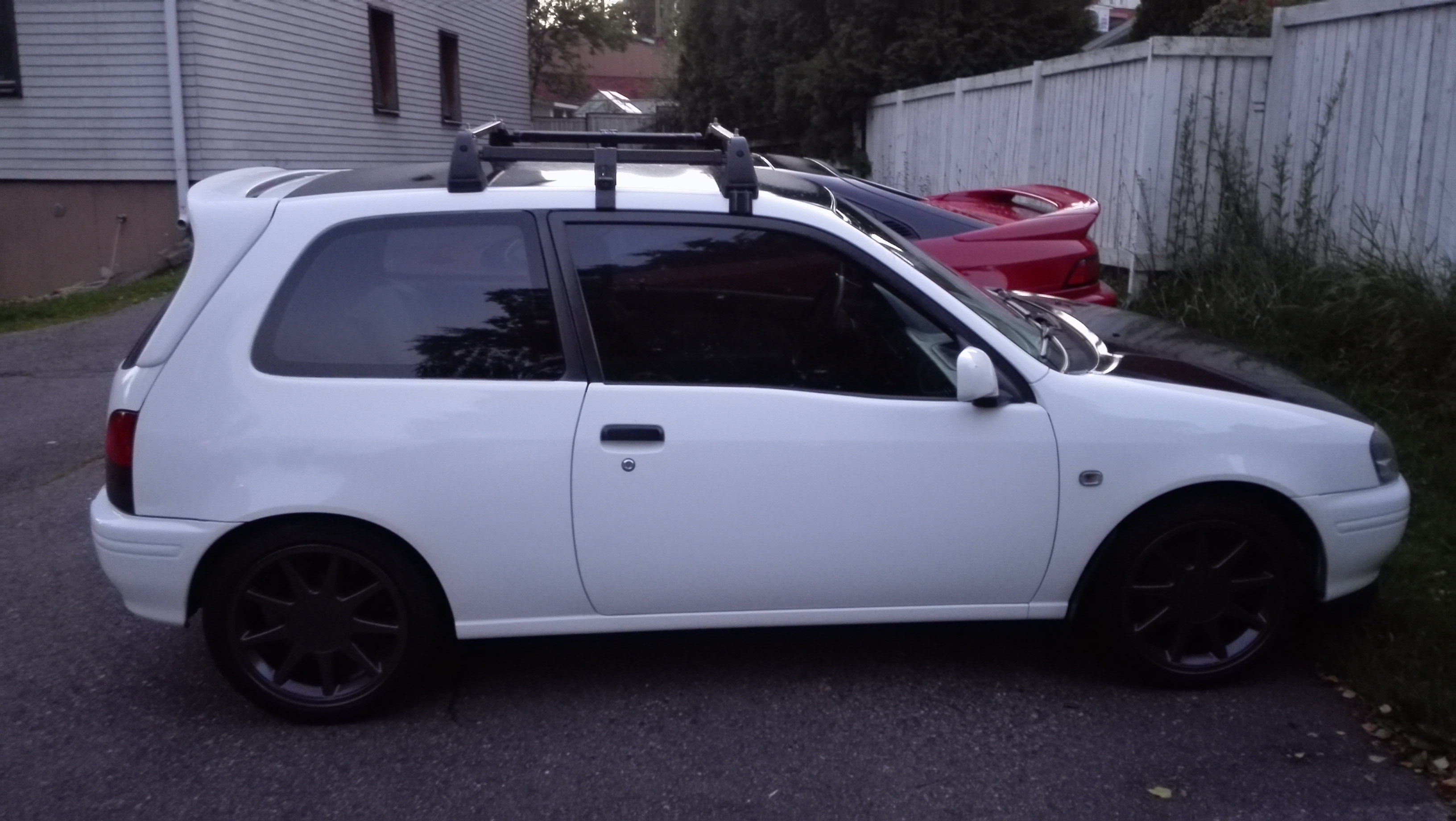

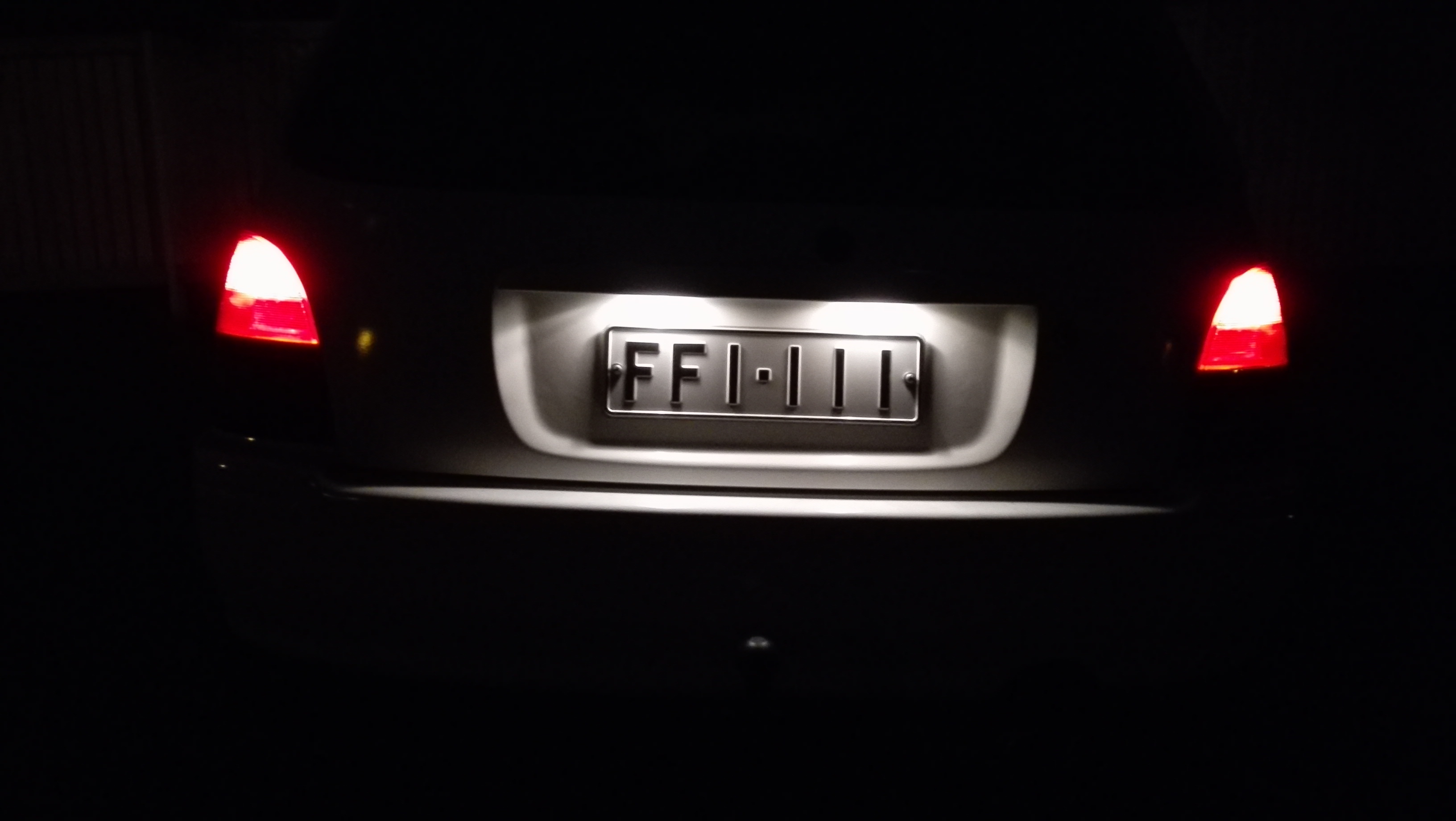

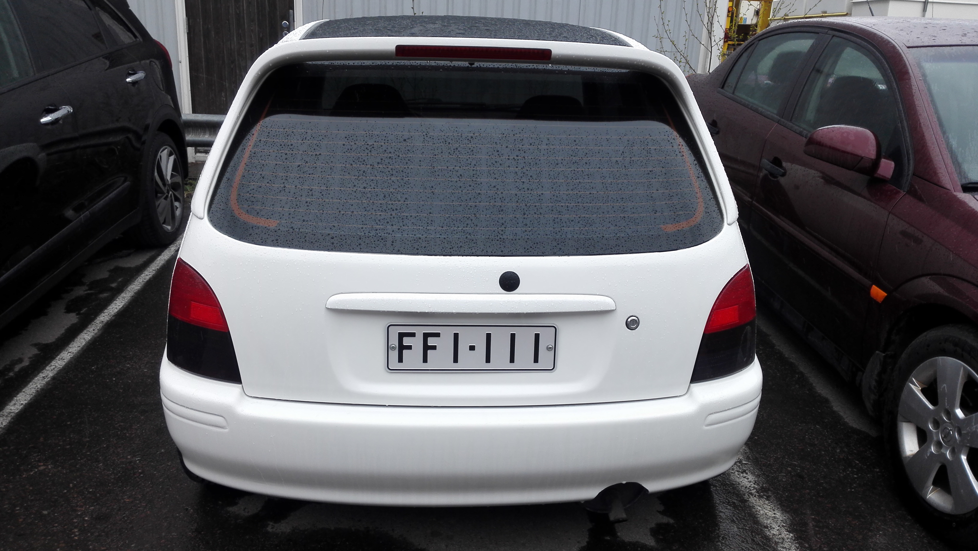

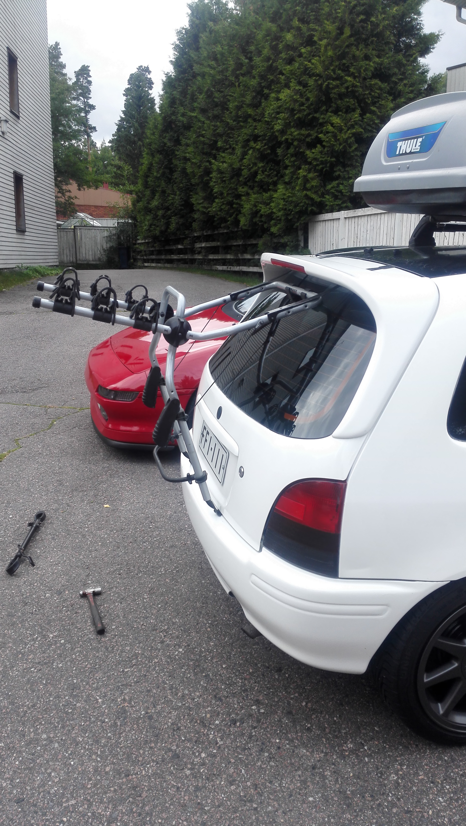

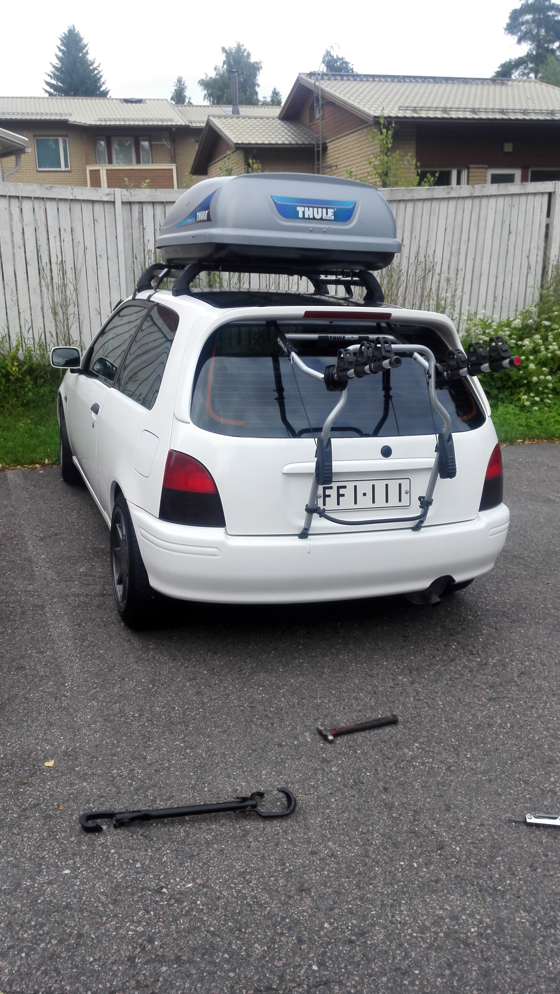

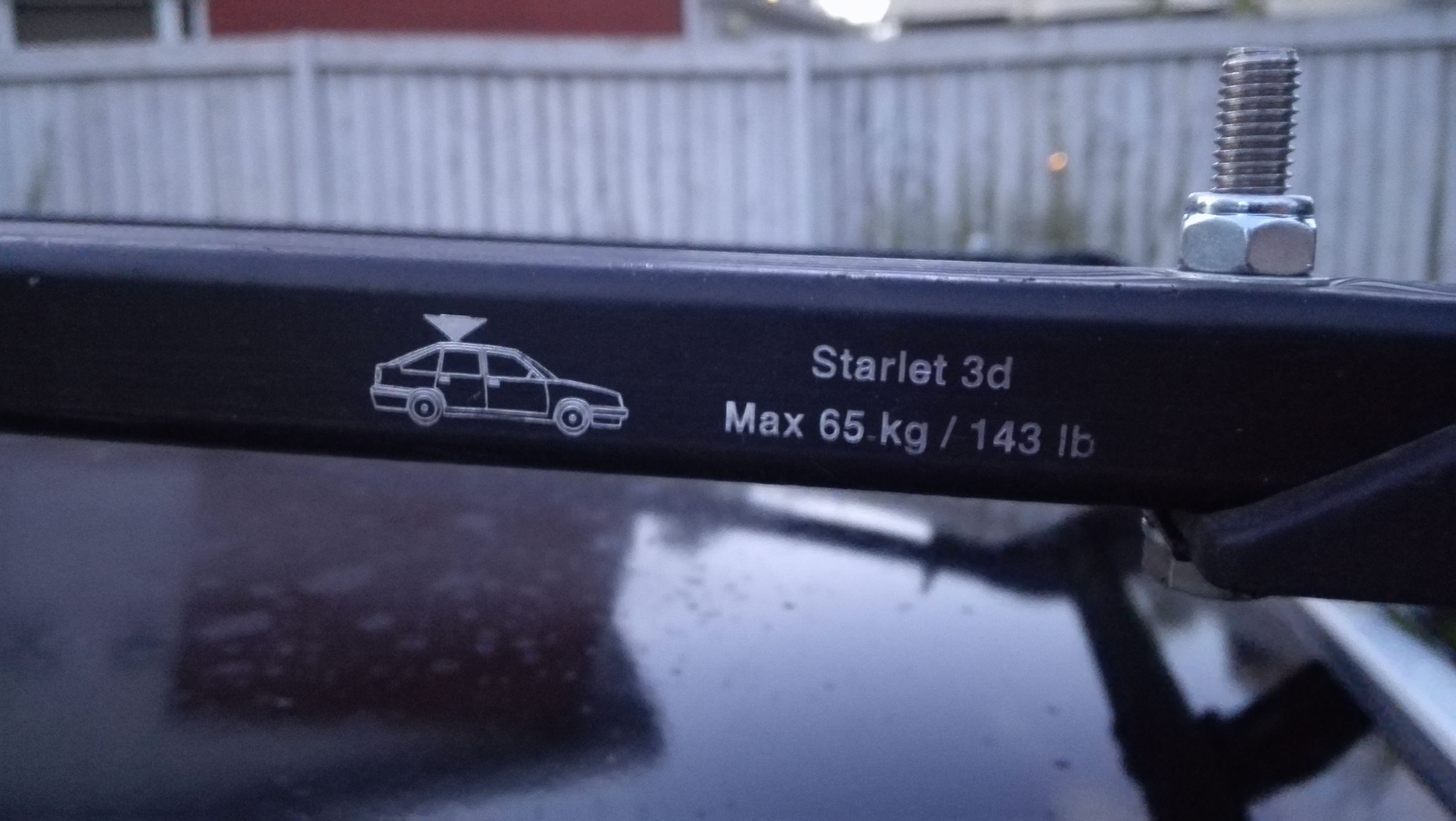

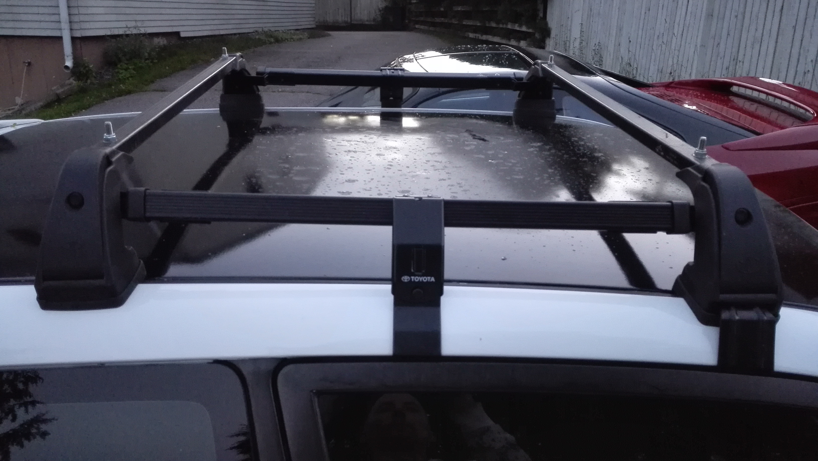

MR-2 Posted November 9, 2017 Author Posted November 9, 2017 Changed brexit register plates and added some bike and roof rack for summer trips, antituning :) Quote

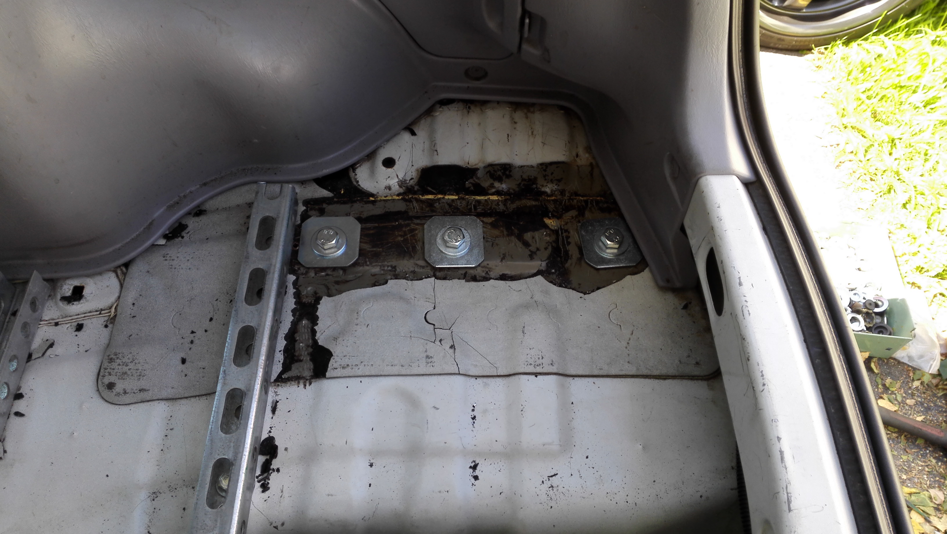

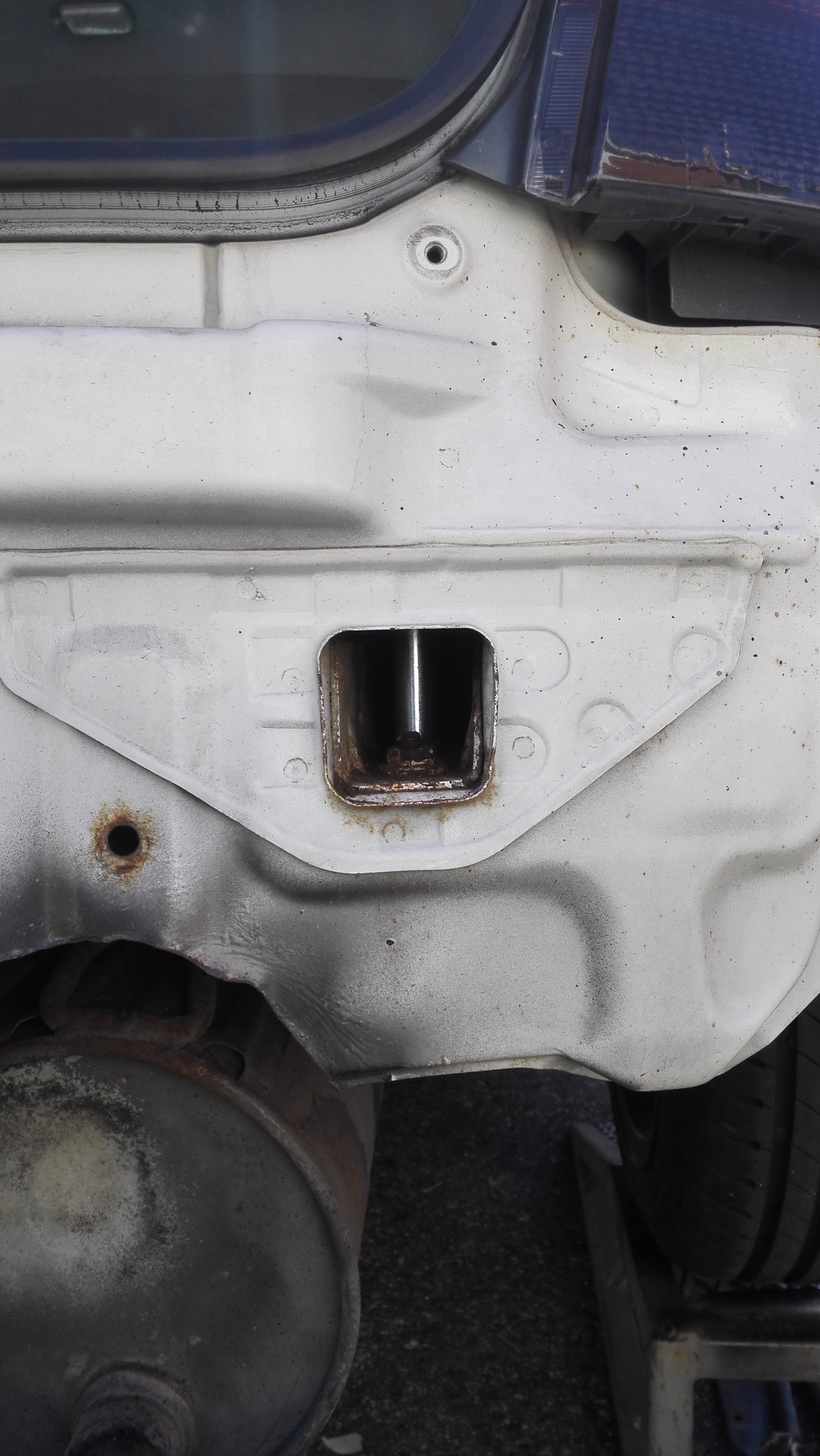

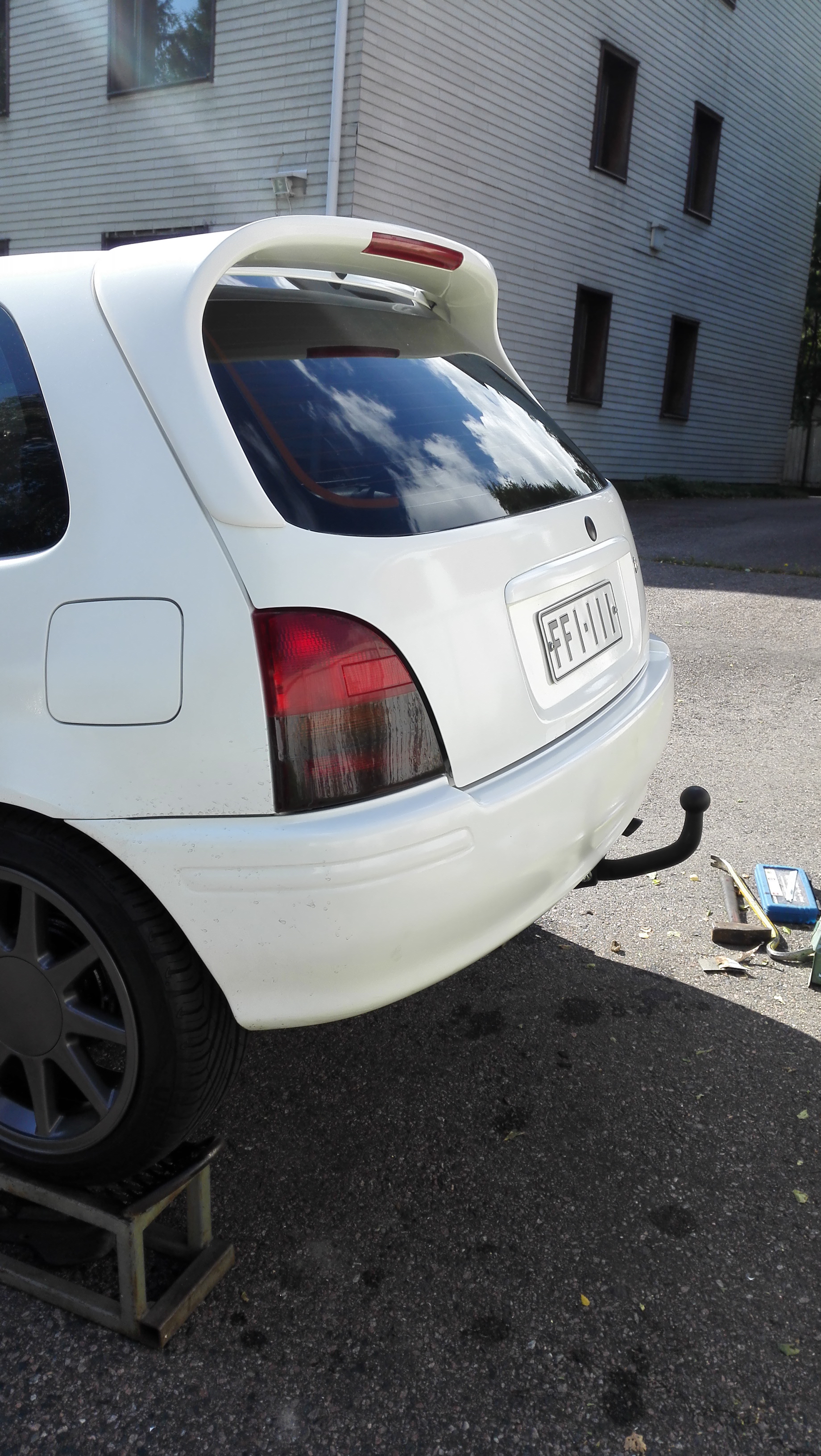

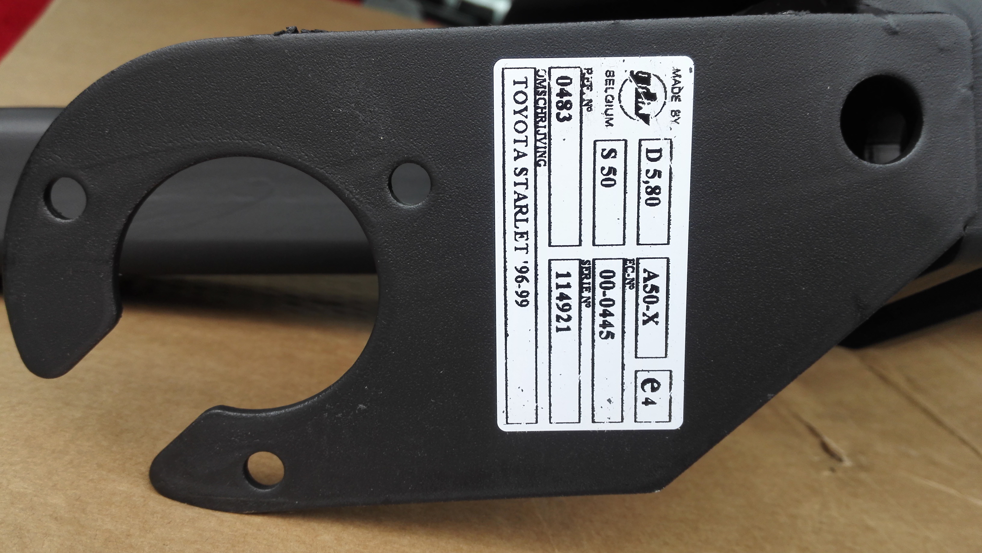

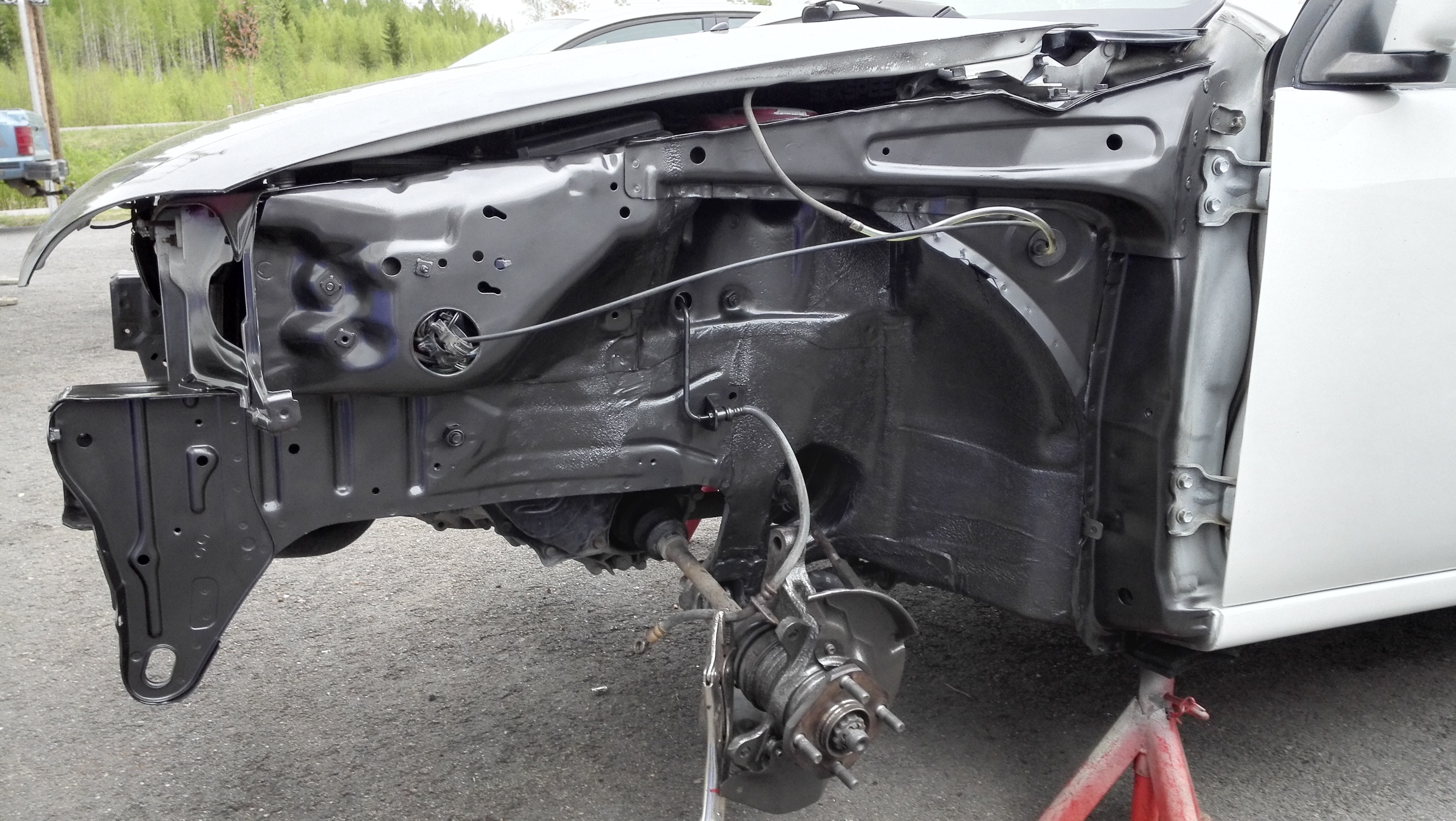

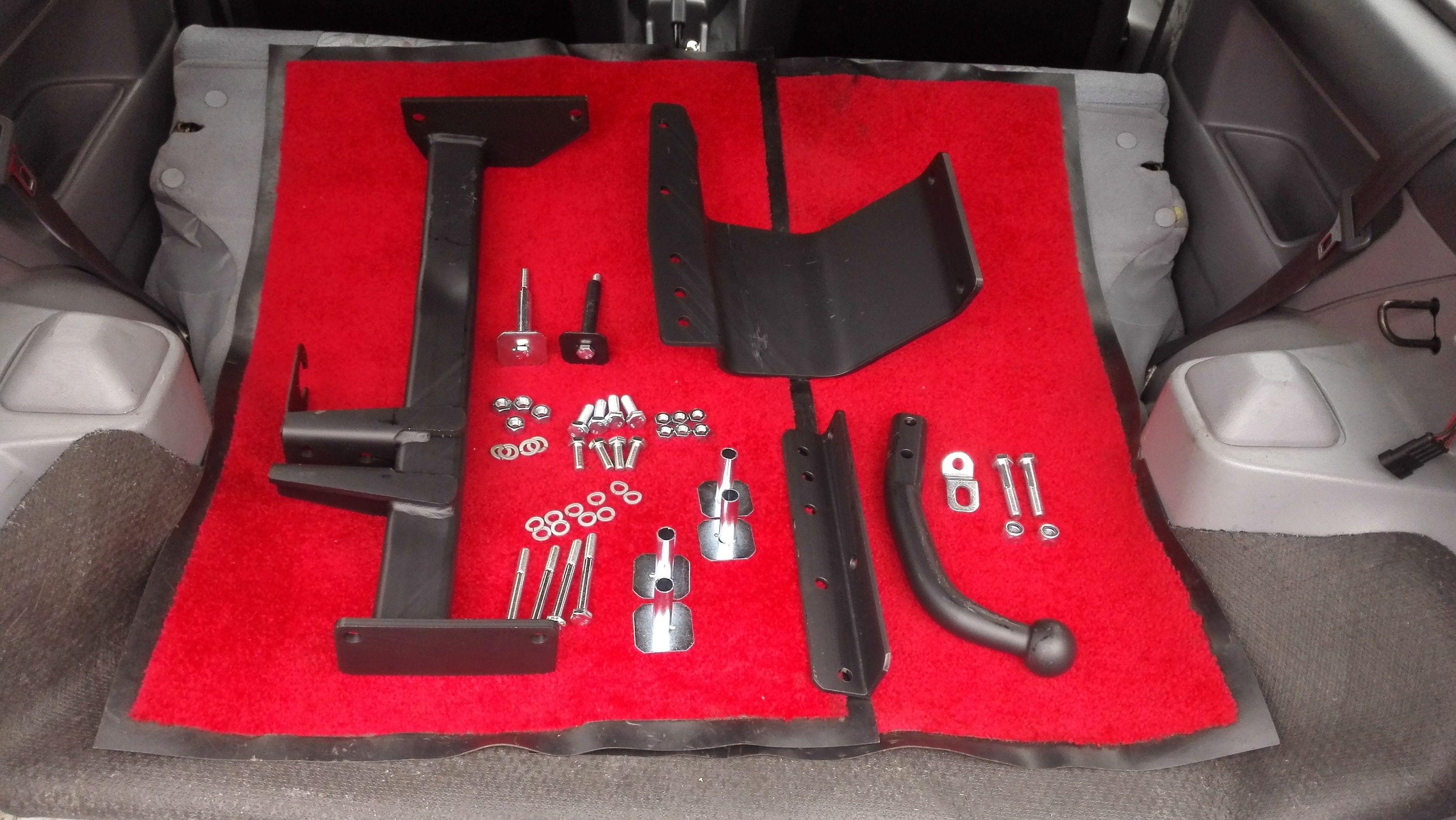

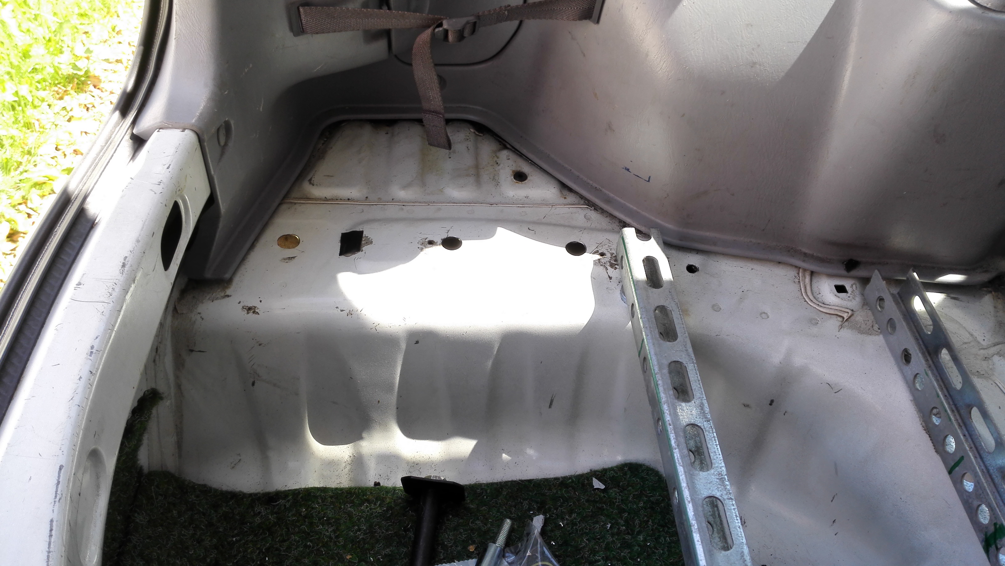

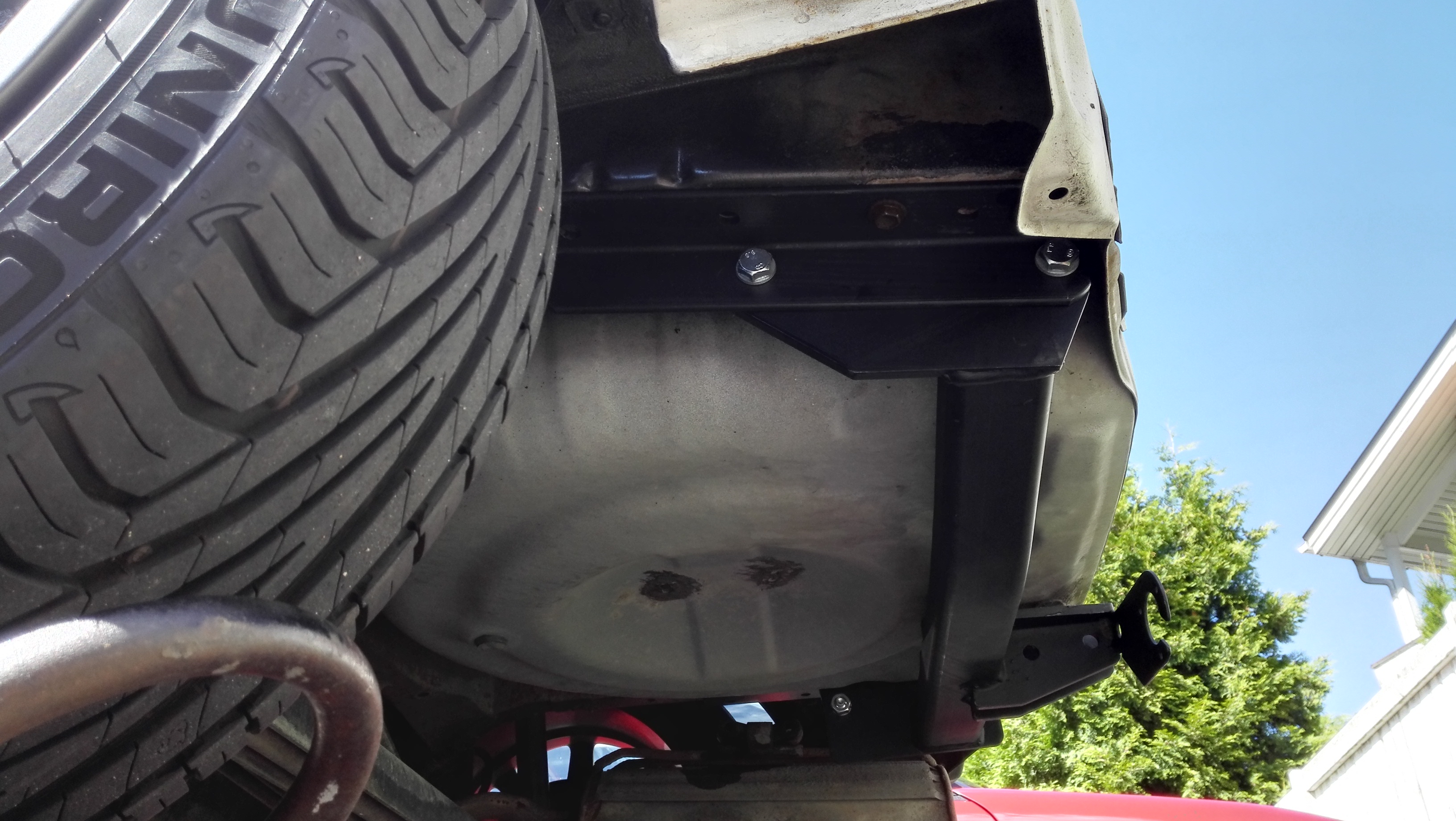

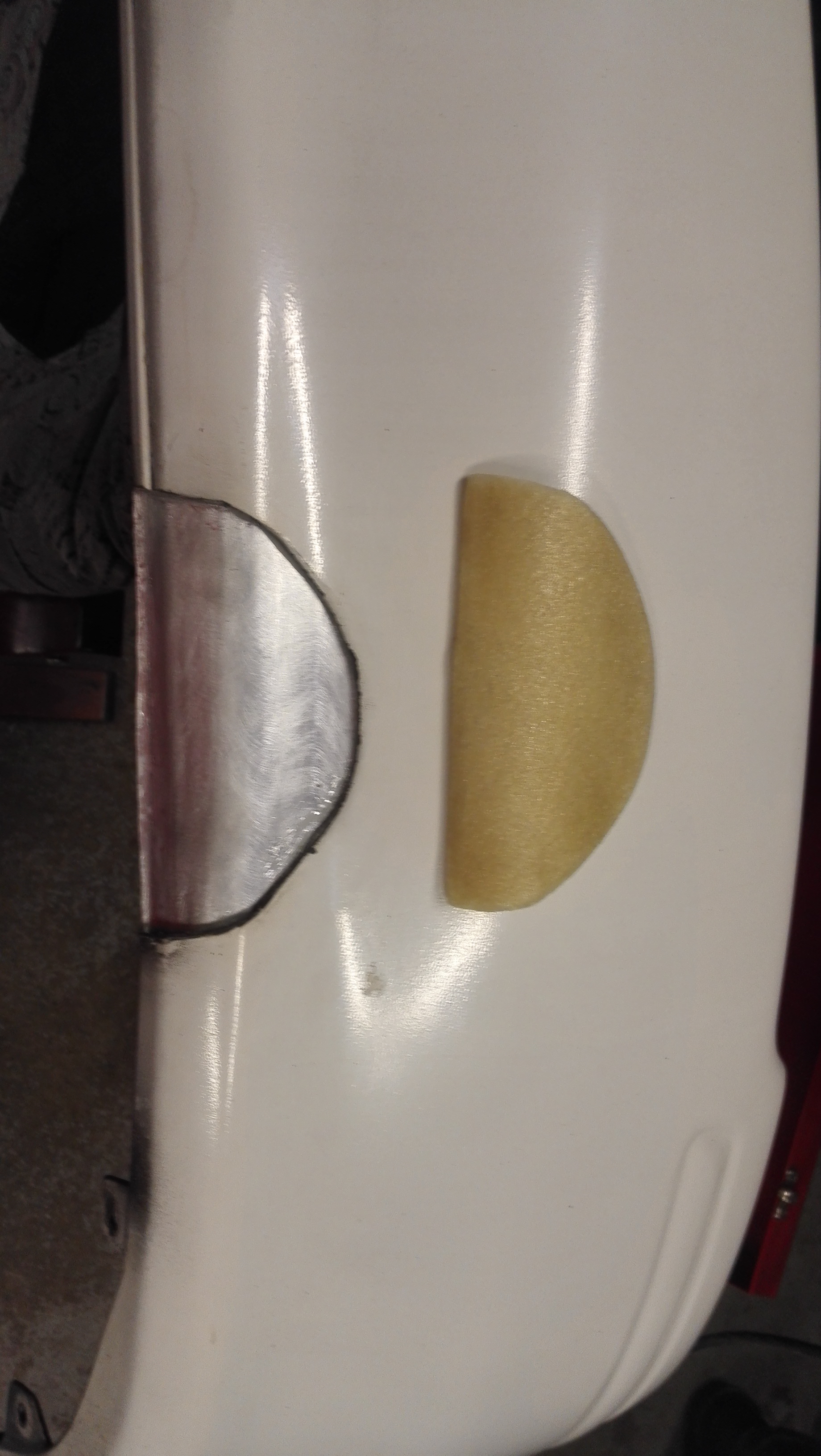

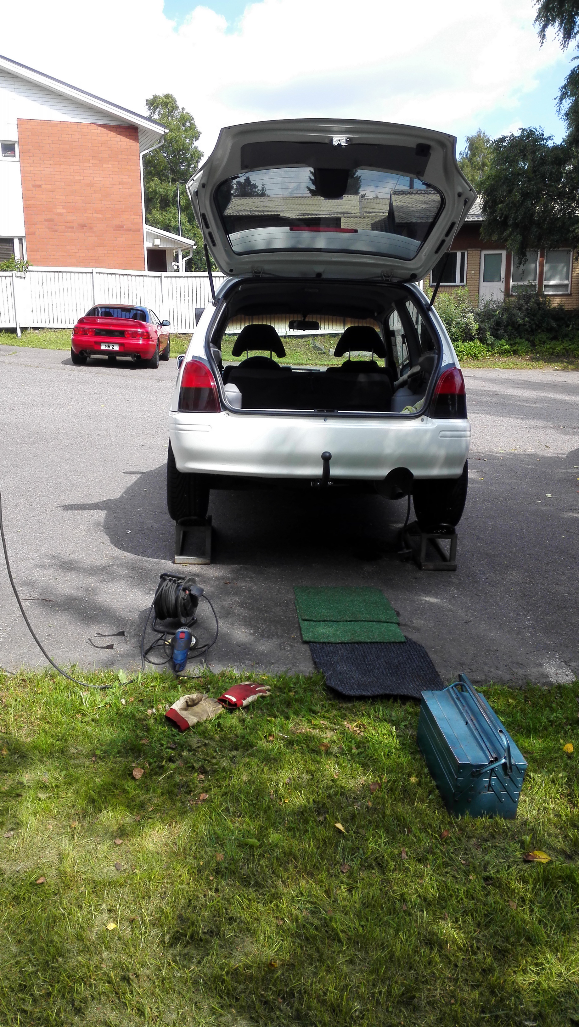

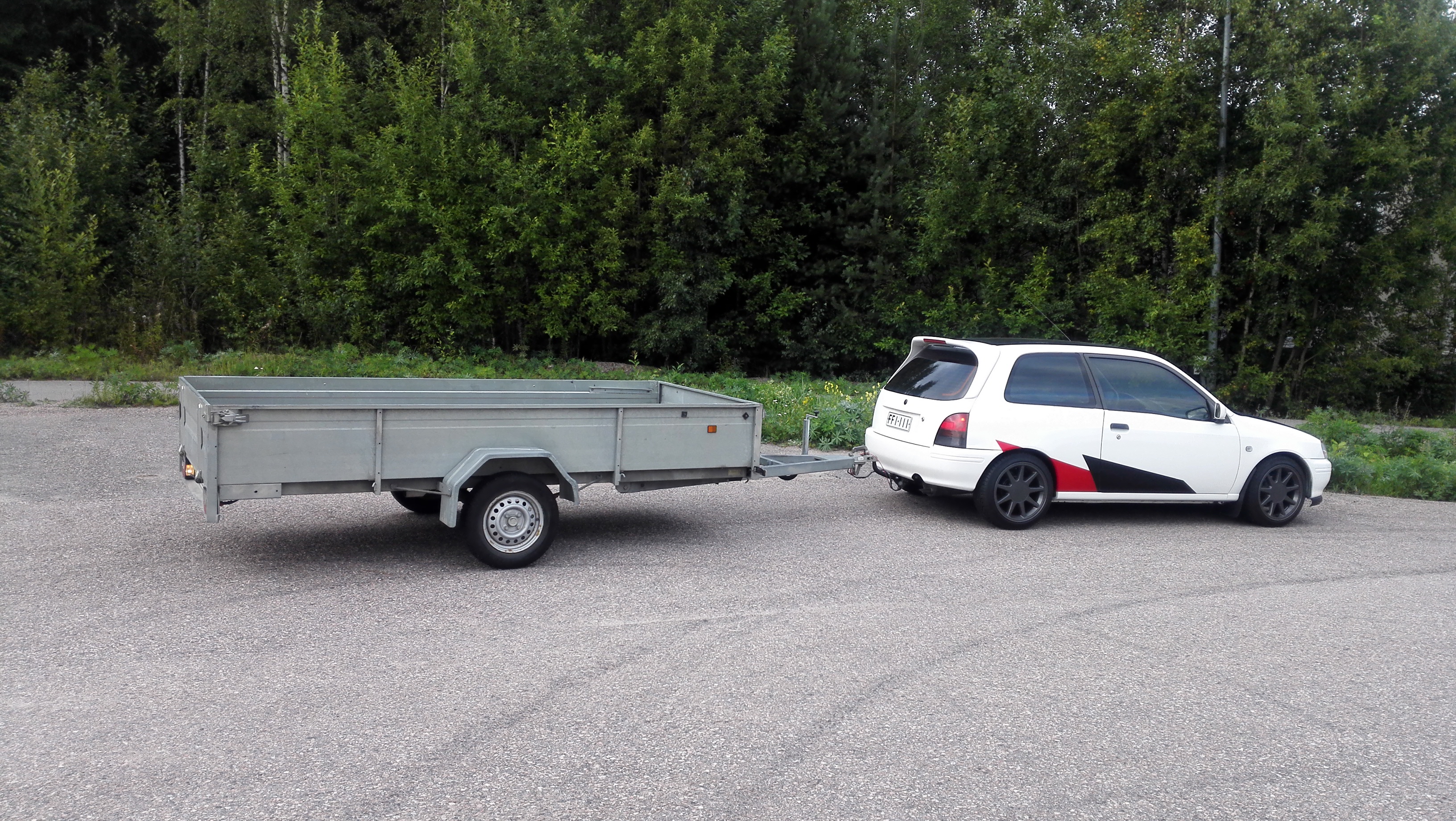

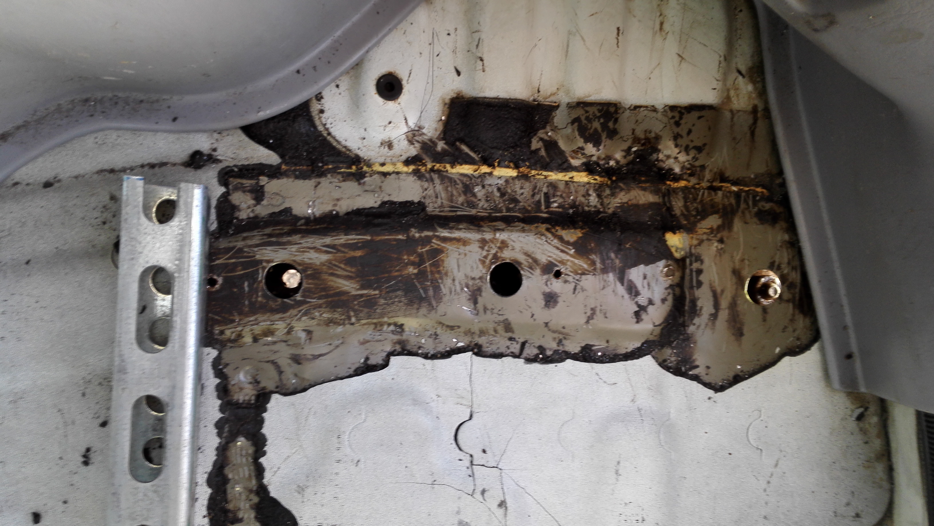

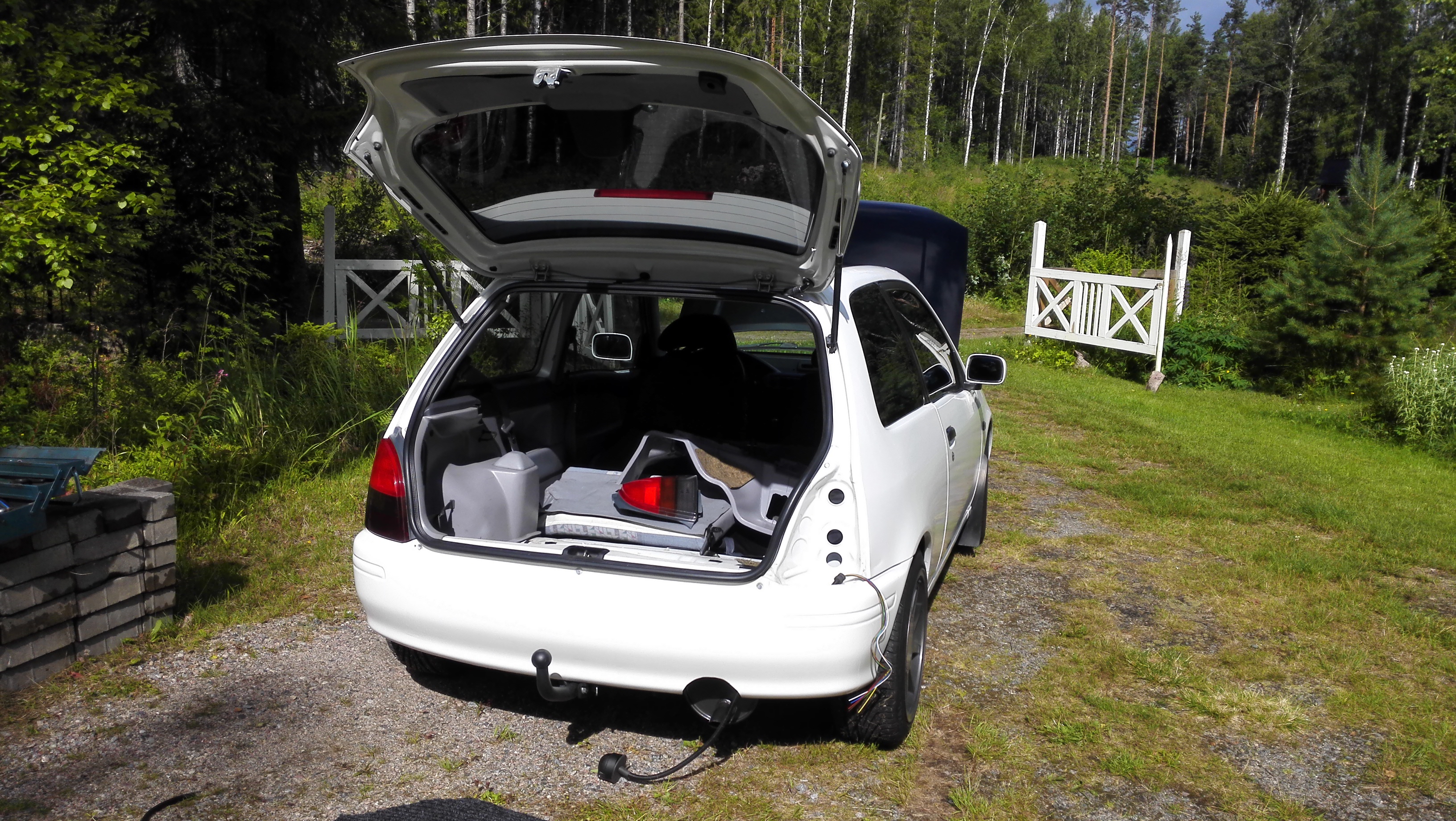

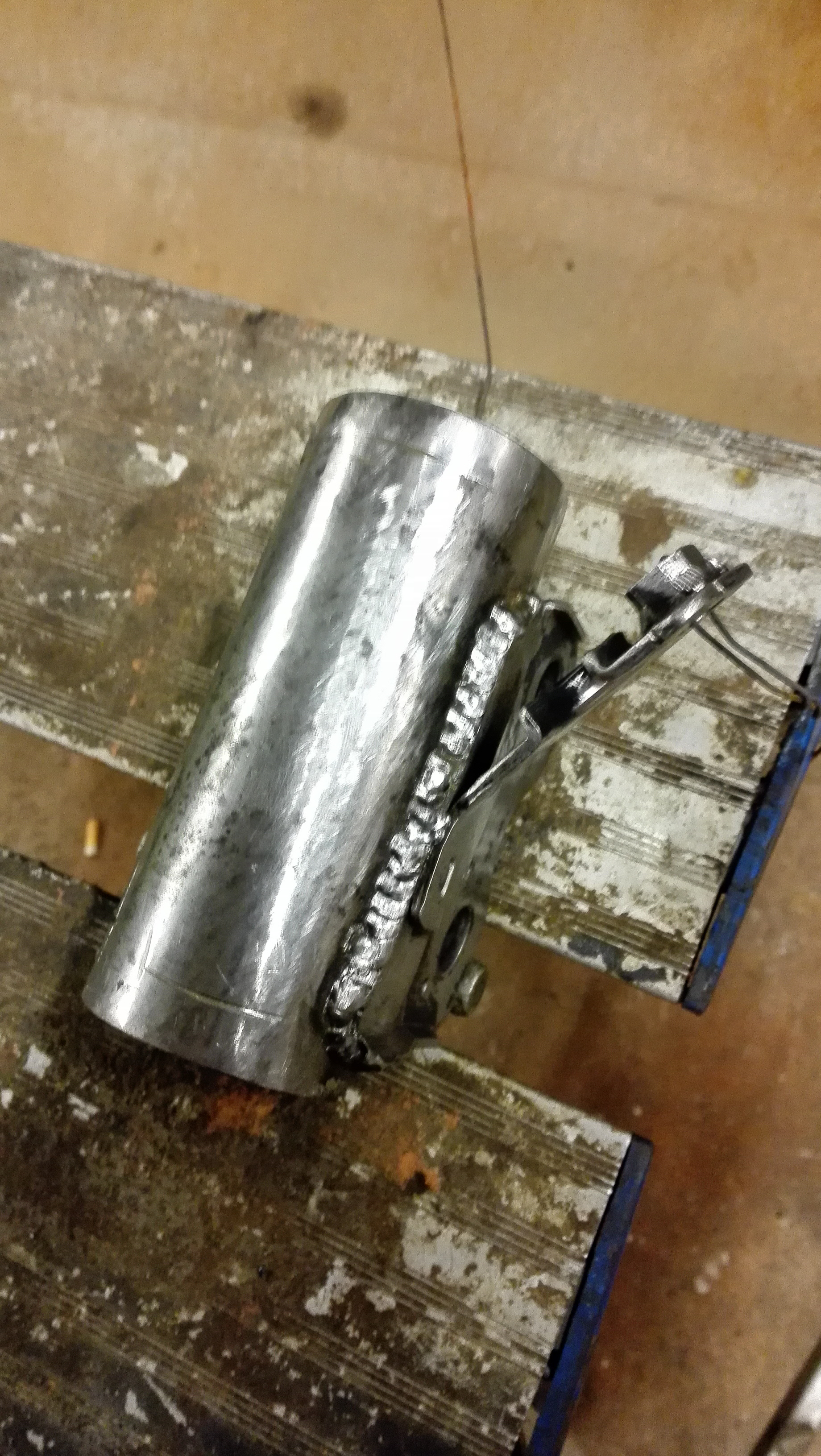

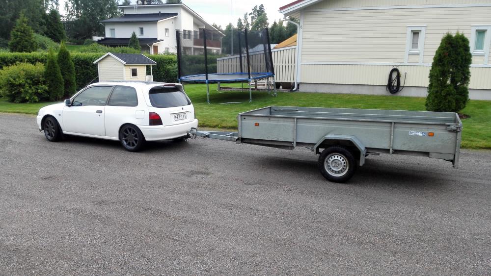

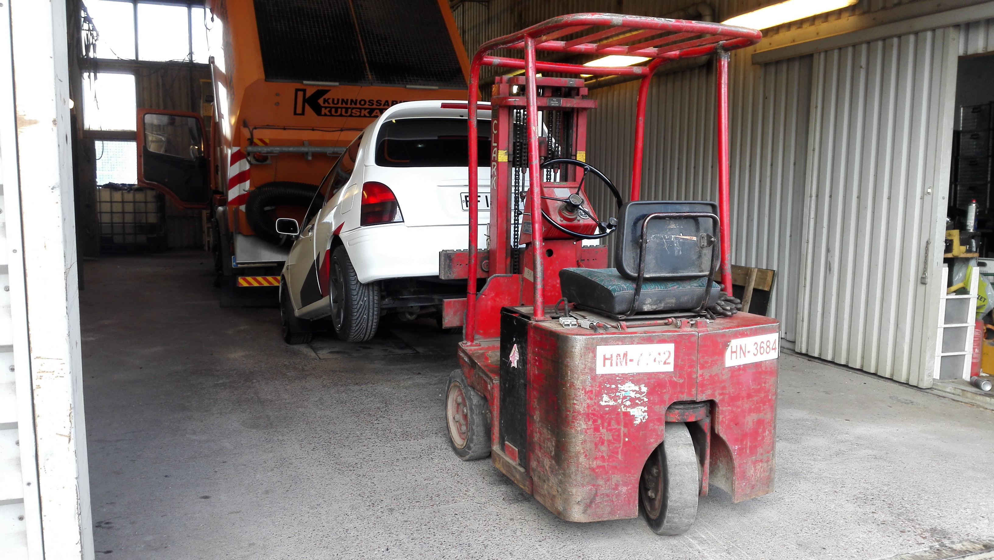

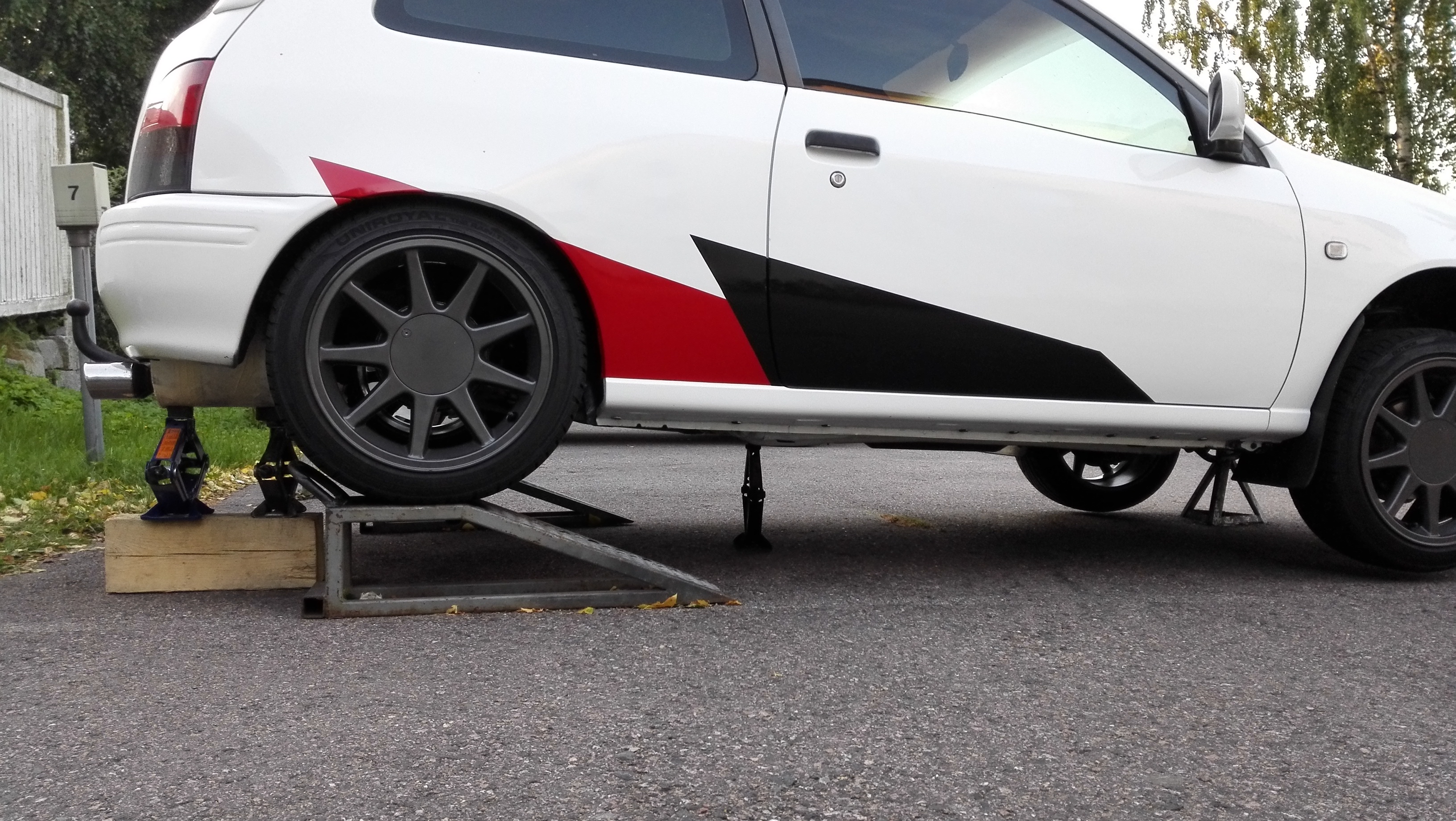

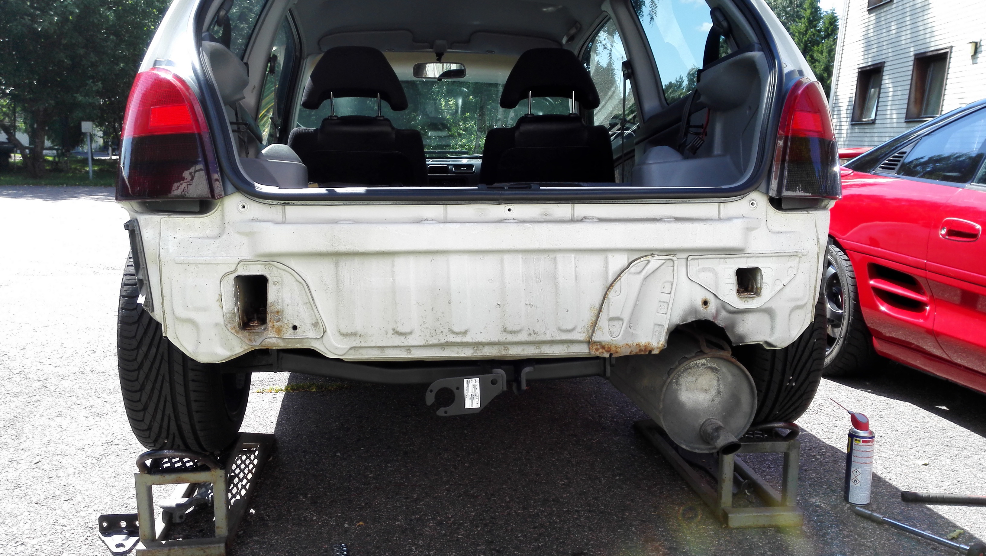

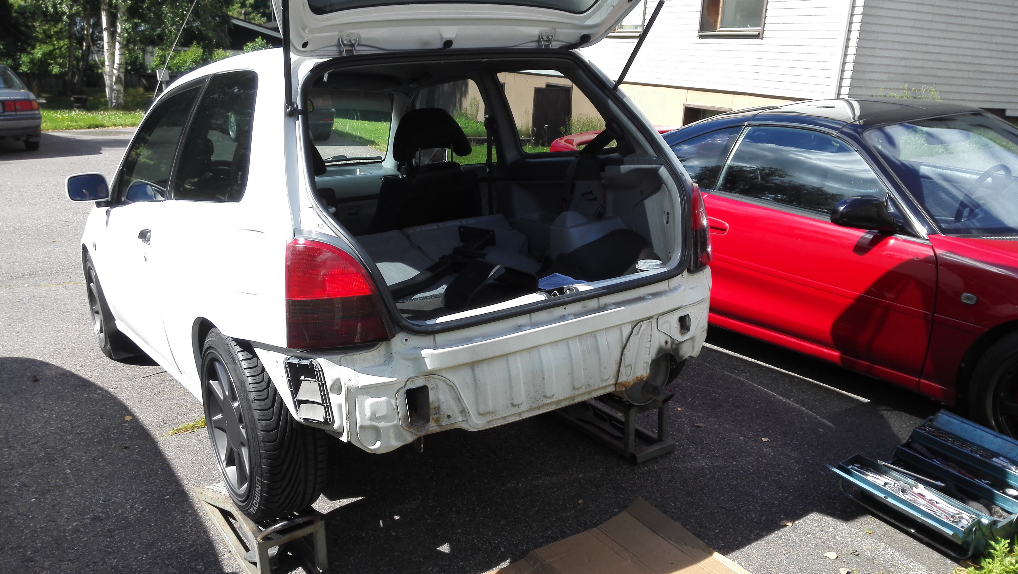

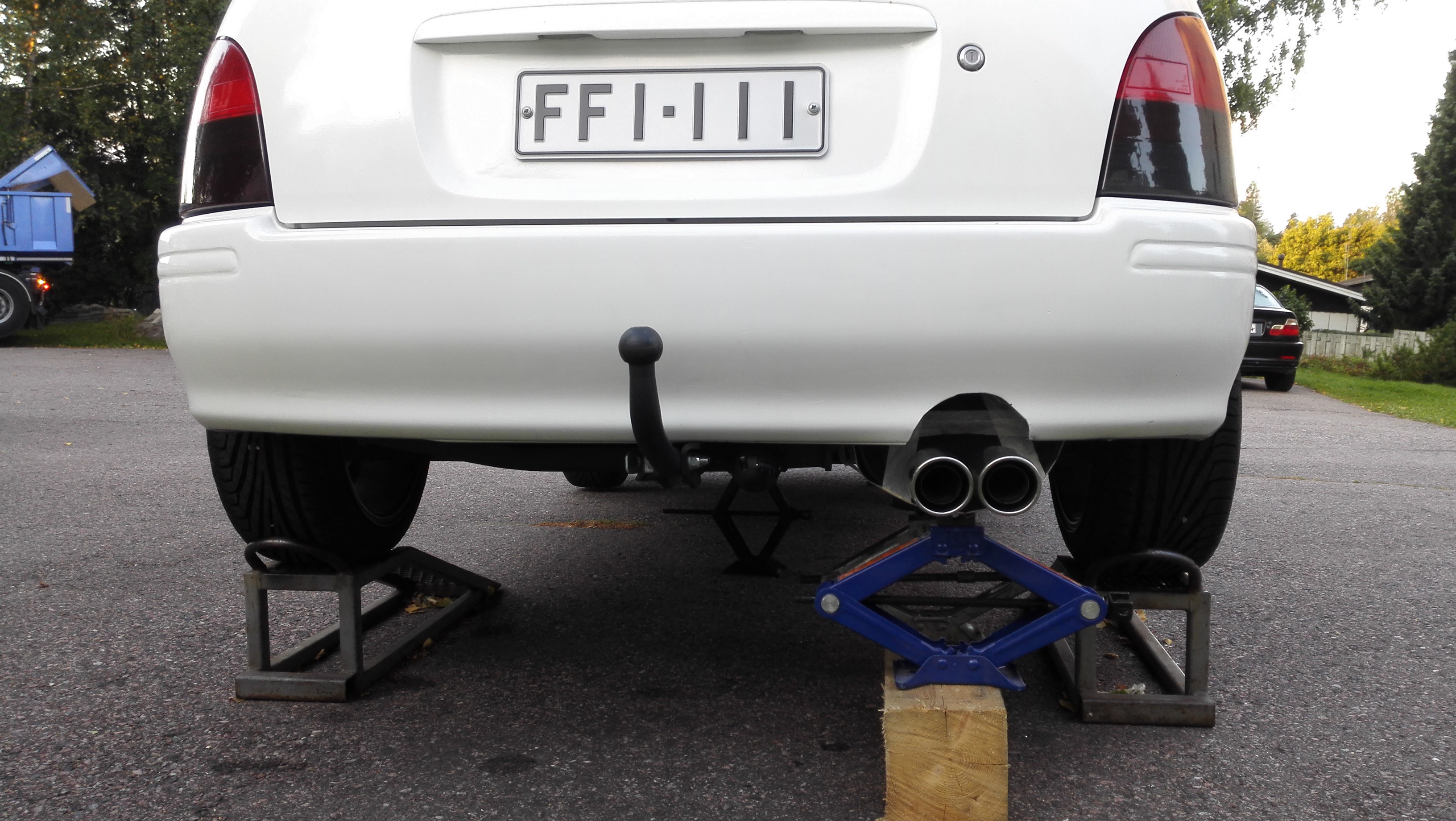

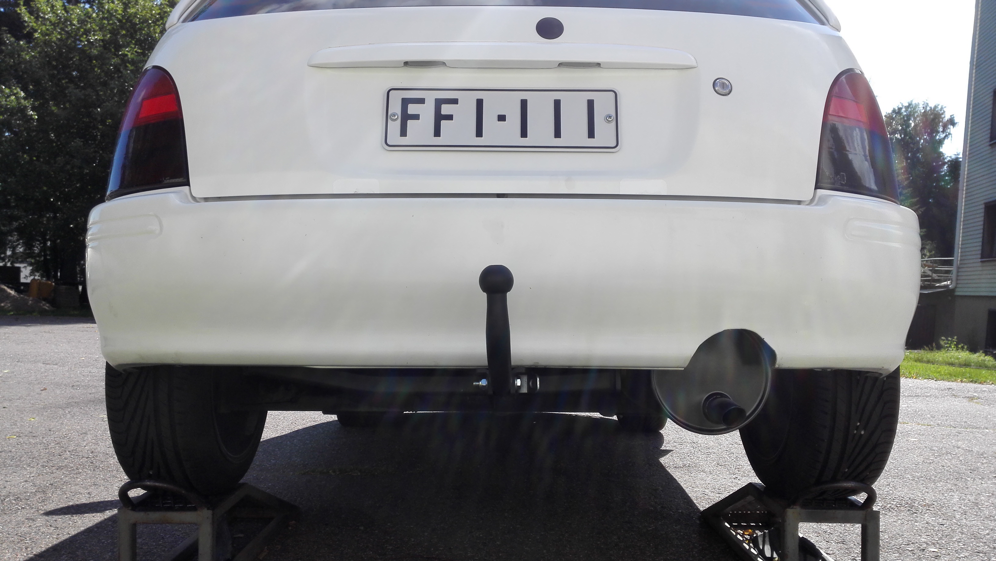

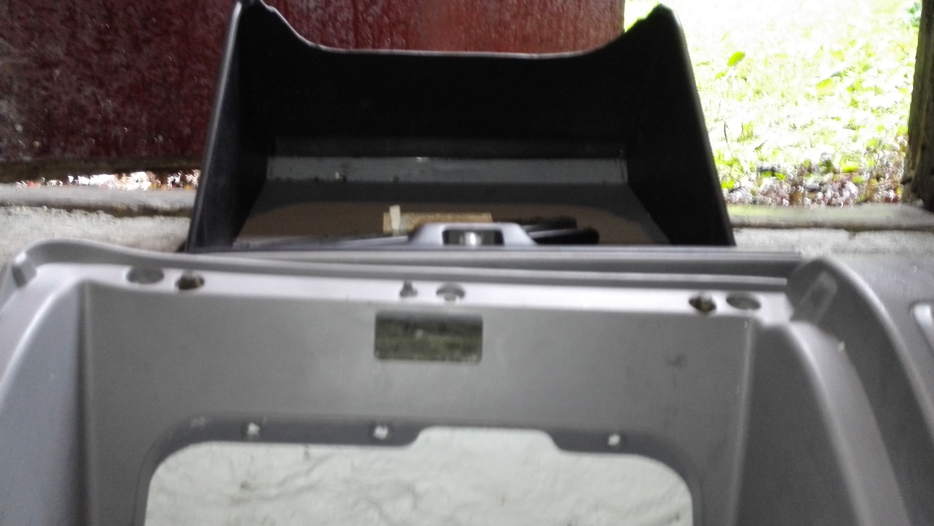

MR-2 Posted November 9, 2017 Author Posted November 9, 2017 Then found cheap towing hitch, must for this car for the fututure. I use old EP70 set when towing, Tein sits too low. Welded typeplate in new place and when taking the hitch away, almost invisible. Quote

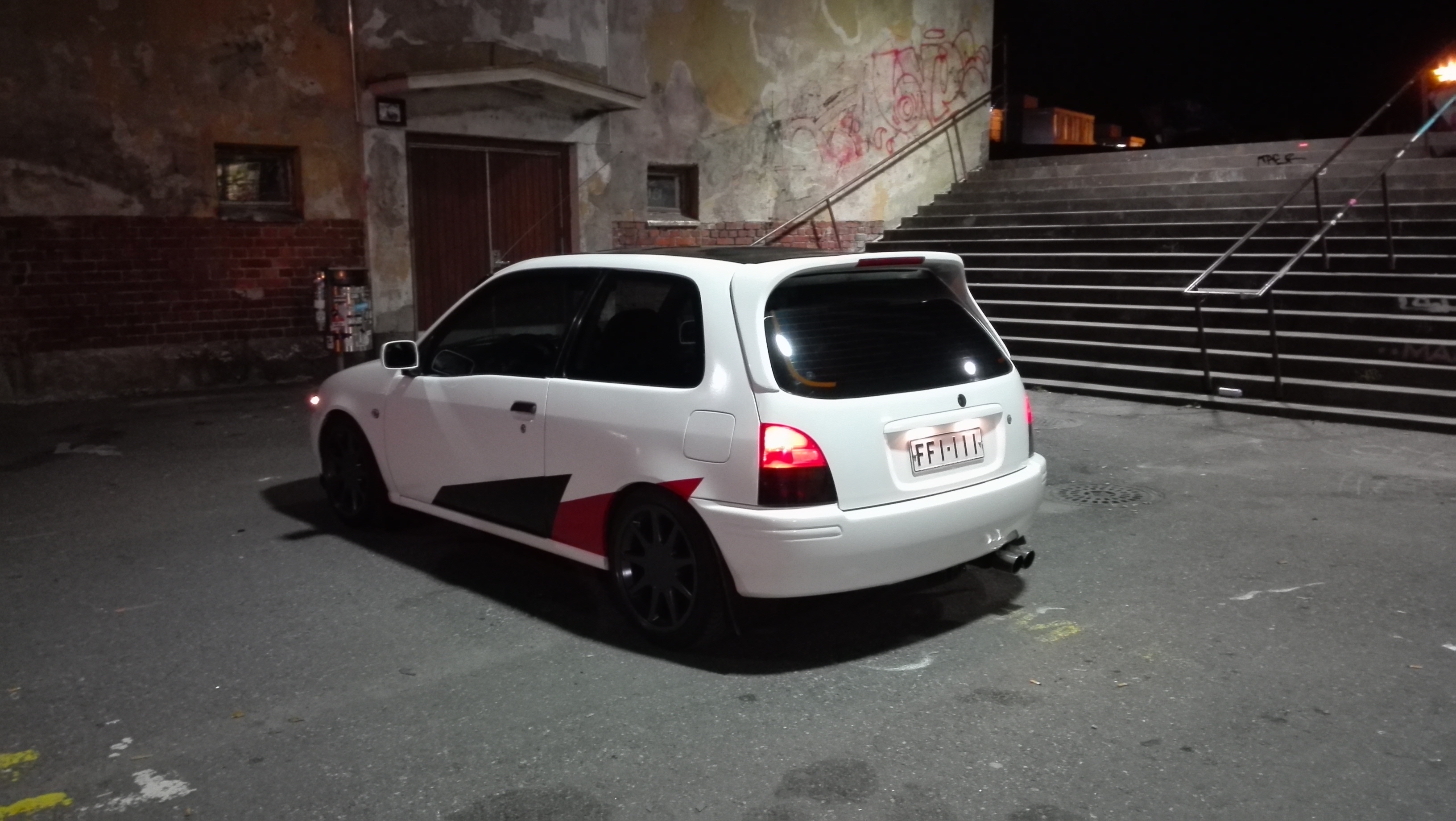

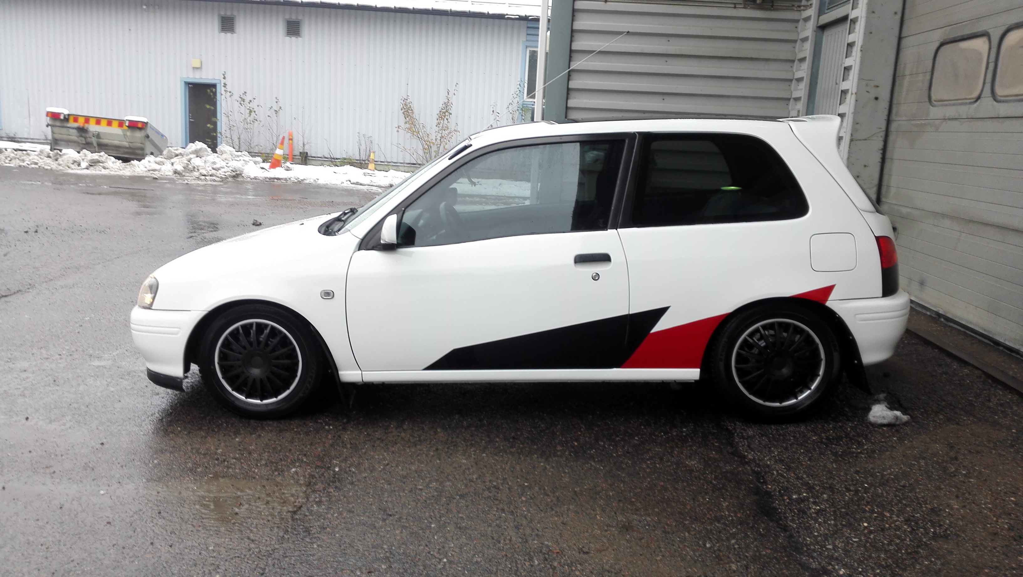

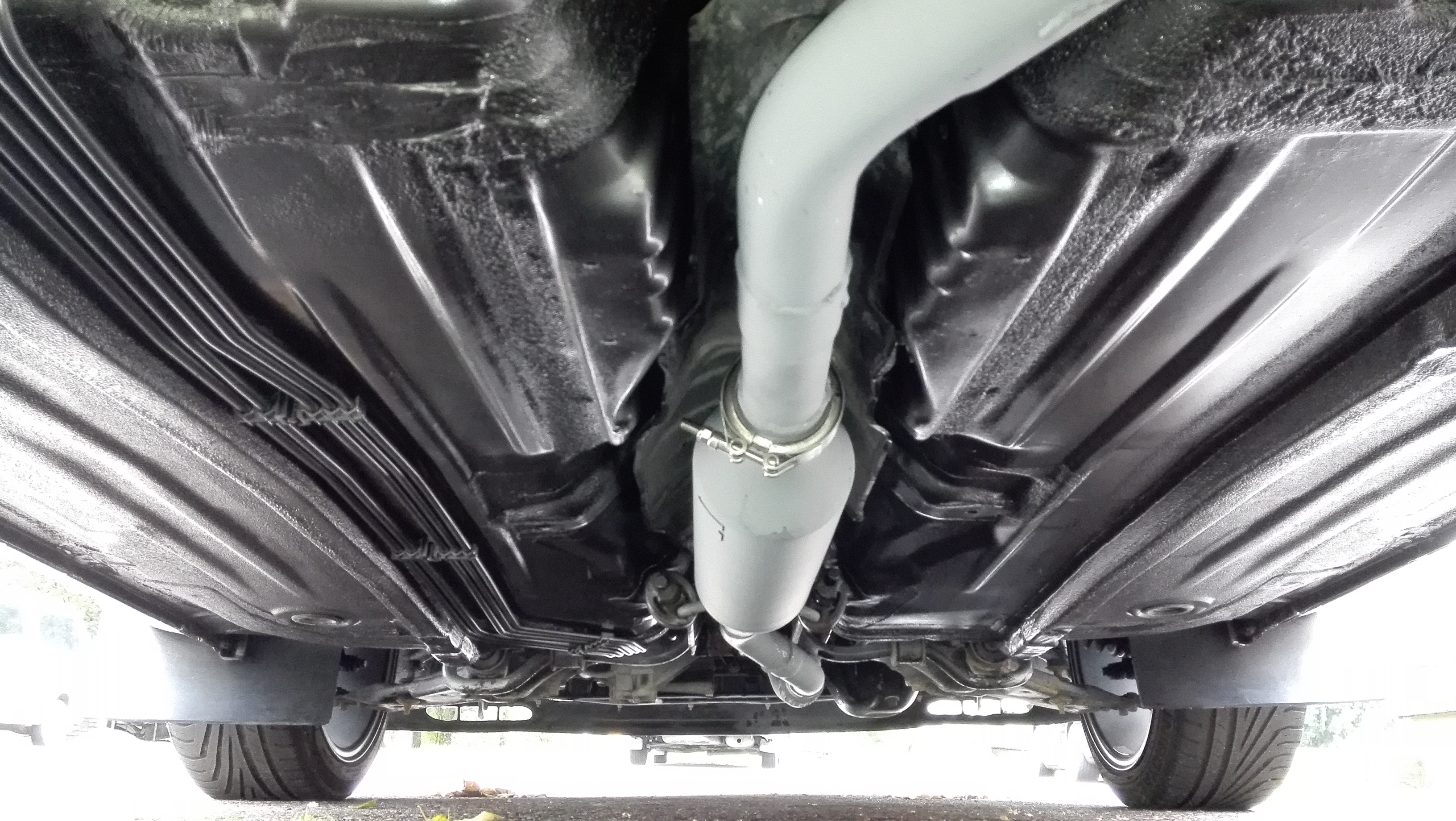

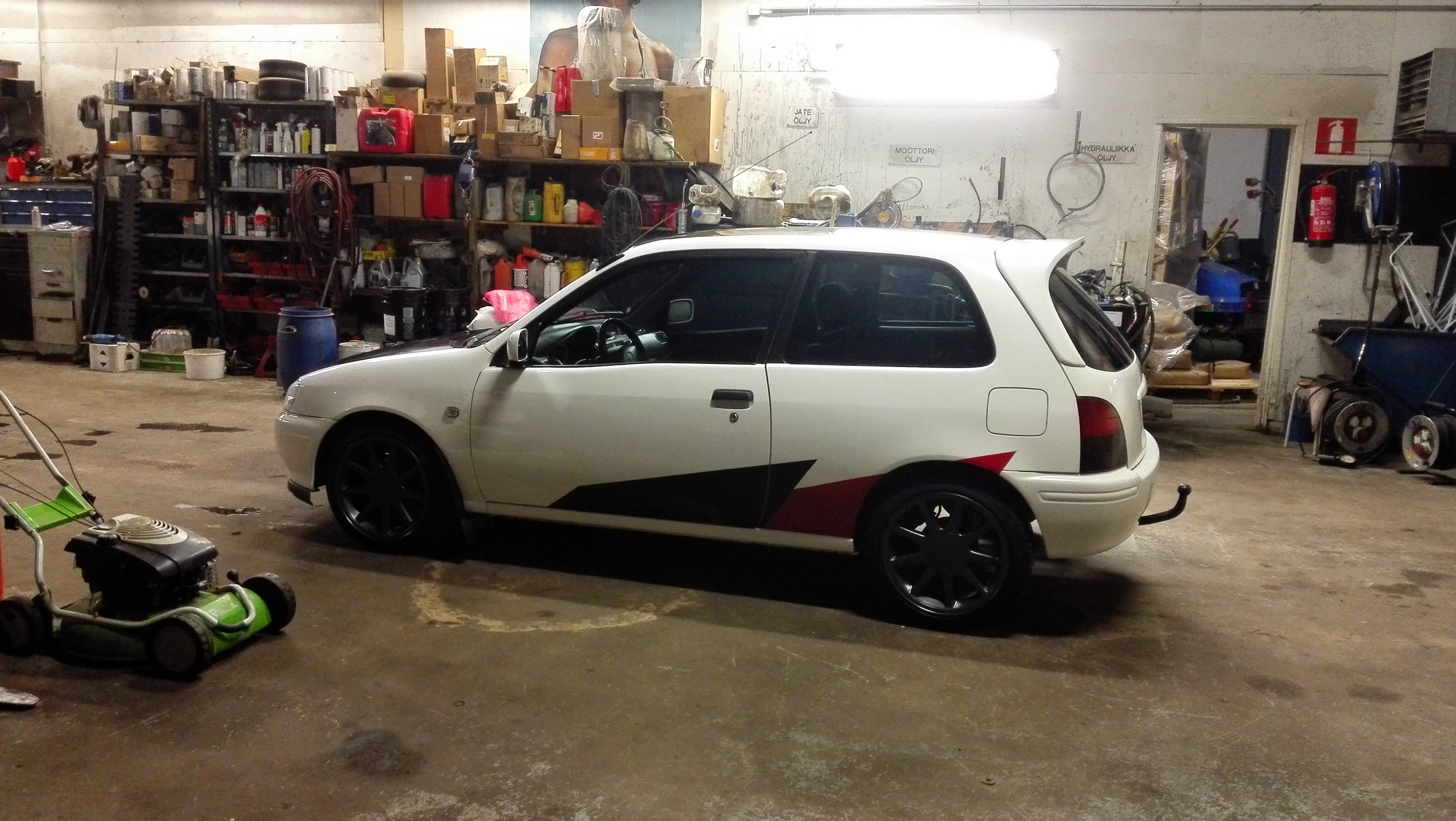

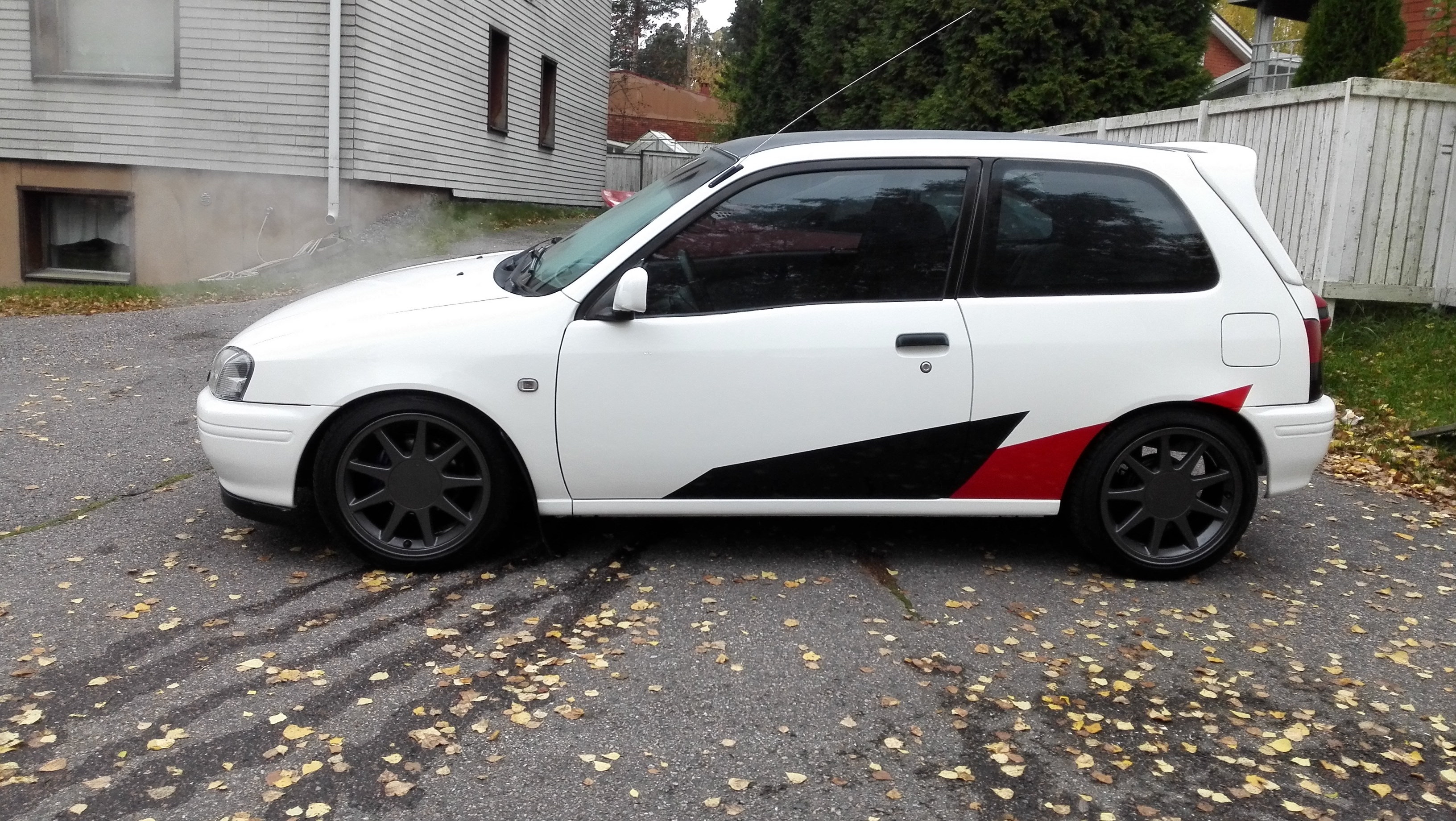

MR-2 Posted November 9, 2017 Author Posted November 9, 2017 Next stupid idea was to make own Gazoo Racing graphics, before new Turbo Yaris arrives. Most of people don't get it, but maybe some rallyfans catch the point :) Washed also floor propely for the painting and exhaust things... Quote

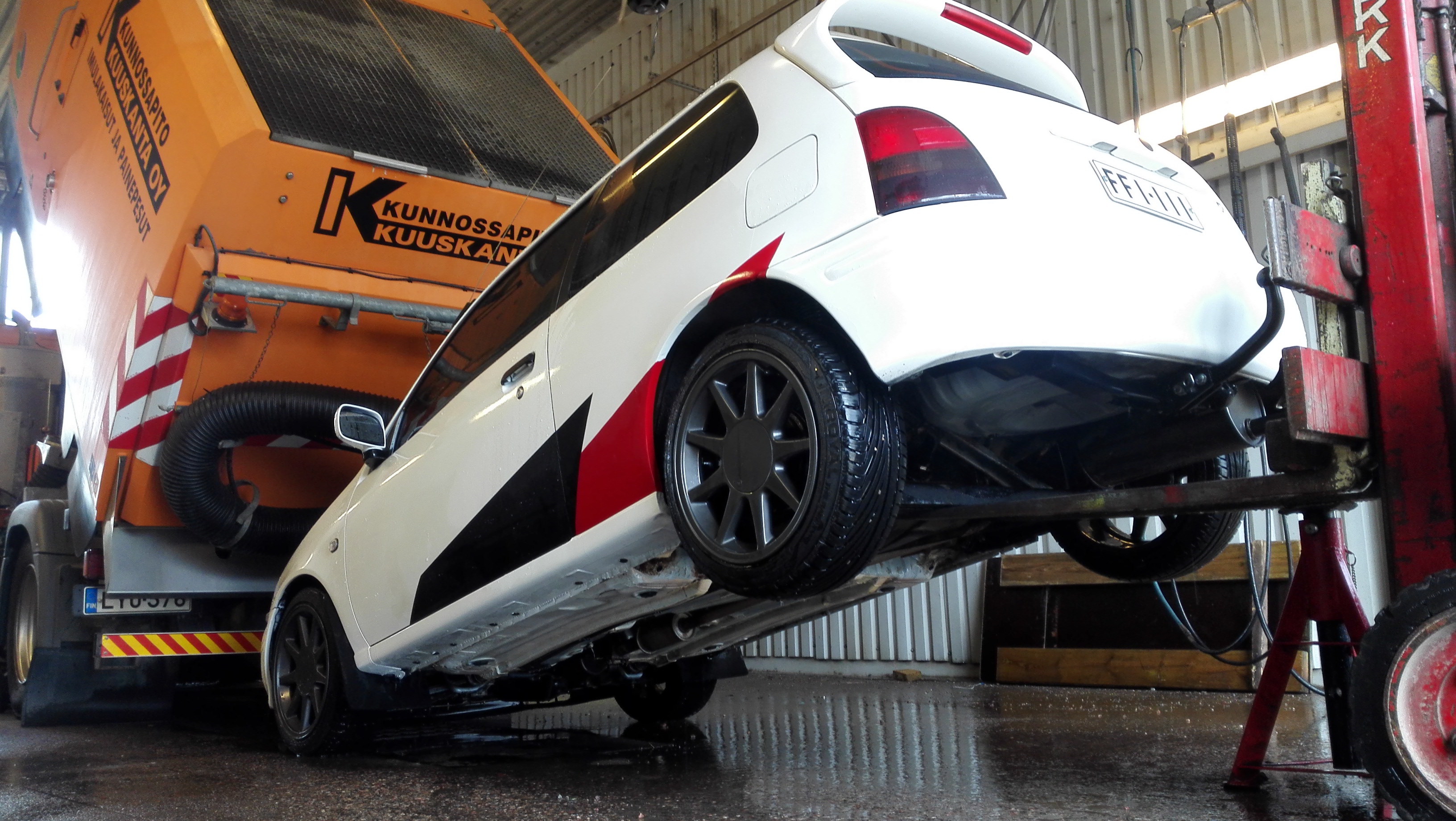

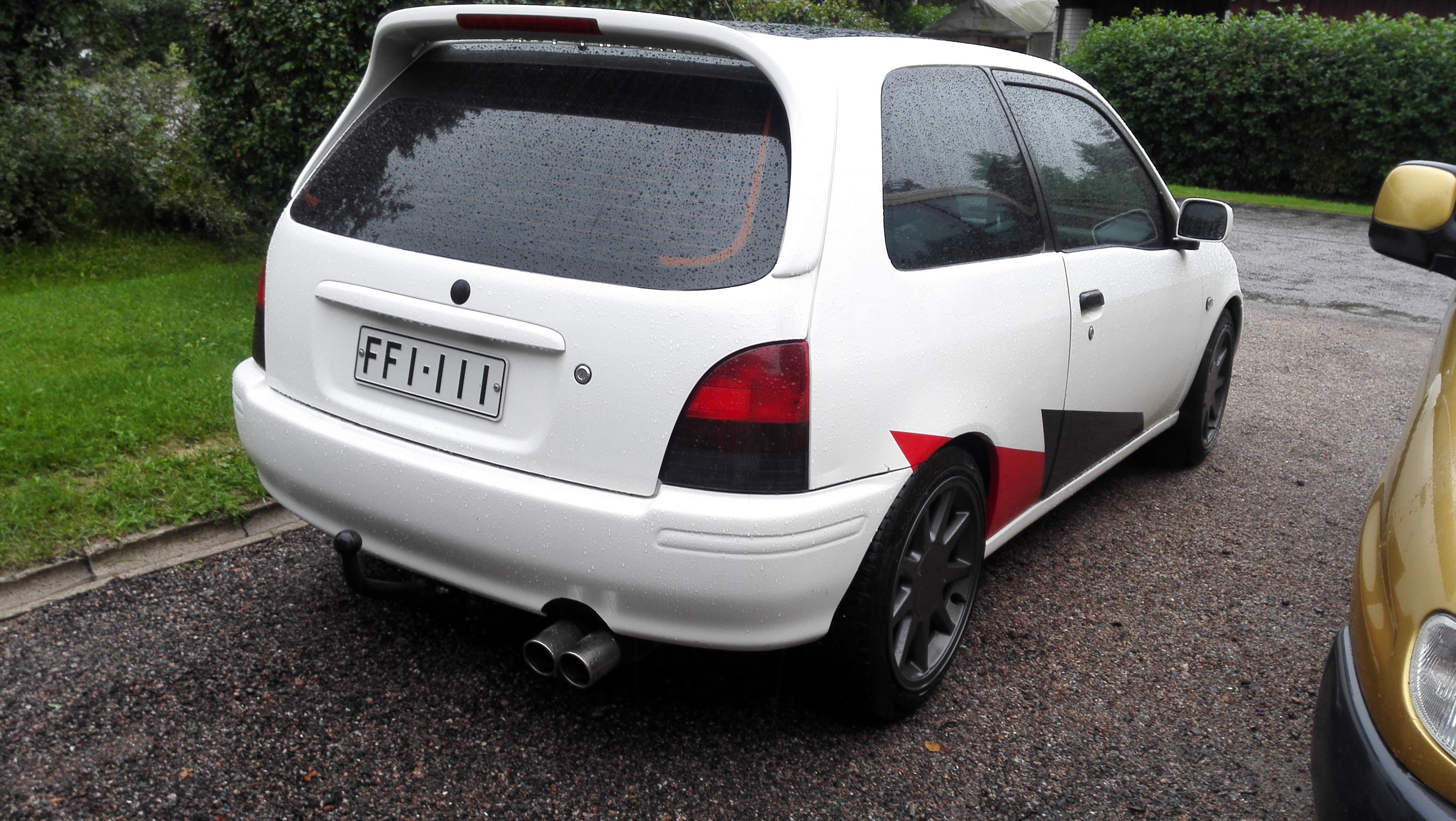

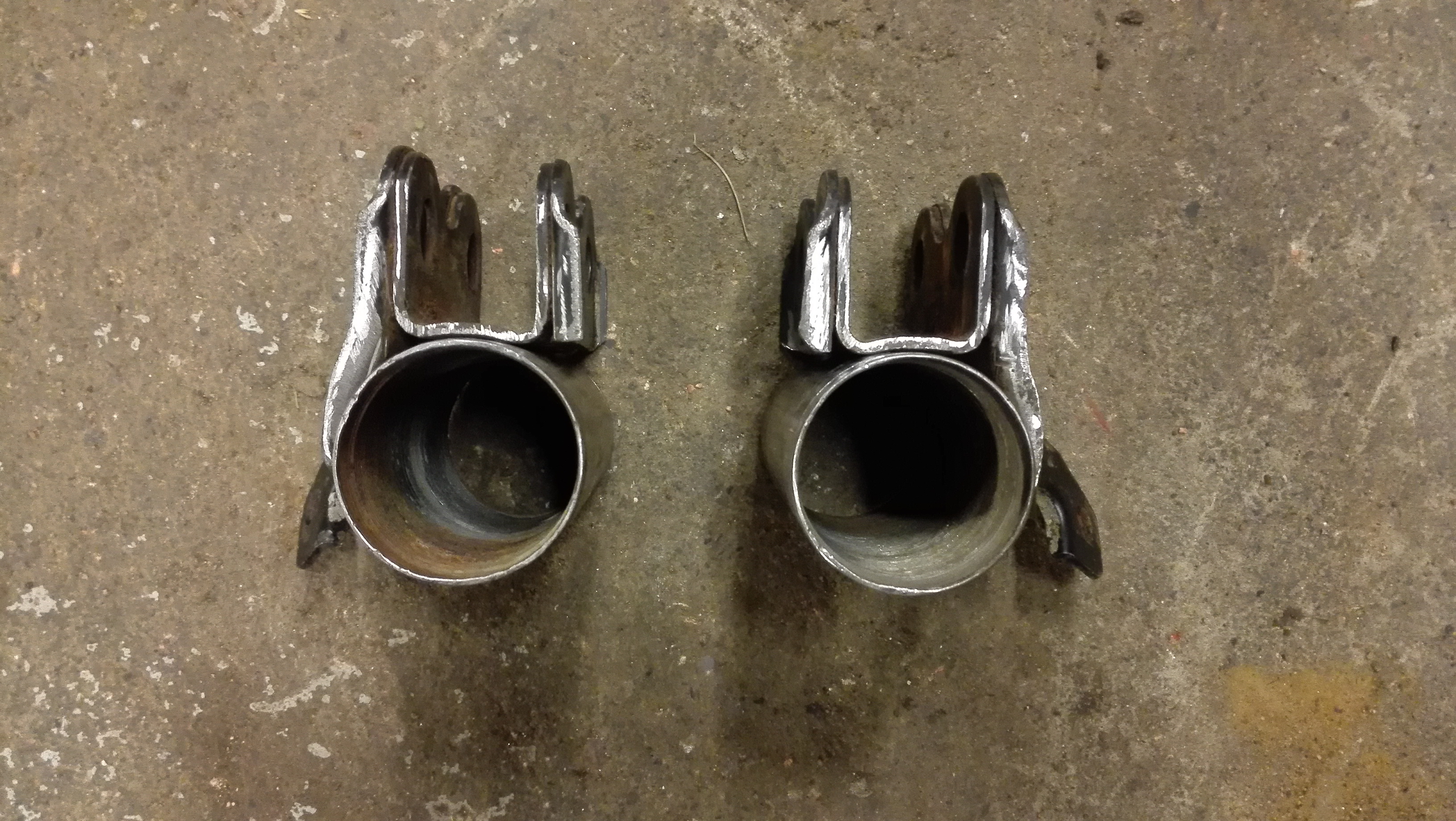

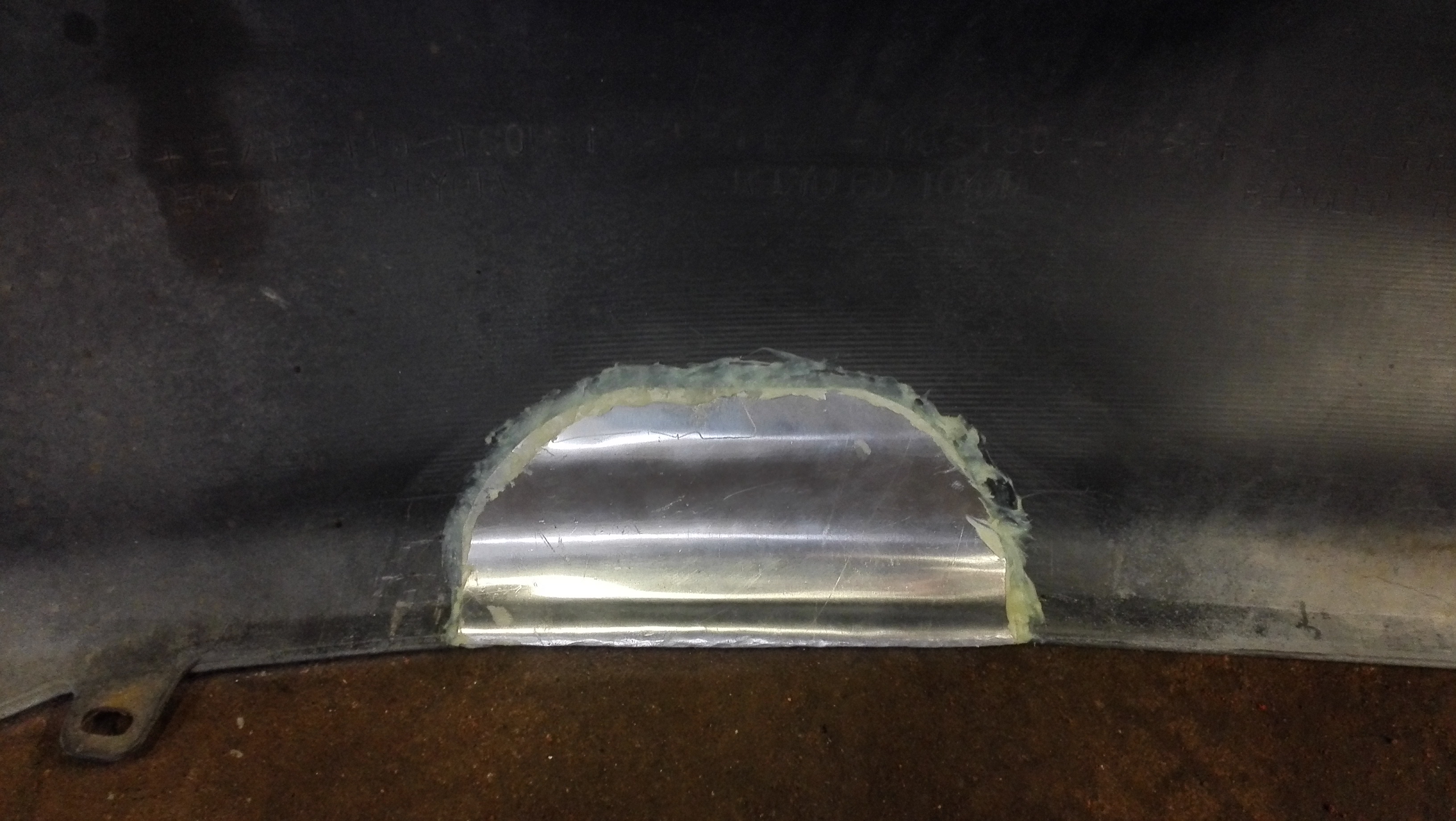

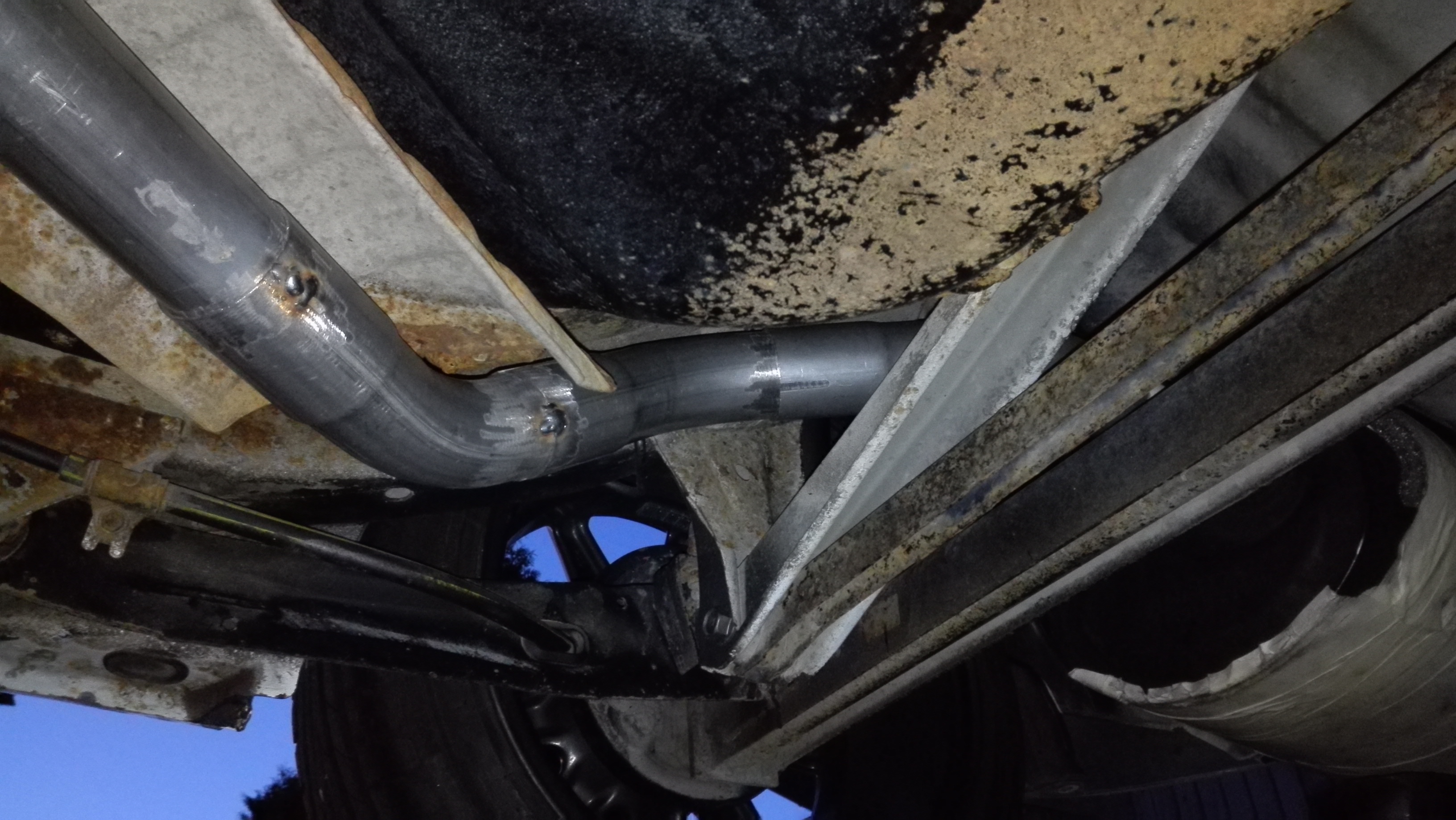

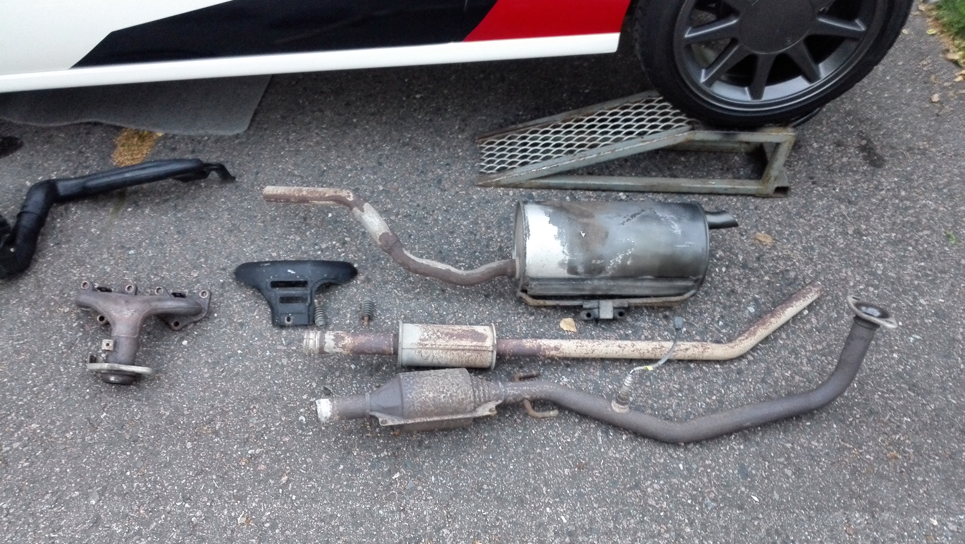

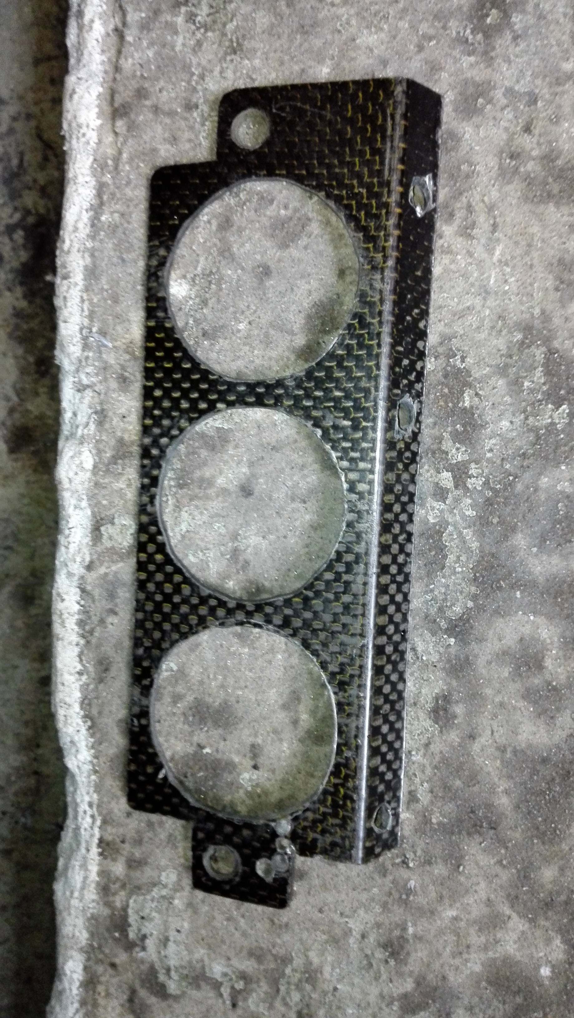

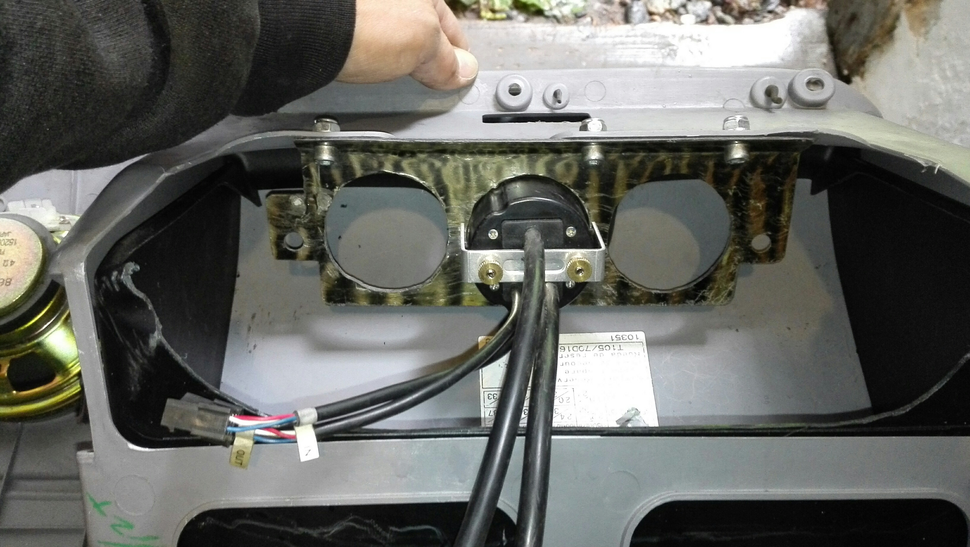

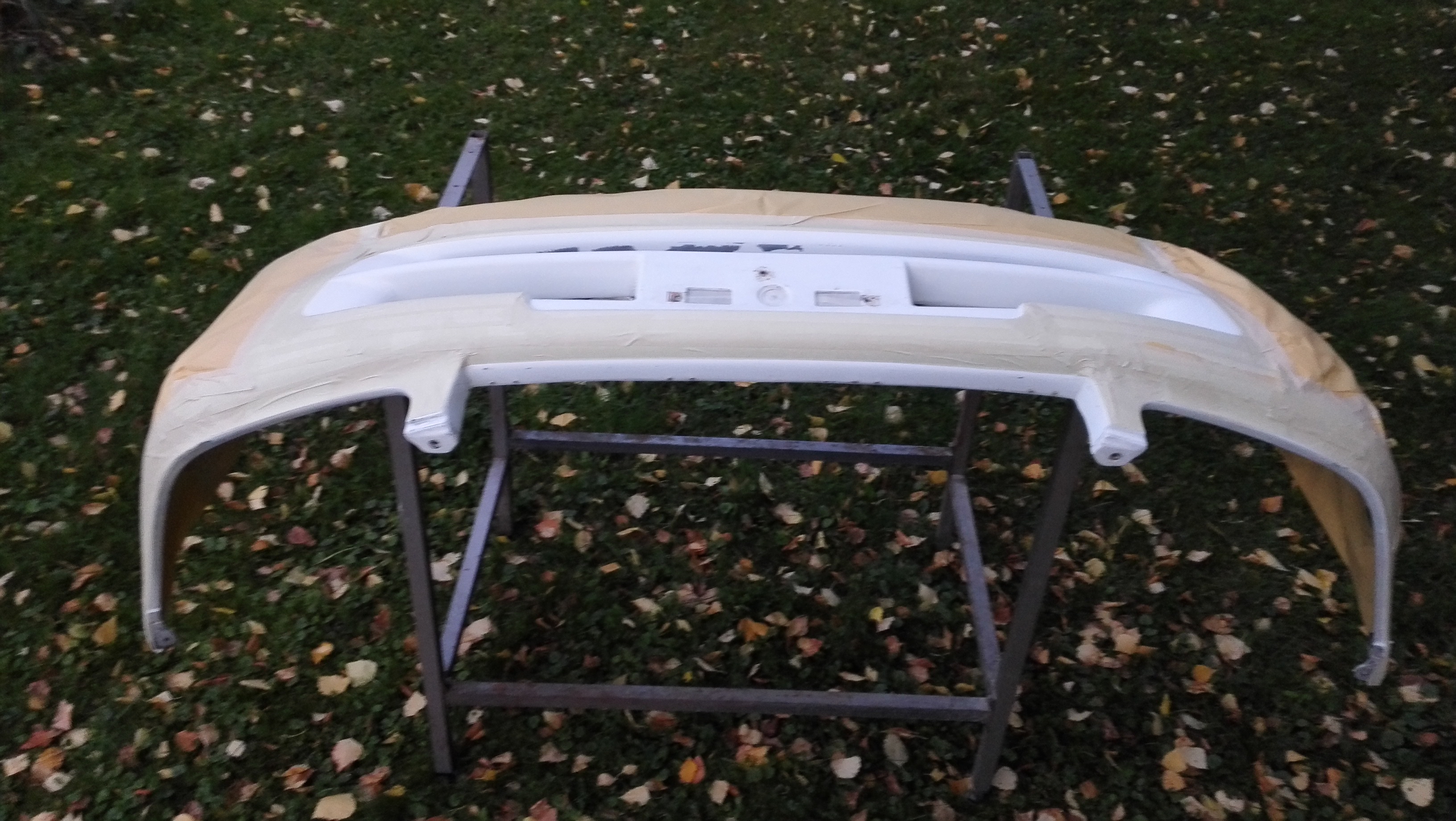

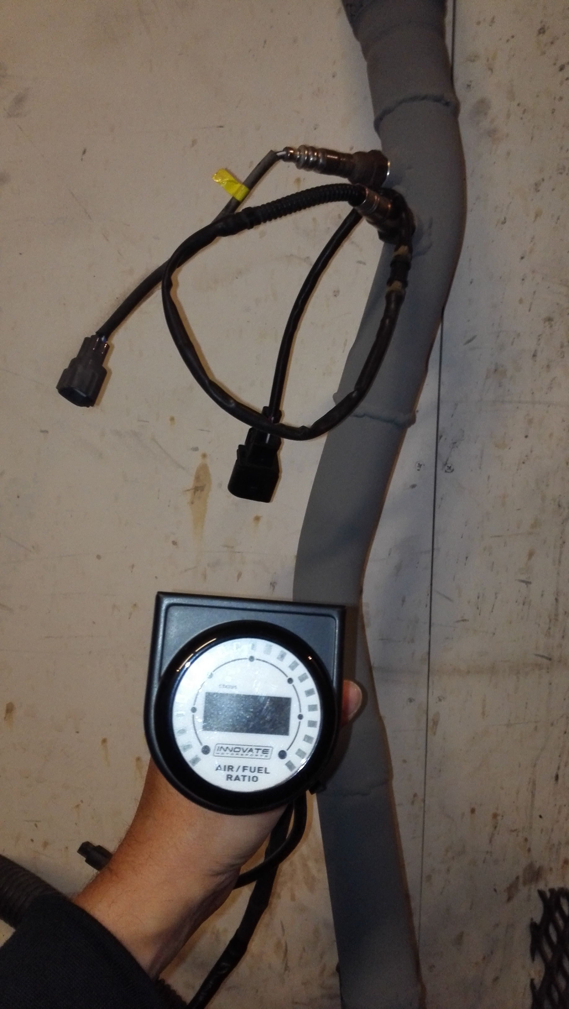

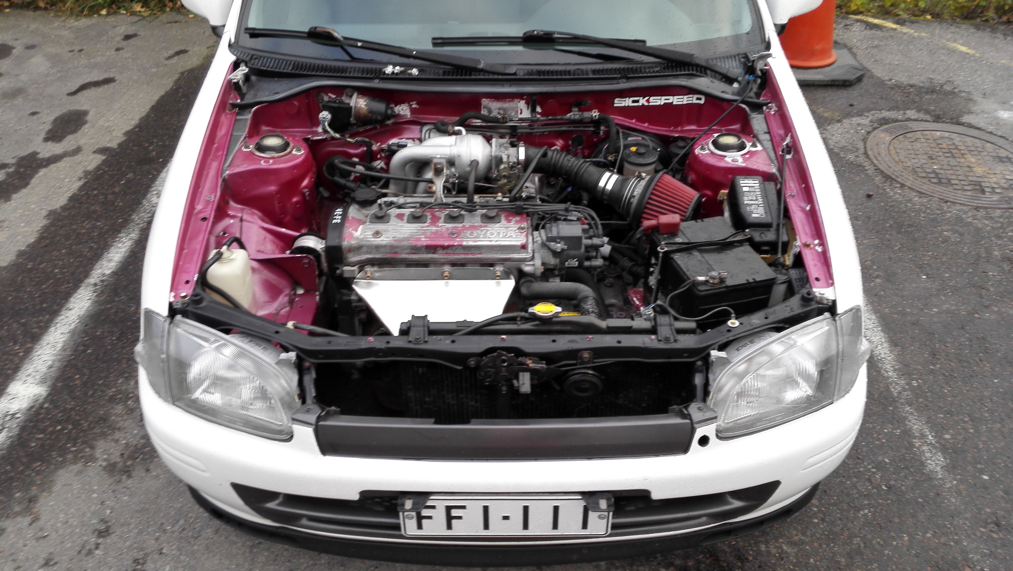

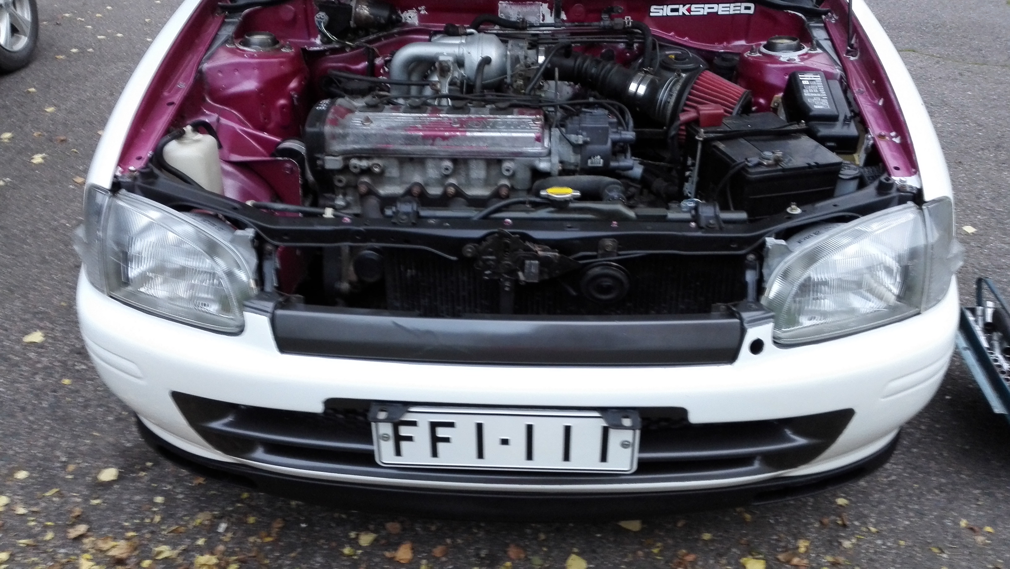

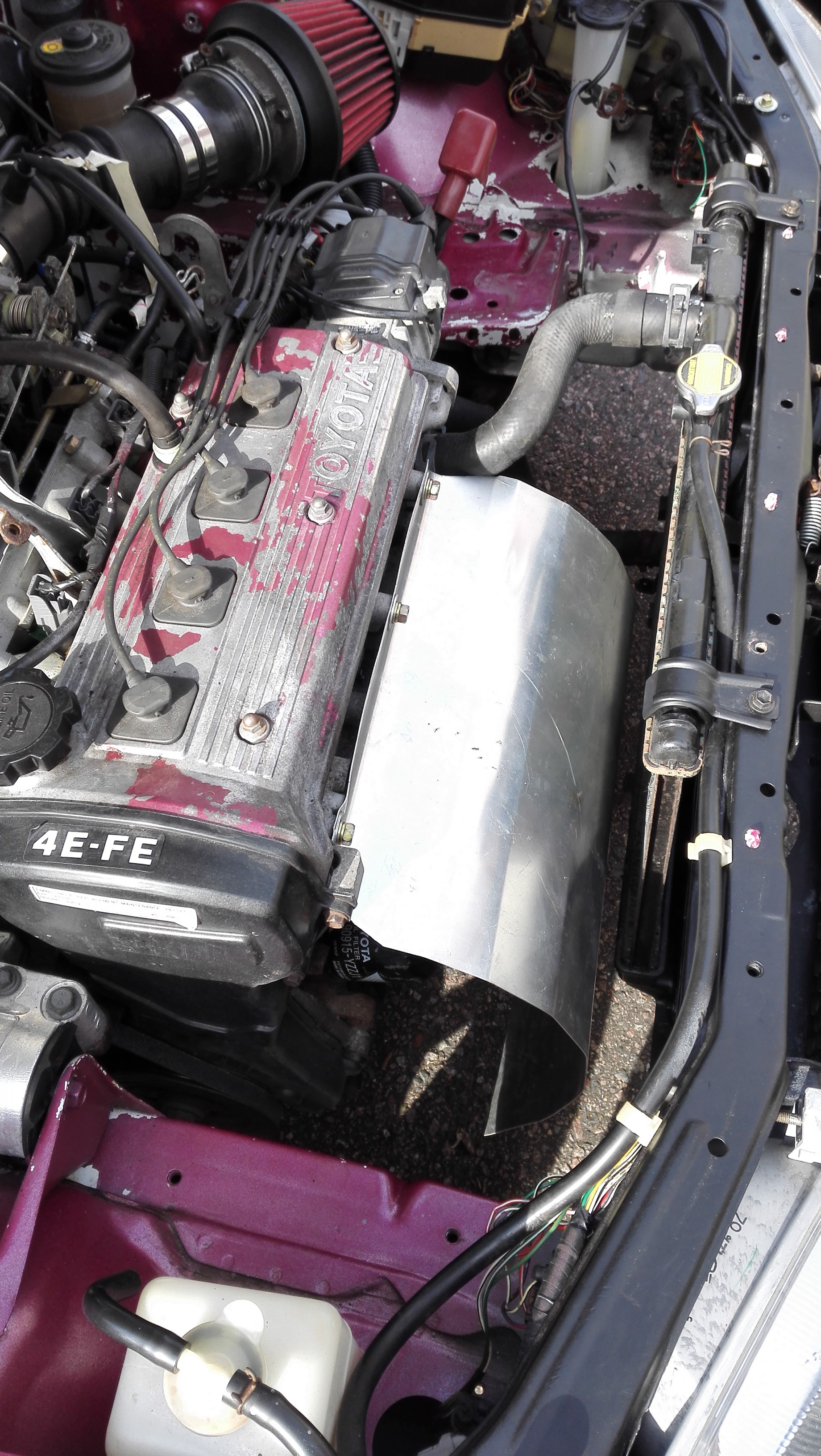

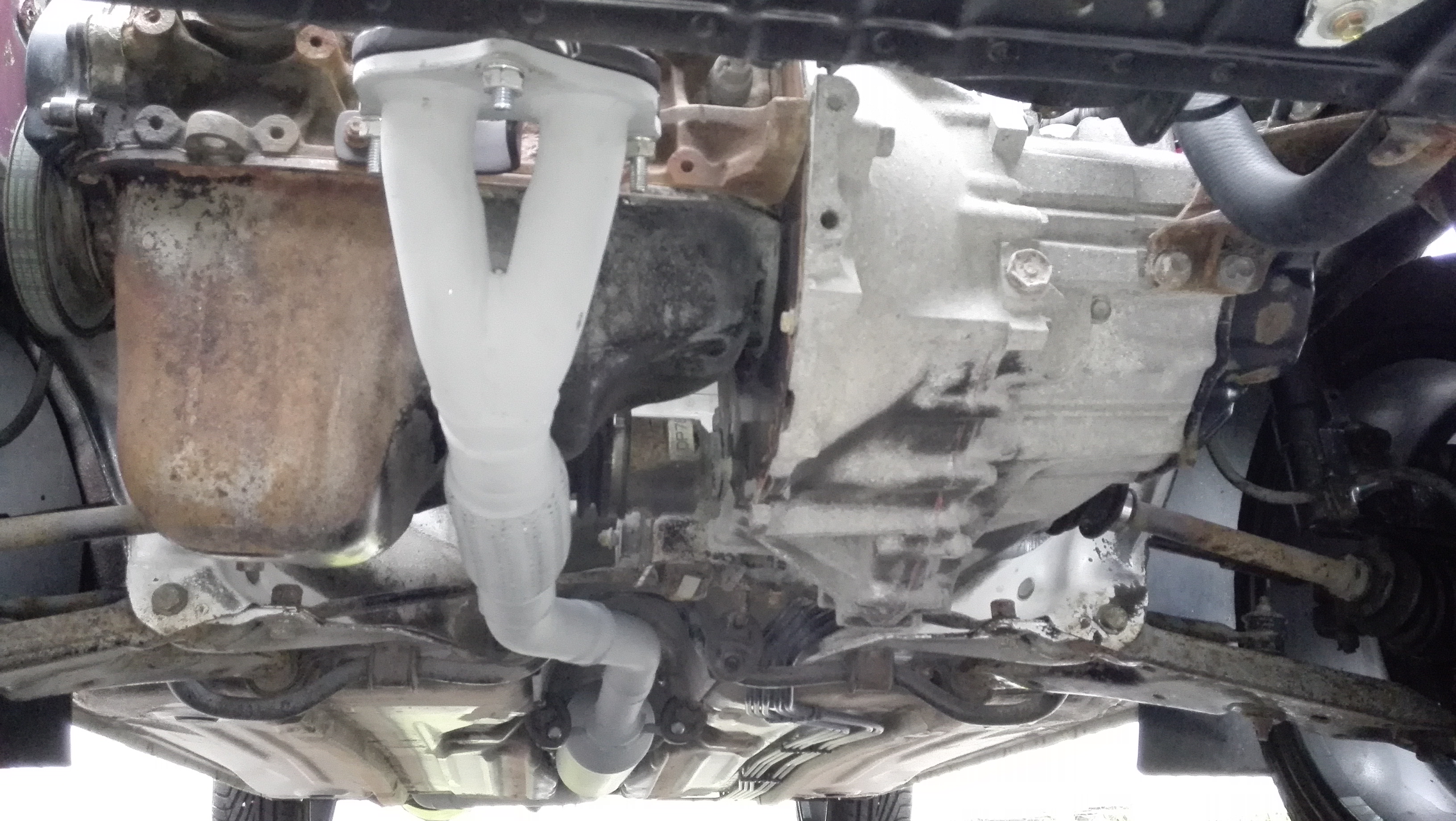

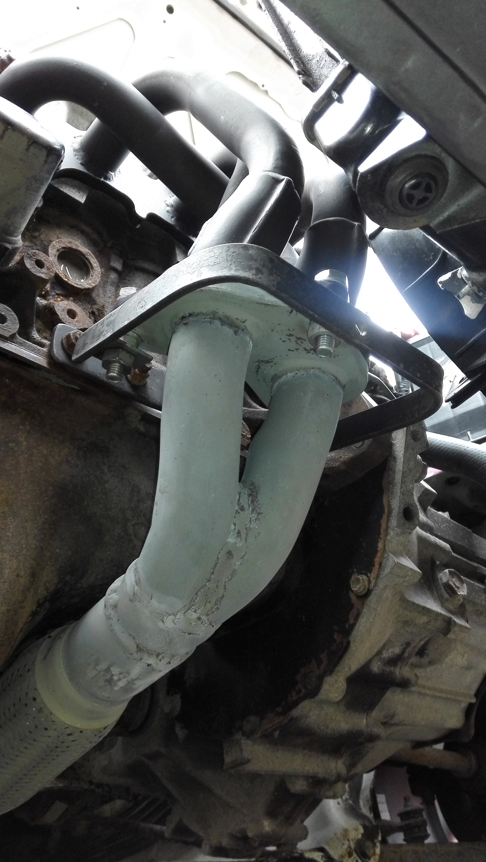

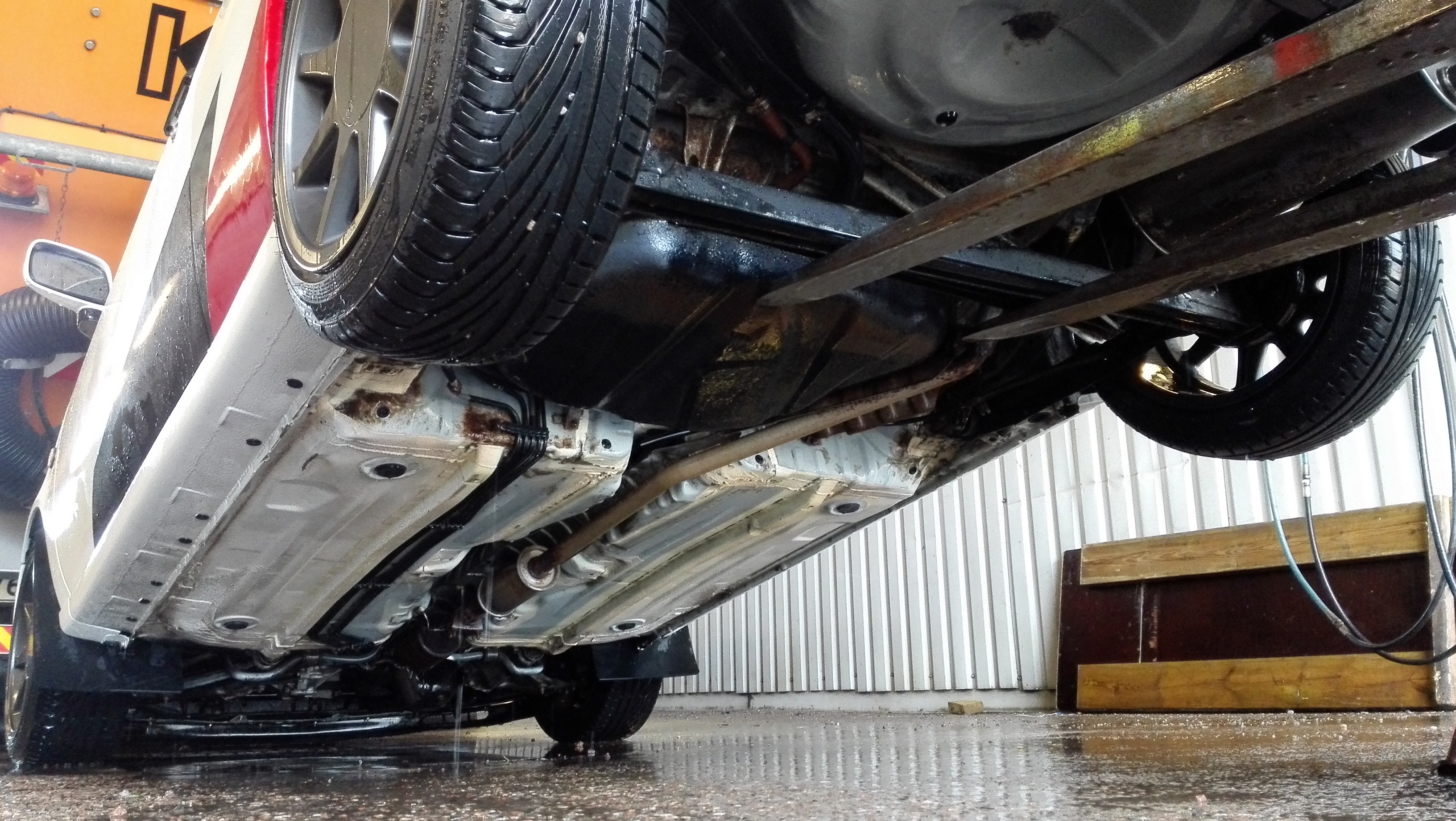

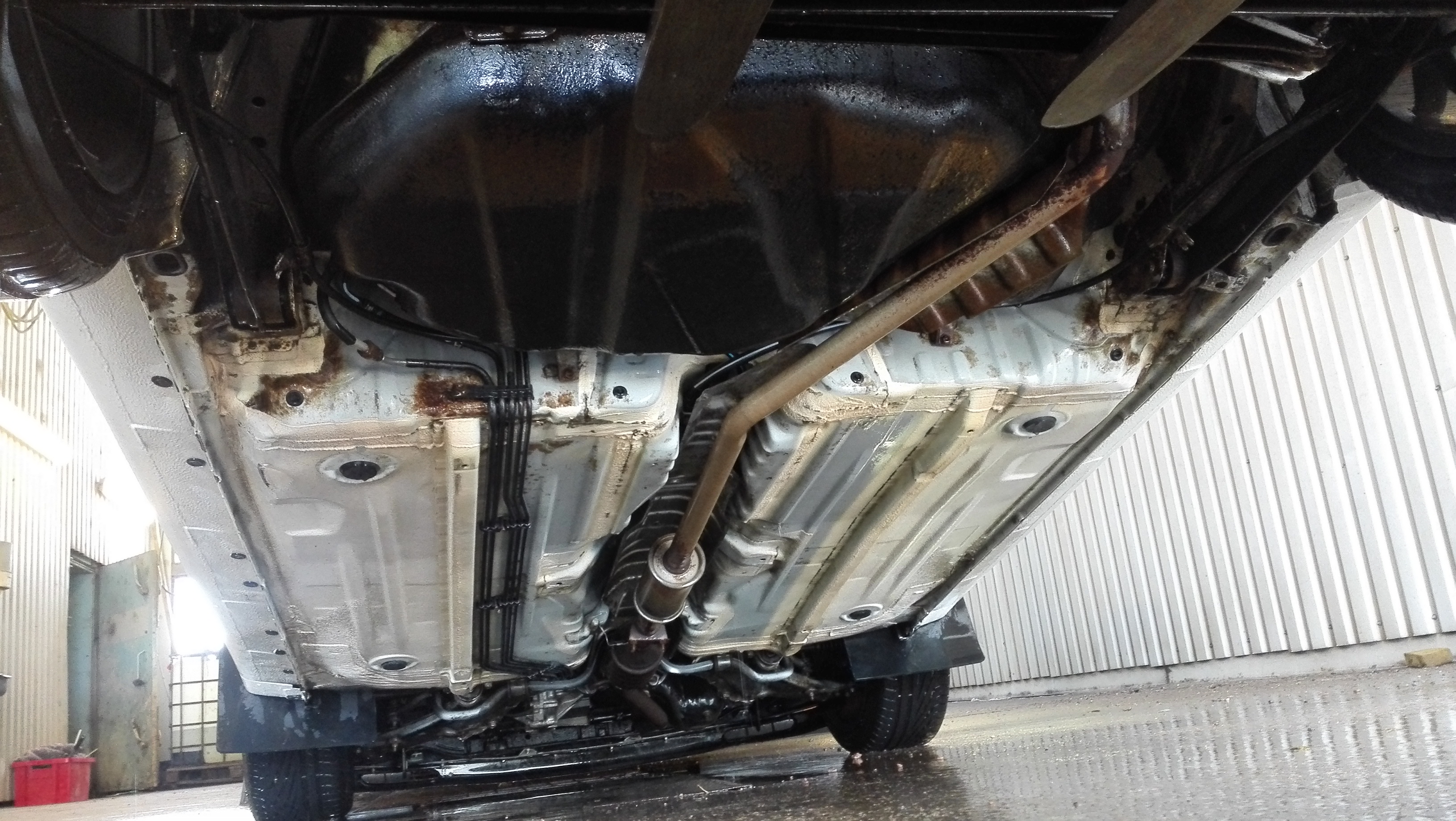

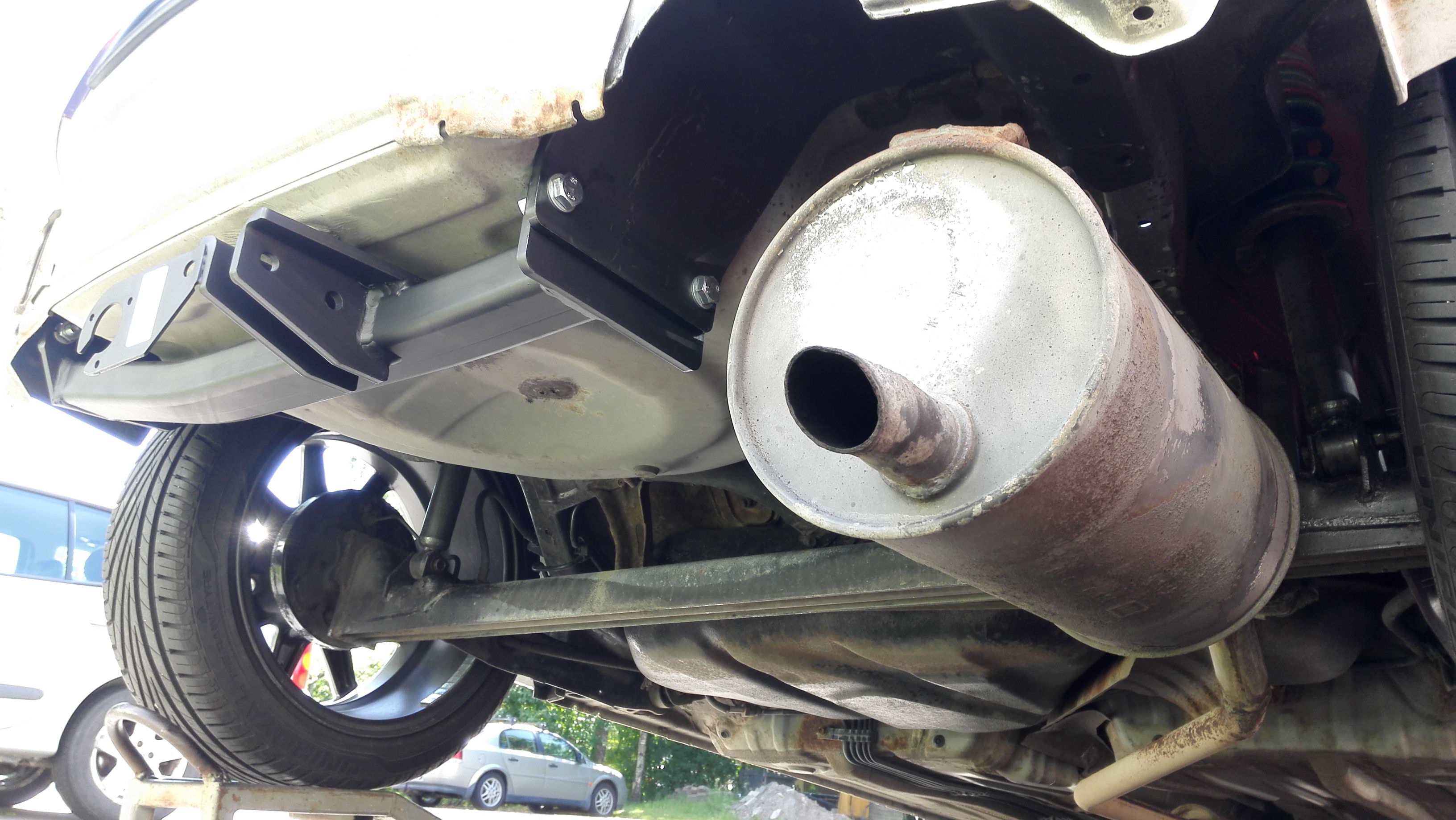

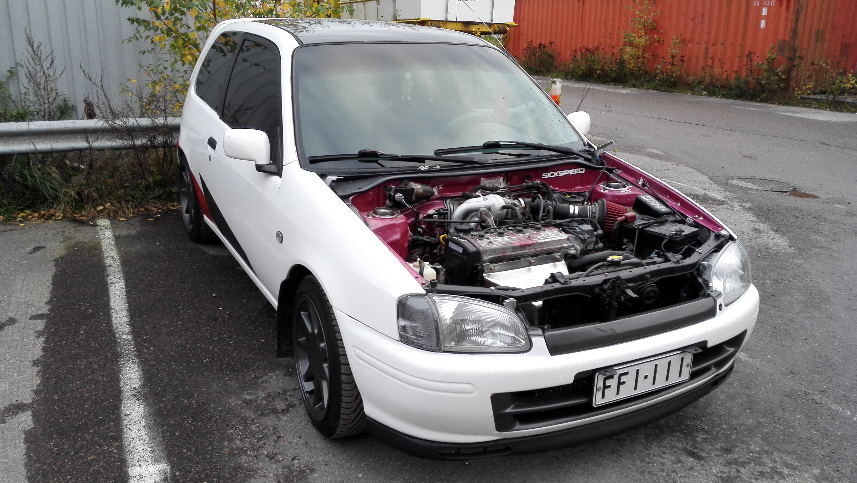

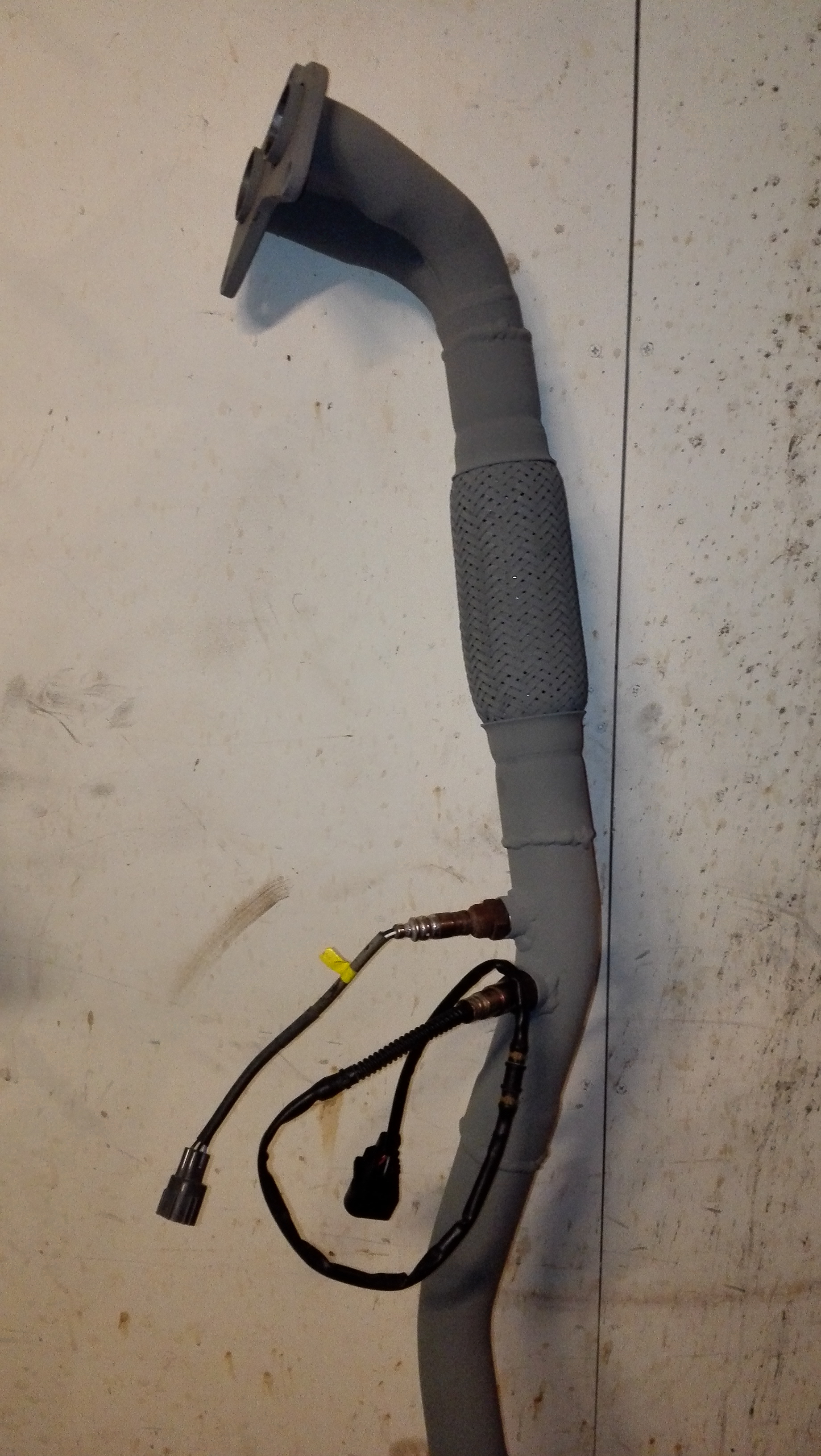

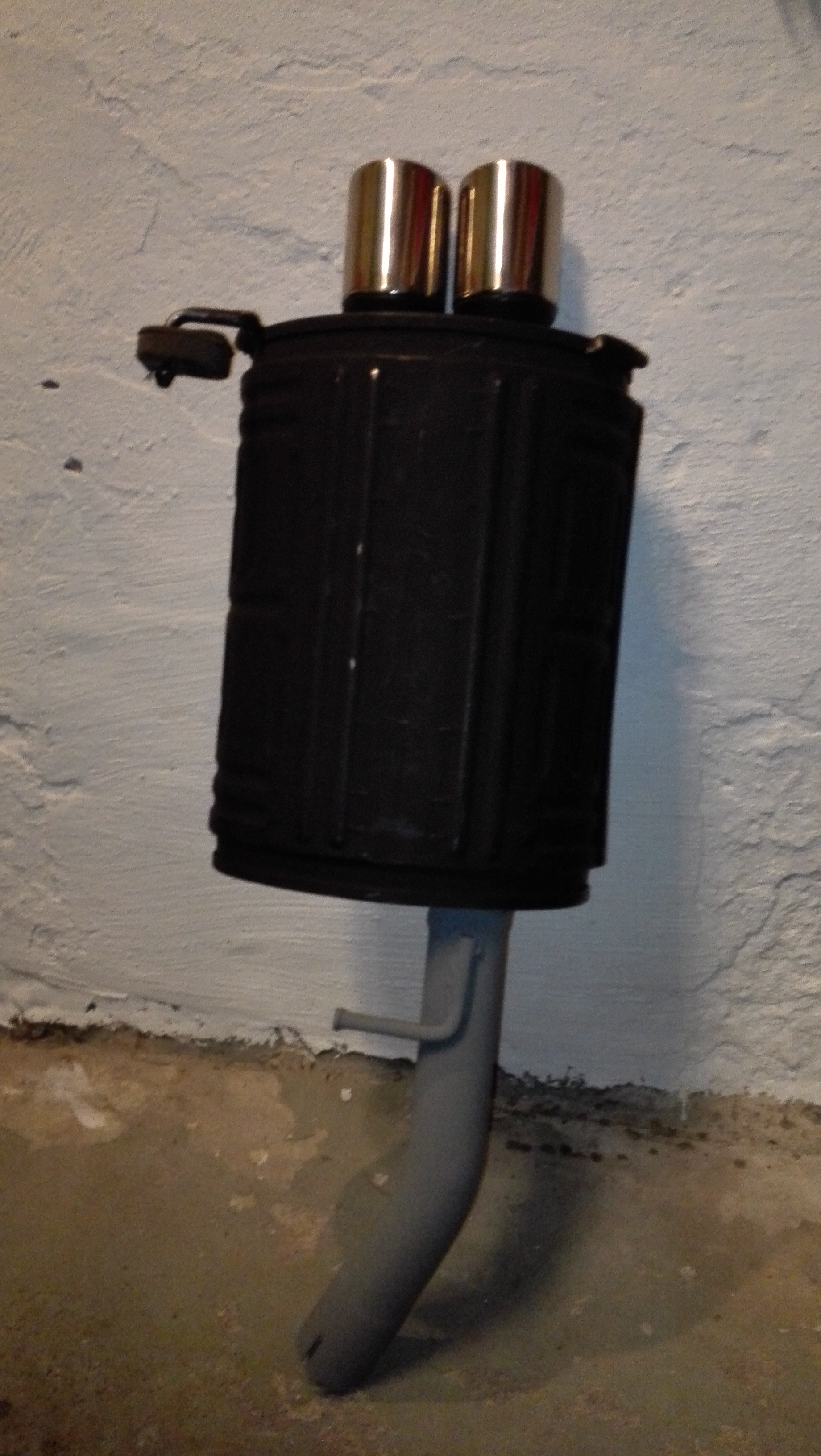

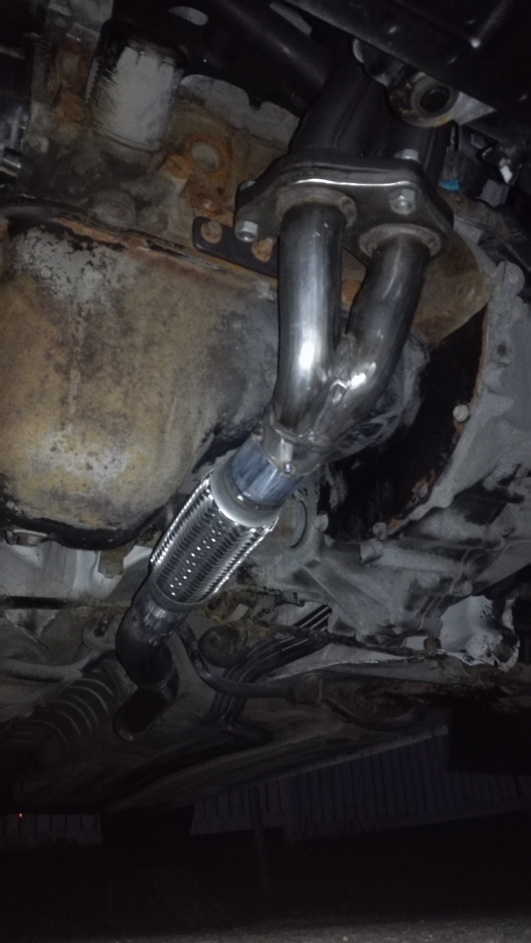

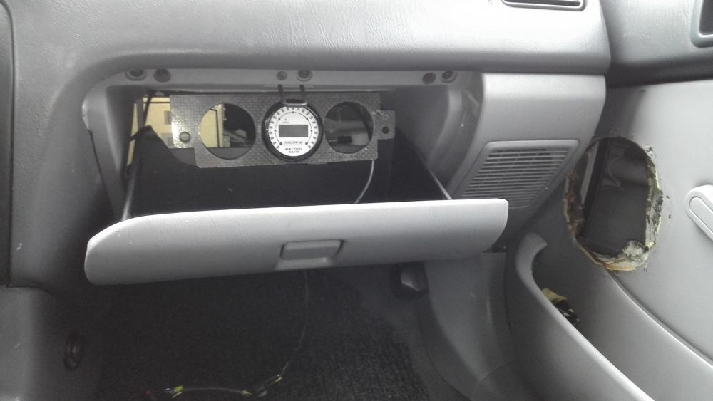

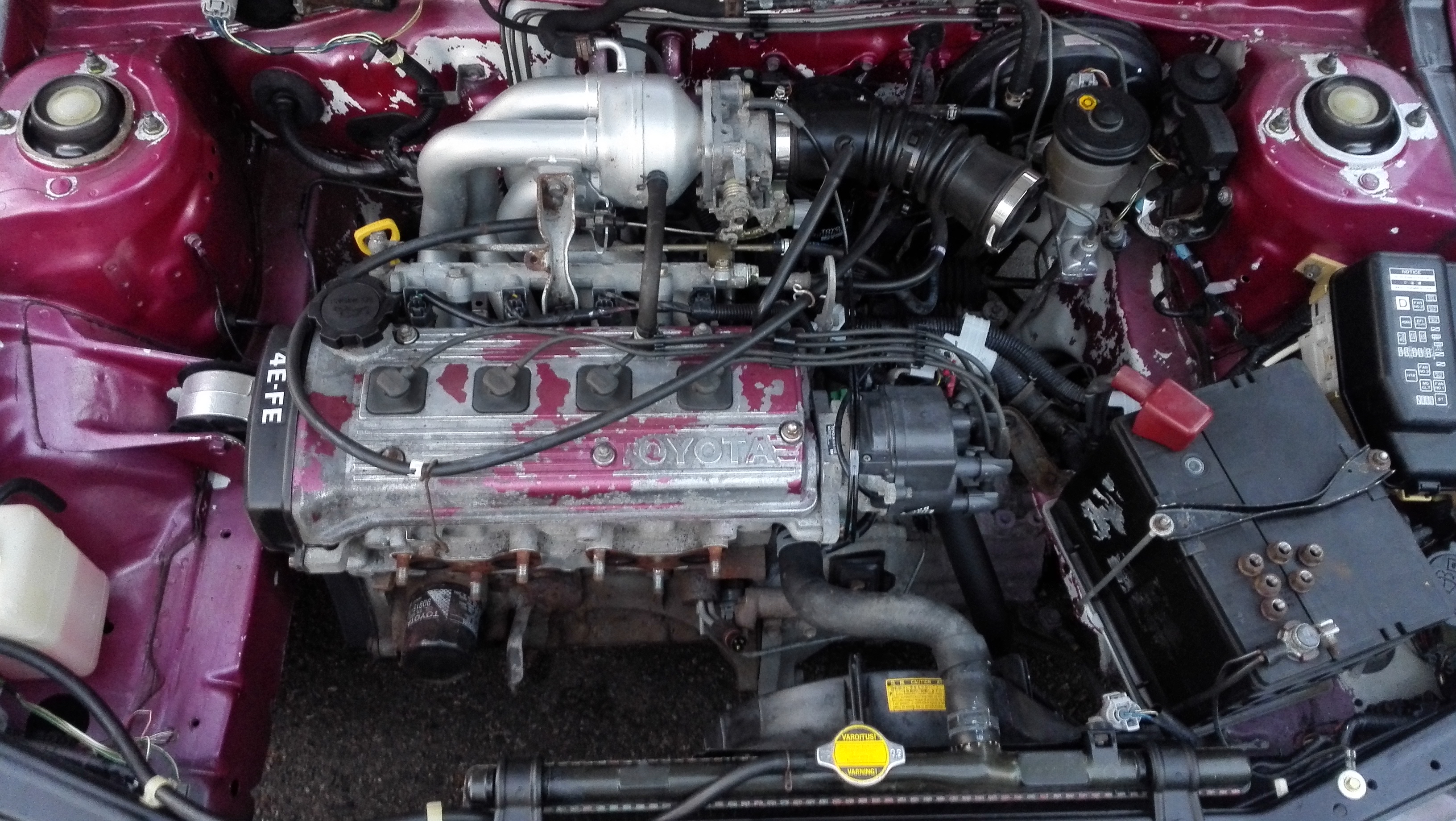

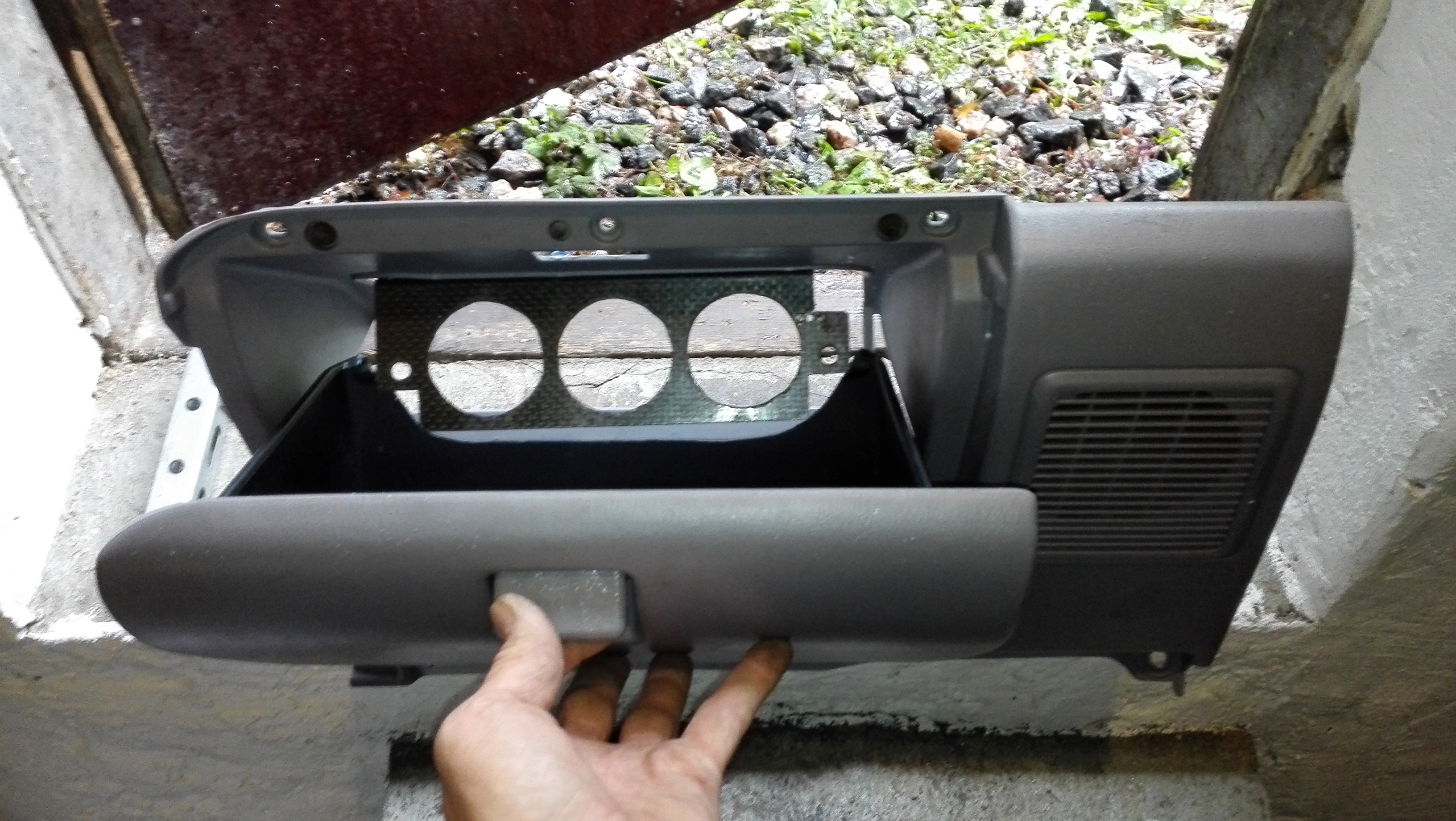

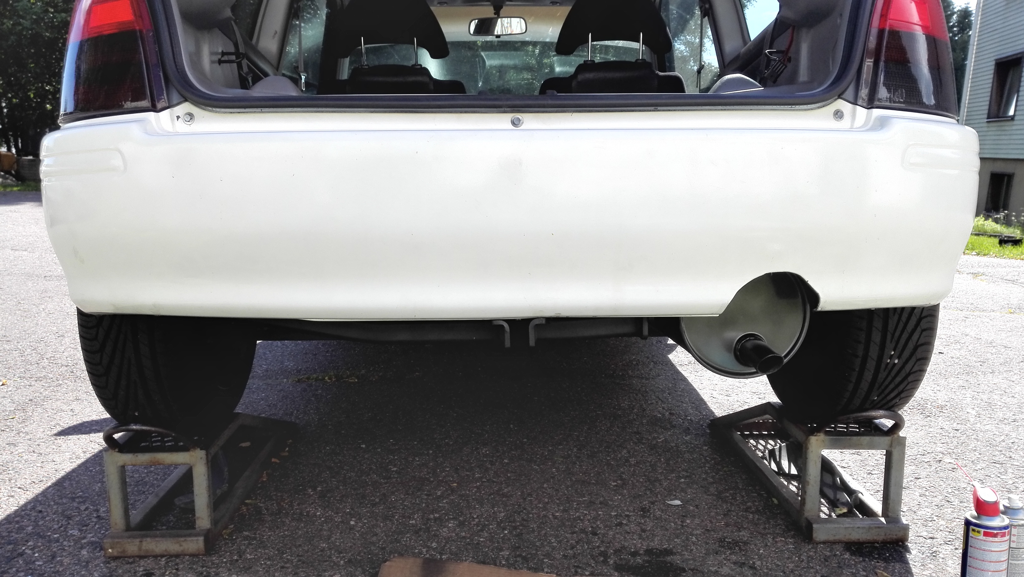

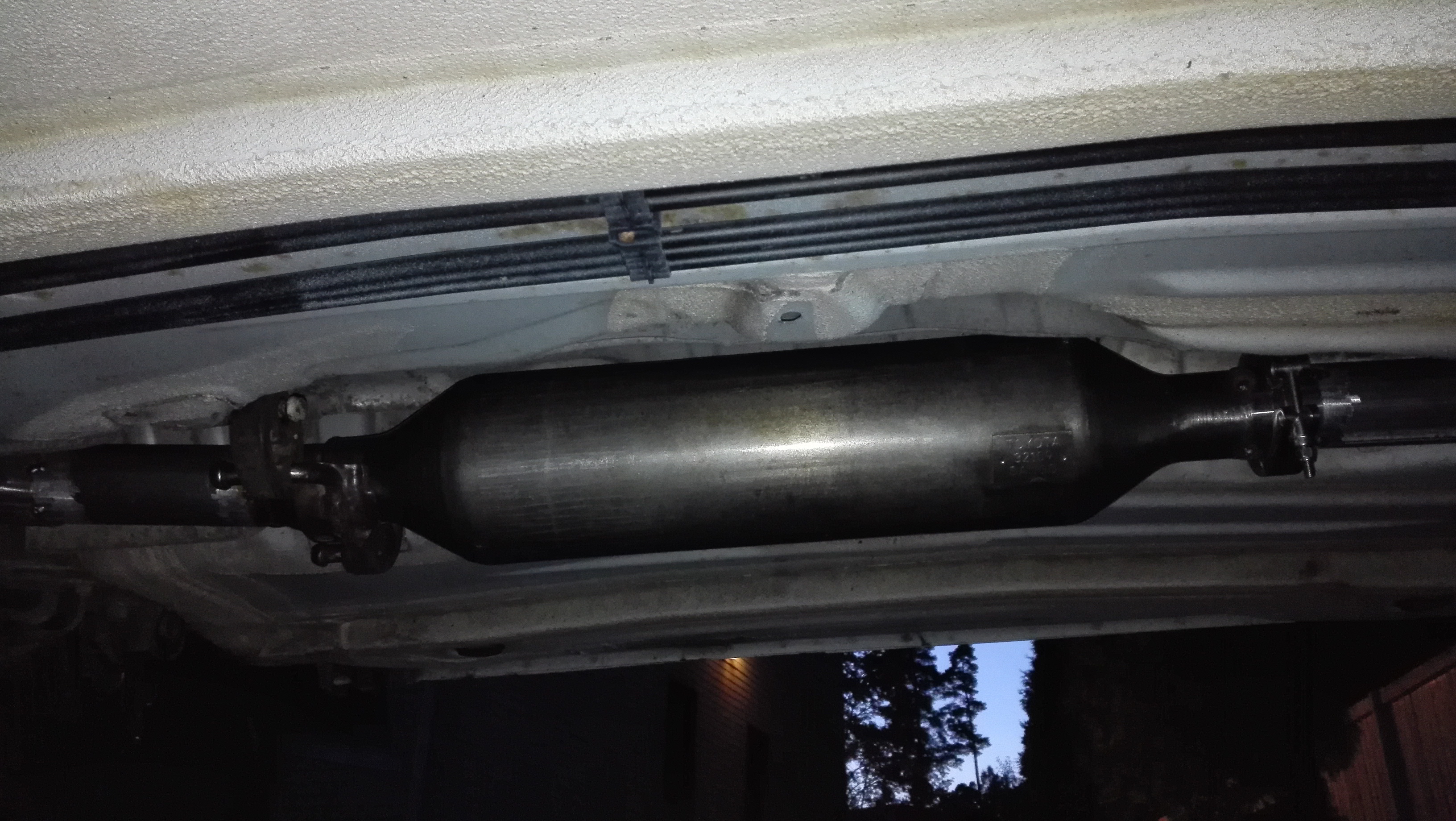

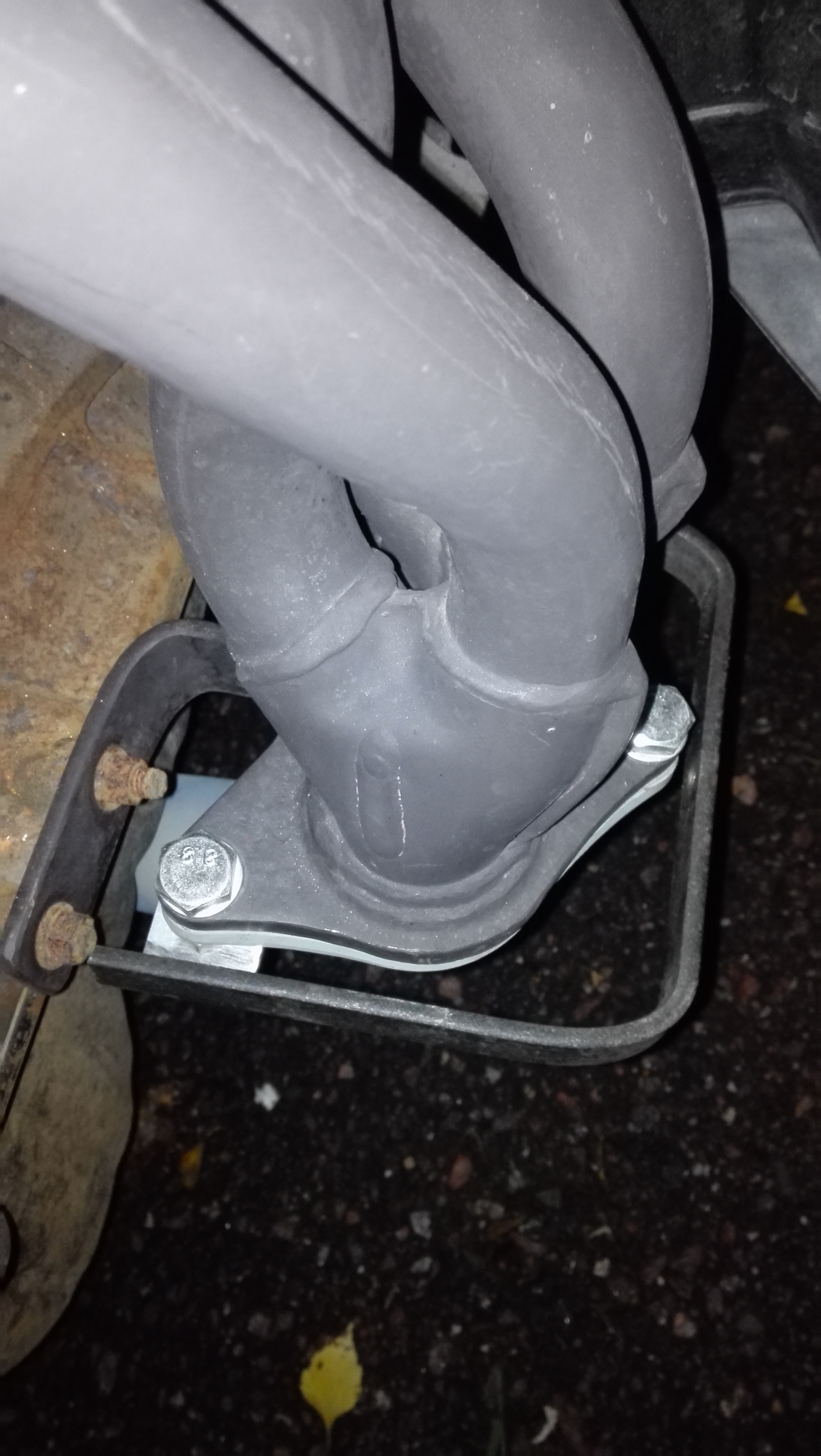

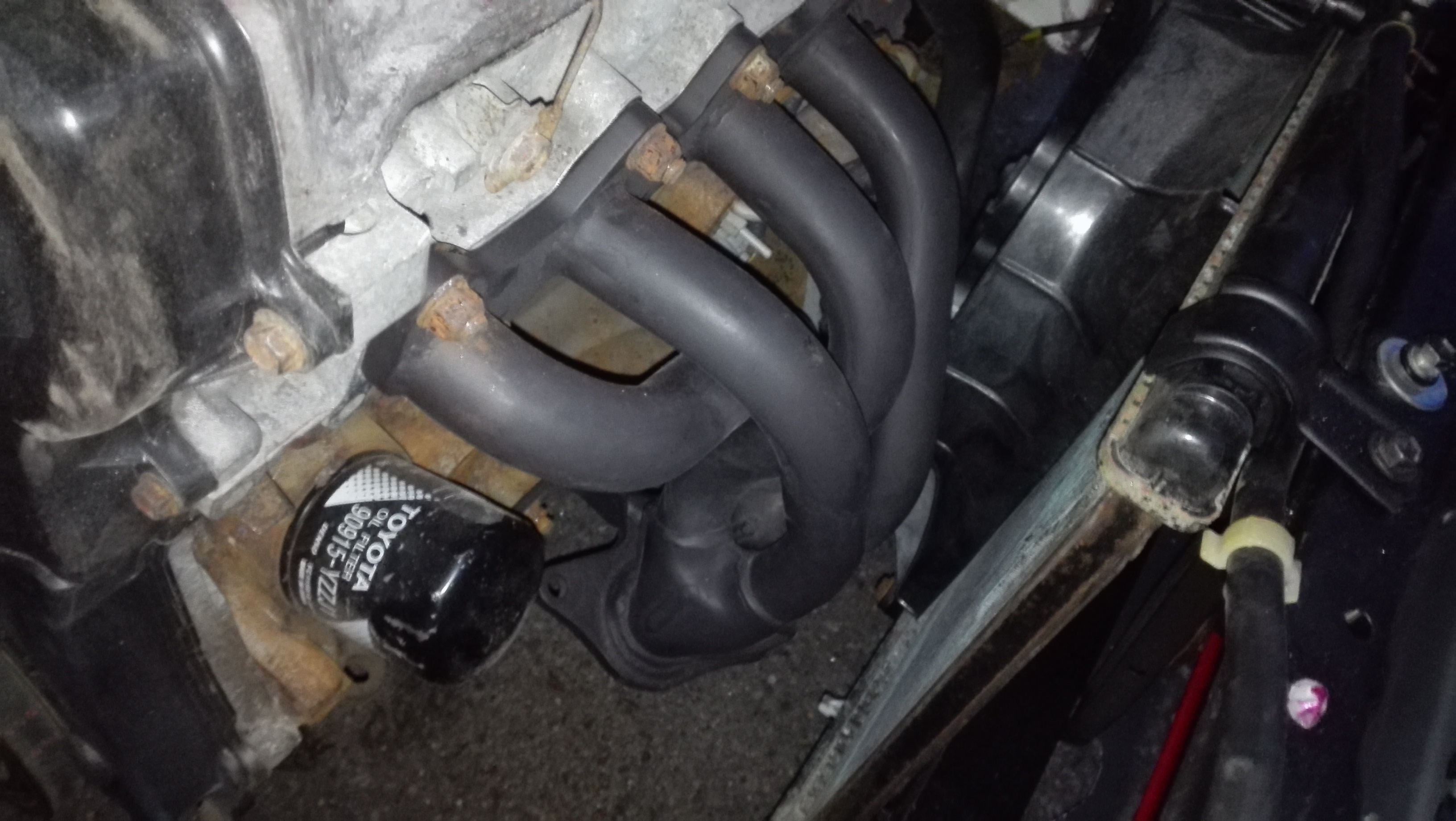

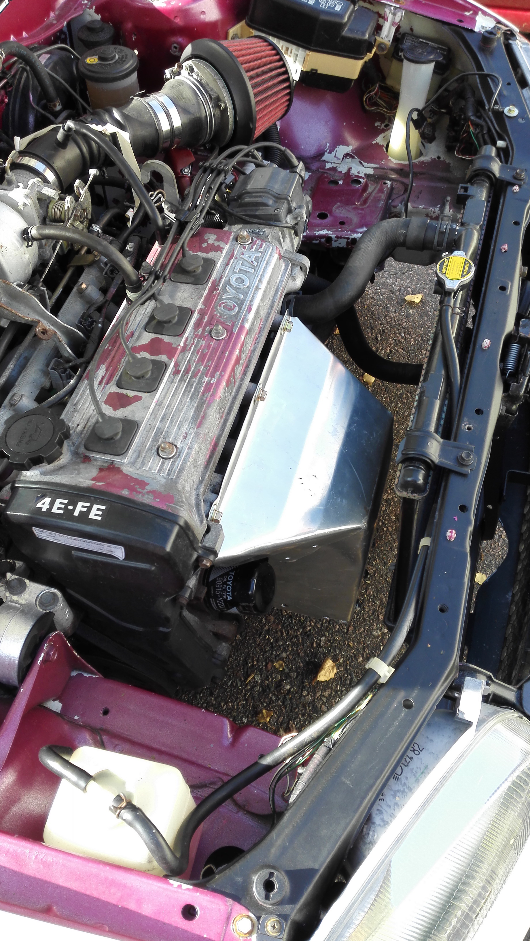

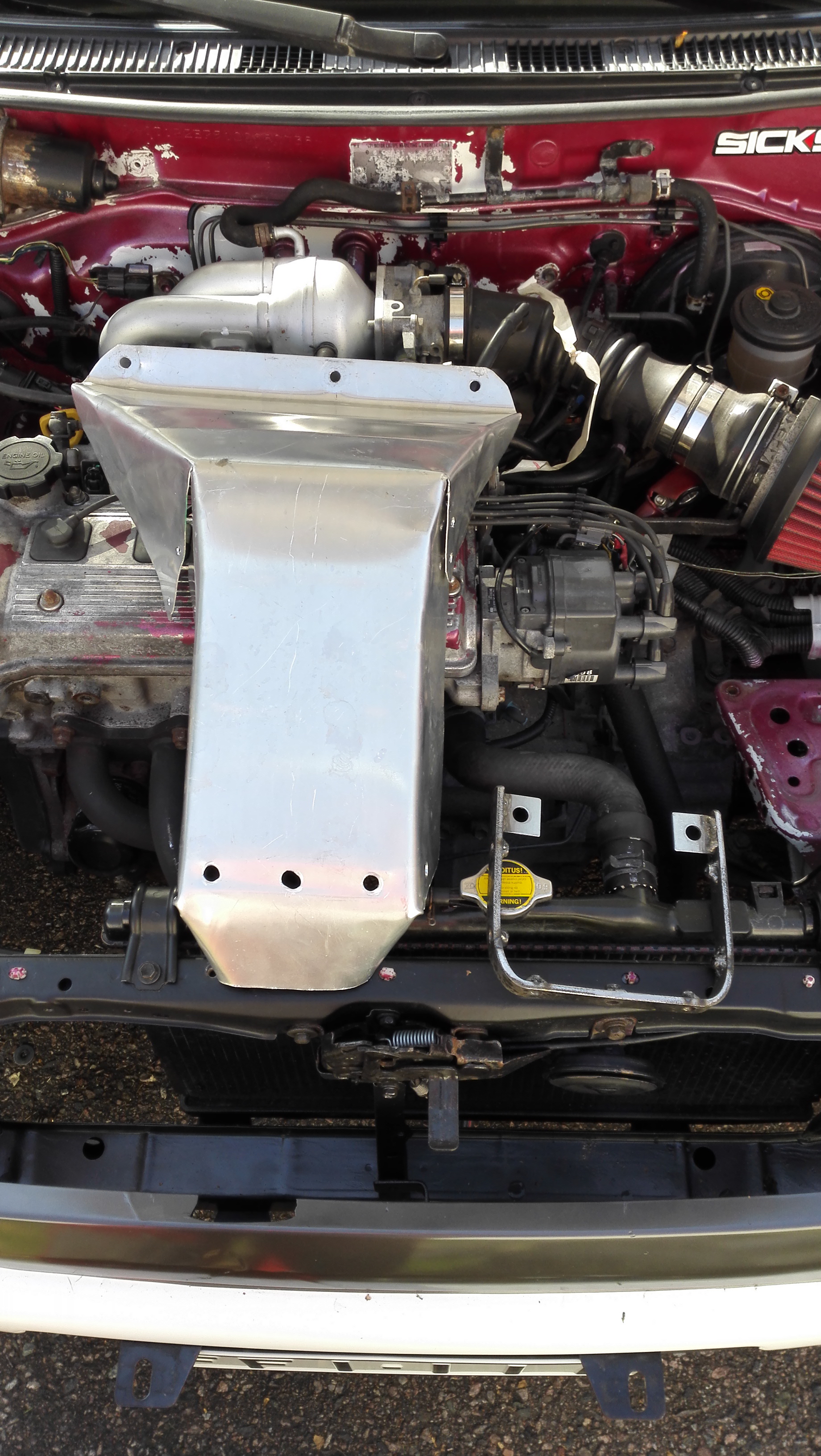

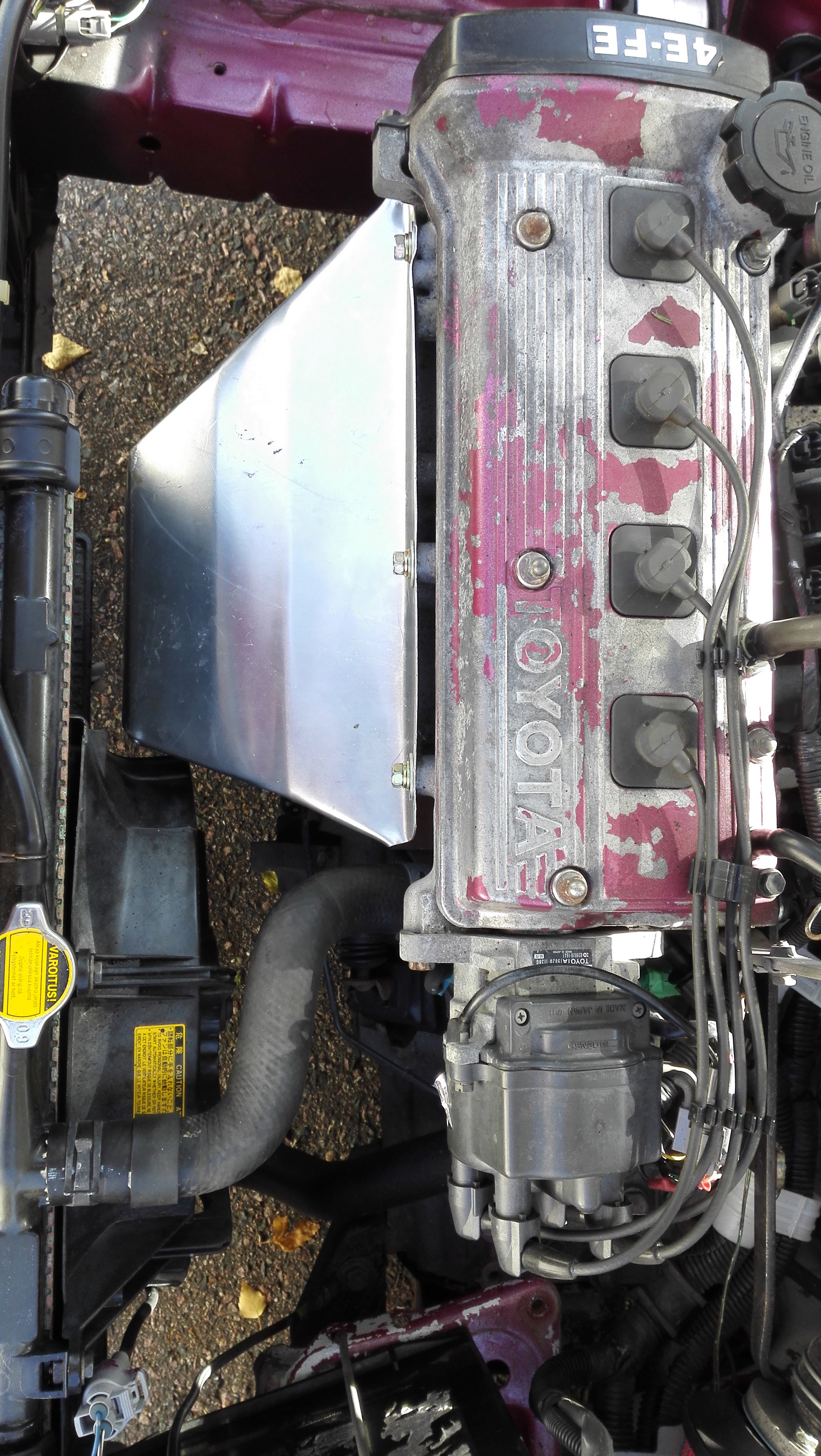

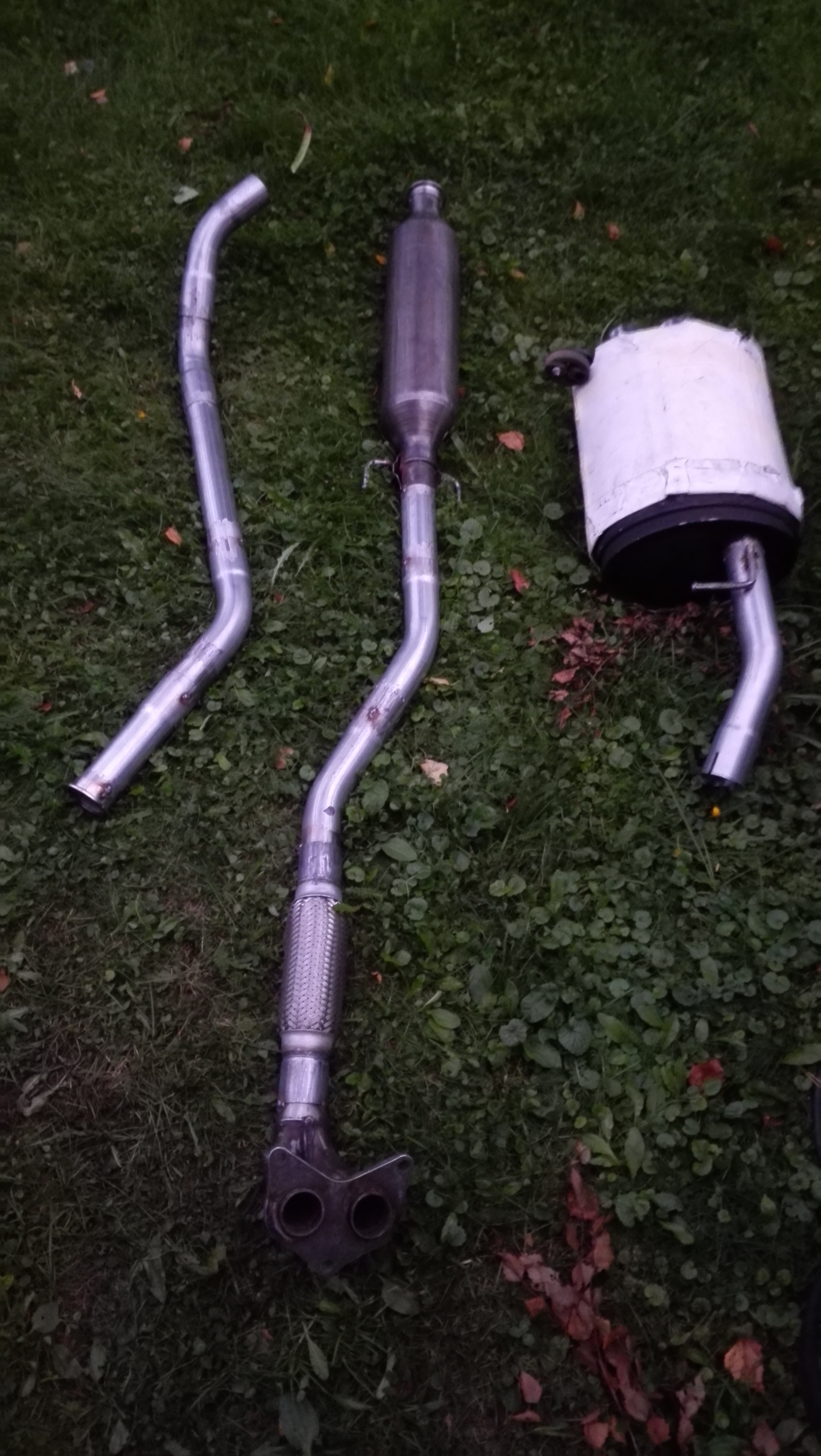

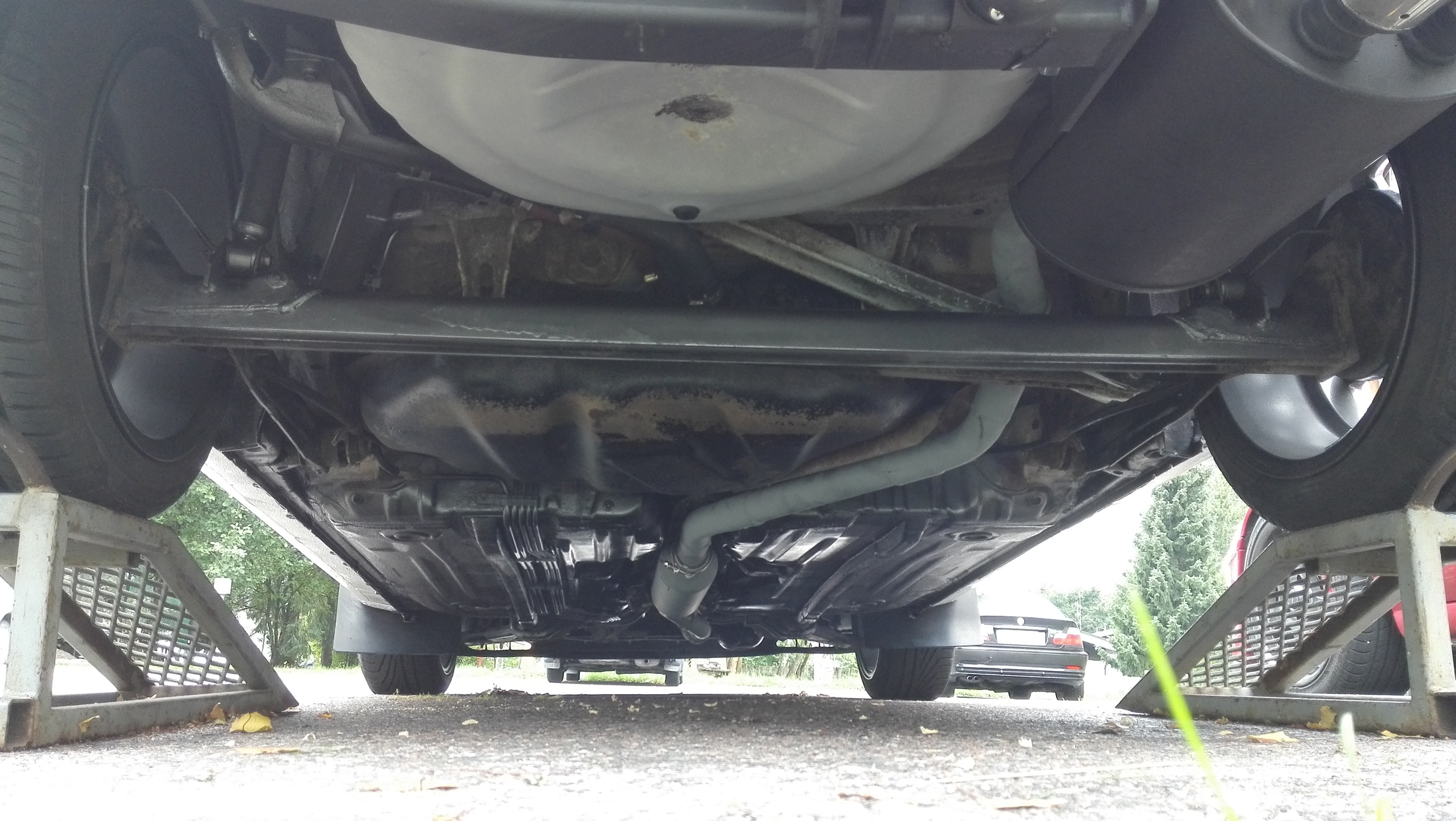

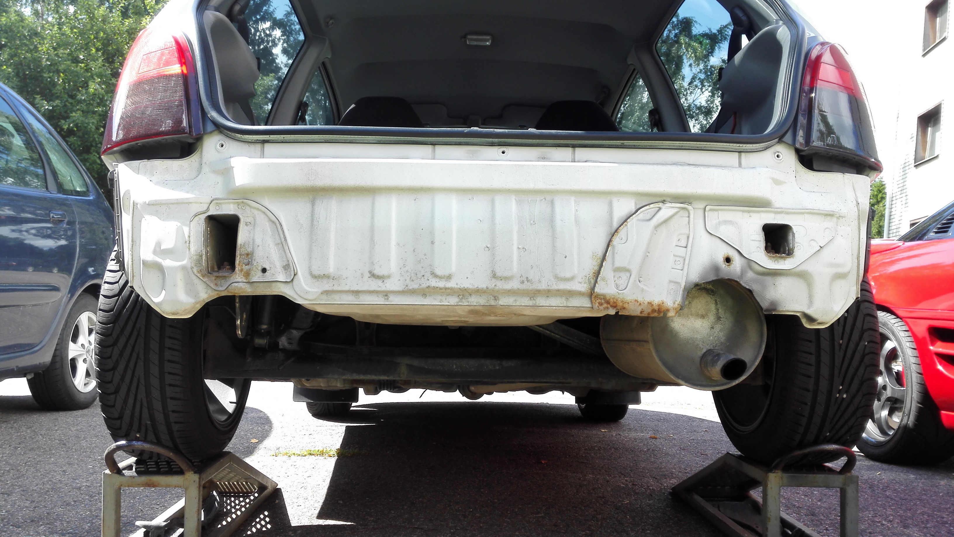

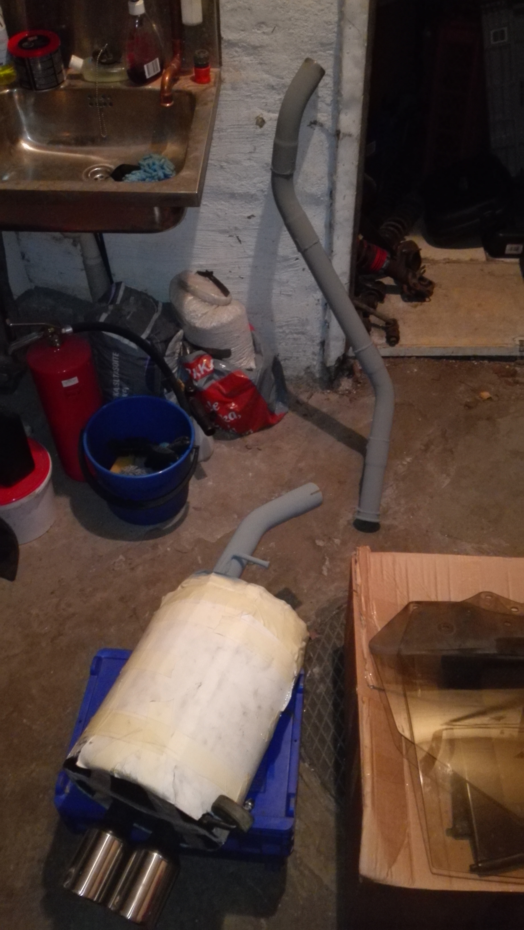

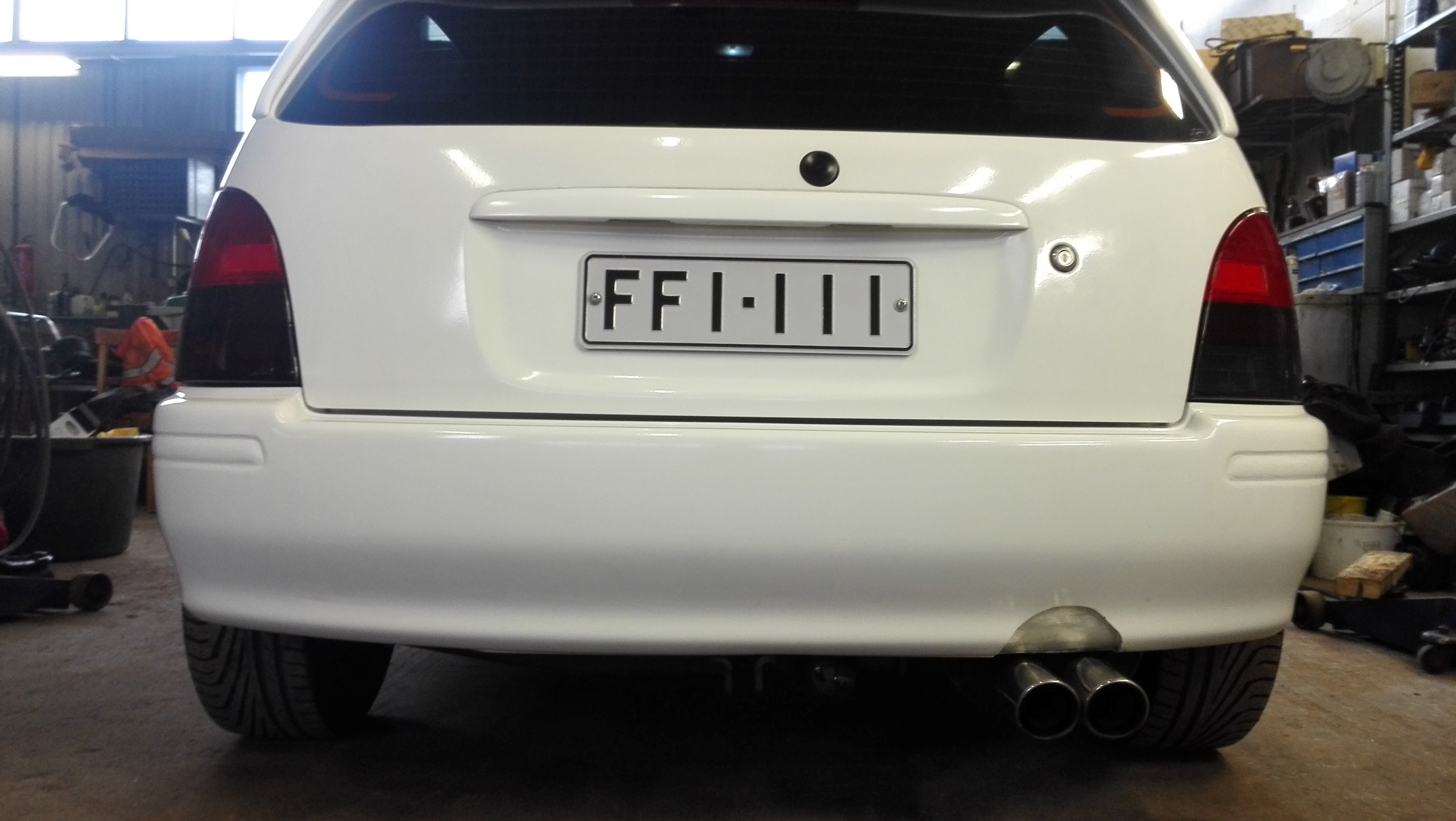

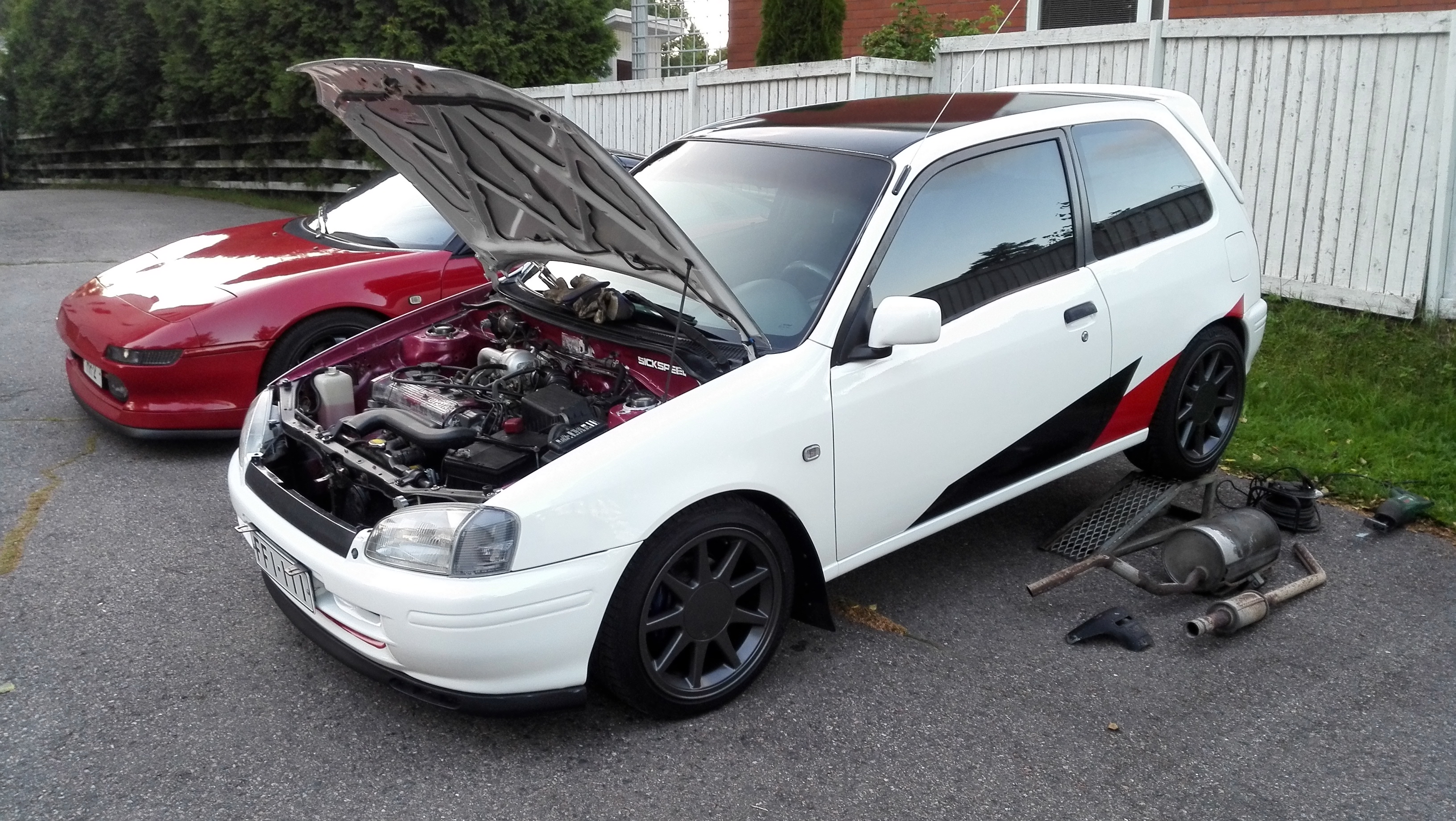

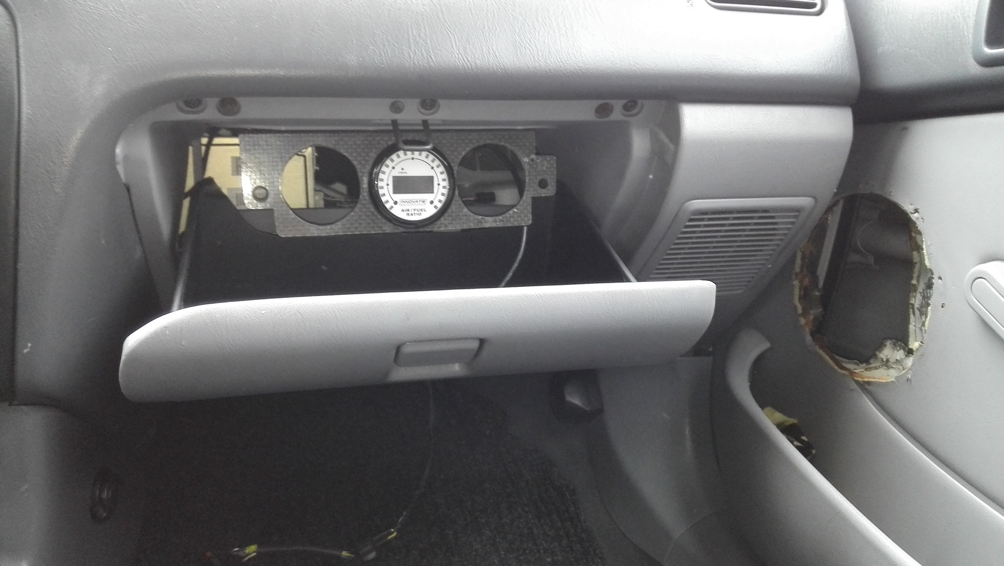

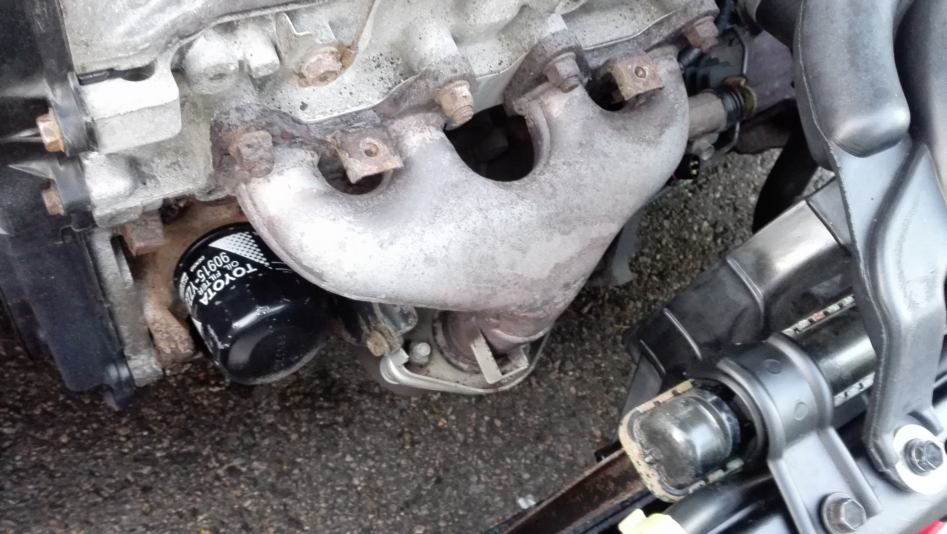

MR-2 Posted November 9, 2017 Author Posted November 9, 2017 It was time to make make new 2" exhaust, 4-2-1 header, no catalysator, old Toyota center and Honda TypeR muffler, as quiet as old original :/ Added also Apexi airfilter and earlier changed that Corolla intake manifold. Exhaust was made also for later turbo purpose... Added also Innovate wideband sensor and gauge in the clovebox, don't wanna any visible gauges. Earlier owner has cutted a hole in the rear bumper, made temporaly panel add, later gona paint lower part or adding some small diffuser on it. Painted also middle floor sector. Quote
MR-2 Posted November 9, 2017 Author Posted November 9, 2017 Later rear muffler sound changed, now more ricer sound, Olli "Whitestar" reving my n/a beast, sounds like bean in the empty canister, maybe some inner plate is loosen or somethig. Much rev happier after 4000 rpm. VID_20171104_130904.mp4 Quote

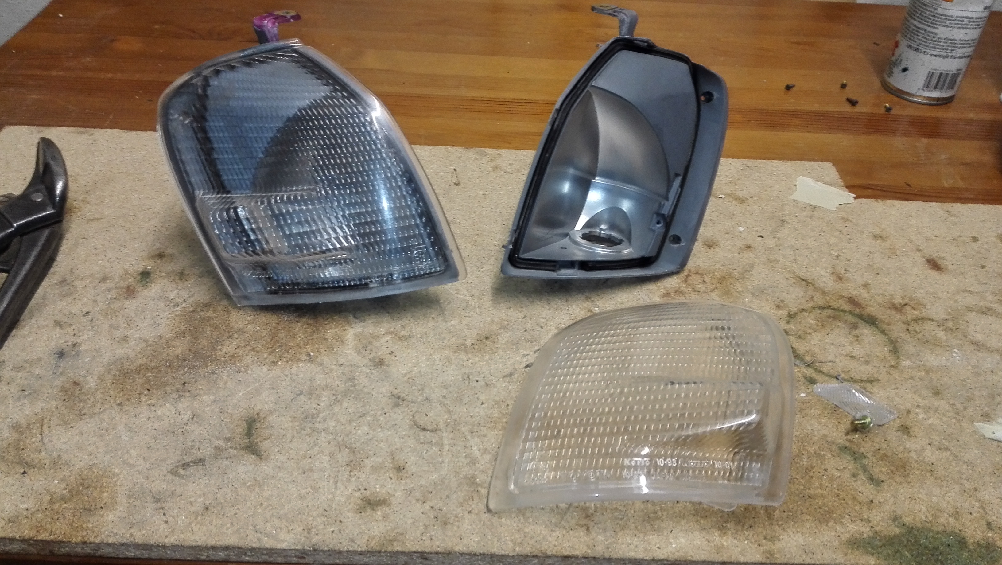

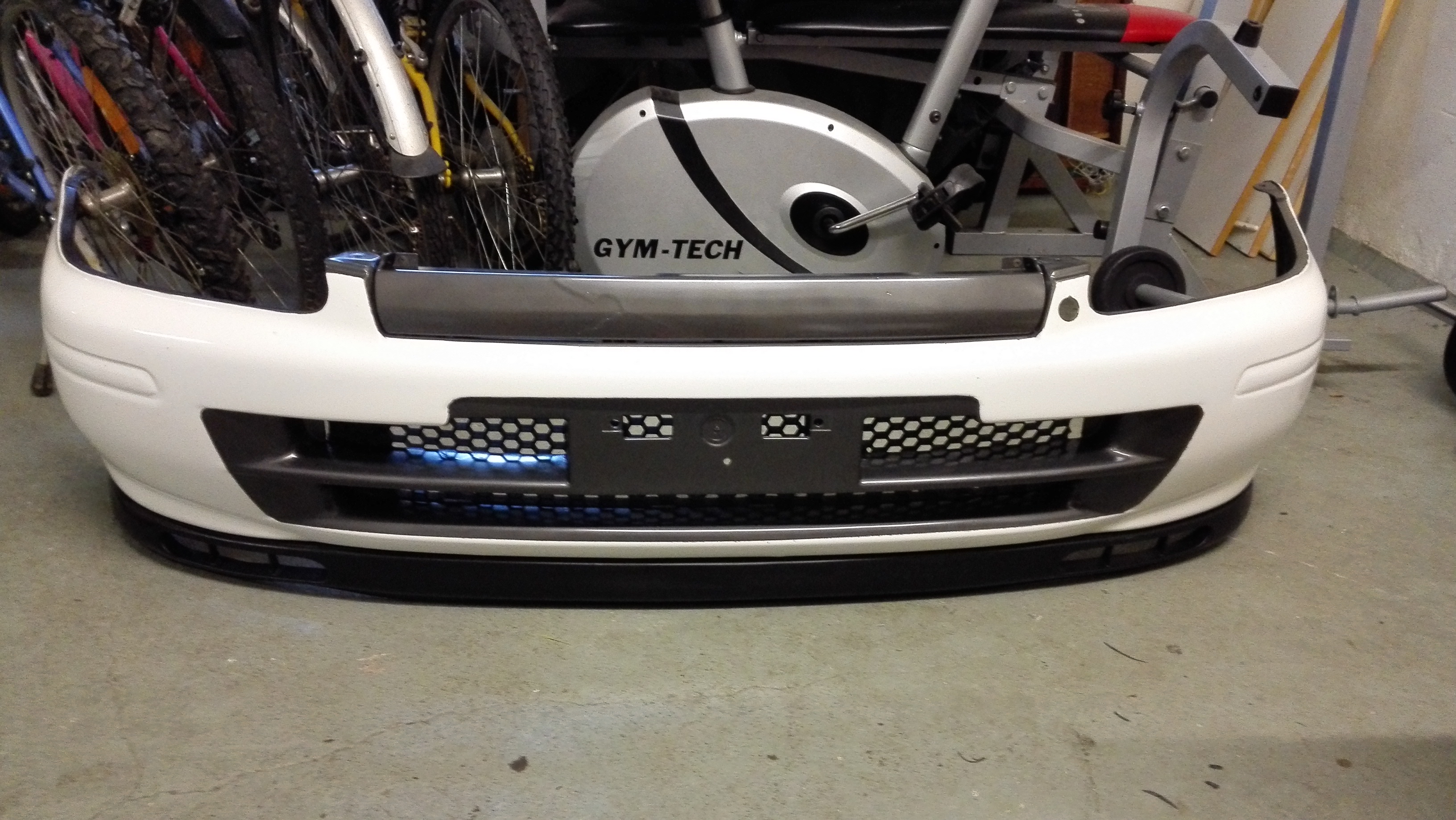

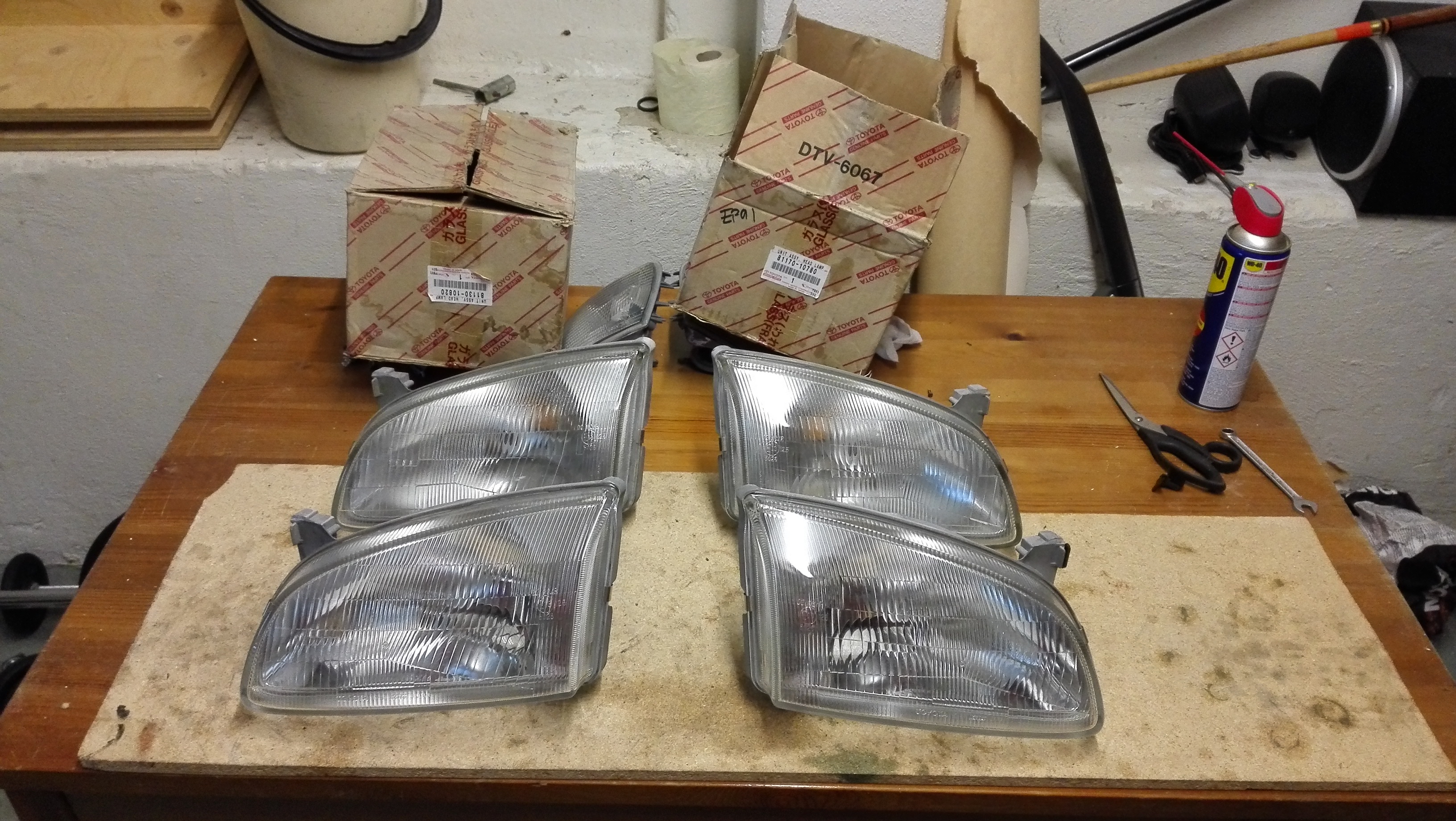

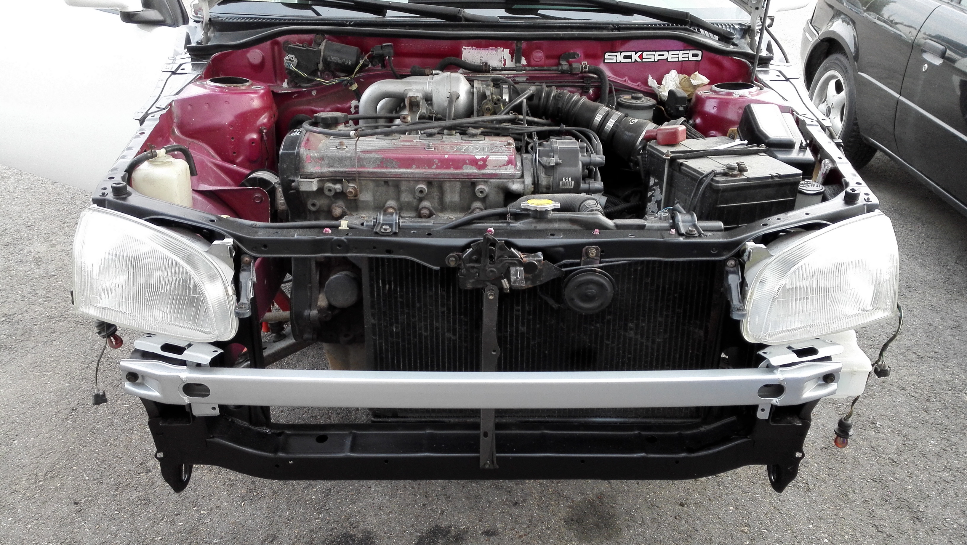

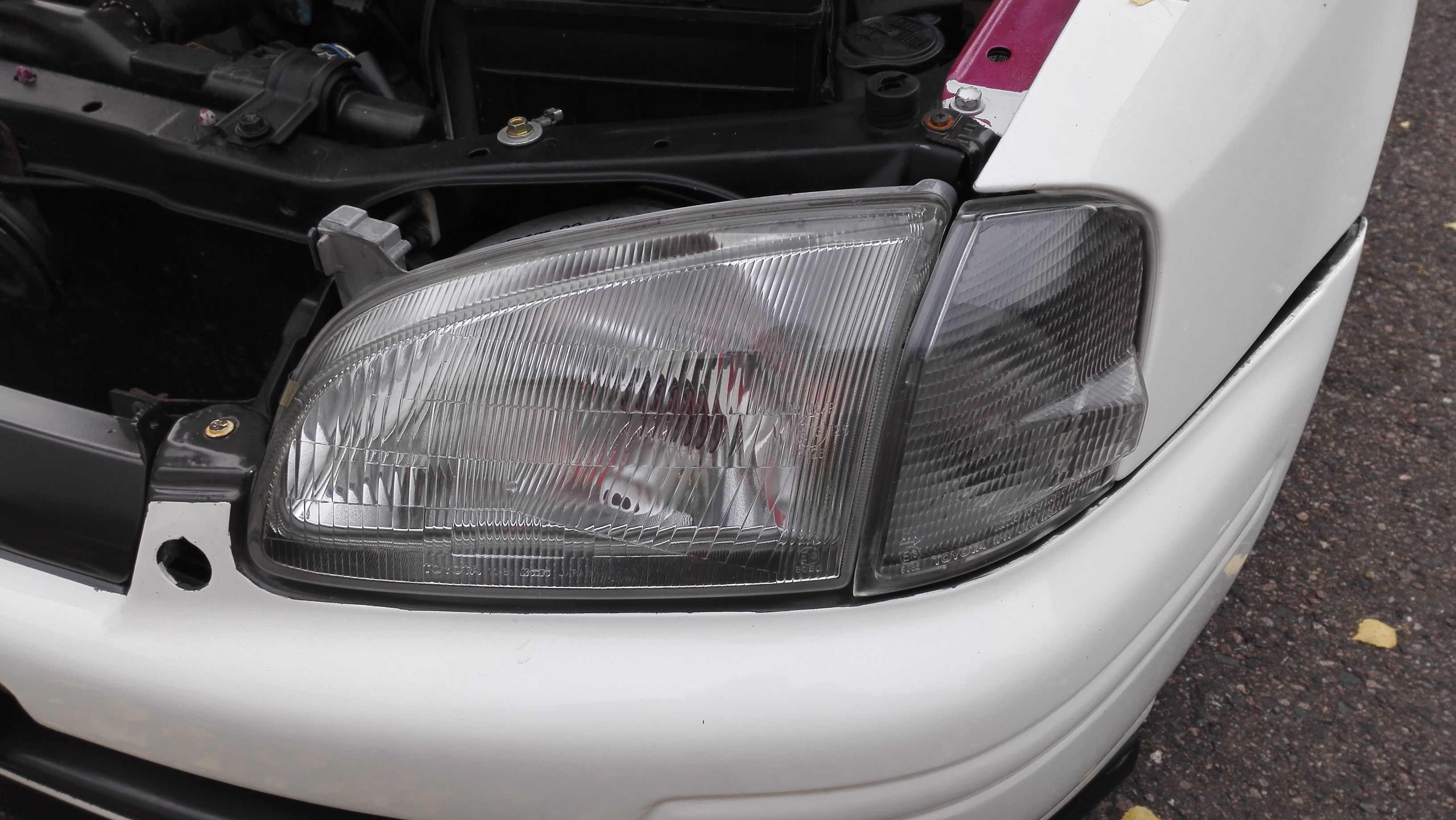

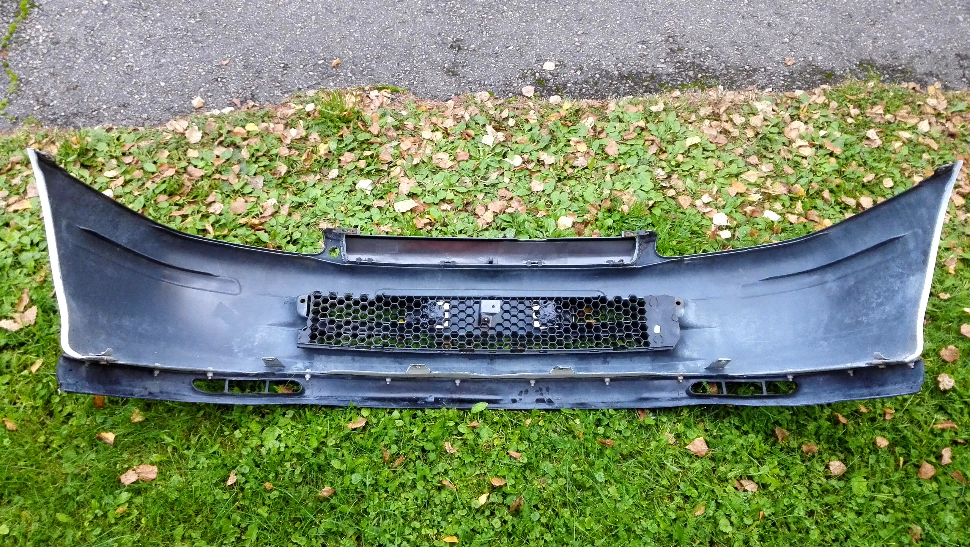

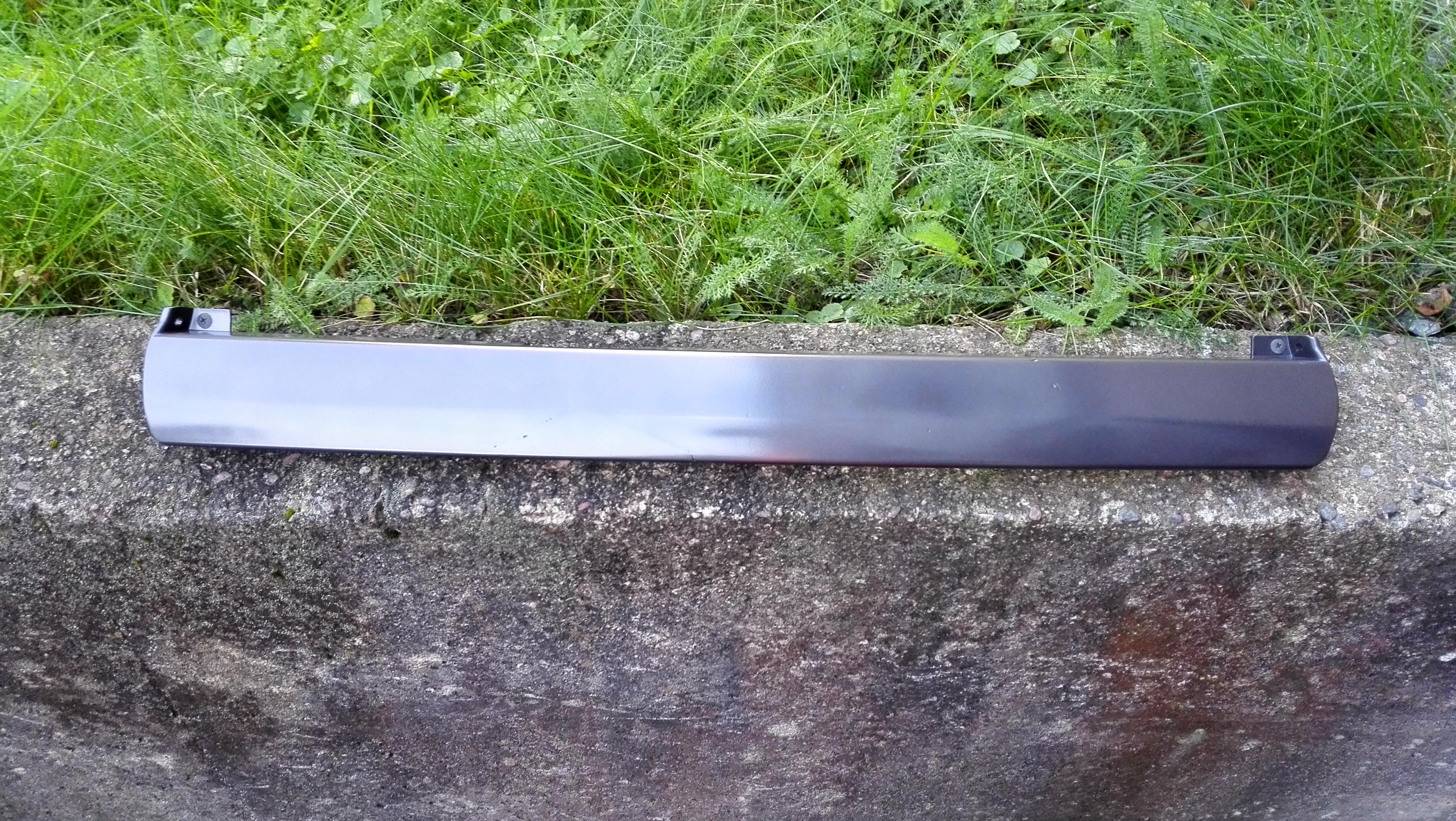

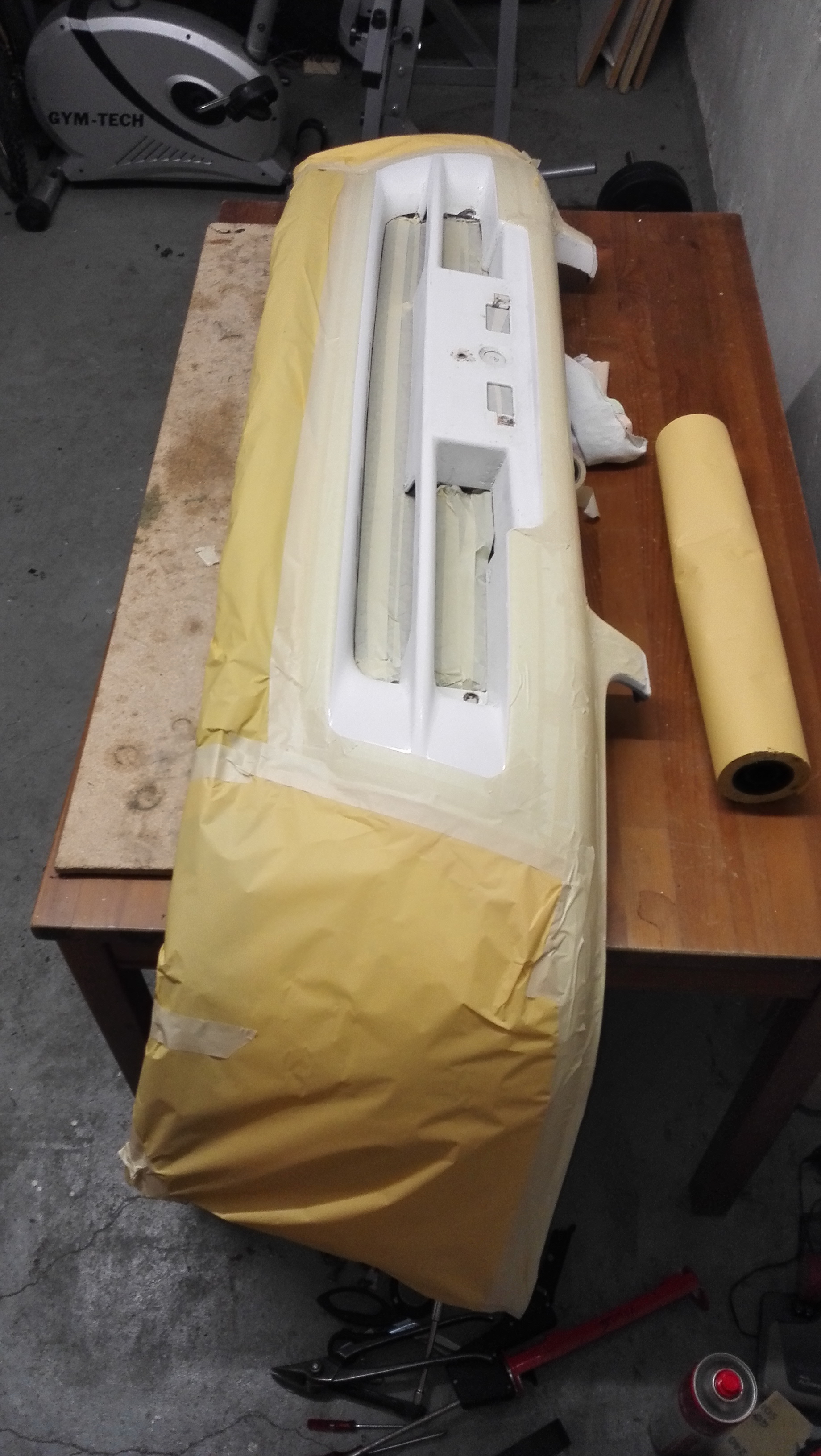

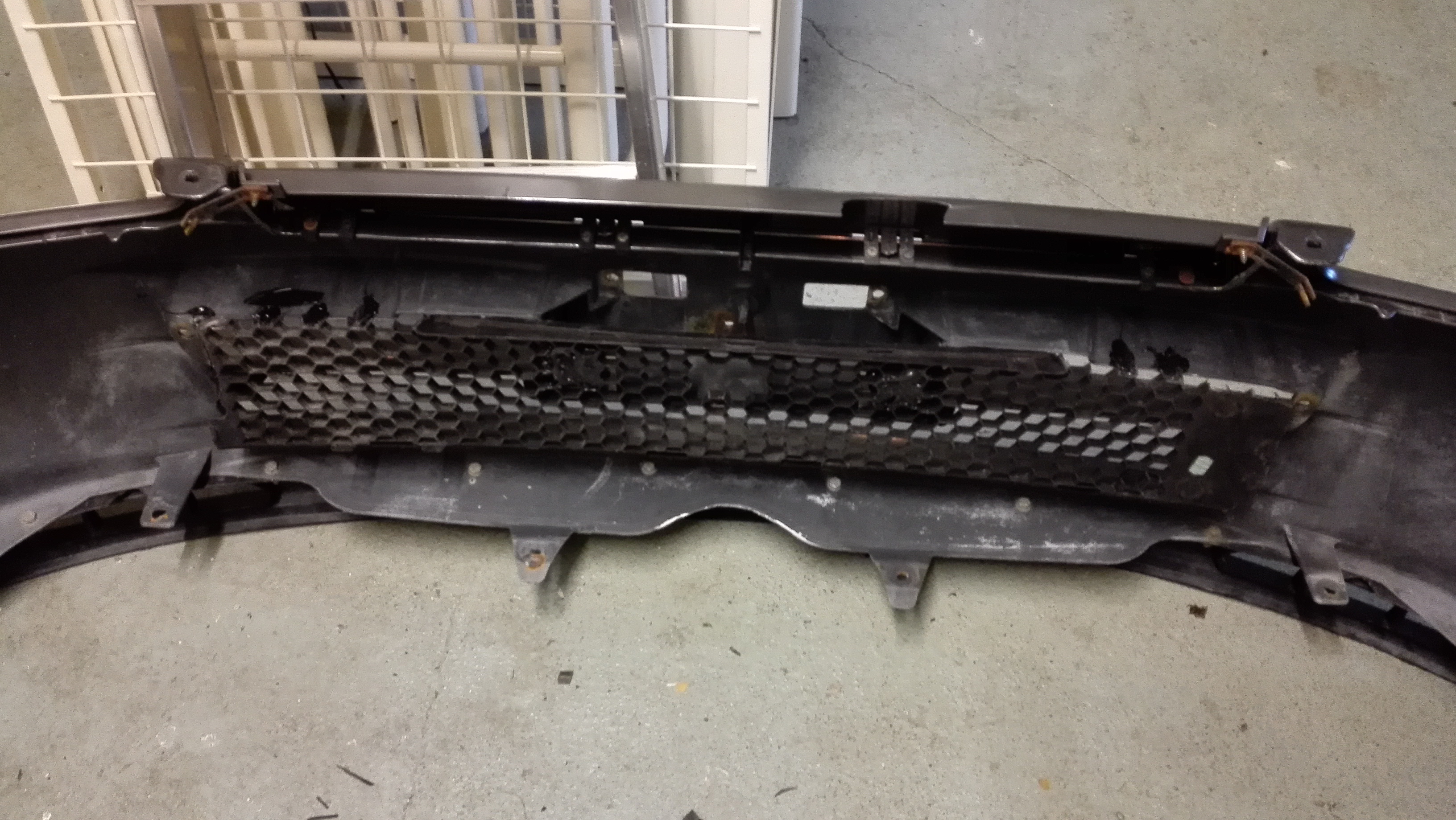

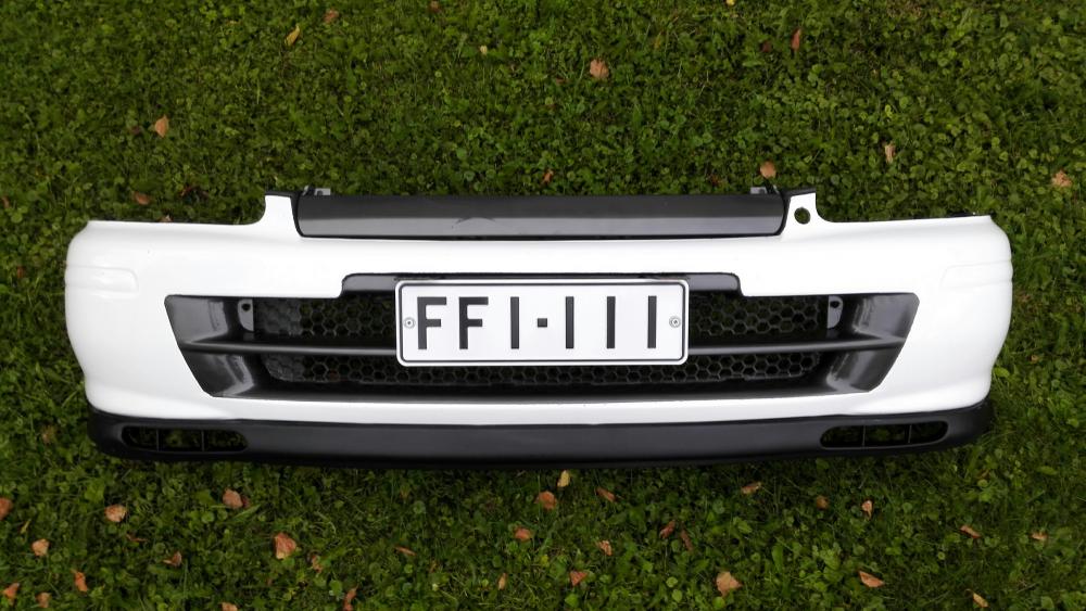

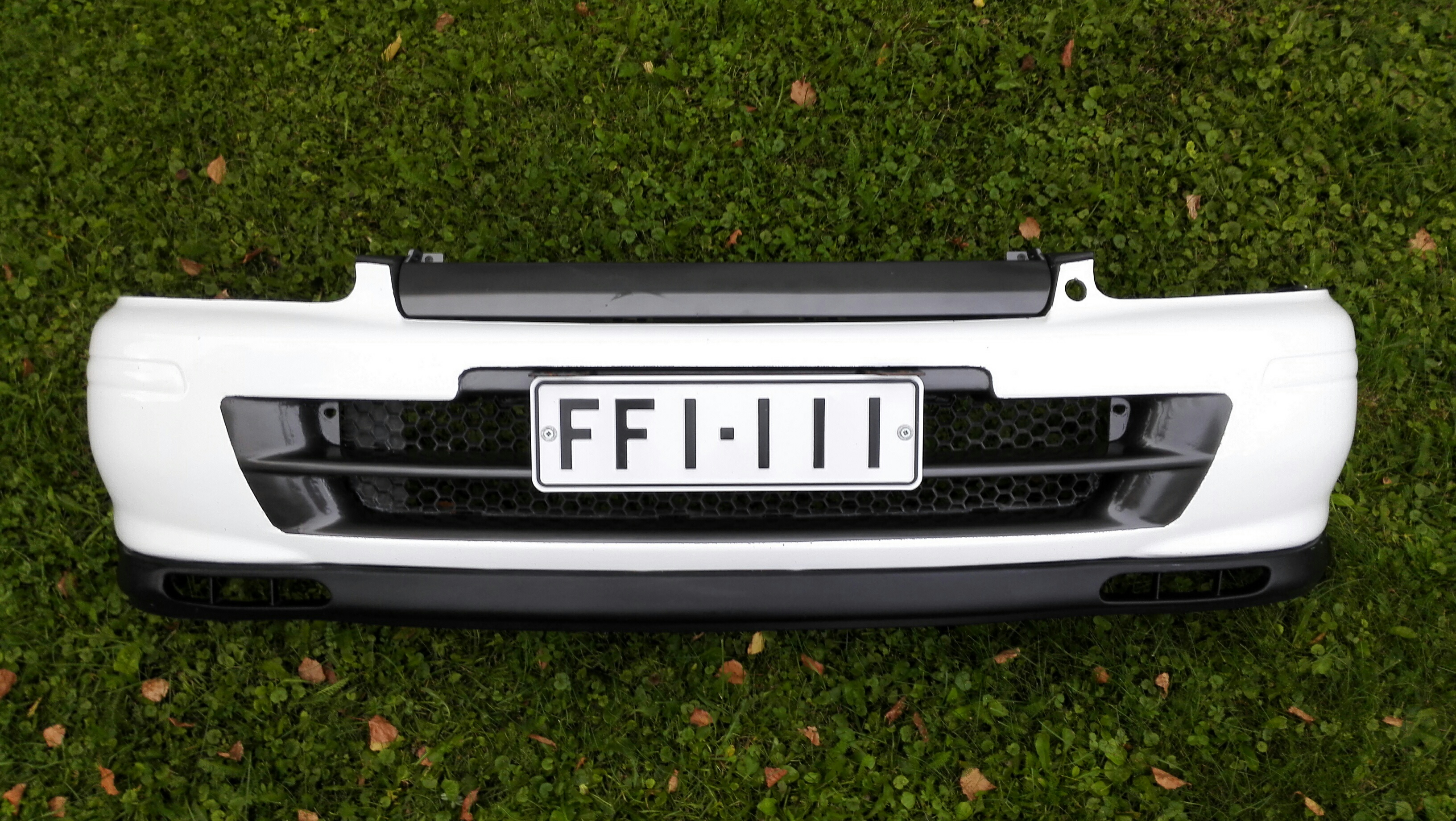

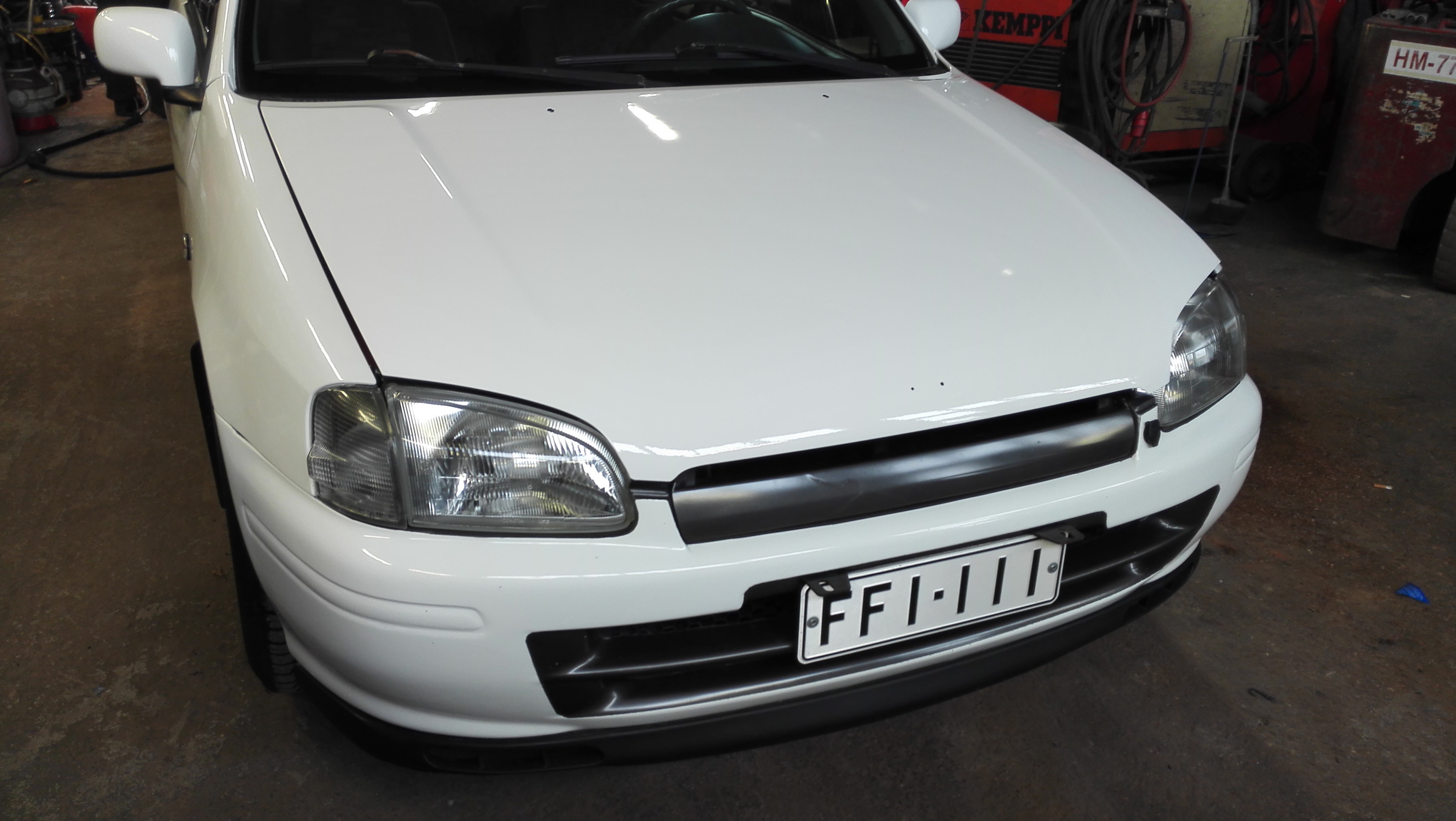

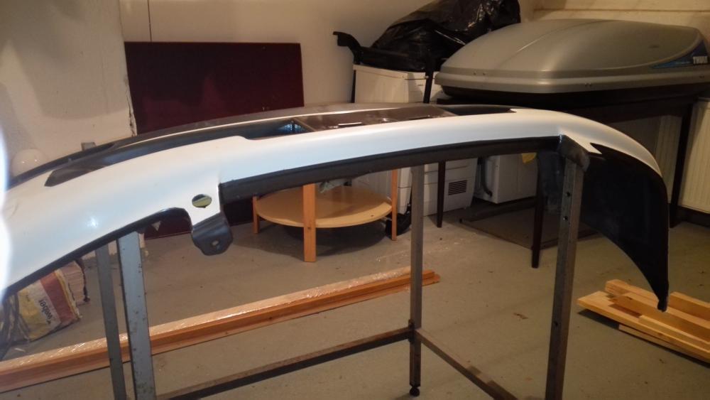

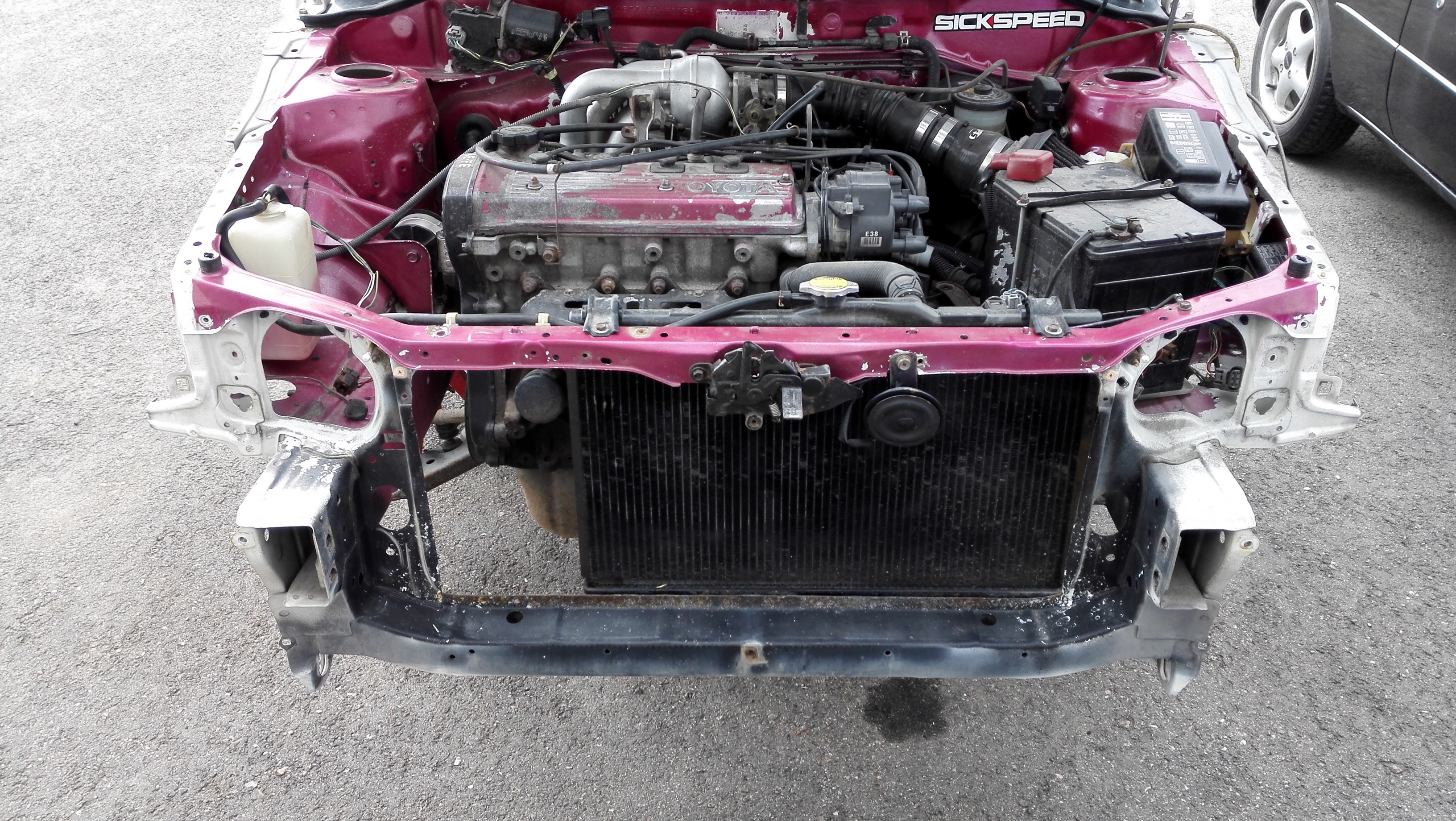

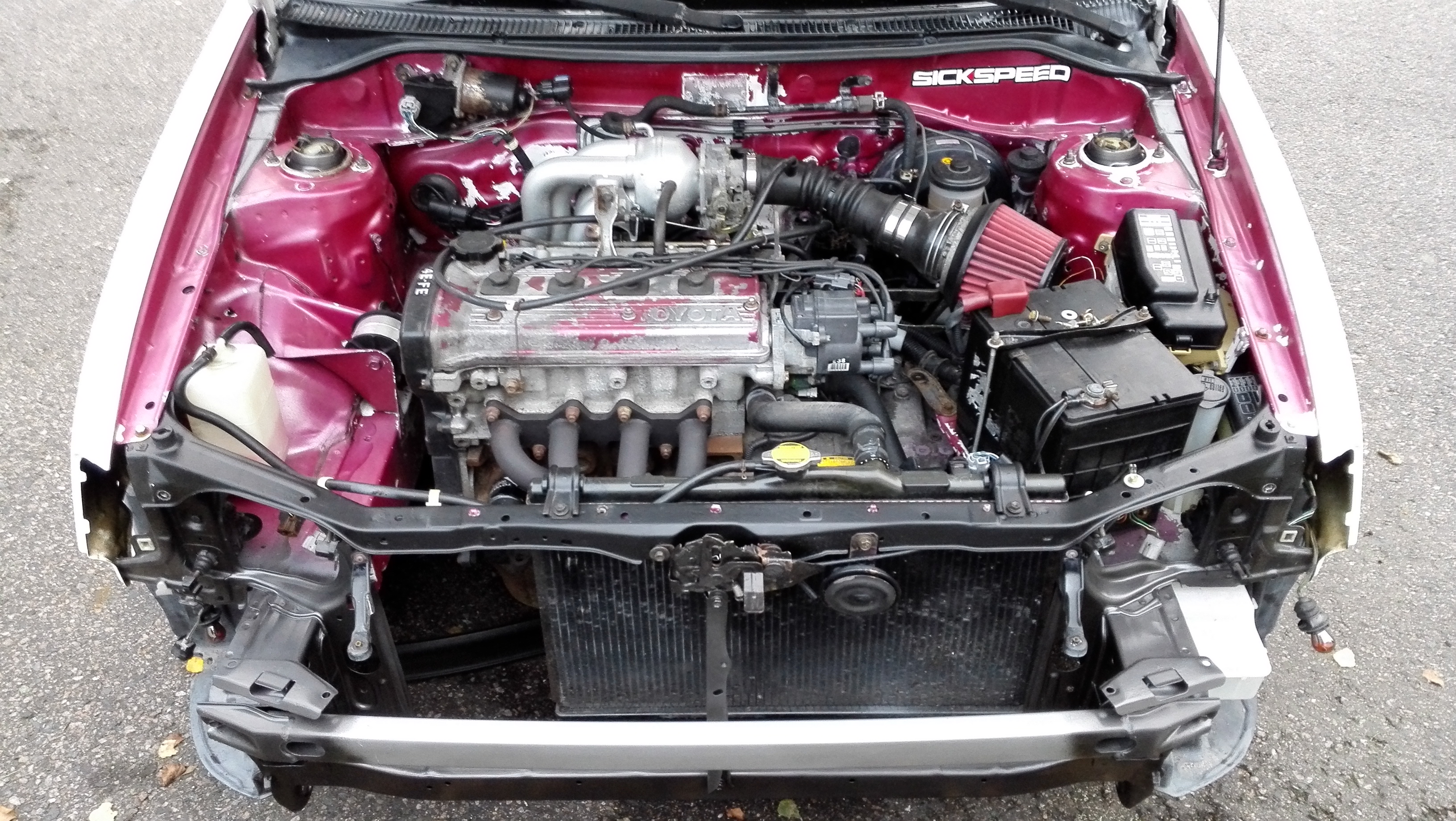

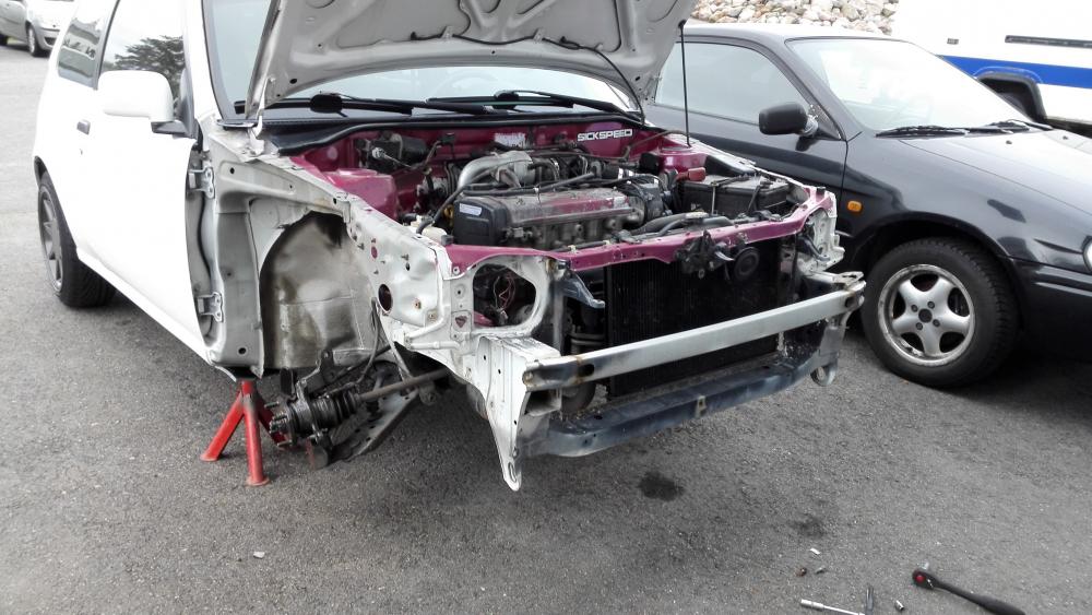

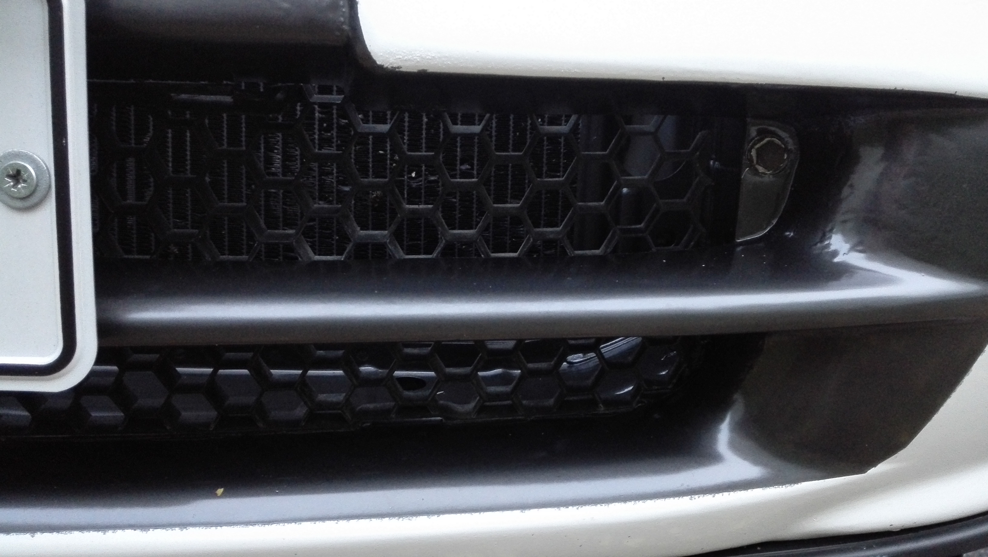

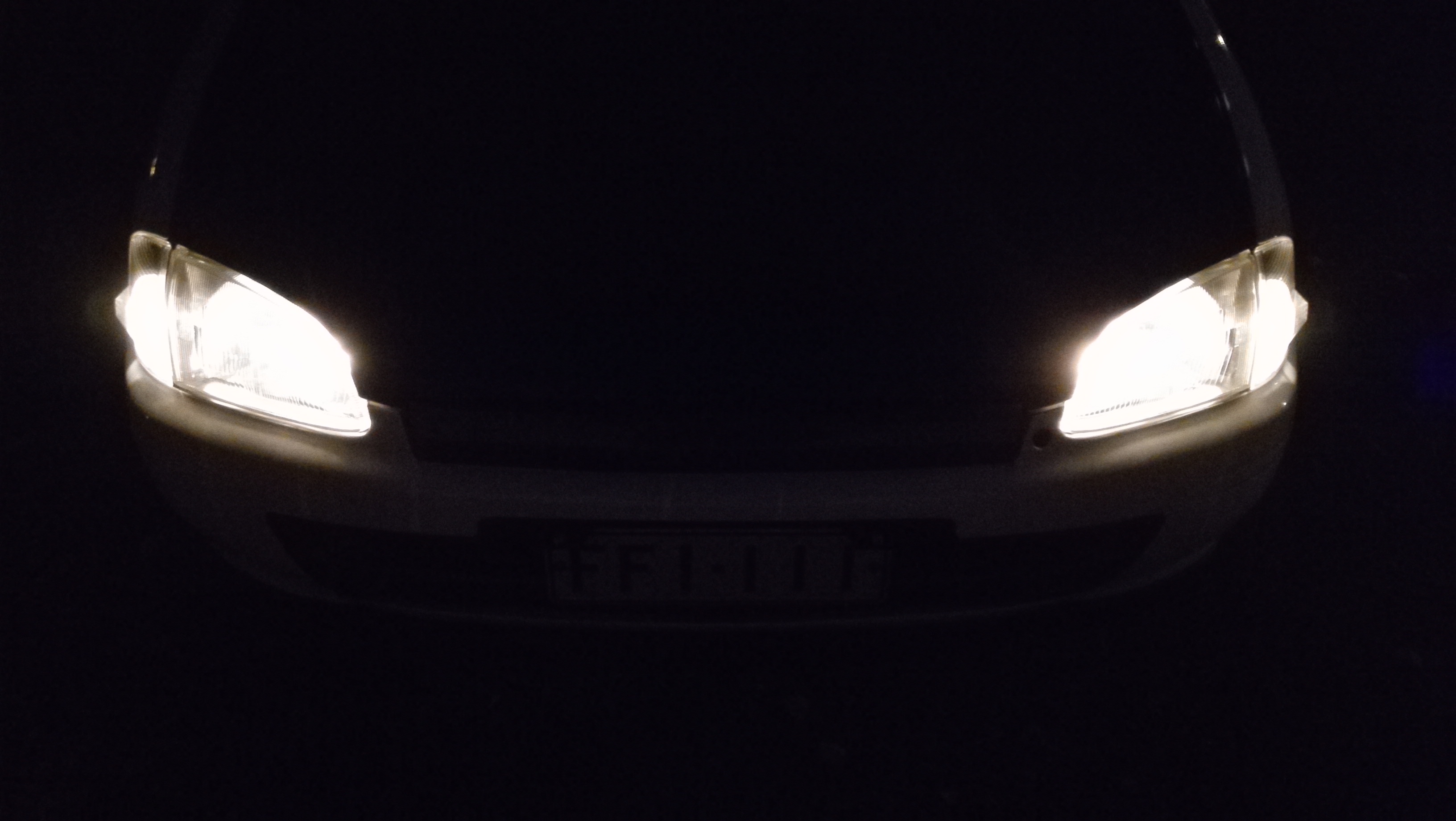

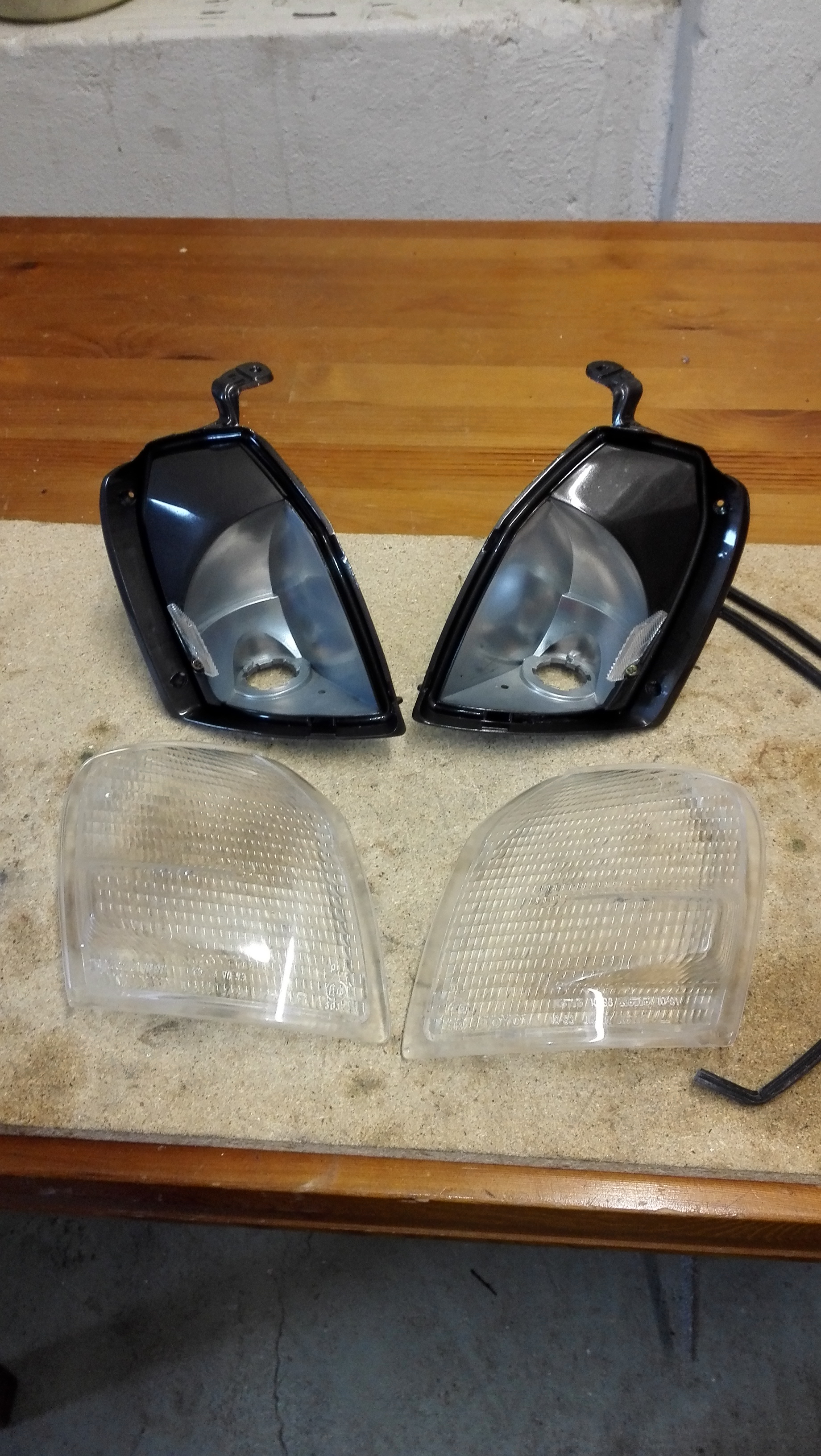

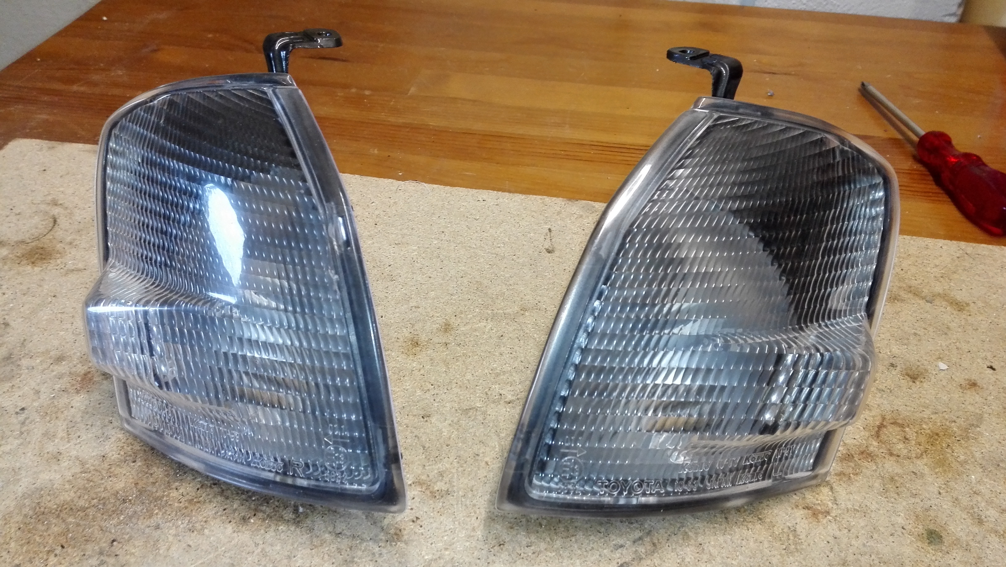

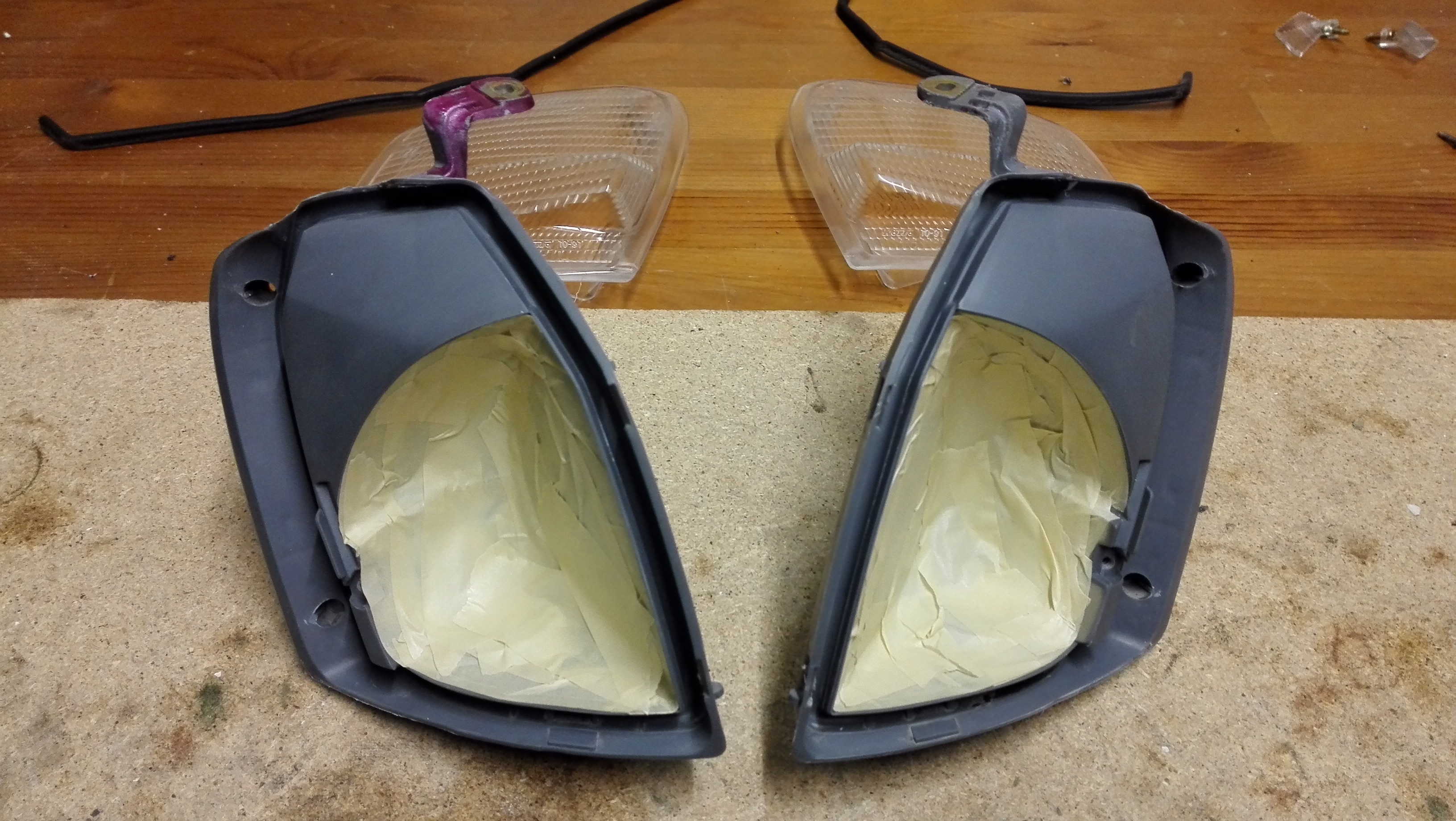

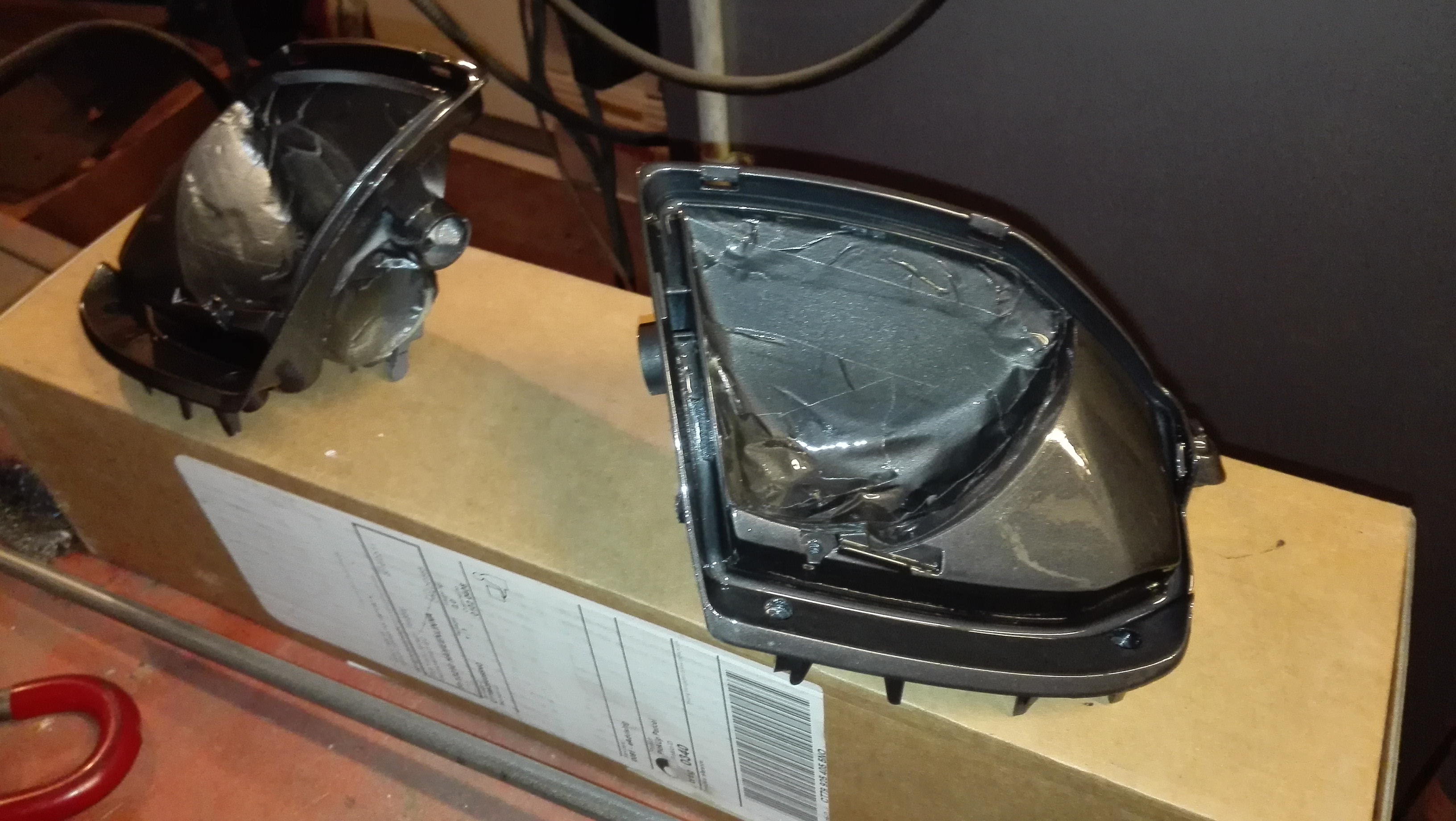

MR-2 Posted November 9, 2017 Author Posted November 9, 2017 Next project was adding some old Ford honeycomp plastic mesh and front bumper partially painting, wanted some gunmetall color also there, same as on my TTE wheels. Center mask was from mk3 Golf, earlier owner cutted that also, not perfect and one day huge stone went threw it, so it is rapidly fixed. Also factory new front lamps, old one were leaking little bit. Same time I painted signal inside for more darker look, don't still match with main lamps. Double parking lamps also and rear lamps are also opened inside for wider look. Sorry for picture tsunami :/ Quote

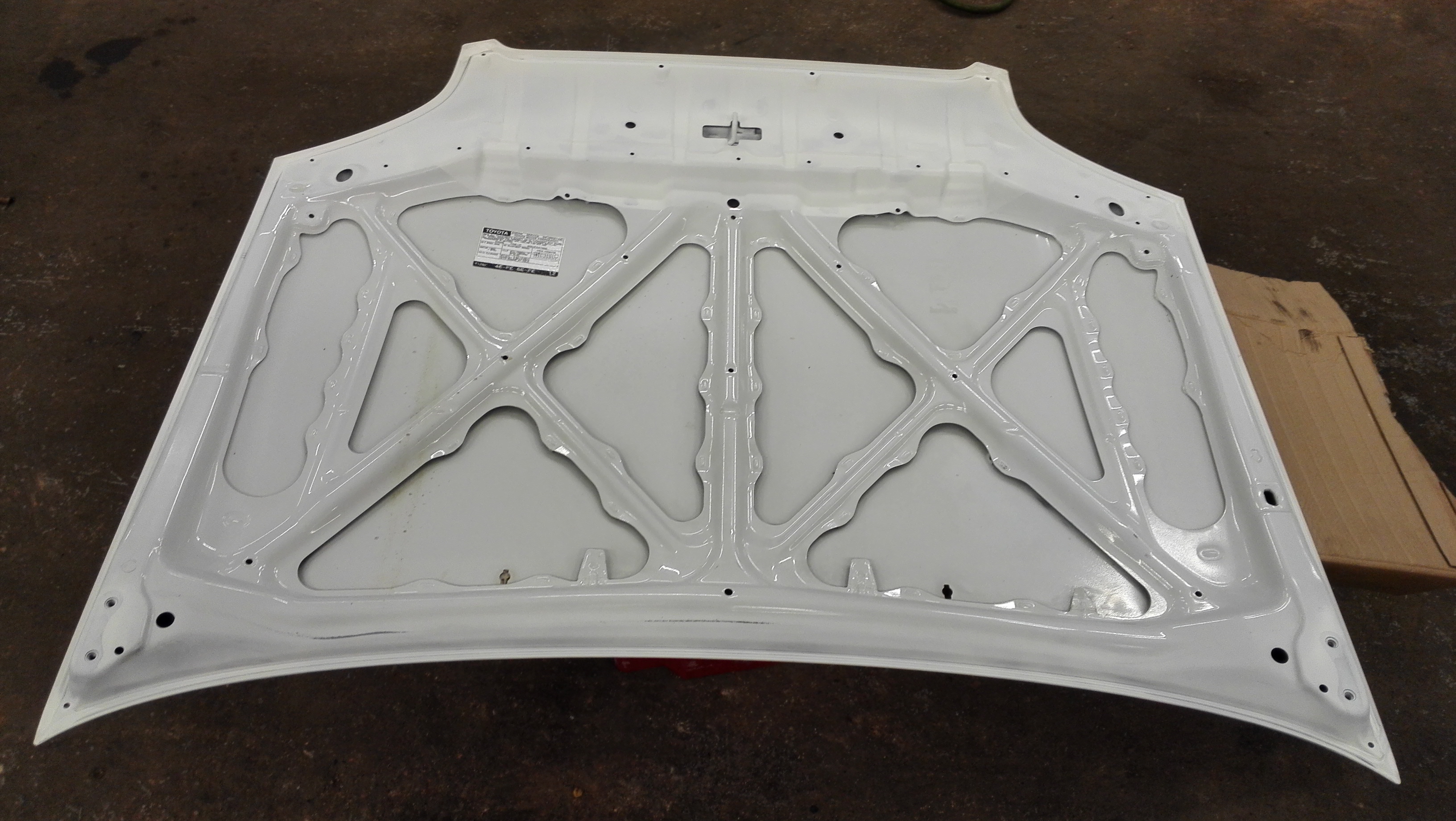

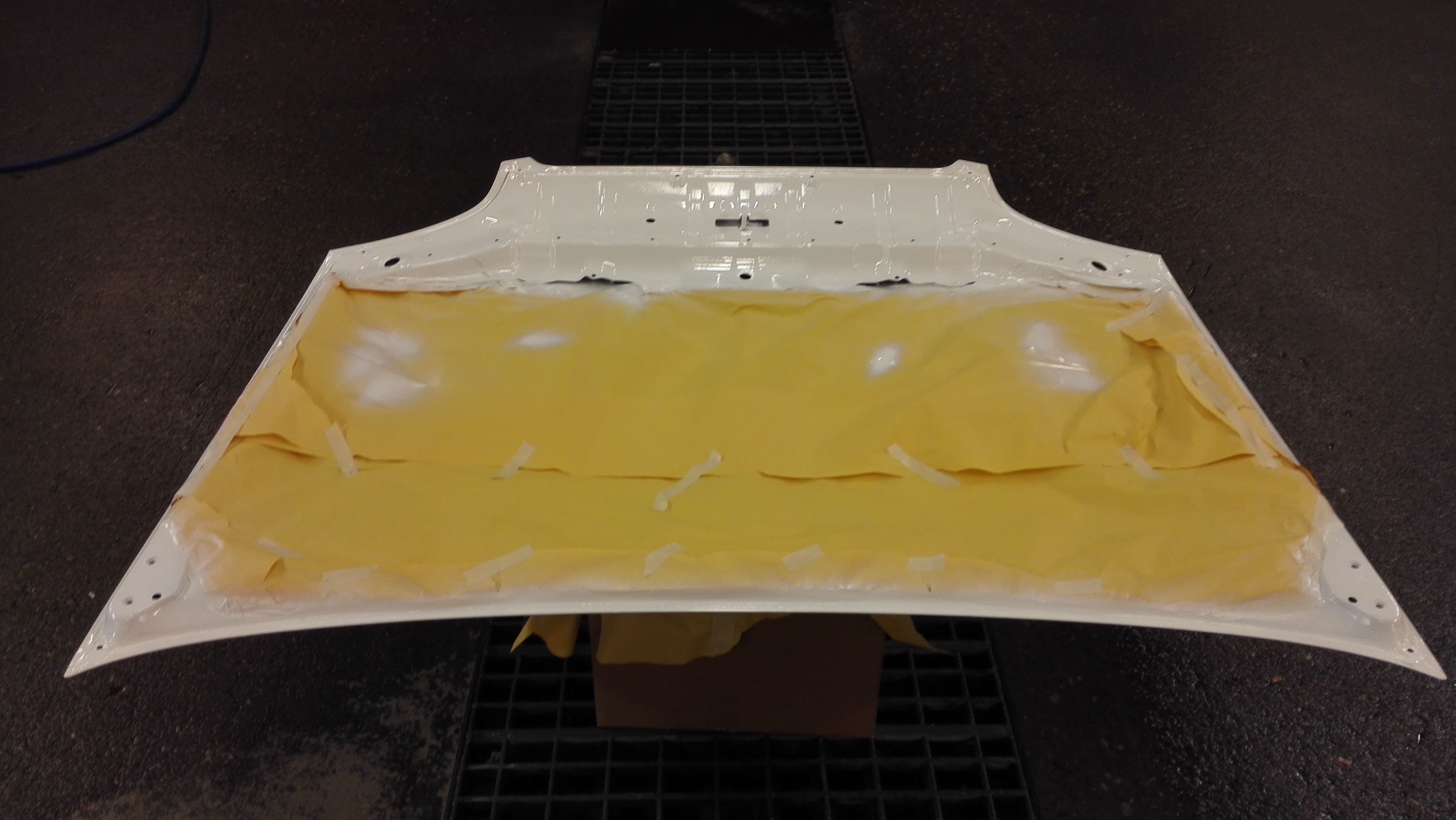

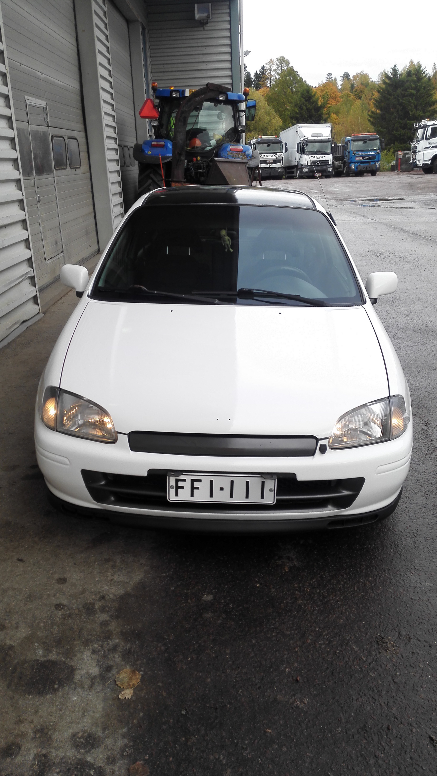

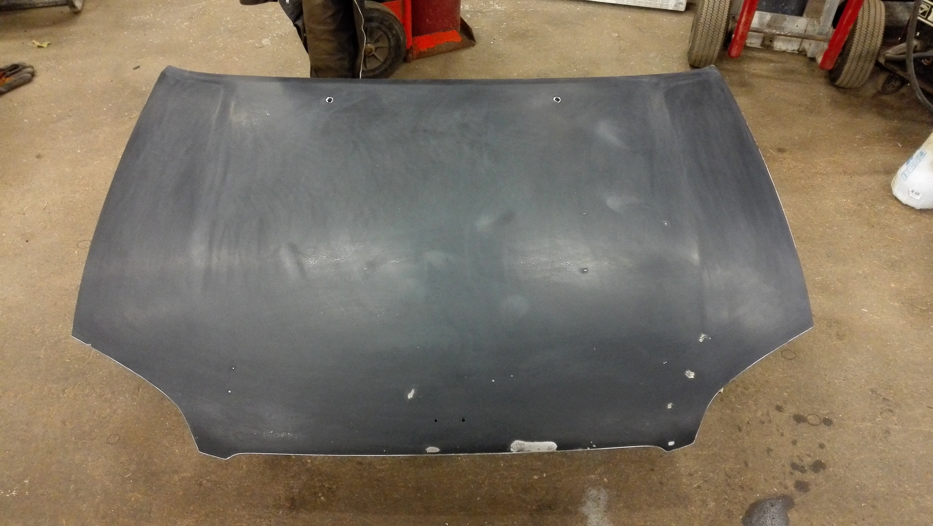

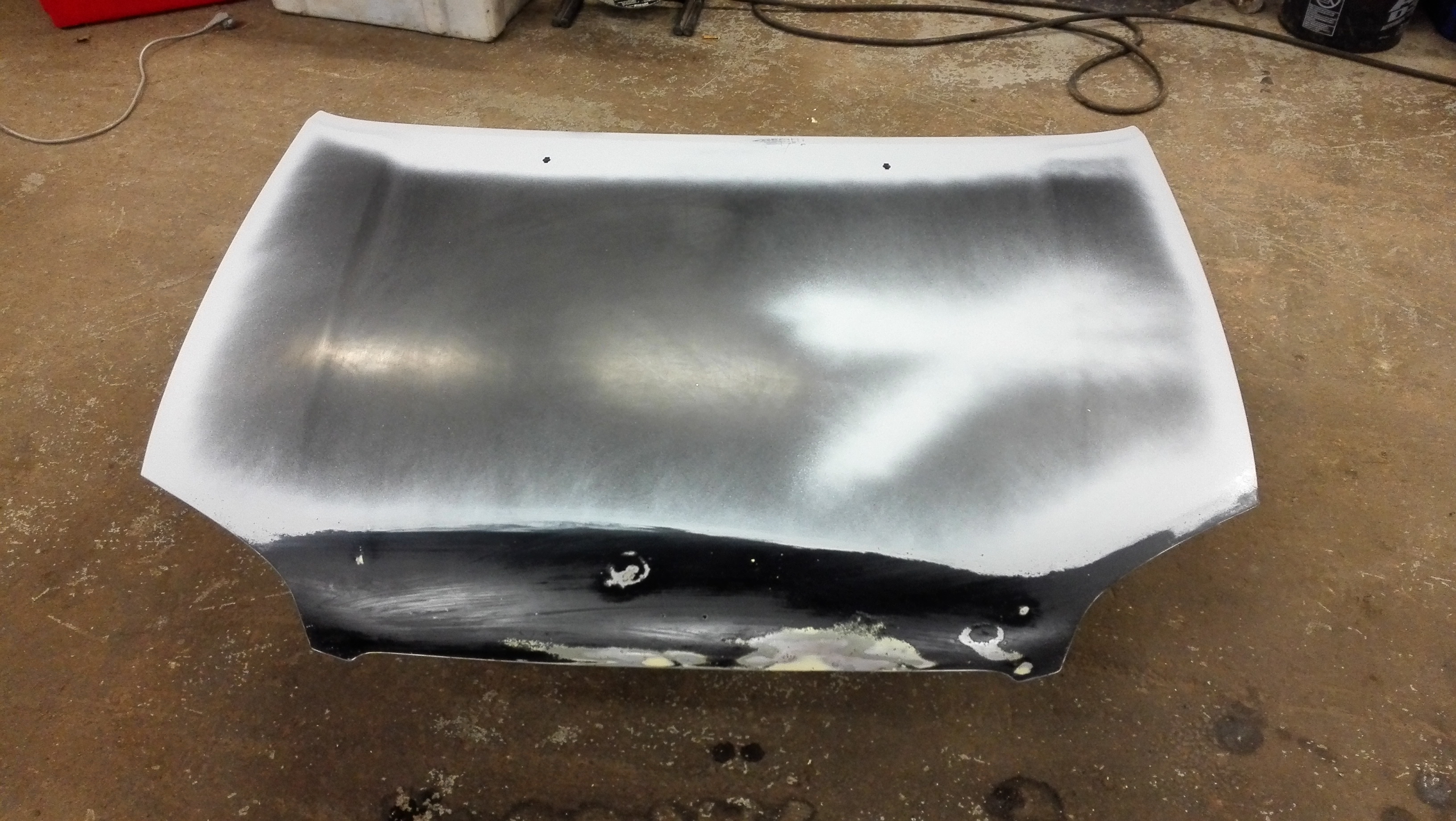

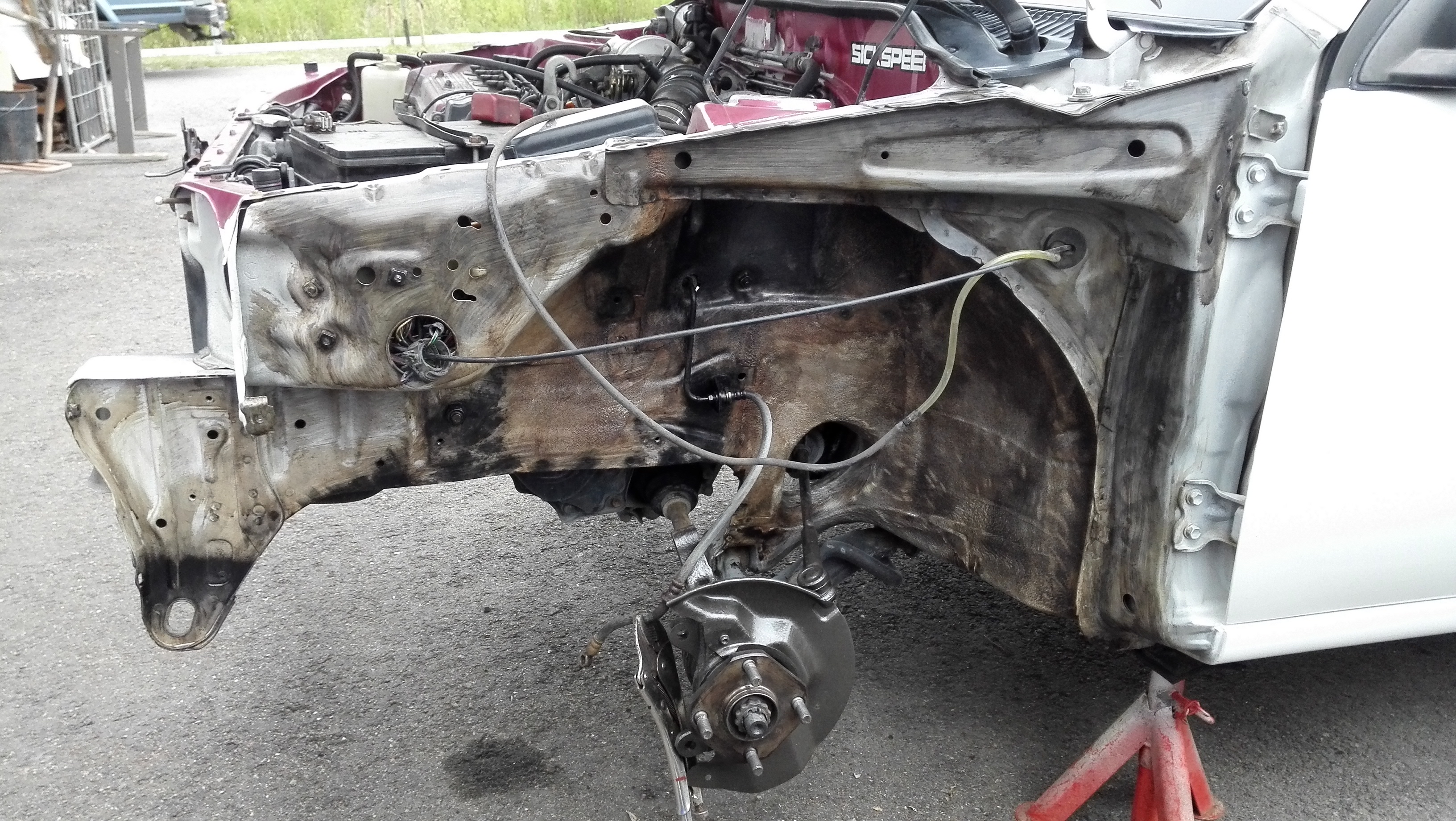

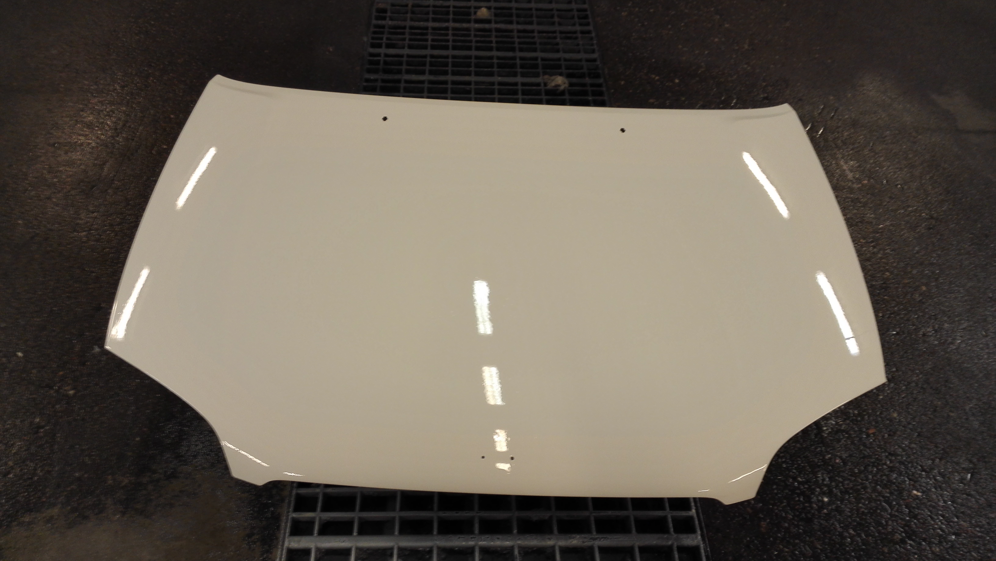

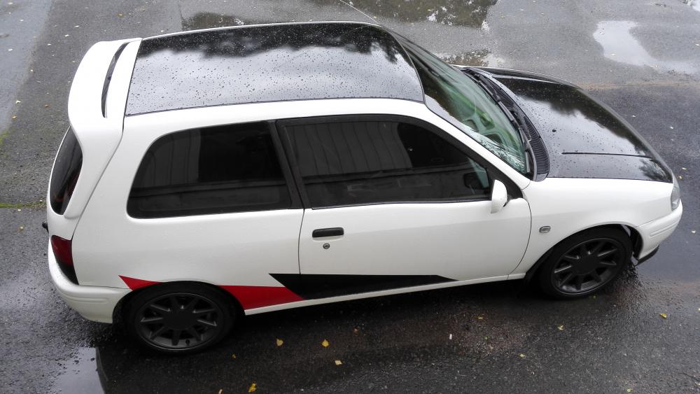

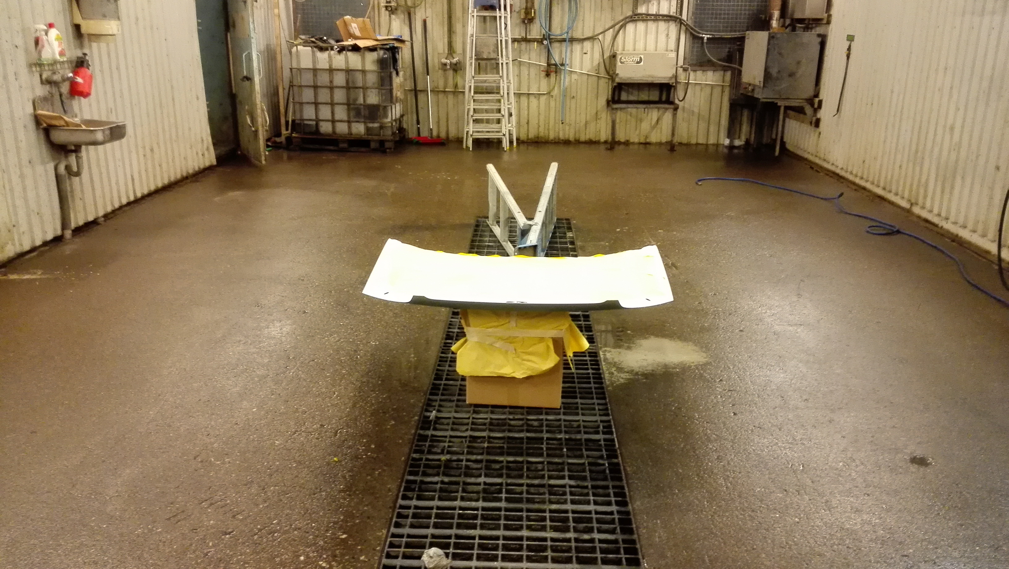

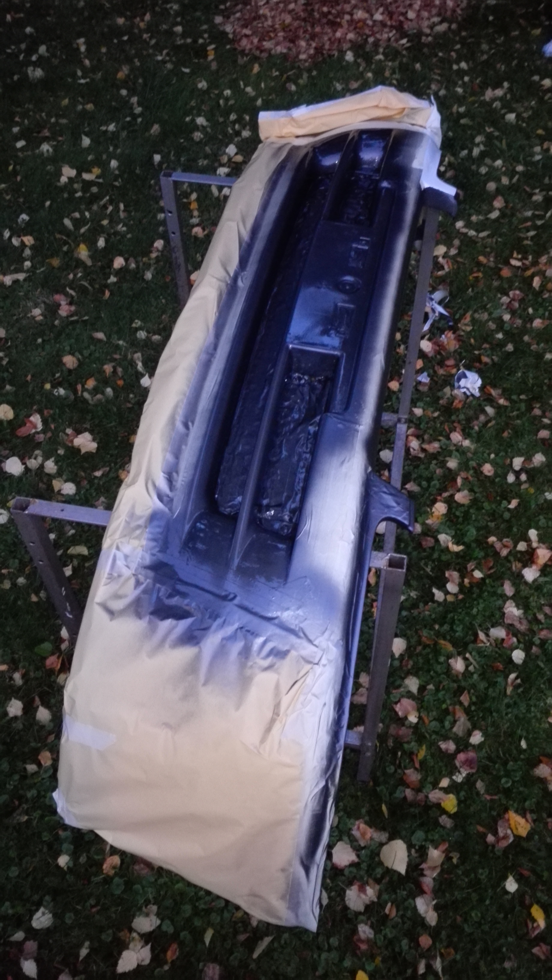

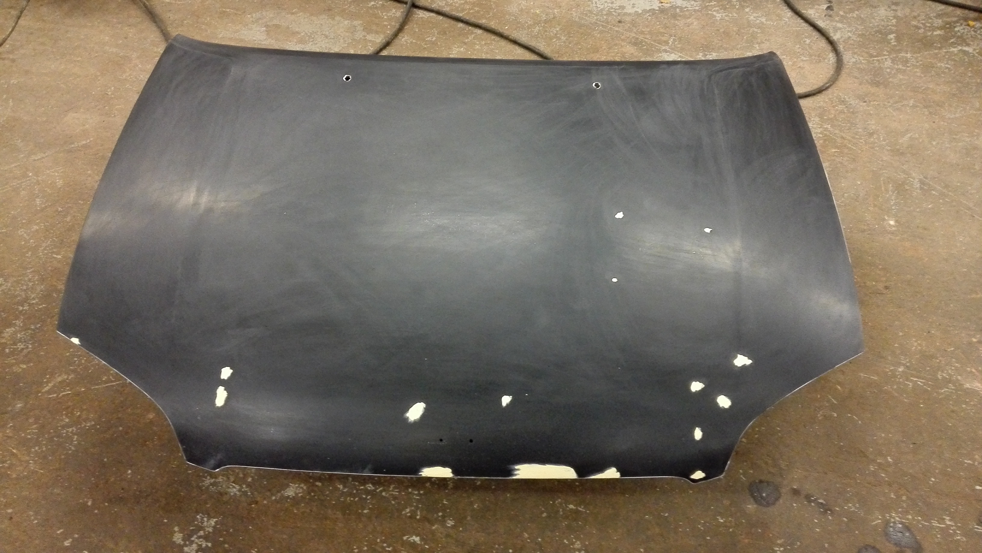

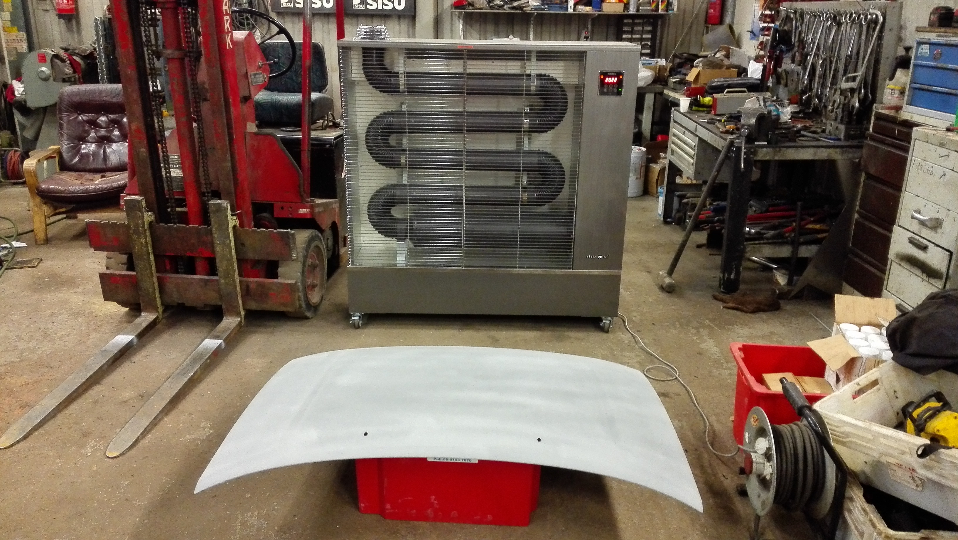

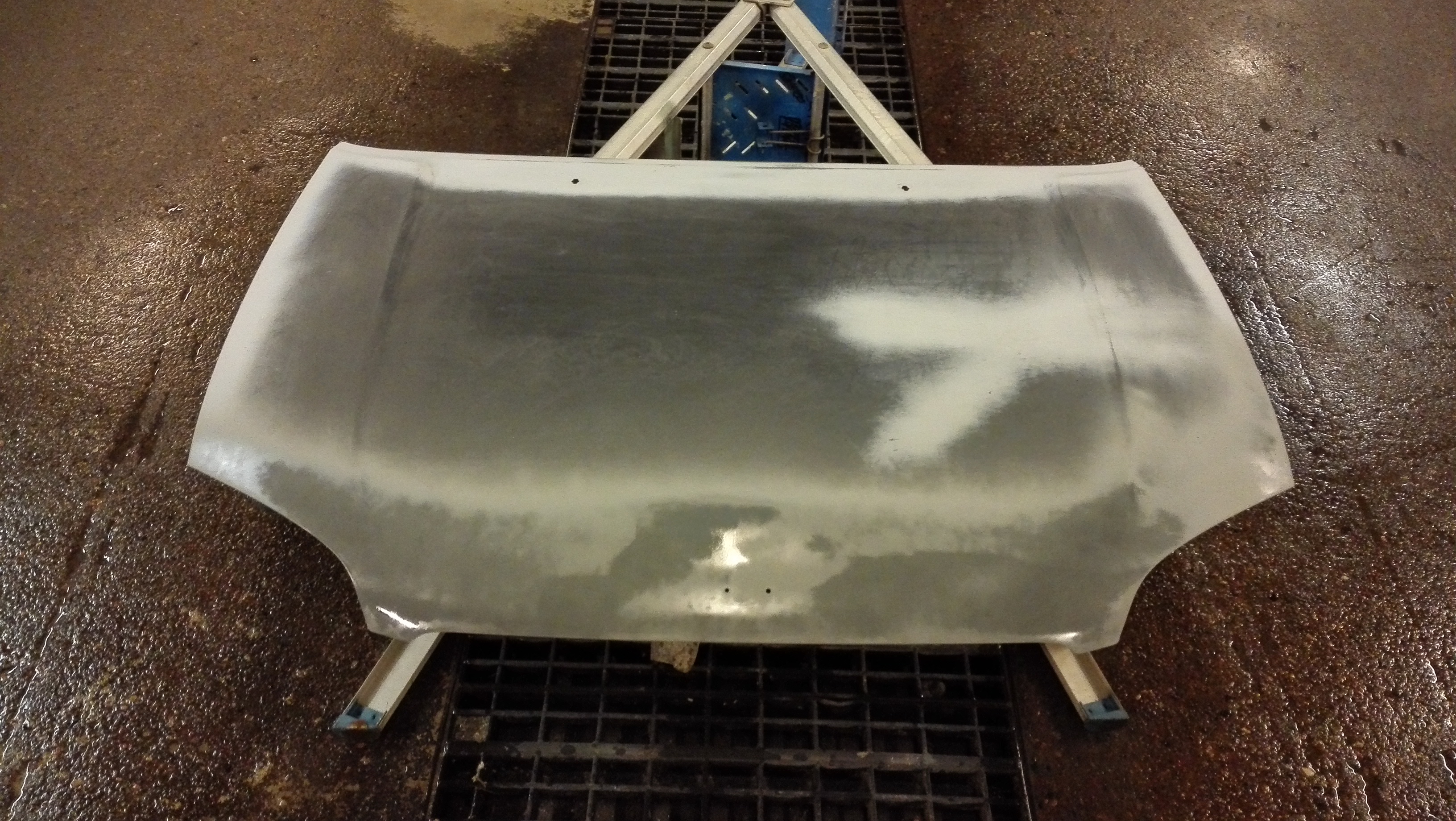

MR-2 Posted November 9, 2017 Author Posted November 9, 2017 It was time to get rid off that stupid black hood, whic was painted by earlier owner. Found little rust under paint and few spots inside also. Sanded it first and sprayed acid primer, result was boiling, then my 1K primer was dryed in the can and had to paint prime it with some shit zink primer. I was little hurry doing this in the work at night time and no other paints available at that moment. Top coat was sprayed with proper 2K paint, went well after few horrible hours, much better on white color, not so teenager look :) Quote

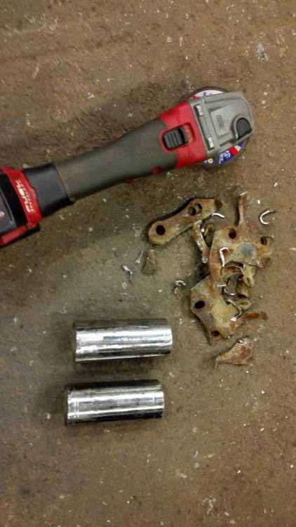

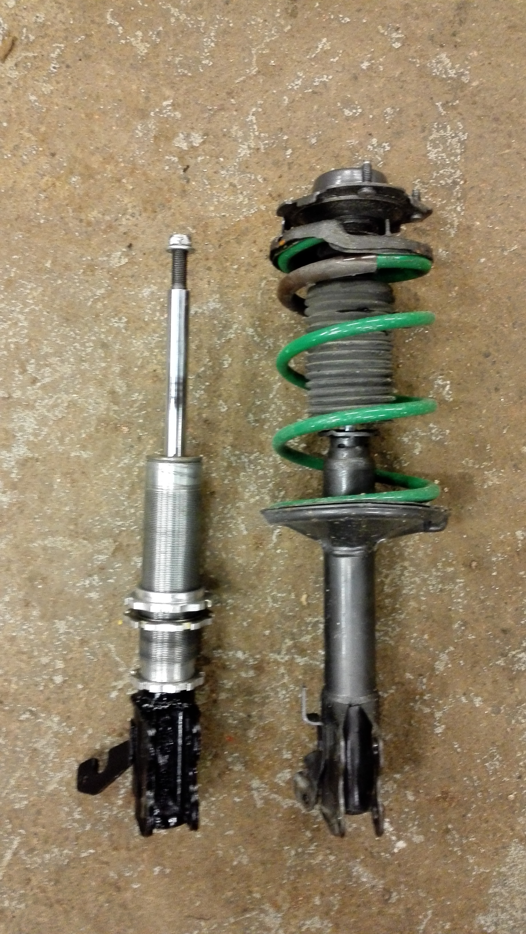

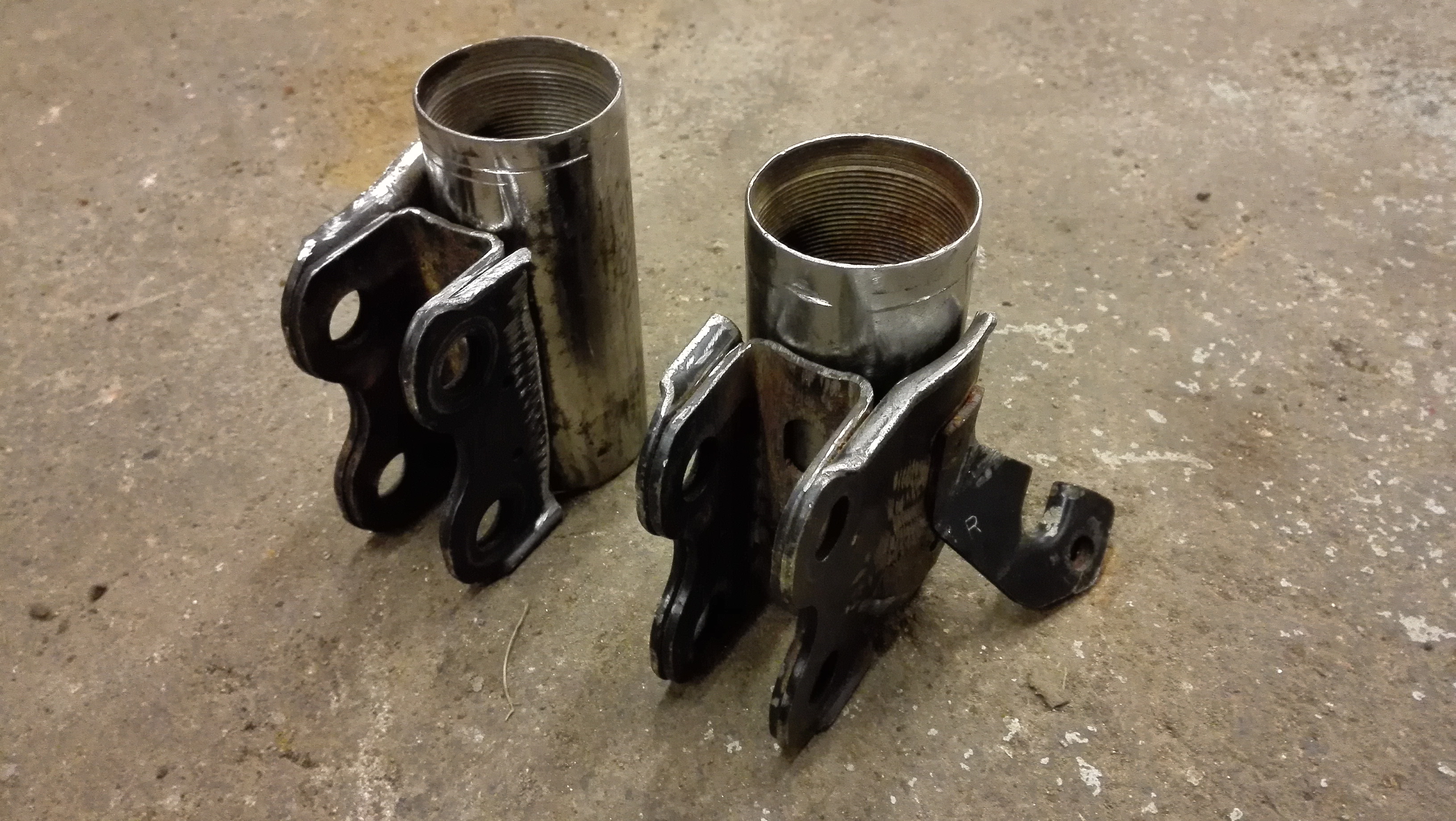

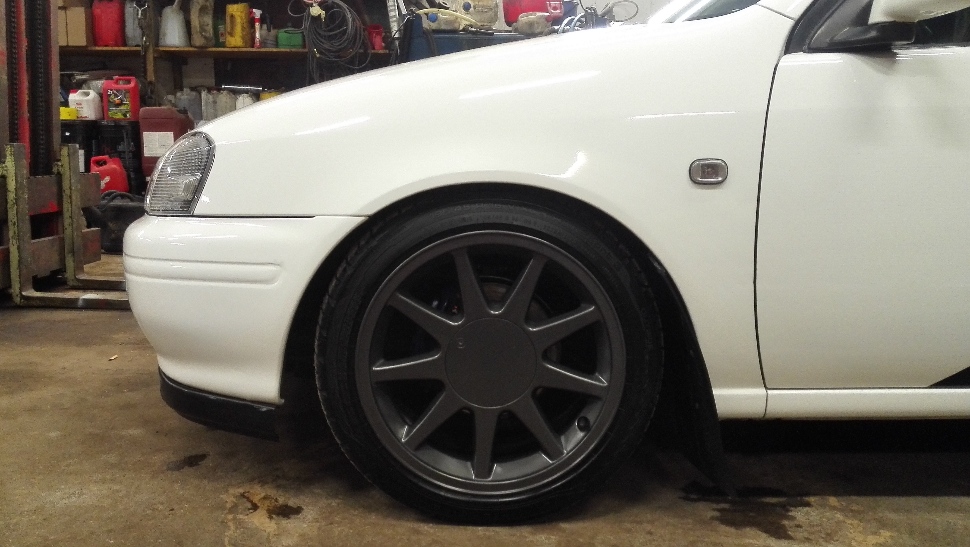

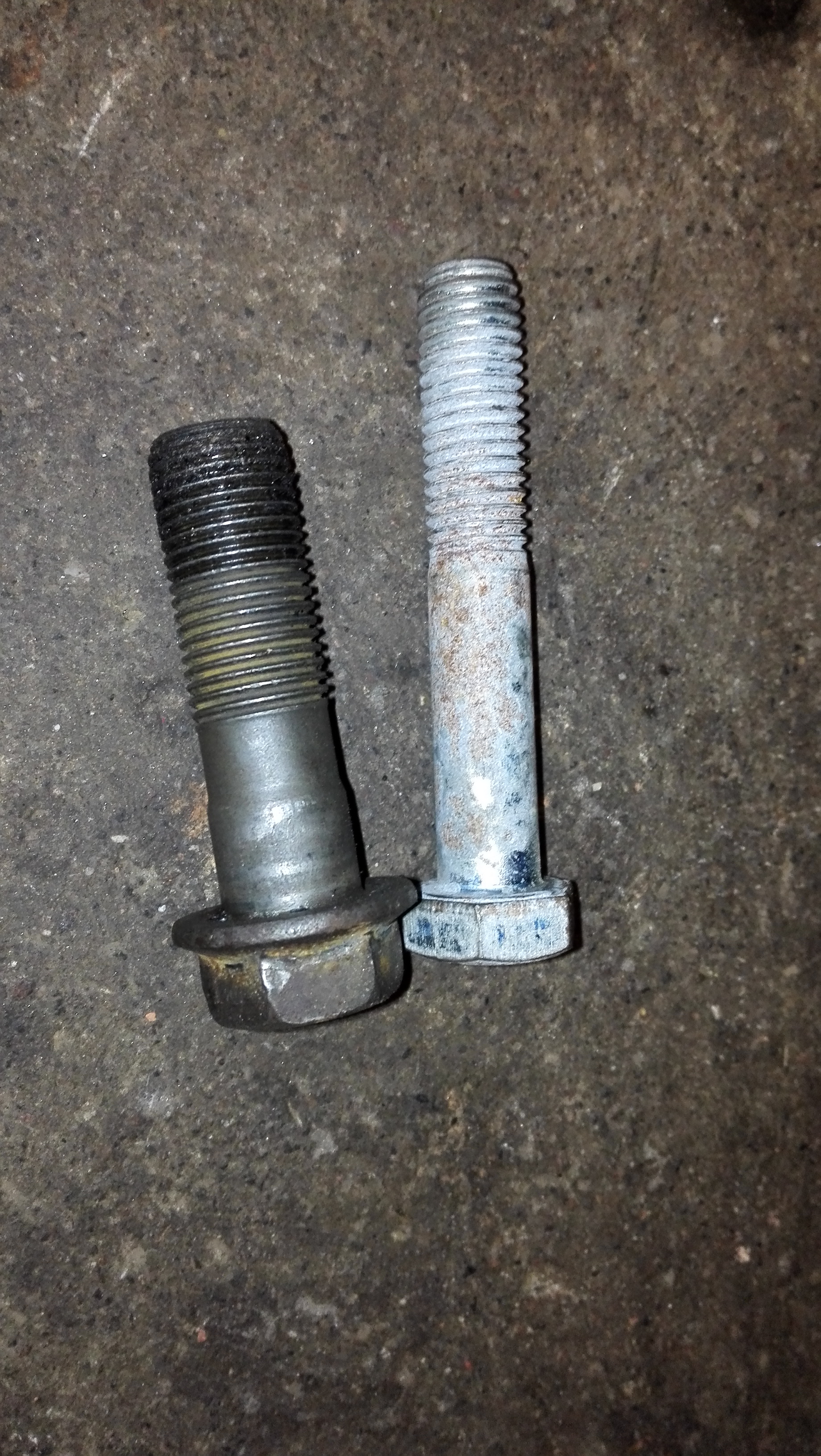

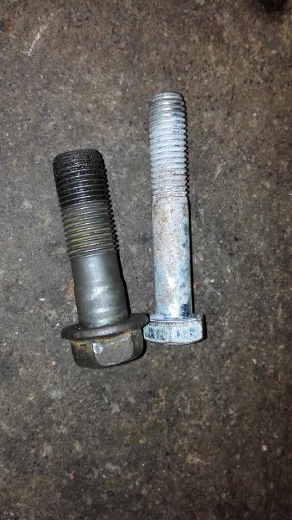

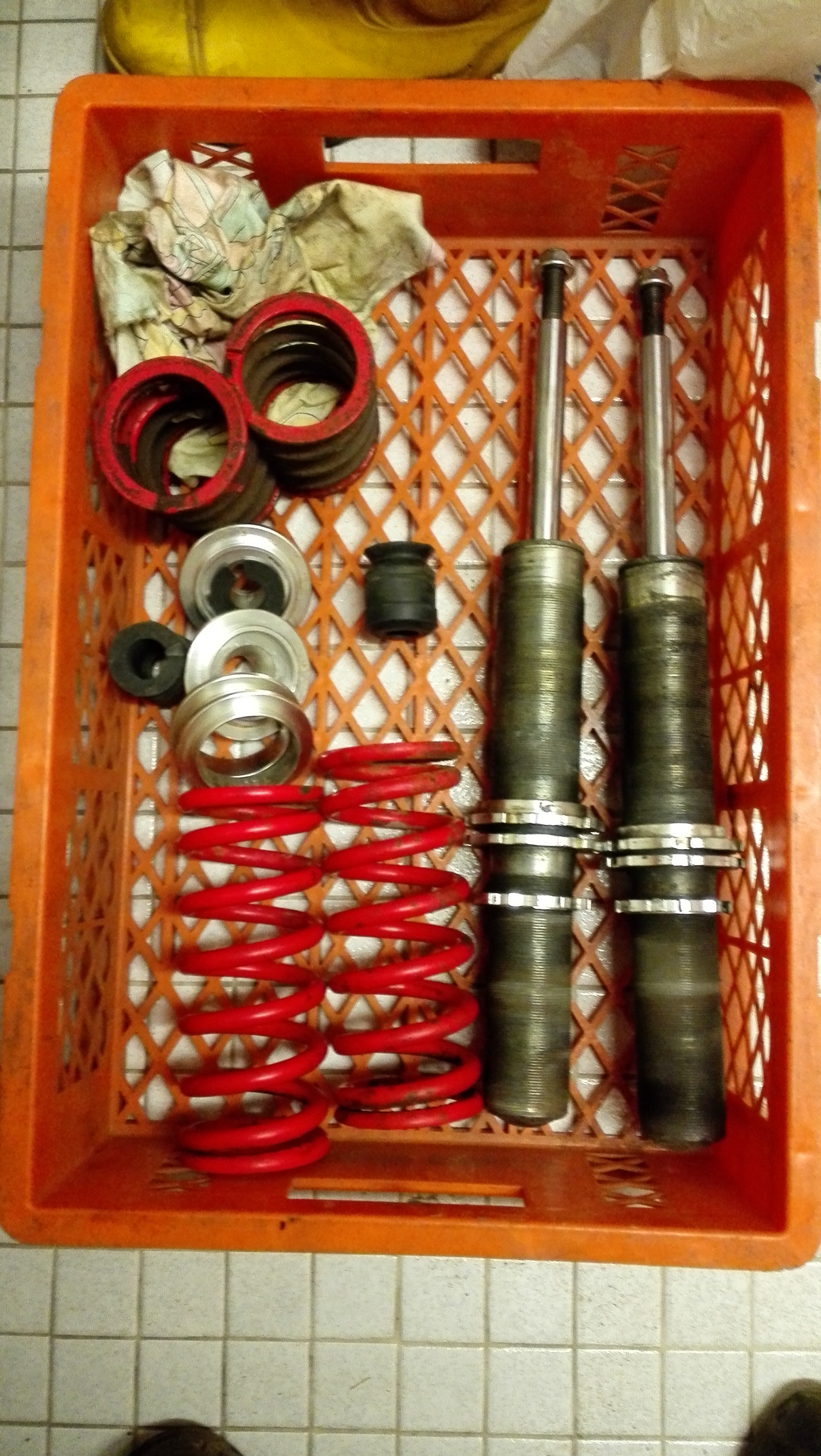

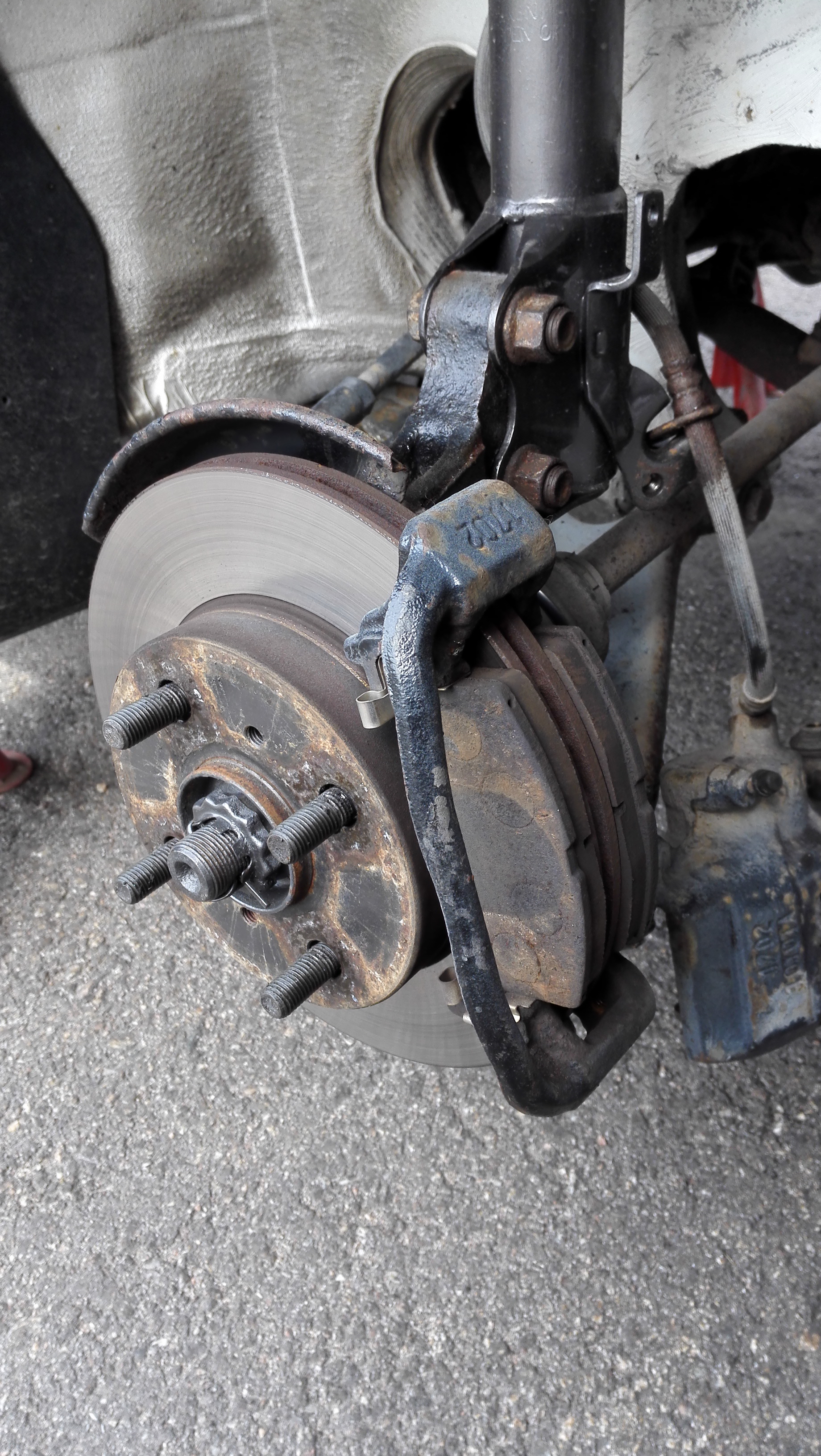

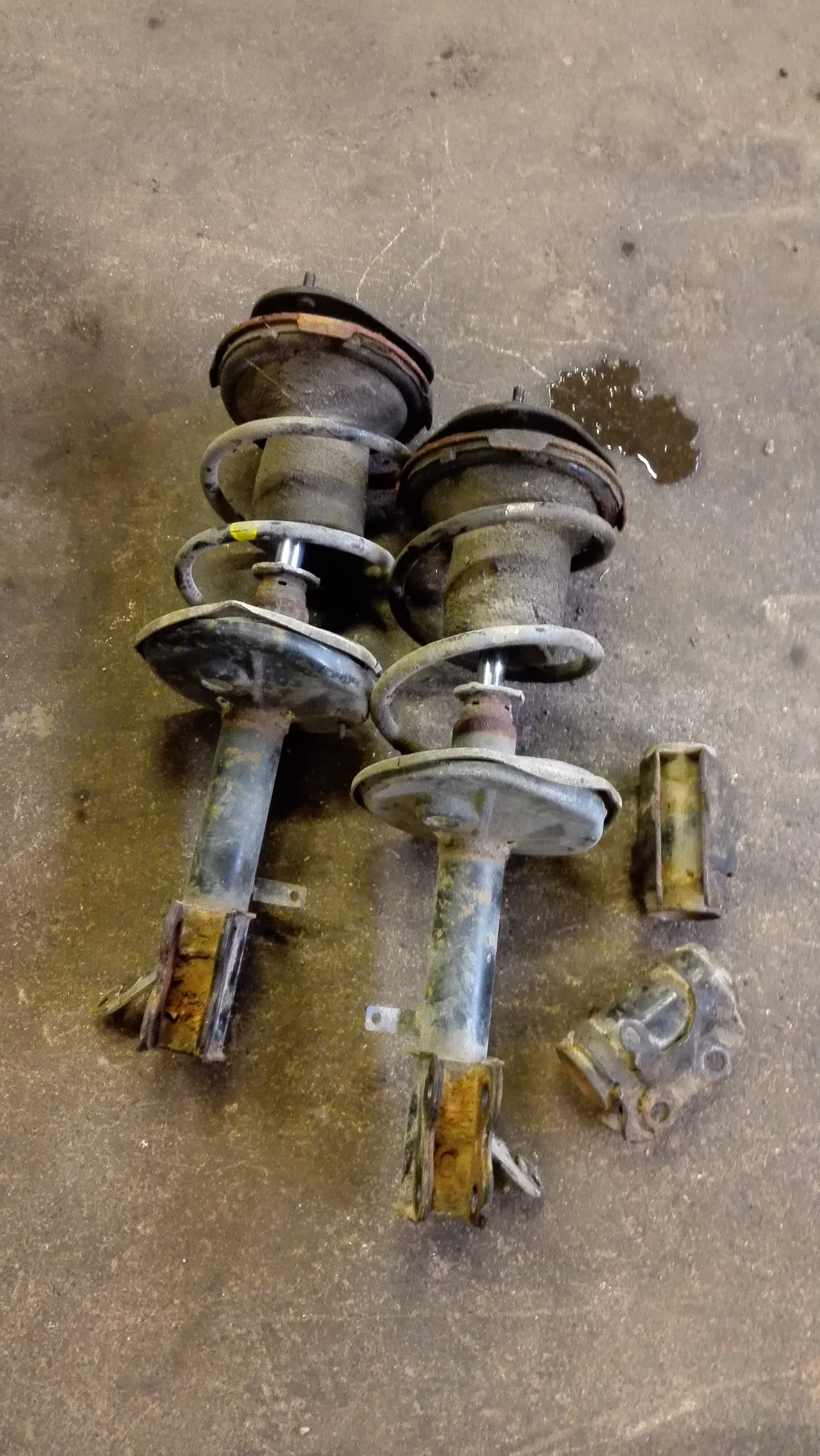

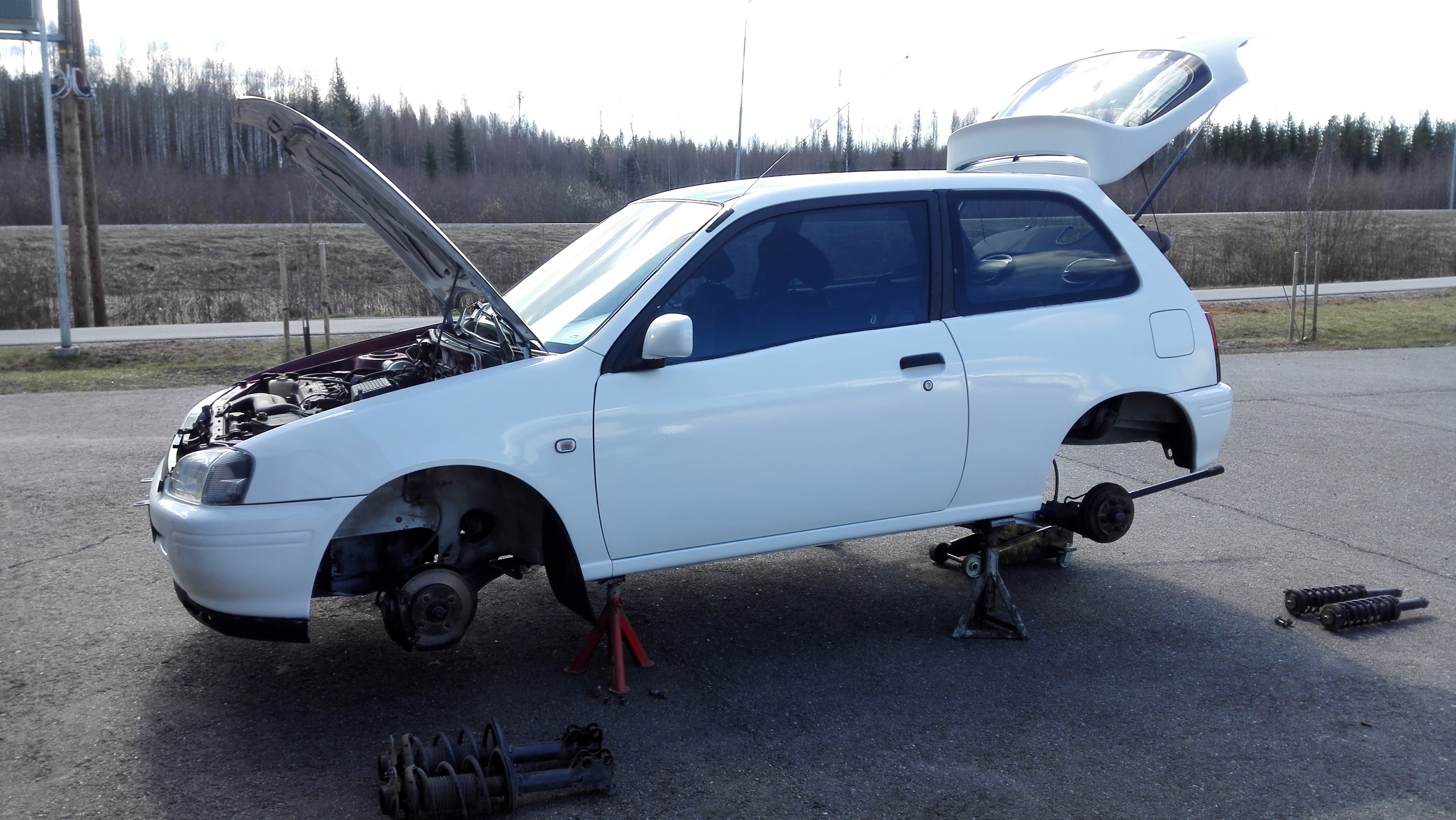

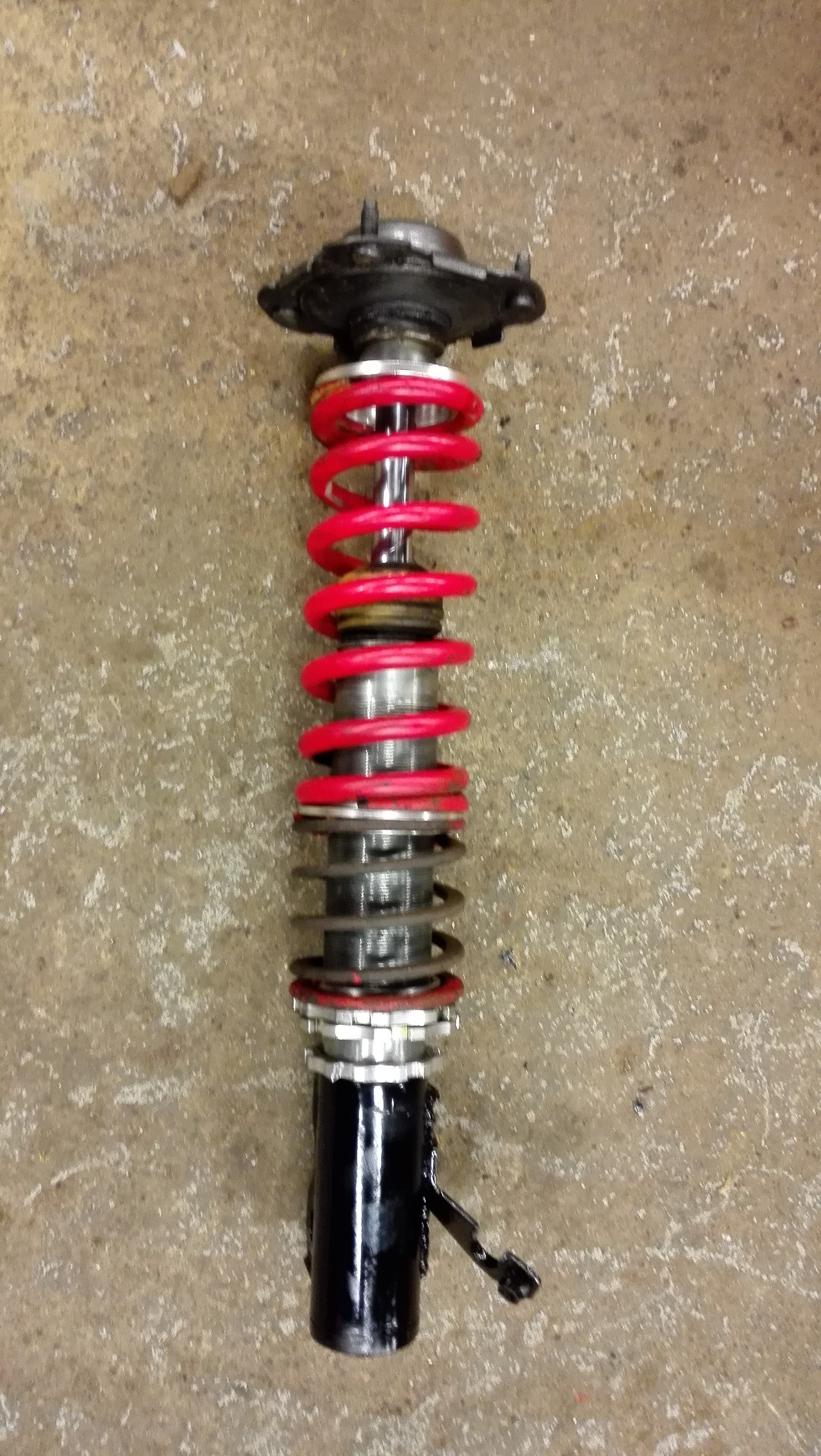

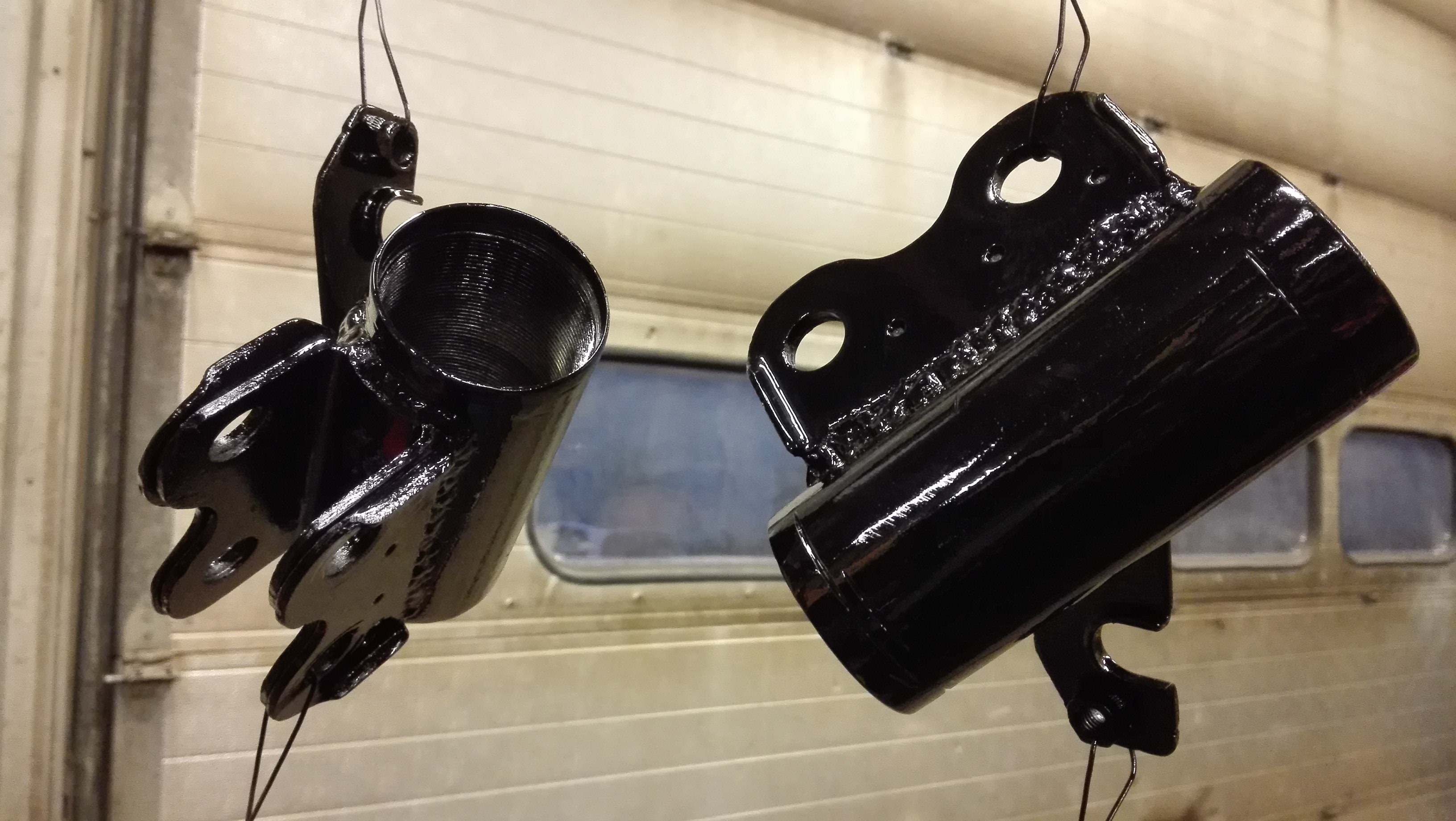

MR-2 Posted November 9, 2017 Author Posted November 9, 2017 Next project was lowering front. Got free VW coilovers and those where on my friends EP70. This adjusting wasn't my favorit and I got idea cut lower parts from AE100 Corolla. After little cut and paste I had lower set with Starlet uppermounts. Also that night had little bit hurry and had to use smaller diameter bolts, distance wasn't same in Corolla, have to tune it later more. No front is very good to drive and won't hit anywhere with et35 7,5" 195/45R16 tyres. Can go lower also, but this is my daily and winter is coming, so I keep it that level. Rear still have Kyb shocks and Tein lowering springs, it is okay level for me and rear must be softer anyway to get all availble grip. Winter time also started in Finland, have to use 14" old winter tyres again, car looks maybe lower with those... Quote
