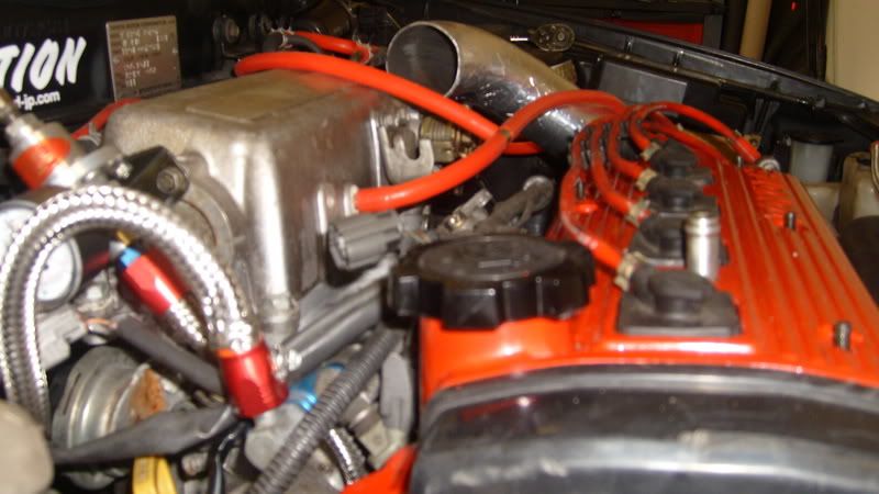

StarletRick Posted March 31, 2008 Posted March 31, 2008 martin, riko was referring to liams post. the stock ex manifold is restricted, not the inlet. as dub said, the stock one can cope with alot of power before it gets restrictive. you can fit the acis manifolds, but they are such a pig to get working right. heres a pic of mine. it shifts the position of the throttle body to the right, so you have to get a new throttle cable, and you have to get soem new intercooler pipes made up for it to work (you can see in the second pic how out it is....)then you have to fanny about with the acis actuator to get that working. and you have to drill and tap a bung for the air temp sensor as it doesnt have one.. its aggro. but it give a good hike in torque. Quote
