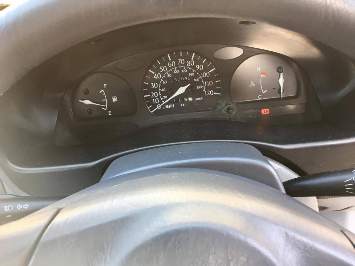

Starlet__SR Posted March 26, 2017 Posted March 26, 2017 Anyone know why the temp gauge has gone like so? Only thing thats changed is a corolla inlet manifold fitted. Everything reconnected and working fine, speedo and fuel gauge working but not the temp gauge. Faulty sensor perhaps? Probably something silly. Car is a 98 UK spec N/A. Thanks Quote
5e colin Posted March 26, 2017 Posted March 26, 2017 The plug wiggled loose probly or sensor dead Quote
Starlet__SR Posted March 26, 2017 Author Posted March 26, 2017 The plug wiggled loose probly or sensor deadSurely this would just leave the gauge at cold? Not cause the needle to drop like so? Just seems odd that's all. Quote
akyakapotter Posted March 26, 2017 Posted March 26, 2017 Earth problem? You've not left one off when you put the corolla mani on have you? Cheers nick. Quote
Starlet__SR Posted March 26, 2017 Author Posted March 26, 2017 Earth problem? You've not left one off when you put the corolla mani on have you? Cheers nick.Checked round and everything bolted back up correctly. Gonna have another look tomorrow just to be safe lol 😂 Quote
J0n4th4n0 Posted June 10, 2017 Posted June 10, 2017 Ooooooo ooo I know this🙂 On the back of inlet mani there's a ground for your sensors I thought I was gunna get a prasial swap a breakers for a rolls mani the other day and pulled the mani off scrubbed it up a bit turned out they were wankers sucked no rolla tubular mani for me. Anyways in putting it back on in less than ideal conditions (drizzling) but I needed it to drive I didn't reground basically I was in a rush because the engine bay was getting wet.Turns out it broke my coolant temp sensor both of them green one and gray one under the dizzyBest of luck Joe Quote
Starlet__SR Posted June 10, 2017 Author Posted June 10, 2017 Thanks for the heads up Joe. Turns out the sensor had died sending the dial all the way round lol. Wasnt cheap to buy from toyota though lol. Quote
