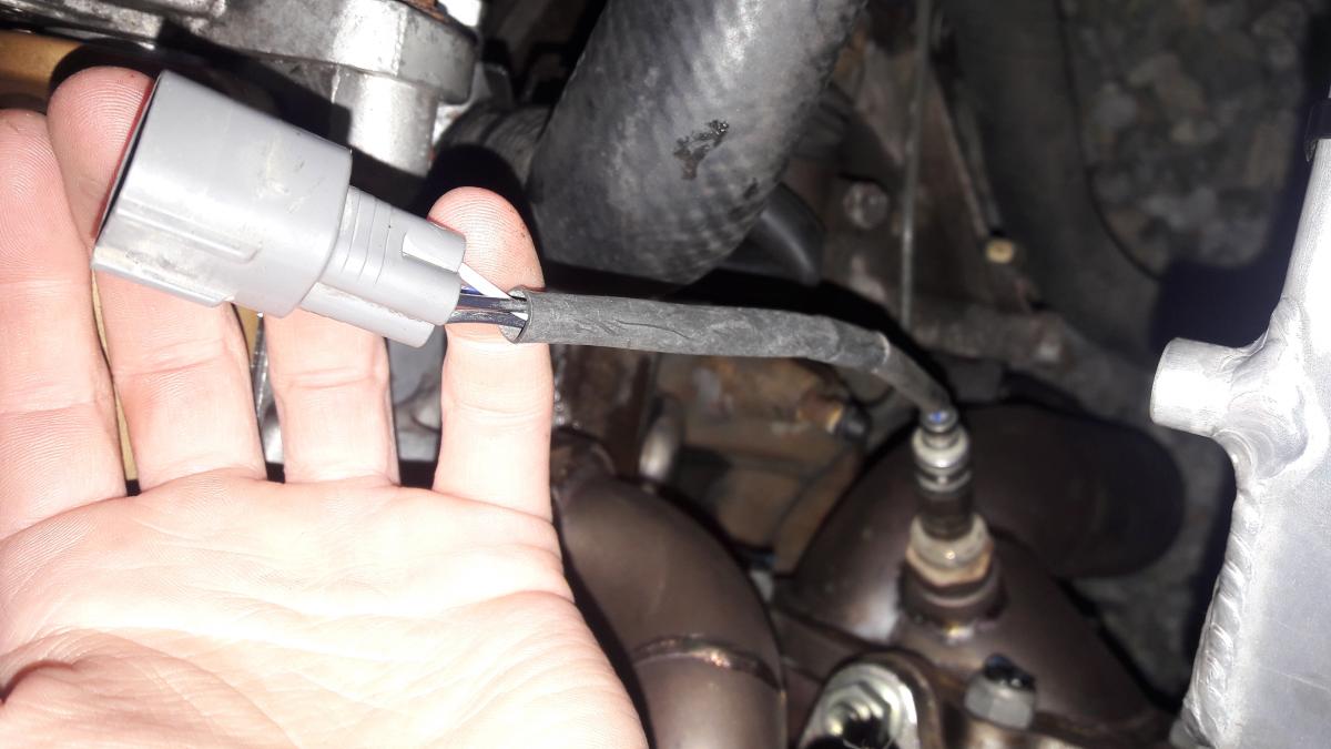

Im having trouble with 2 plugs.. the oil pressure sensor and lambda. Ive used the lambda off my n/a as id imagine theyre the same but cant find a plug.. also i think ive located the plug for the pil pressure sensor but it doesnt nearly reach it. Is it the right one ?

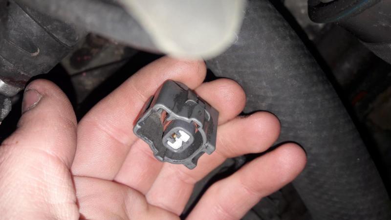

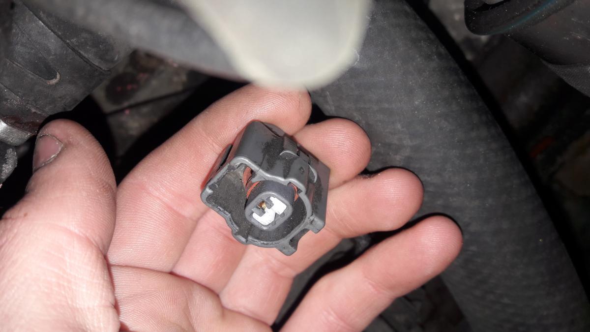

Is this the oil pressure sensor plug ?

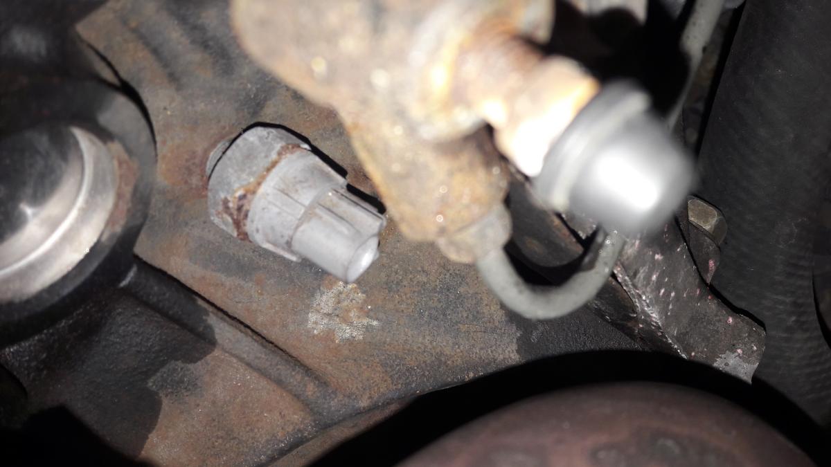

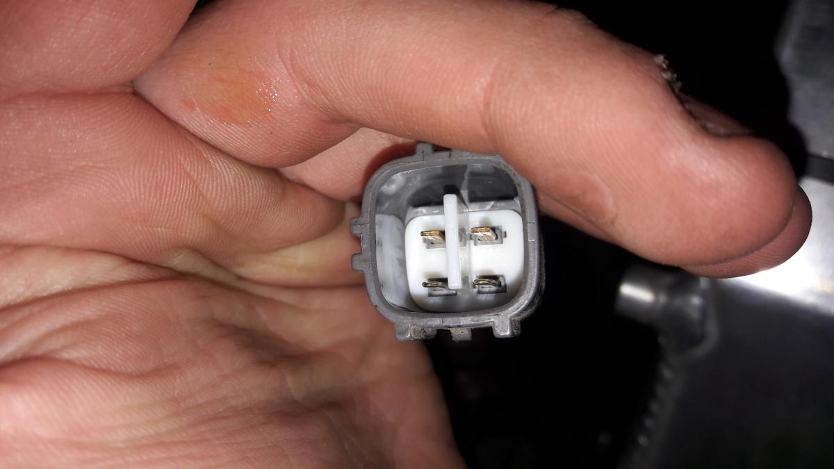

Also the plug for the lambda seems non existant ? If theyre even the same as the n/a ?

Different lambda sensor on na's , Glanza ones are 1 pin connectors 👍🏼 , the plugs for it will be on top of the gearbox near the thermostat housing
The 1st plug is a 1 wire plug looks yellow.
My lambda has 4 wires
Okay cool thanks mate. The 1st plug has 1 wire on it will that be it ? Looks yellow
Right for the oil pressure switch , this is the connector and what the sensor looks like 👍🏼441526CC-2FBB-4B97-A2B7-0FA80D6A2CB7.png0855A441-22BC-4EAA-8F00-887FF3247EA5.png
Okay so again the n/a oil pres. Sensor is different. Have on of the glanza ones on my 4efte block which ill get.
Would you happen to know either the colour of the wire for it or what part of the loom it comes off ? Didnt see a plug like that on my loom except the single pin plug for a sensor on the thermostat housing that seemed very long for where it was going
