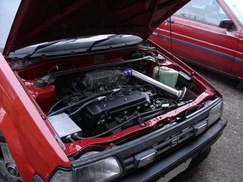

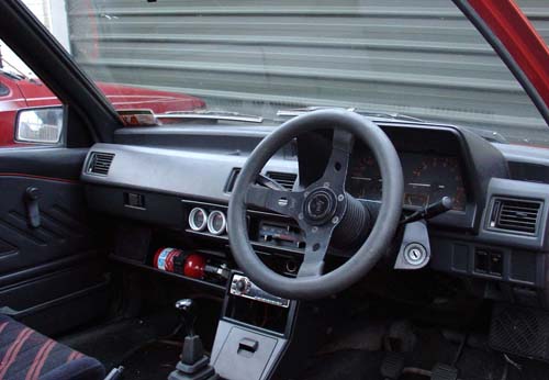

Stu Posted August 21, 2017 Posted August 21, 2017 Cool project! Makes me want to build another 5e EP71 (Ive build quite a few over the years). Quote
Teun Posted August 24, 2017 Author Posted August 24, 2017 Cool project! Makes me want to build another 5e EP71 (Ive build quite a few over the years). Sweet! Nice interior of the car. What did you use to make the intake and were did u place the wasserfluid tank? Quote
Teun Posted August 24, 2017 Author Posted August 24, 2017 Update time (with pictures:) At this moment i'm still waiting for parts for the engine like the timing belt and seals. I expect to receive them tomorrow so i can refresh the engine. In the meanwhile i did some things. Fitted the radiator fan of the paseo to the radiator of the starlet so i can get better cooling and have a cleaner bay (with the tank on the fan itself). Made the Paseo fuelpump fit in the Starlet tank. Before: After: Glued a extra part on the seal to help seal under the part that is higher then the rest (excuse my horrible English in this sentence). Here you can see the pick up on the right spot in the tank. I then moved to the fuel lines. As i said before i was not sure if i could use the line of the Paseo. It ended up breaking so i used the line of the Starlet. I cutted the one of the Paseo and made it fit to the existing line of the Starlet. For the other end i used a fuel hose of a Kia Sportage Festival (1999 or something like that). I was able to use this hose to convert the excisting line to a AN fitting that would fit a filter that would fit the fuel hose to the fuel rail. Like this: To make the filter fit i changed some clamps for the brakelines. Worked out perfectly! After that i soldered the Paseo ignition switch to the Starlet switch. All done. For those interested, i made this for the connector of the Paseo. A buddy of mine welded up the exhaust. I had the flange of the Starlet fitted to the Paseo exhaust. I figured out why the engine was leaking coolant. A fitting below the throttlebody broke. Here you can see the nasty coolant that leaked on the bay of the Paseo: I had some Loctite and Qbond laying around so i fixed the fitting. Before: After: Then i decided so clean the engine. I started by painting the valvecover and cleaning the bolts. Before: During: Continued by cleaning the beltcovers. Next up was the intake. Back together with the gearbox and block cleaned aswell: Fixed the bolt that was stripped by tapping new threads. A while back i bought some Polo 6n coilovers. I made them fit the Starlet by drilling a new hole and making the excisting hole bigger. Installed on the car. The coilovers are used and the collars on the front coilovers are frozen. I was able to brake the collars on one side lose. I will do my ultimate best tomorrow to break the other side loose to. Once i receive the parts i can drop the engine in! Quote
Stu Posted August 25, 2017 Posted August 25, 2017 Sweet! Nice interior of the car. What did you use to make the intake and were did u place the wasserfluid tank? Thanks! I made the intake from some 2.5inch stainless tube and the washer bottle is bolted to the strut tower just behind the fuse box. Quote
