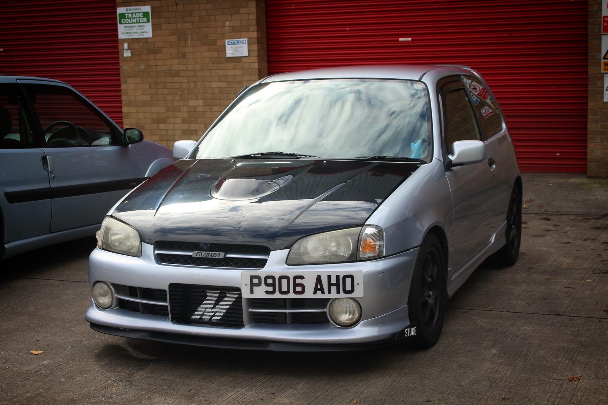

Hi, my glanza is running a stock 5E bottom end and I’m wanting to stay with the 200mm clutch for quicker revs, is this possible and is there any clutch out there that will hold?
And if any one has td04 on a stock 5E with glanza Head, what power have they had out of it ?
