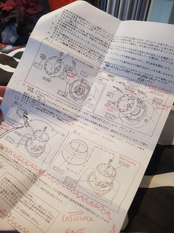

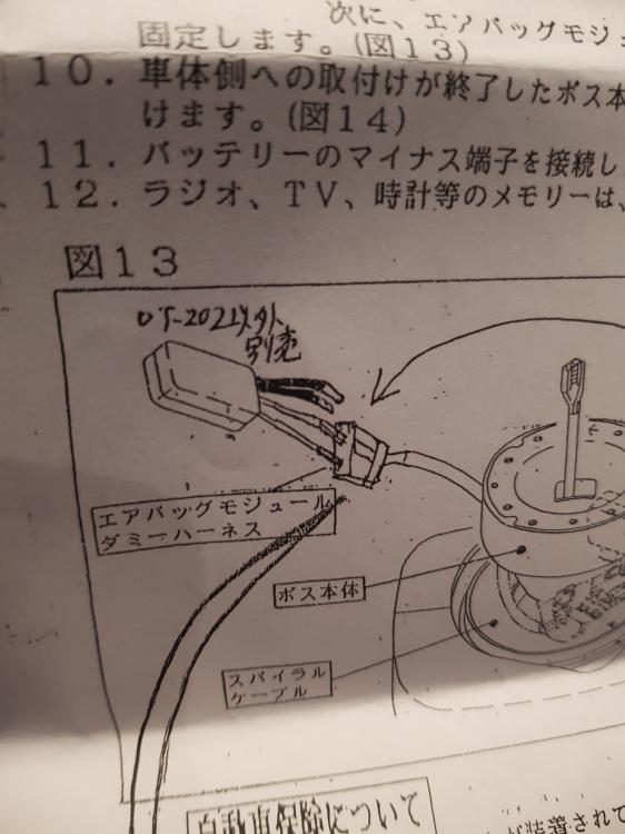

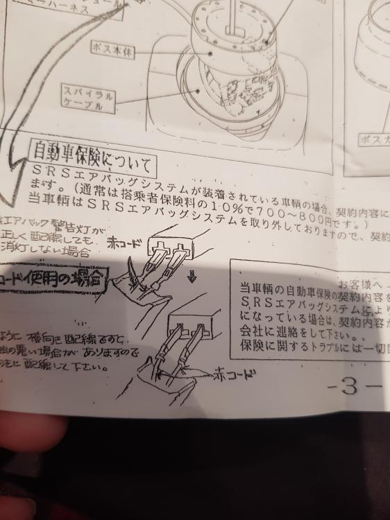

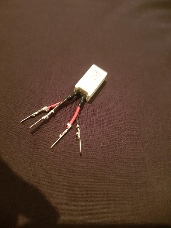

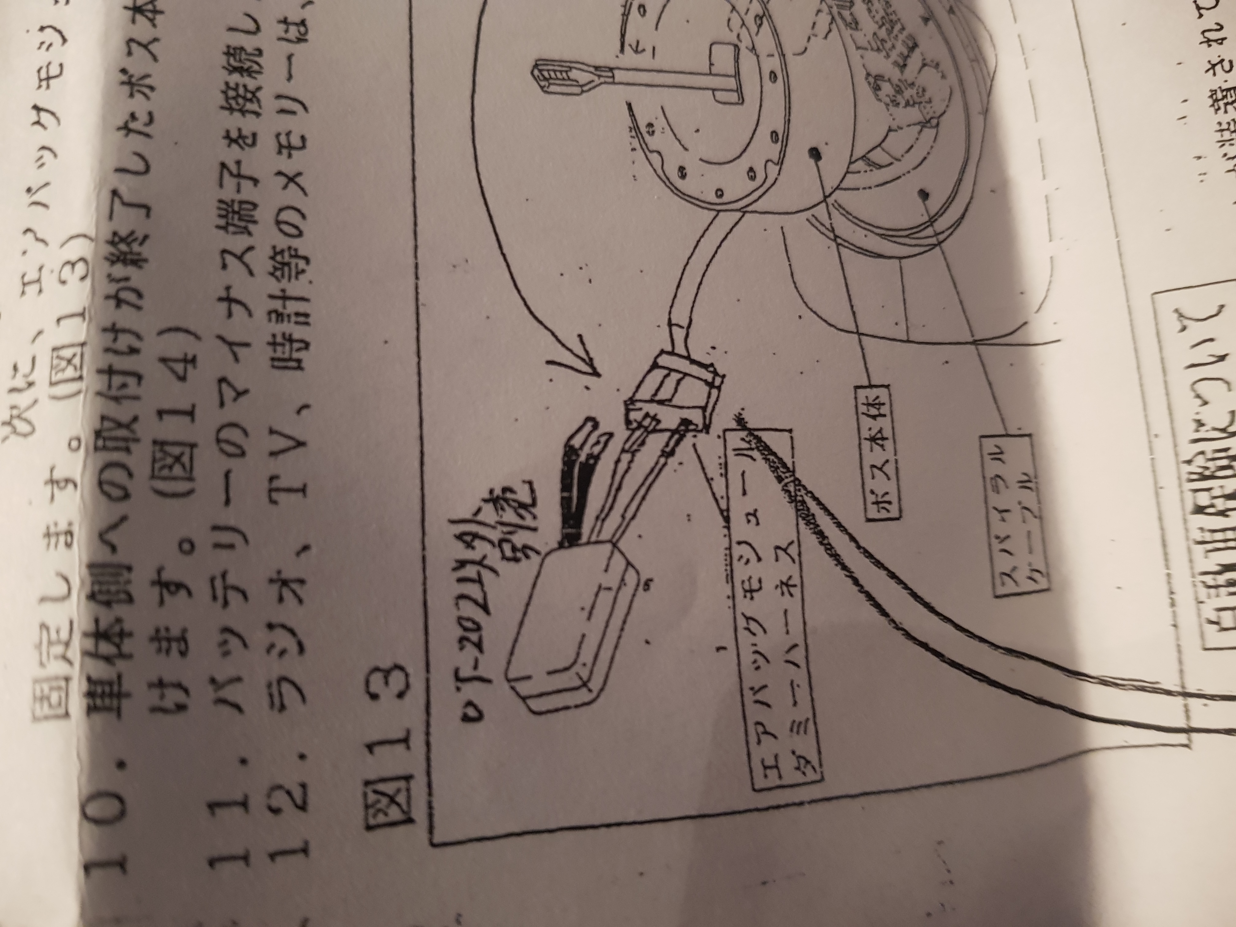

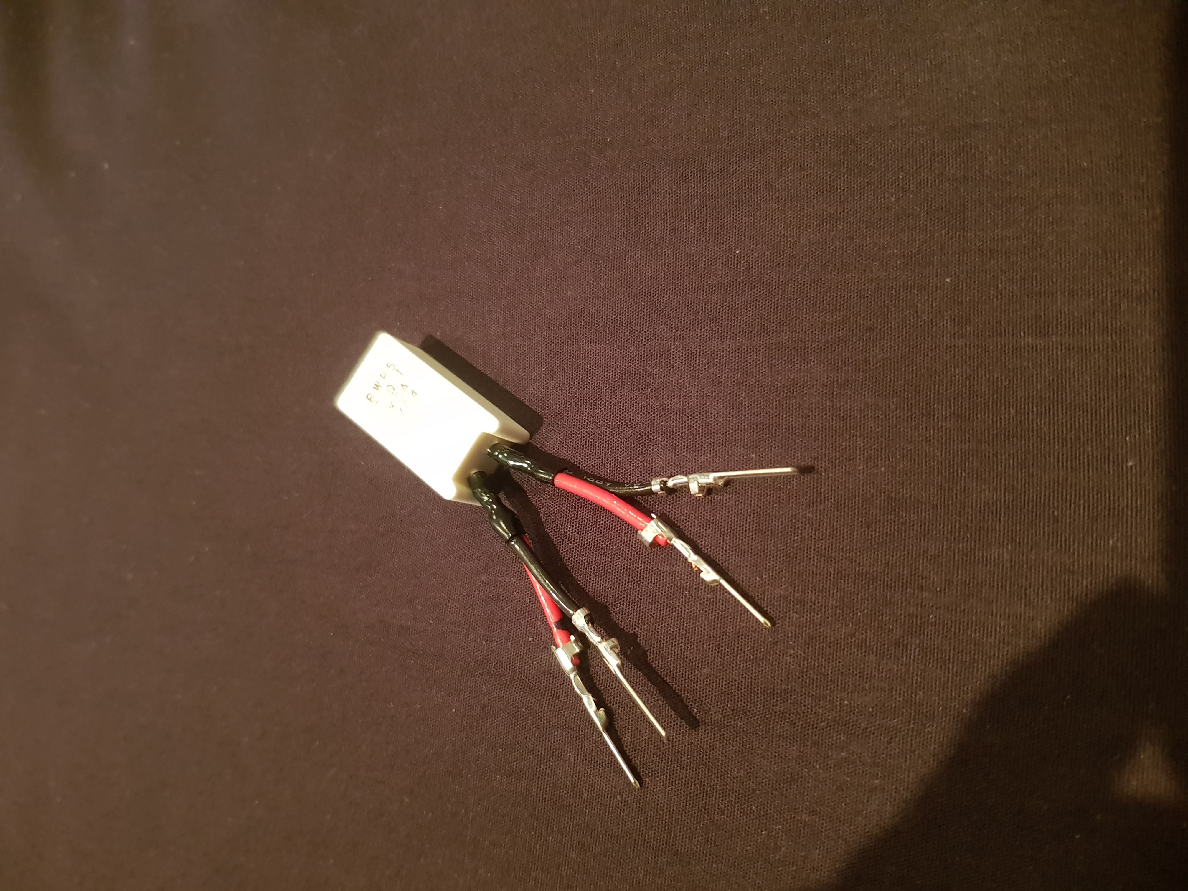

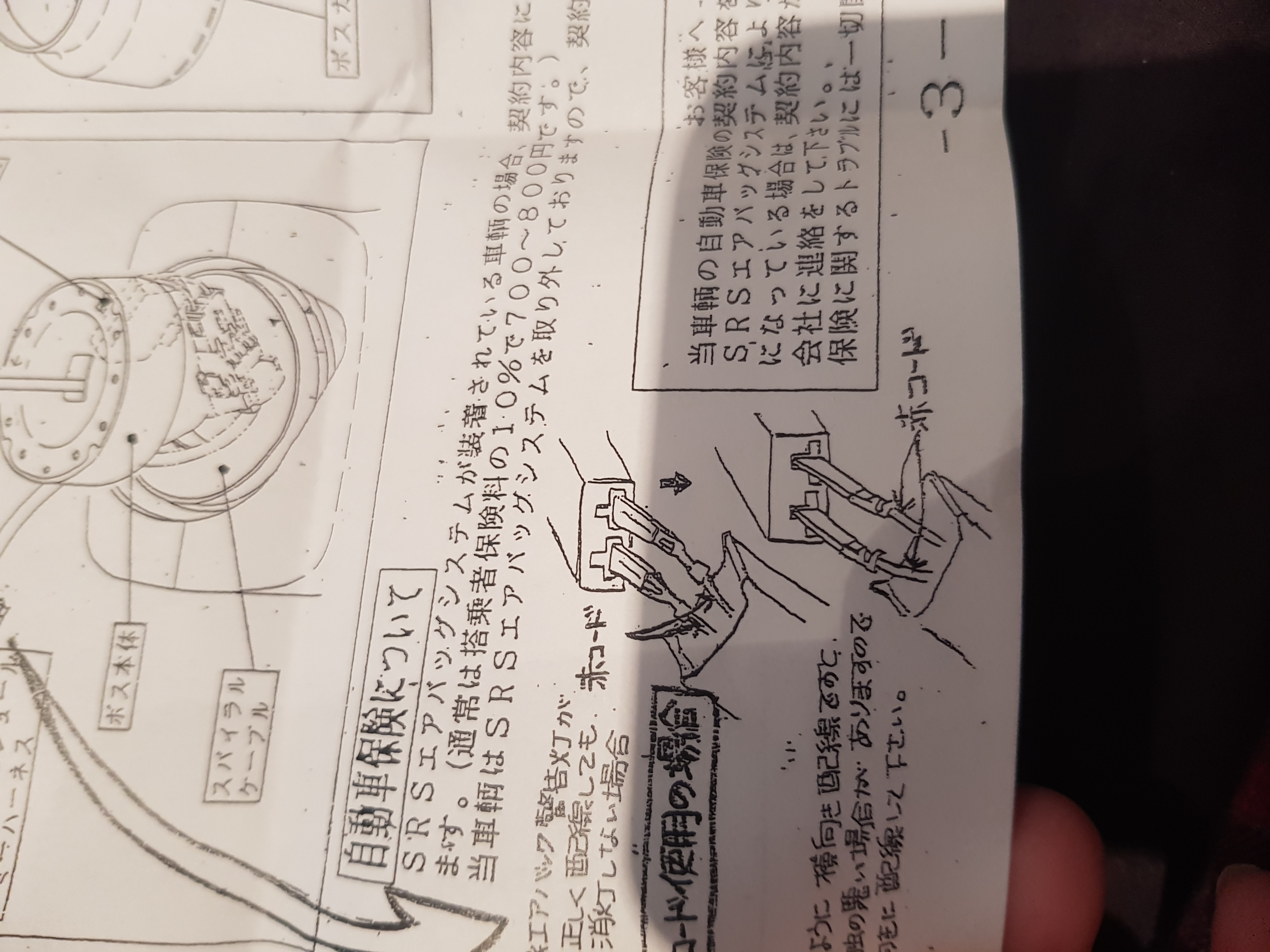

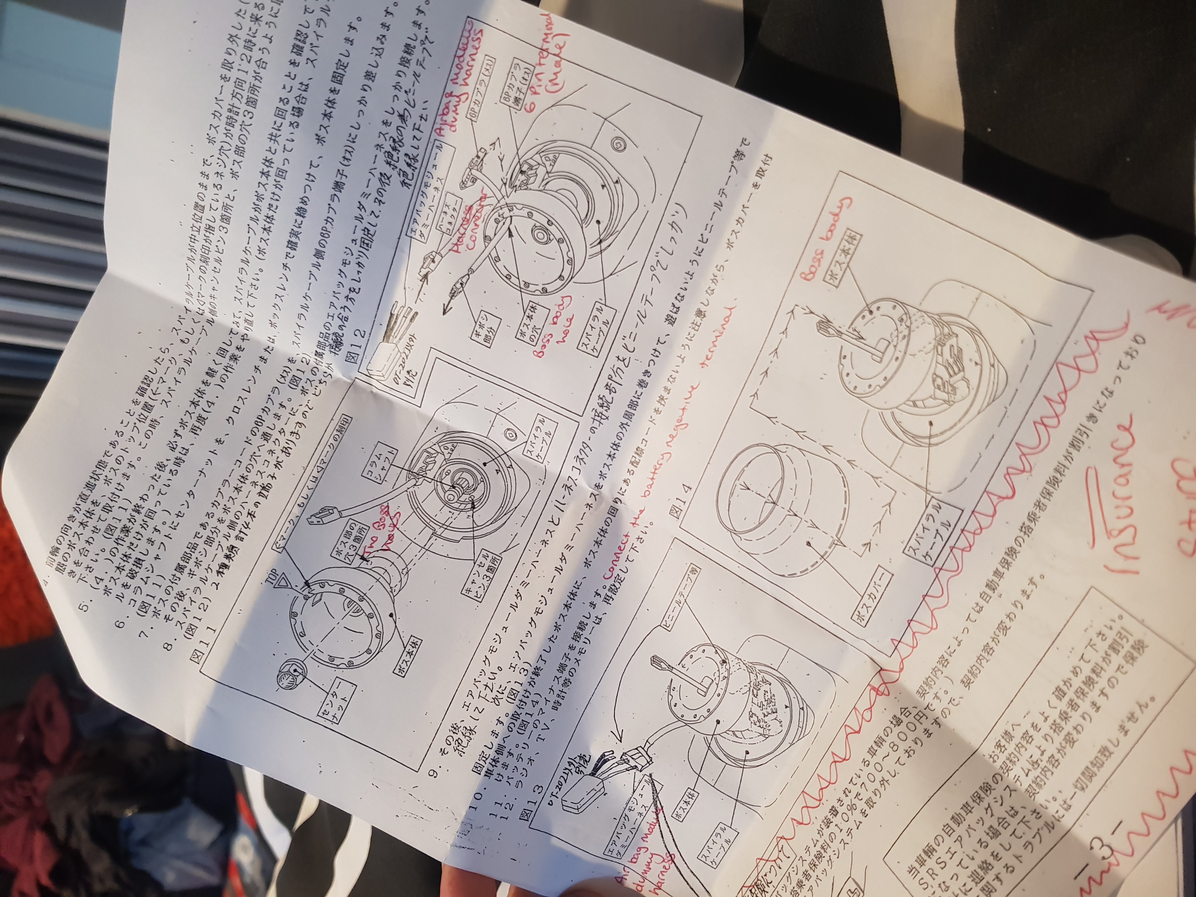

Tom Selby Posted April 30, 2018 Posted April 30, 2018 (edited) Not sure if this is the right place but, Got my hkb steering wheel boss in the post today with airbag cancelling resistor Obviously instructions are in japanese and dont understand a word of it The resistor has 2 black and 2 red wires coming from the resistor The instructions show only 2 wires plugging into the air bag connector (im guessing the 2 red wires from the drawing ?) Are the 2 black left and taped up ? Has anyone else fitted the hkb resistor boss kit and able to tell me which wires to use ? Thanks Edited April 30, 2018 by Tom Selby Quote
akyakapotter Posted April 30, 2018 Posted April 30, 2018 just plug one of the red and black in id say the other set are for passenger airbag if you have one. cheers nick. Quote
Tom Selby Posted April 30, 2018 Author Posted April 30, 2018 7 minutes ago, akyakapotter said: just plug one of the red and black in id say the other set are for passenger airbag if you have one. cheers nick. Ok thanks, i do have passenger air bag, will all wires from the resistor need plugging into the conector if possible if thats the case ? Quote
akyakapotter Posted April 30, 2018 Posted April 30, 2018 I'm not sure with your one but i put a resistor in each connector. cheers nick Quote

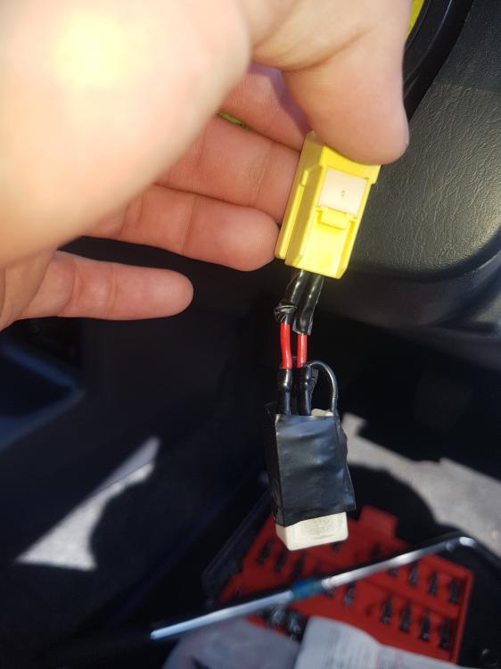

Tom Selby Posted May 5, 2018 Author Posted May 5, 2018 Just put the boss and steering wheel on Its the 2 red wires on the resistor you need to use for this kit if anyone needs to know for future Quote

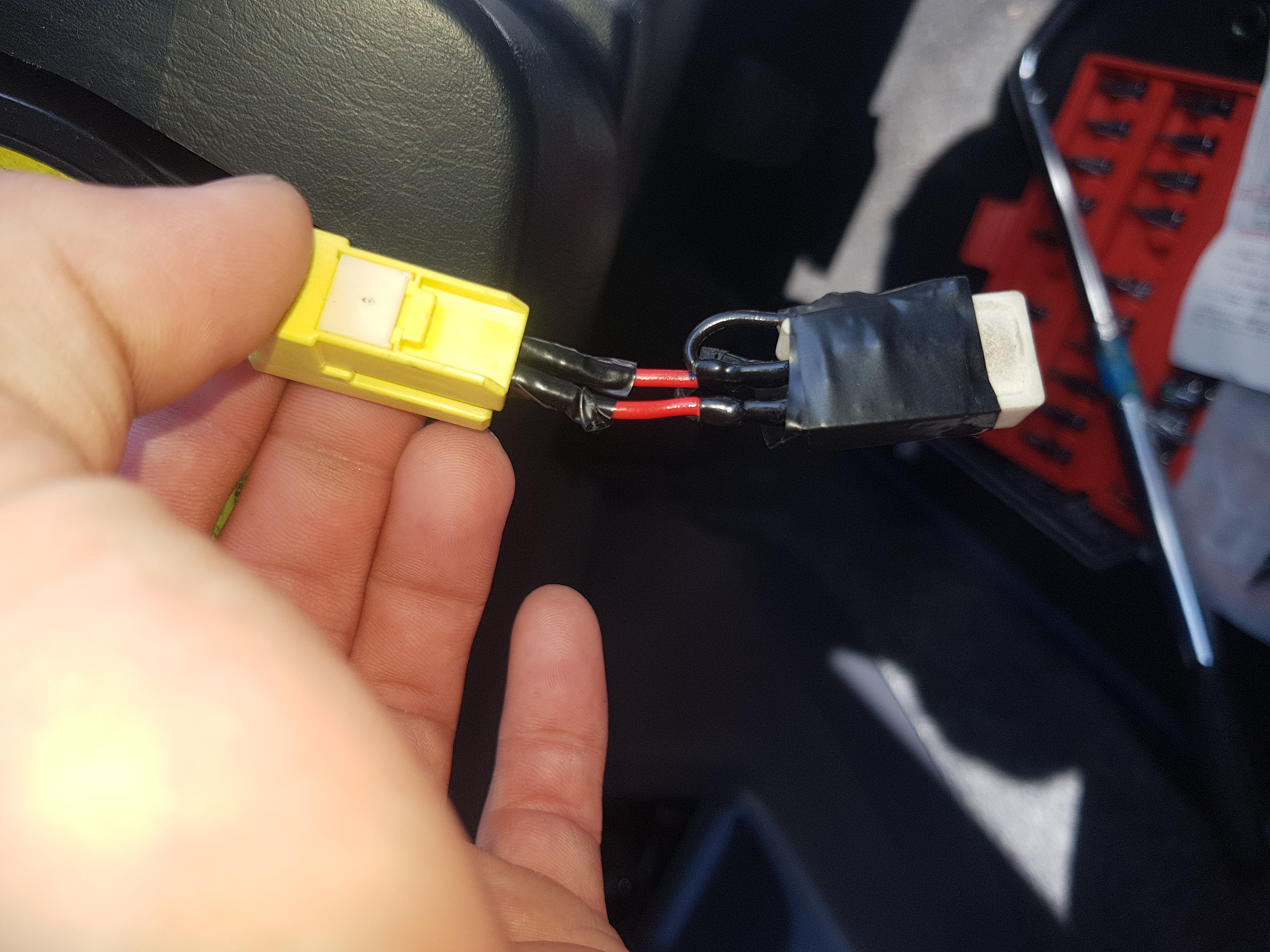

rasslenny Posted May 8, 2018 Posted May 8, 2018 o good lord..... please heat shrink the wires pleaseeeeee... that tape job is hurting my ocd soul Quote
