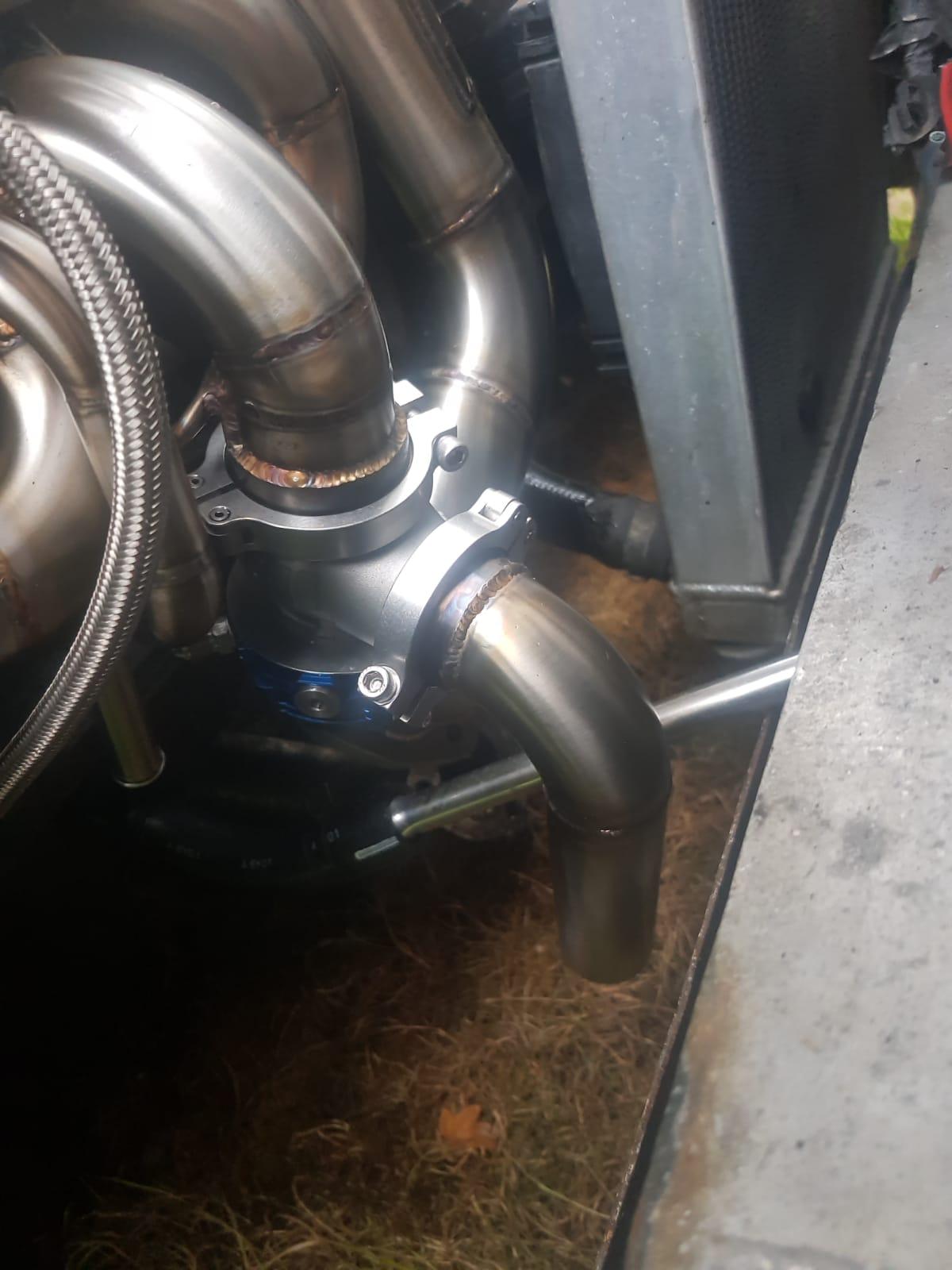

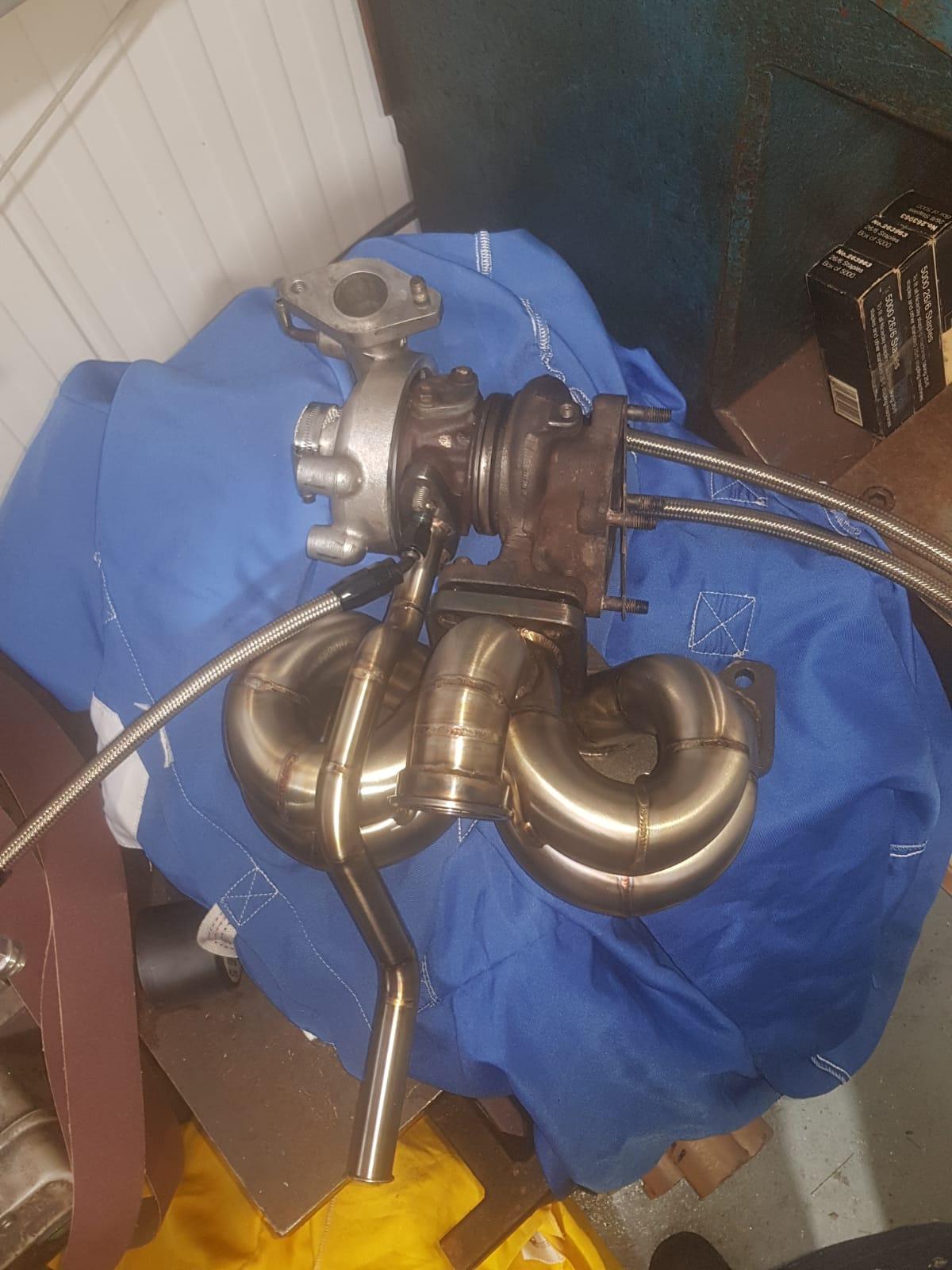

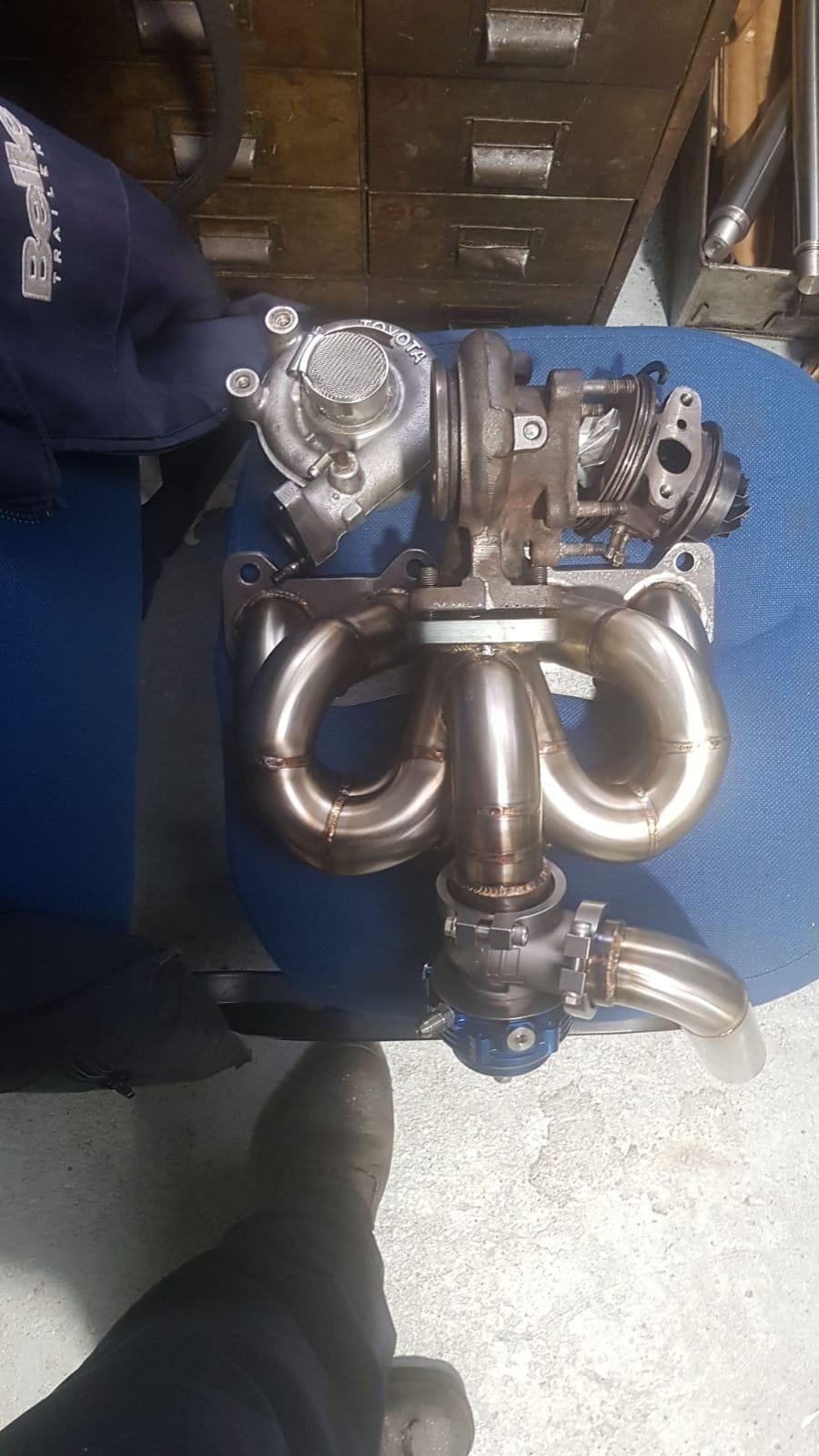

HedgeyGedgey Posted December 22, 2018 Author Posted December 22, 2018 Been speaking with the man himself Sacha, sorted out a new turbo kit as it really needed an external wastegate as the boost cut was pretty horrendous. I quite like the CT9 turbo, nice and quick spooling so decided that was staying, went for something different though.....top mount setup in stainless steel. Mounted to a genuine Tial 38mm wastegate on a vband. Have braided oil and water lines made too, as well as the the oil return pipe in stainless steel. Honestly this kit is exceptional quality, it's almost criminal to put heat through it and make it change colour lol Quote

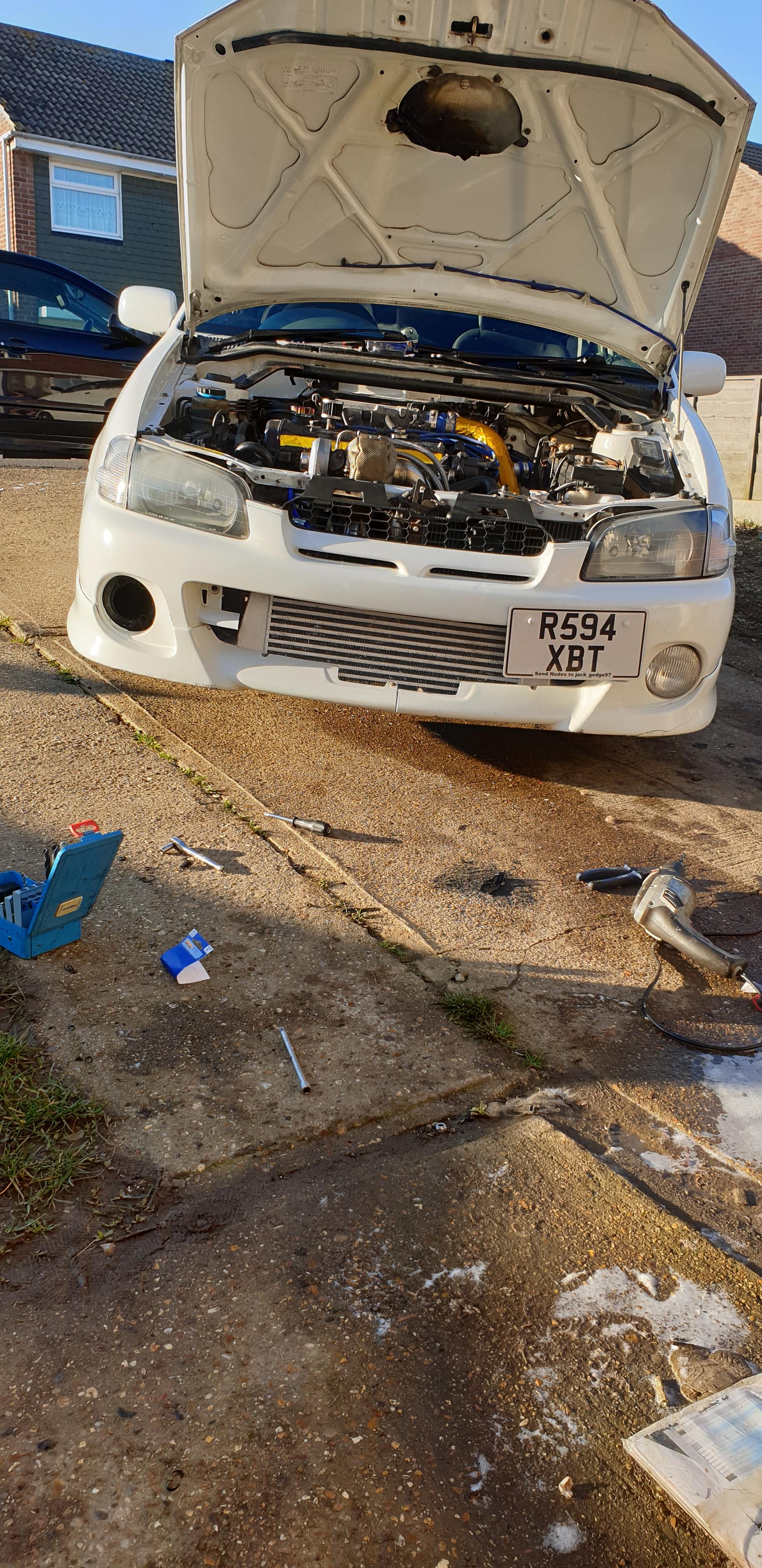

HedgeyGedgey Posted December 29, 2018 Author Posted December 29, 2018 So thought I'd mock up the turbo kit, I was concerned that the down pipe wouldn't clear the bottom rad hose, it's got a civic rad but I've no idea which one as the it clears Just gotta get the actuator off, wastegate welded up and the clock the turbo for the oil and water lines Quote

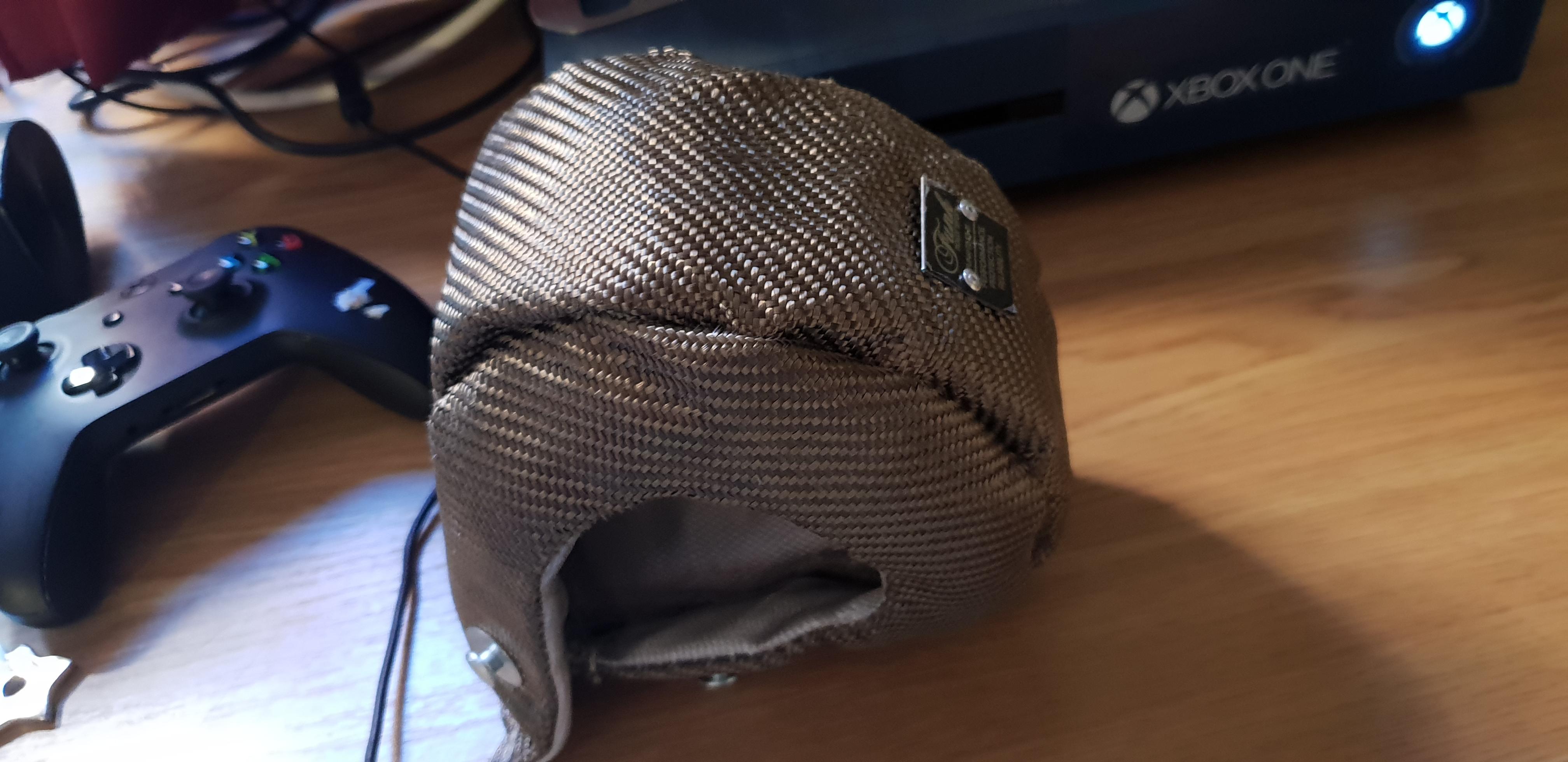

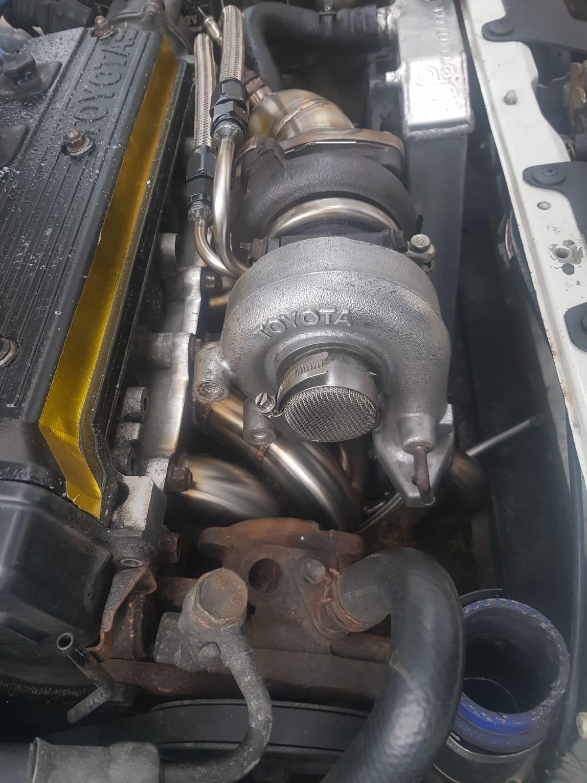

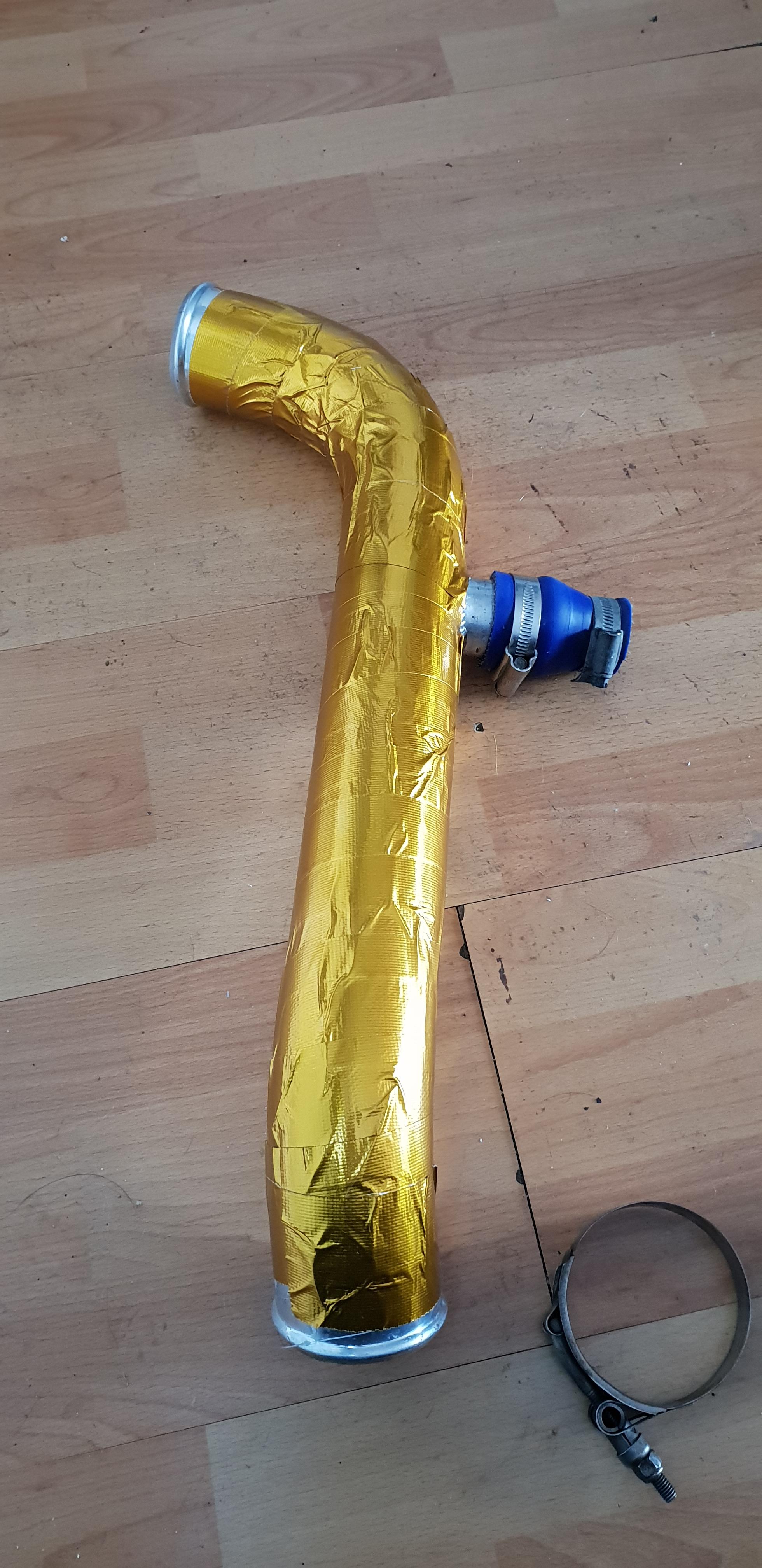

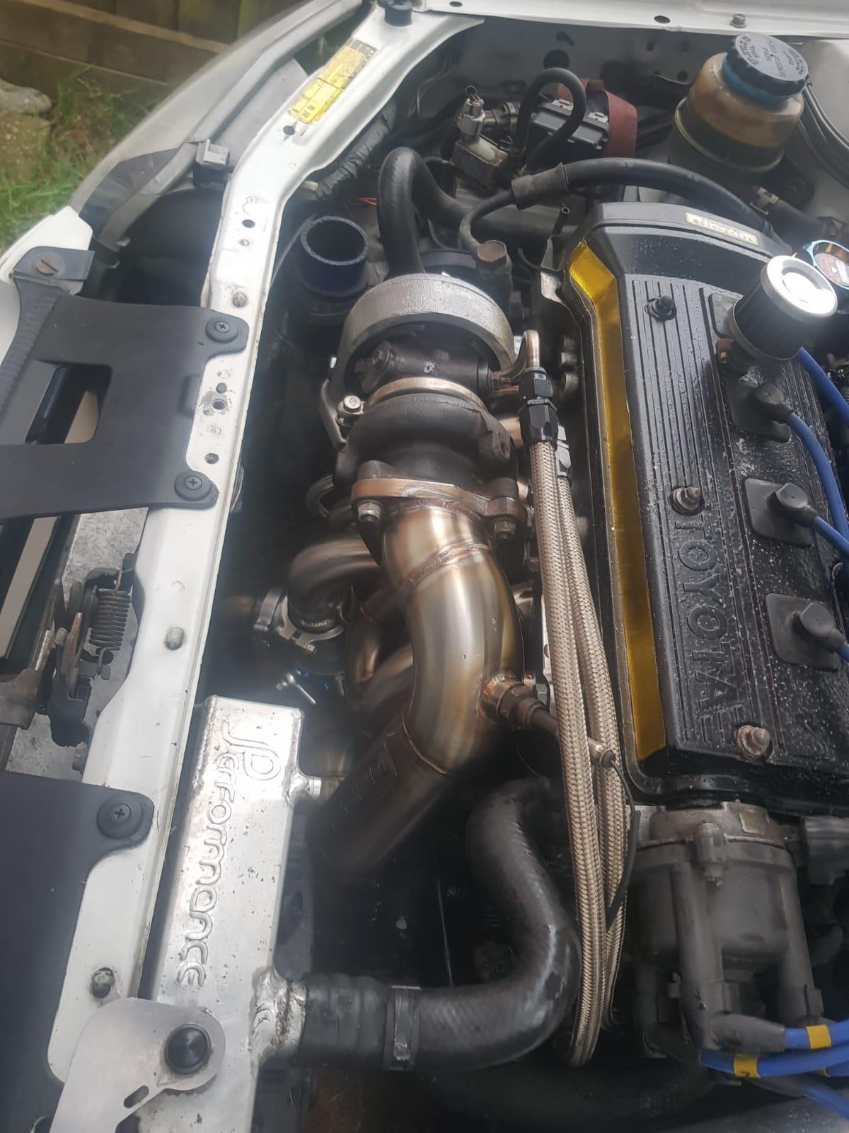

HedgeyGedgey Posted January 28, 2019 Author Posted January 28, 2019 Update time, semester finished at Uni and I quit my job (bunch of assholes) so now I have ~2 weeks off till uni starts up again. Made a large order general servicing parts with ID Workz. All the gaskets needed, calliper rebuild kits, Walbro 255, some fresh Miller's CRX oil for the rather tired gearbox. And set about getting stuck in on Scarlet With the top mounted turbo, you have to rotate the core of the turbo so the oil drain is at the bottom. Not a big job, just a pain. All done though All bolted up in place finally now, all genuine gaskets used (yes my bank account has taken a bloody good beating, almost £2k this winter on Scarlet, scary once you start adding it up) Braided oil and water lines ran Oil return and the brace put on Lucked out on the civic rad, managed to rotate the top hose so it fitted without being crippled. And the bottom hose just misses the down pipe. Went to see Funk Motorsport at Autosport show, ended up getting some goodies. Heat blanket for the hot side And some of their gold heat reflective wrap (not cheap!!!!) As I wanted to start in the heat management of the car before we start screwing big power into it. Heat wrapped the upper intercooler pipe, not the prettiest but it should make a difference to the inlet air temperatures Purchased a genuine Walbro 255 fuel pump, dads melted a piston using a fake Walbro before so it had to be genuine for Scarlet. Fyi doing a fuel pump on these cars is so fucking easy. Longest thing was pulling out the seats I think haha I'm hoping to have the thing running Sunday, gotta work out what I'm going to do with the hot side intercooler piping, cutting it apart seems the easiest way atm. I bought myself a Xmas present. AEM failsafe x series wideband, the daddy of AEM widebands. Set me back a few pennies, but long term goals is I'm going to use the wideband for closed loop fueling and self learn on the ME221 Quote

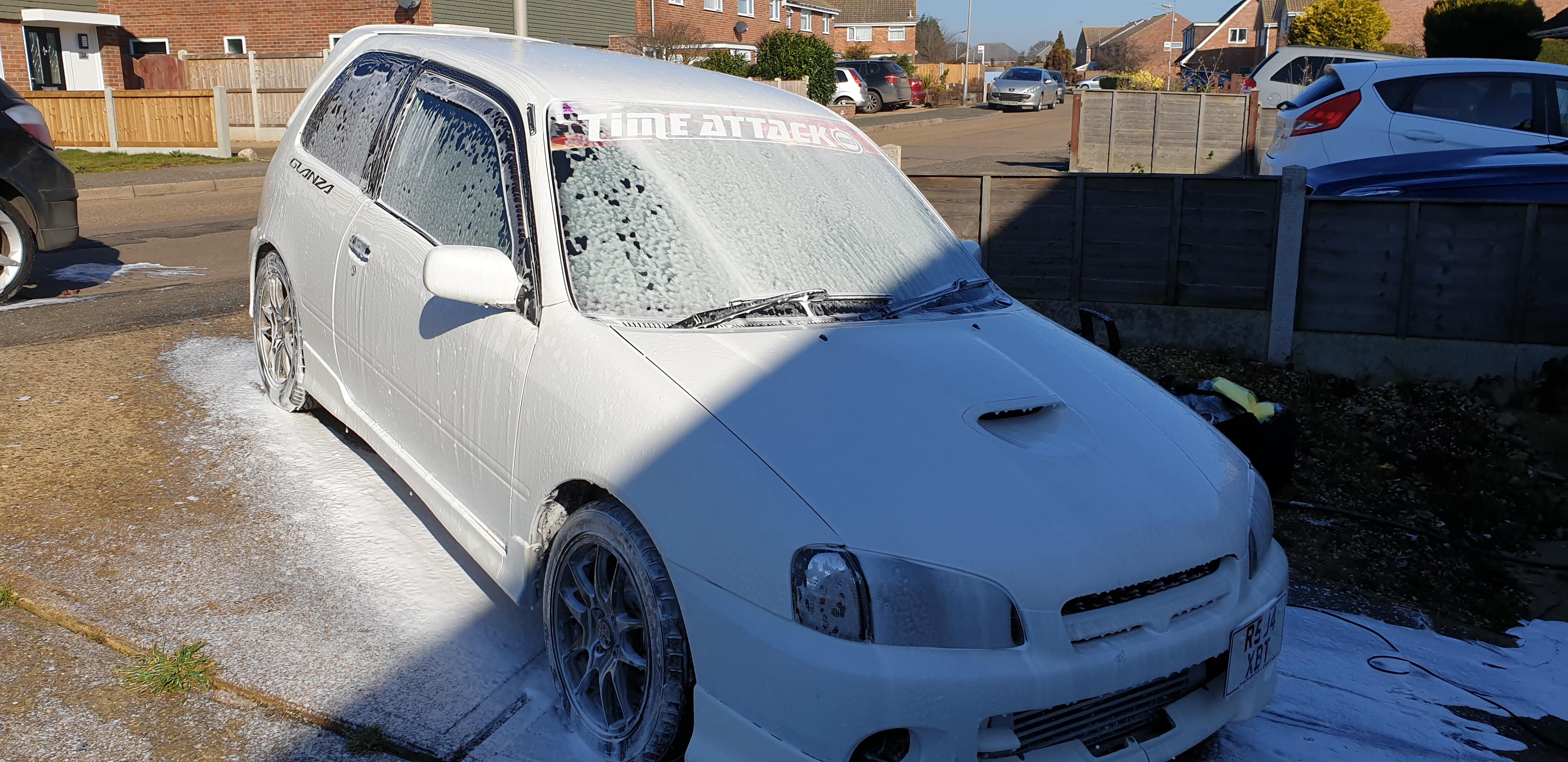

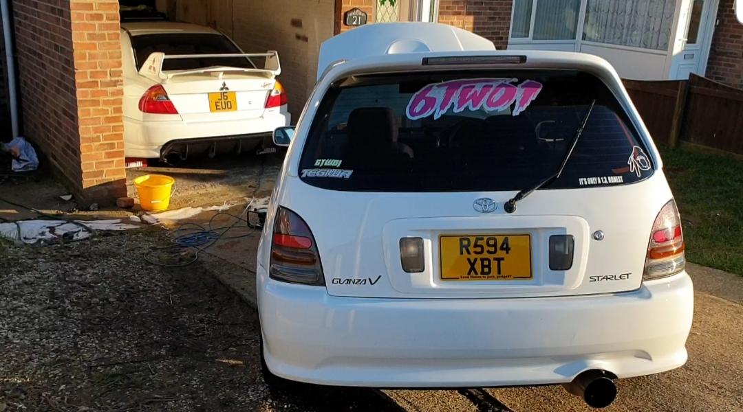

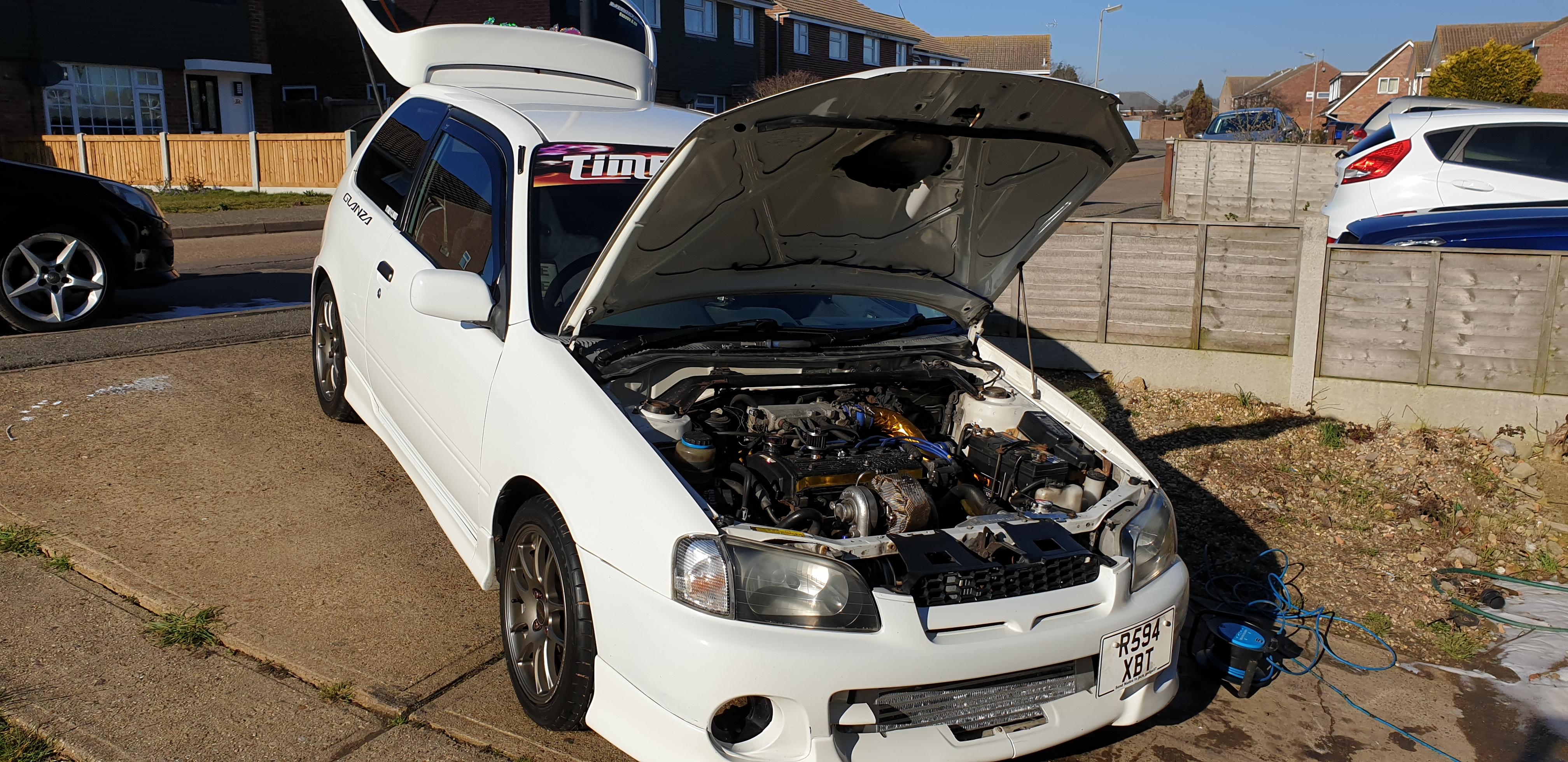

HedgeyGedgey Posted March 10, 2019 Author Posted March 10, 2019 Finally got the old girl running, few issues with the water lines. Had to take a drill to open them up a few mm, but it's all running now. Moved her from the front garden where she was basically stuck till the grass dried out a bit. Nice spring clean, who doesnt like a snow foam pic might de-chav the rear end of the car, although I'm still undecided. Annoyingly the headlamps need another cut with the mop and might attempt to lacquer them this time to stop them going yellow I'm relatively happy with the car. As I'm still a new driver shes plenty powerful enough for me now, although a local lad has just bought a cheap glanza and potentially getting a free 4EFTE block from him. So may drop that off at the machine shop and start building an epic high revving 4E for the future Yet to take her up the road on the new setup, never heard an external wastegate before so I'm rushing all my uni work so I can MOT the old girl and rag the balls off her lol Quote
