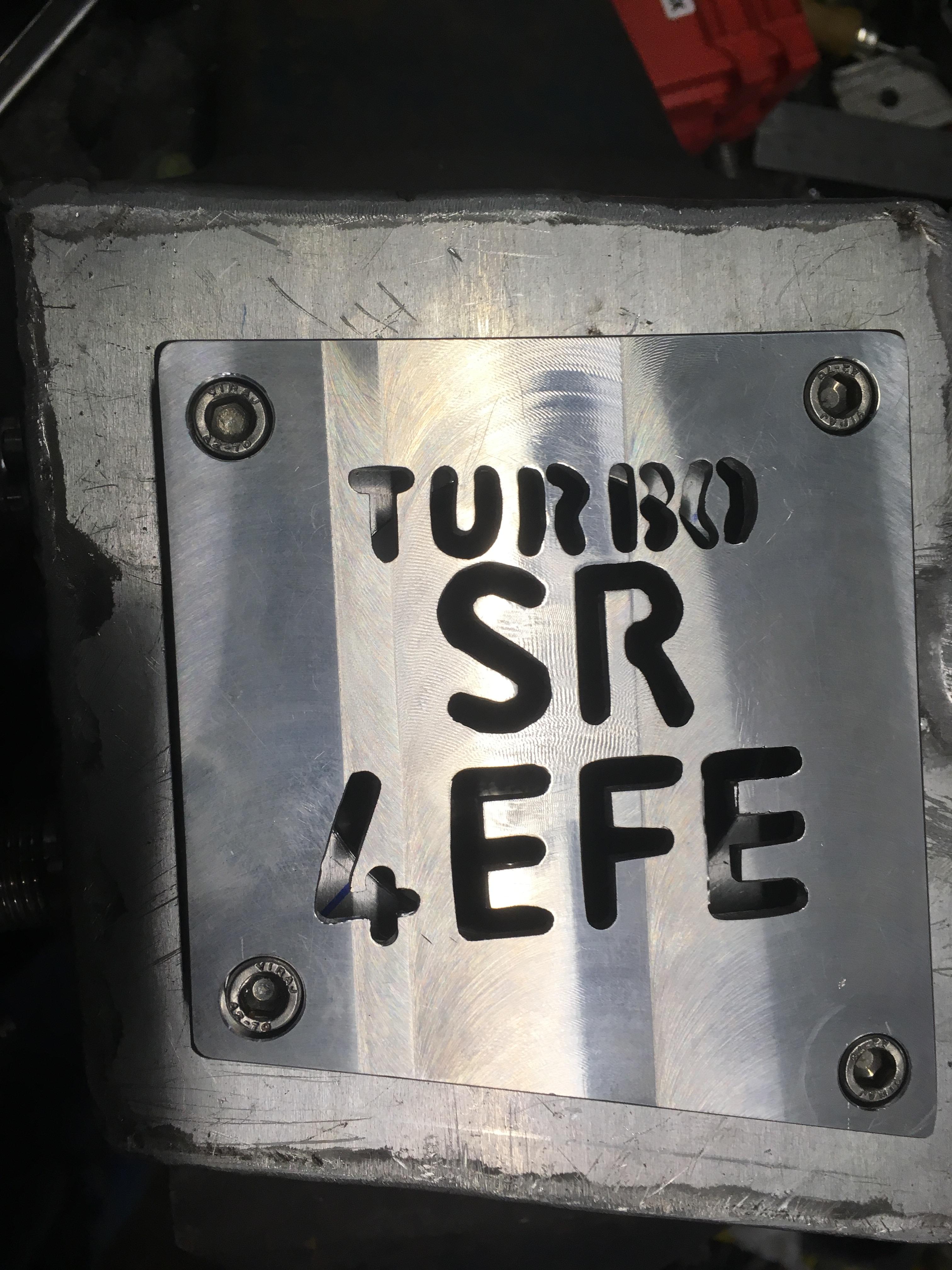

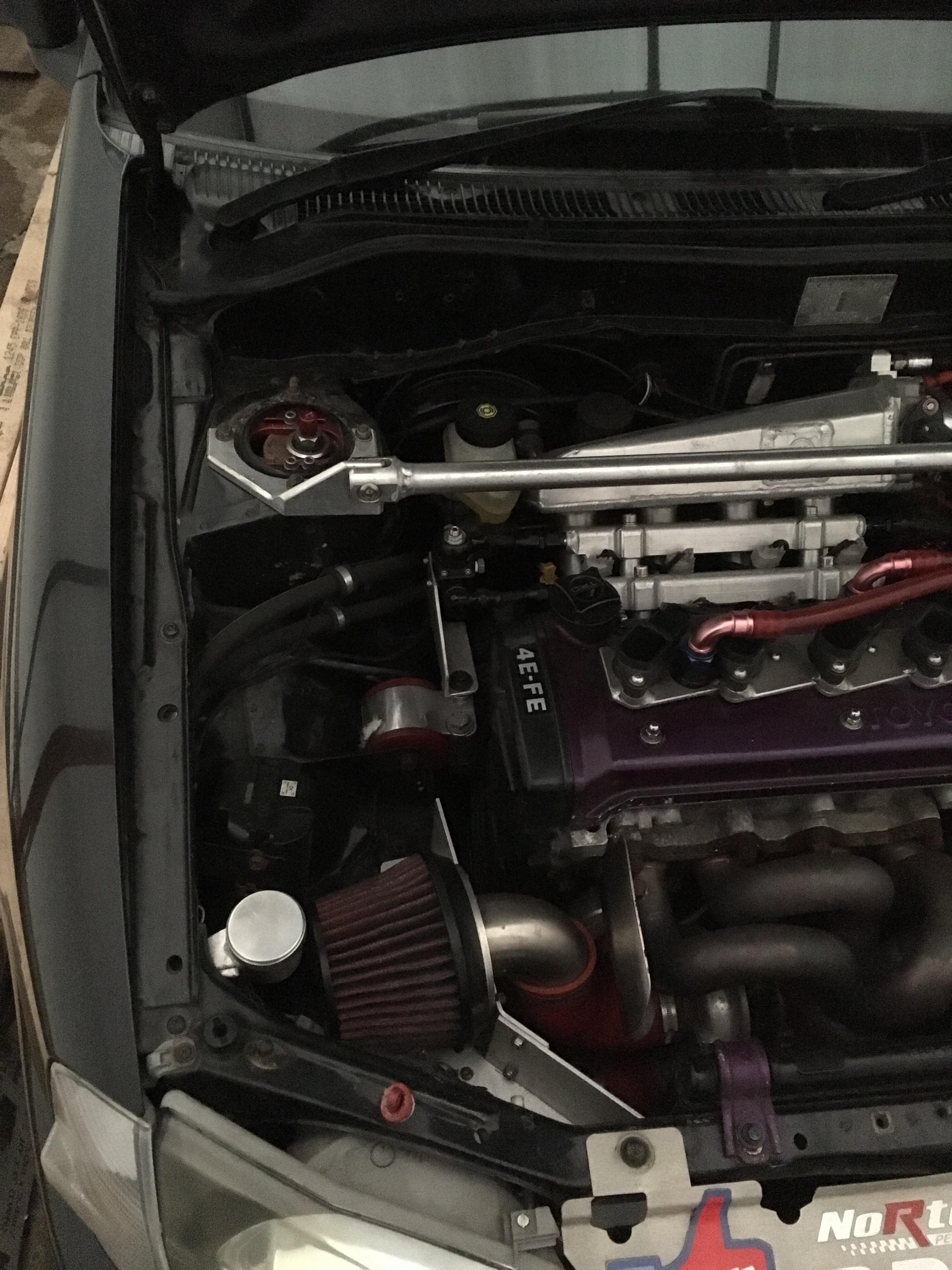

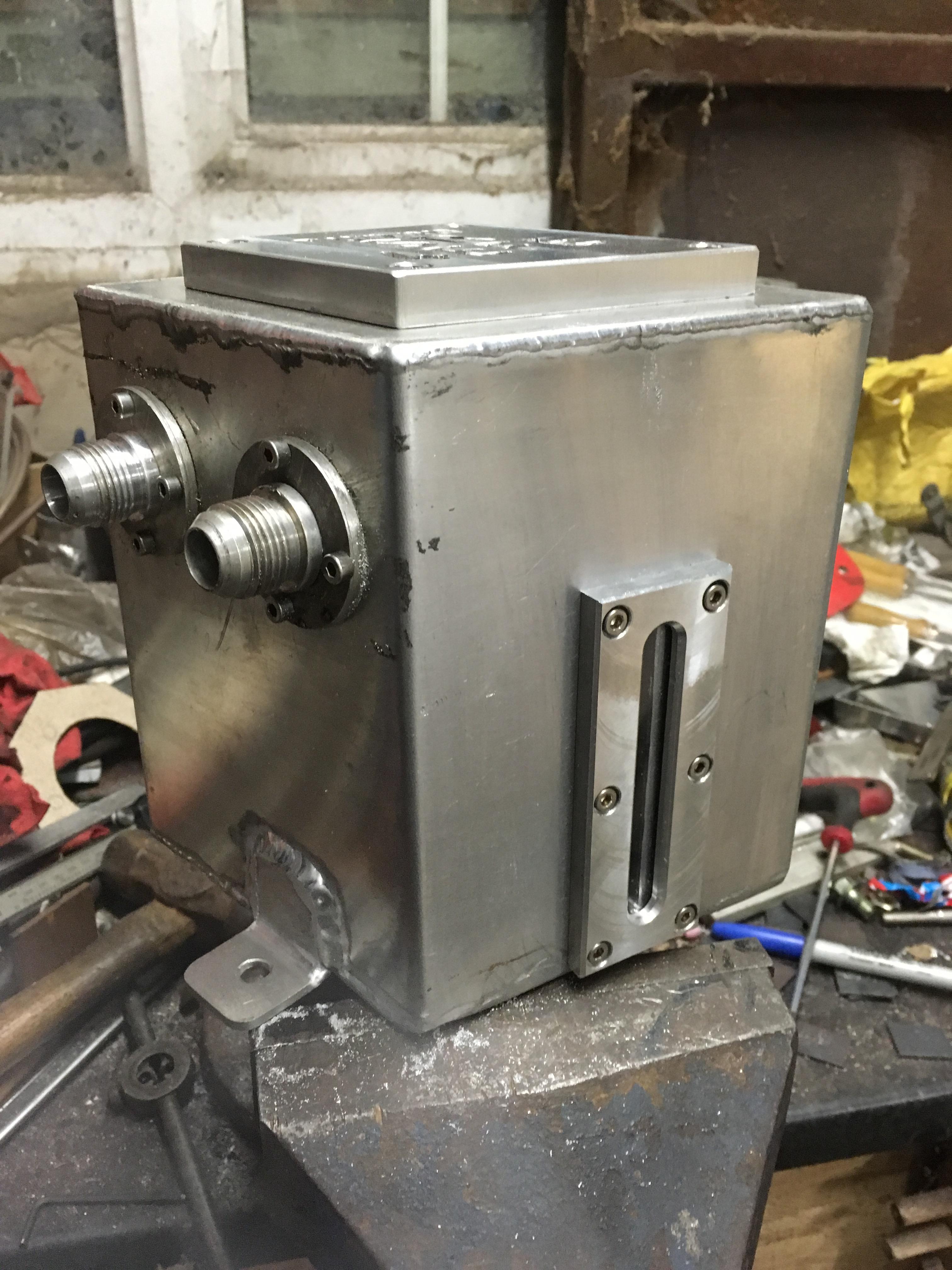

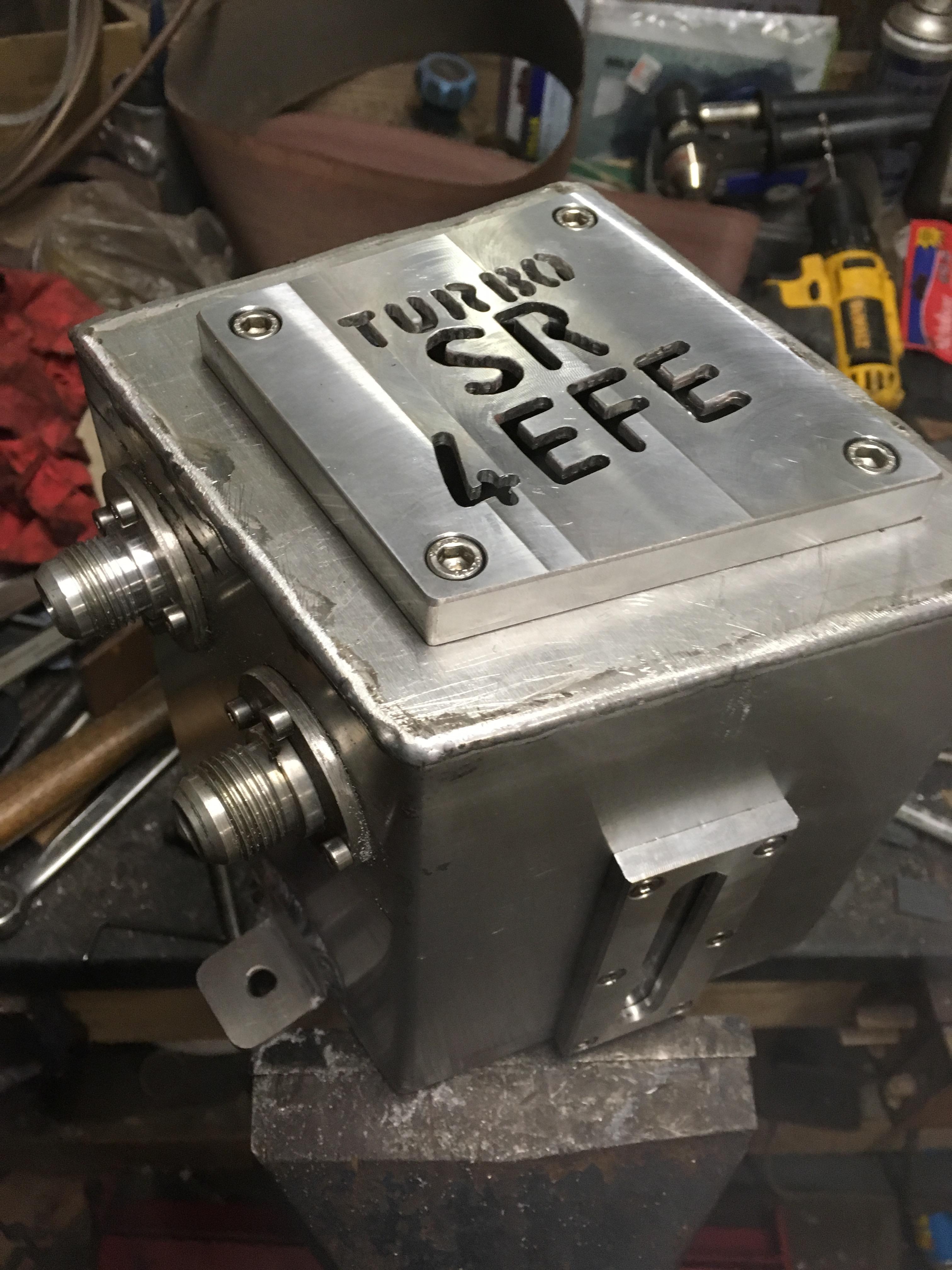

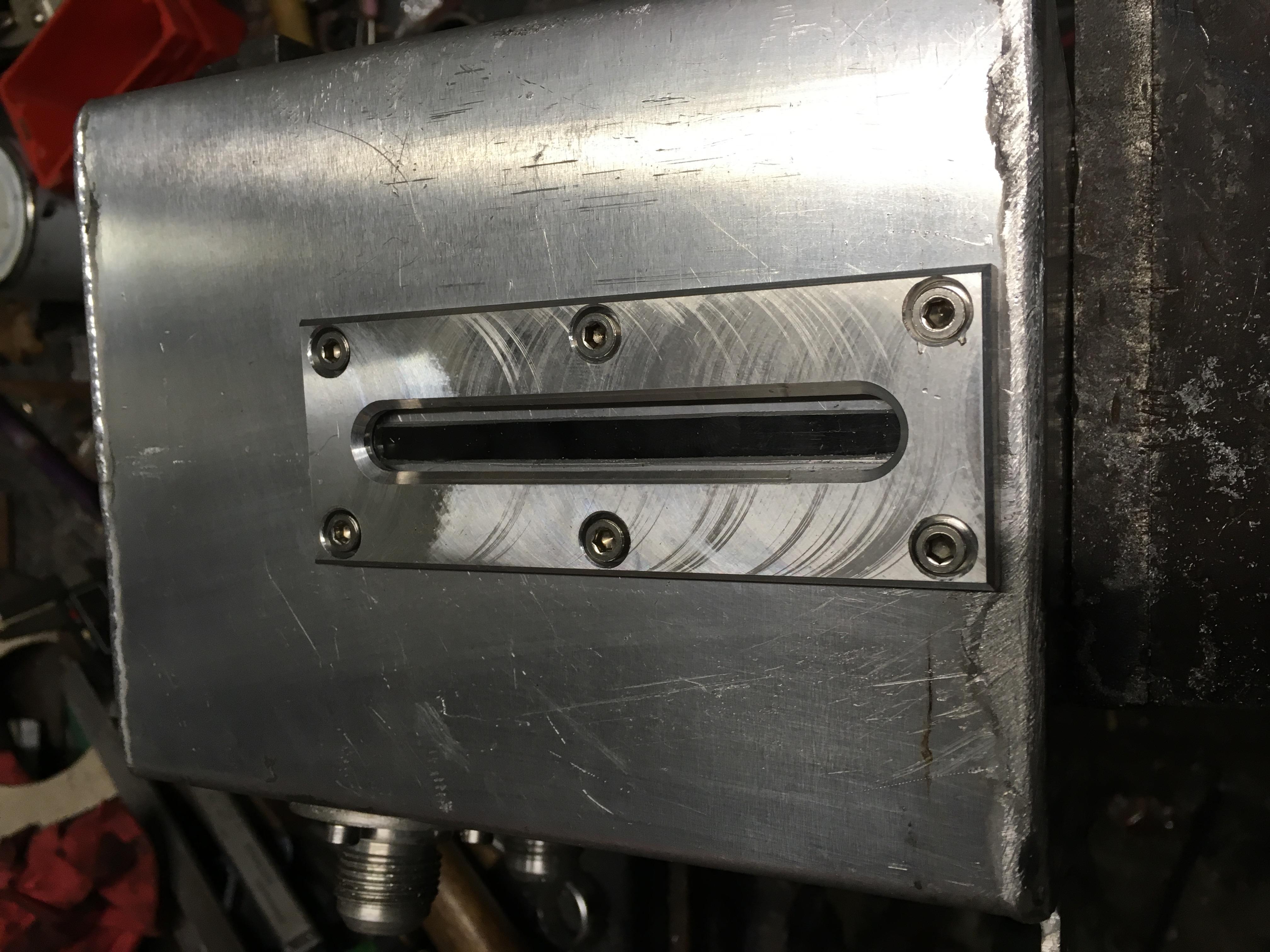

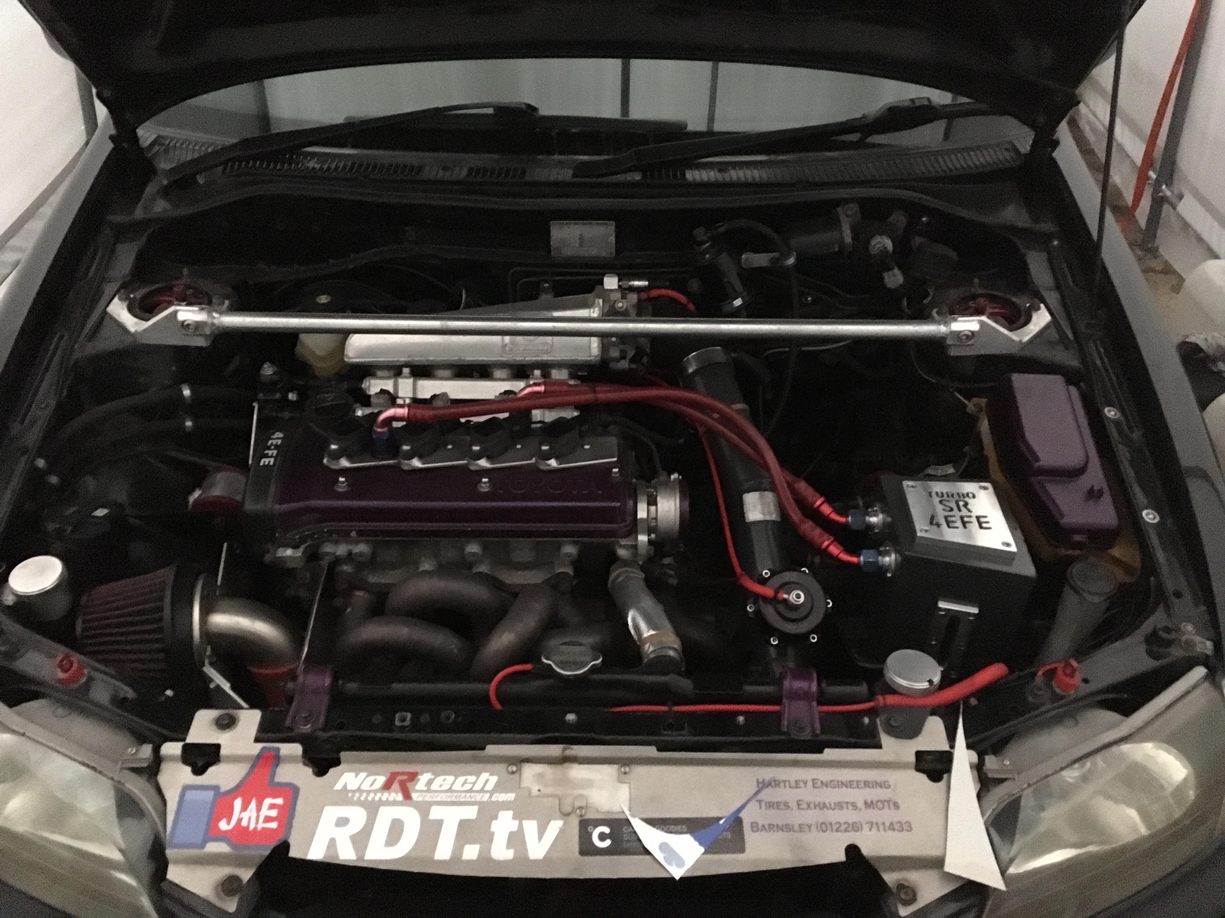

My catch tank for the turbo SR.

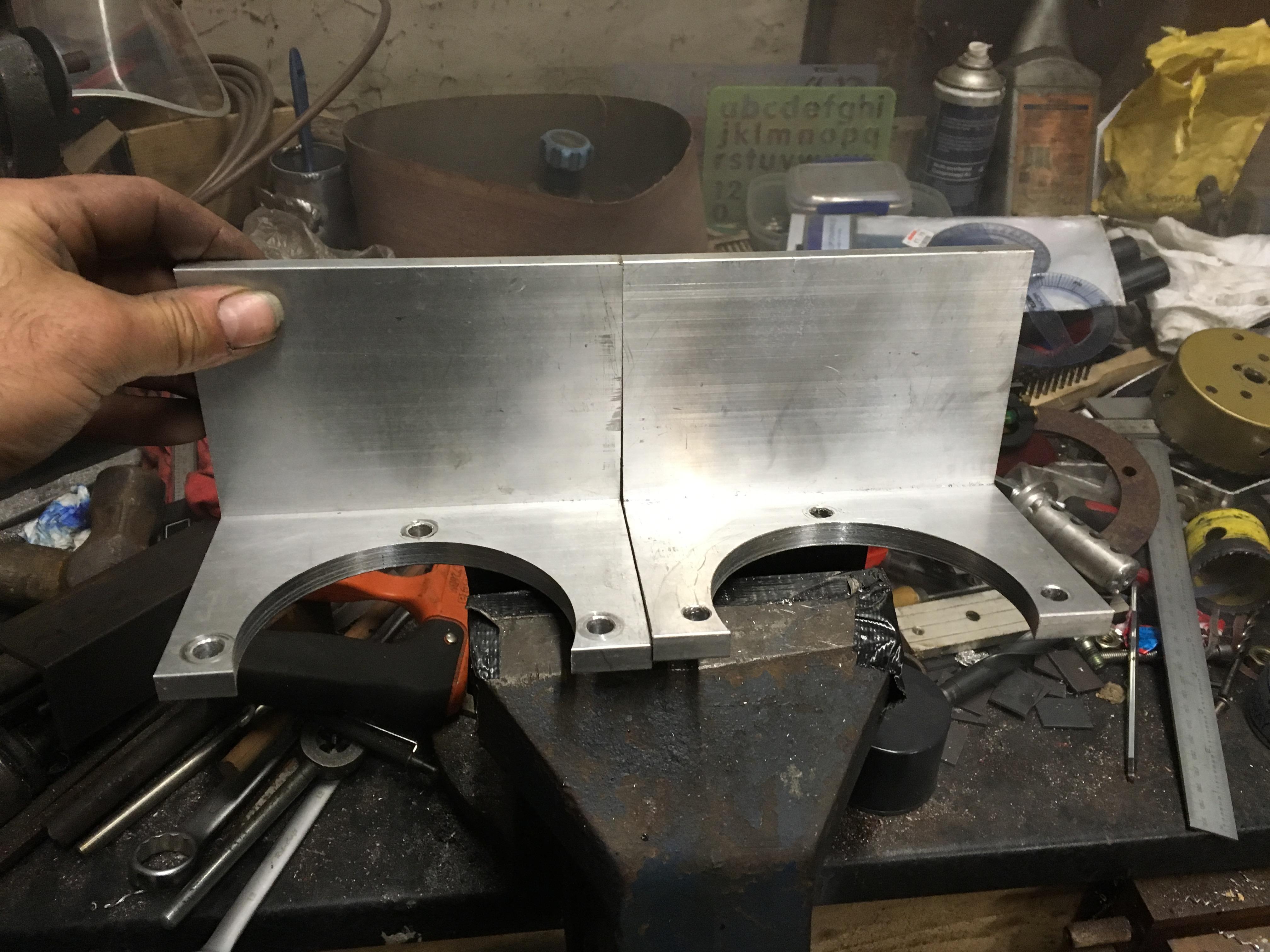

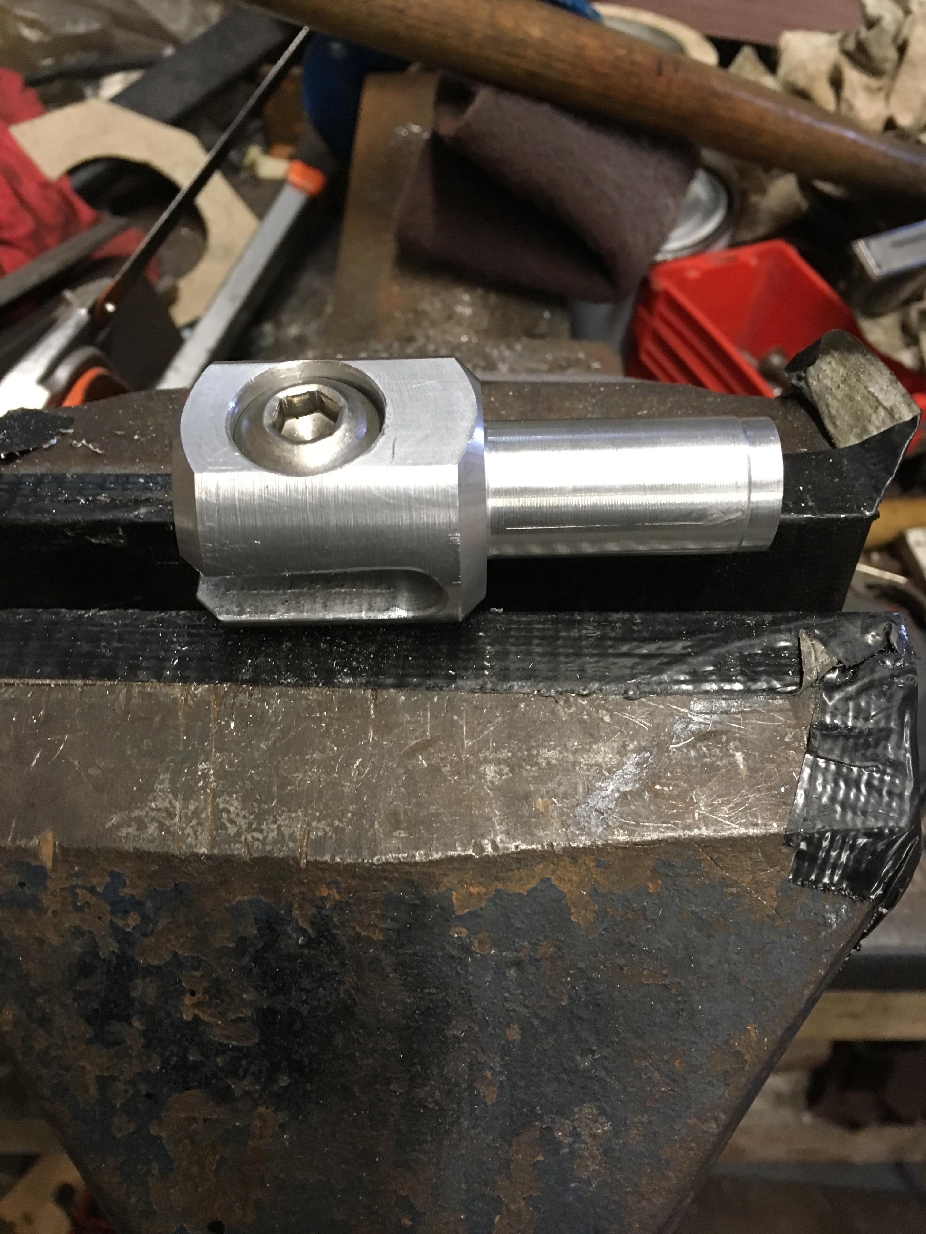

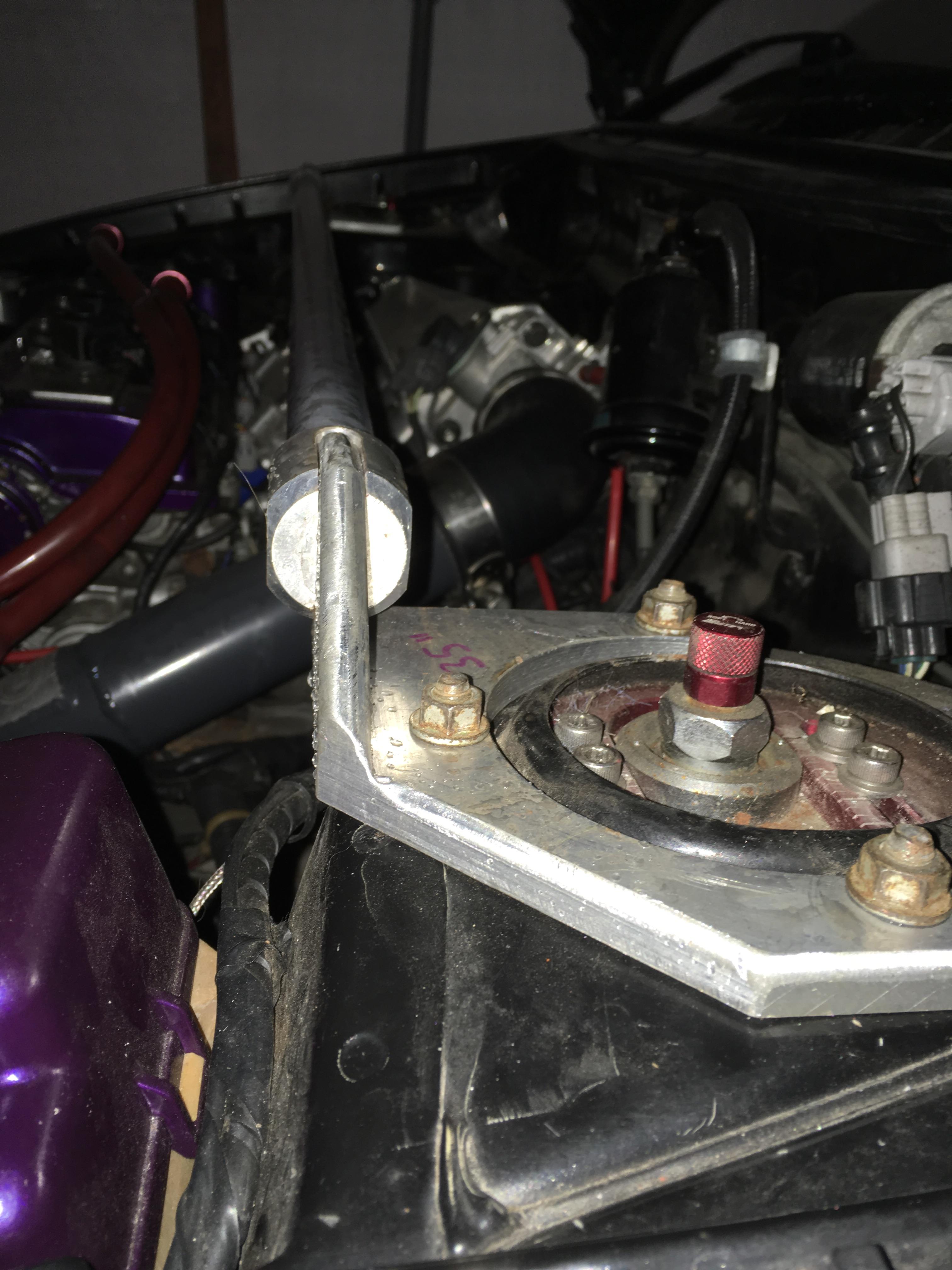

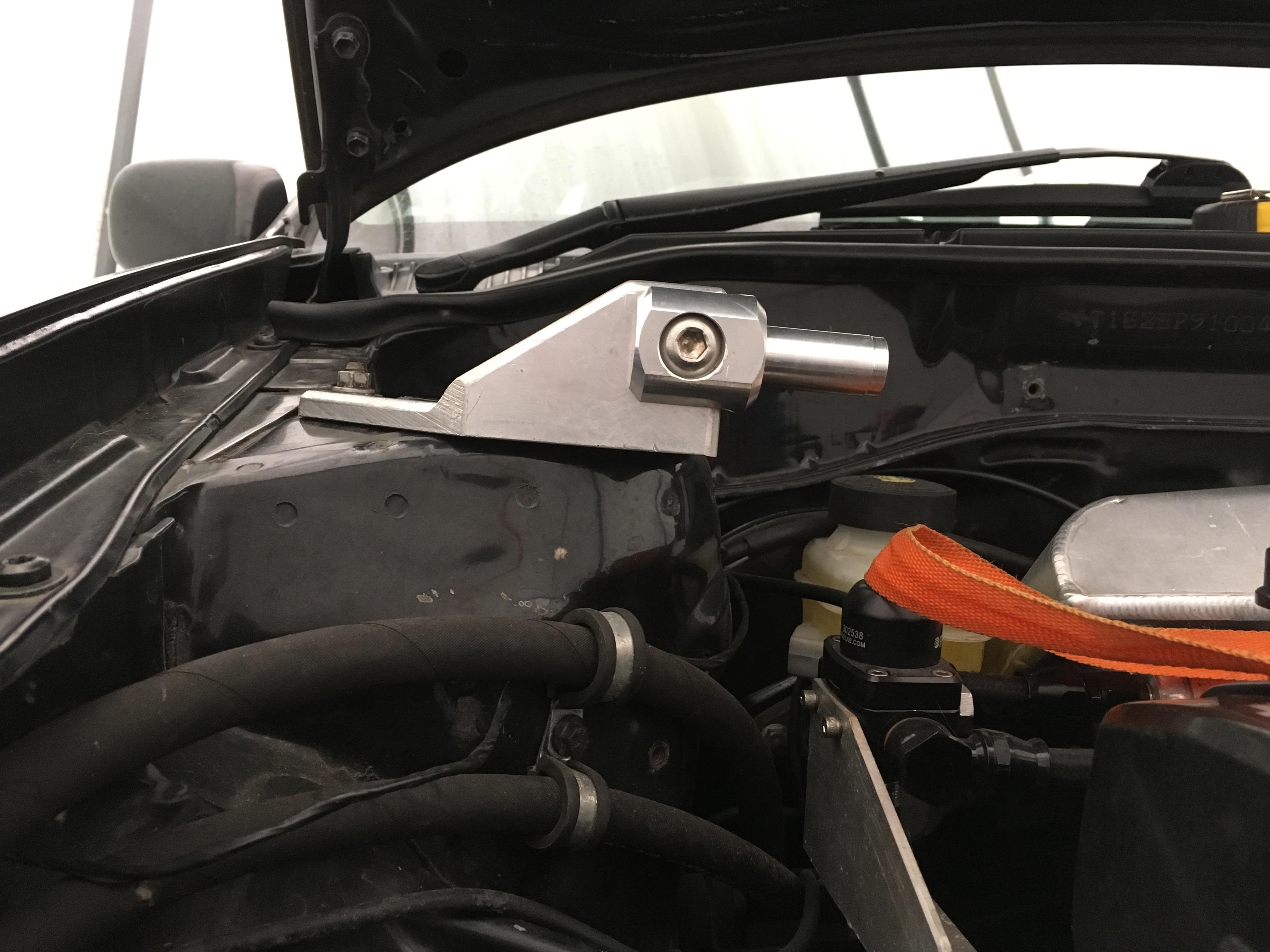

Same agin strut brace for my SR!

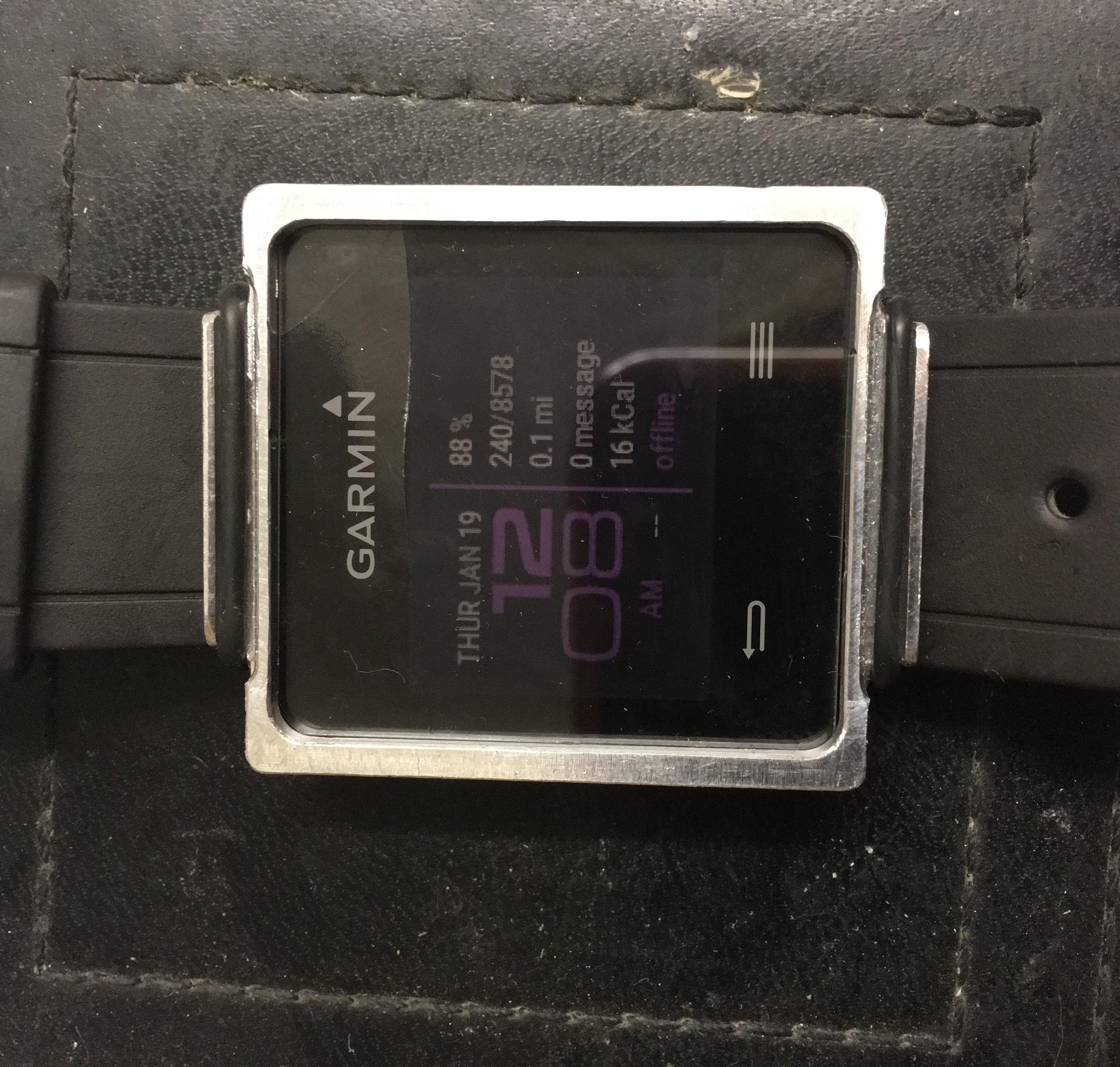

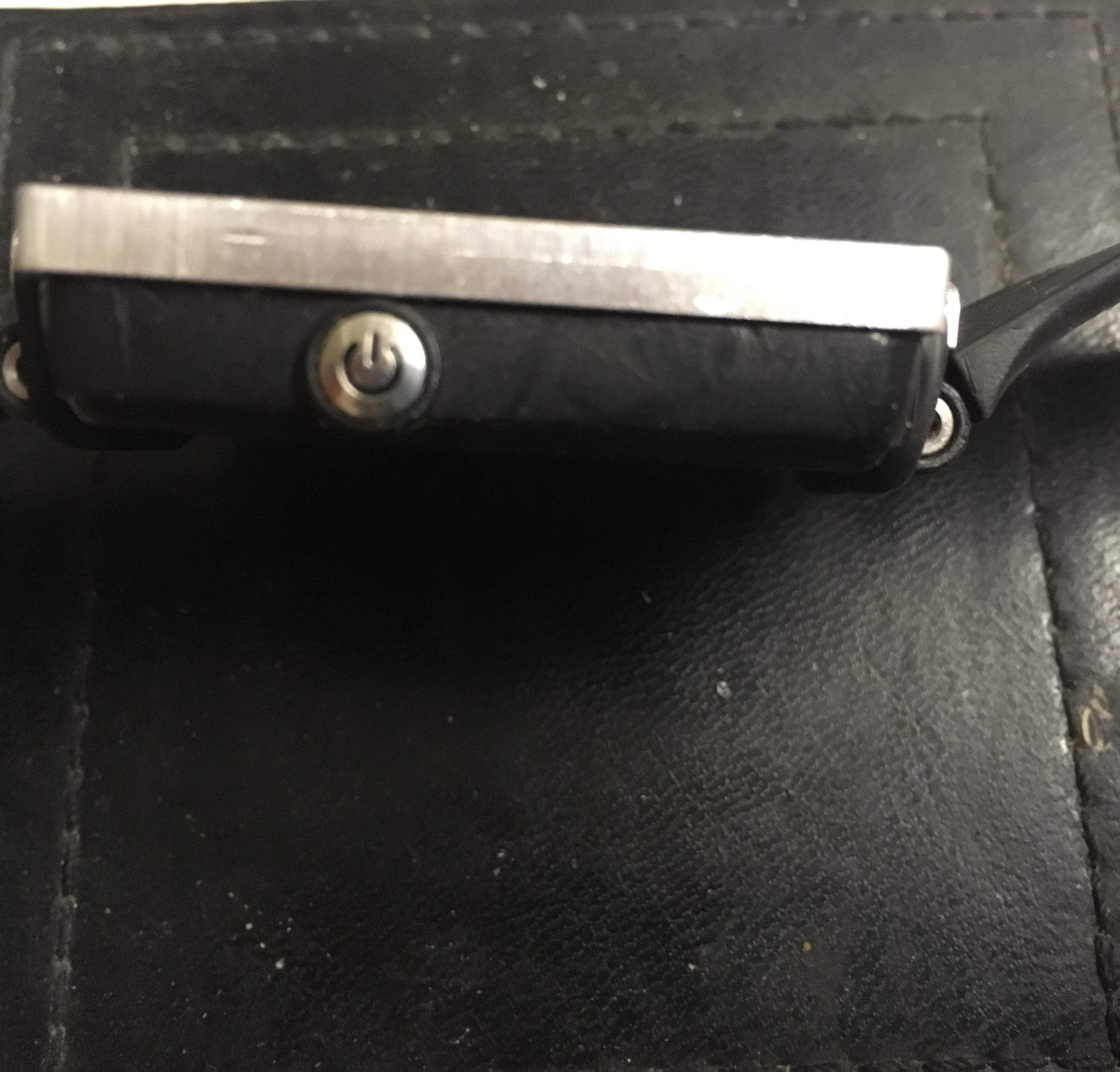

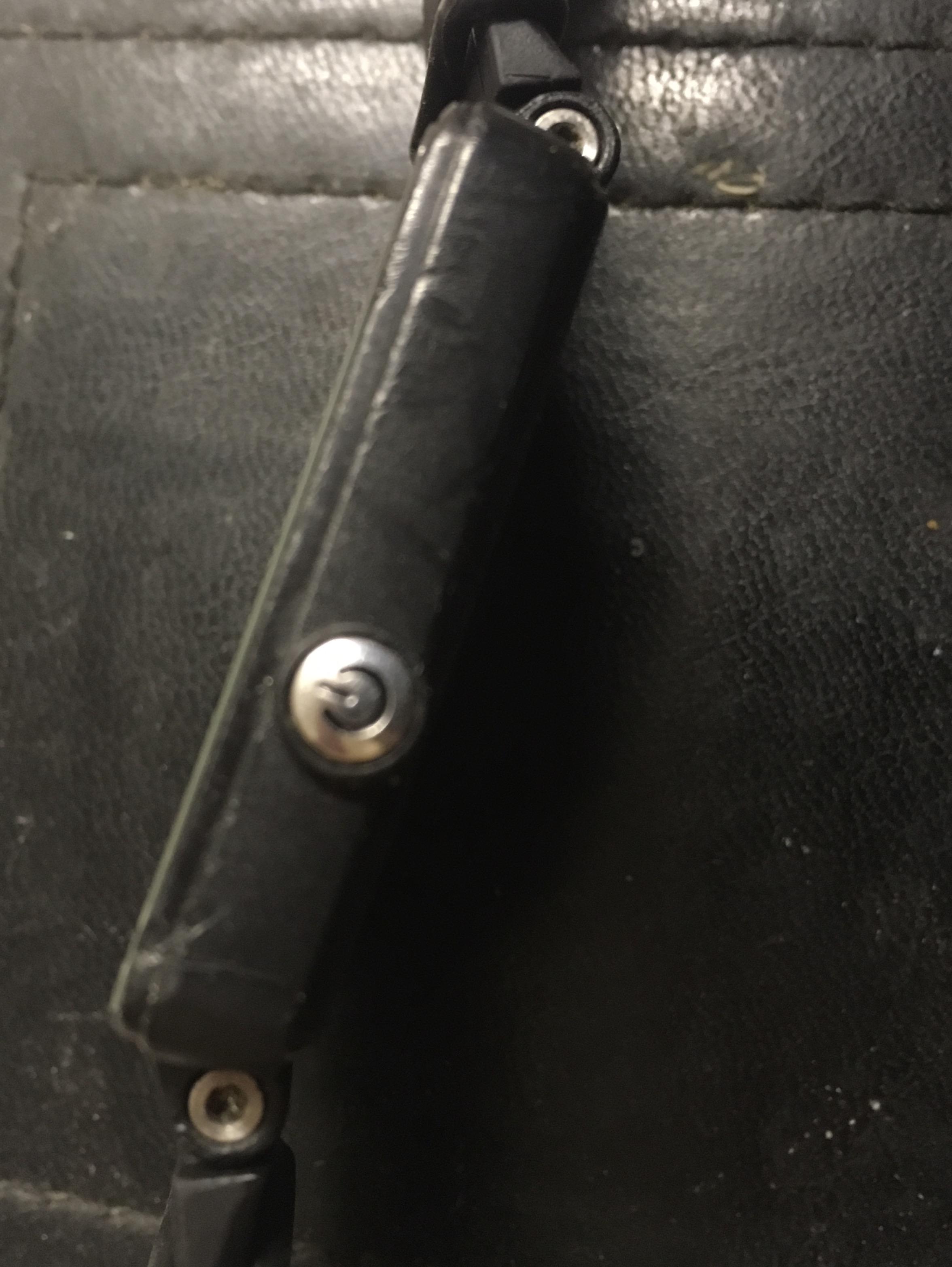

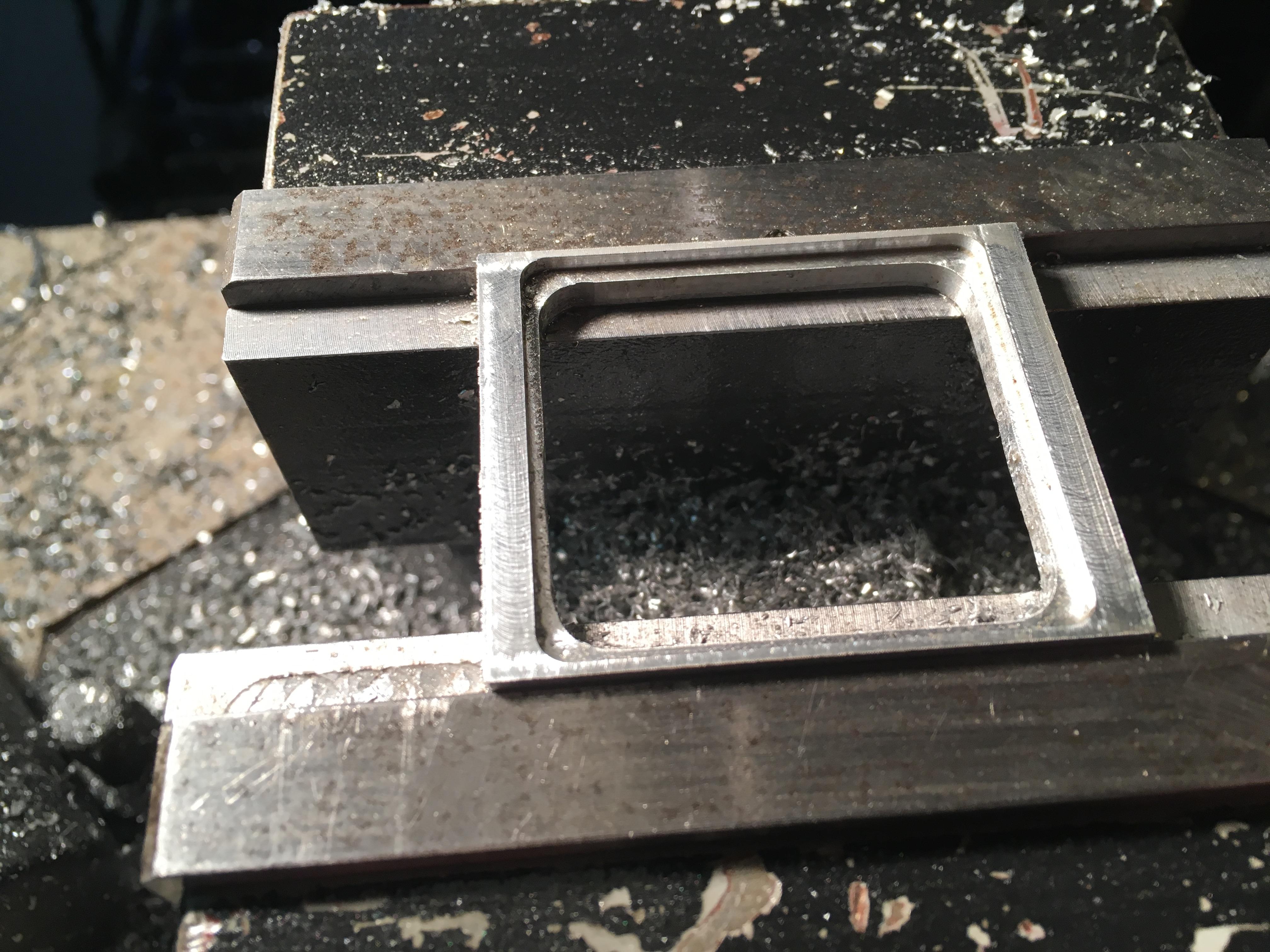

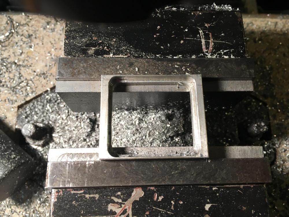

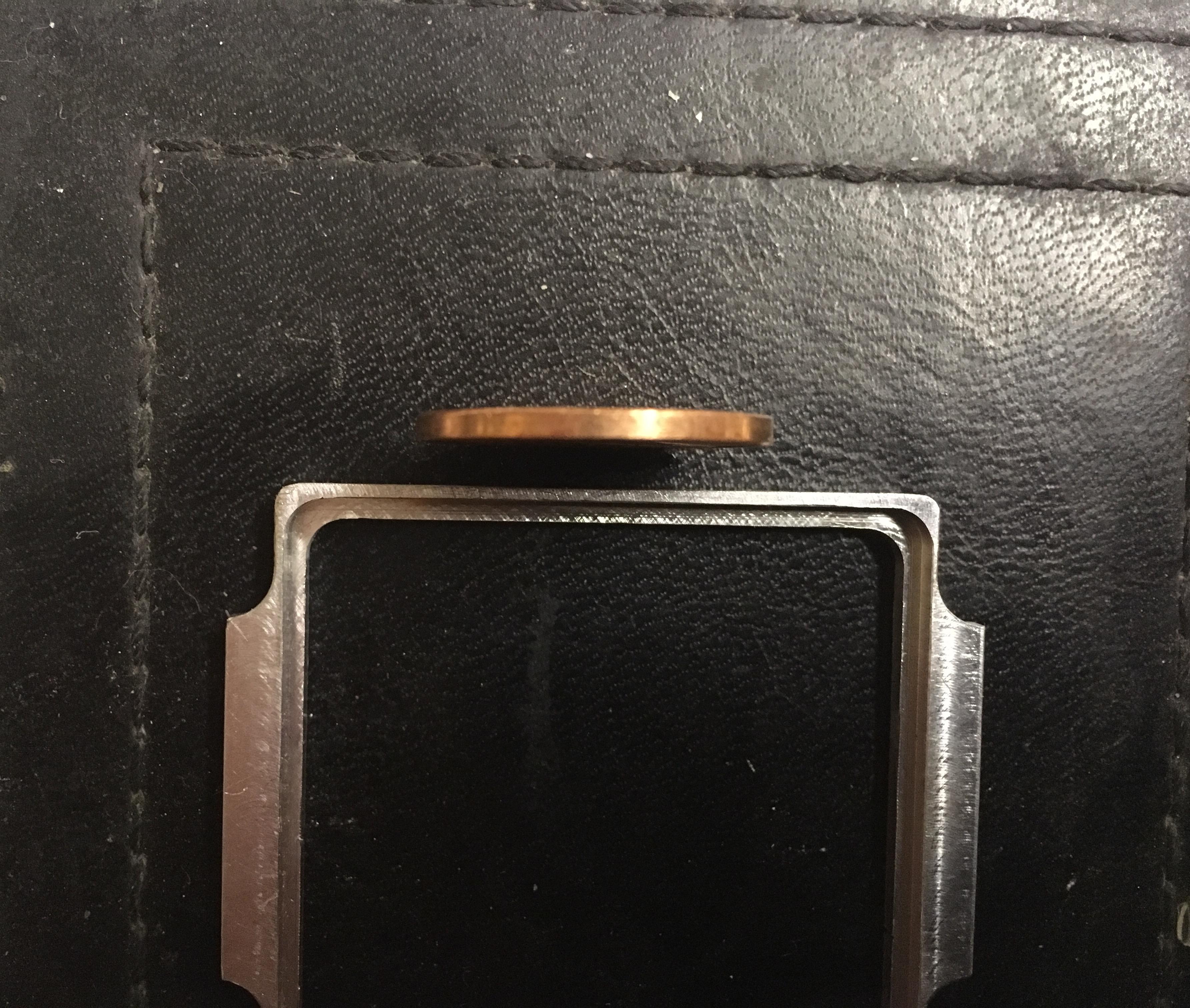

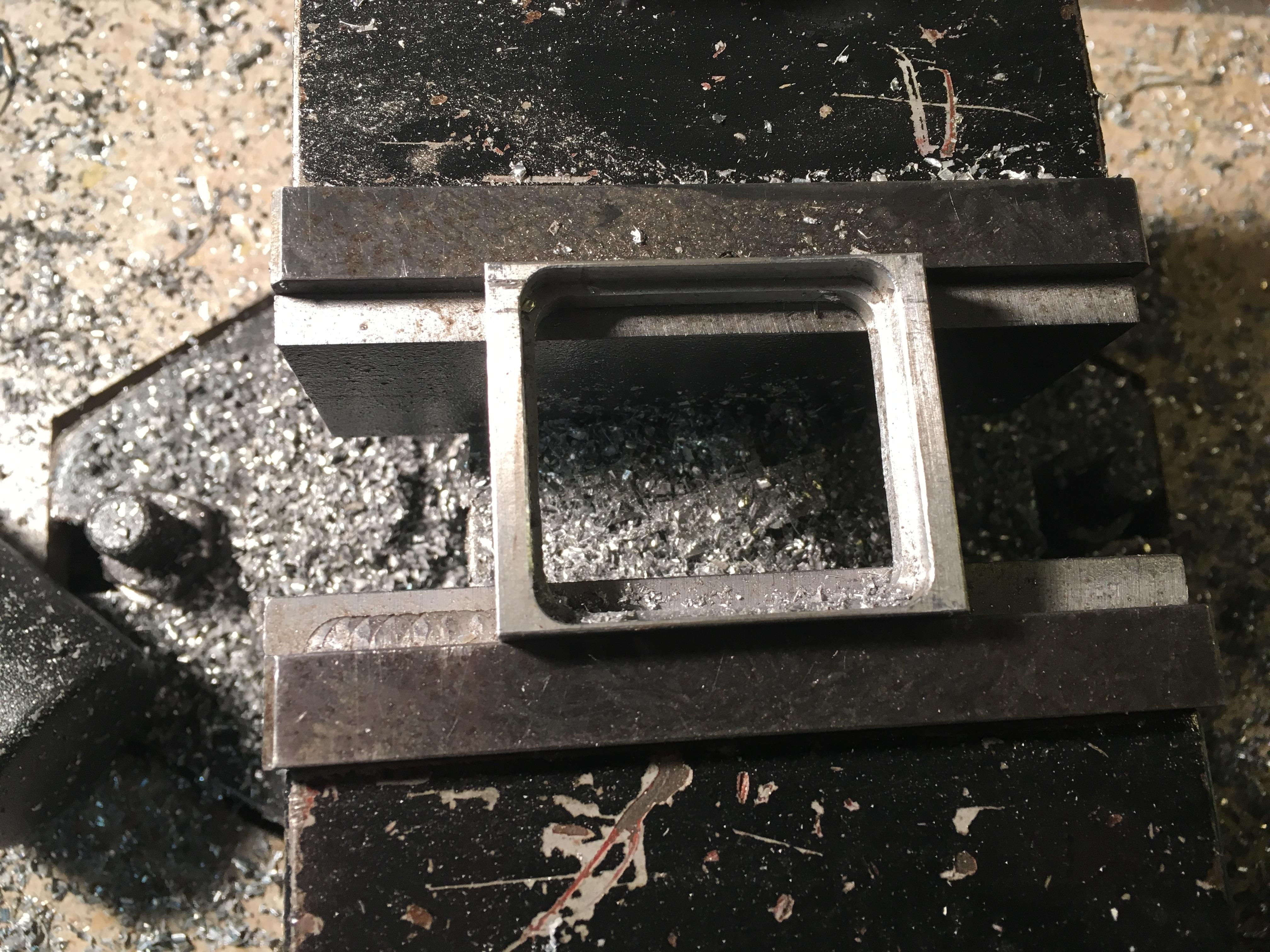

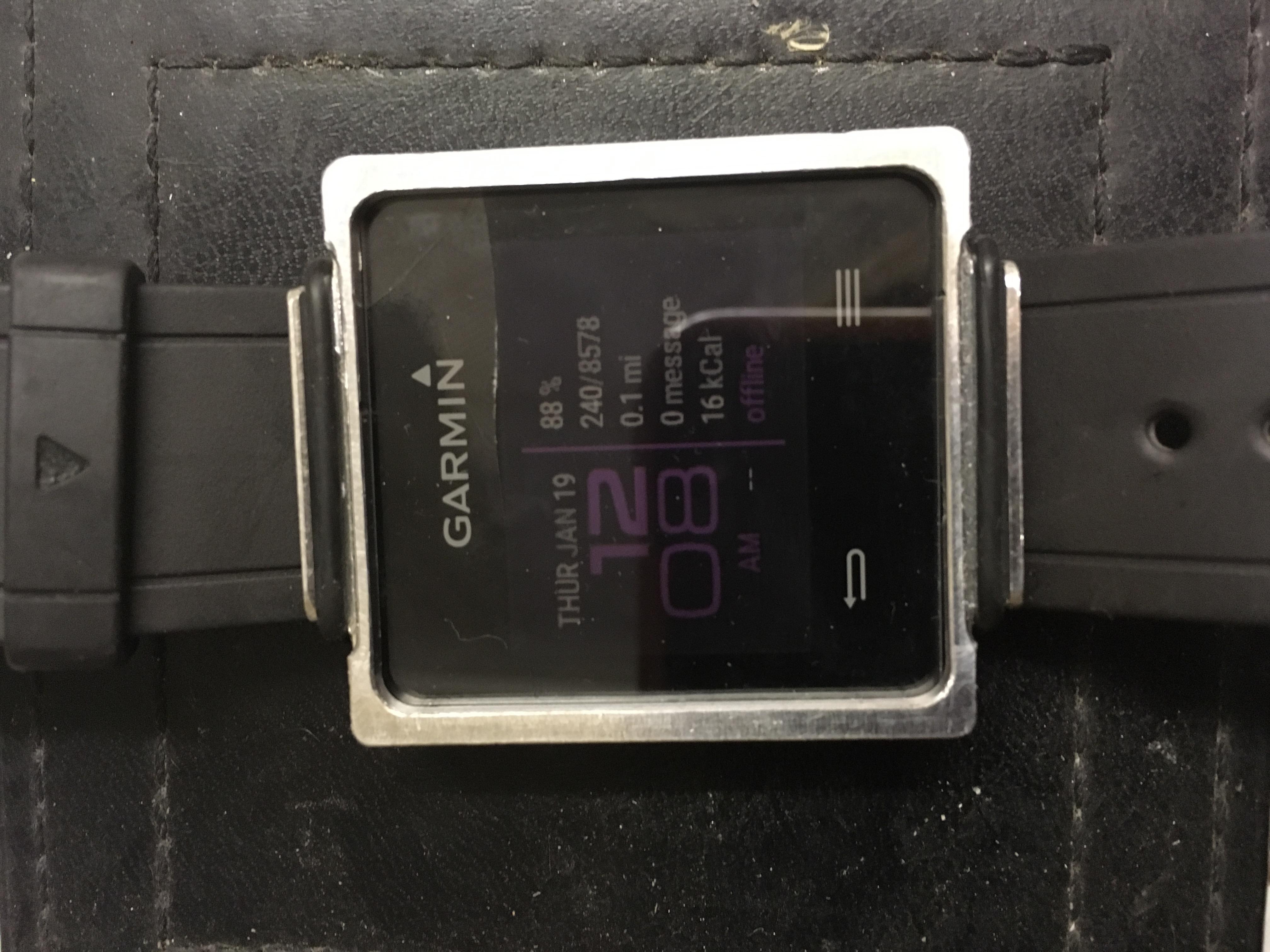

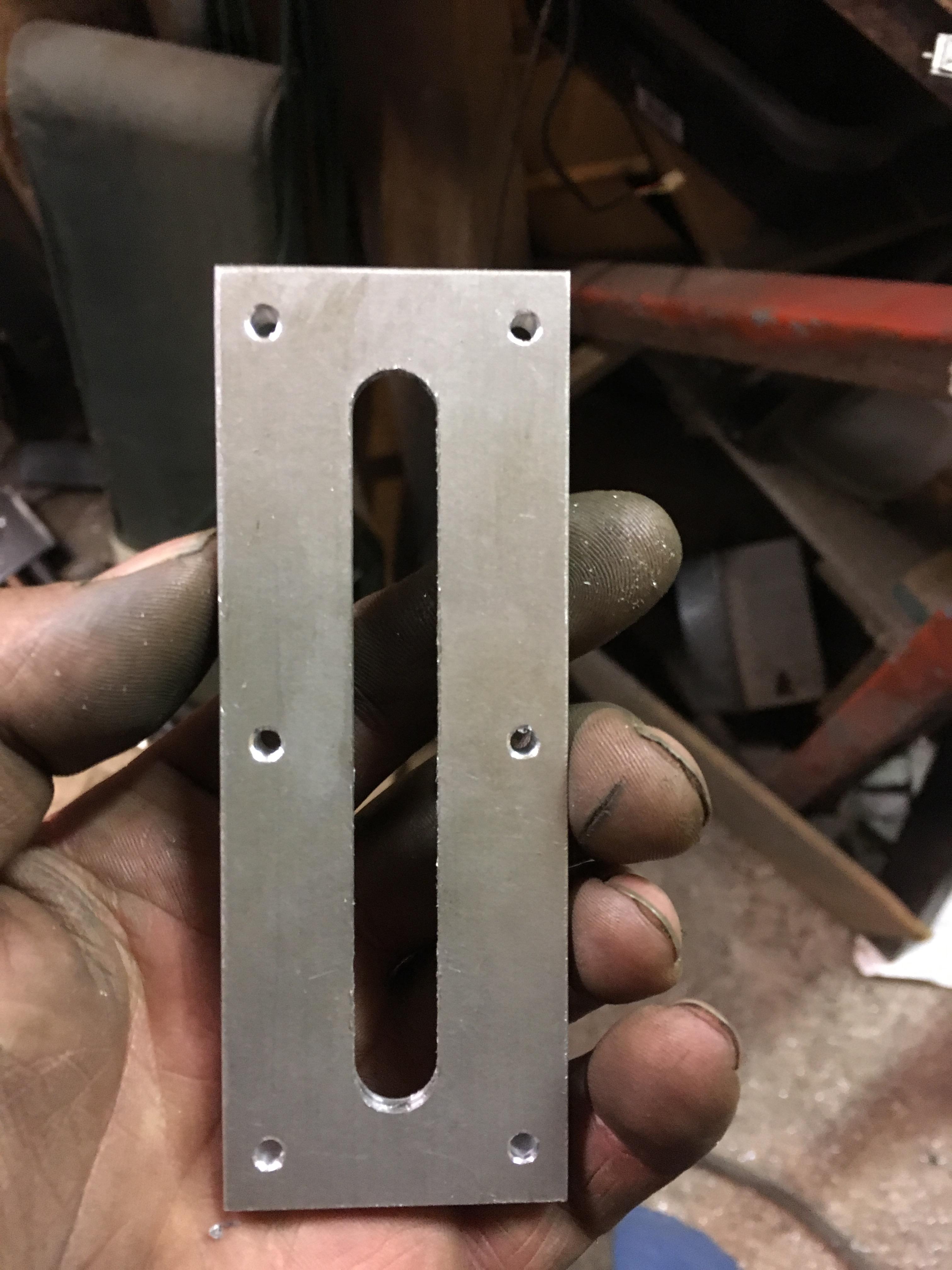

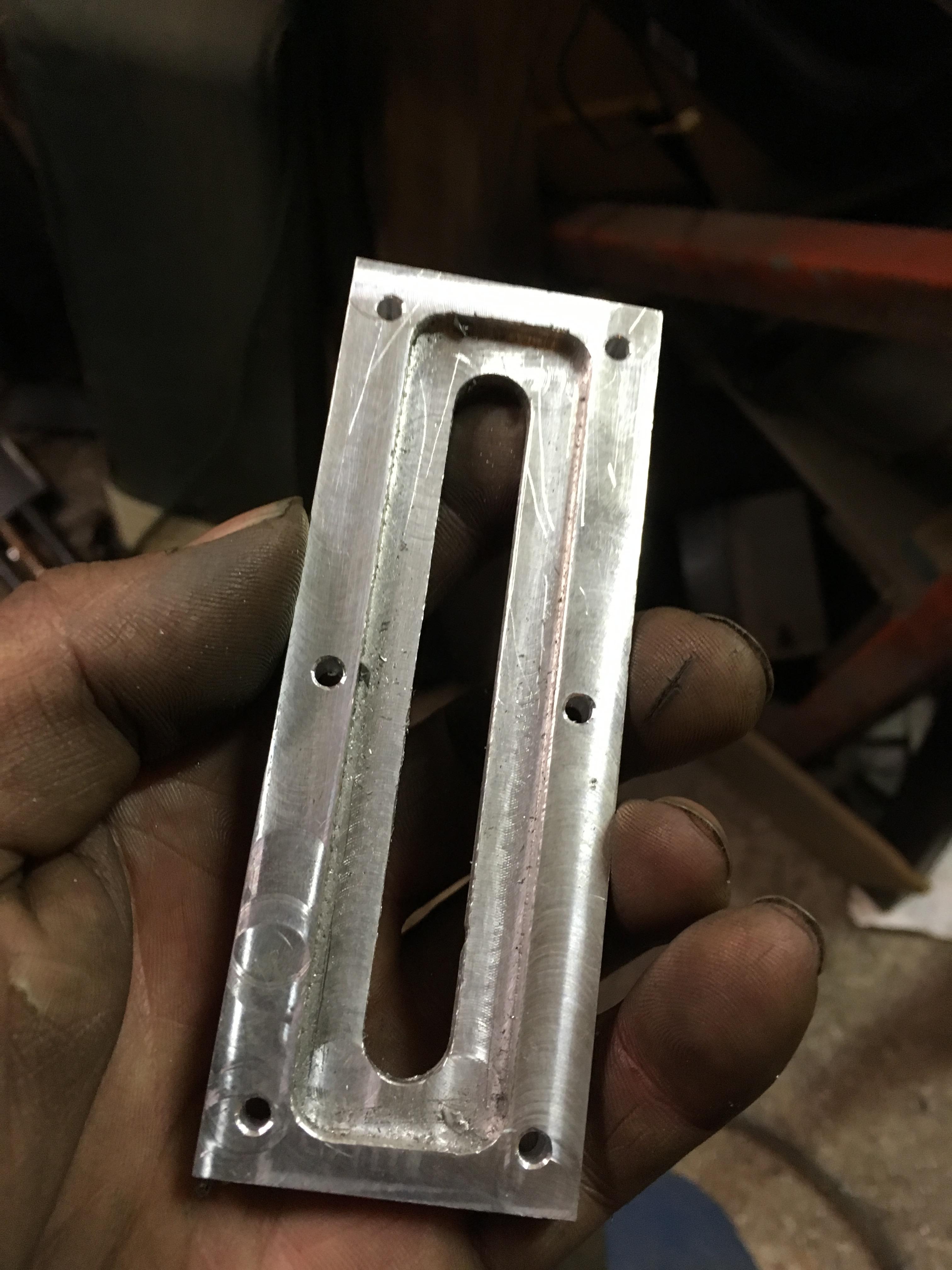

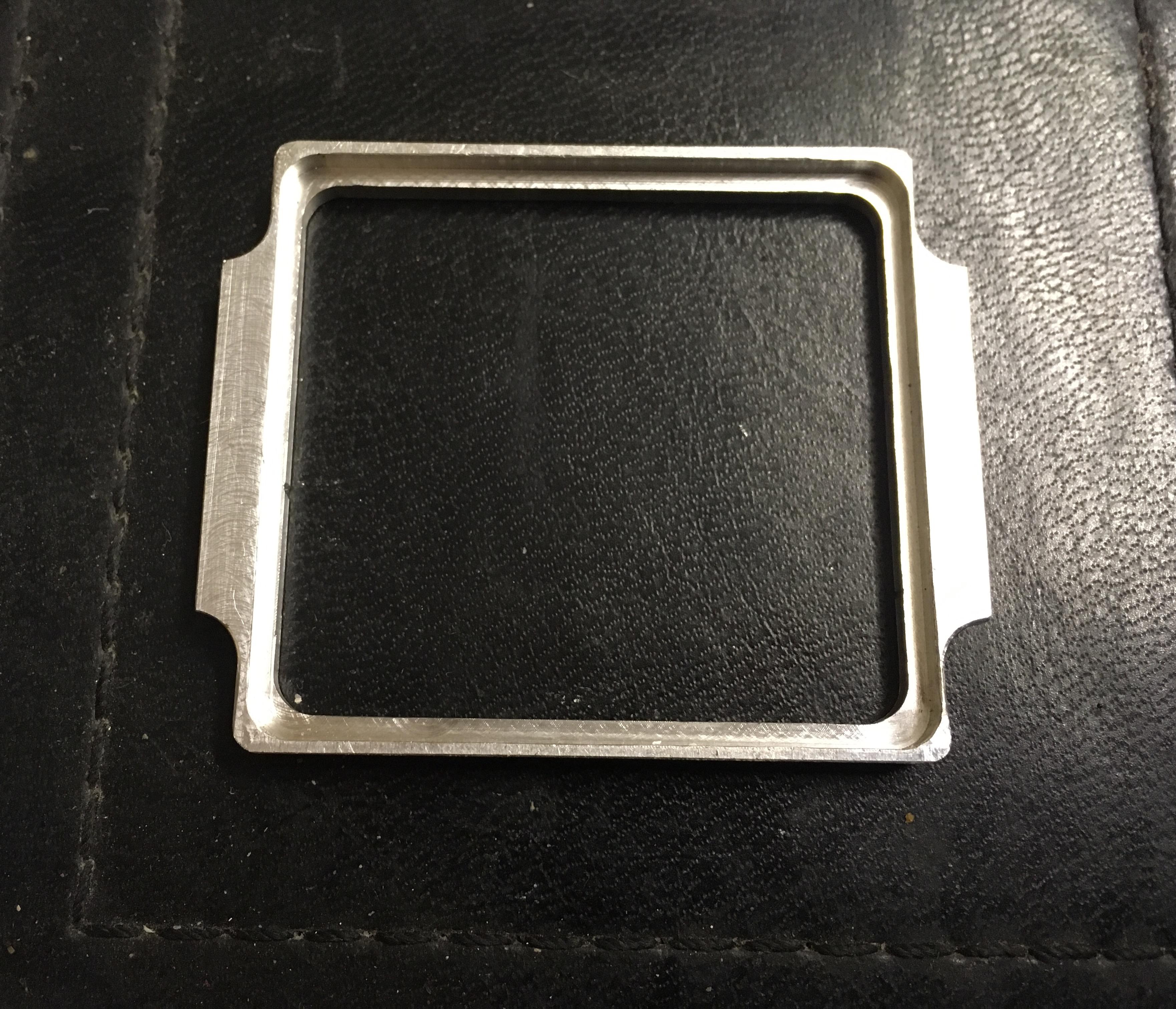

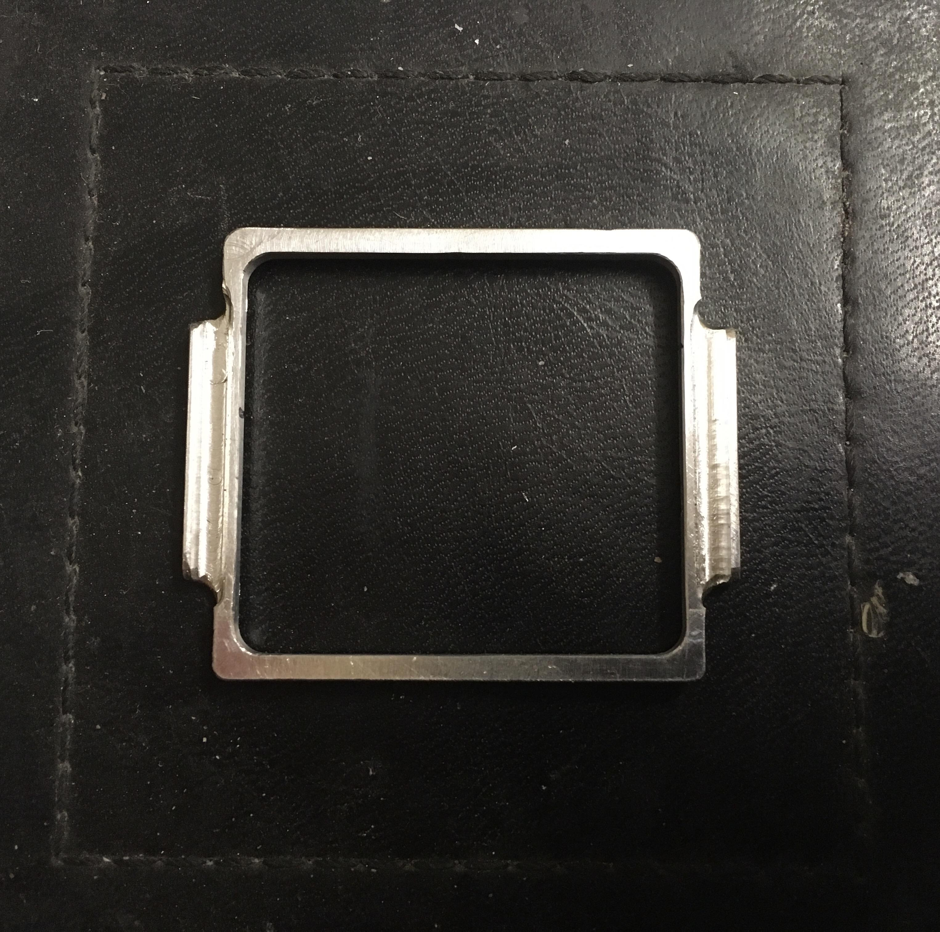

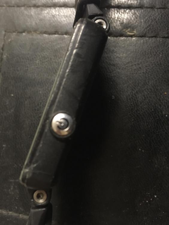

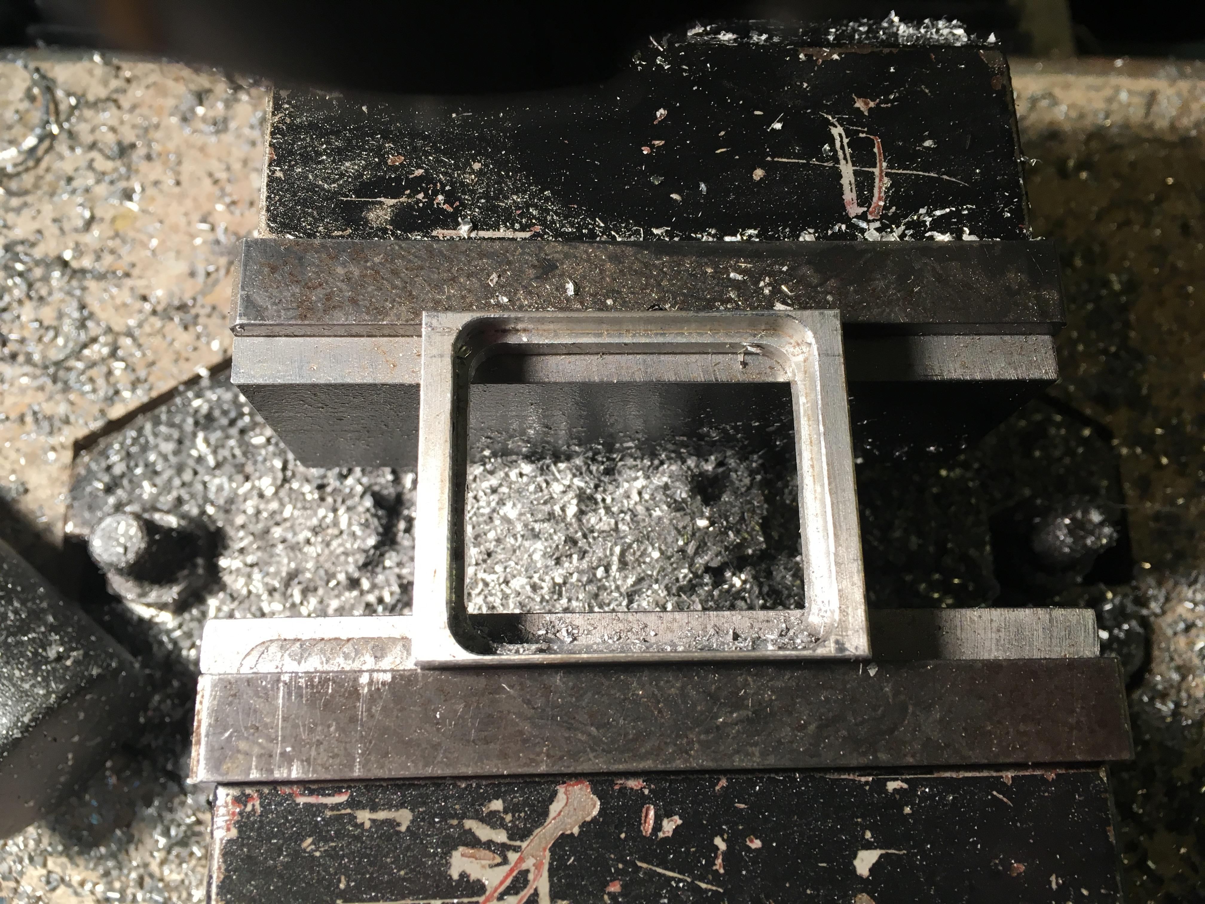

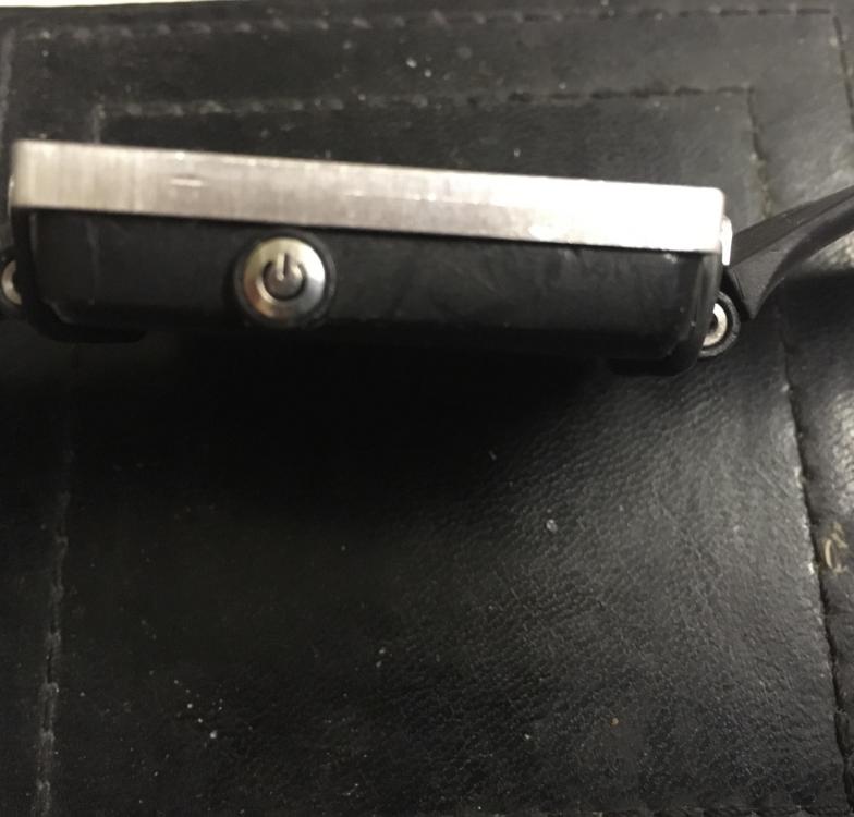

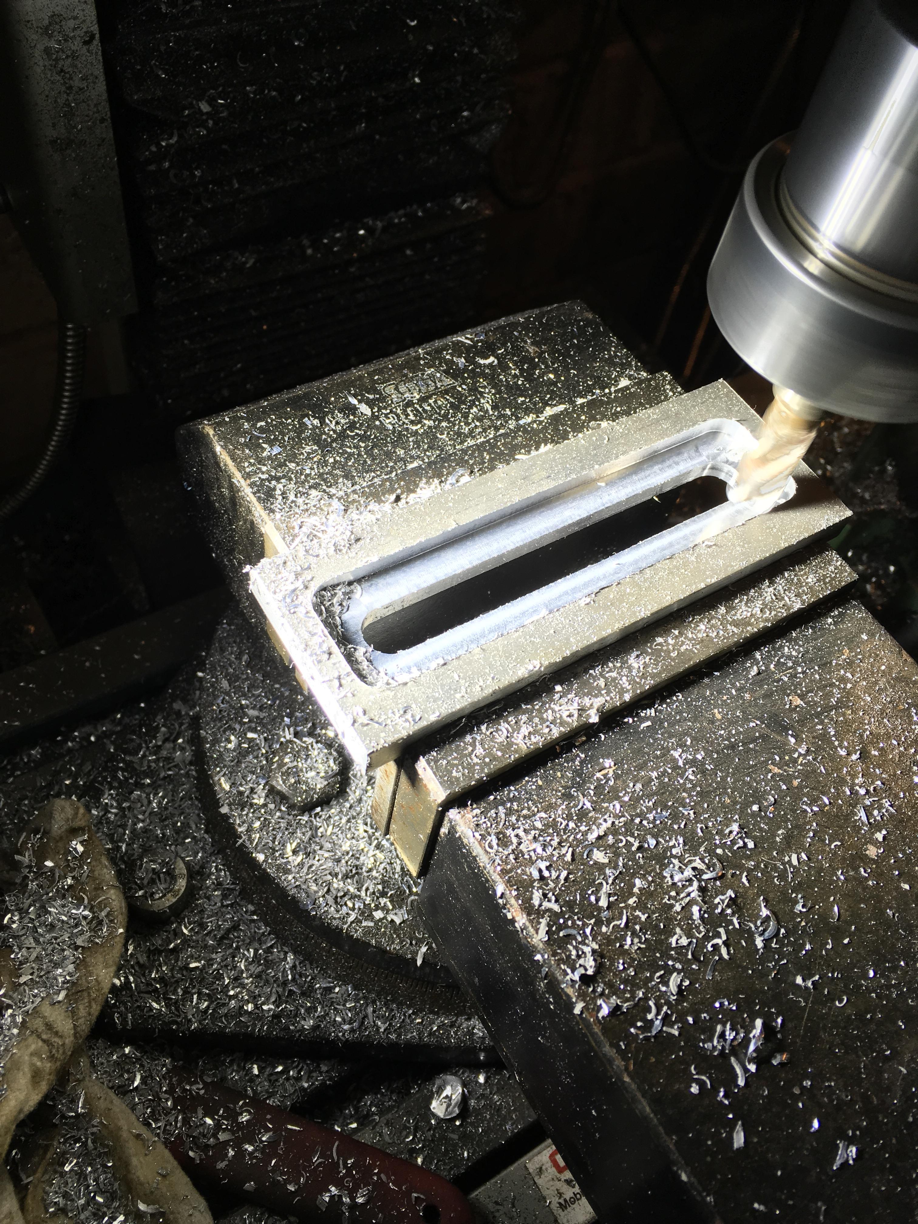

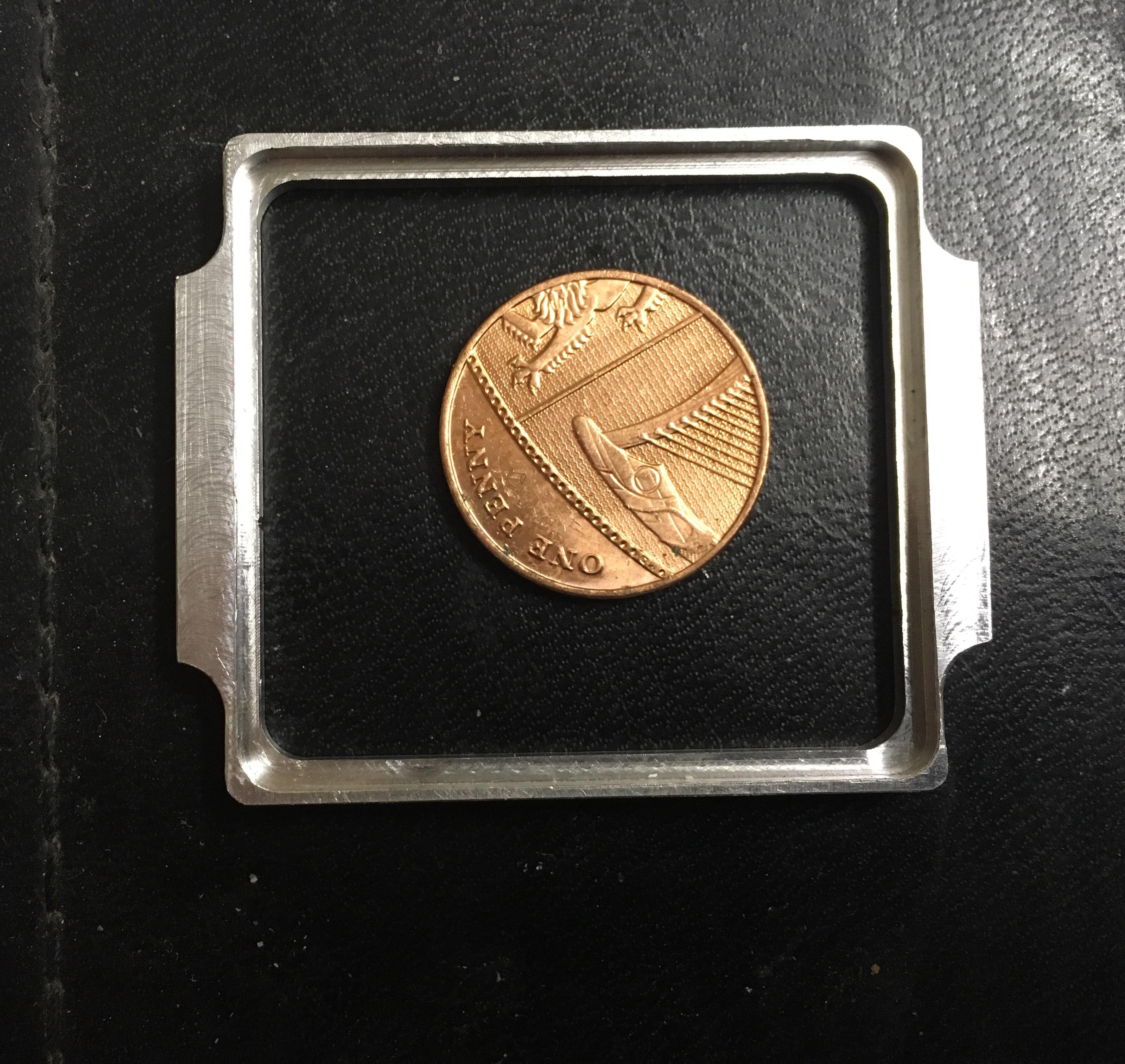

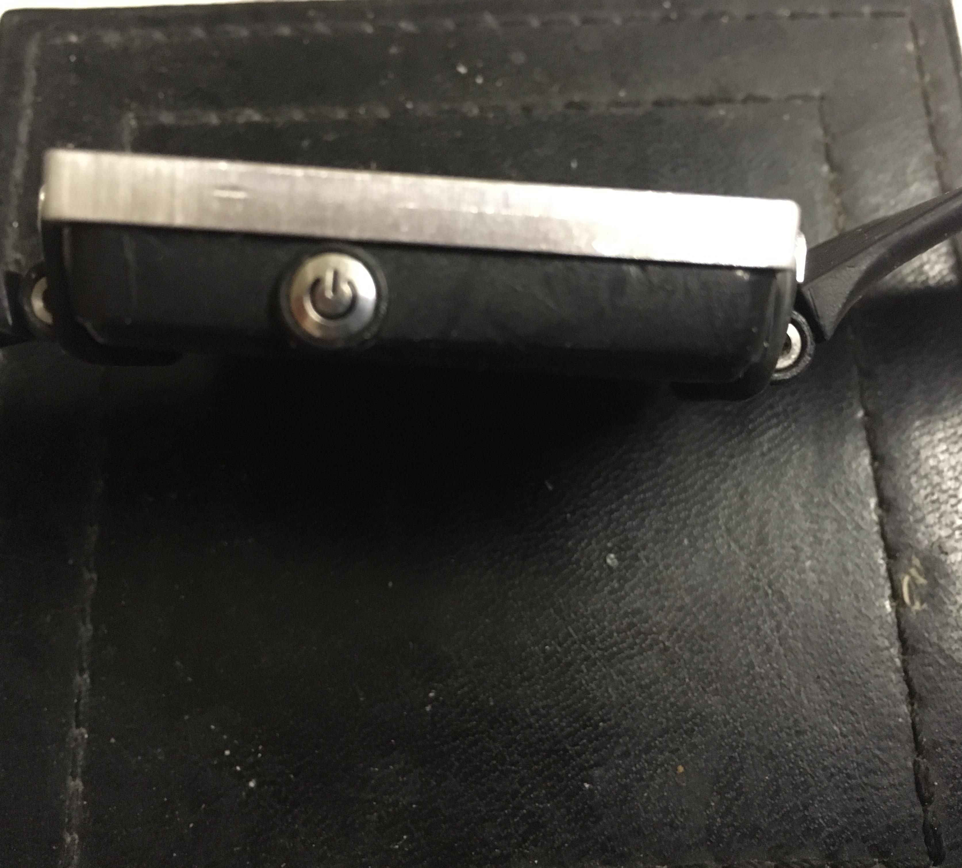

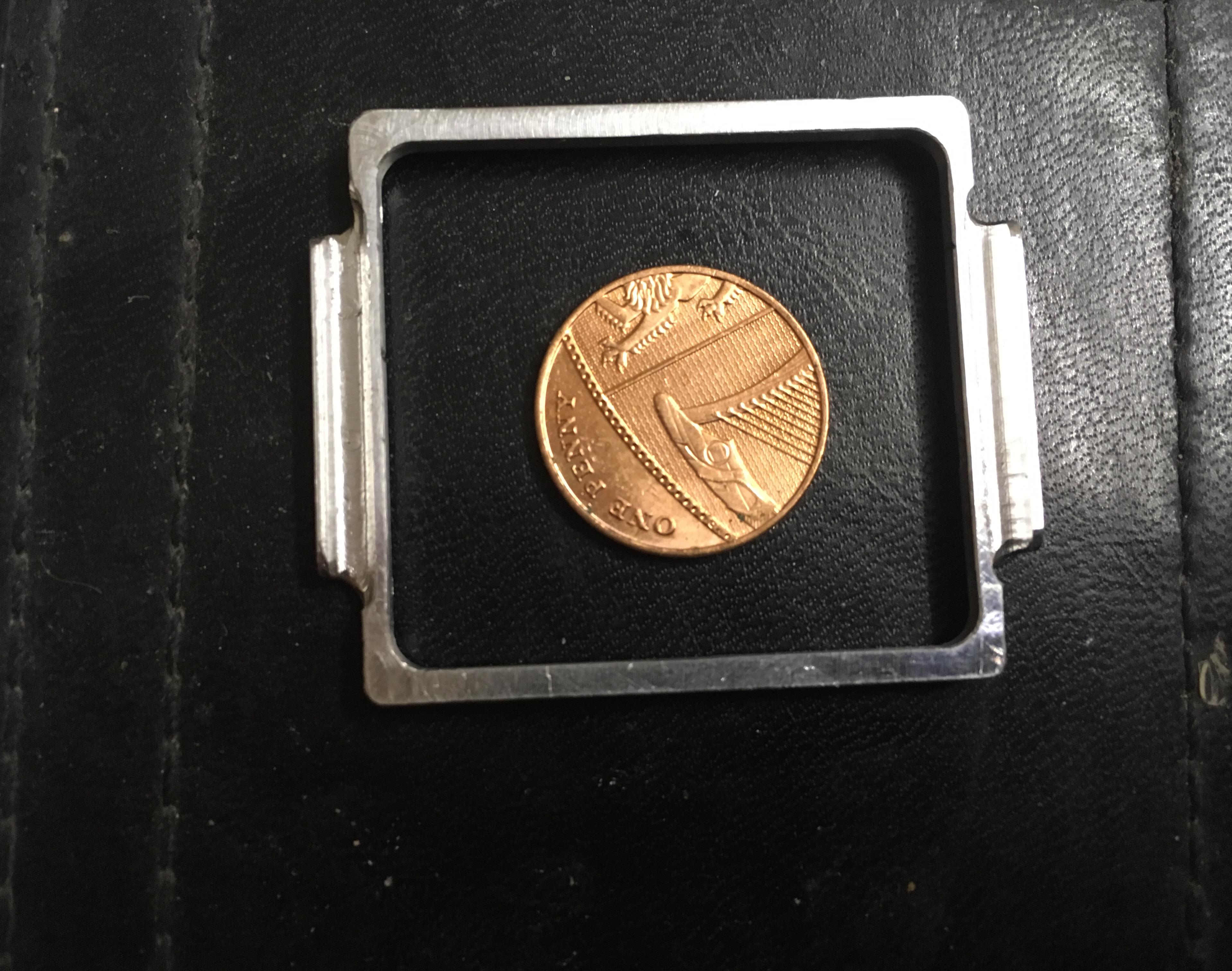

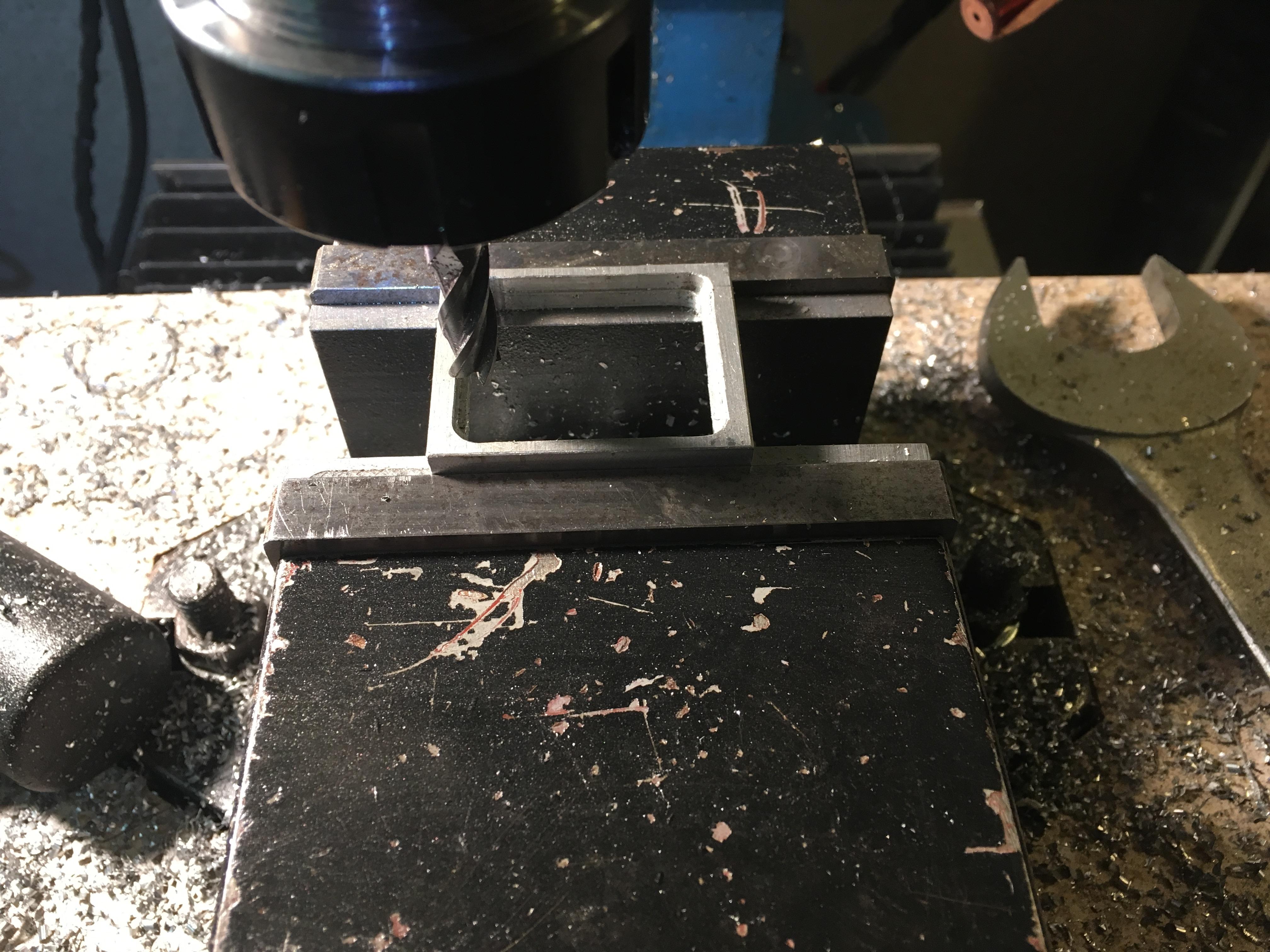

This is a edge protector I made for my garmin vivoactive it works really well but I’d already broken the screen before I made it.

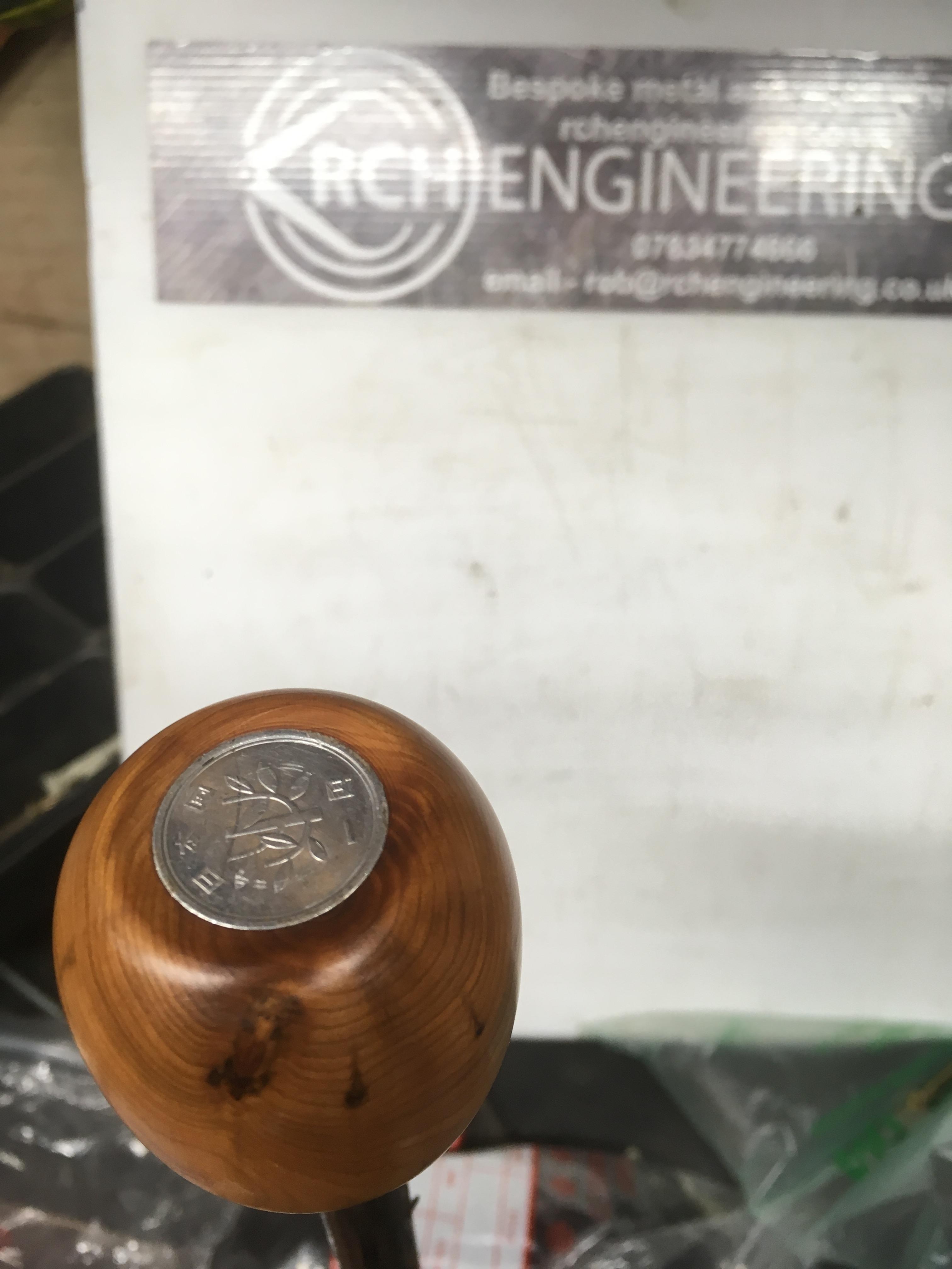

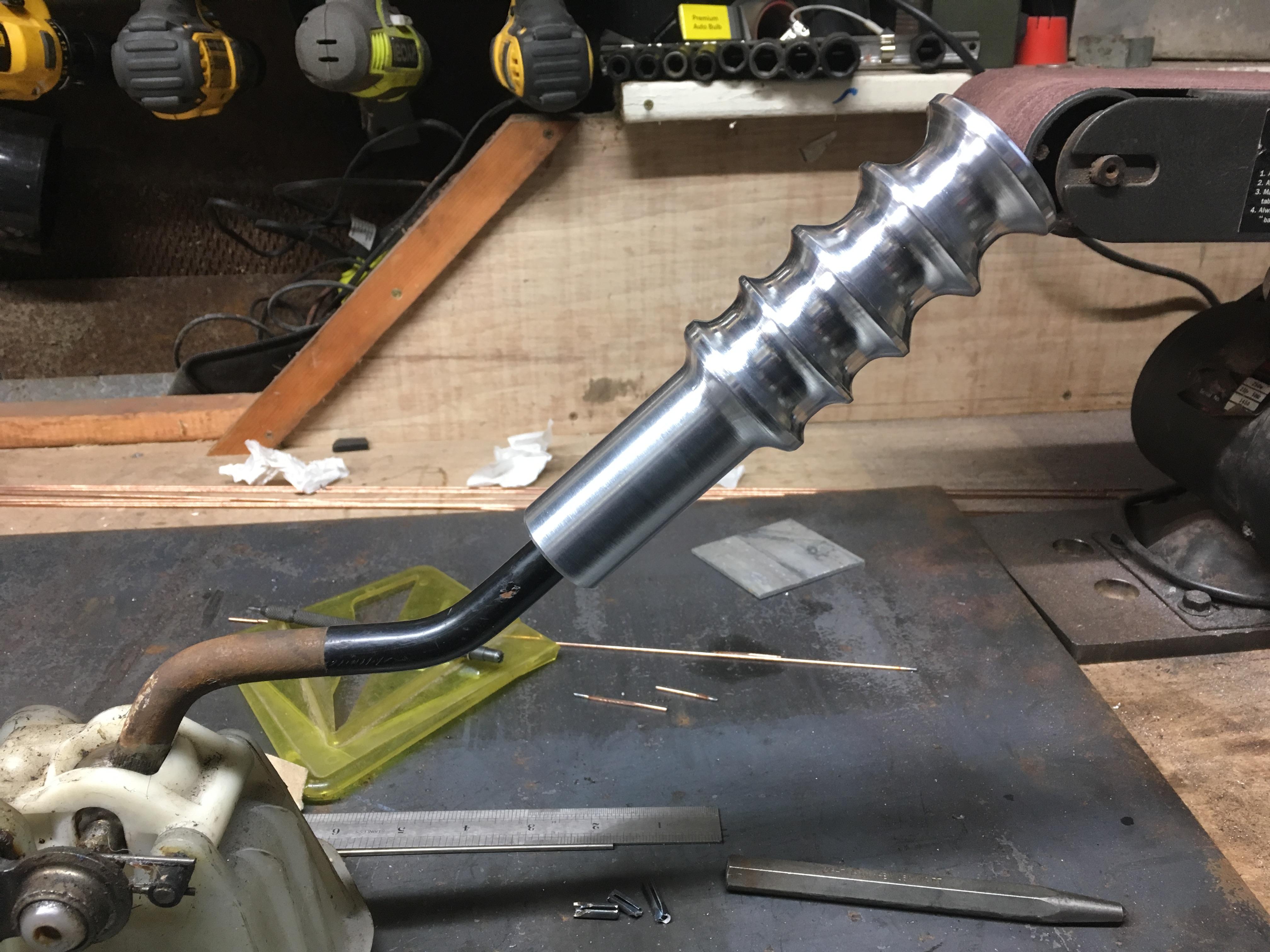

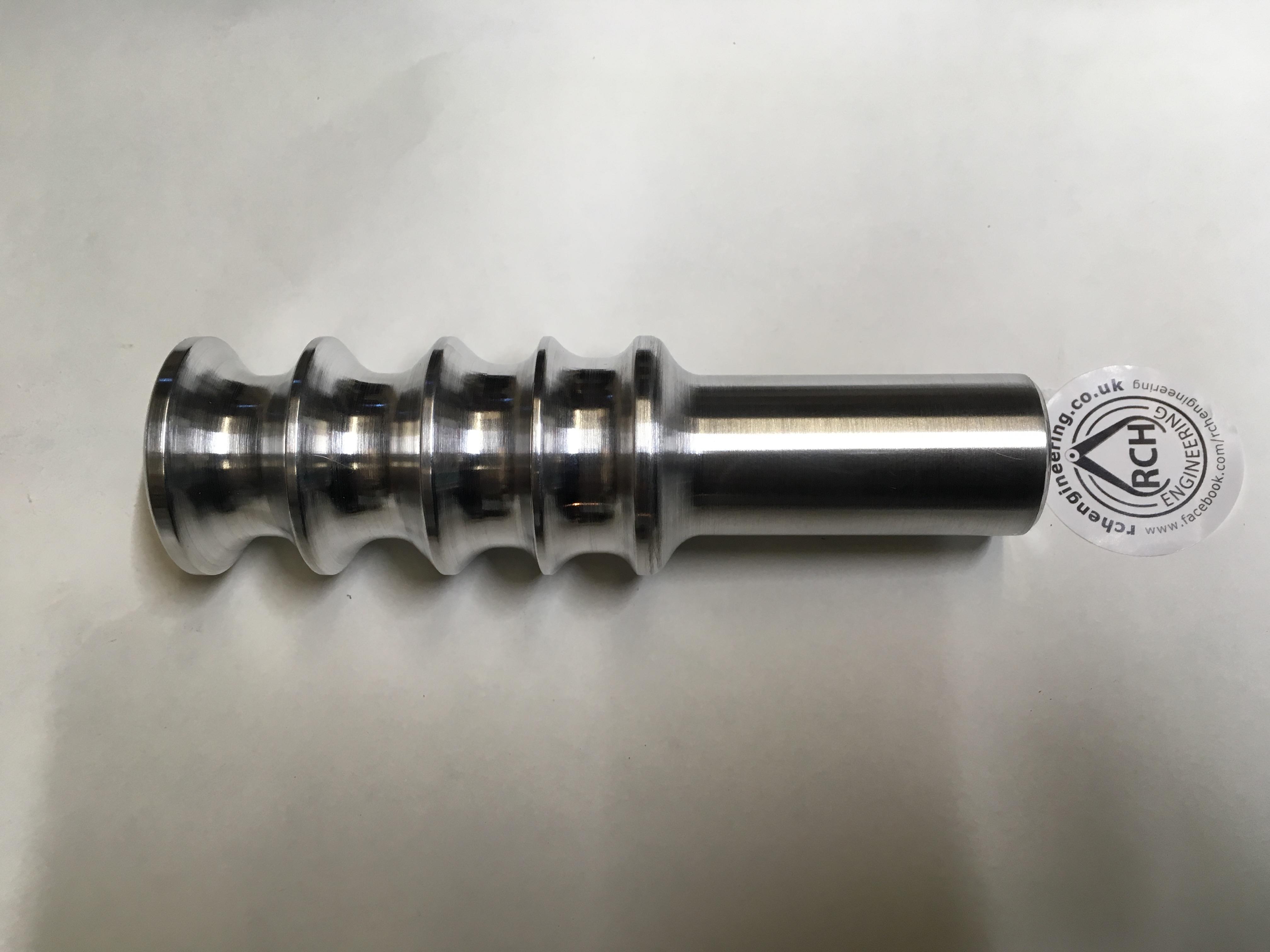

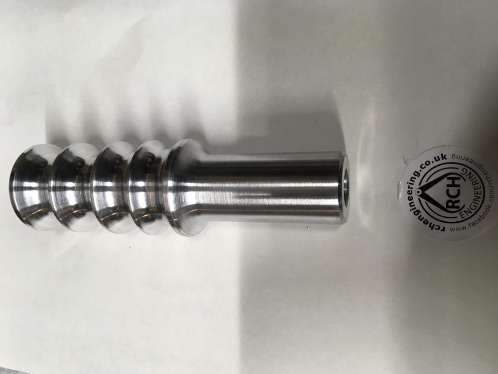

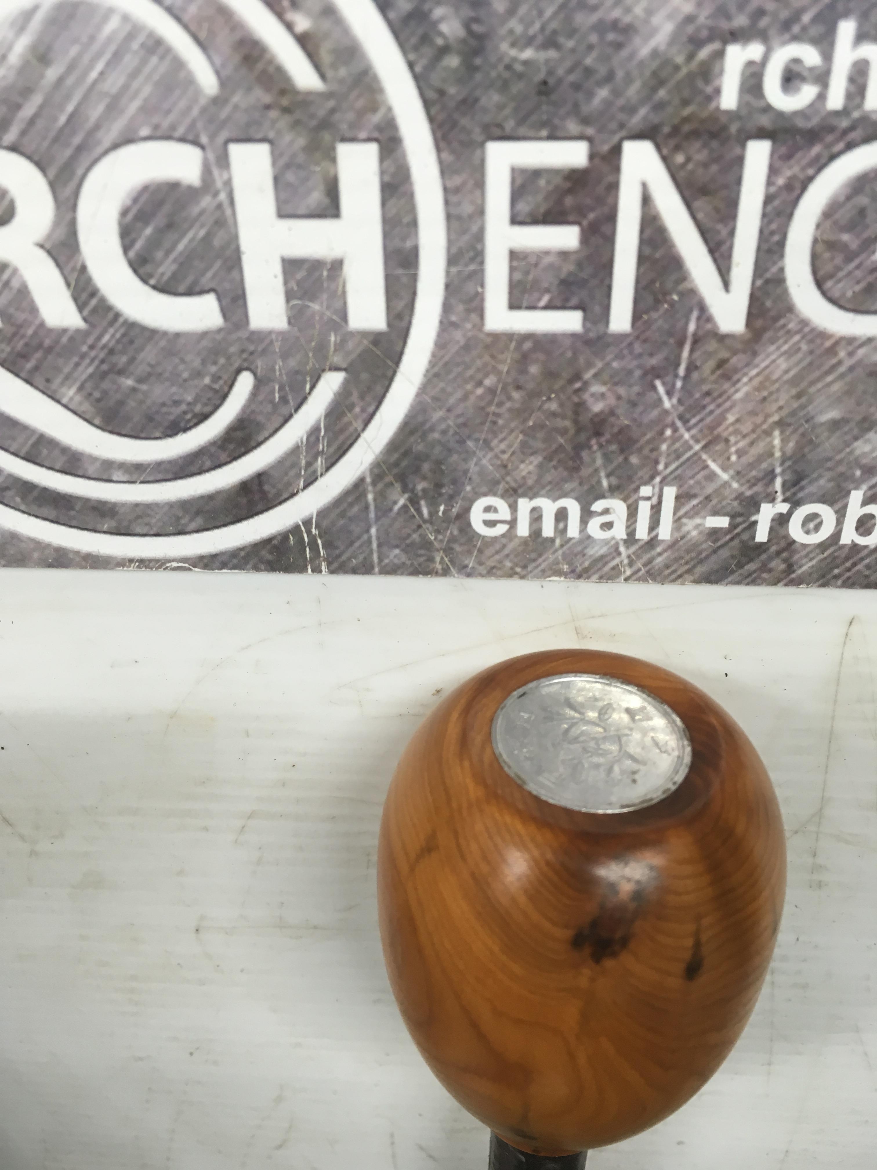

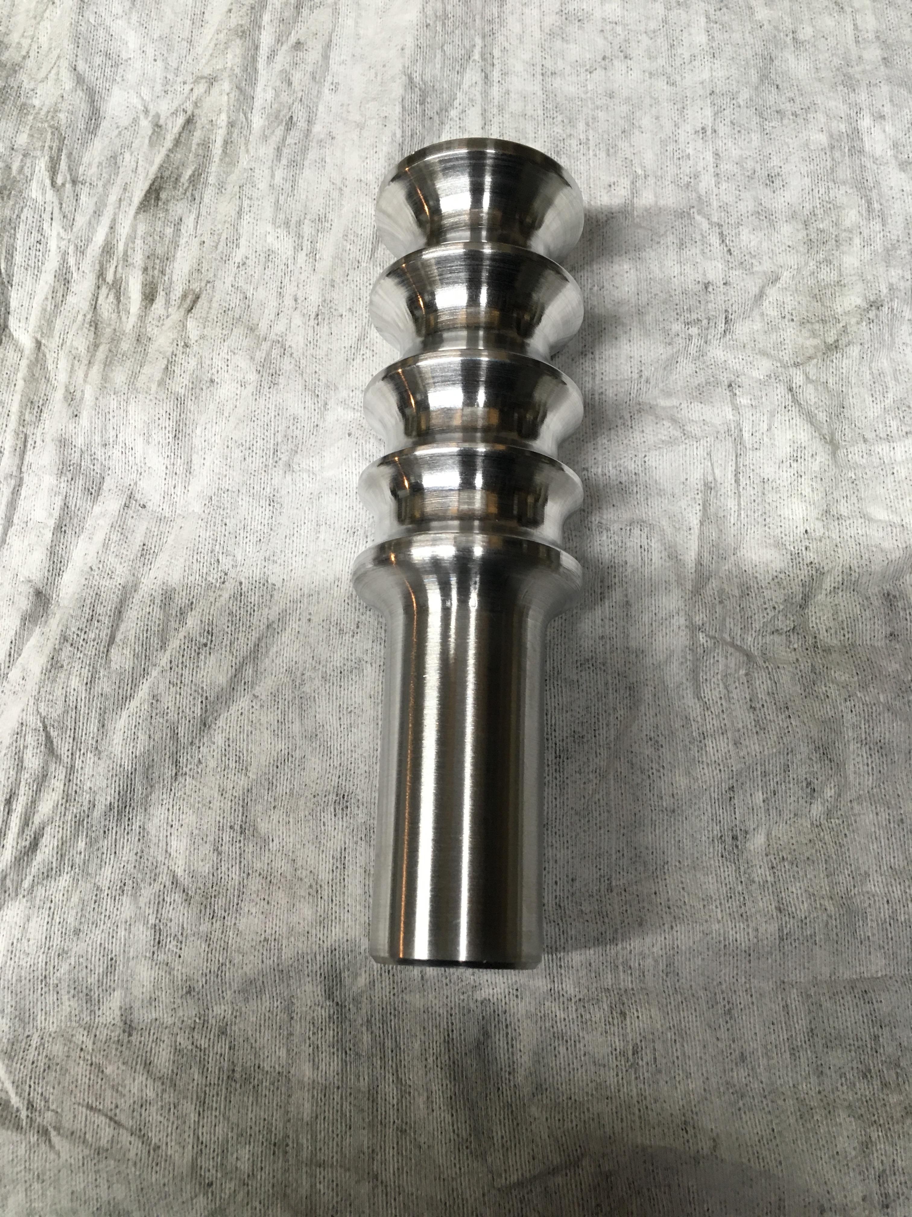

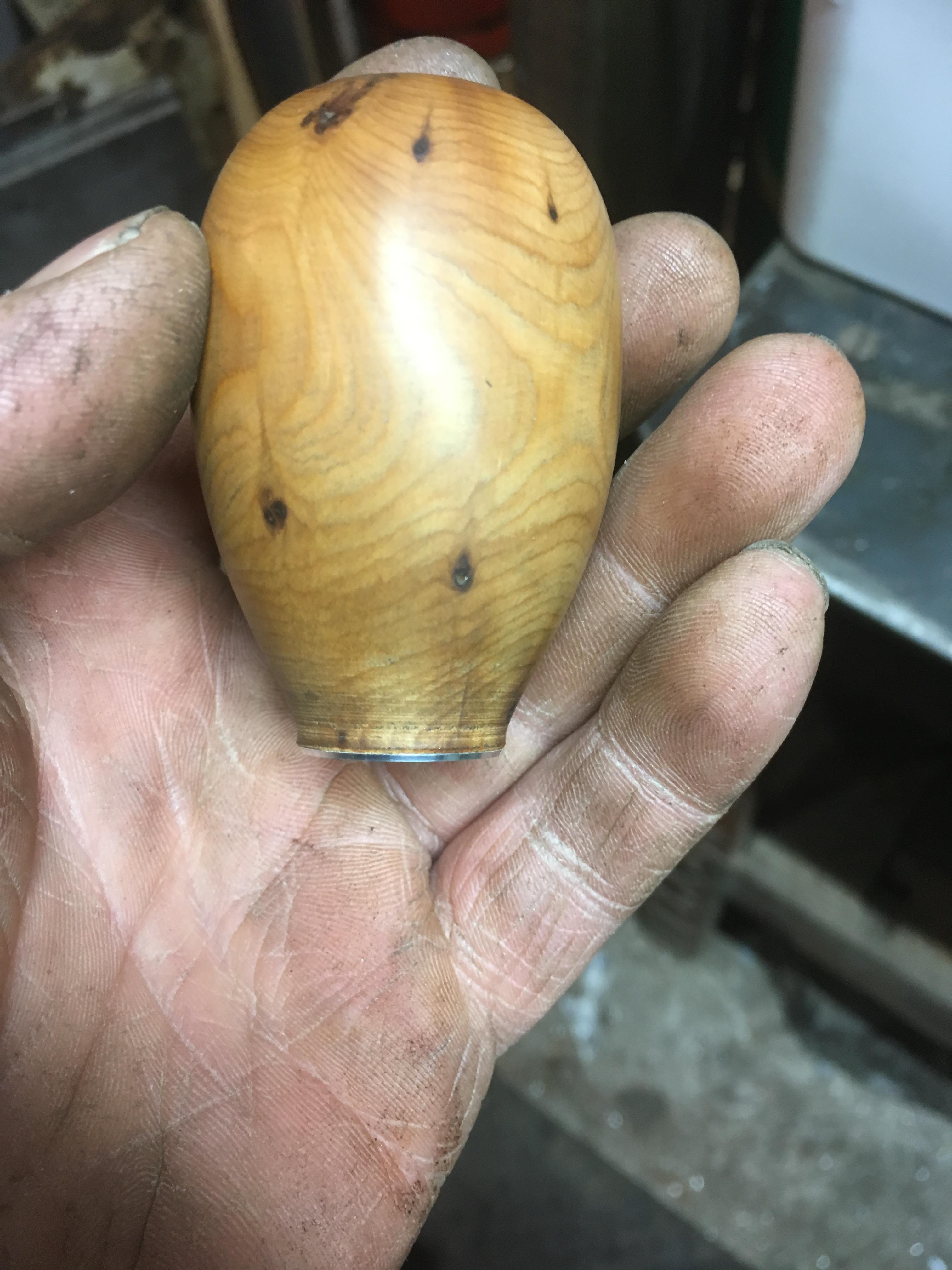

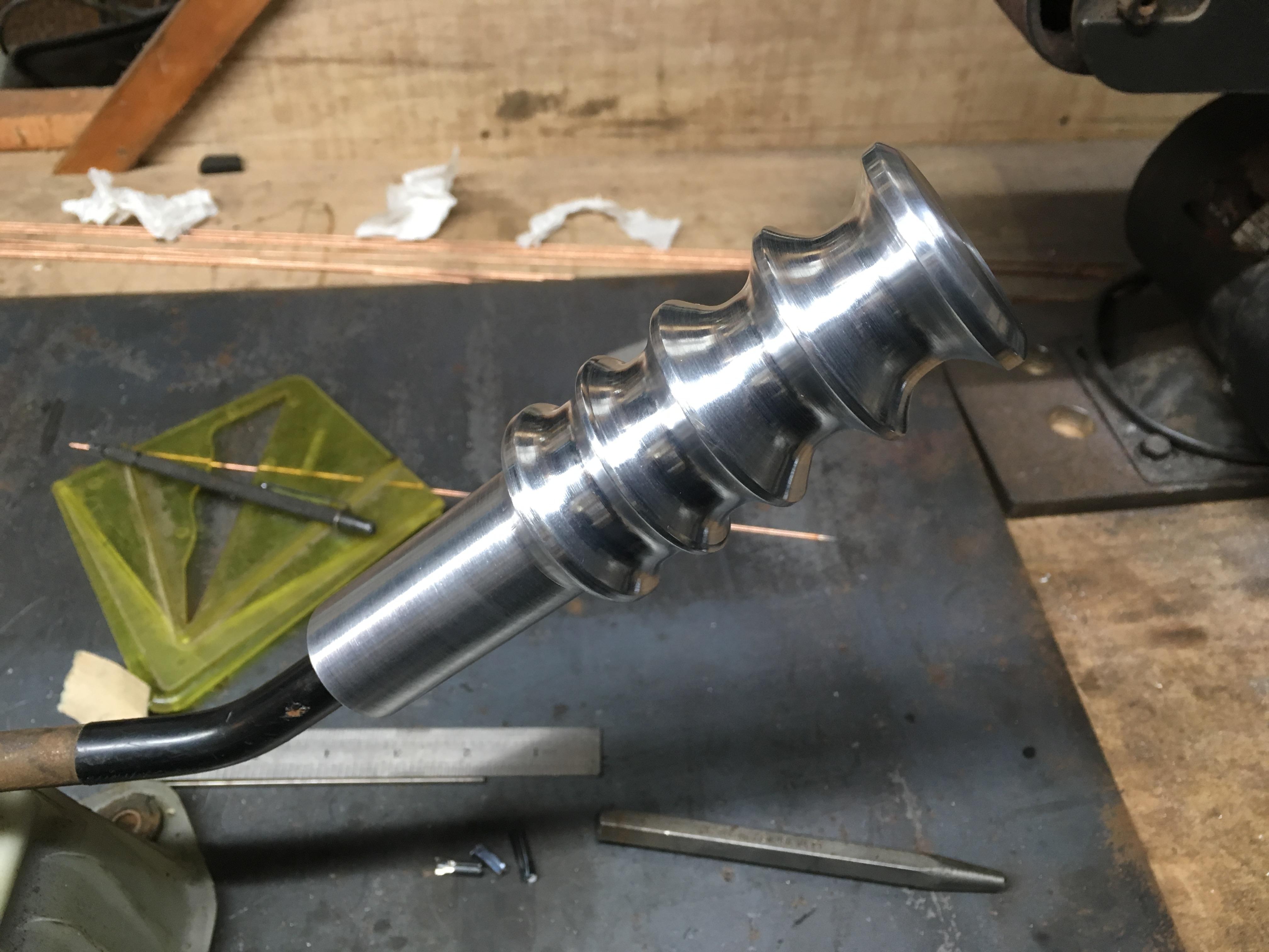

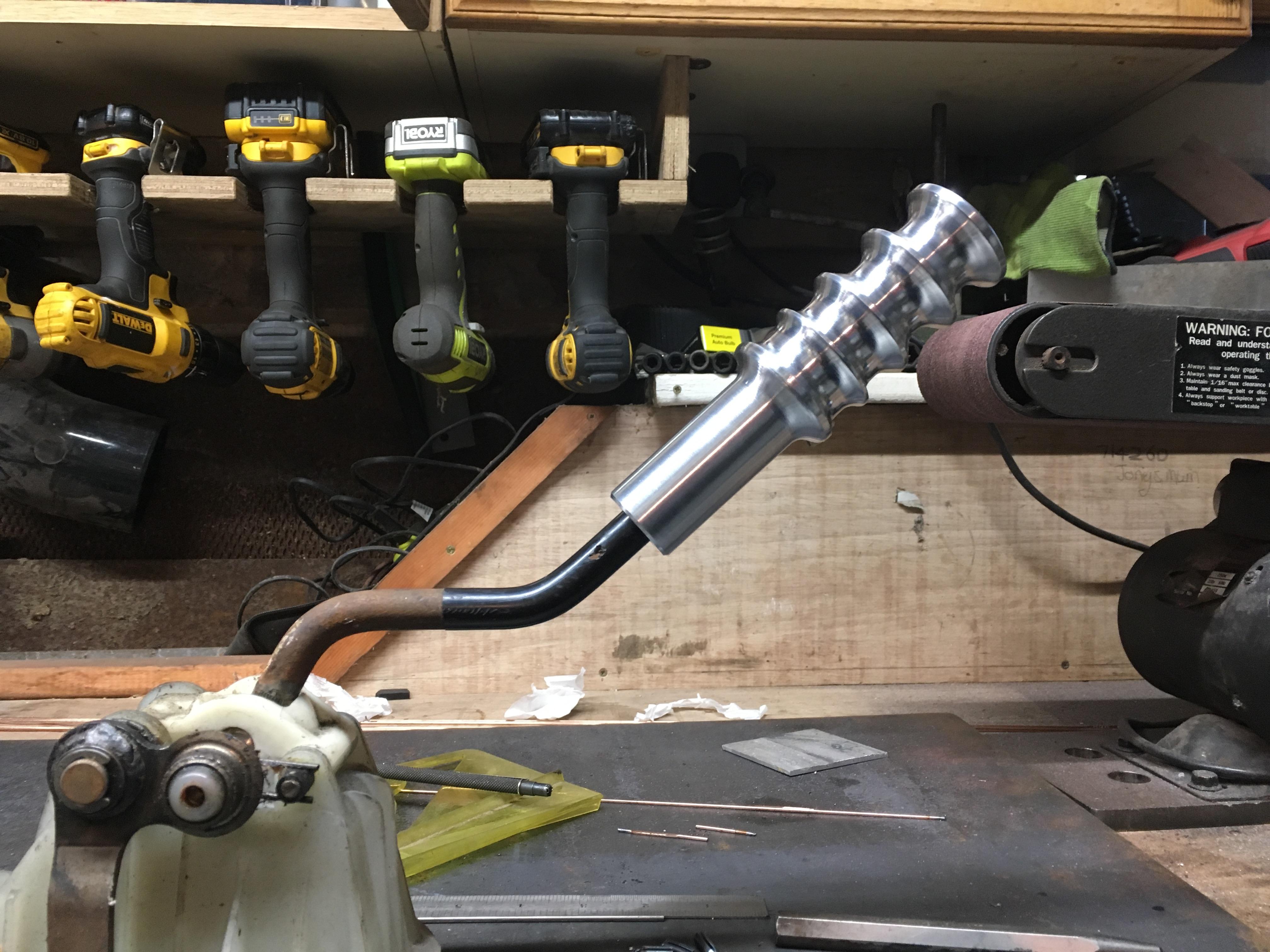

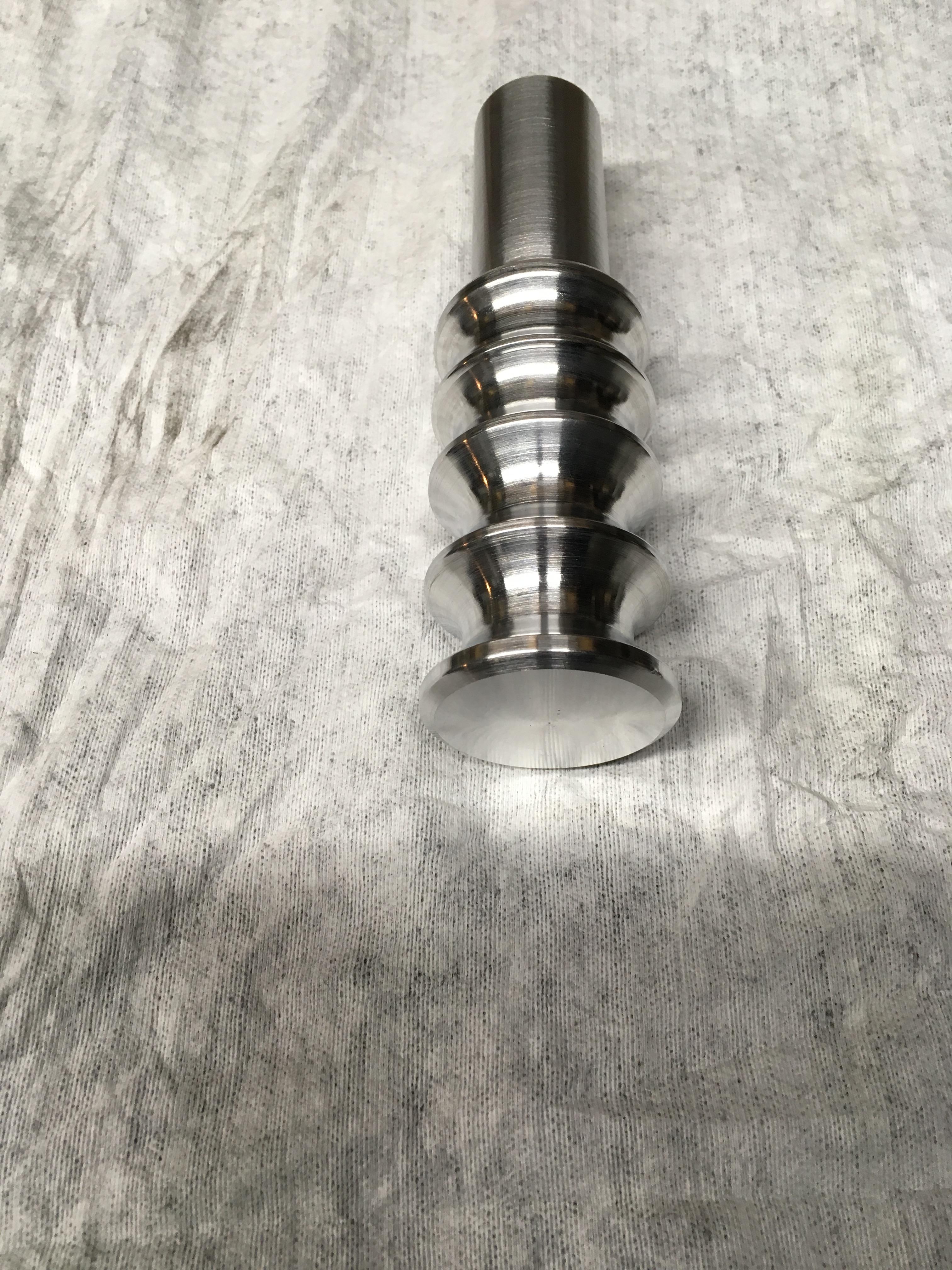

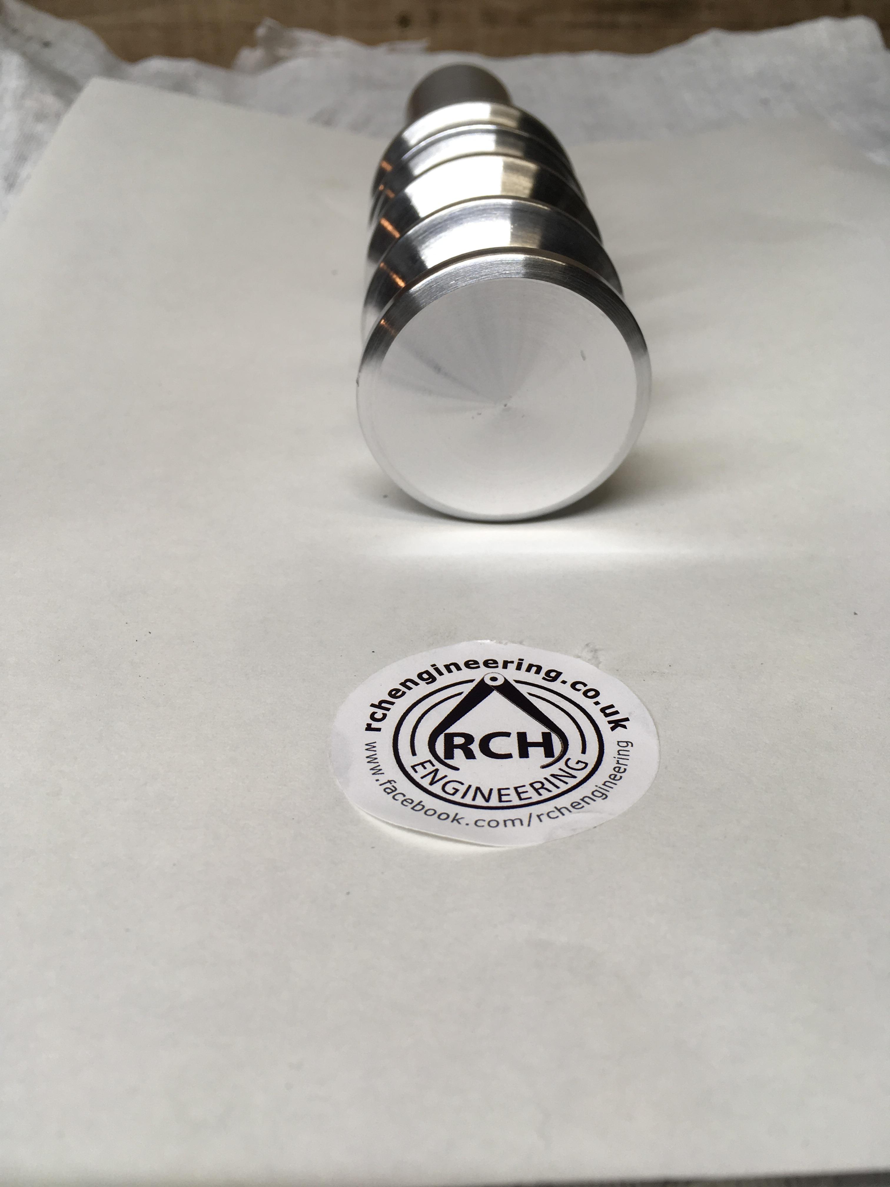

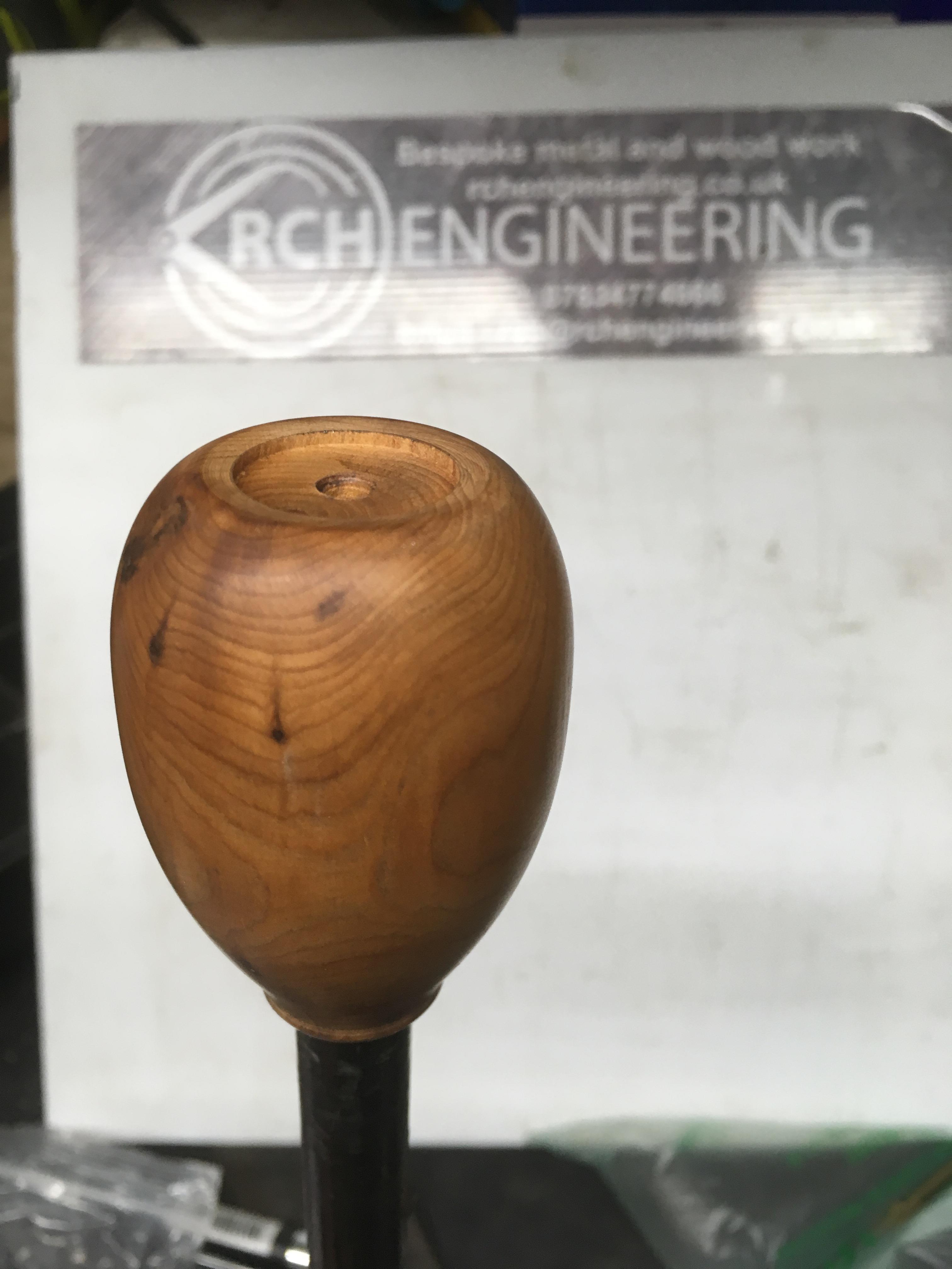

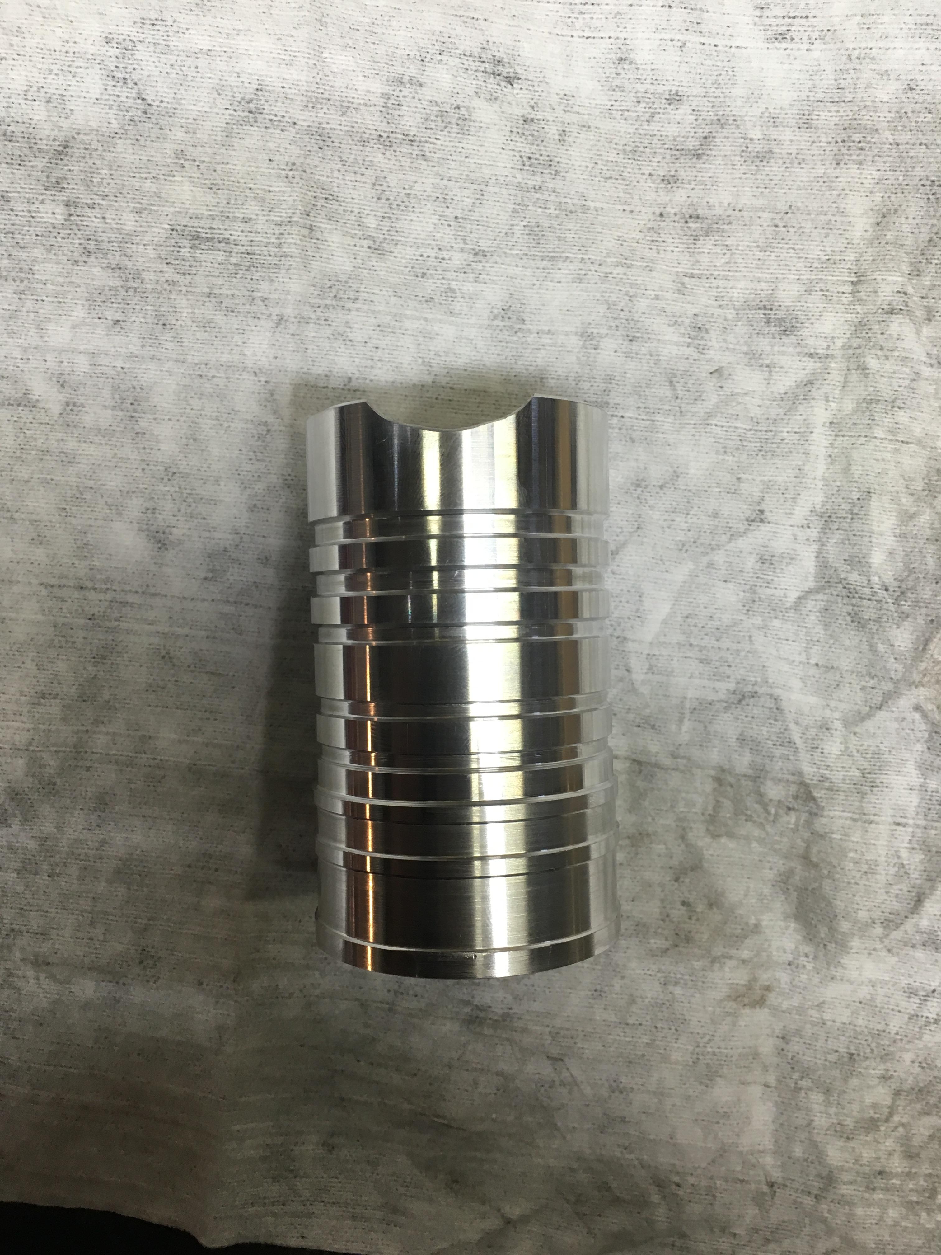

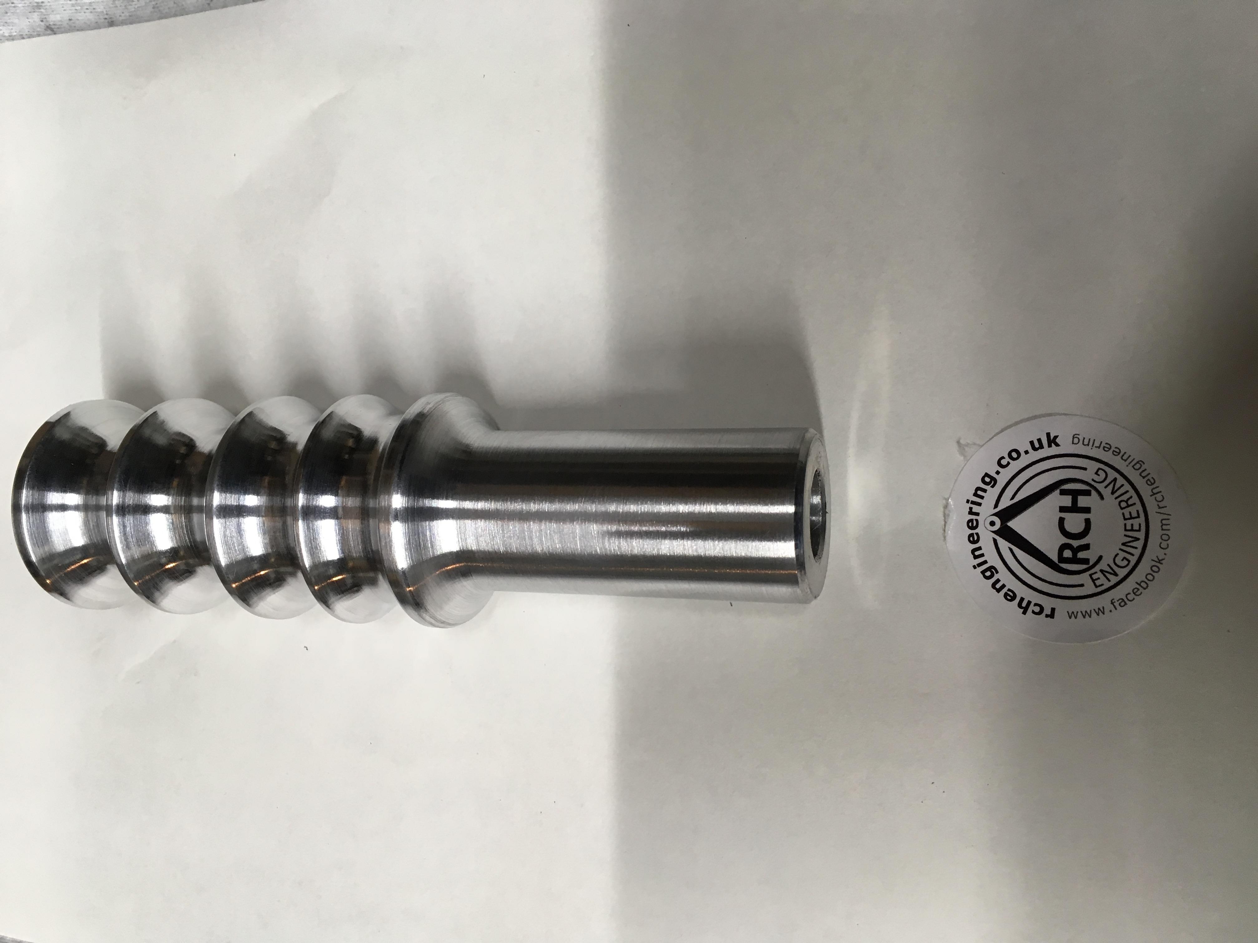

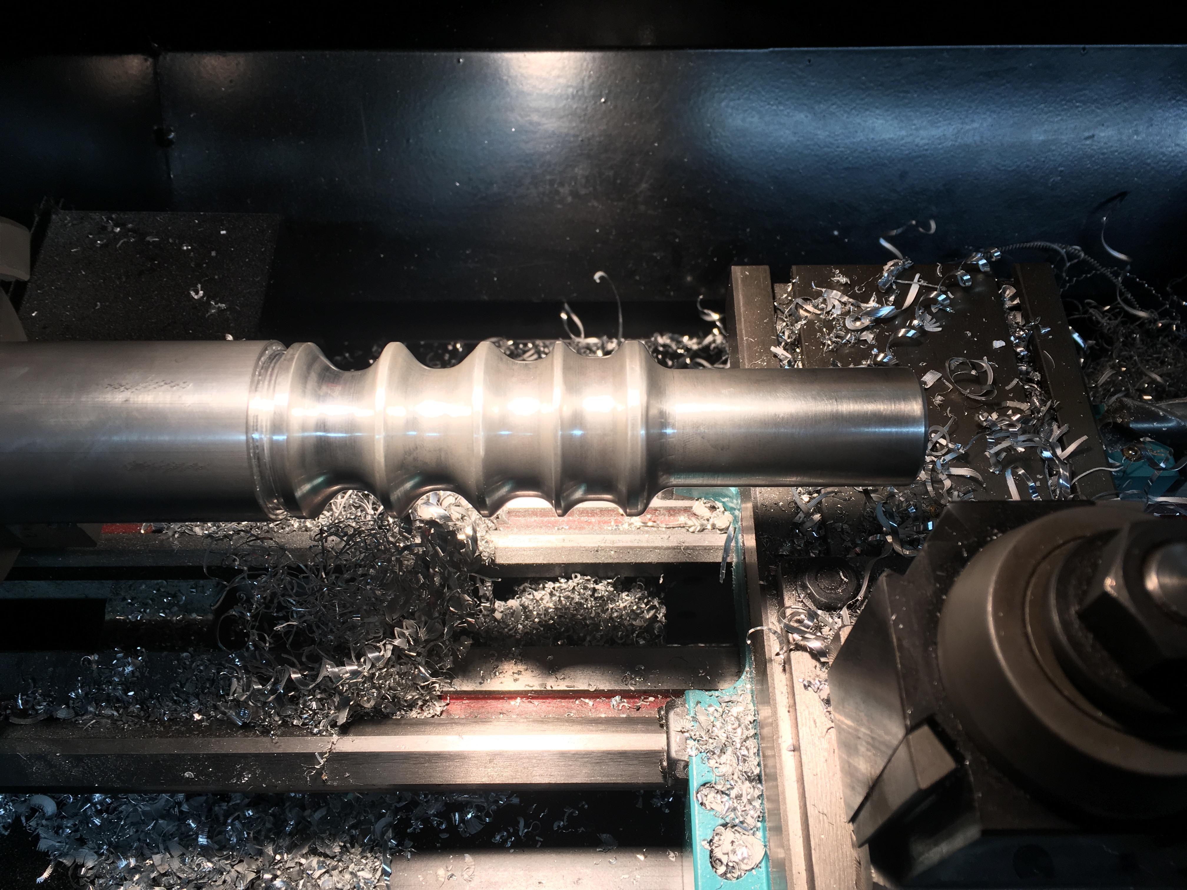

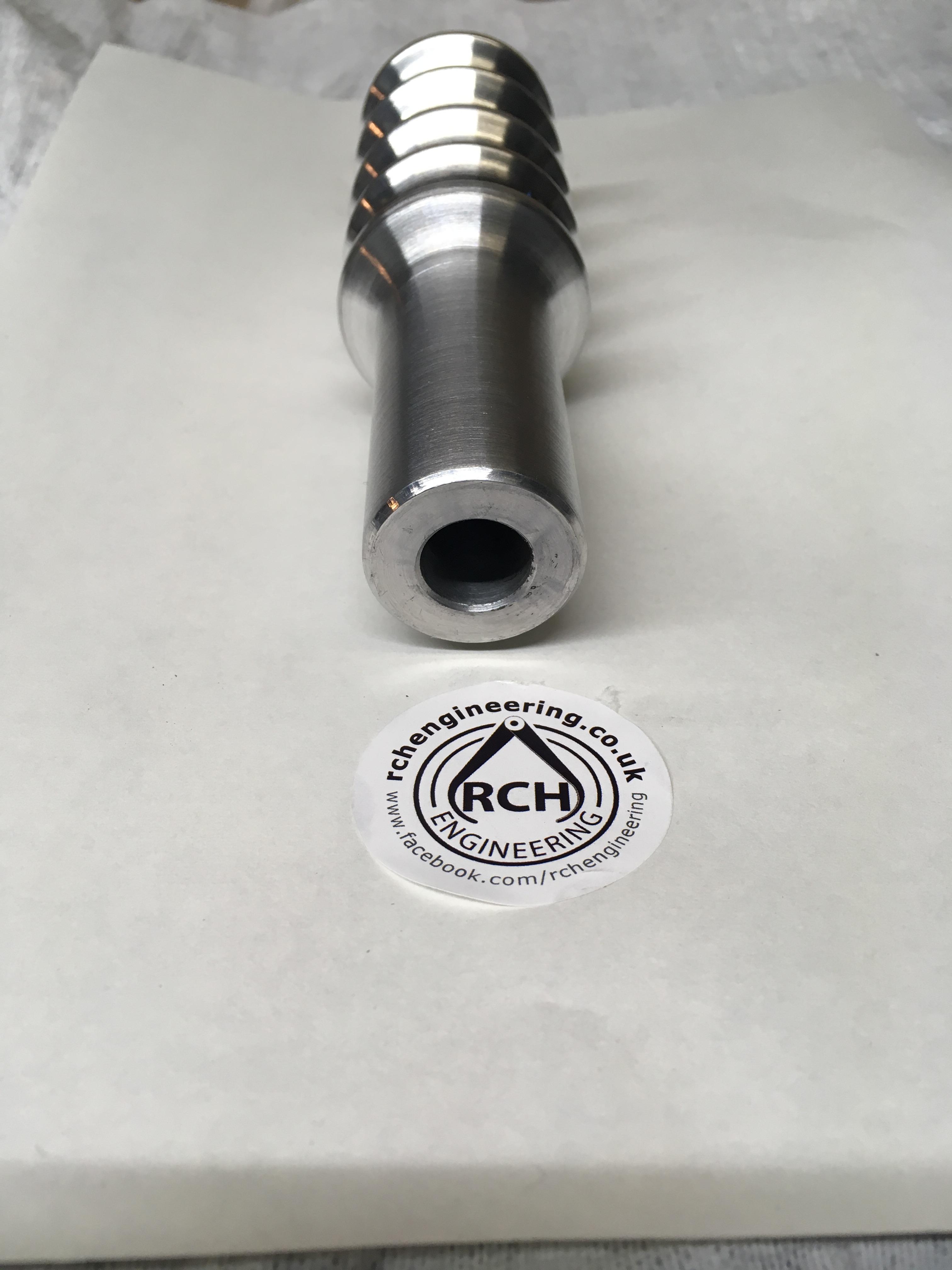

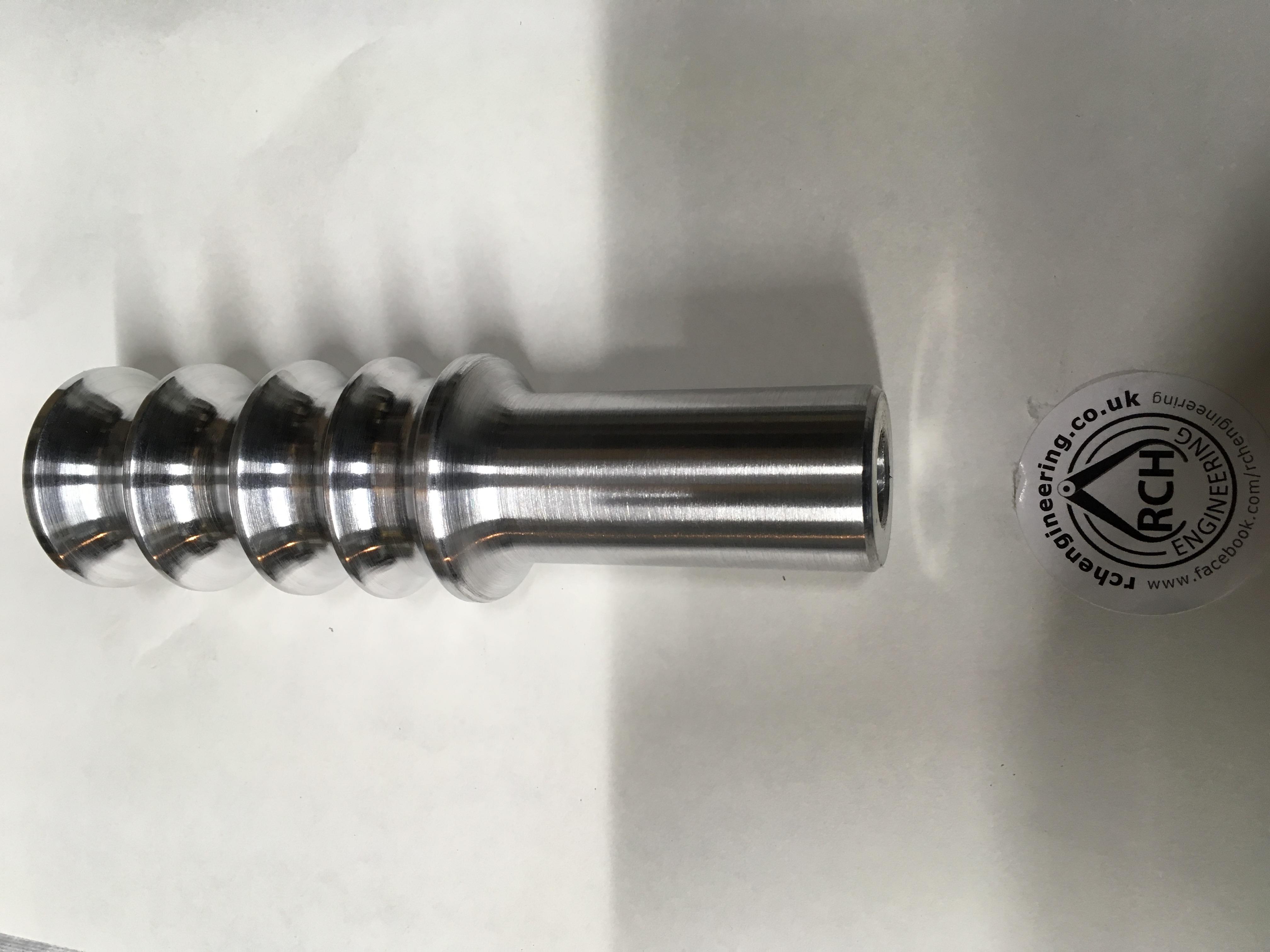

This is a gear knob I made for Matt of the forum, I made it shaped to his fingers too!

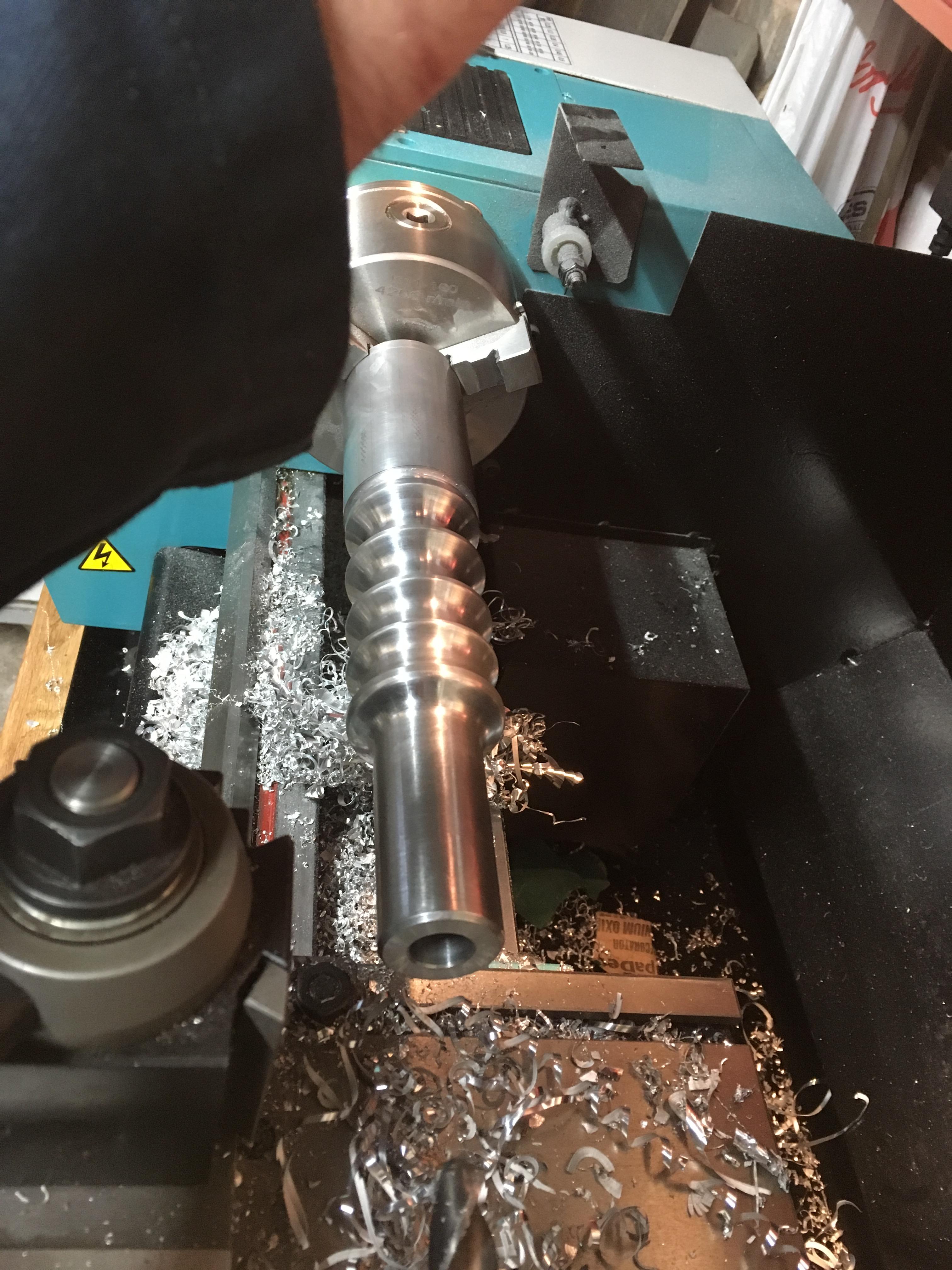

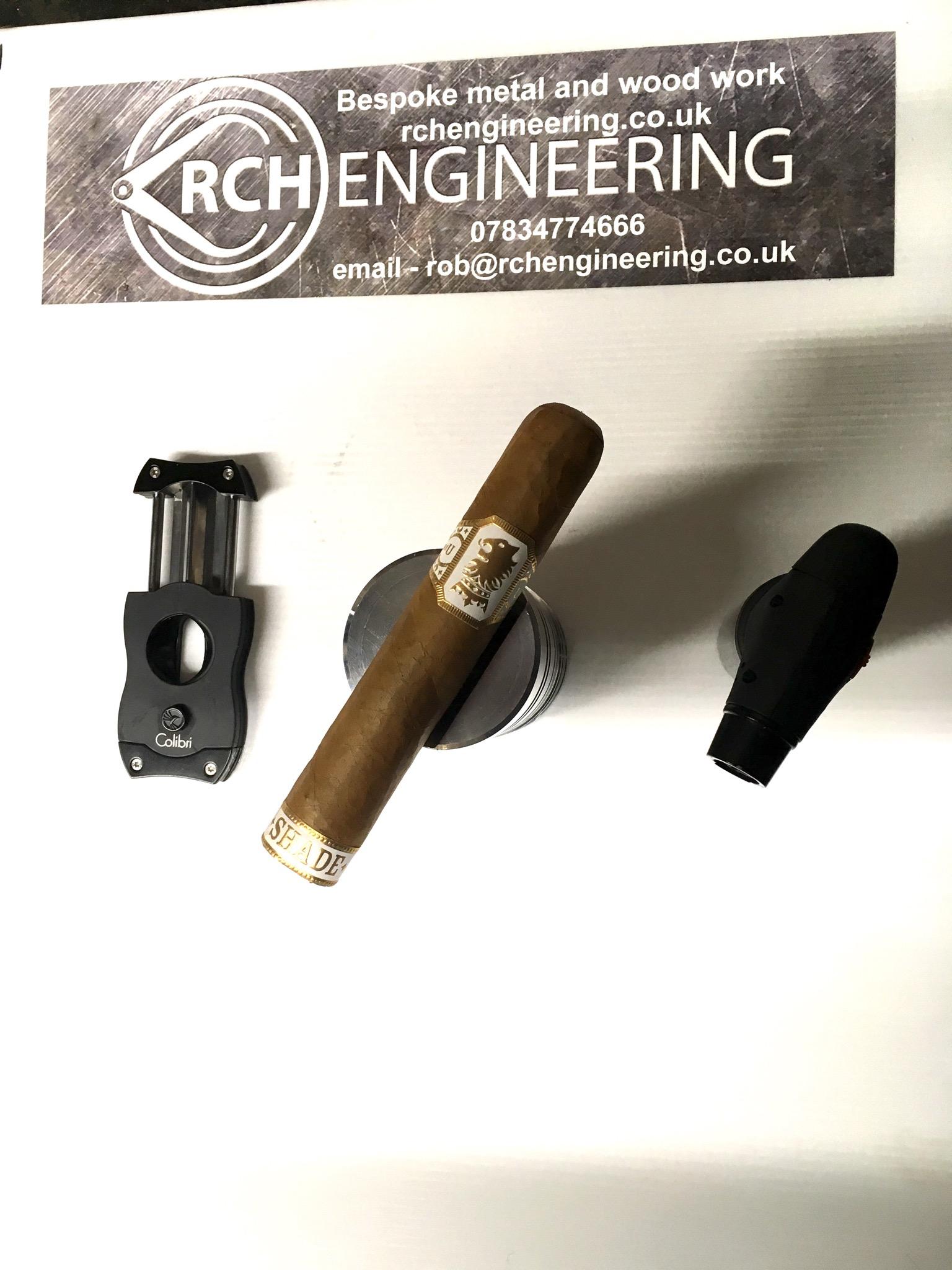

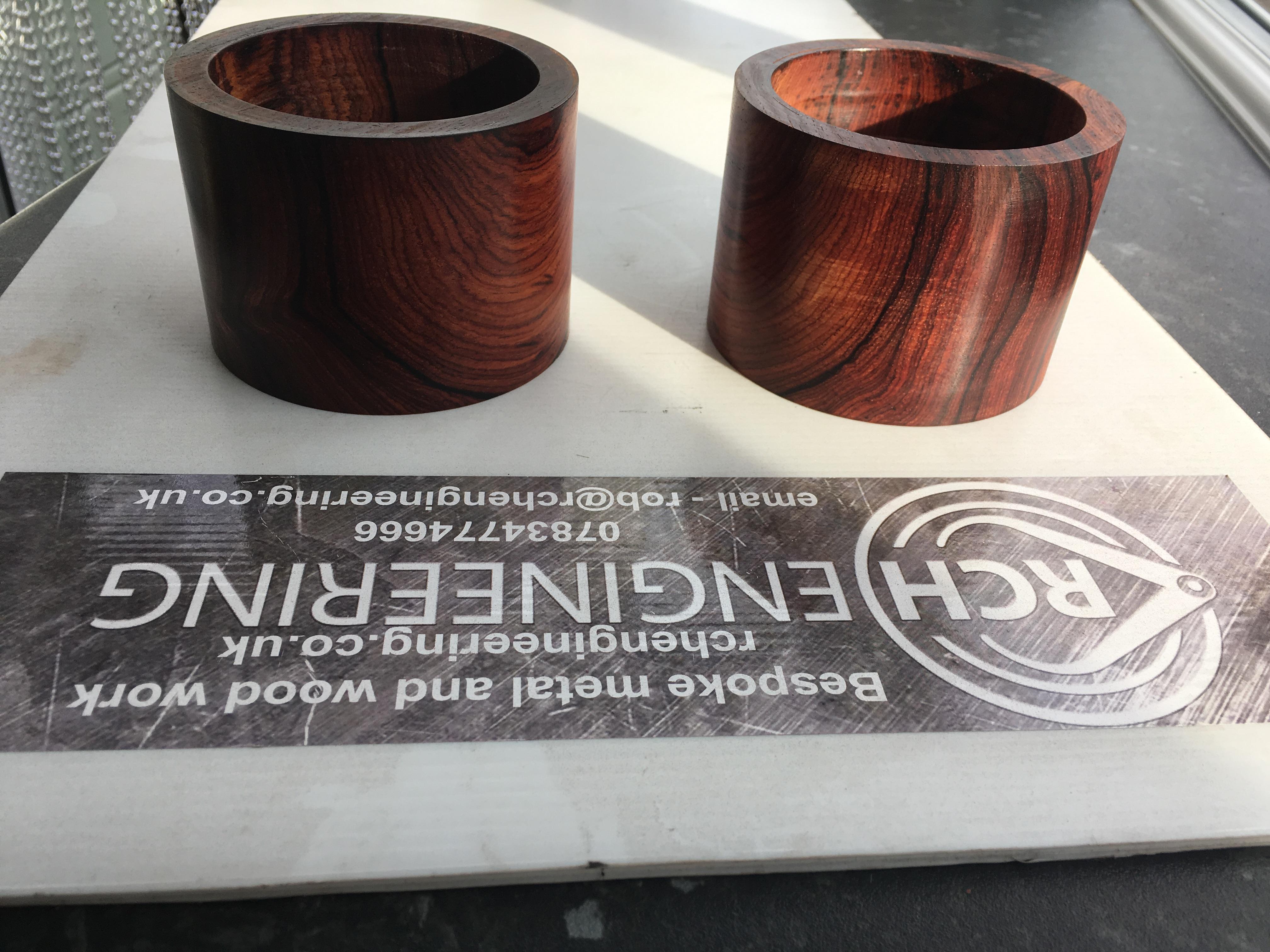

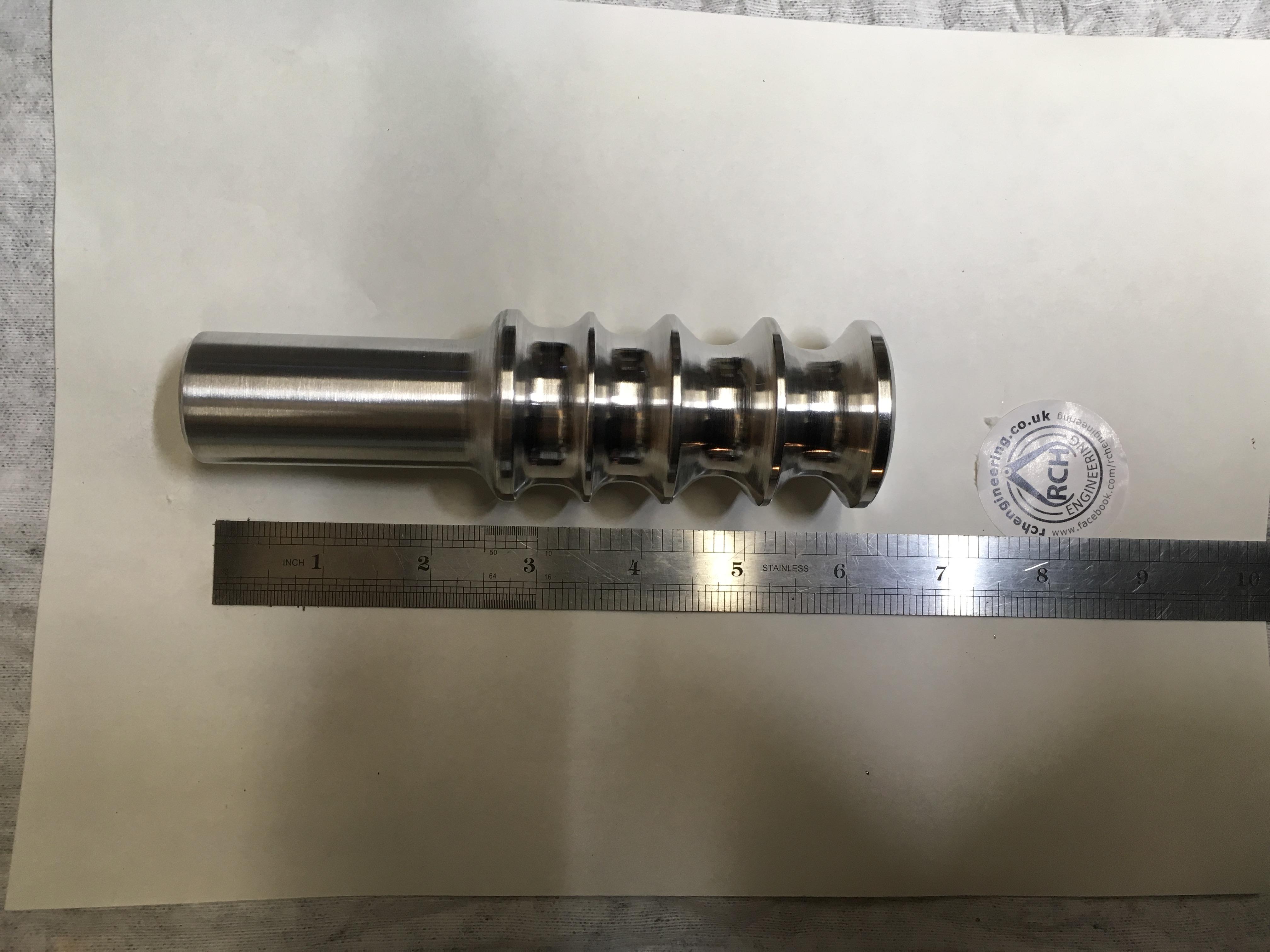

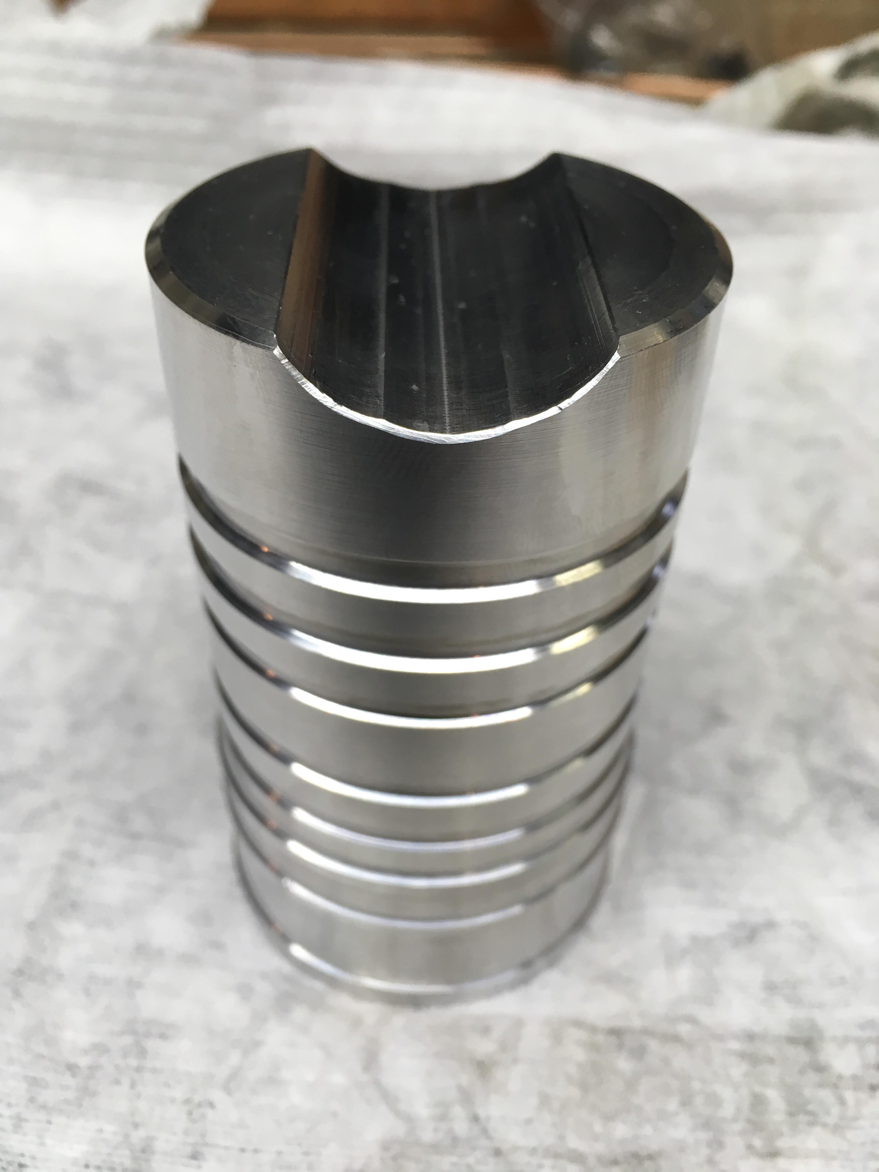

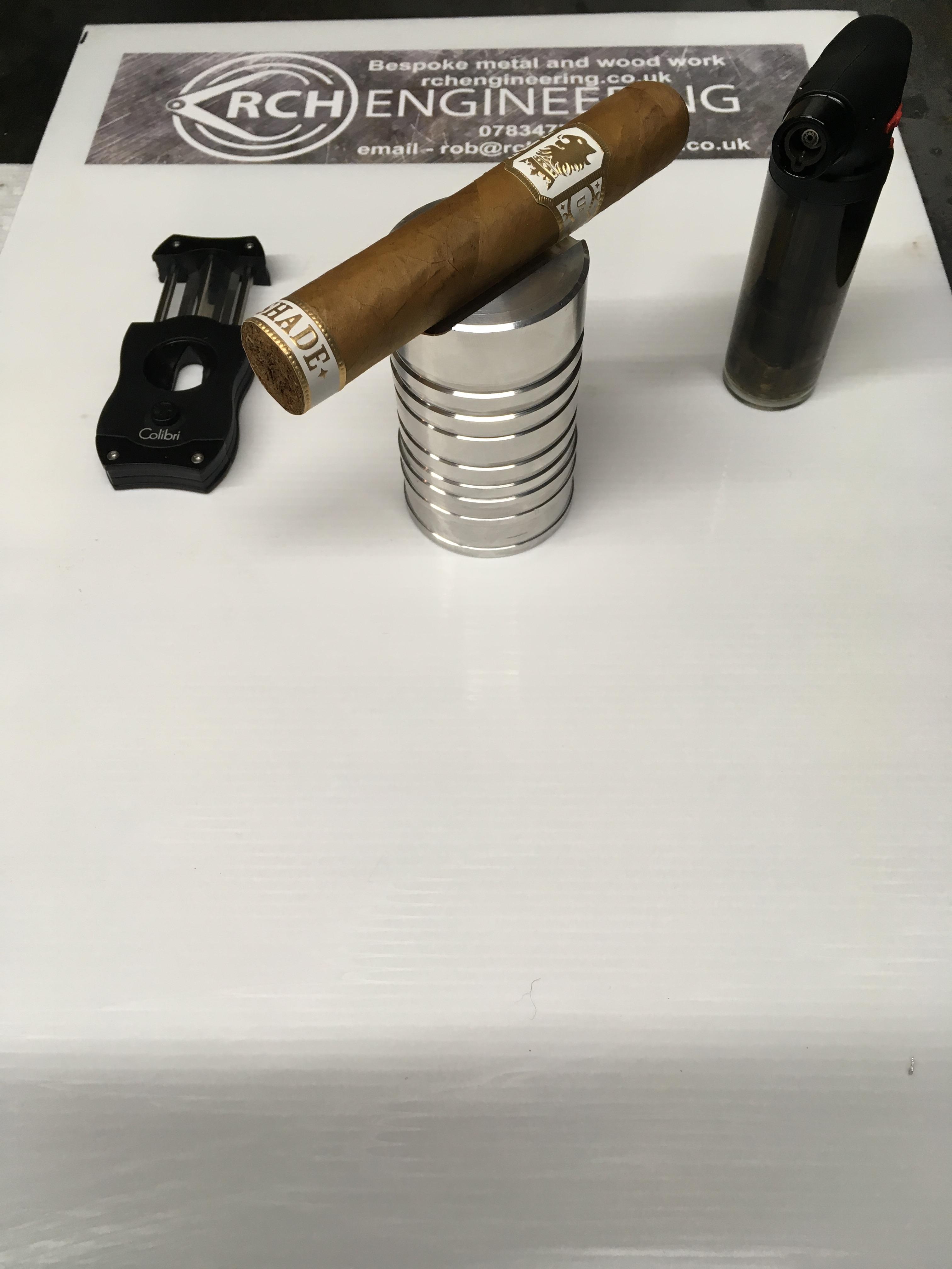

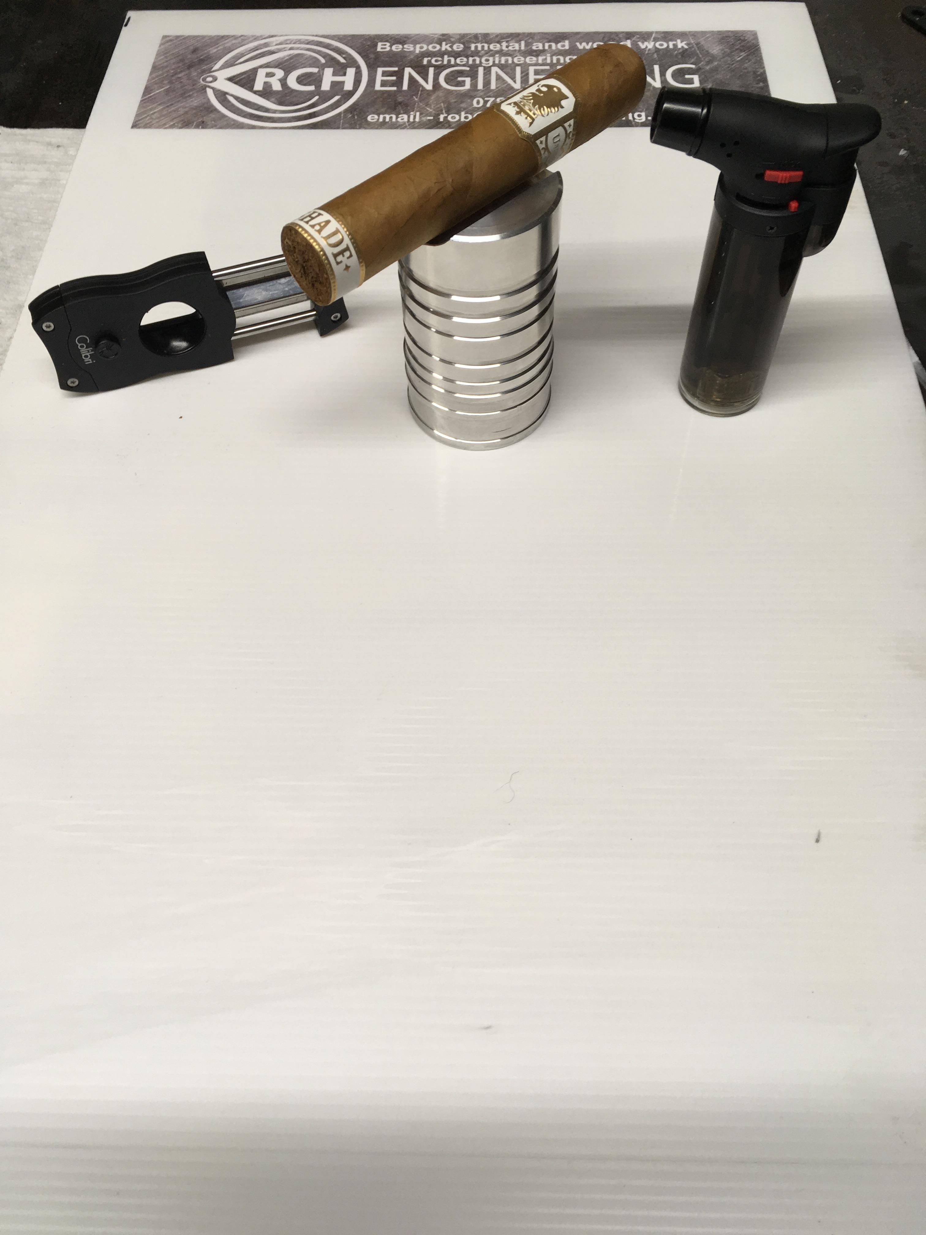

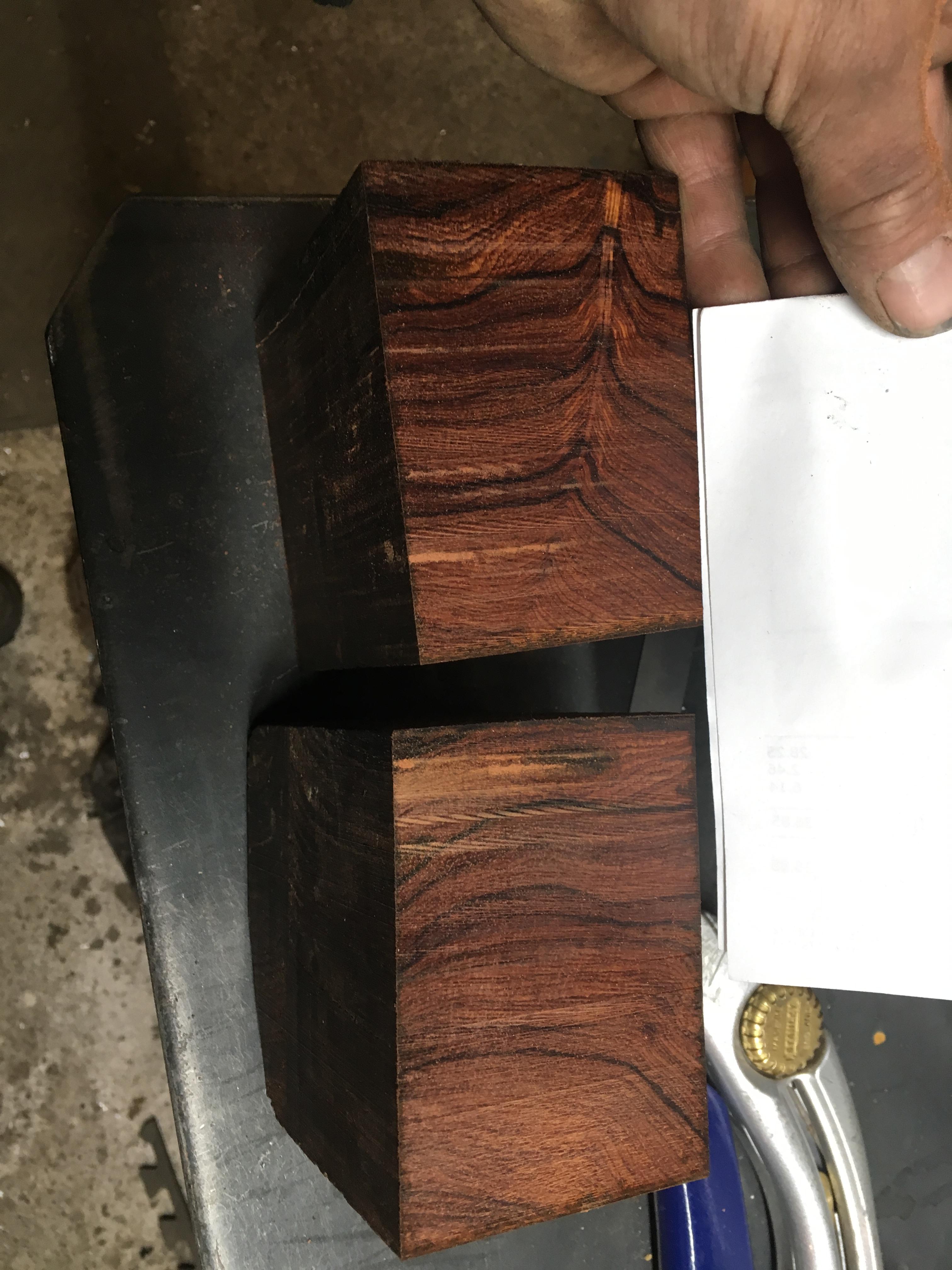

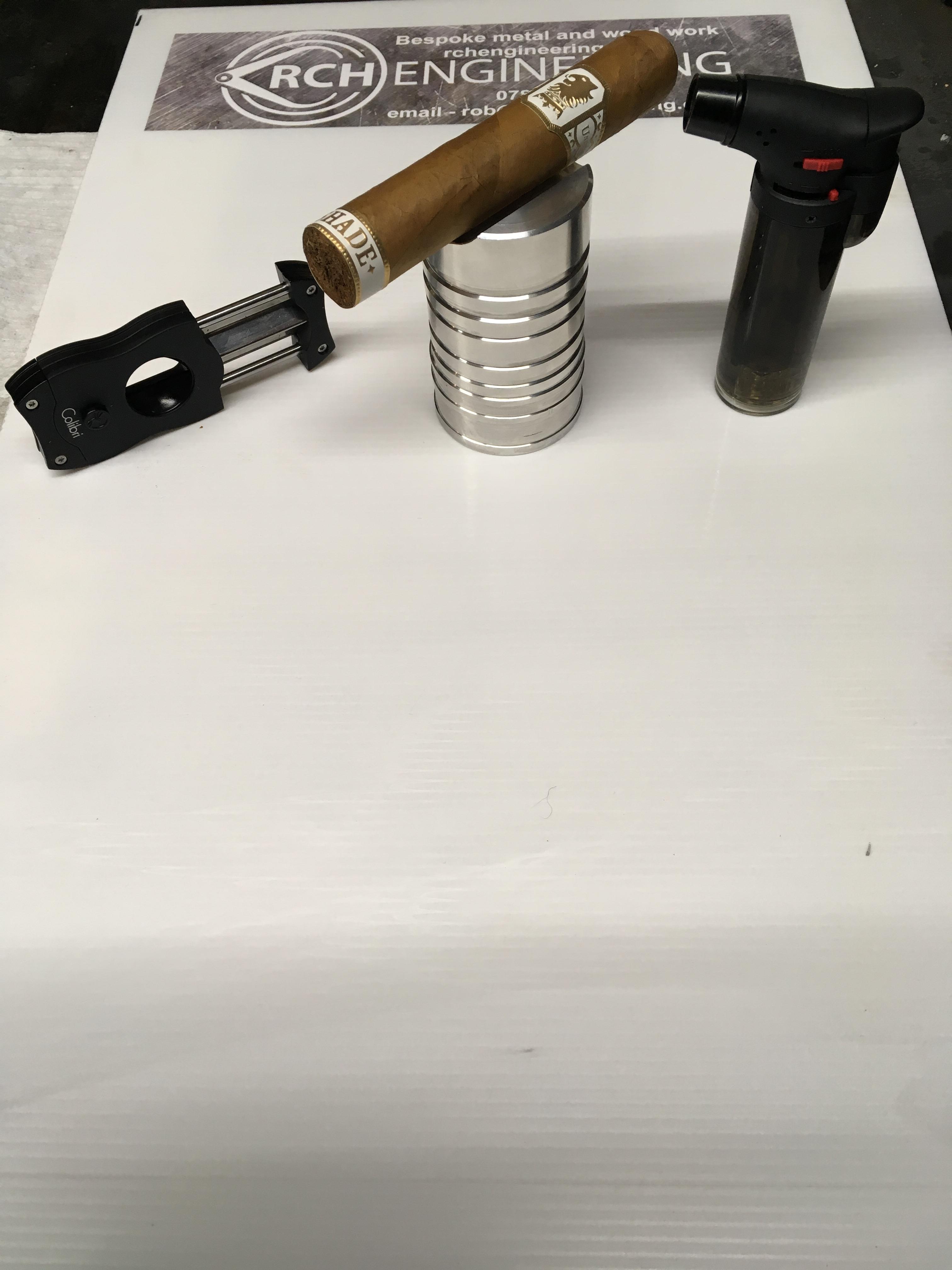

This is a cigar stand I made for someone on Facebook.

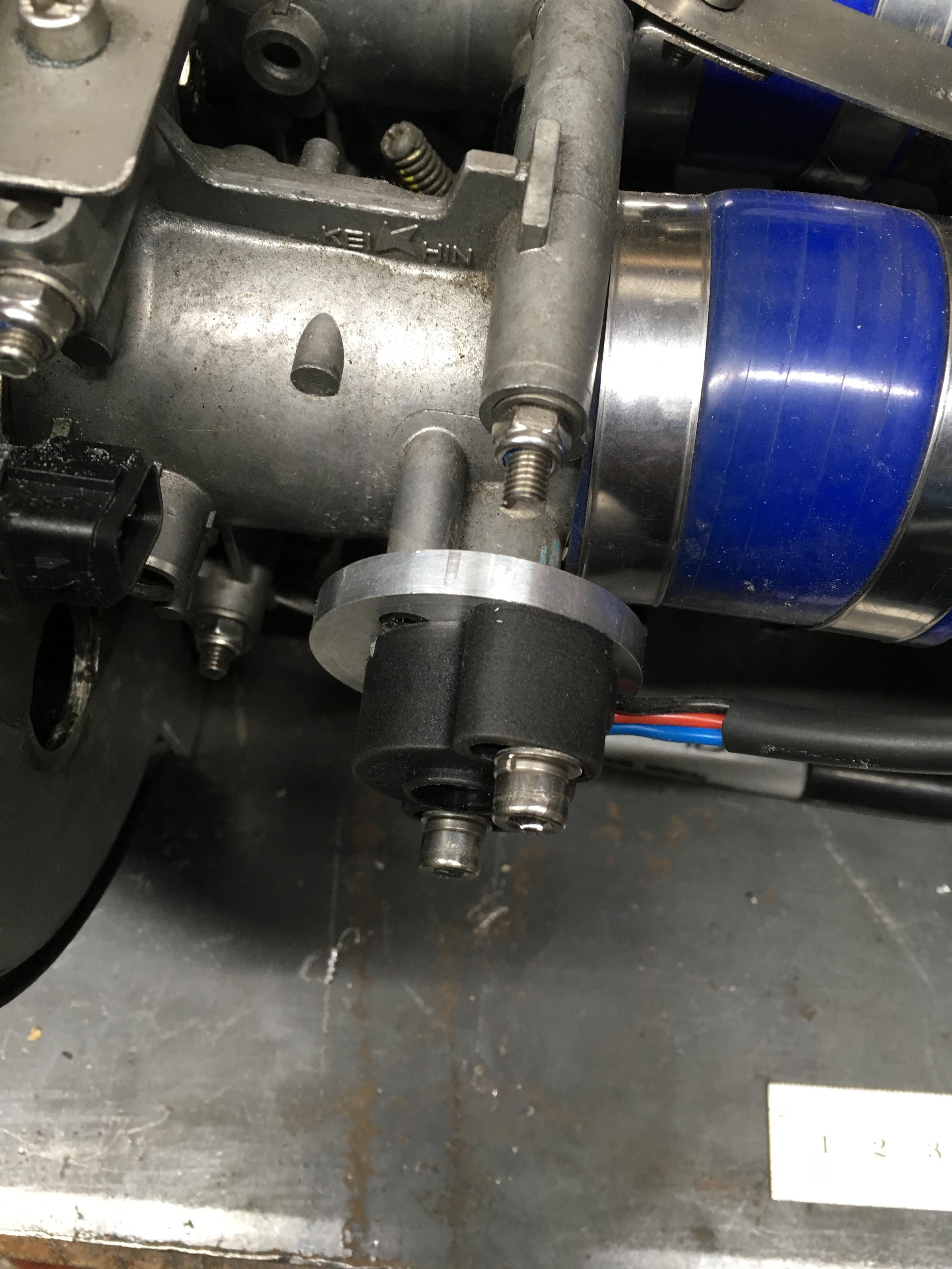

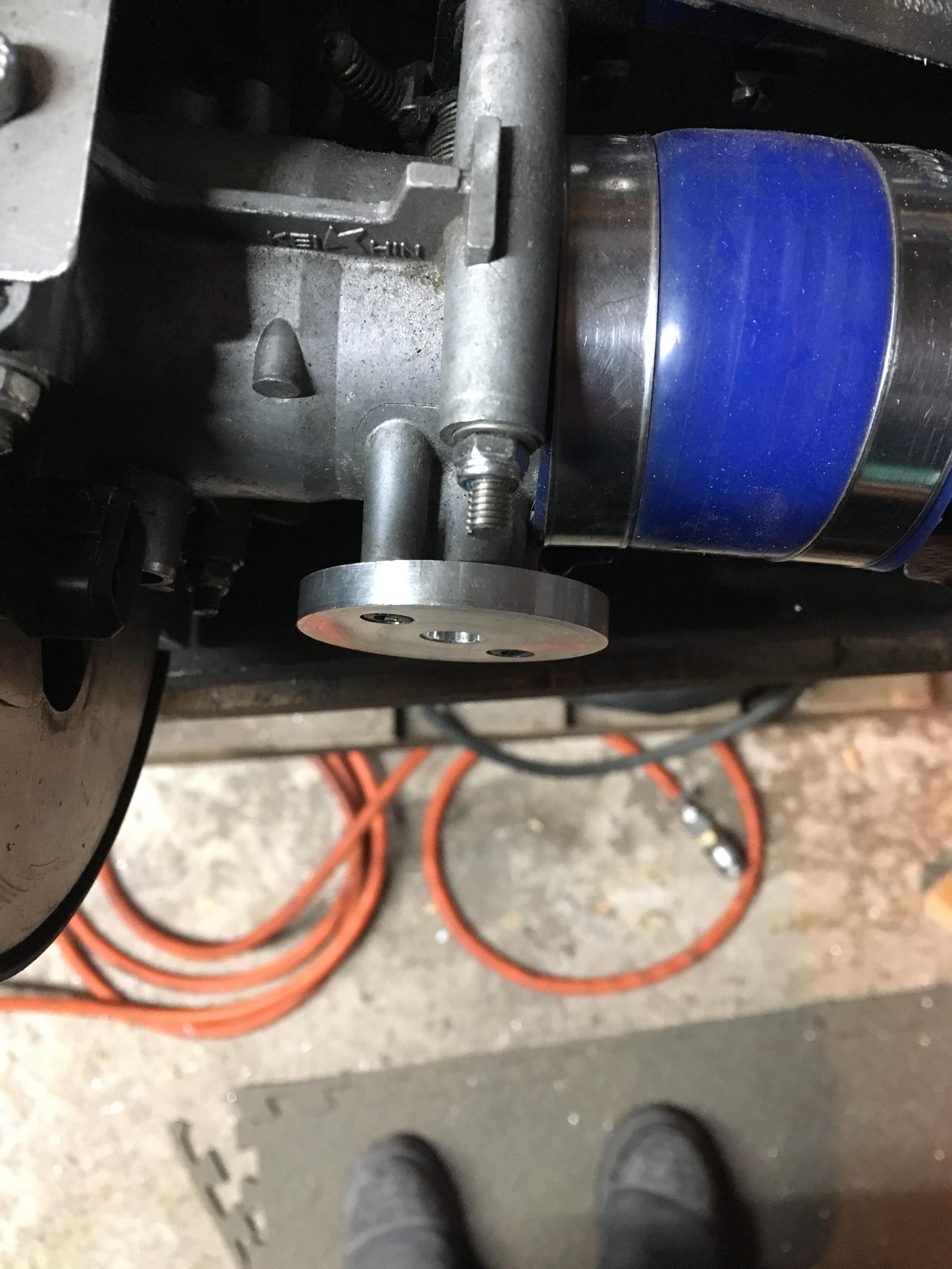

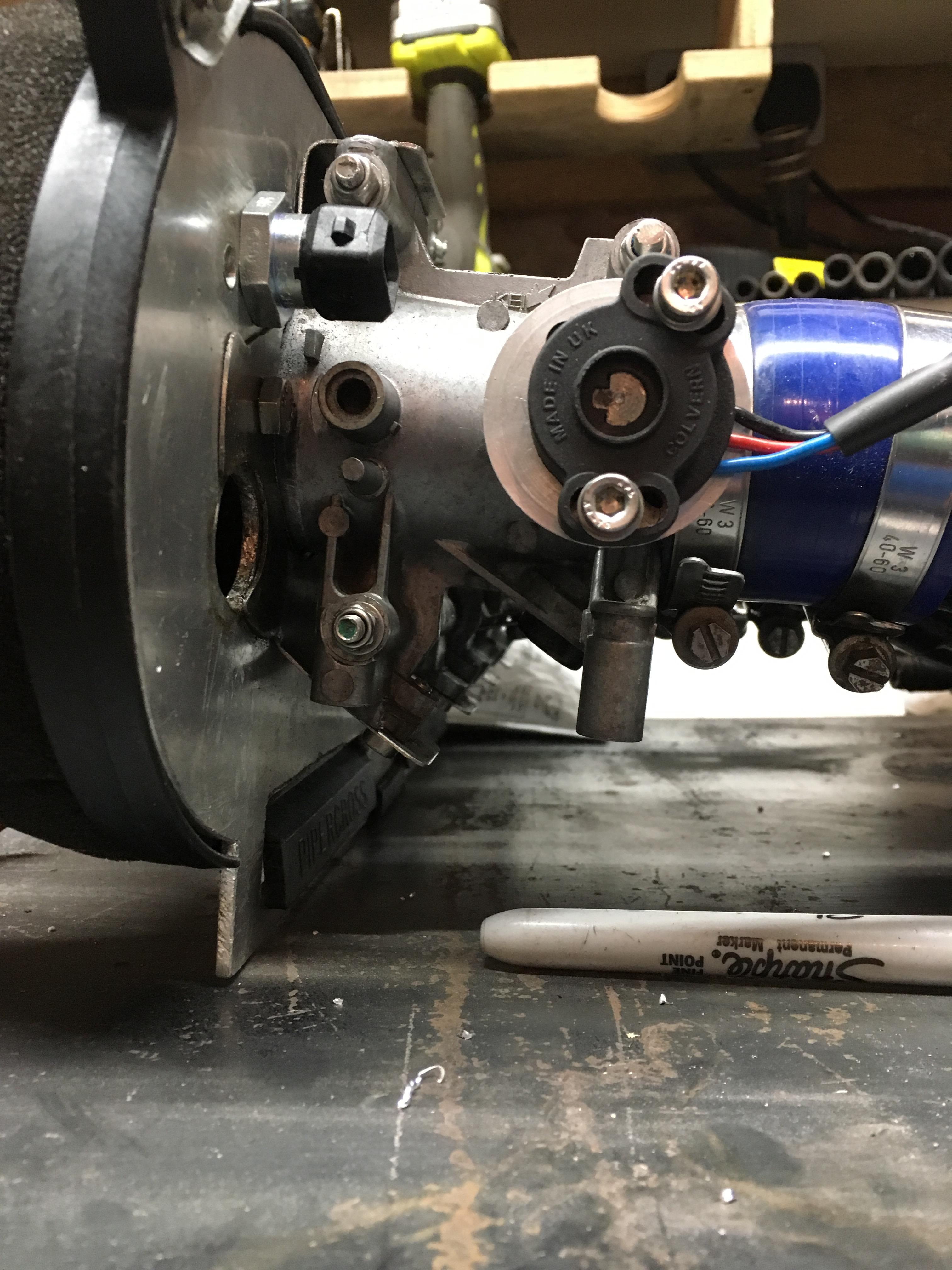

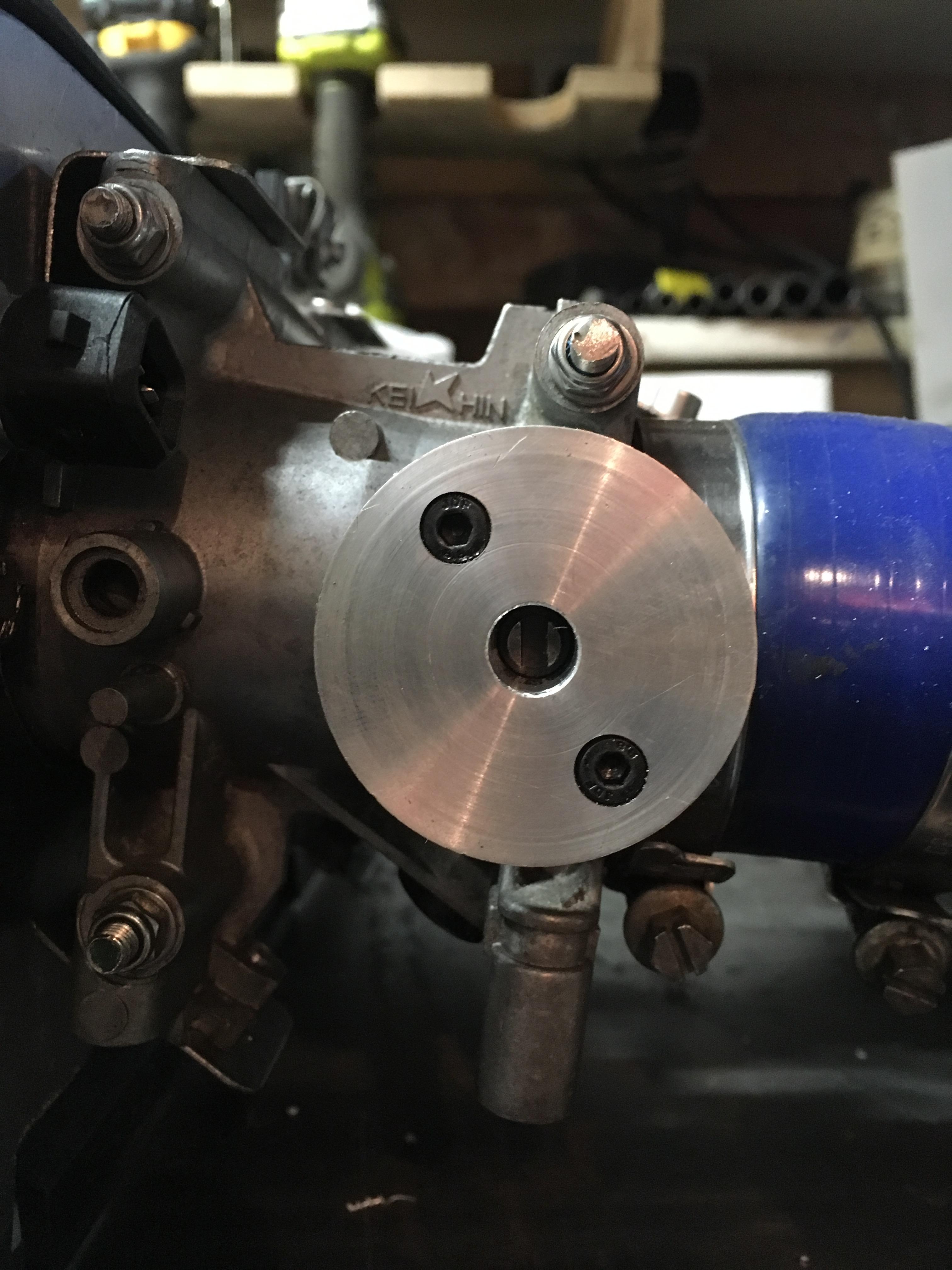

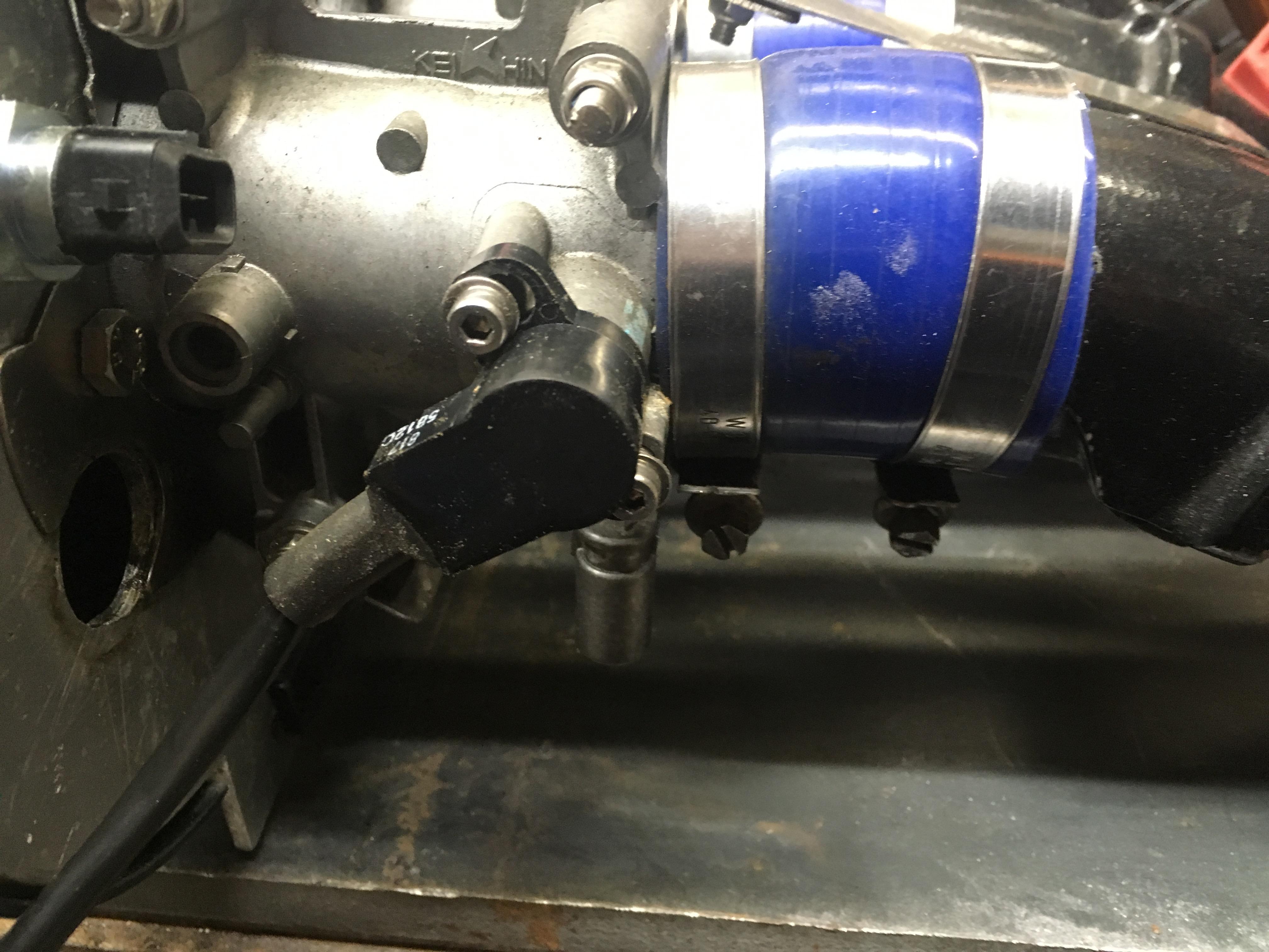

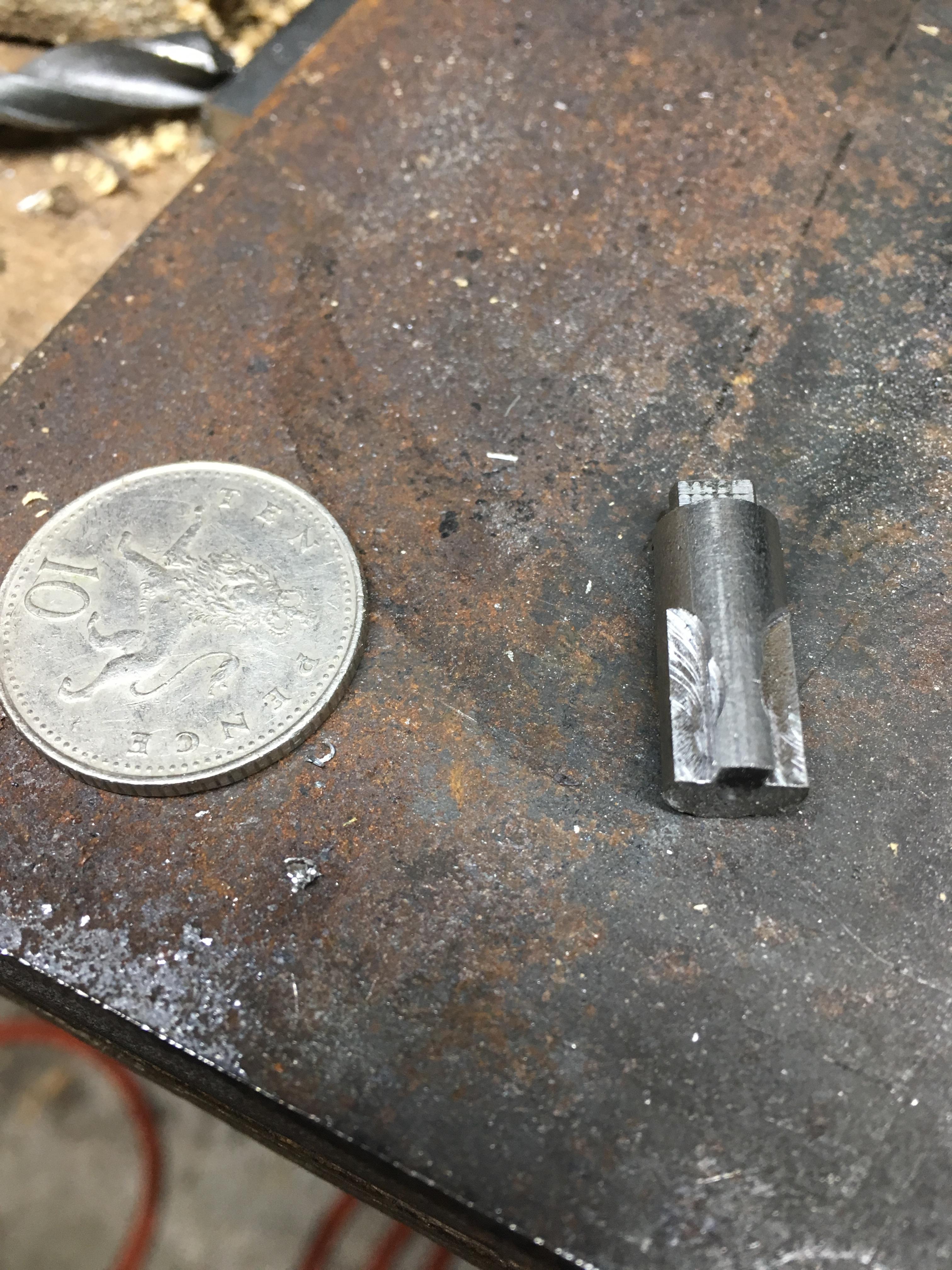

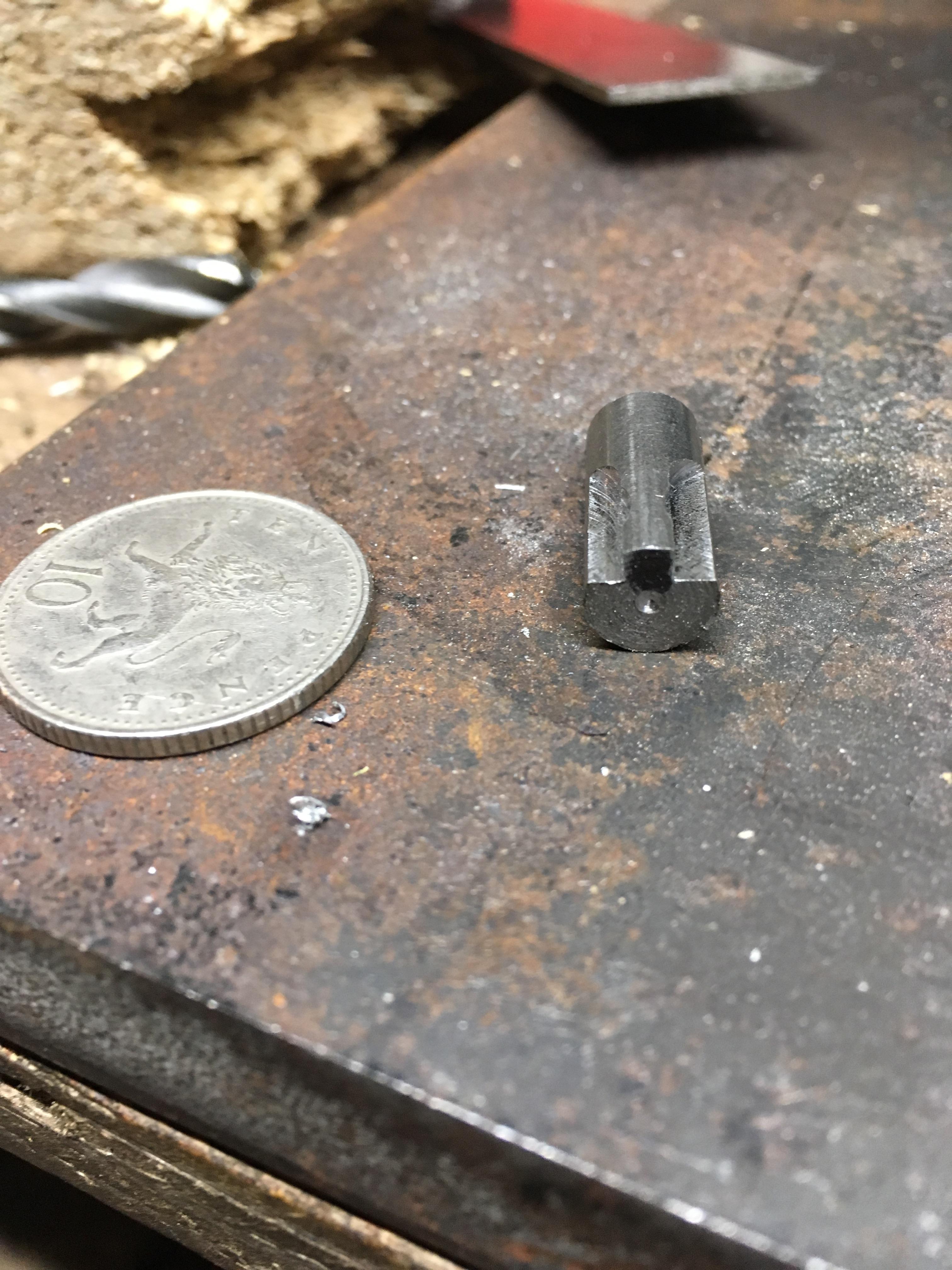

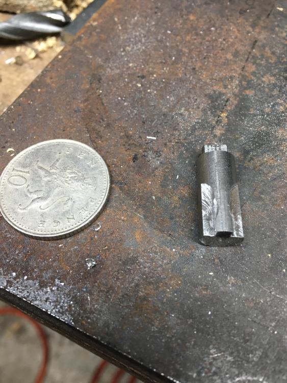

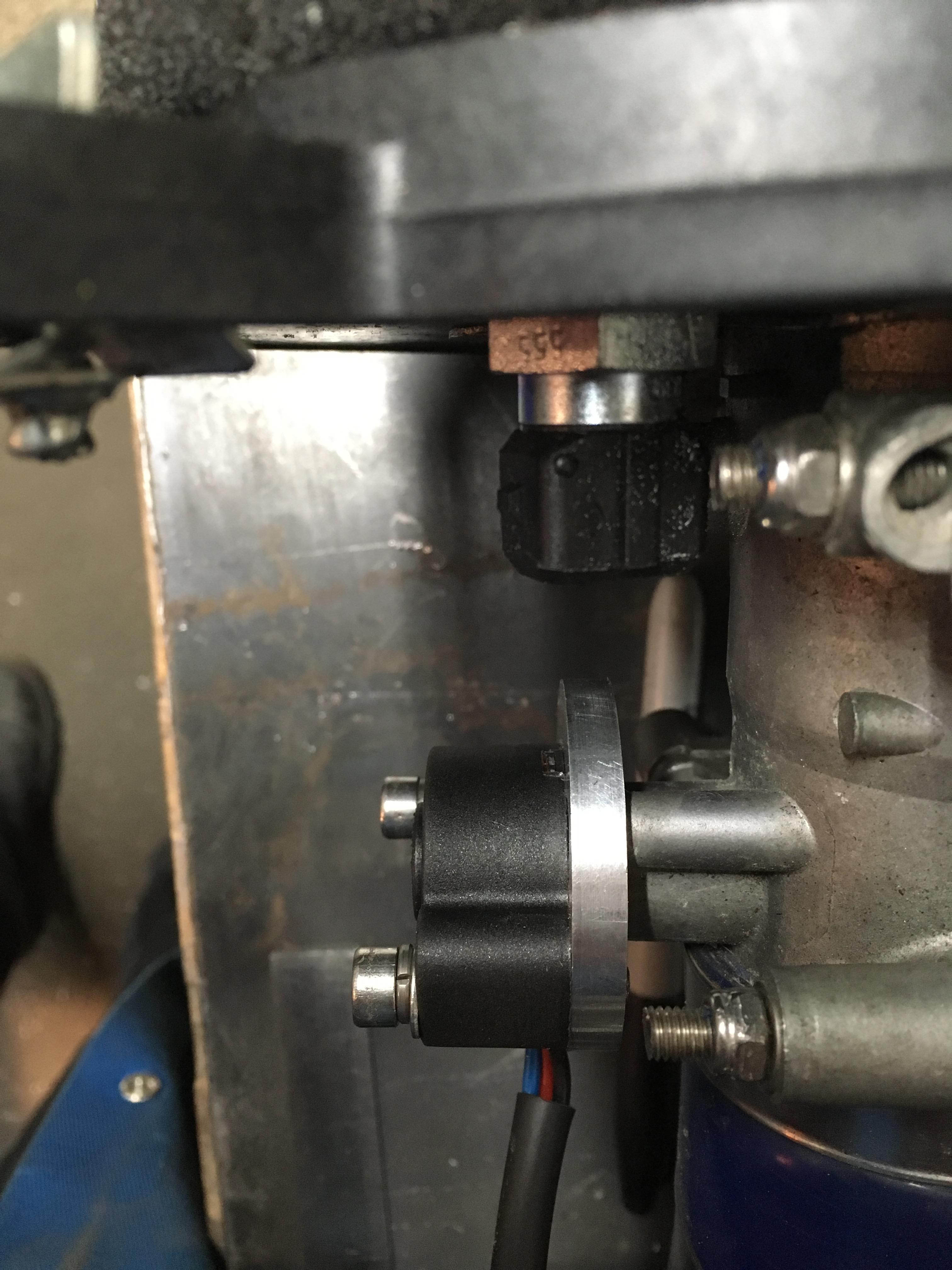

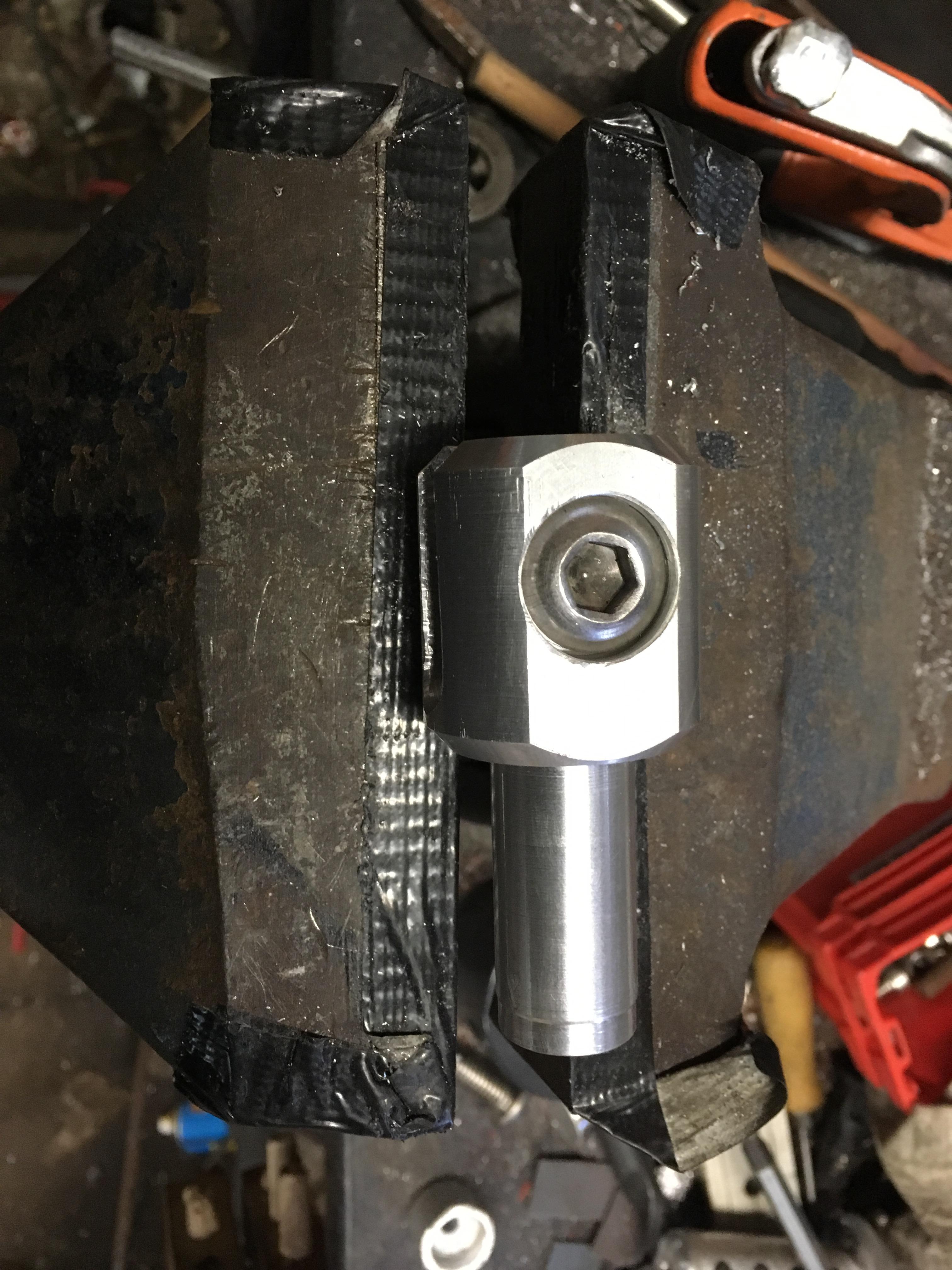

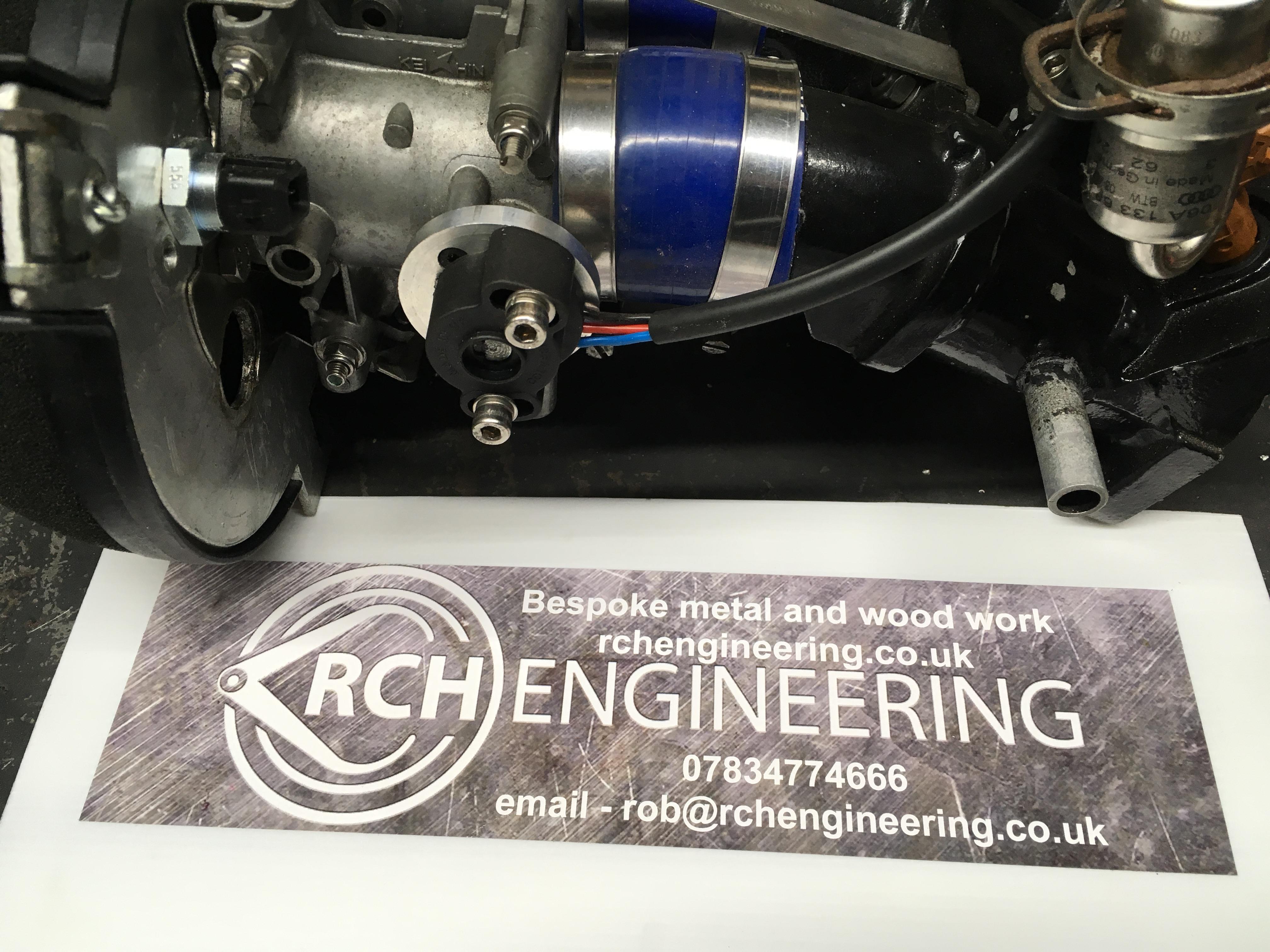

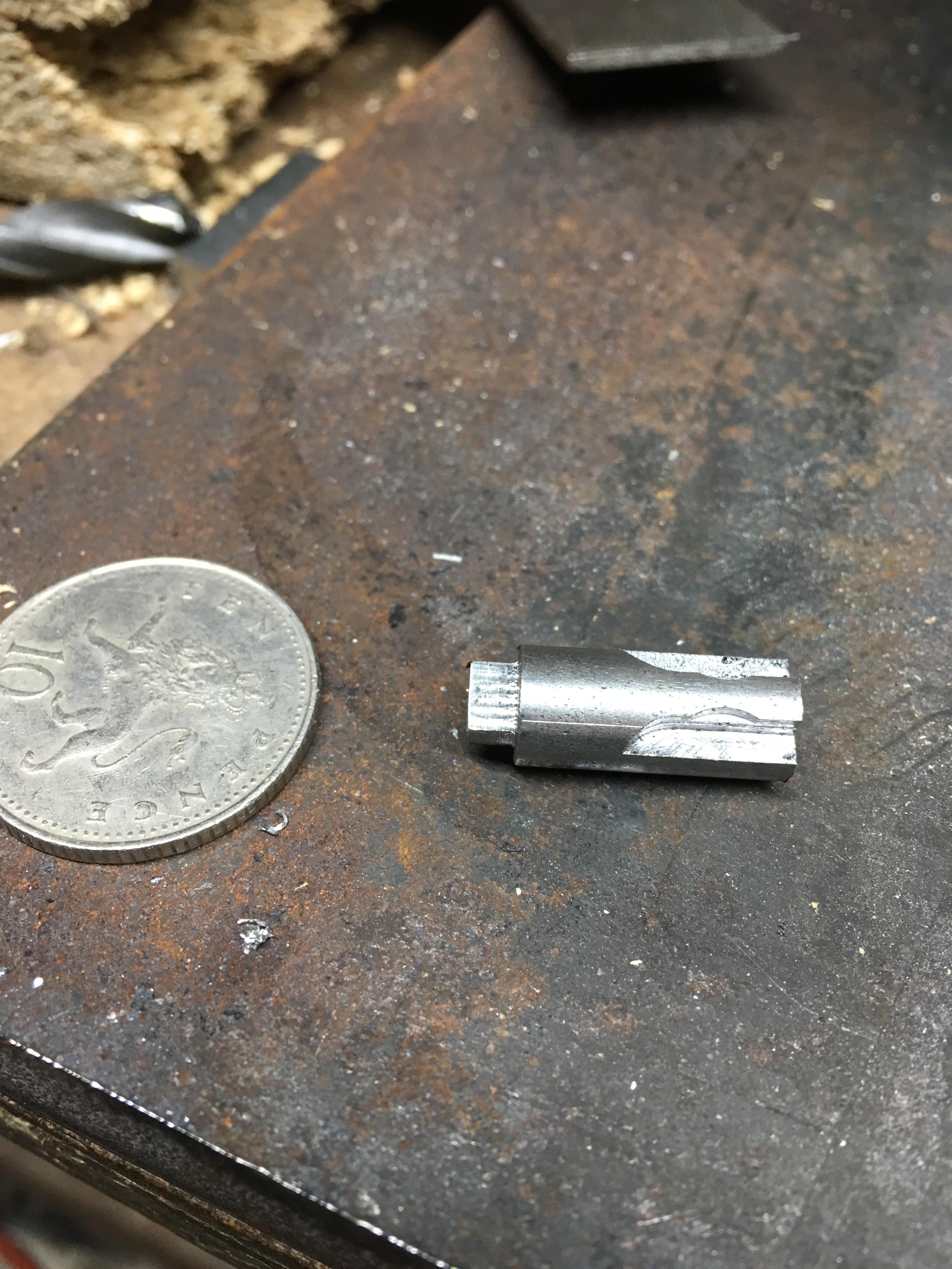

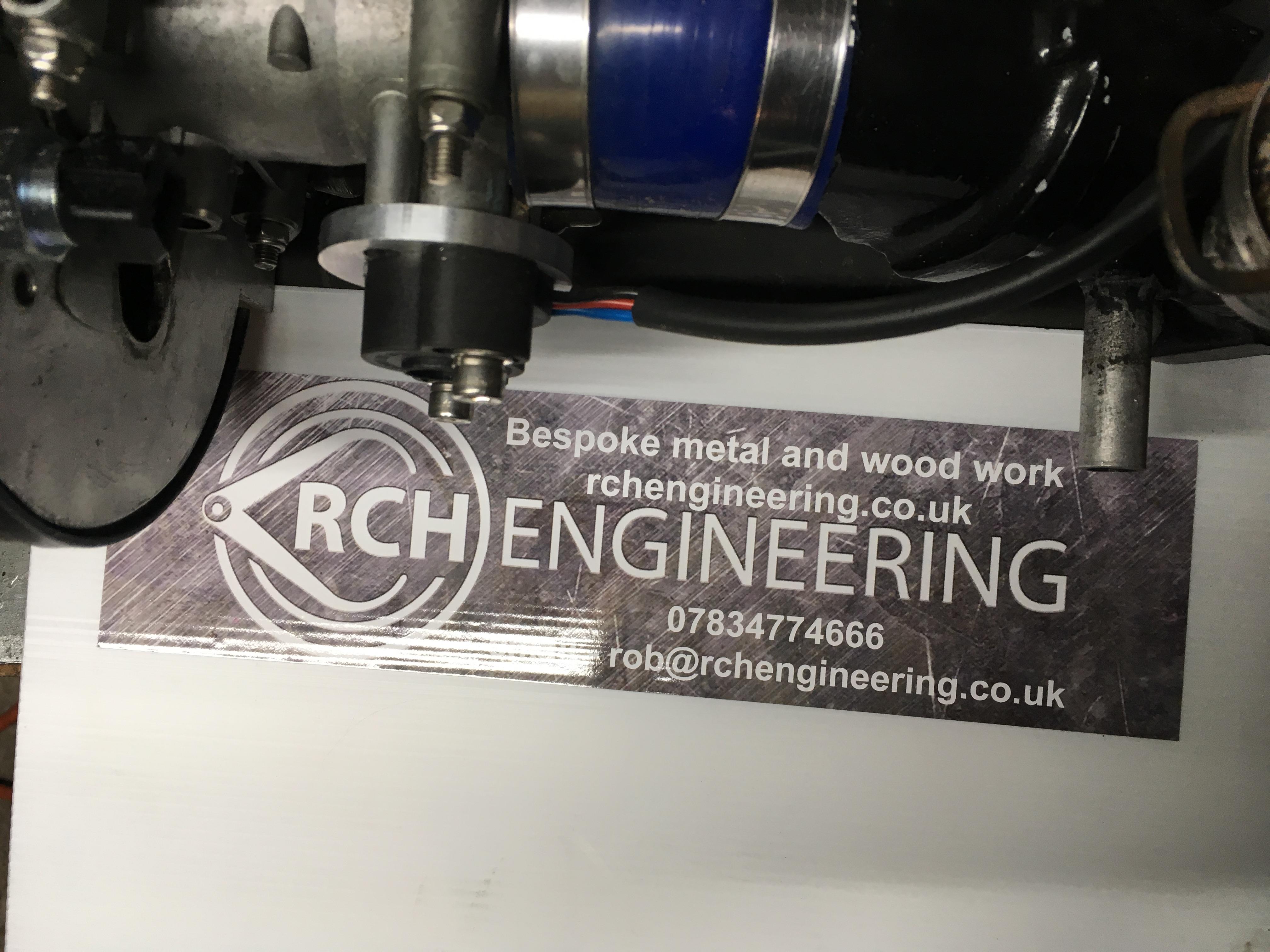

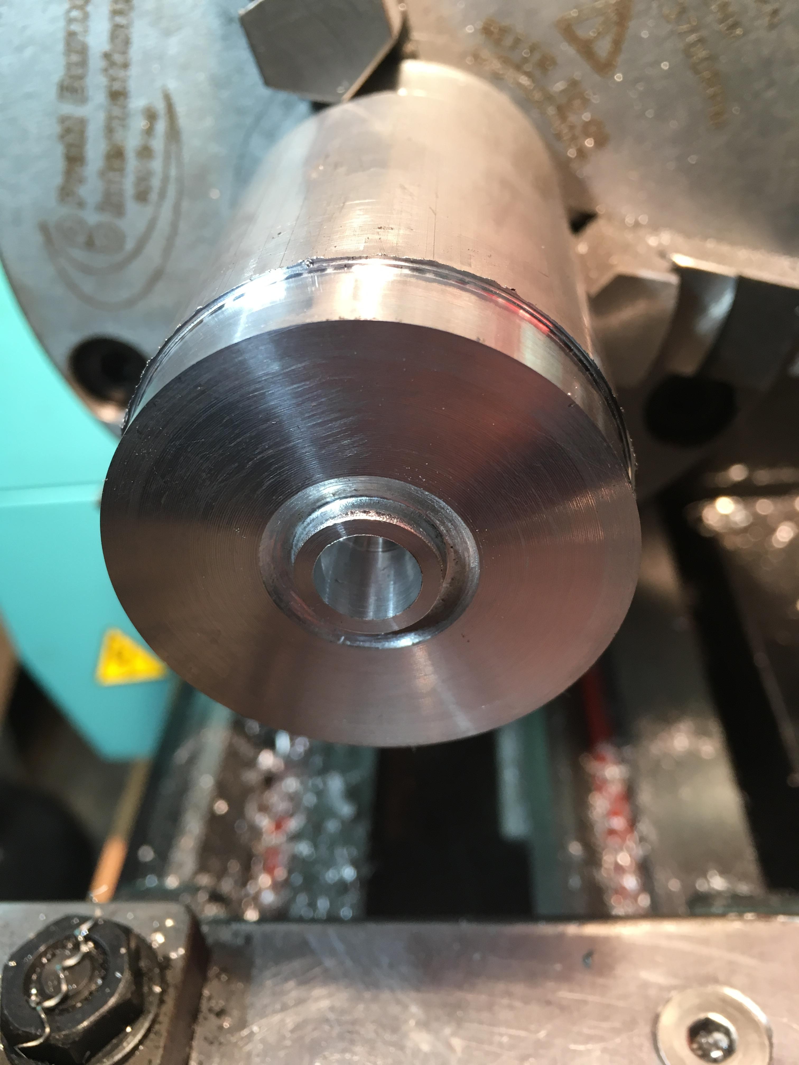

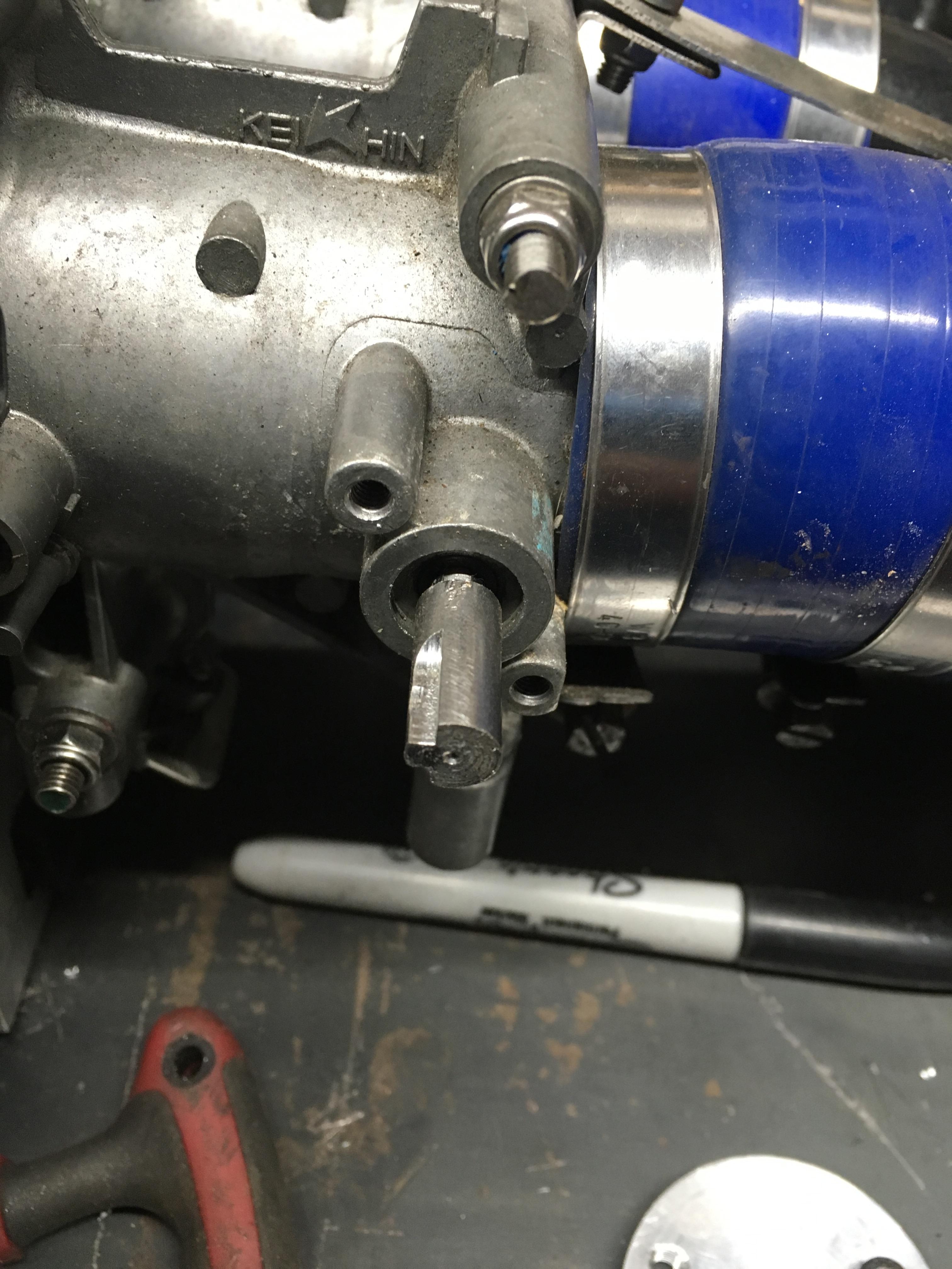

This is a TPS conversation I did for a Peugeot 205 race car. They needed a proper mount and drive as the drive it came with was only plastic and was flexing, the new mount also made it so the TPS could be adjusted for mapping.

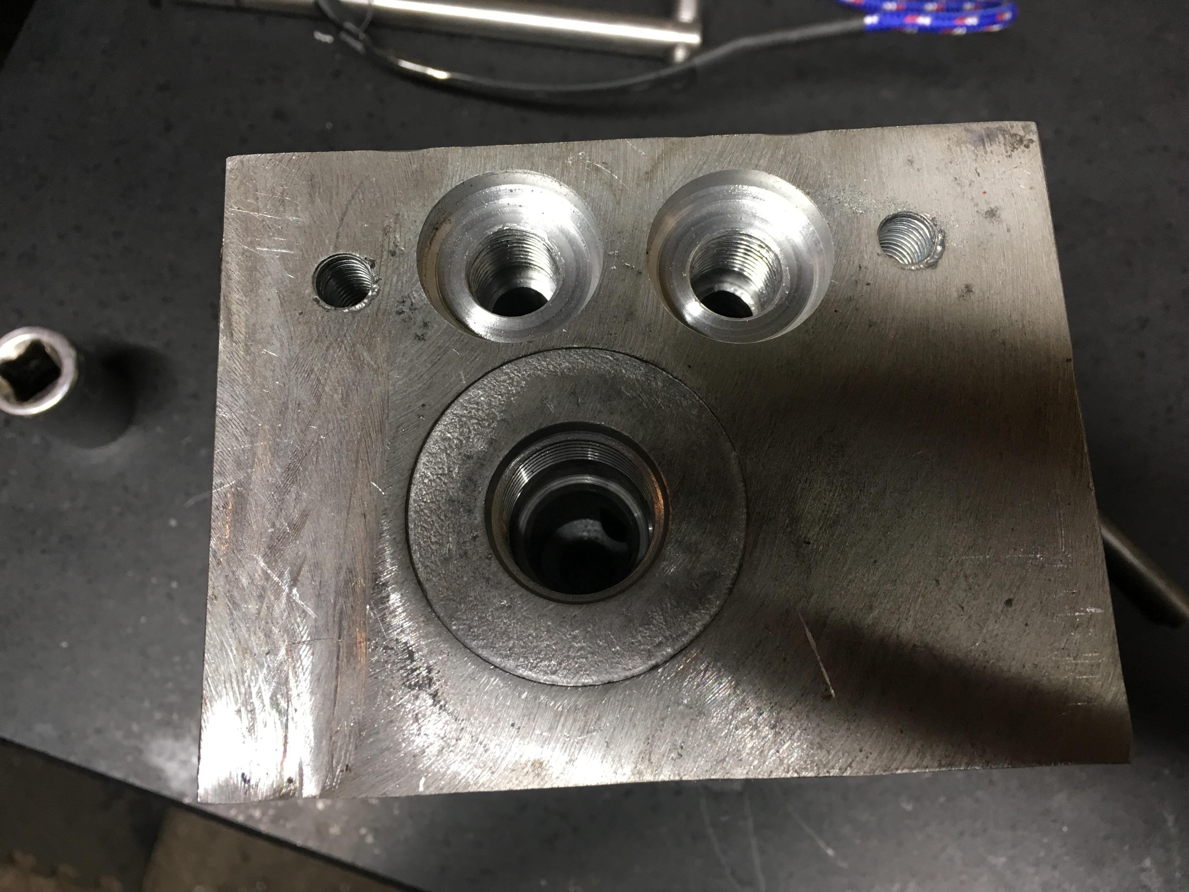

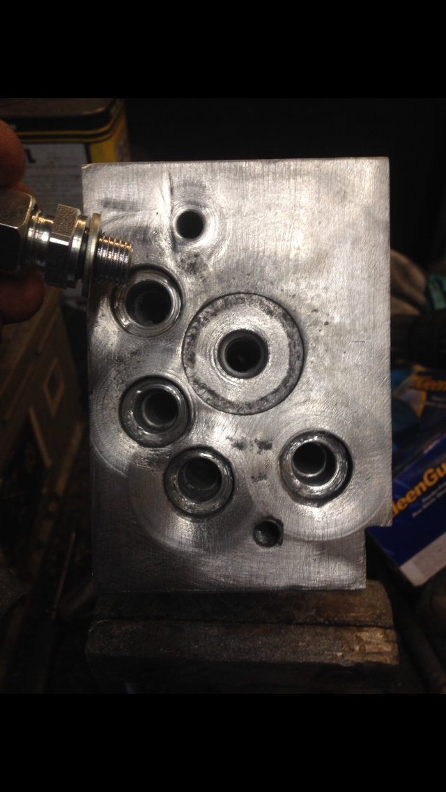

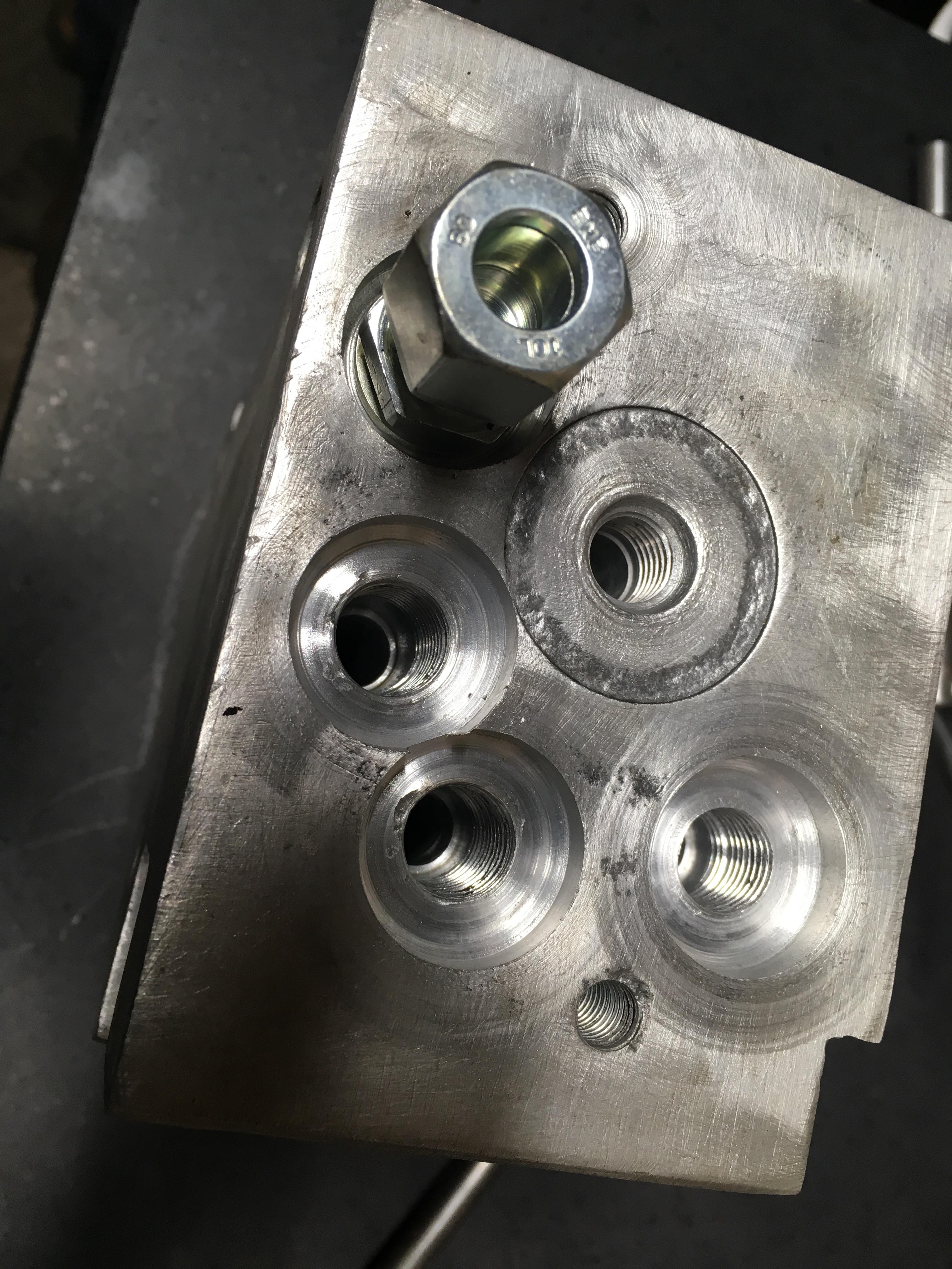

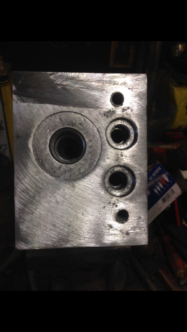

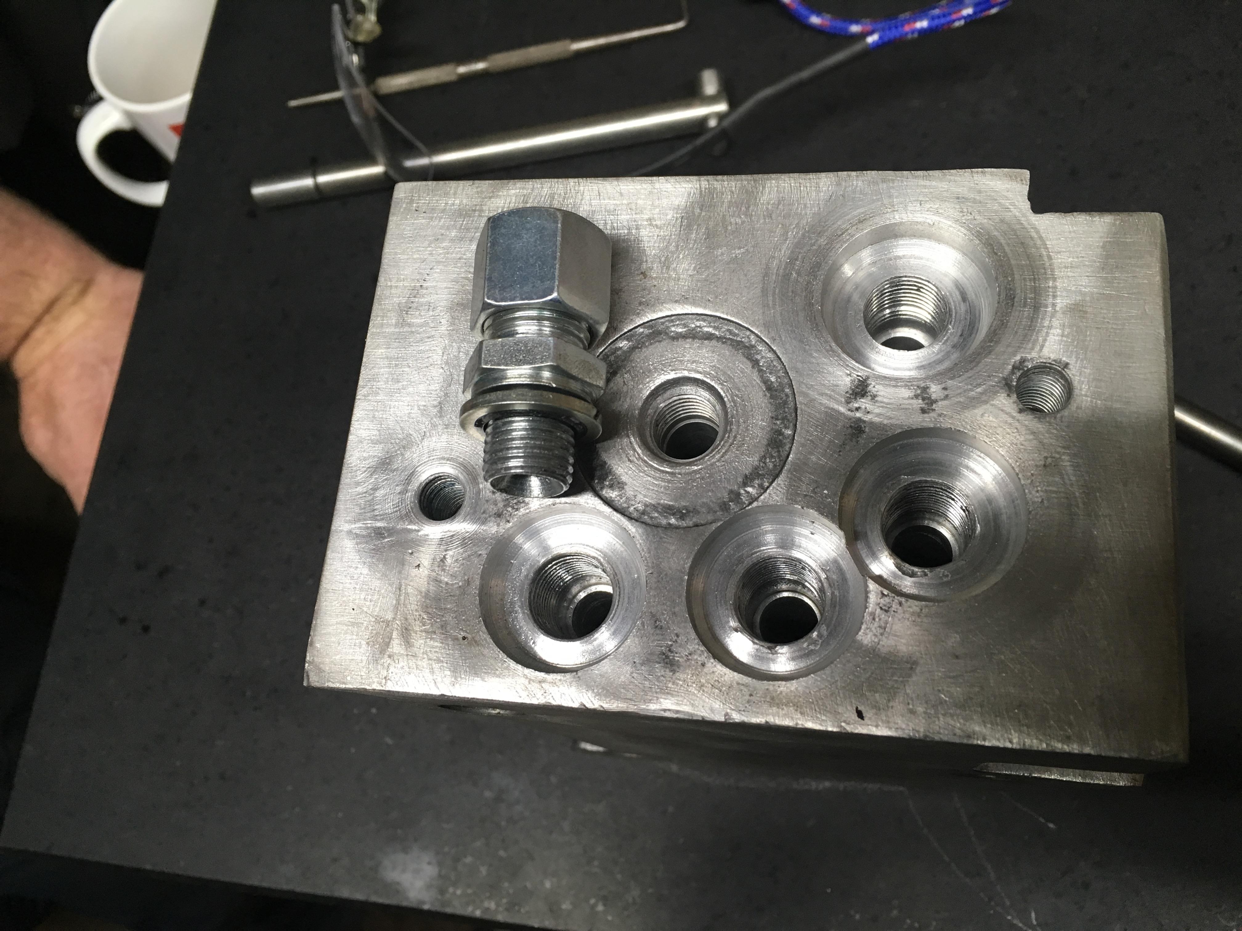

This is a Land Rover Discovery active stability valve block I refaced and tapped to take hydroulic pipe fitting instead of the silly push fit ones.

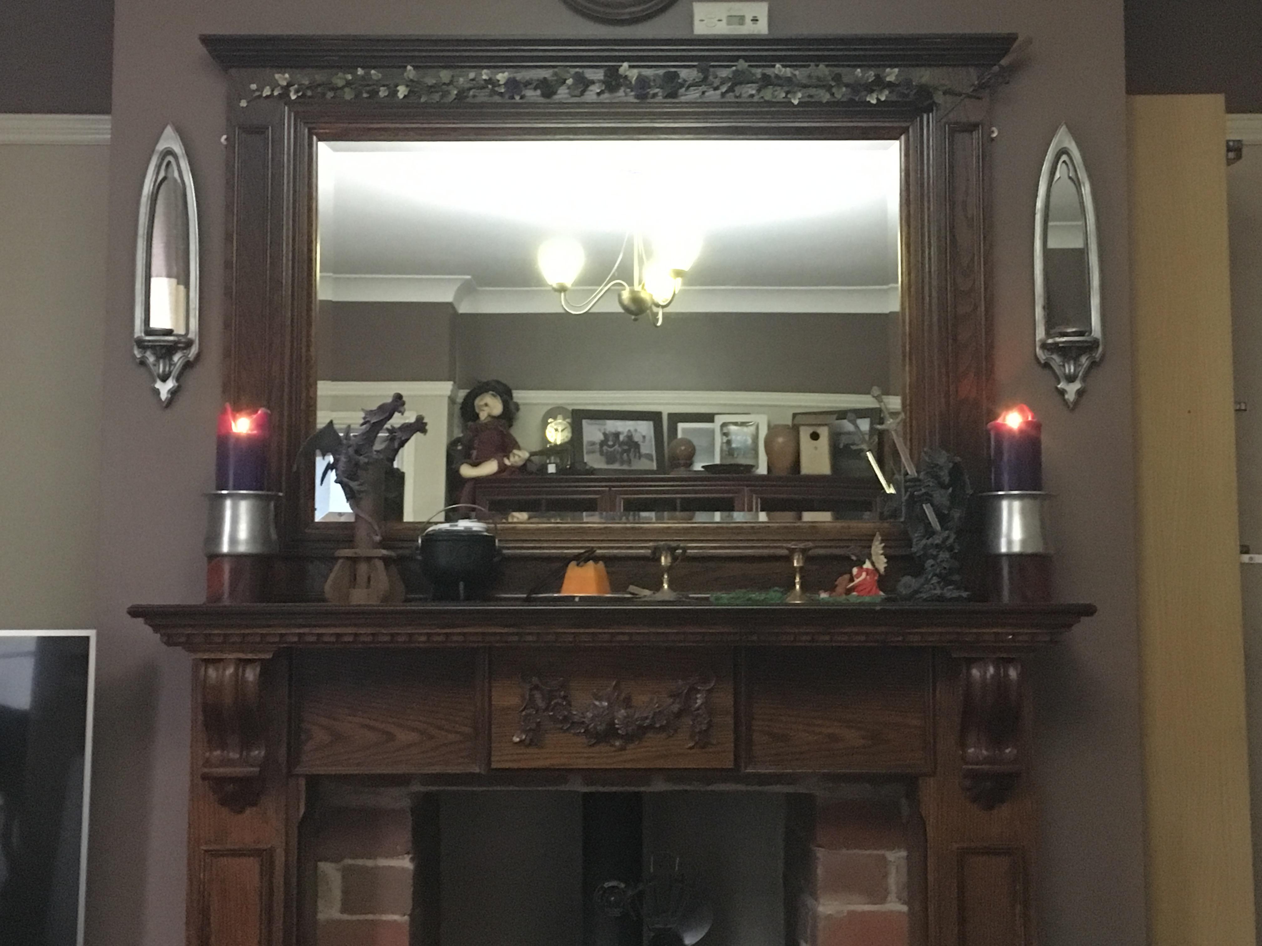

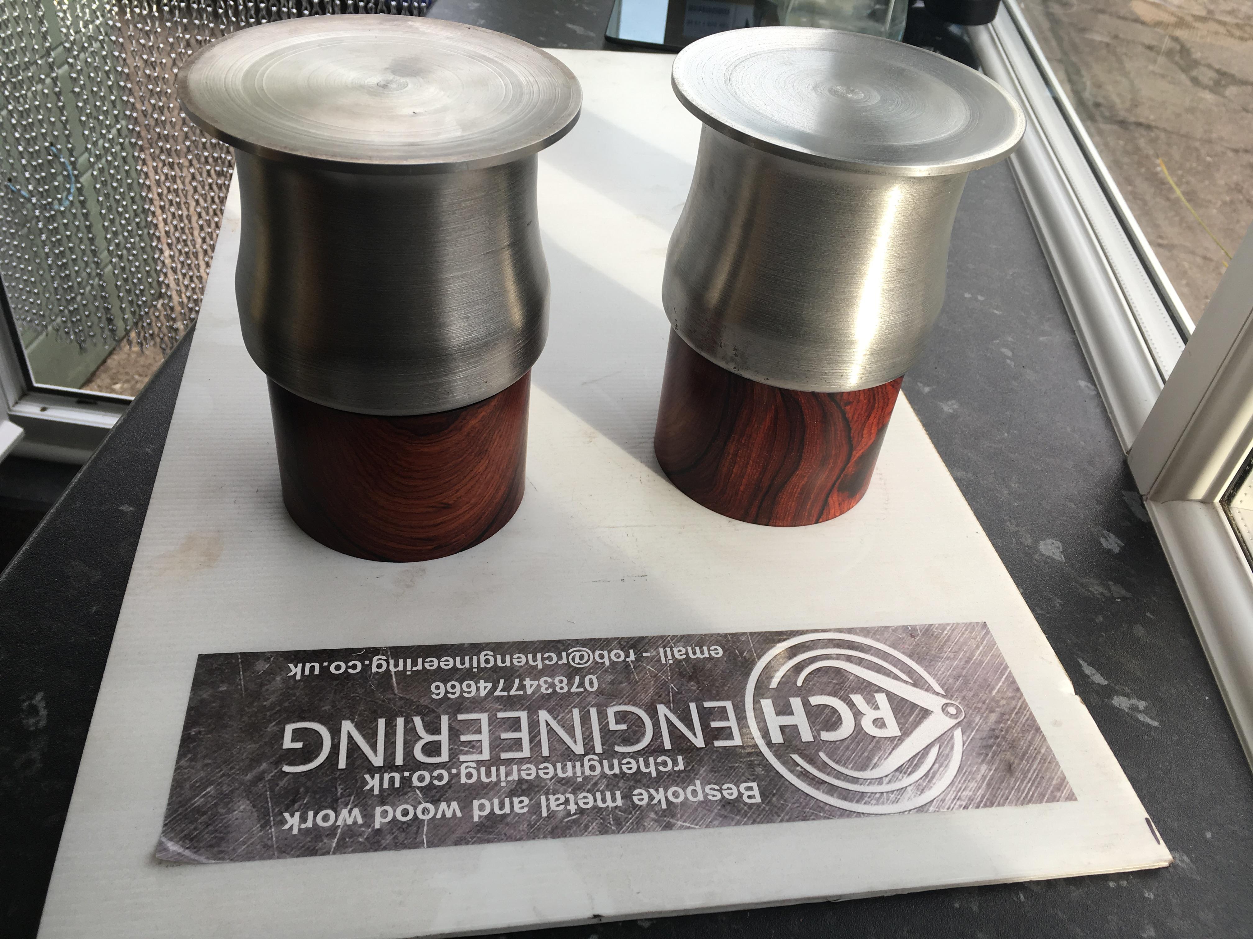

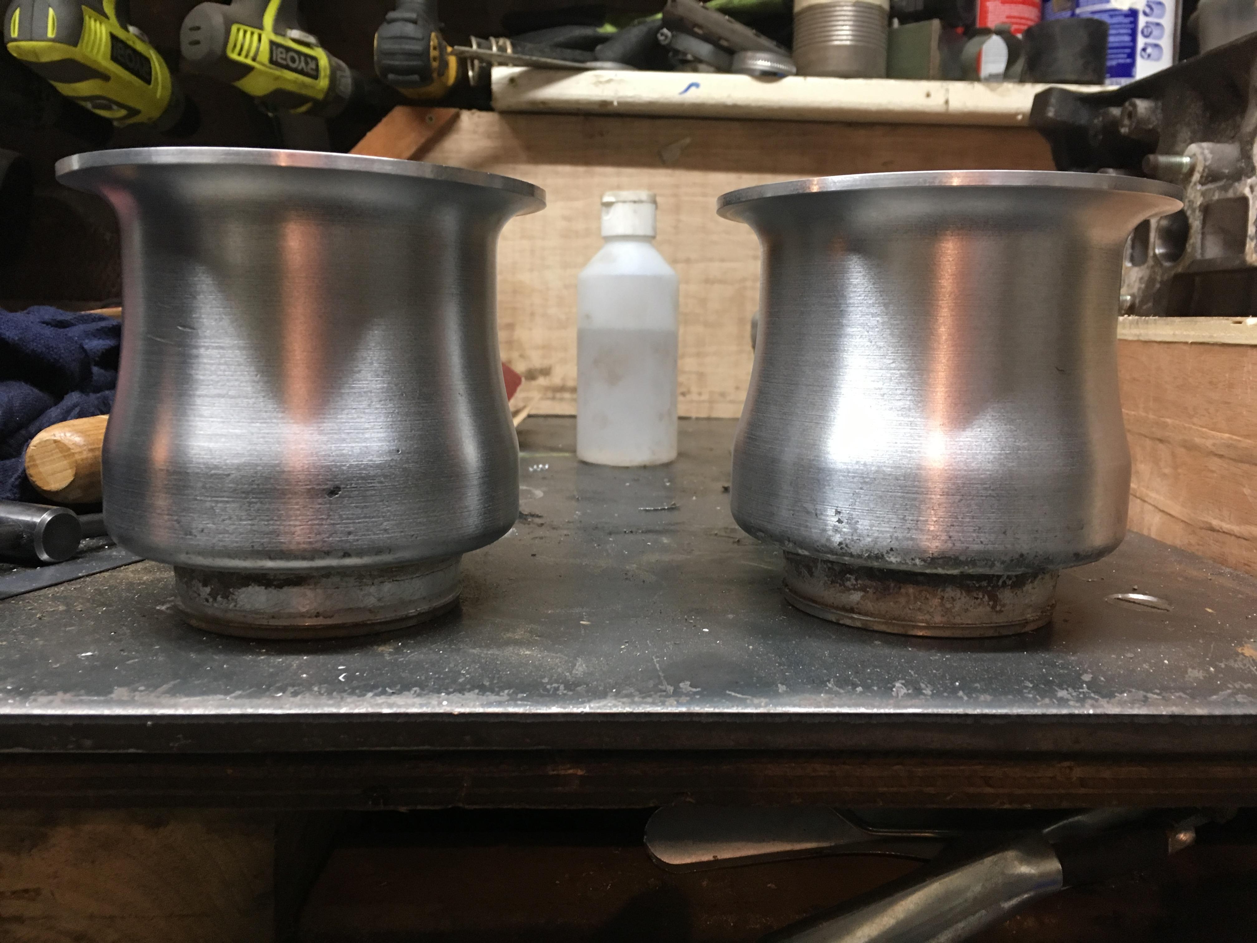

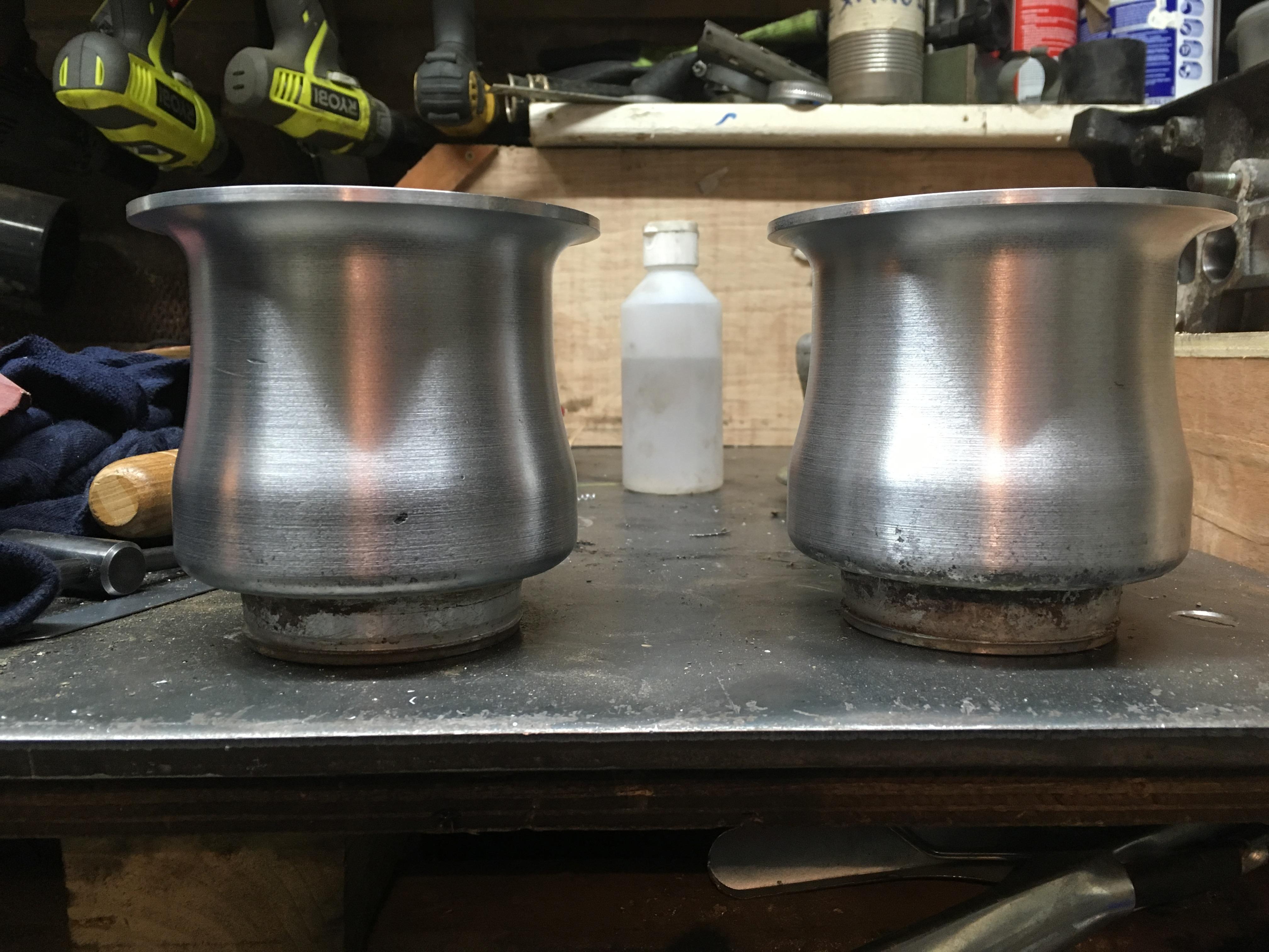

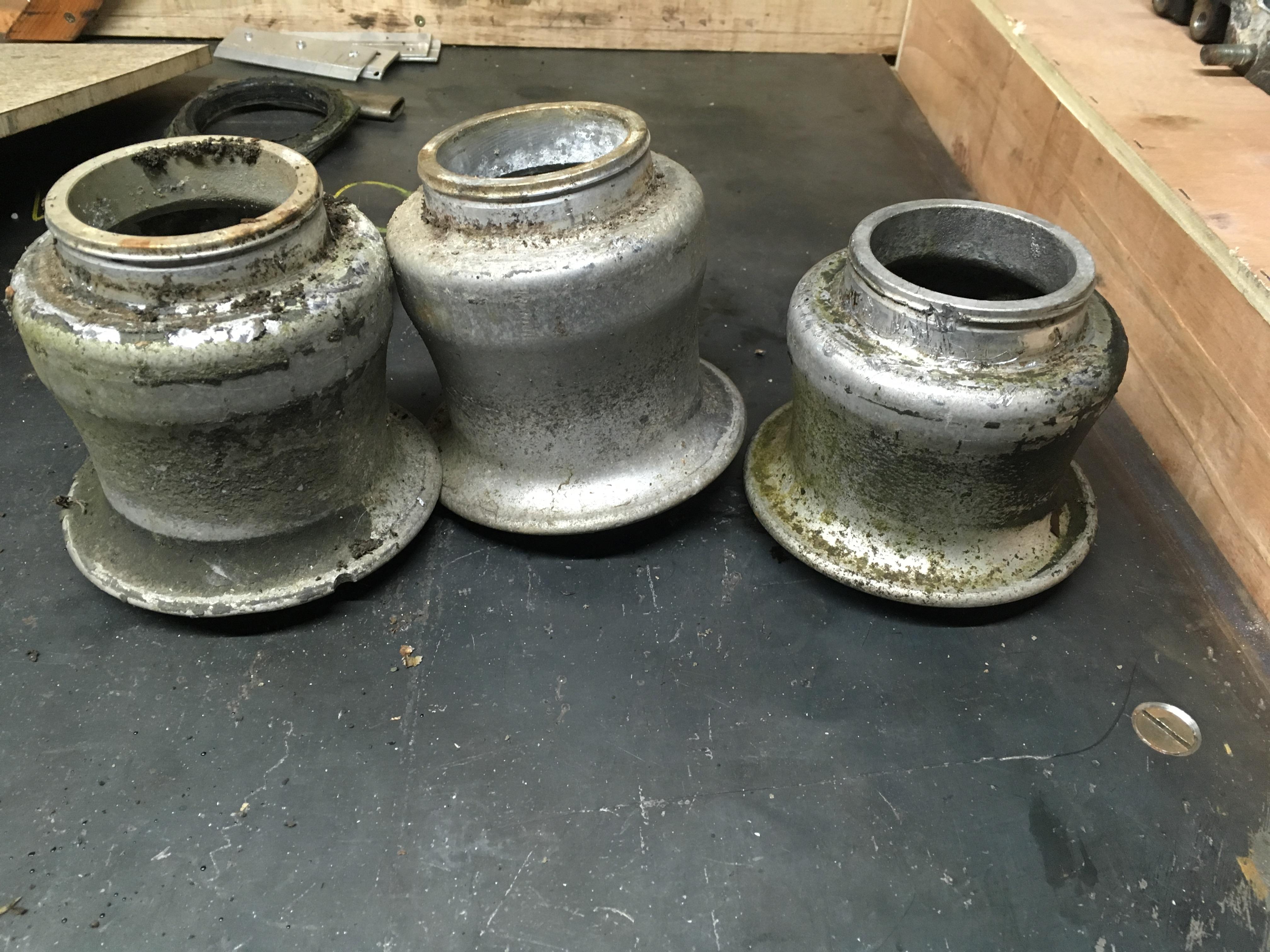

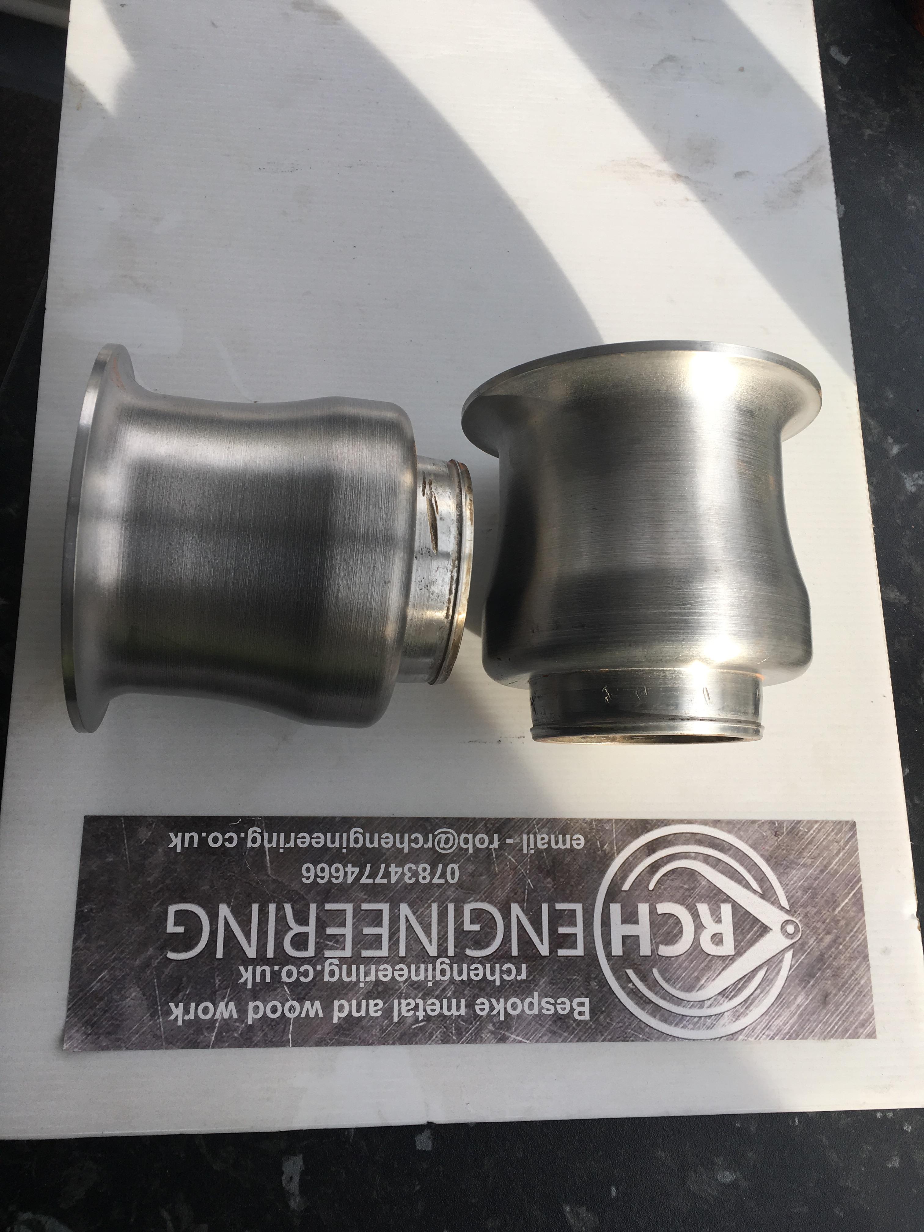

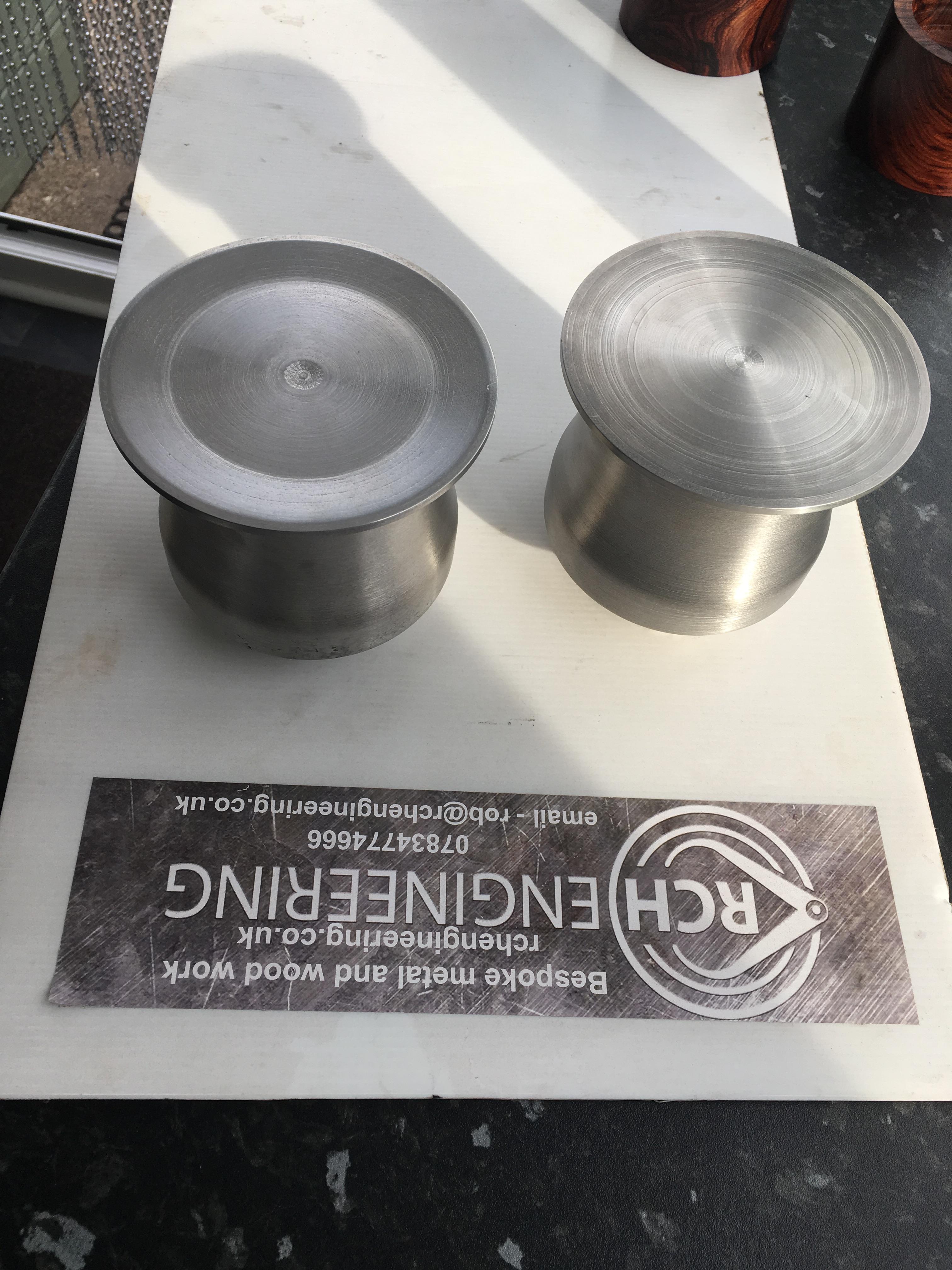

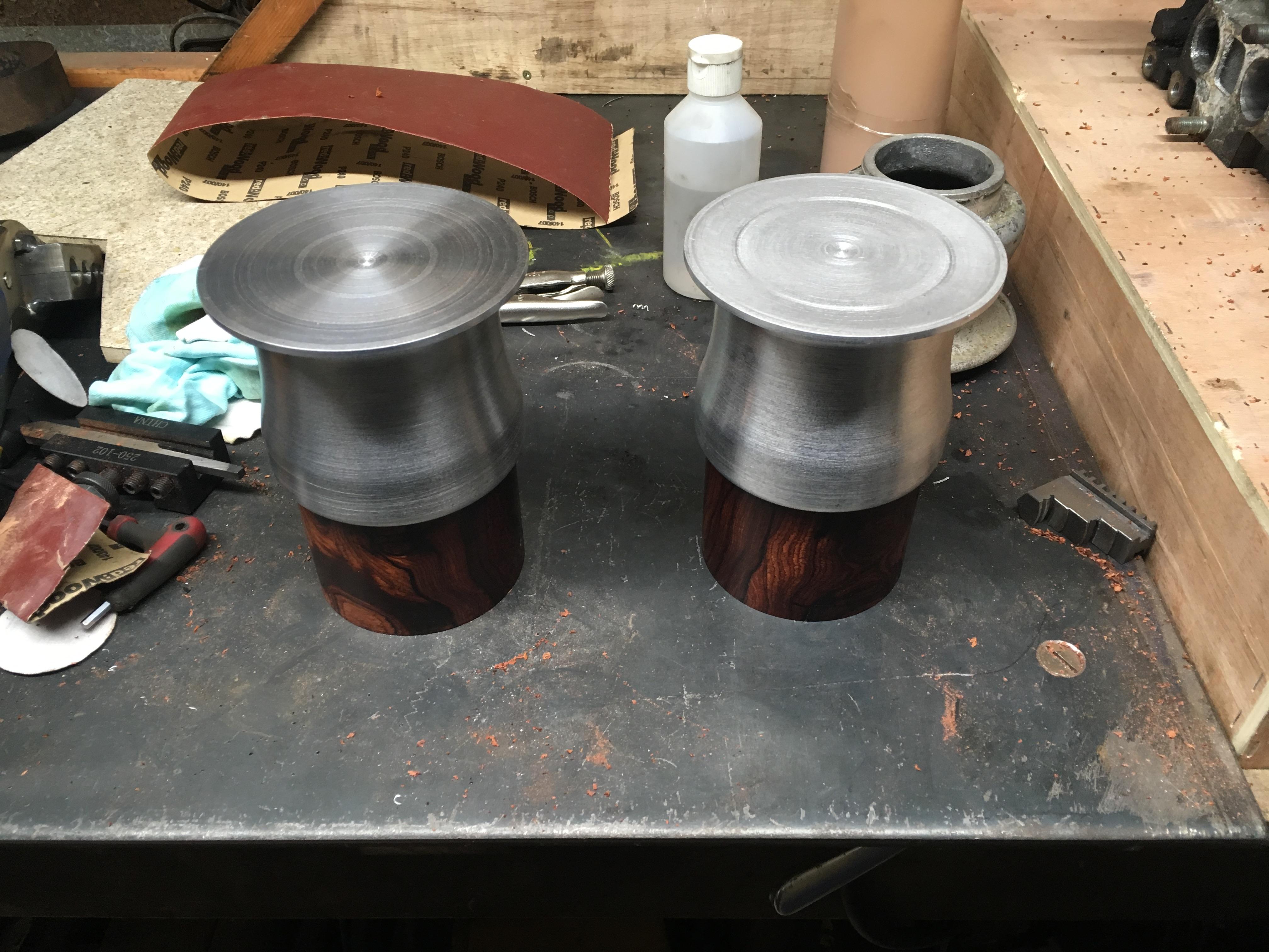

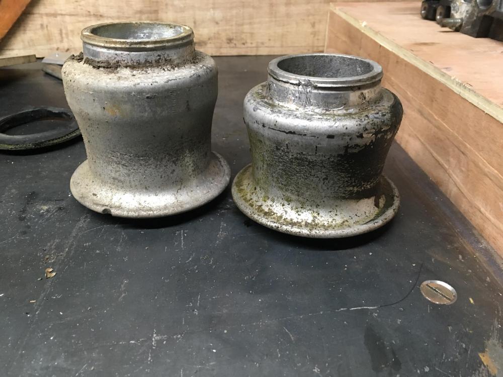

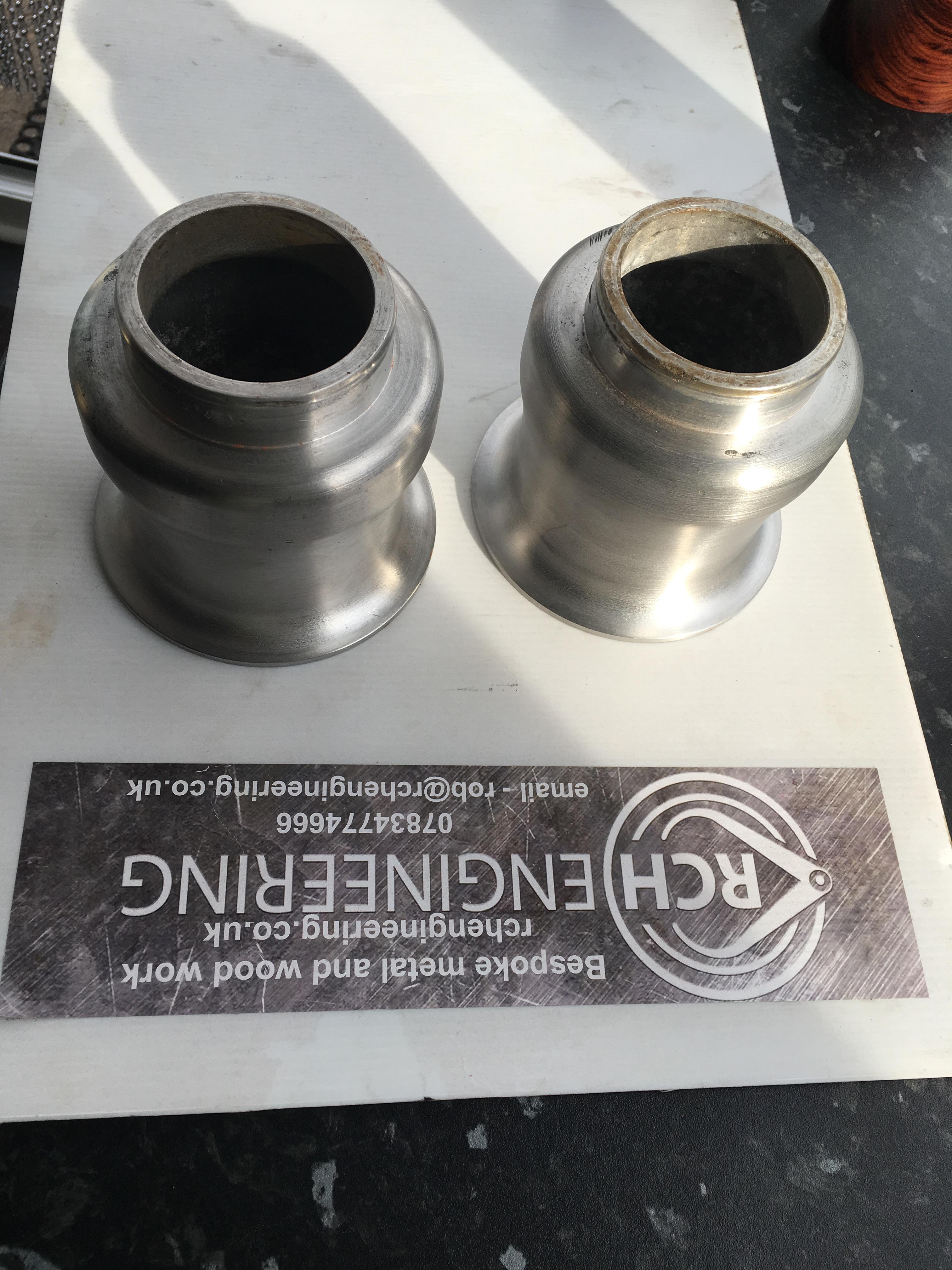

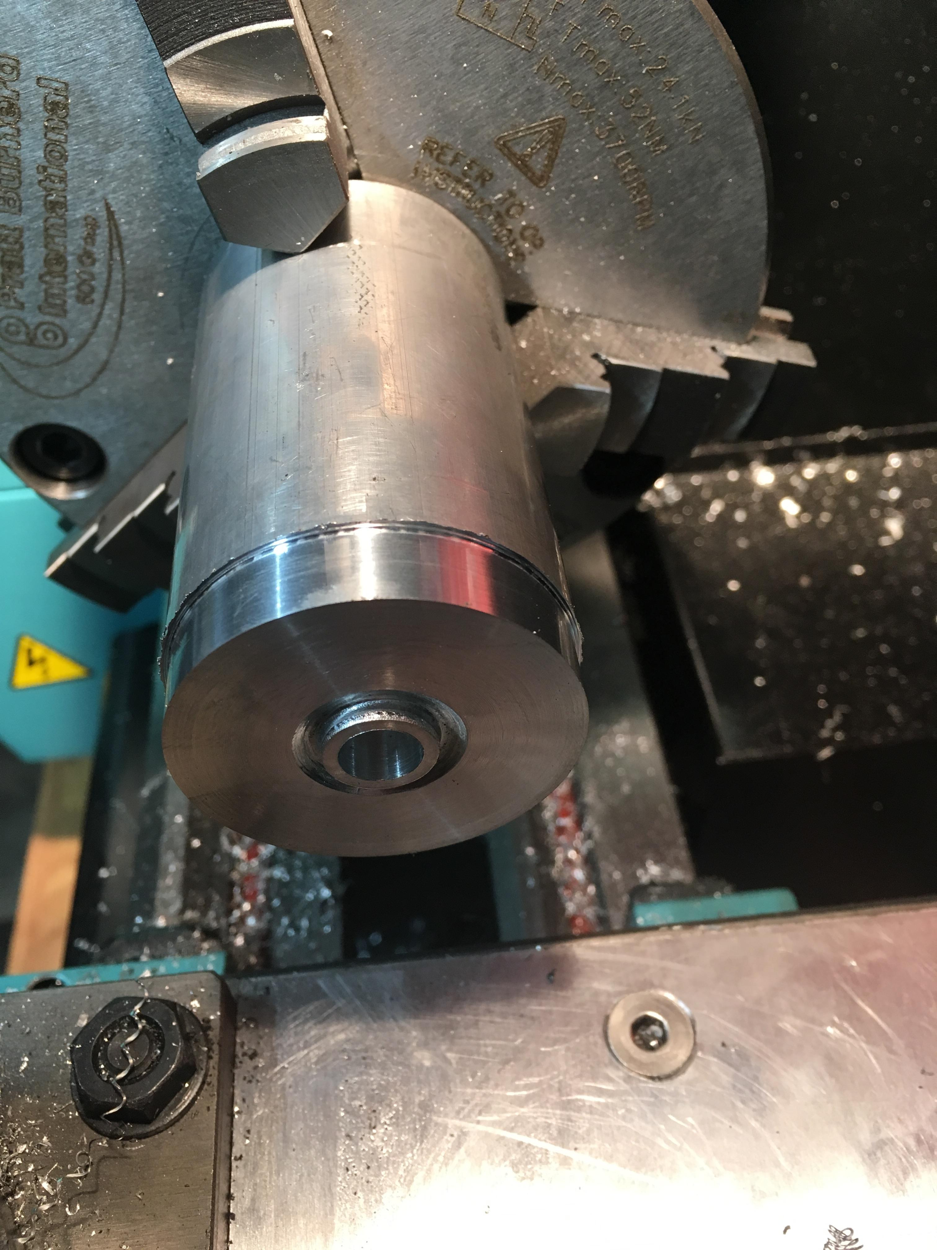

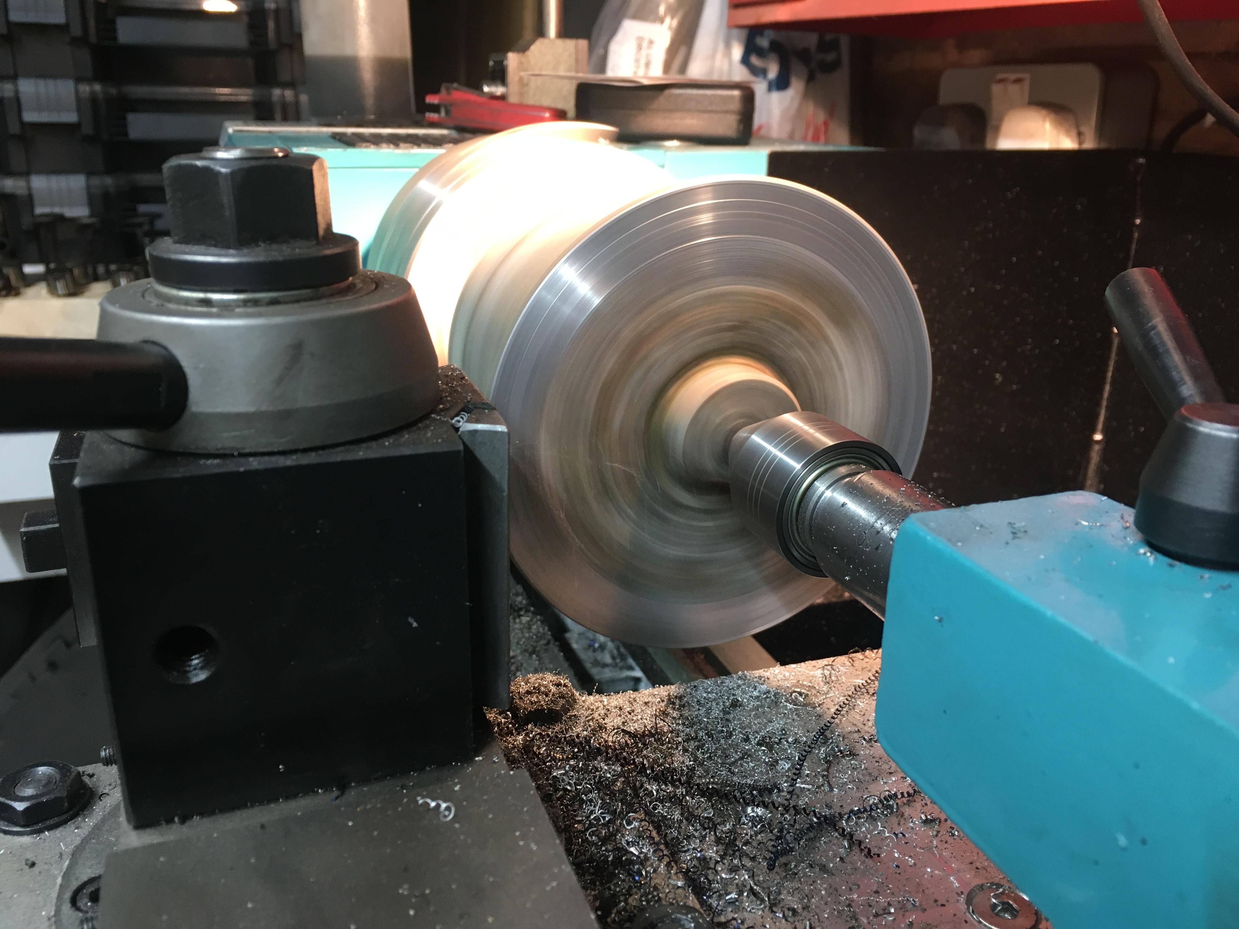

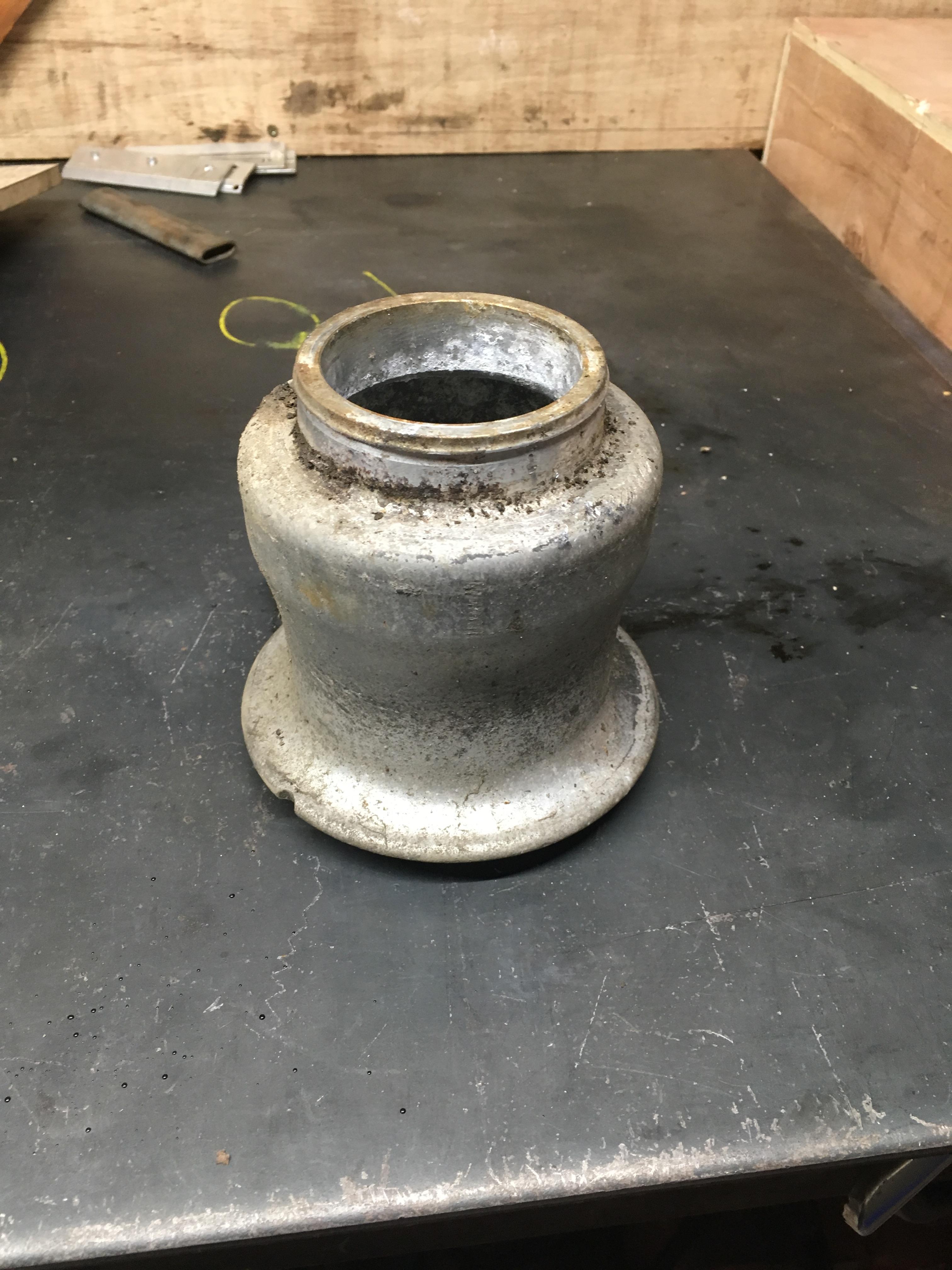

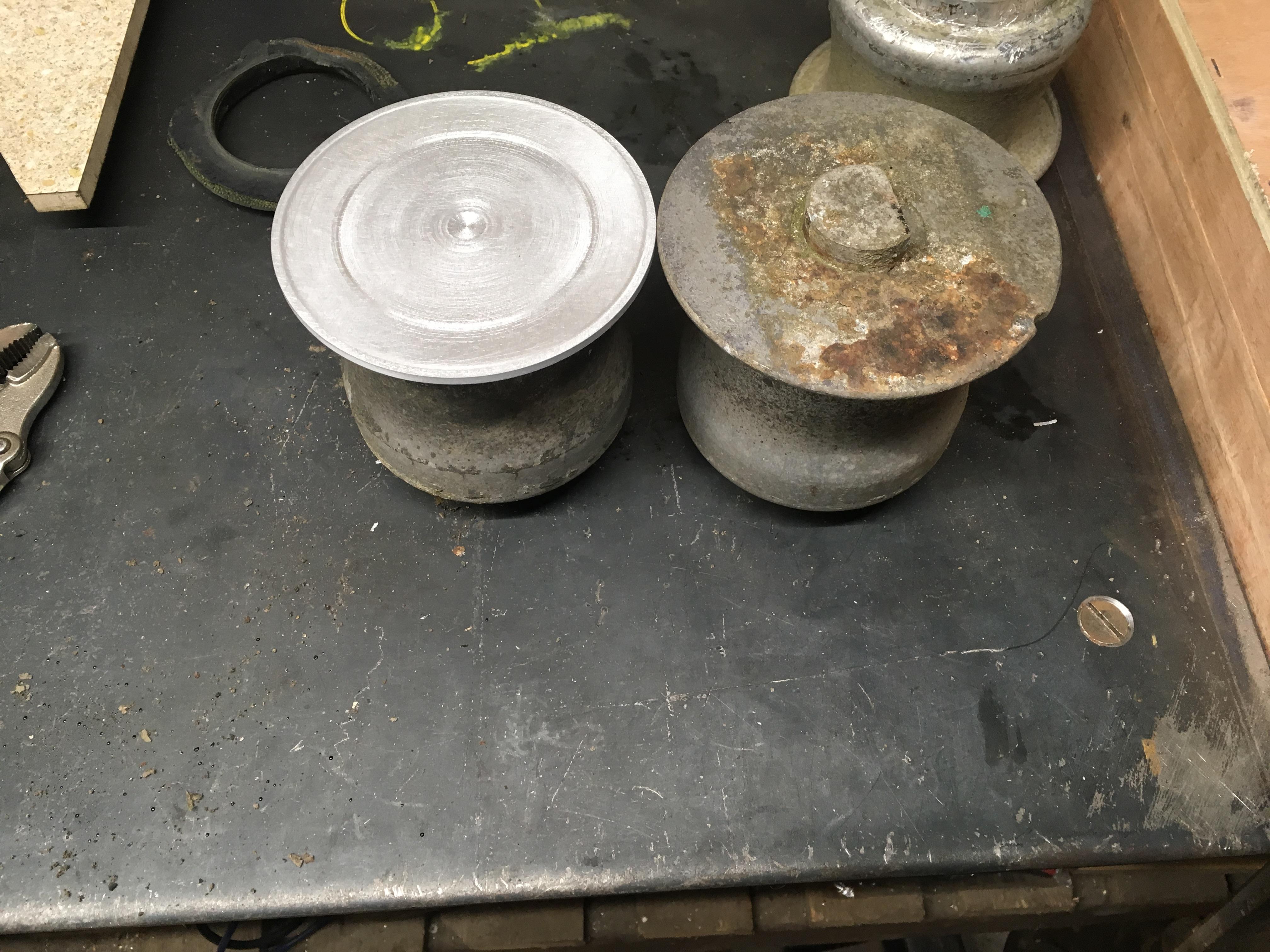

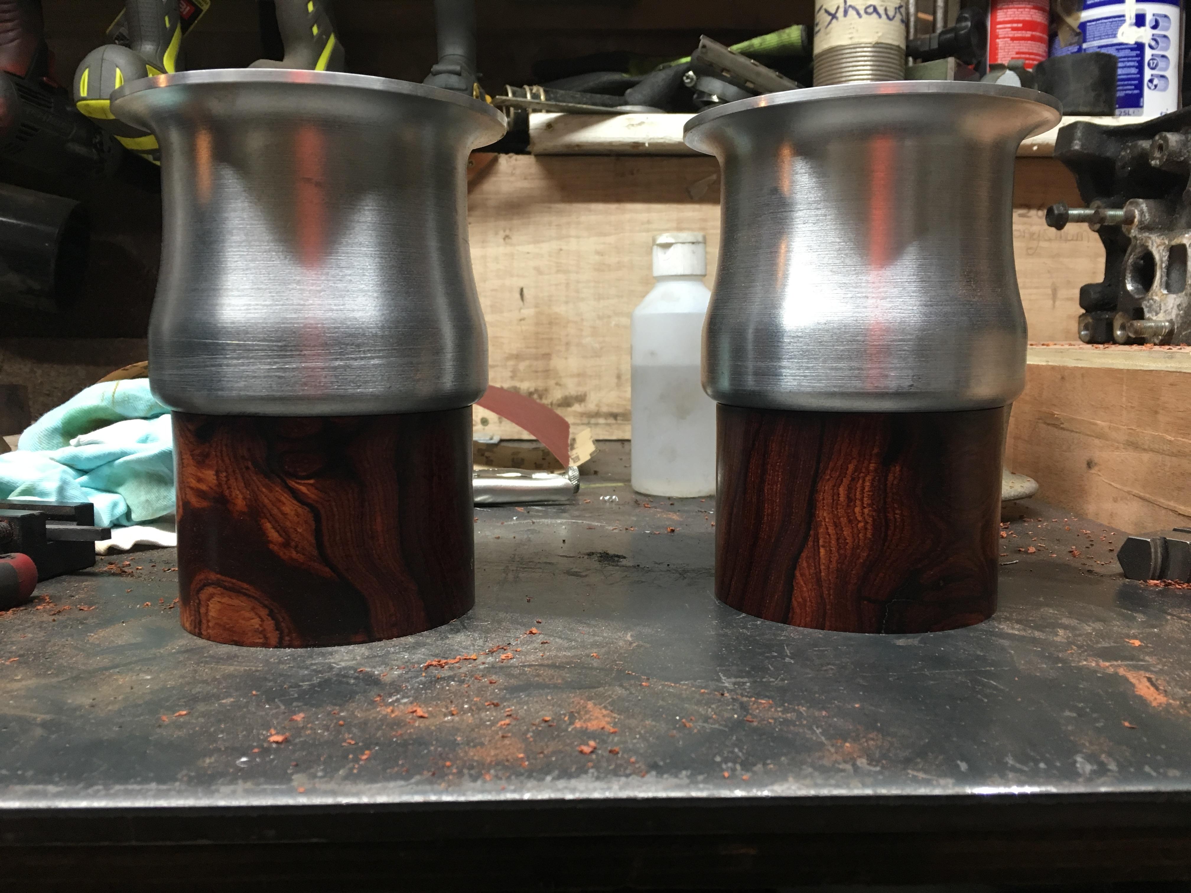

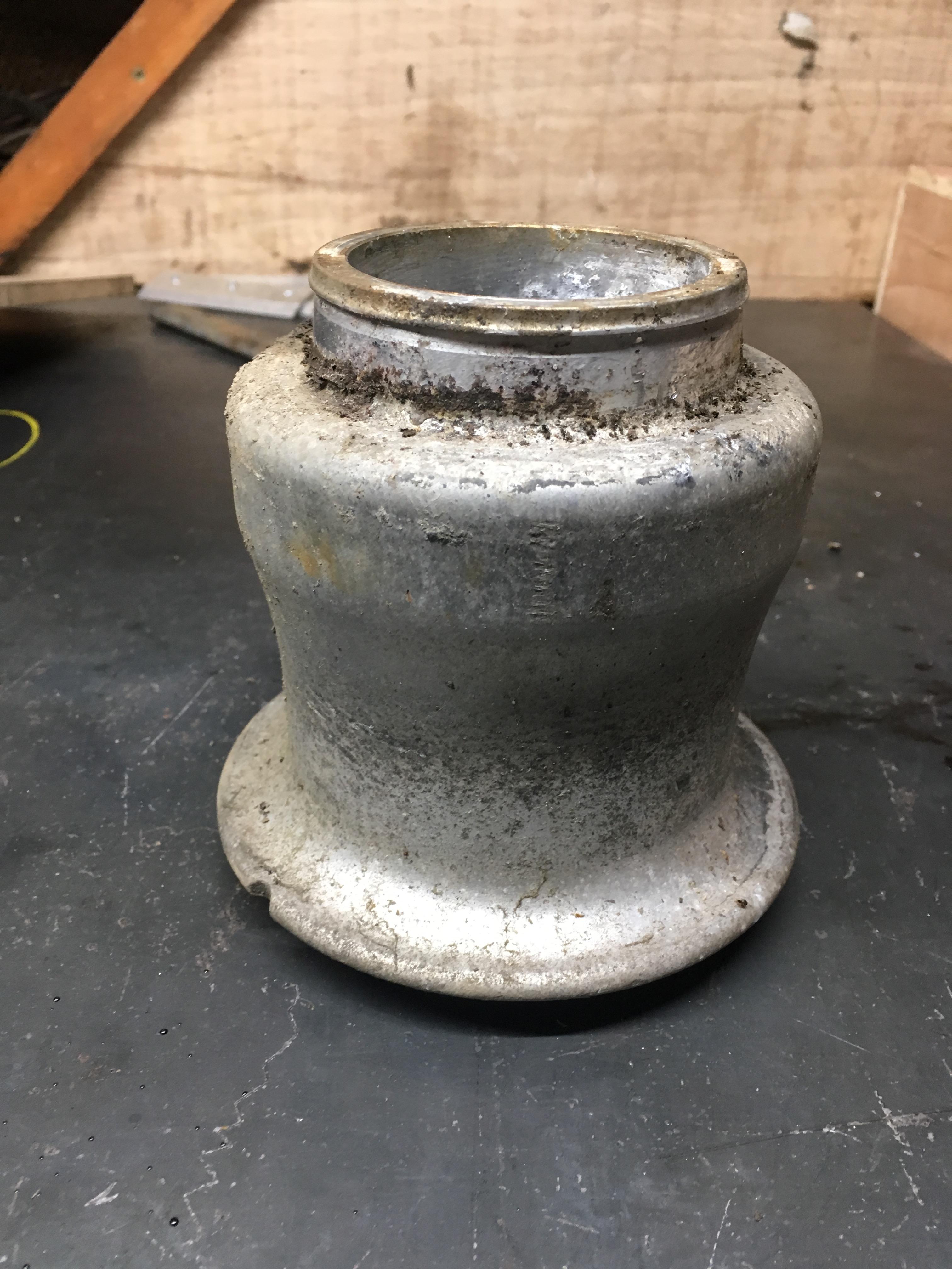

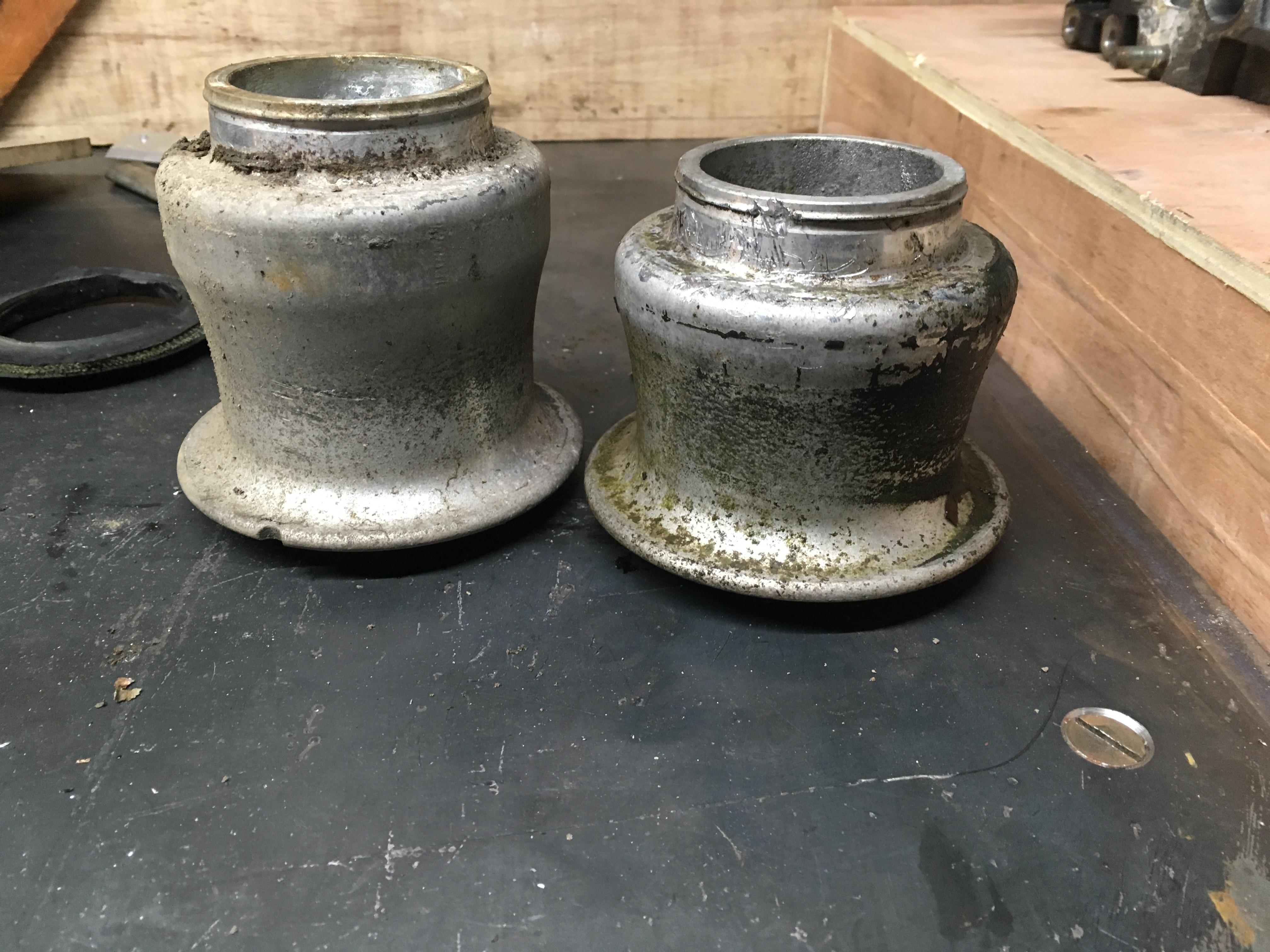

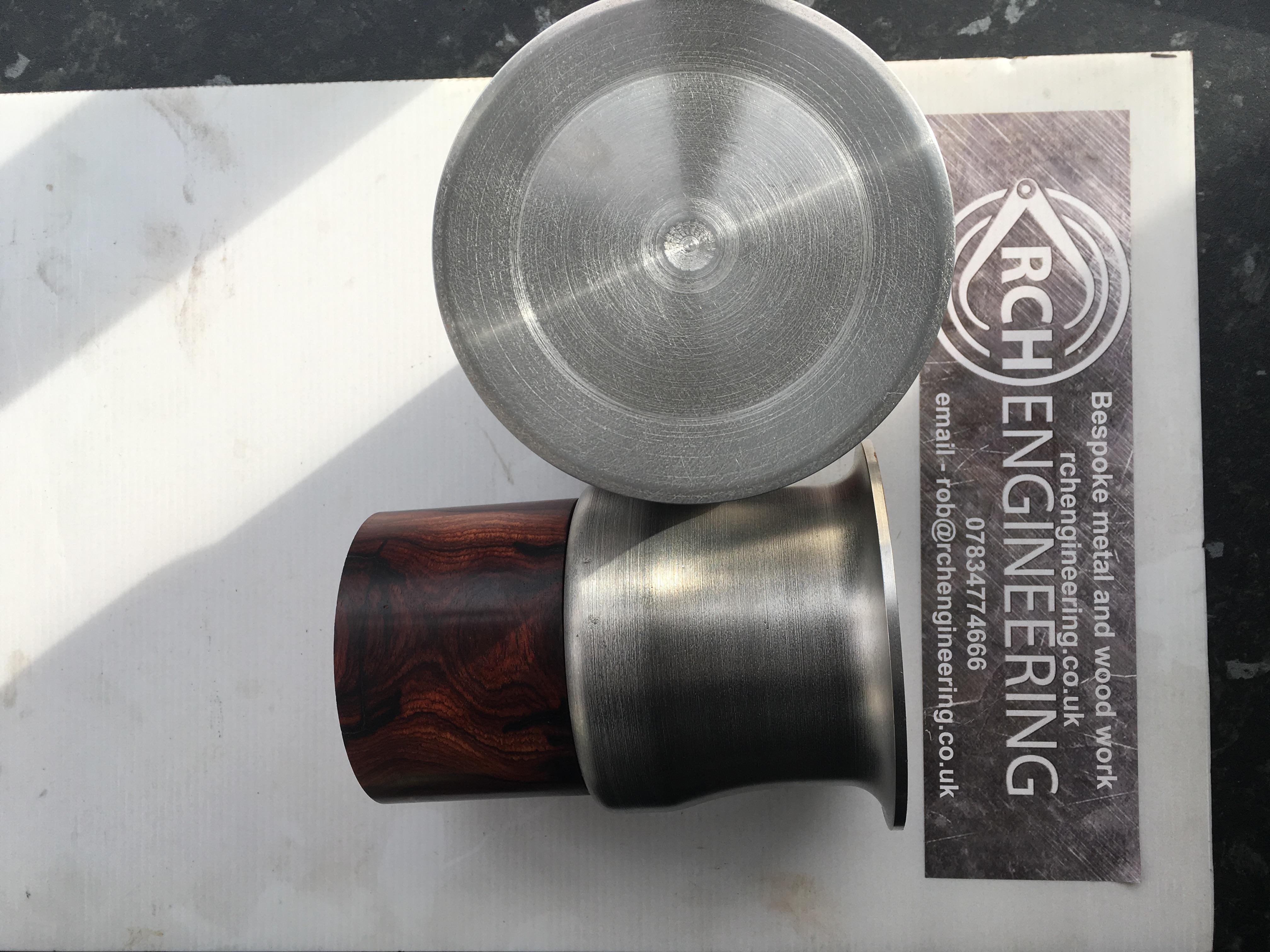

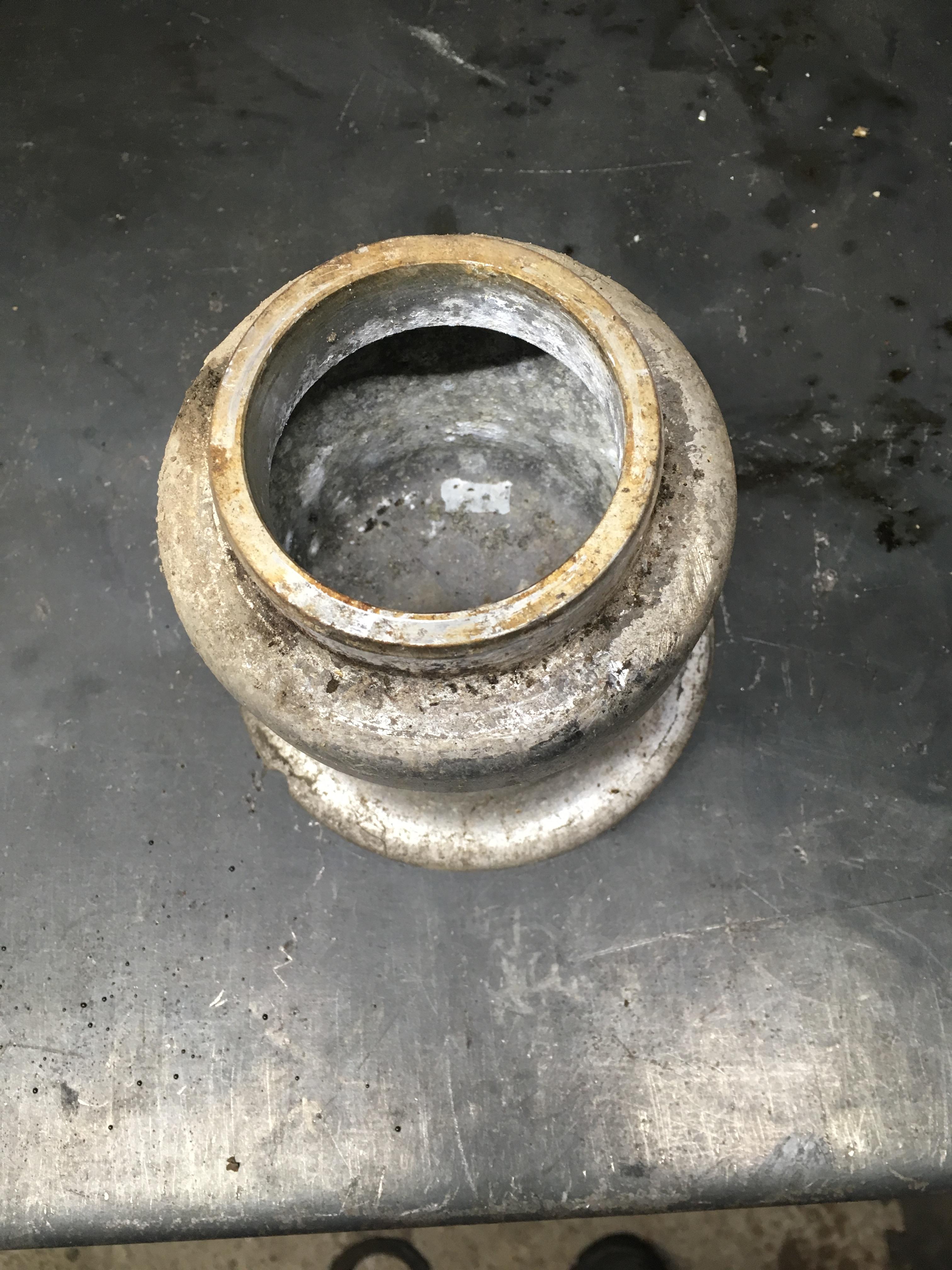

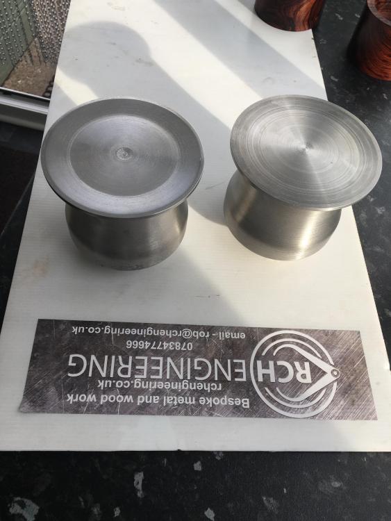

Land Rover P38 Range Rover air bag pedistal candle stands, these were for me too!
