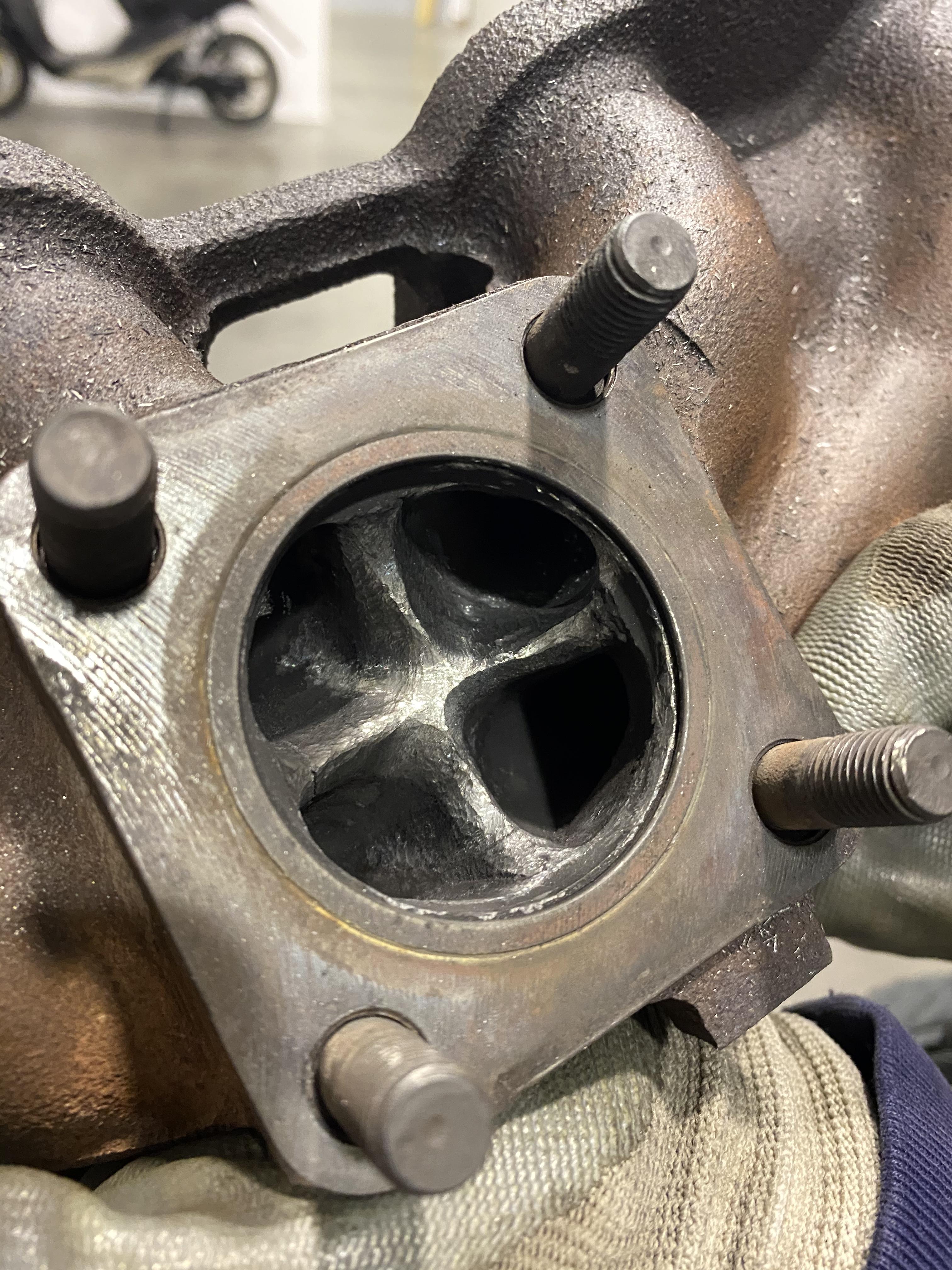

we already modified the exhaust opening the turbo side ports. It’s similar to what you posted on your thread.  Is this enough??5EDD98A0-D406-4269-89DD-F193402BE6B0.thumb.jpeg.a1e4964686d9cc3786cf5e5a684a9555.jpeg

I don't think it's enough, I didn't remove much material from the + in the turbo side. The big restrictions are in the #2 and #3 runners, so your restrictions are still there. My build thread shows where to remove material. Or if you don't want to grind it you should buy a tubular manifold before you increase the boost.

When we were in the process of grinding the exhaust manifold we figured that getting rid of material in the areas where the bolts get in would create weak areas that could crack. My friend didn’t feel like doing it. There are these Indian guys who sell a custom exhaust made of cast iron. I would have to buy that one and replace it.
