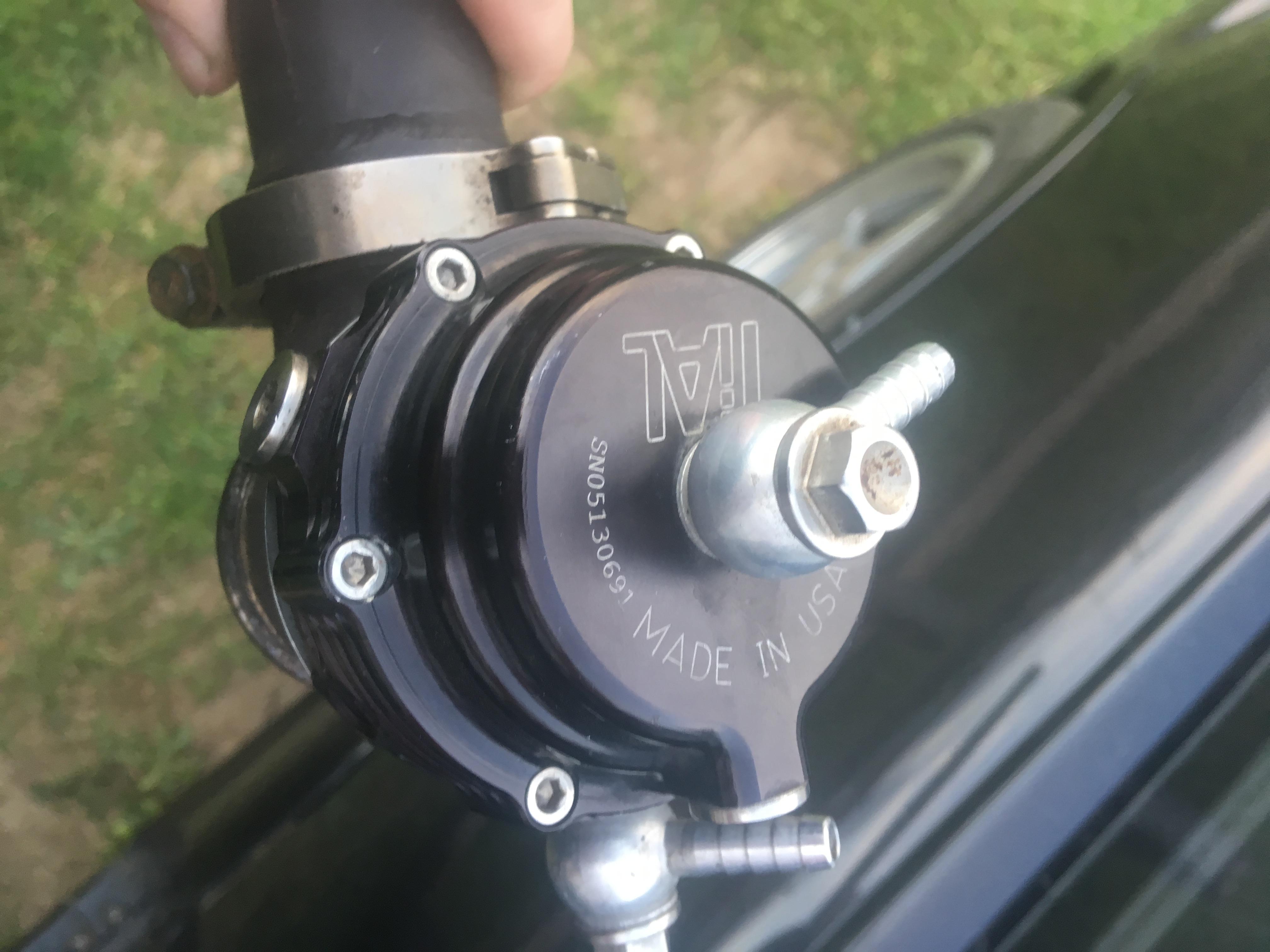

i need a new v clamp after my wastegate literally fell off while driving. I’m not sure what size v clamp I need, can anyone identify this wastegate

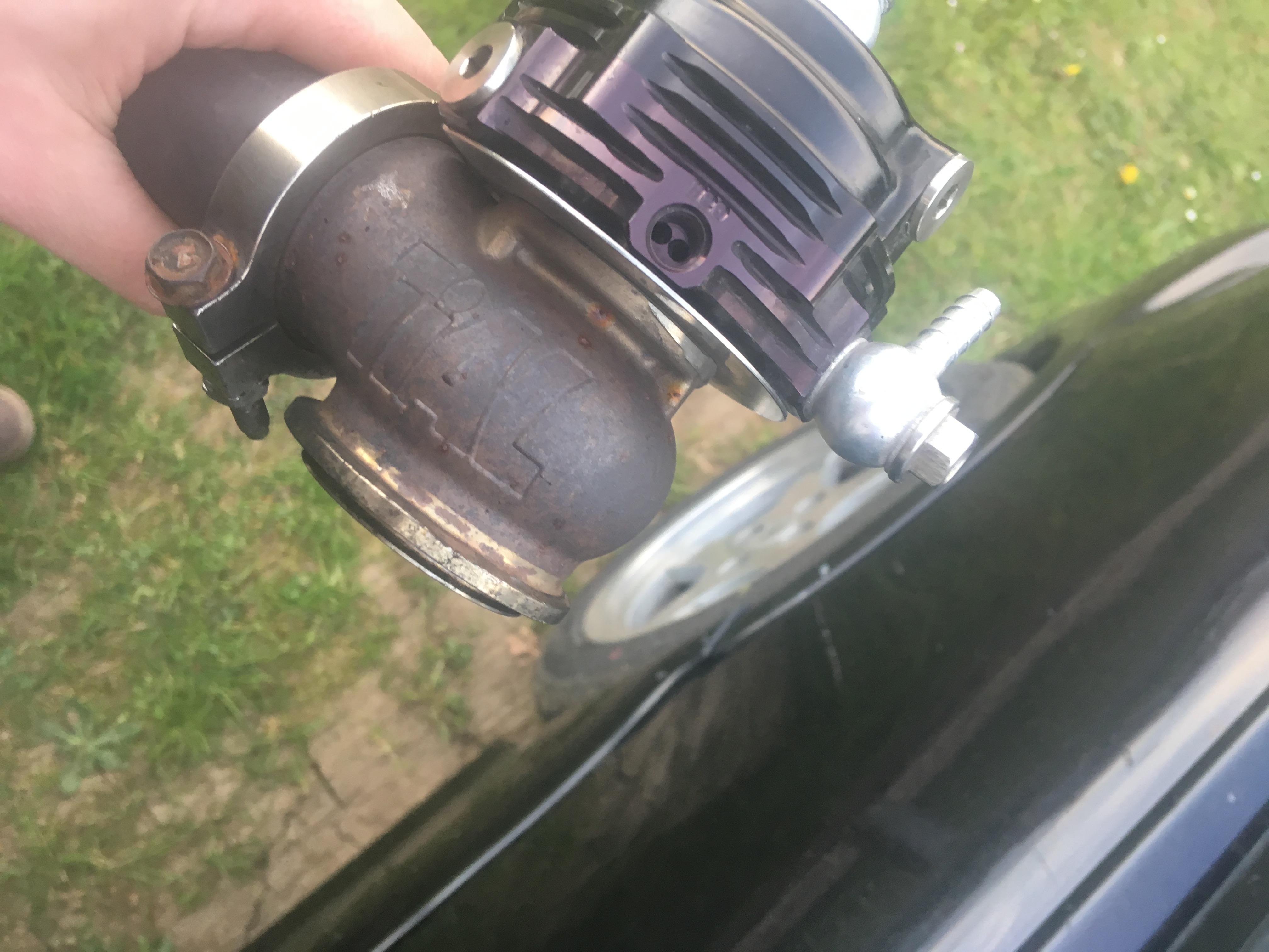

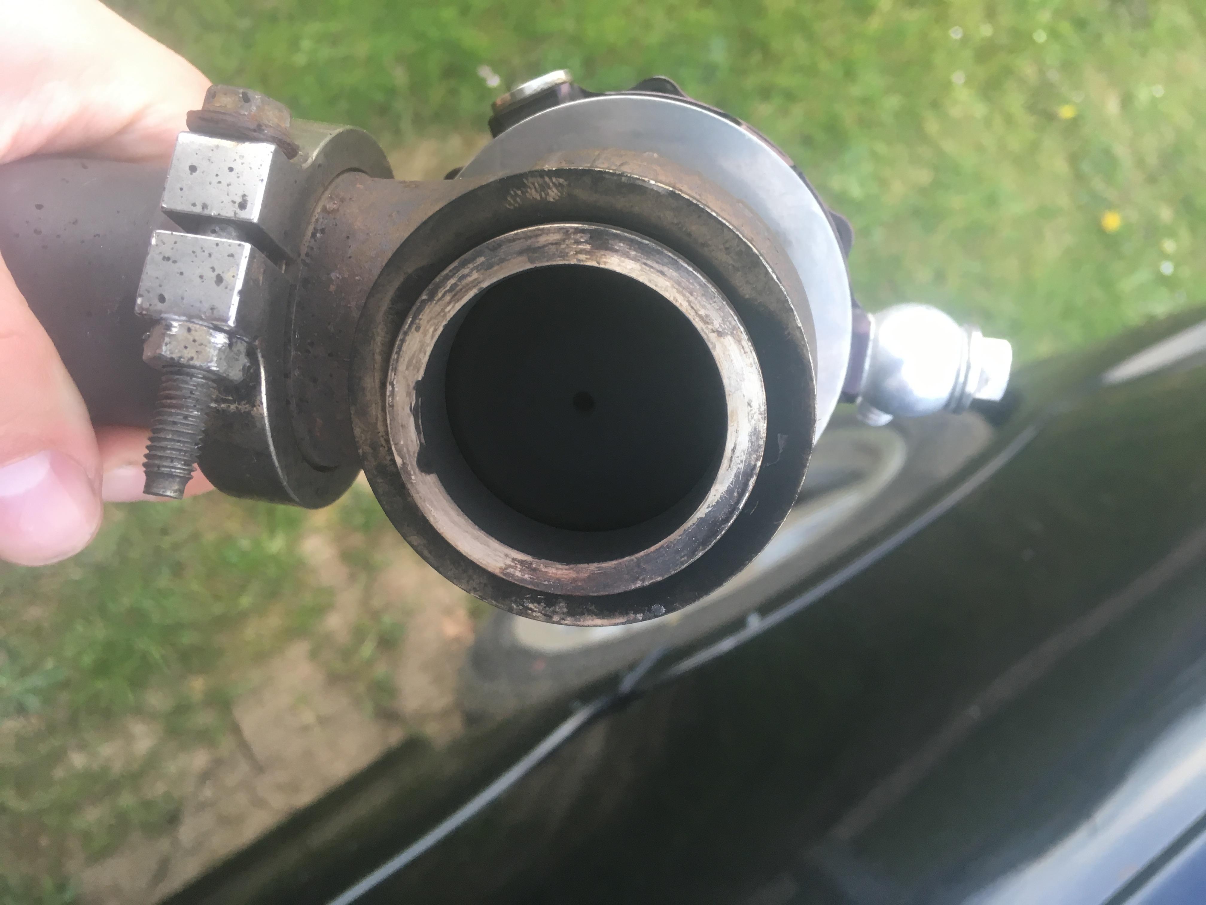

Is there anything I can measure to confirm this?
cheera dude

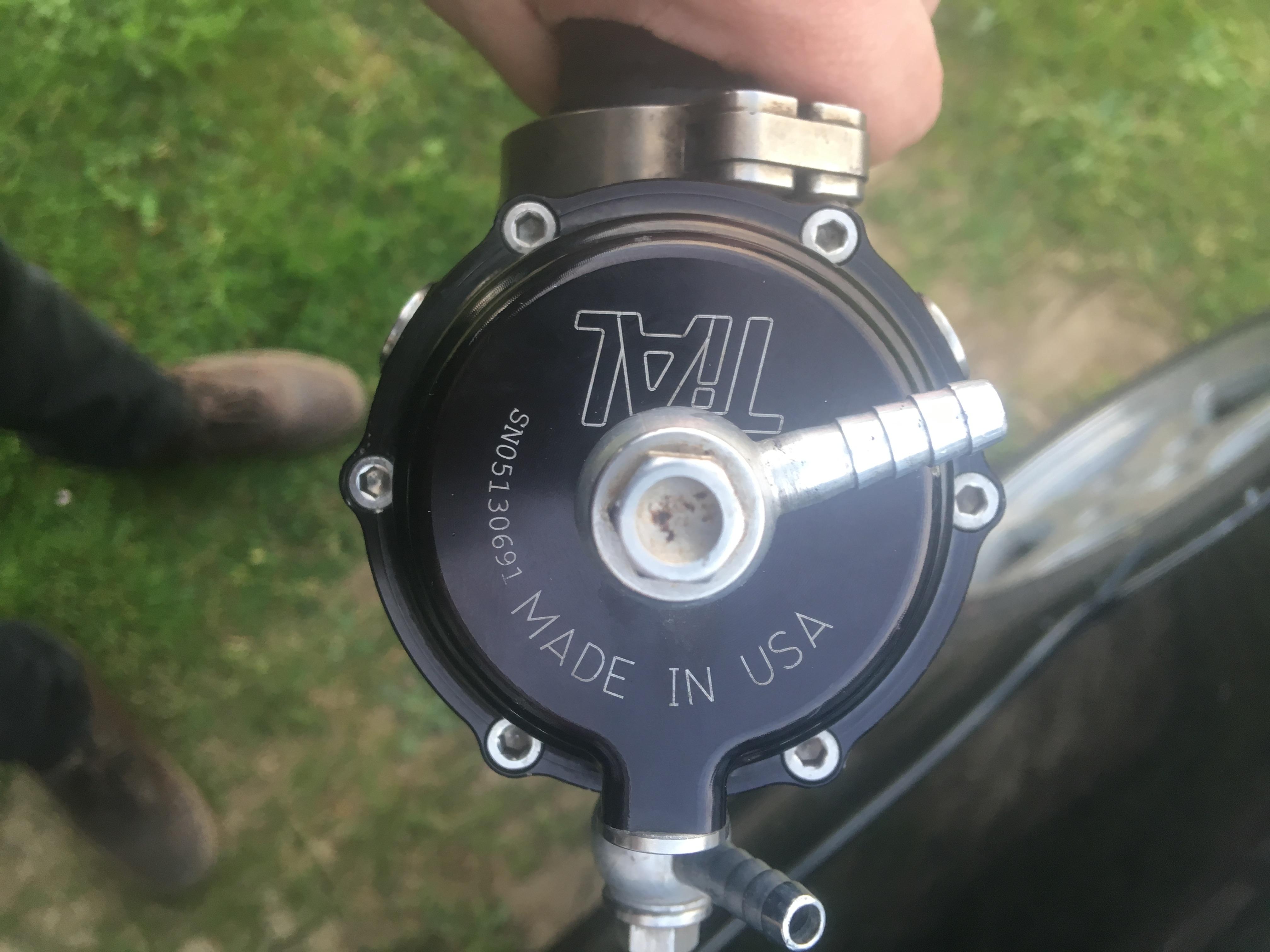

They only come in 2 sizes, 38mm and 44mm, looking at the pics its very easy to tell its a 38mm wastegate.
