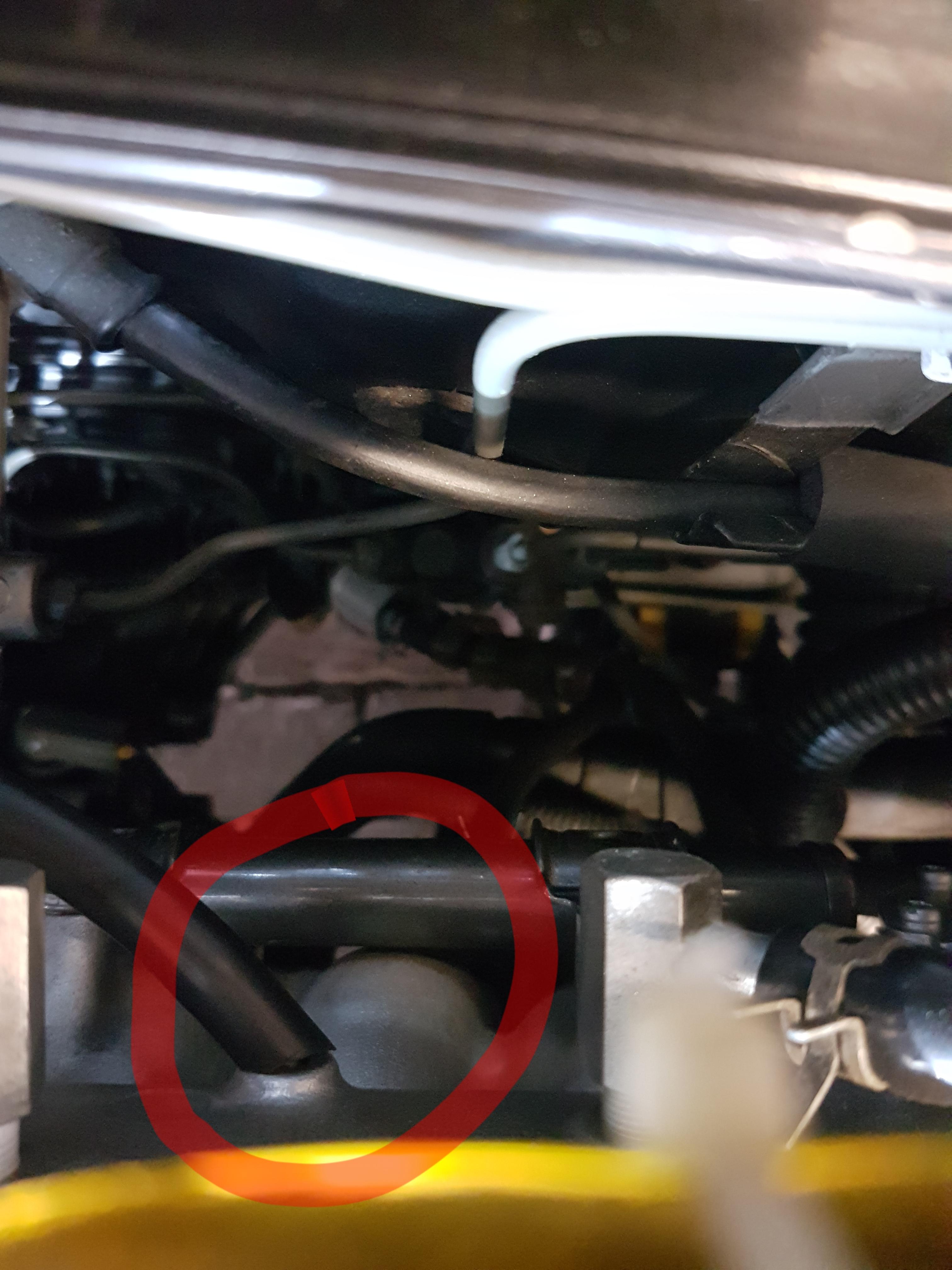

Is the vacuum nipple on the inlet for the map sensor supposed to be straight or does it come out at an angle? Its straight on my mates gt so not sure if mine is causing a restriction as it comes out at a 45° angle on my glanza.
That’s been bent mate . Should be dead straight . So yeah could be casing a issue were it’s kinked

Thanks for confirming that mate
