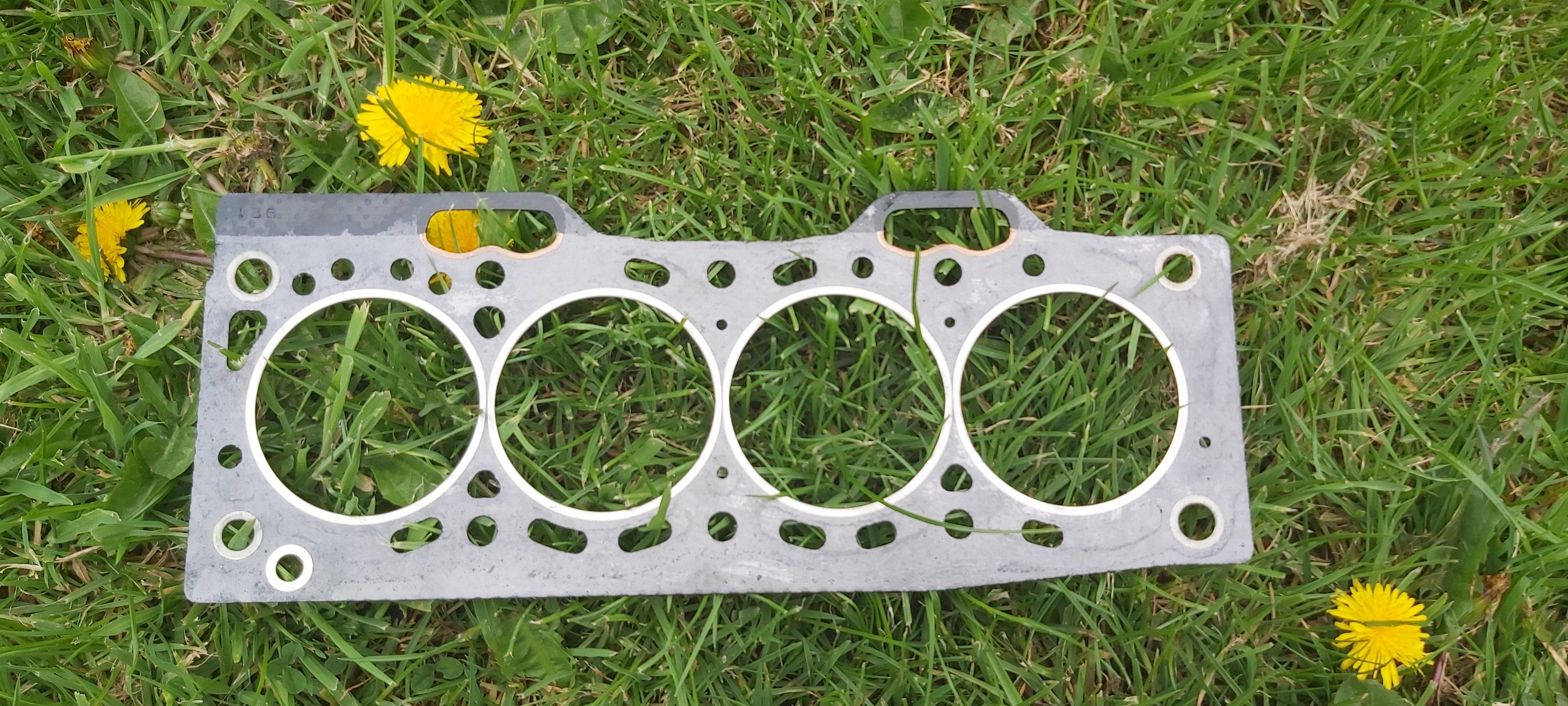

RenBlue Posted April 29, 2020 Author Share Posted April 29, 2020 (edited) I tried a few different things to no avail. I notice a small oil sweep/leak where the cylinder head and block meet. I thought maybe the headgasket was fitted upside that was causing the problems. I got someone to fit one for me 2 weeks ago so I stripped it down today. Is this the right way it goes? It only seems to fit one way ? Edited April 29, 2020 by RenBlue Quote Link to post Share on other sites
ChristopherEP70 Posted April 29, 2020 Share Posted April 29, 2020 (edited) I think the lot number on the top left should be facing up so that would be the right way Edited April 29, 2020 by ChristopherEP70 Quote Link to post Share on other sites
