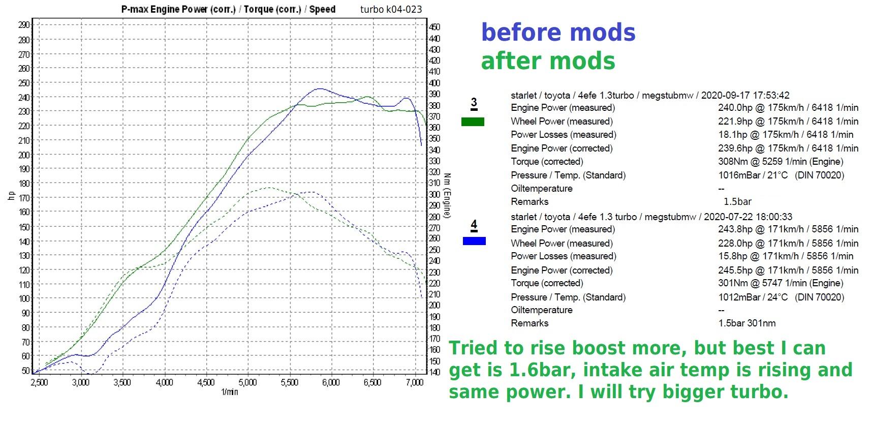

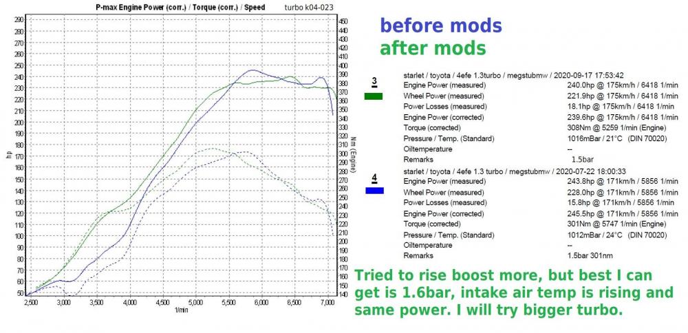

MegstuBMW Posted October 23, 2020 Author Posted October 23, 2020 (edited) Edited October 23, 2020 by MegstuBMW Quote
Sam44 Posted October 23, 2020 Posted October 23, 2020 (edited) Nice work, very respectable figures. I'm liking the smooth power build and torque figures from a 1.3ltr engine. I must admit I was expecting more from the k04. Edited October 23, 2020 by Sam44 Quote
MegstuBMW Posted October 23, 2020 Author Posted October 23, 2020 6 minutes ago, Sam44 said: Nice work, very respectable figures. I'm liking the smooth power build and torque figures from a 1.3ltr engine. I must admit I was expecting more from the k04. Thank you. With this turbo I can make 1.5bar at 3k rpm, but I tuned boost control to make power progressively. Power at low rpm makes more stress for gearbox, crankshaft bearing caps.. Quote
Sam44 Posted October 23, 2020 Posted October 23, 2020 (edited) 33 minutes ago, MegstuBMW said: Thank you. With this turbo I can make 1.5bar at 3k rpm, but I tuned boost control to make power progressively. Power at low rpm makes more stress for gearbox, crankshaft bearing caps.. Very surprised with the k04. Great tunning. The waste gate/exhaust side is better positioned and a good option for the starlet. Edited October 23, 2020 by Sam44 Quote

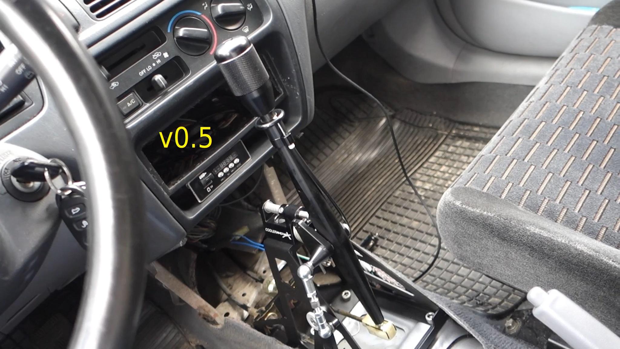

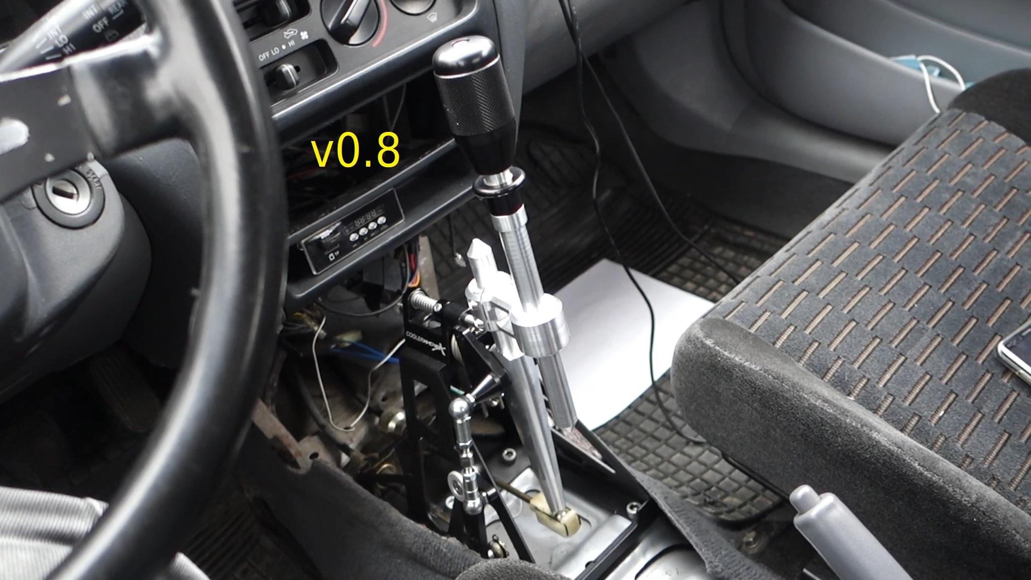

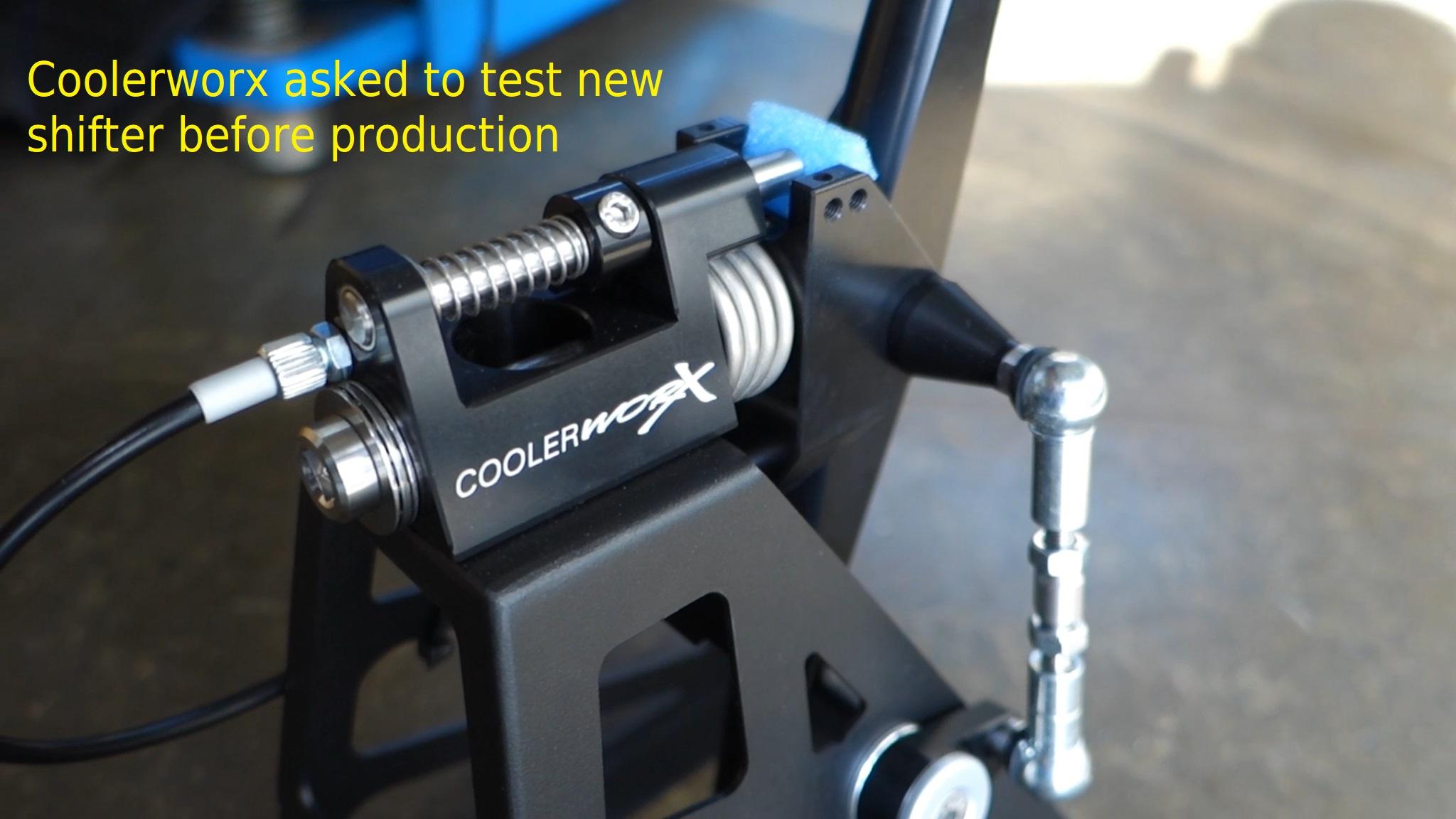

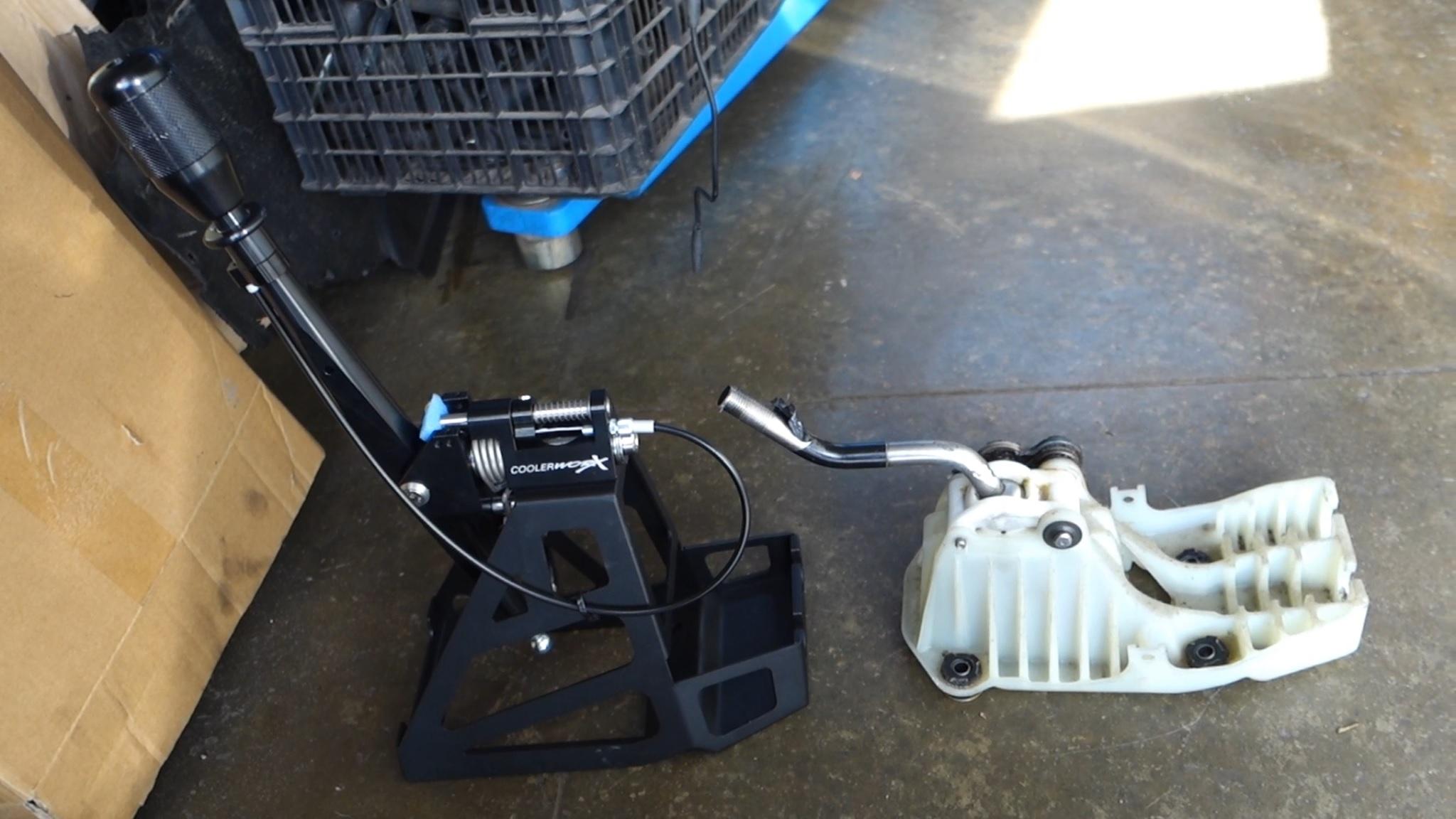

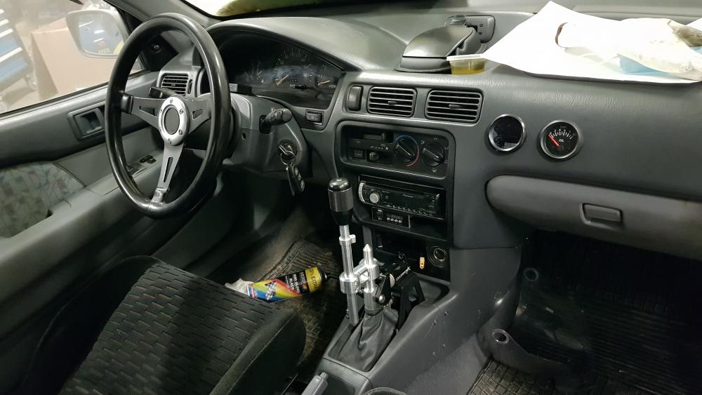

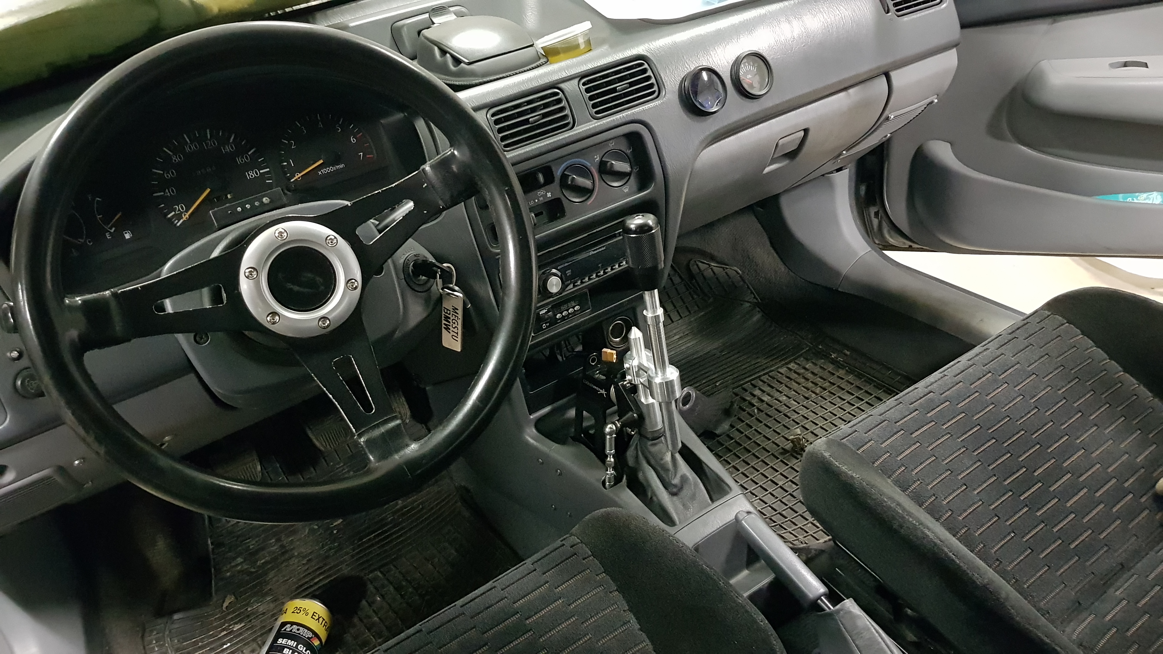

snails ep91 Posted December 7, 2020 Posted December 7, 2020 how does the coolerworx shifter feel/work with the cables? looks like a neat upgrade to improve shifter feel. my gear selector has such a sloppy feel to it Quote
MegstuBMW Posted December 7, 2020 Author Posted December 7, 2020 45 minutes ago, snails ep91 said: how does the coolerworx shifter feel/work with the cables? looks like a neat upgrade to improve shifter feel. my gear selector has such a sloppy feel to it Shifter feels very solid and precise, pleasure to shift every time 🙂 . Quote
snails ep91 Posted December 7, 2020 Posted December 7, 2020 15 minutes ago, MegstuBMW said: Shifter feels very solid and precise, pleasure to shift every time 🙂 . are they making them available to buy for starlets? Quote
MegstuBMW Posted December 7, 2020 Author Posted December 7, 2020 1 hour ago, snails ep91 said: are they making them available to buy for starlets? Yes, this is still not final version, but it is very close. Quote

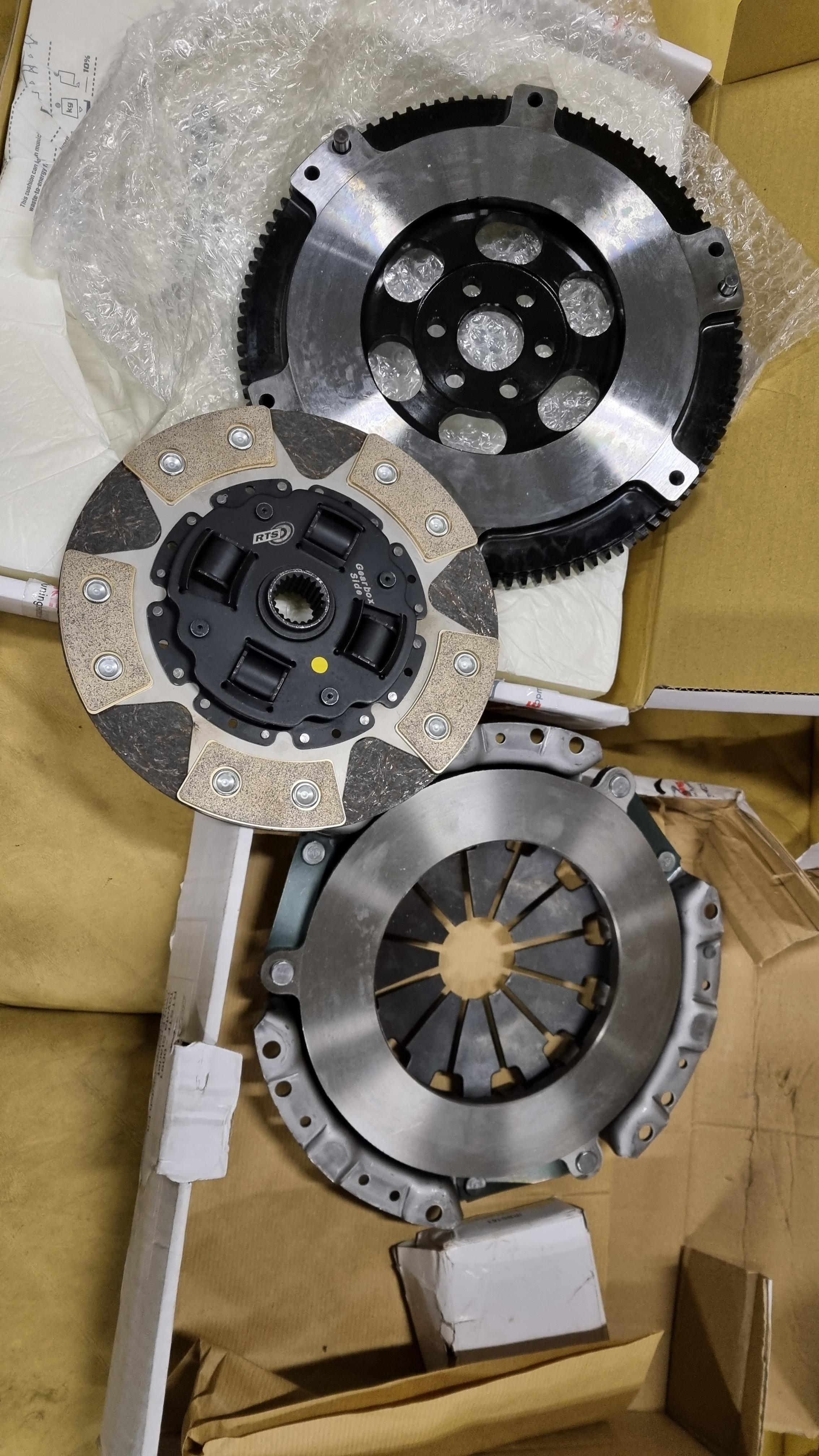

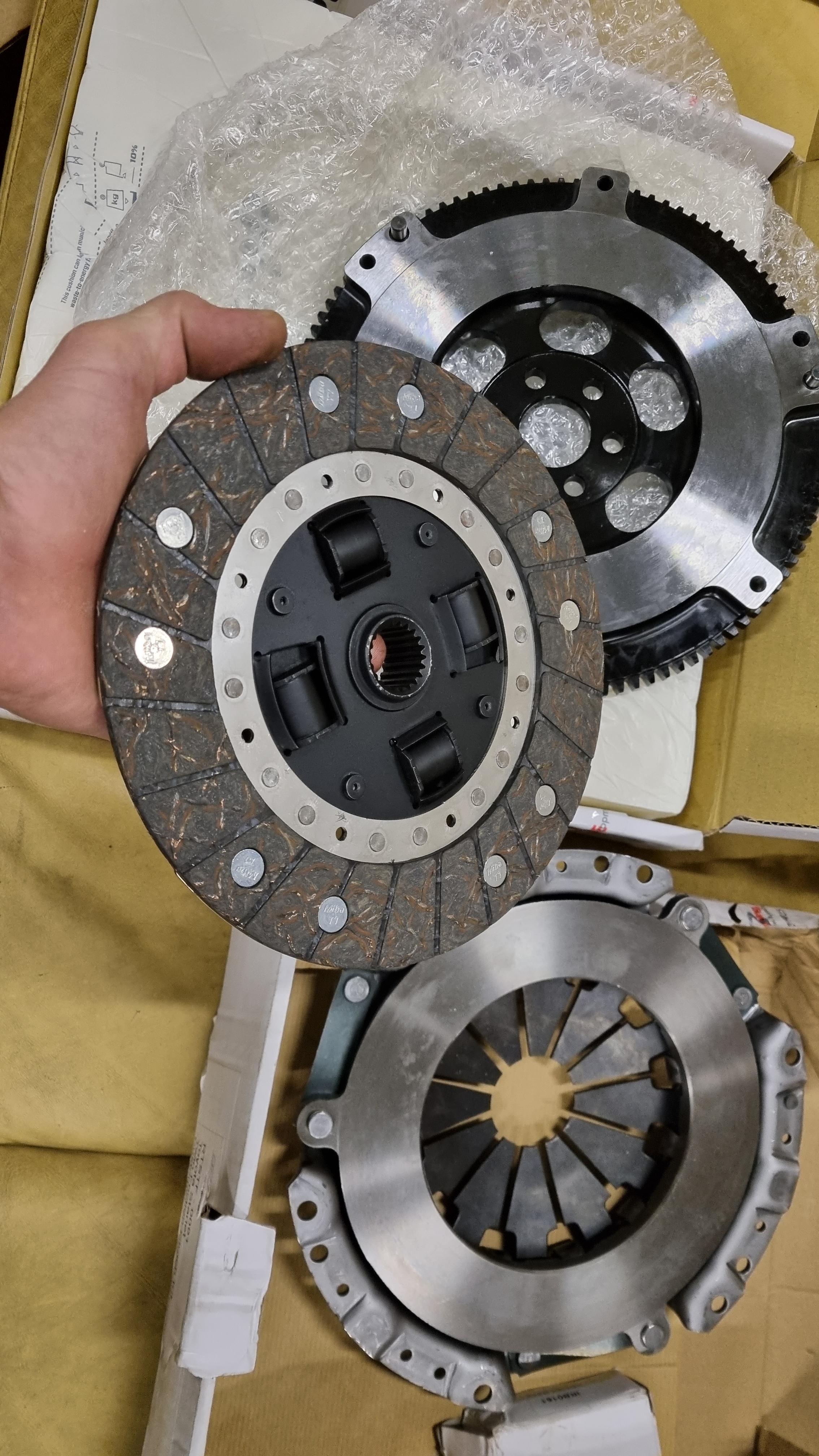

MegstuBMW Posted October 12, 2021 Author Posted October 12, 2021 New clutch waiting to be installed. Clutch is from "tuning development" New twin friction disc design. Quote
