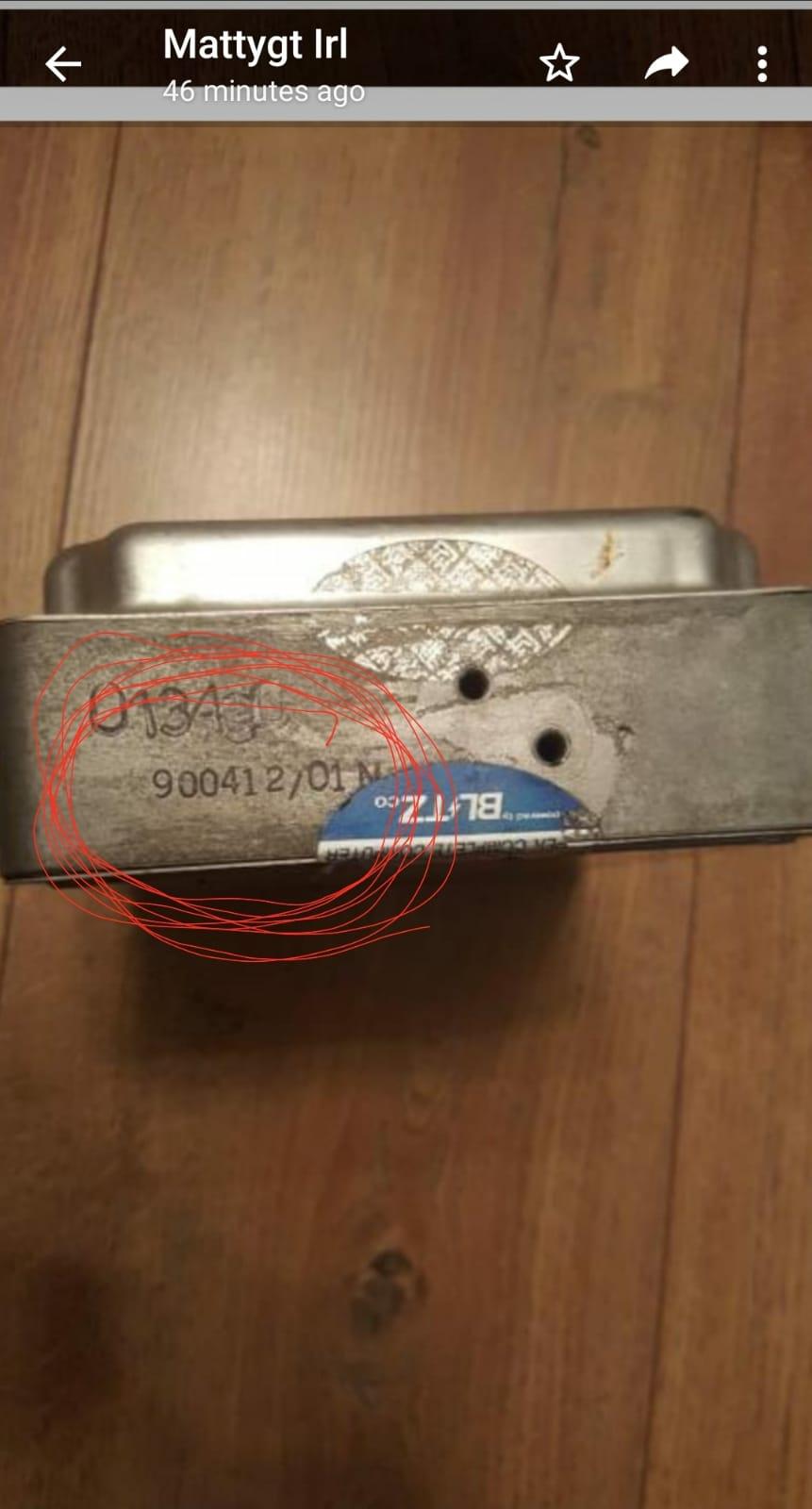

matty gt Posted June 19, 2020 Posted June 19, 2020 Lads any one any ideas as i am the seller of the ecu to neil any help would be appreciated Matty Quote

matty gt Posted June 24, 2020 Posted June 24, 2020 The blitz ecu is defiantly for mk1 gt as confirmed by jaystar on here production date japan reads from back so its 12/04/1990 this has been sorted on here surely with the world of knowledge thats on here im happy to issue neil a refund but he would rather get the ecu running in his car Quote
