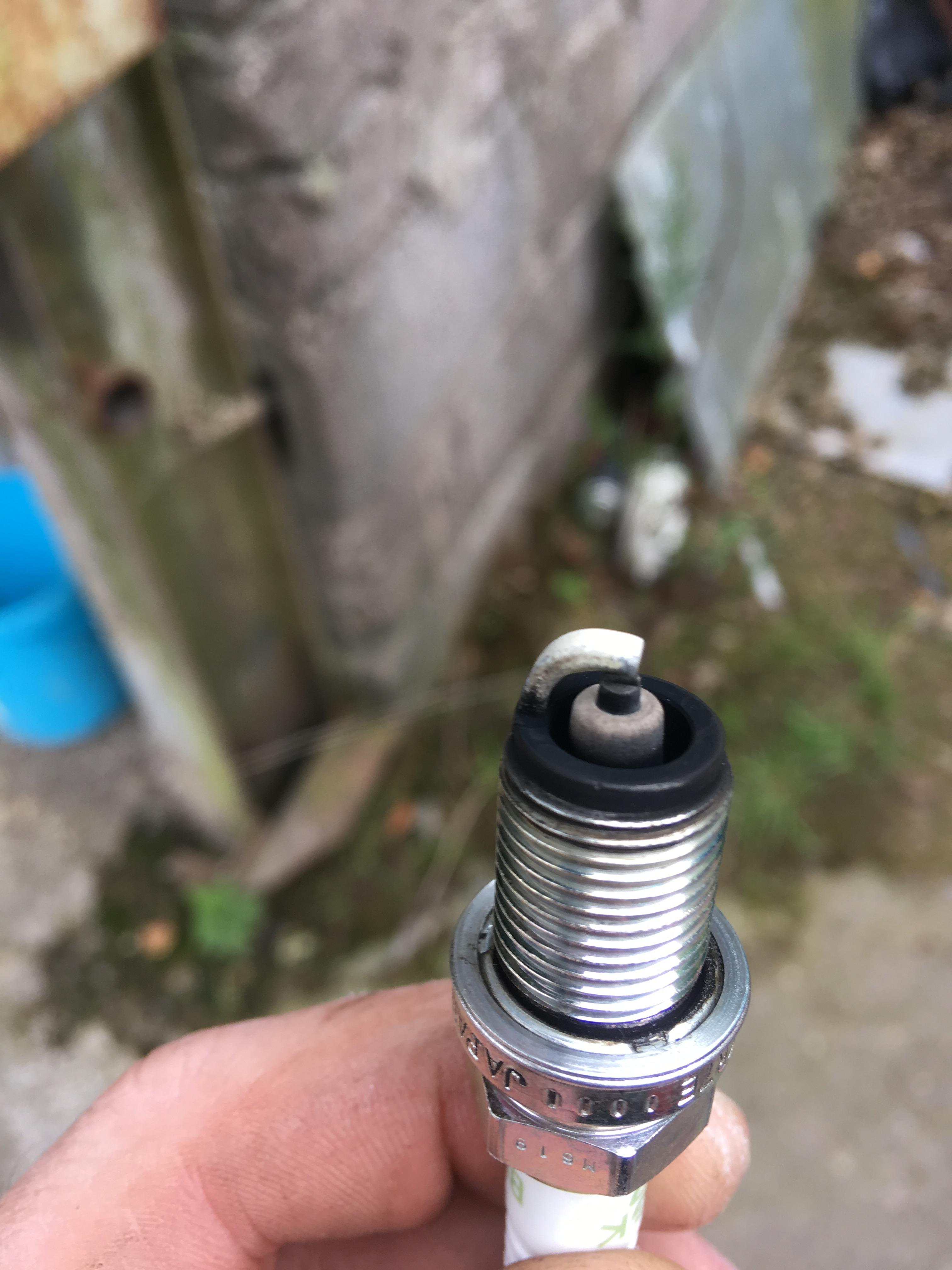

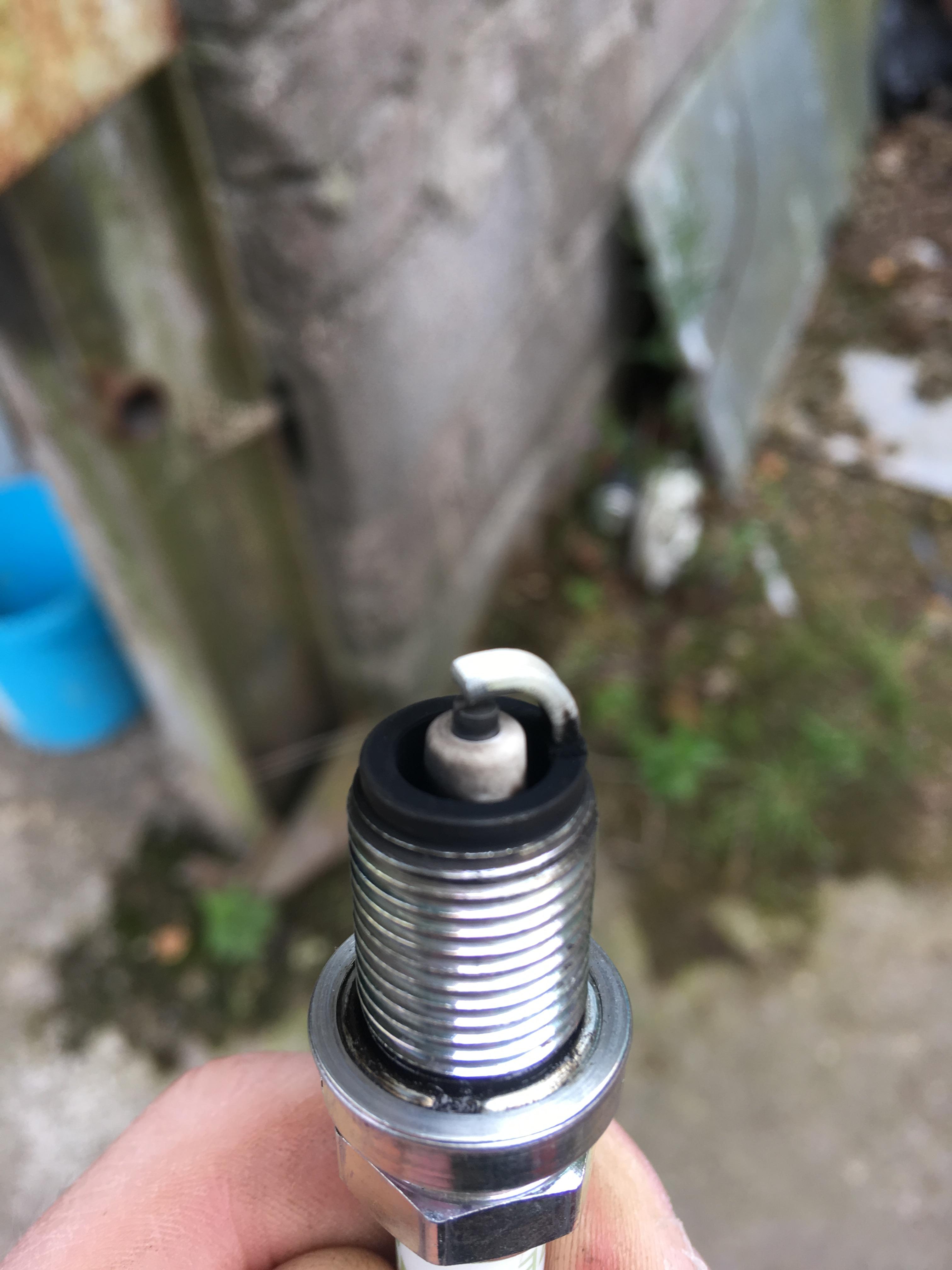

Hows it going  ive recently went to td04 setup in my boxy. Ive changed the plugs and have taken one out now and was wondering if somone could read it to see if there is anything untoward going on.
Setup is standard injectors, mani, decat, new td04L internally gated with Hks adjustable actuator full 2 1/2” straight through exhaust, bosch 044 external pump, cold air relocate, front mount intercooler,blitz access pnp ecu. Running only .5bar with small creep to just under .6 > Spark plugs are ngk bkr7e gapped to .8mm
My concern is the ground strap being white, is this indicative of an ignition timing issue or the wrong heat range plug ?
Any info appreciated, thanks

Quite a bit of cement boil and the shroud is to black. What's your fuel pressure set to and I'd get the injectors cleaned. What boost pressure are you running. Which cylinder is the plug out of and are all the plug shroud this black.

Well lad she has the standard fuel pressure reg so i would imagine ~2.5bar base pressure. The injectors have been refurbed and flow tested, all within 5%. I am currently only running just under .6bar I was under the inpression that the outer shroud is black due to running rich which is safe to say as i am using the blitz access ecu which tends to run richer than stock and also the 255lph 044. All spark plugs are almost identical to one another. Had hybrid ct9 setup not too long along and everything was spot on at .8bar. Ct9 setup was run on standard ecu and got the blitz to run the td04 for i was hoping.8bar. I belivee that the blitz may have somthing to do with it as it has abit more aggressive timing/fueling etc so my belief is that the base ignition timing from the dizzy is abit out and from this the more ‘aggressive’ timing is causing to go out of its safe operating or ideal range. Currently i am unable to set/check the base ignition timing again due part of the crank pulley having chipped off around the mark used to time it up with cover. I have a 4efe one on the way for the time being. It is not being driven so I was just trying to pick some brains to see if anyone could help as you can imagine I do not want to cause any negligent damage. Thanks for your reply.

I would suggest fitting a wideband o2 sensor and gauge to read the AFR's as well as timing check (when you can).
Also be aware that the 4efe crank pulley isn't a harmonic balancer type like the 4efte one is. Some have expressed concerns about using the non harmonic type.
A lean condition and too advanced spark is a recipe for melted pistons. You have done the right thing to be cautious.
I'm certainly not an expert in reading spark plugs but after doing some internet research, soot on the outer part can be rich at idle, might not be rich at full throttle though.

I'd say  The mixture isn't lean I'd say it's not atomising properly either injector fouling or low fuel pressure, there's alot of crust (cement boil) on the center earth electrode this happens when the fuels boils instead of being atomised both the black outer and white inner also contribute to this.
When I tested my fuel pressure it was 30psi at idle throttle closed and 32psi throttle open. I got better fueling results showing on my wide band, egt and plugs from 32psi idle upto 40psi open throttle the power difference was also very noticable. 36psi us a sweet spot I've setup a GT turbo recently on a near standard ct9 standard high boost using an fse fpr throttle open is very noticable. The GT also had 30psi and 32psi fuel pressure on standard fpr. Just to add near all denso top feed injectors record 30psi on the data sheets I've seen so this confirms the physical results I've seen.
In this cylinder you are running the wrong heat range plug. I'd drop to a 6. It's normally around 1bar of boost a heat range 7 is required. Compression ratio and fuel mix dependant. the colour of the center electrode white insulation but first I'd try and up the fuel pressure alittle and see if it cleans up the plug.
If you can get me better high resolution up close pictures I can help alittle better.
Always a great idea to check ignition timing.
