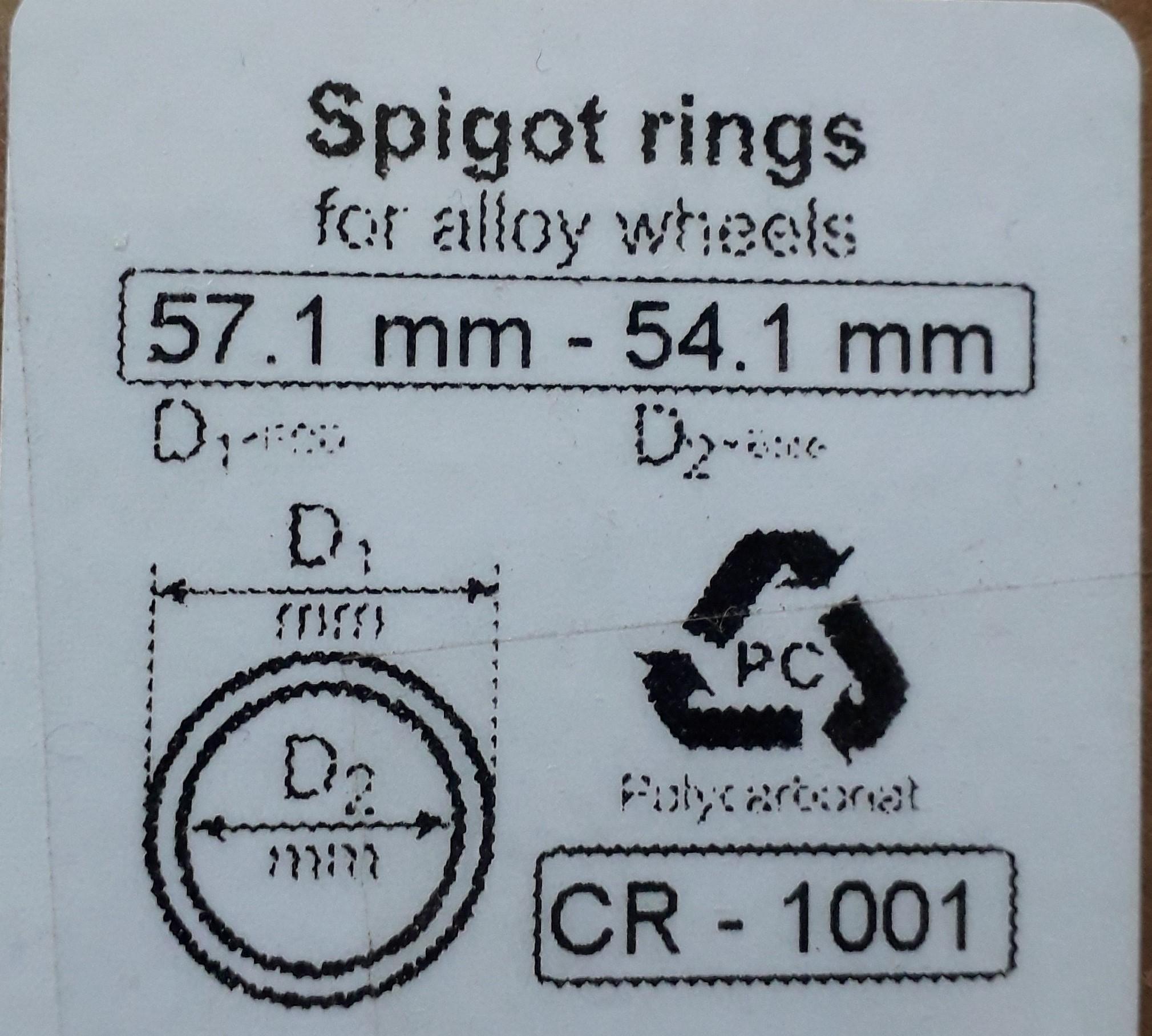

RWDM47 Posted July 23, 2020 Posted July 23, 2020 (edited) Hi guys, I recently bought some 15 inch replica BBS wheels for my 1998 Starlet but now that they're installed, the steering wheel is slightly off centered towards the left, if I center it, the car pulls to the right. I don't have hub centric rings as I bought these second hand. Would I need to get an alignment done after I get hub centric rings on? Also, while measuring, would I be correct that the center bore of the hub is 54mm? Do I need to get 54.1-56.1 or 56.1-54.1? Sorry about the questions I've never had to do this until now so still learning Edited July 24, 2020 by RWDM47 Quote
Claymore Posted July 24, 2020 Posted July 24, 2020 I would check that all the alloys are the same size (width and diameter) same offset (ET??), the tyres are the same size and that the tyres are in good condition and evenly worn (not worn on one edge and full tread on the other.) All of these could affect the steering. You should get spigot rings, the sizes are the outside diameter of the ring and the inside diameter of the ring. You can't buy a spigot ring to make an alloy centre bore bigger 😉. 54.1mm is car hub size (I/D or internal diameter of ring), alloy centre bore (O/D or outside diameter of ring) size will vary by manufacturer so measure or check if your alloys are stamped with the measurement. Quote
RWDM47 Posted July 24, 2020 Author Posted July 24, 2020 7 hours ago, Claymore said: I would check that all the alloys are the same size (width and diameter) same offset (ET??), the tyres are the same size and that the tyres are in good condition and evenly worn (not worn on one edge and full tread on the other.) All of these could affect the steering. You should get spigot rings, the sizes are the outside diameter of the ring and the inside diameter of the ring. You can't buy a spigot ring to make an alloy centre bore bigger 😉. 54.1mm is car hub size (I/D or internal diameter of ring), alloy centre bore (O/D or outside diameter of ring) size will vary by manufacturer so measure or check if your alloys are stamped with the measurement. Tyres seem fine and same size, I've ordered some 56.1-54.1mm rings should arrive within a few days to 2 weeks, was a bit hard to find that size but got there in the end. I have badly measured it though, When I used my calliper measurer (if that's the right name) I seem to have read 53.1 for the hub and 55.1 for the wheel, do you automatically have to add an extra mm when you measure? It was probably just me badly measuring it but since I was only 1mm off for the hub, i'm assuming I was 1mm off for the wheel and I'll give it a shot hopefully. Thank you. Yeah I wasn't sure in the order to get 54.1-56.1 lol, unless you drill the wheel maybe? I'm new to modifying so I still have PLENTY of things to learn, my celica already came with TSW wheels and rings for them so I never had to figure out. Quote
