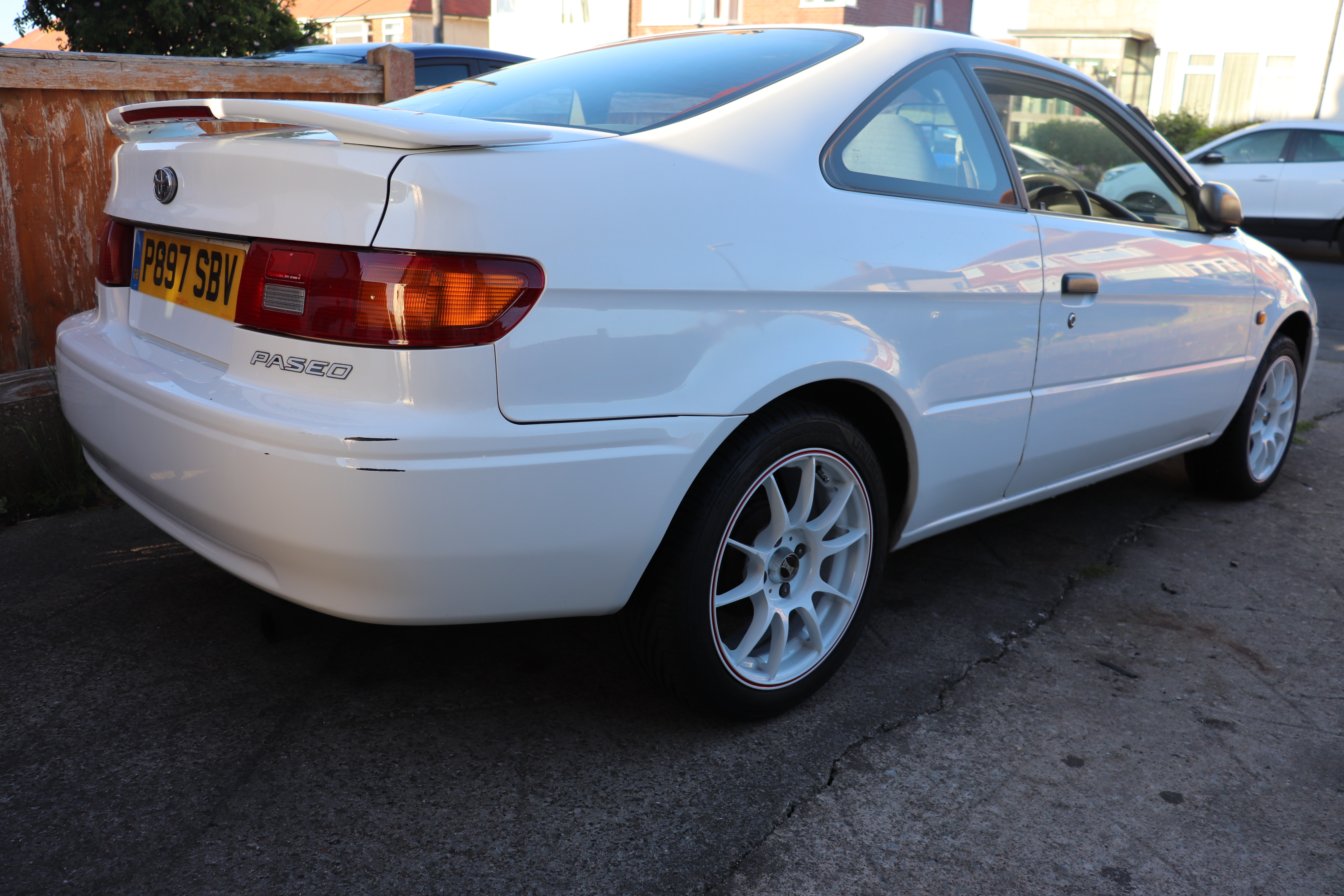

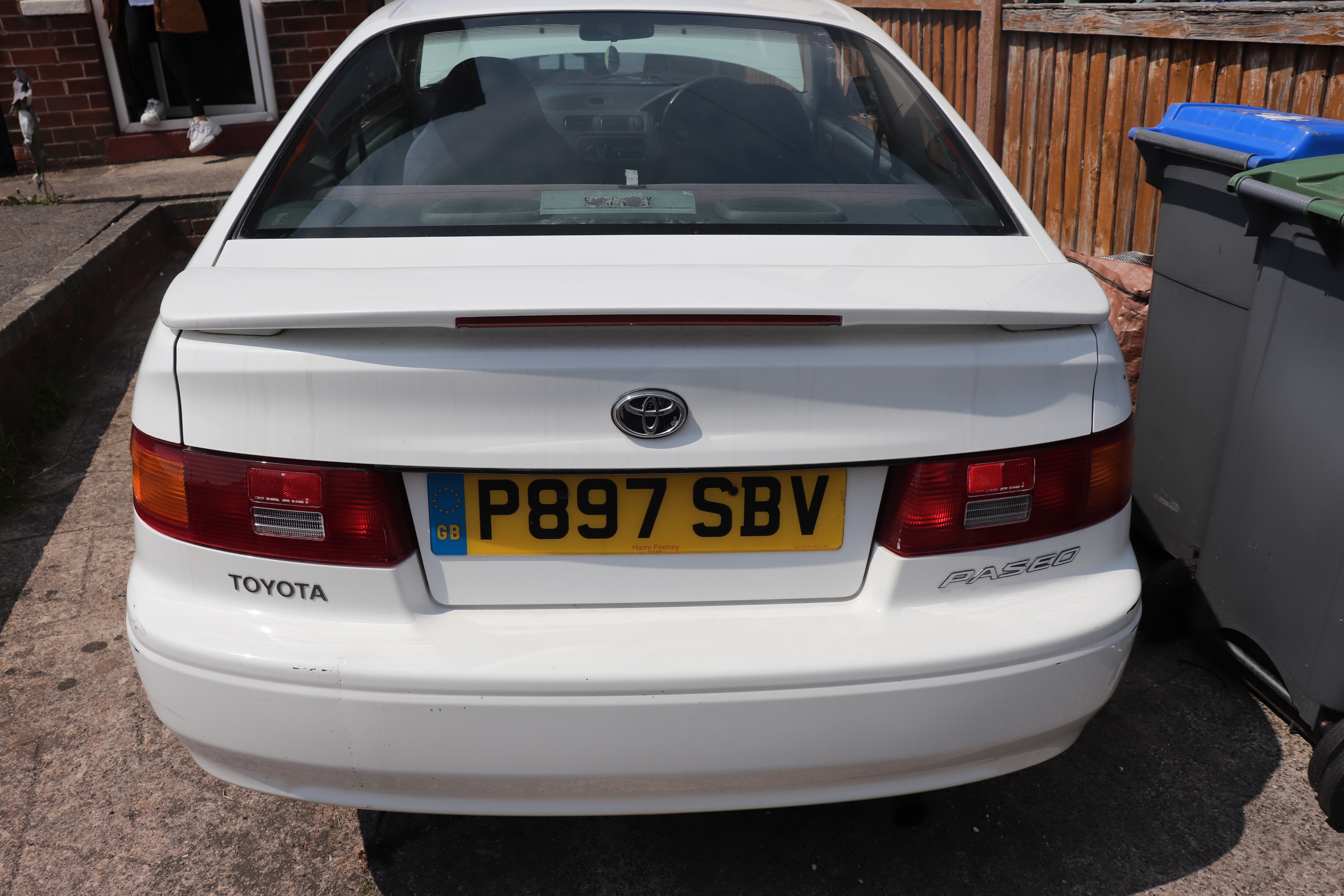

I've just finalized the purchase of a mint low milage paseo si. It took awhile to convince the guy to sell his pride and joy.
The proud new owner.

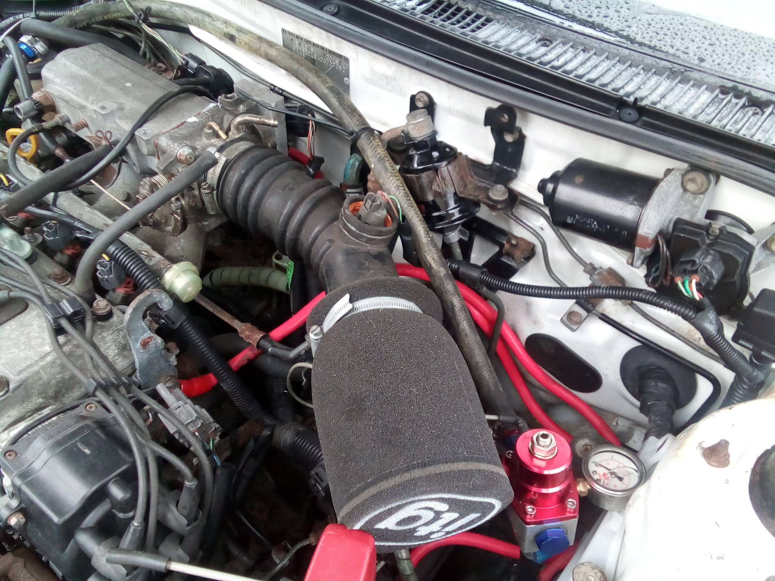

Turbo/gen1 4efe power inlet manifold (increasing power over 4krpm by some margin)

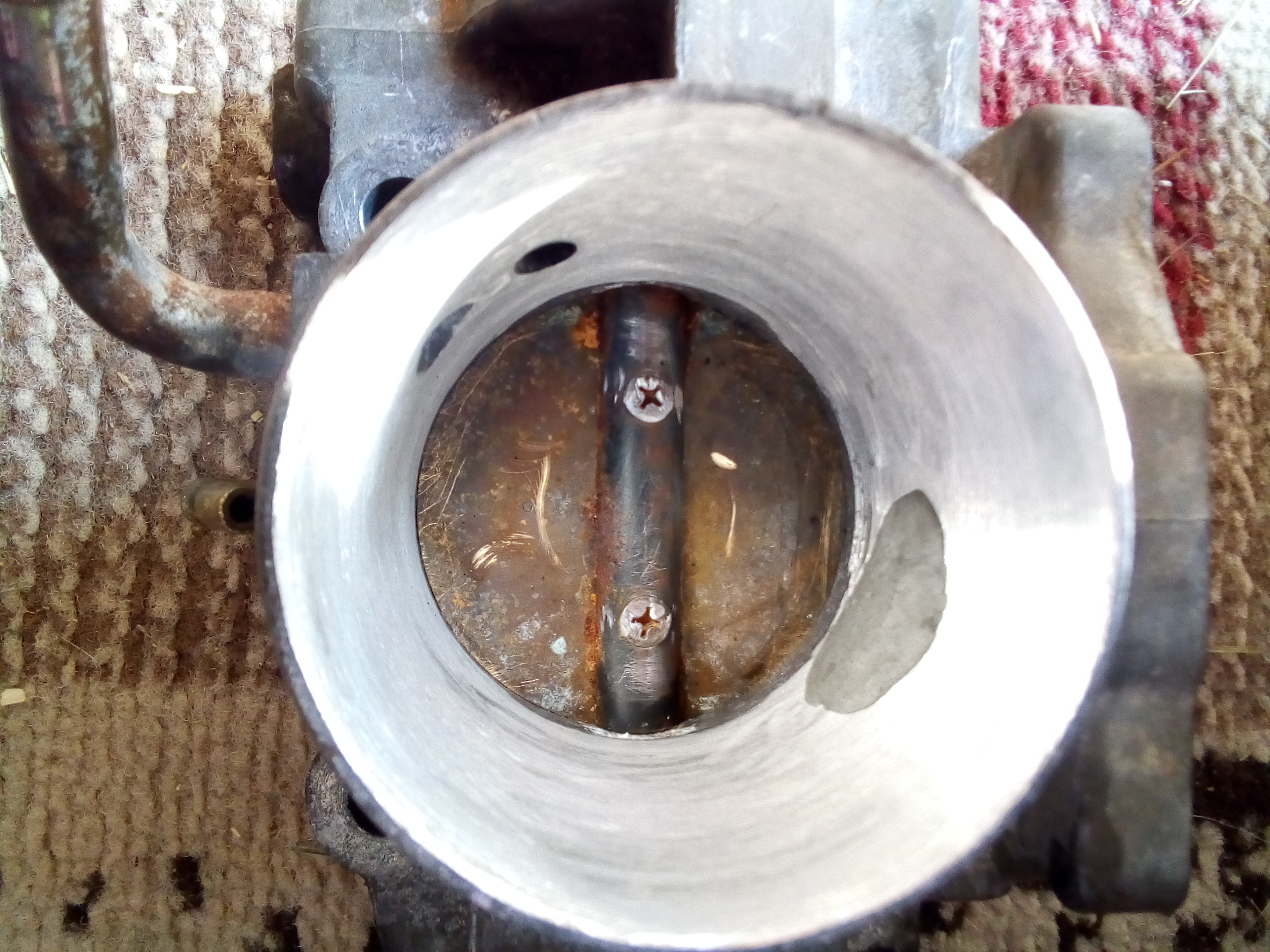

4efte 50mm throttle body modified to house the 5efe TPS, ported/polished with the heater element removed lowering intake temps by as much as 30deg'C (increasing power again over 4krpm)
corrola intake pipe, and itg £15 sock air filter.
Light weight alloy 4+kg flywheel (helping the engine rev alot freely threw out the rpm)
Low anertia exedy paddle clutch 212mm 4efte (again helping the engine rev as well as being ready for boost when it comes).
230cc 7afe denso injectors.
ebay copy aroemotive adjustable fuel pressure reg set at 2.8bar regulated pressure. (Helping provide the near perfect fueling on the 5e factory management. with a perfect small increased fuel pressure of 3psi upon throttle open) passed the mot emissions with no problems, as well as a noticeable power increase using the 230cc units on the standard 190+cc injectors.
ngk iridium heat range 5 spark plugs. (Helping the low kv factory coil provide accurate ignition timing along with the engine earthing kit fitted. (A sweet spot found with an increased base ignition timing set at 15deg btdc).
kemso high delivery and flow eBay fuel pump (I'm very impressed with these pumps). And so far can't fault them. Provides much better fuel pressure.
zisco rams horn exhaust manifold modified to fit the factory paseo exhaust system. (Again affecting the mid to top end power by a good margin, as well as giving the engine a very smooth throttle response). The exhaust system starts to whistle around 3krpm with the throttle just over 1/2 open and gets louder and louder with increased rpm/opening of the throttle, telling me it's hitting peak flow.

yeh im well chuffed its only done 49k miles and is clean.
after experiencing the 4e starlet ive decided to hand in my company car that im paying a shit load for to be parked up and go for a rare toyota, of course boost the little bugger. the shape and style really appeals to me. very much like the honda dc2.
get a nice set of period wheels for it revamp the suspension so it rides like new and enjoy.
Edited by Sam44

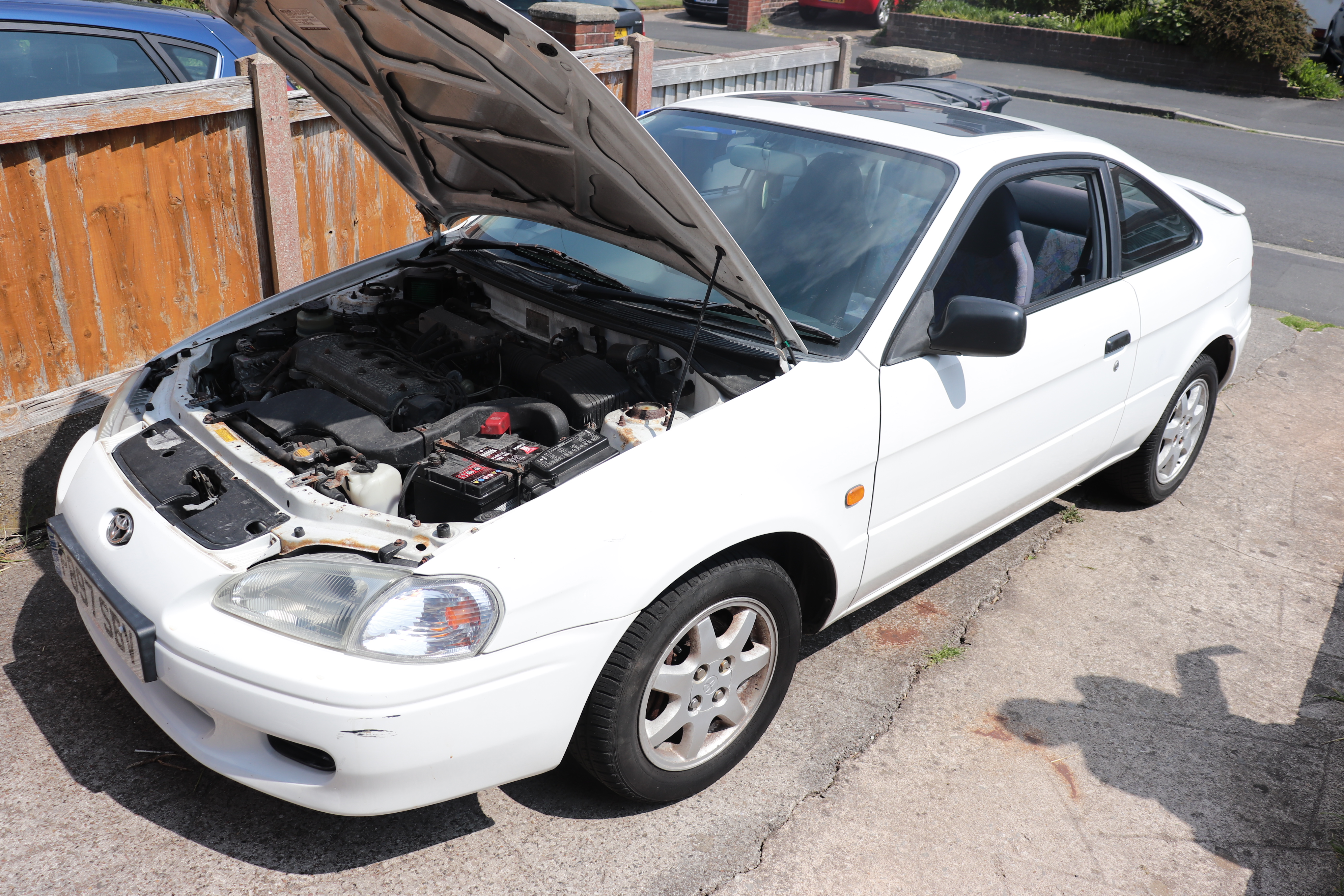

So I've got a good friend to go and collect the car with his trailer this weekend. Pictures coming soon.

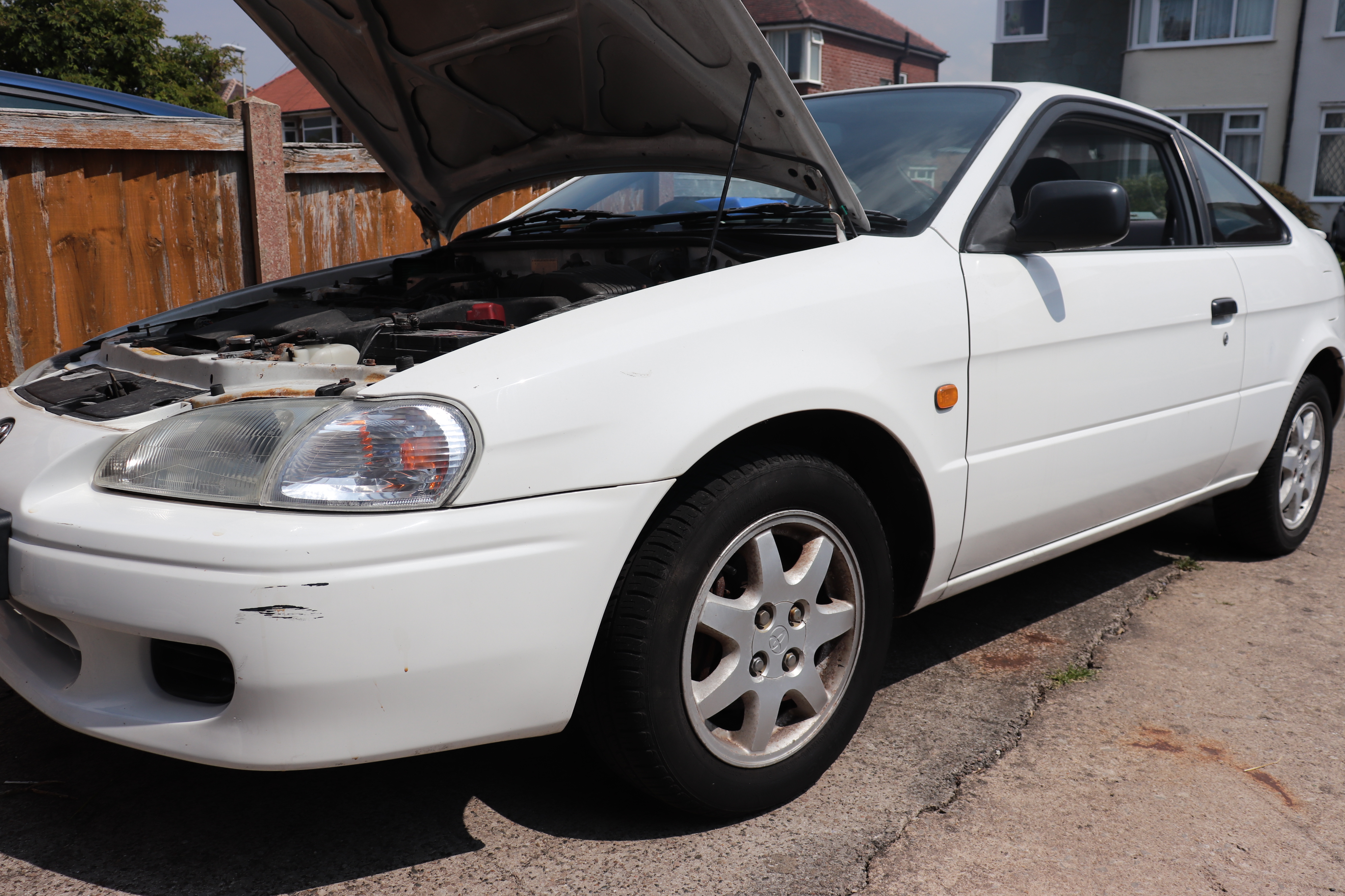

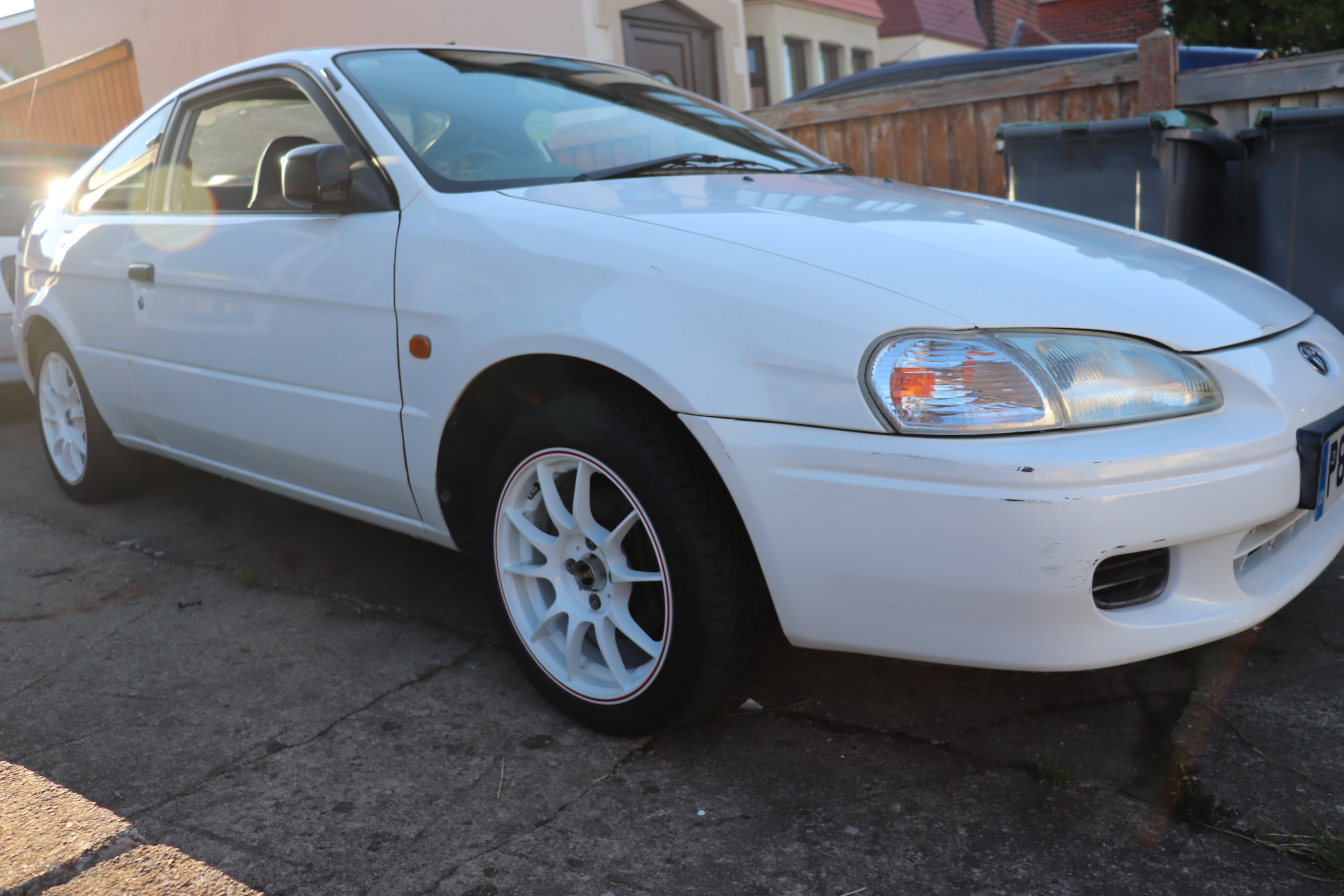

here we are with another Toyota. THE DAILY DRIVER

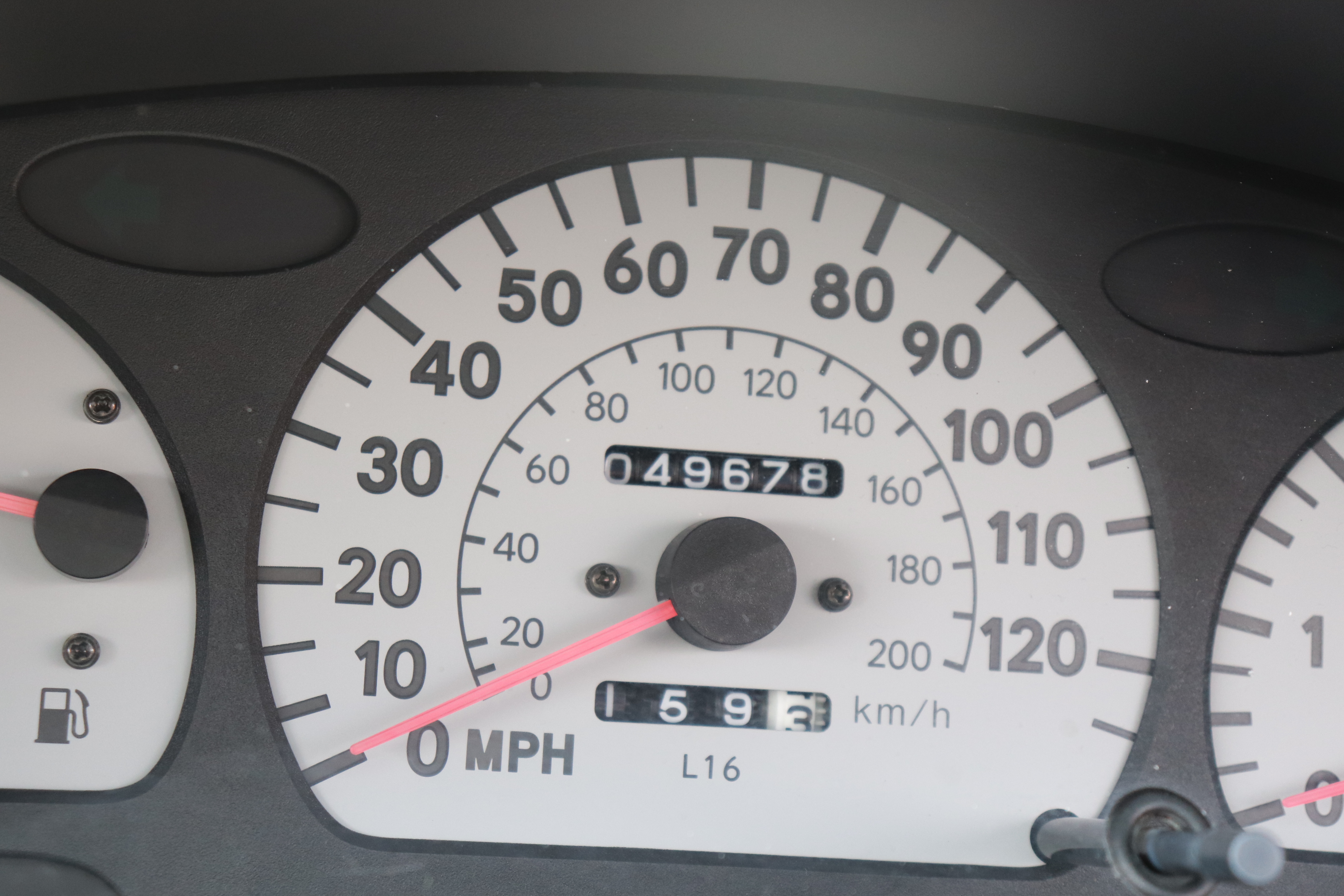

there is a little surface rust in places. 49000 miles. it used 20quid of fuel to get it home 159 miles. loving that mpg already. i have been told by a few people that these engines do crazy mpg. which alot will be owed to the low drag shape.
im told it drives like new only slight speedo cable flicker on the needle, and it idles at 1.5krpm, the Ariel is seized in/down.
its super clean. one owner from new. full service history.  the cam belt was changed in 2012 at 40kmiles.
plans are to get it in for a full color change and restoration. going normally aspirated power till march next year then im hoping to get it into racetech for a full standalone and mapping, by that time the starlet will be done painted and everything so i can use that till this is ready at that point.
im so chuffed to own this the 5e engine is a hell of a power house coupled with the c60 sixspeed its a match made in heaven. it will make the gears feel longer with the engines torque output, its going to hunt them speeds down even at 160/180hp. its going to be interesting to see if the starlet can match it.

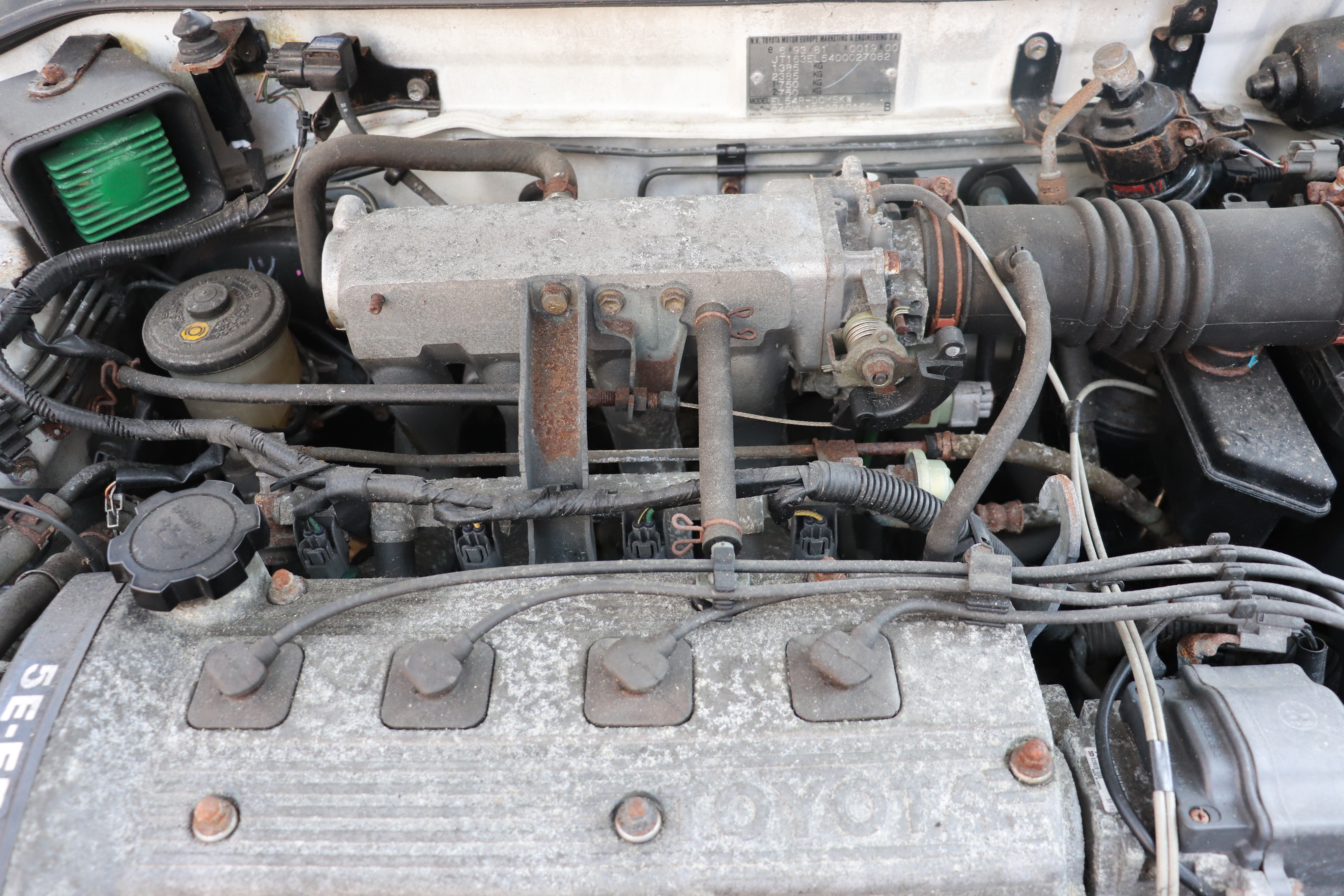

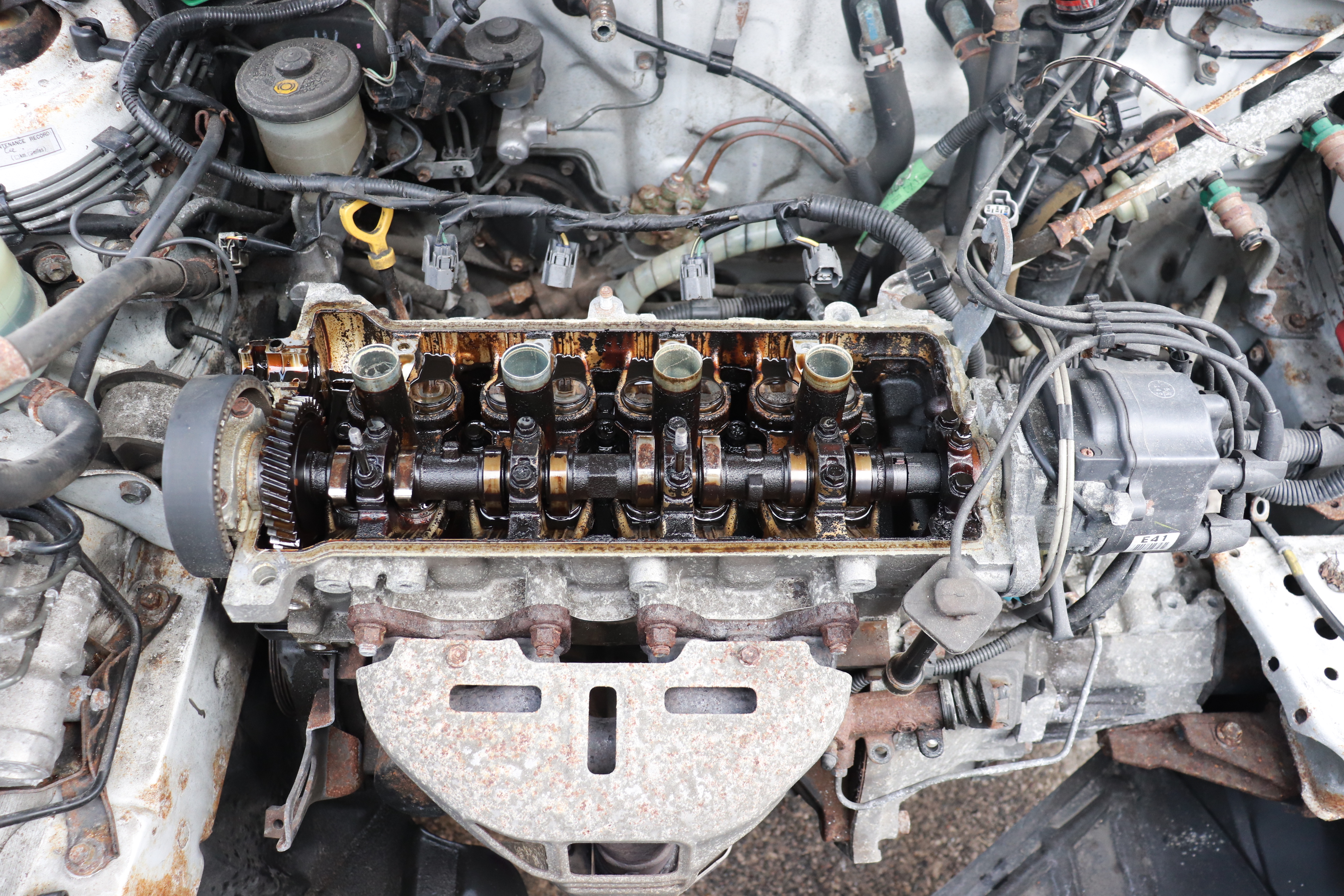

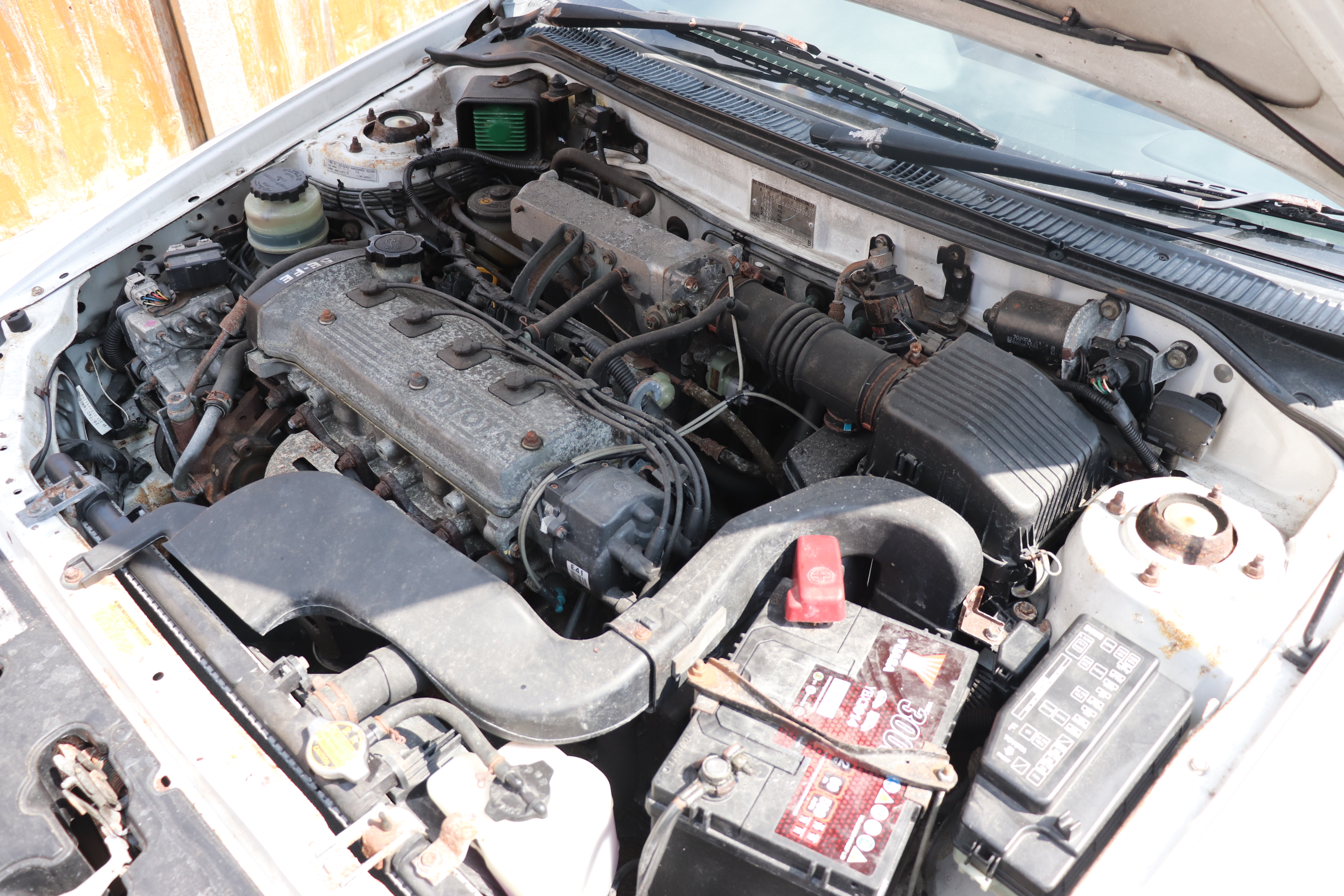

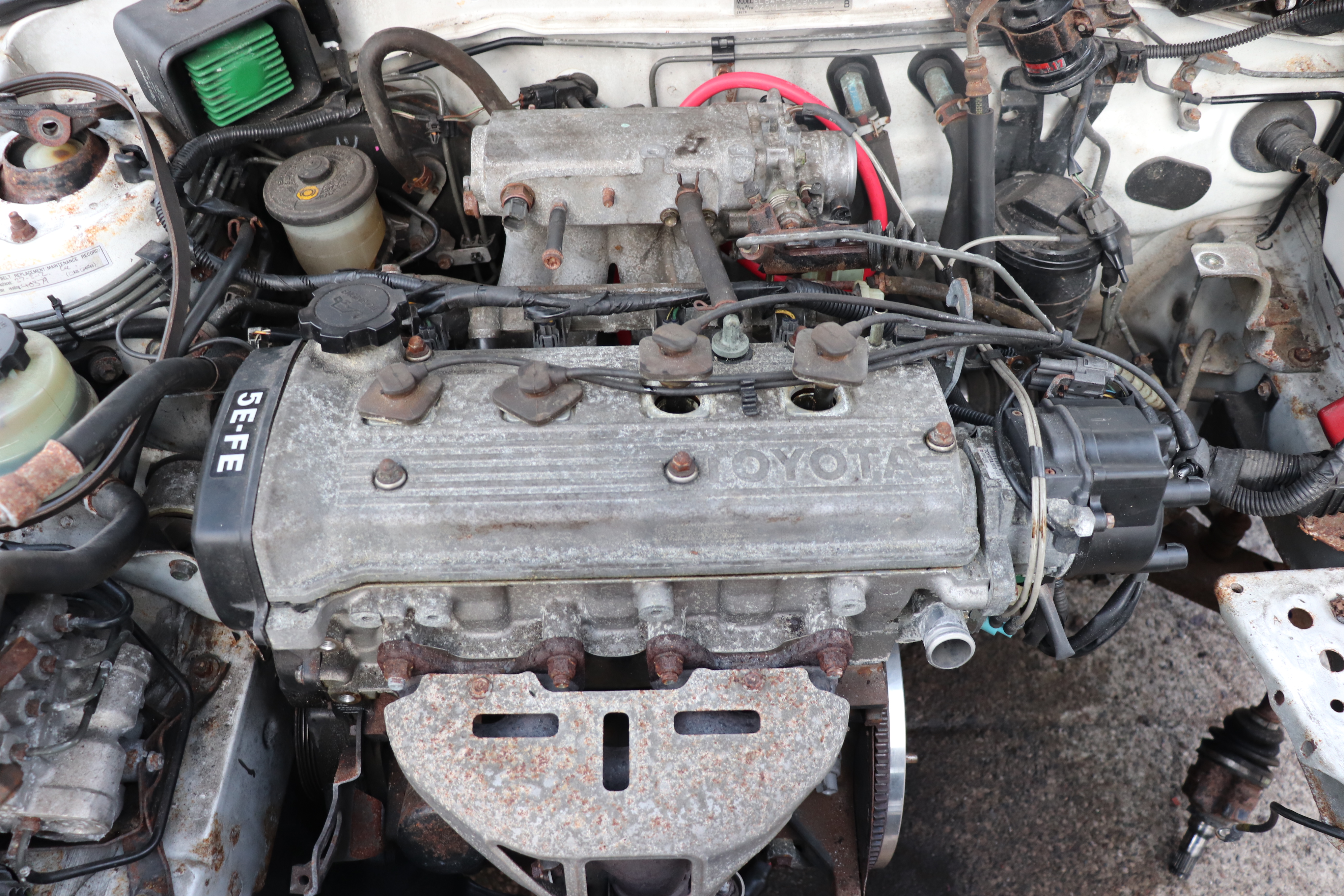

lets make a start.

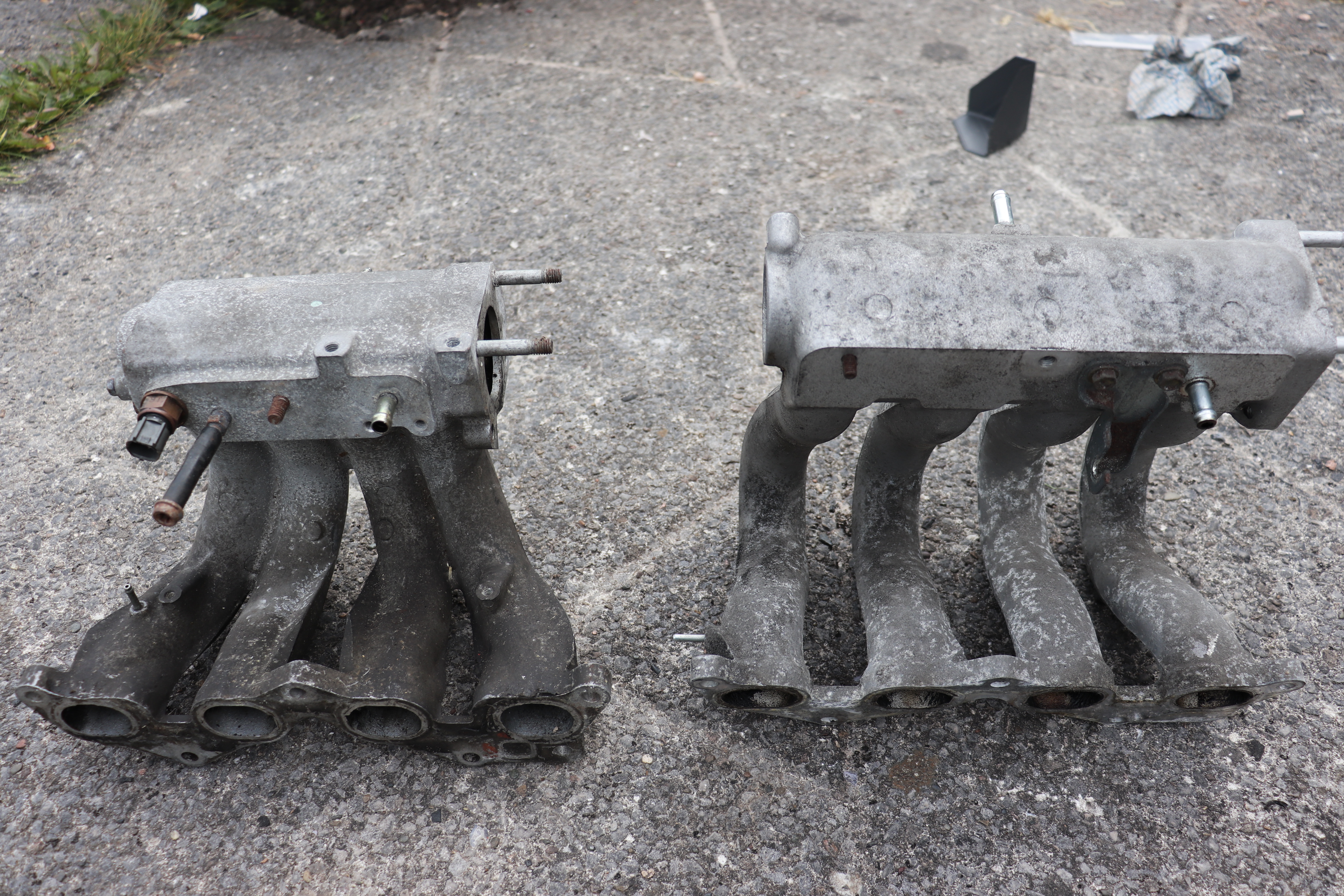

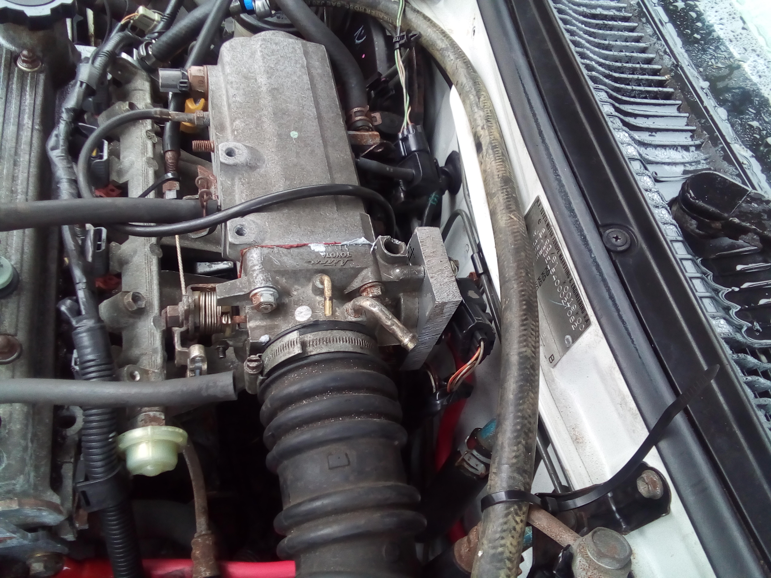

4efe gen1/4efte inlet installed (power inlet) this also comes on the sera 5ehfe
throttle body cleaned out and idle valve freed off so it no longer idles at 1.5krpm.

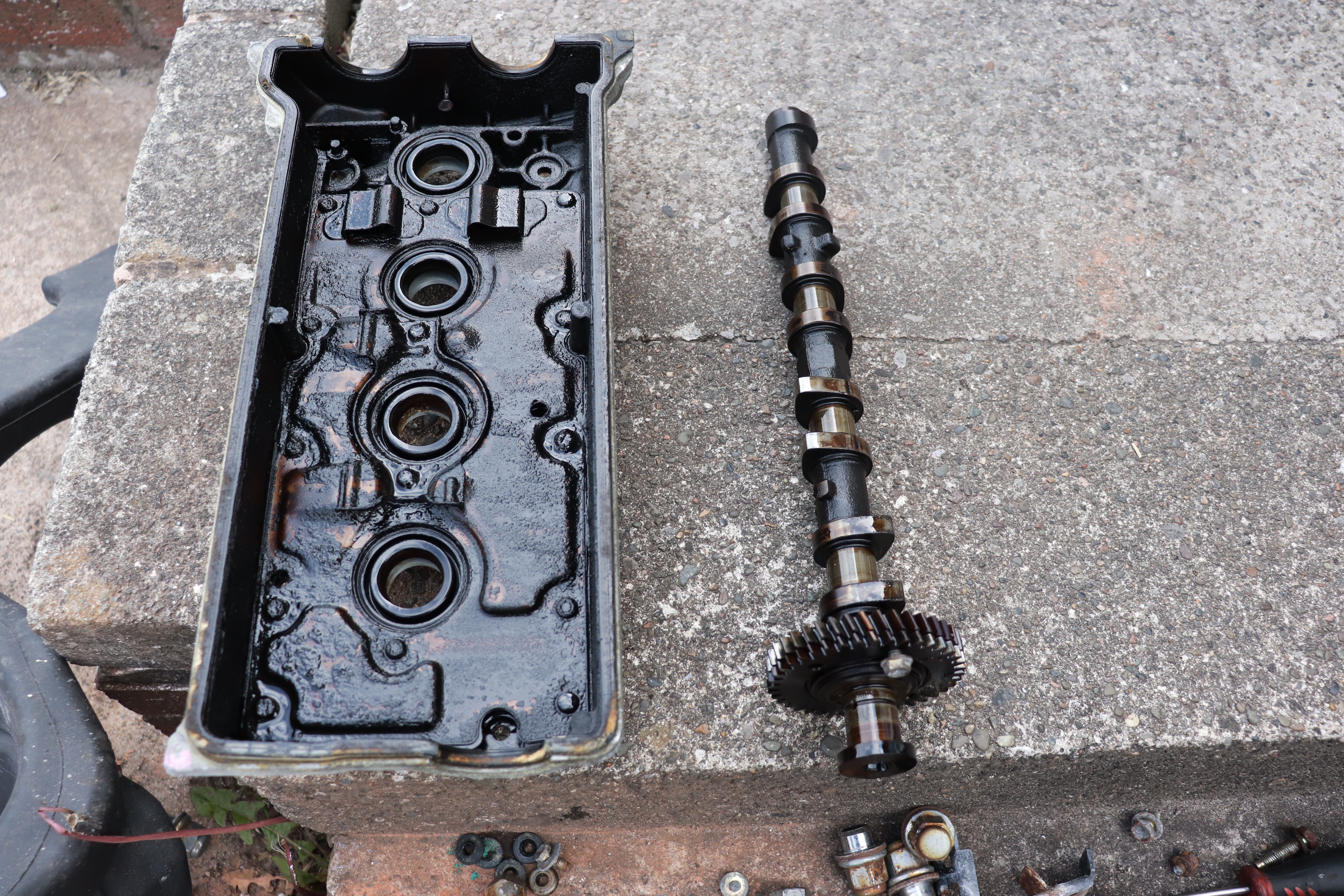

5e inlet cam removed, and measured. 41.7mm same as the 4efte inlet cam (the 4efe ep91 uk is 40.5mm)

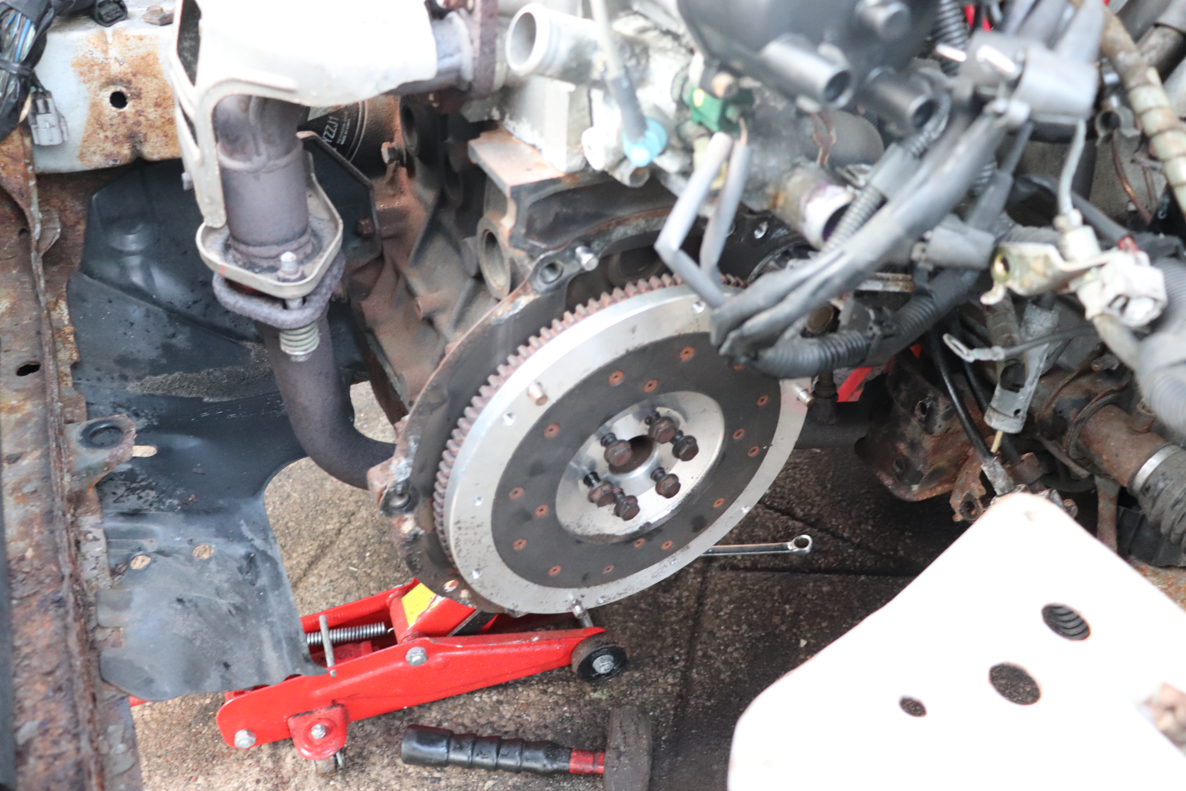

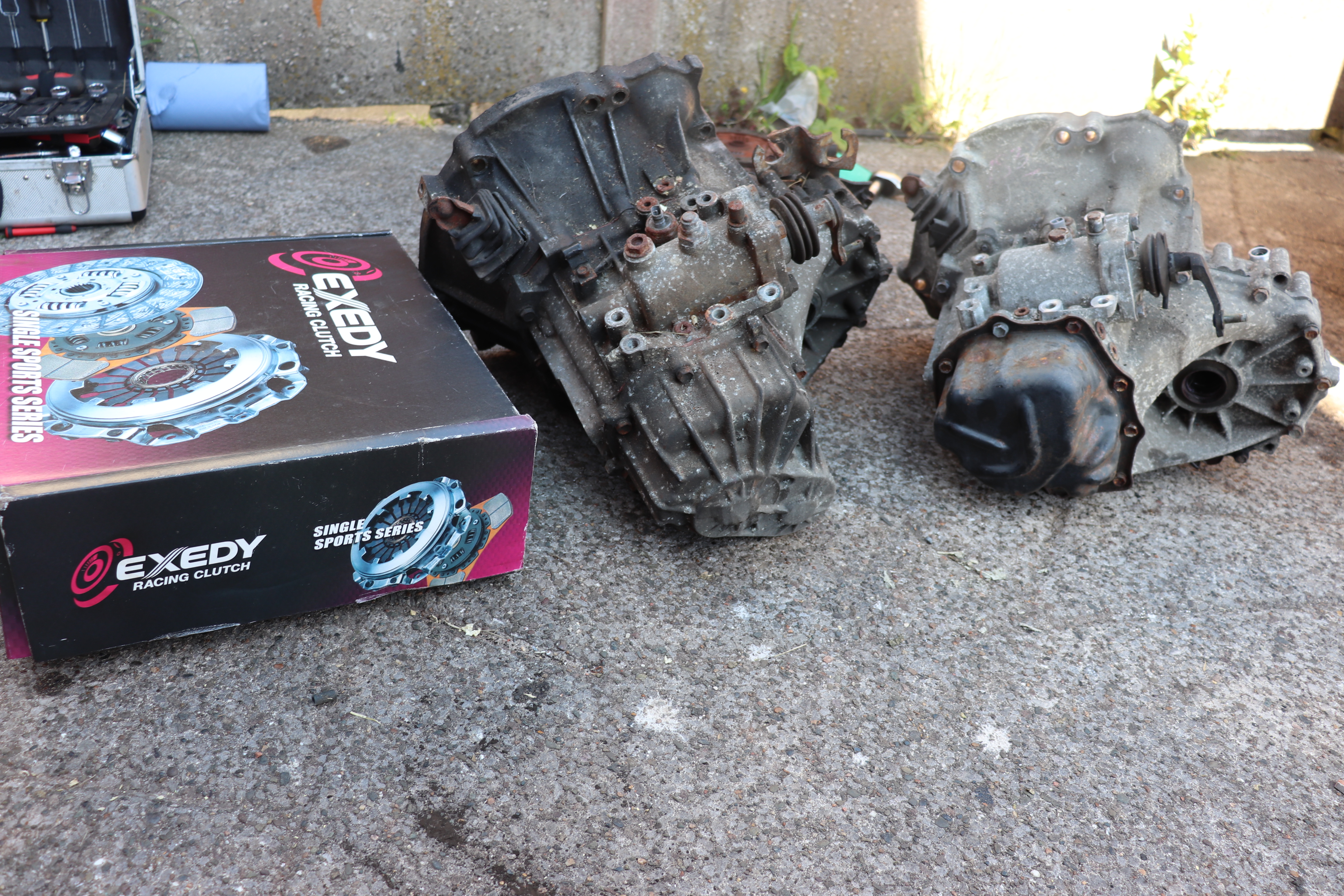

gearbox removed ready for the g6 c60 gearbox. alloy flywheel fitted with the 212mm 4efte clutch fitment.

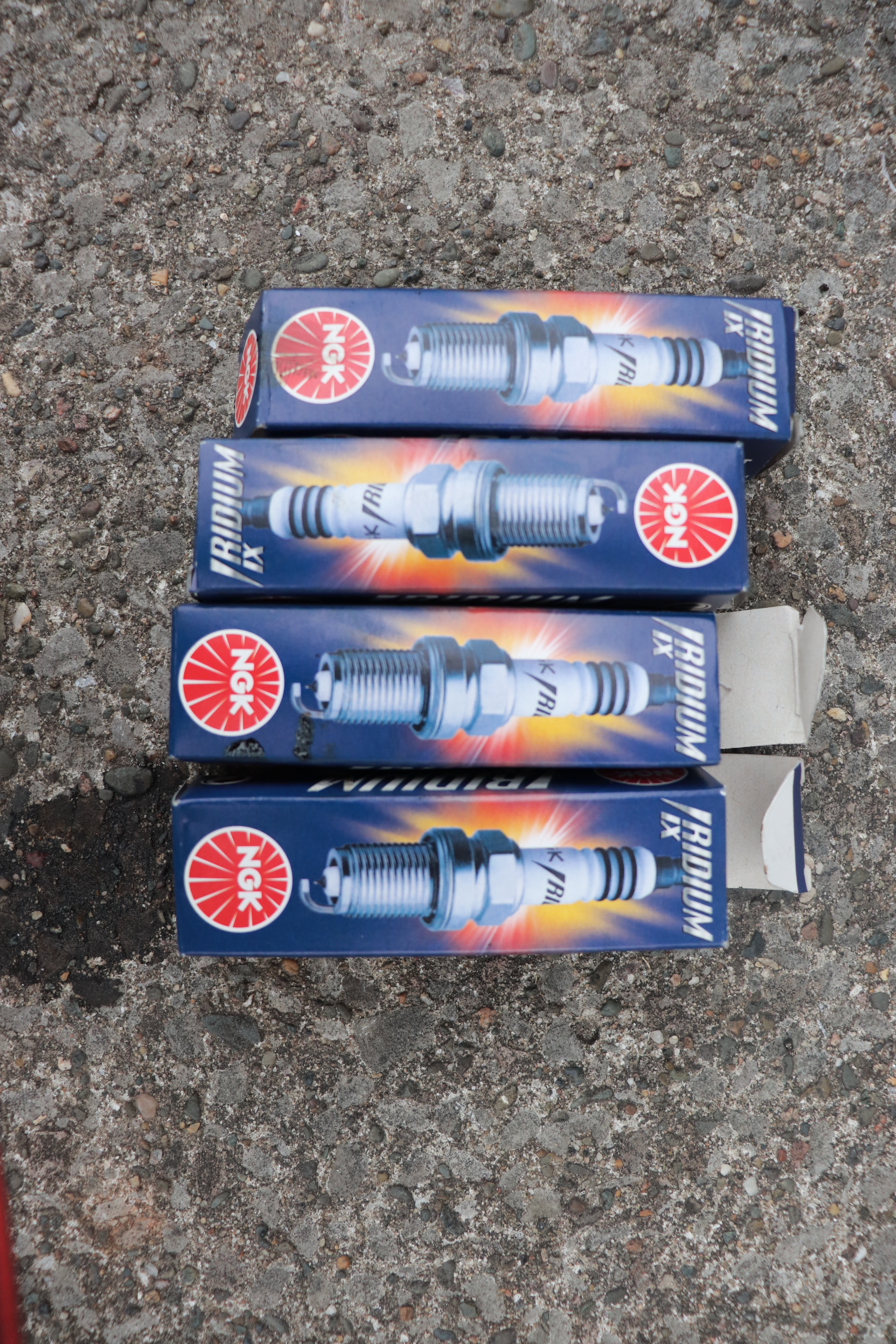

iridium ngk spark plugs installed bkr5eix with an engine earthing kit and new dizzy cap and rotor arm.

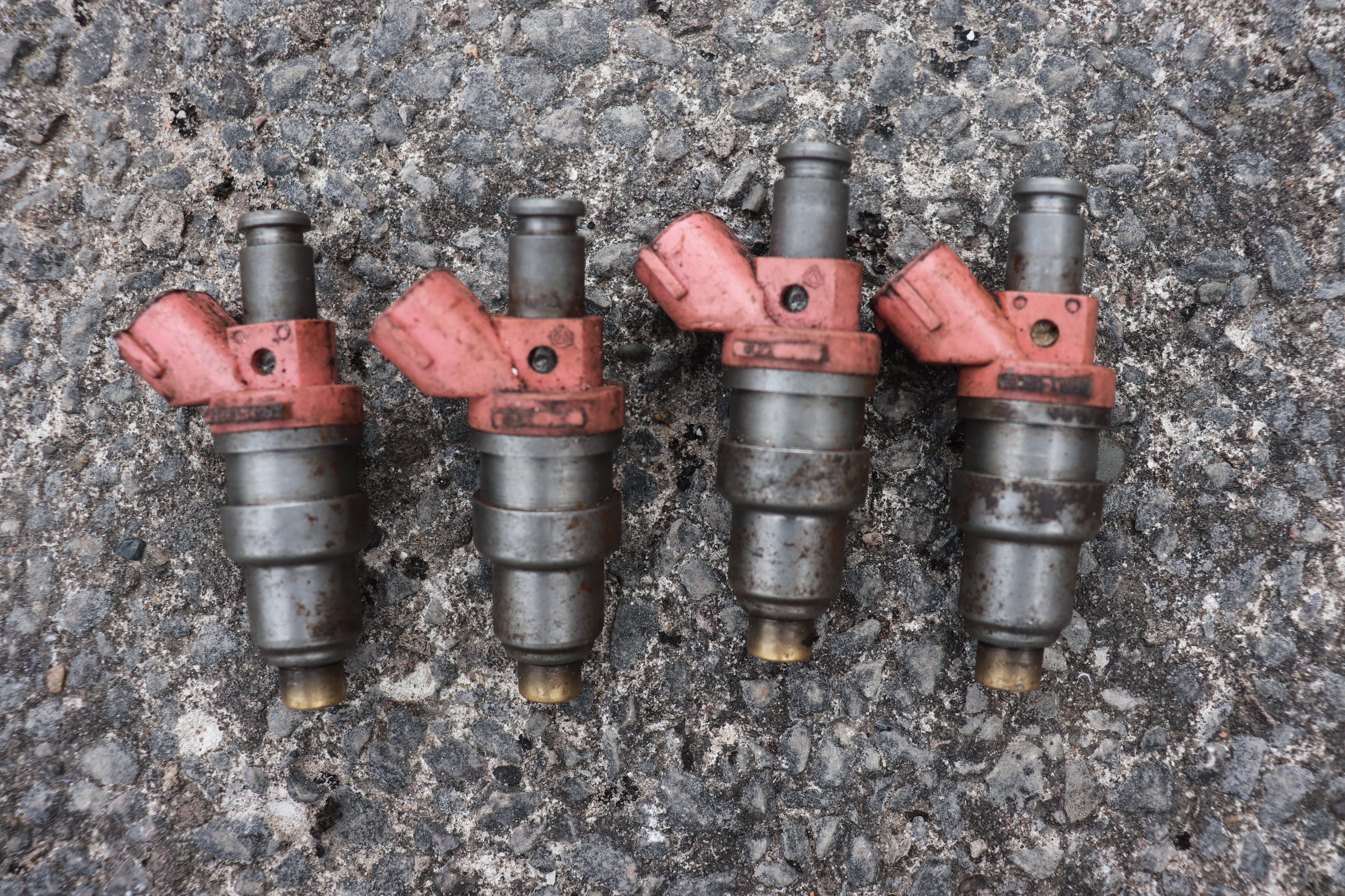

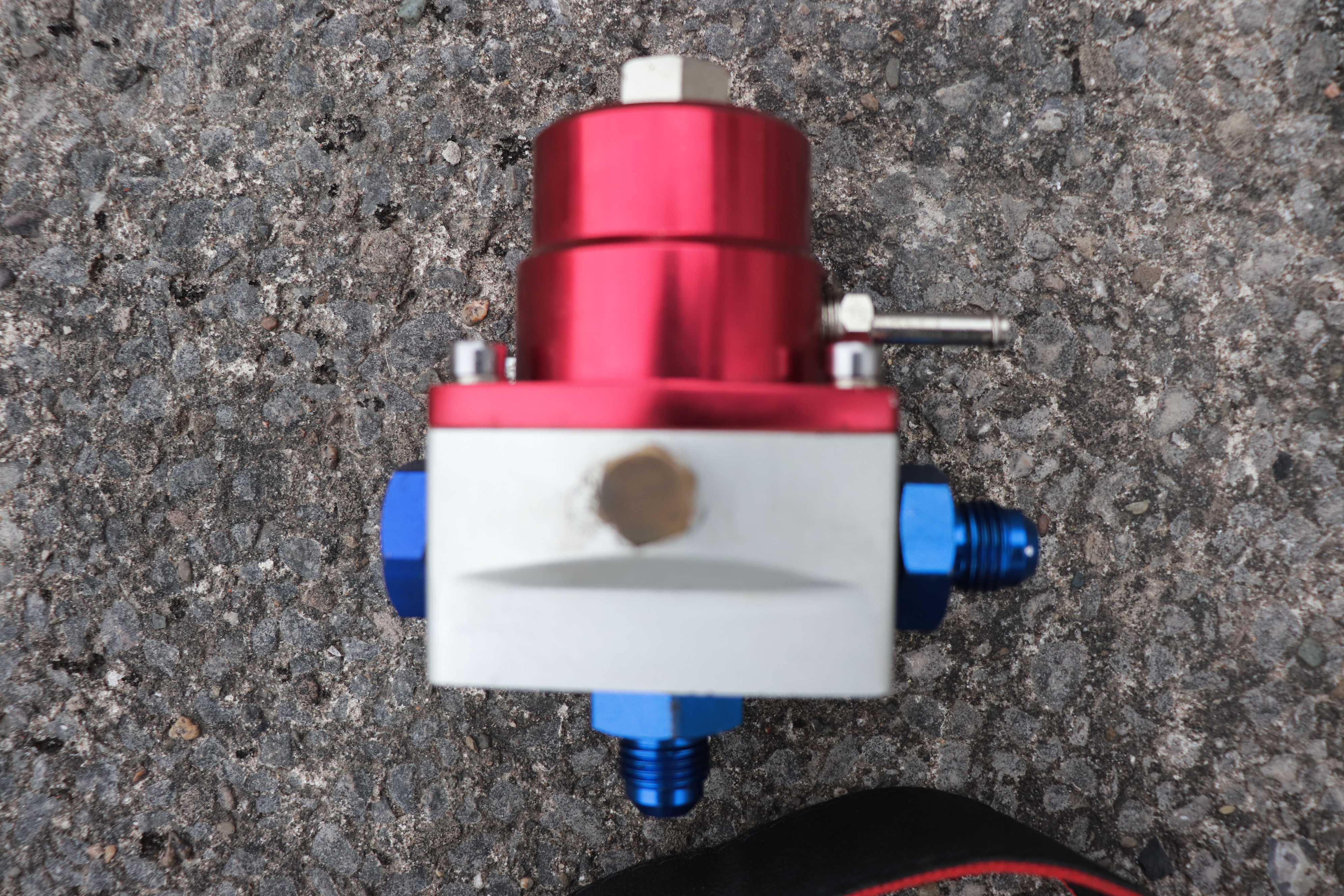

fpr, kemso uprated fuel pump, and 230cc denso 7afe injectors going in, im told these are also used in the 115hp+ 5ehfe sera engine.  (replacing the 197cc 5efe injectors)
the throttle body coolant pipes have also been rerouted to bypass the throttle body, reducing intake temps.

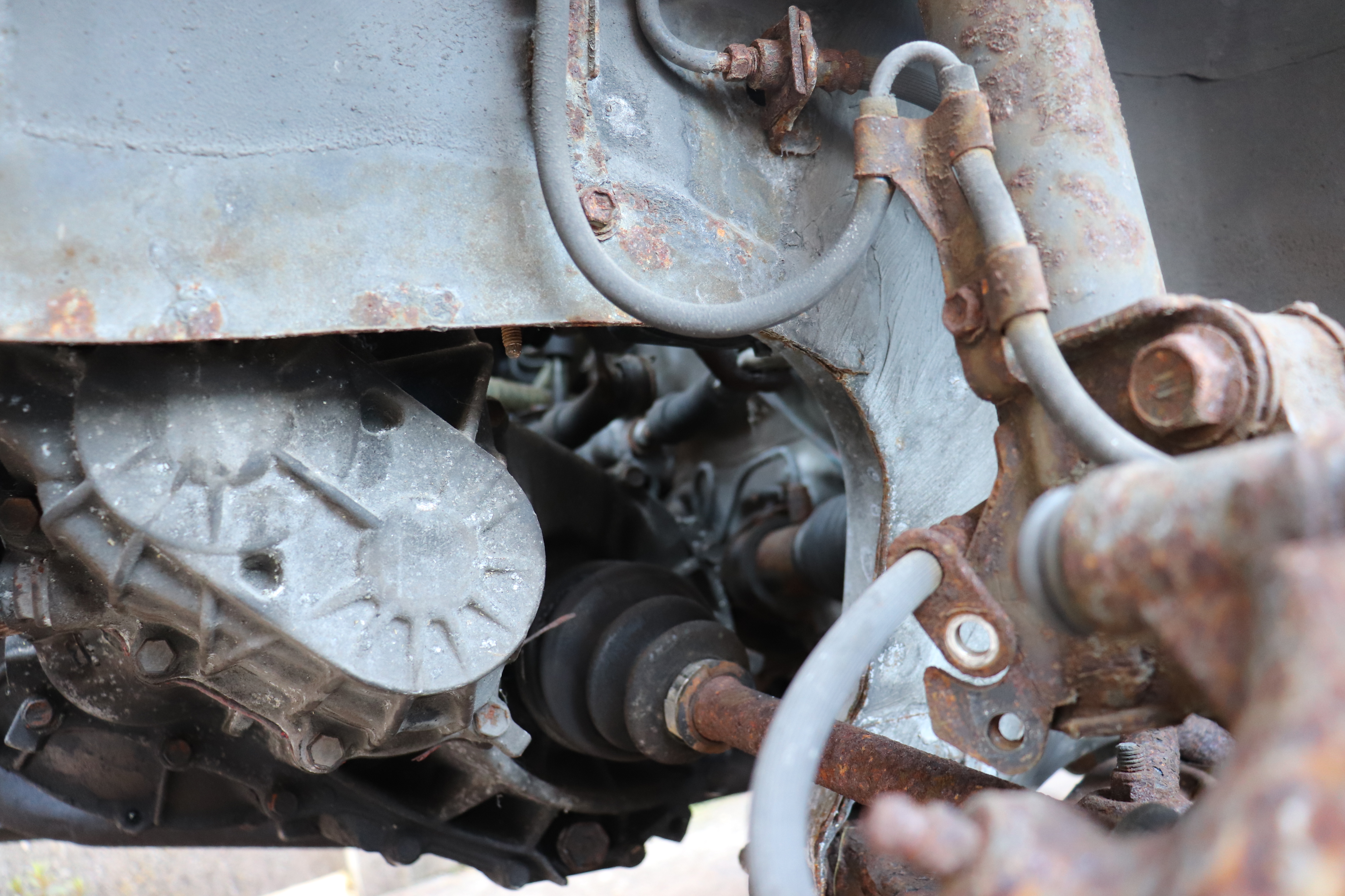

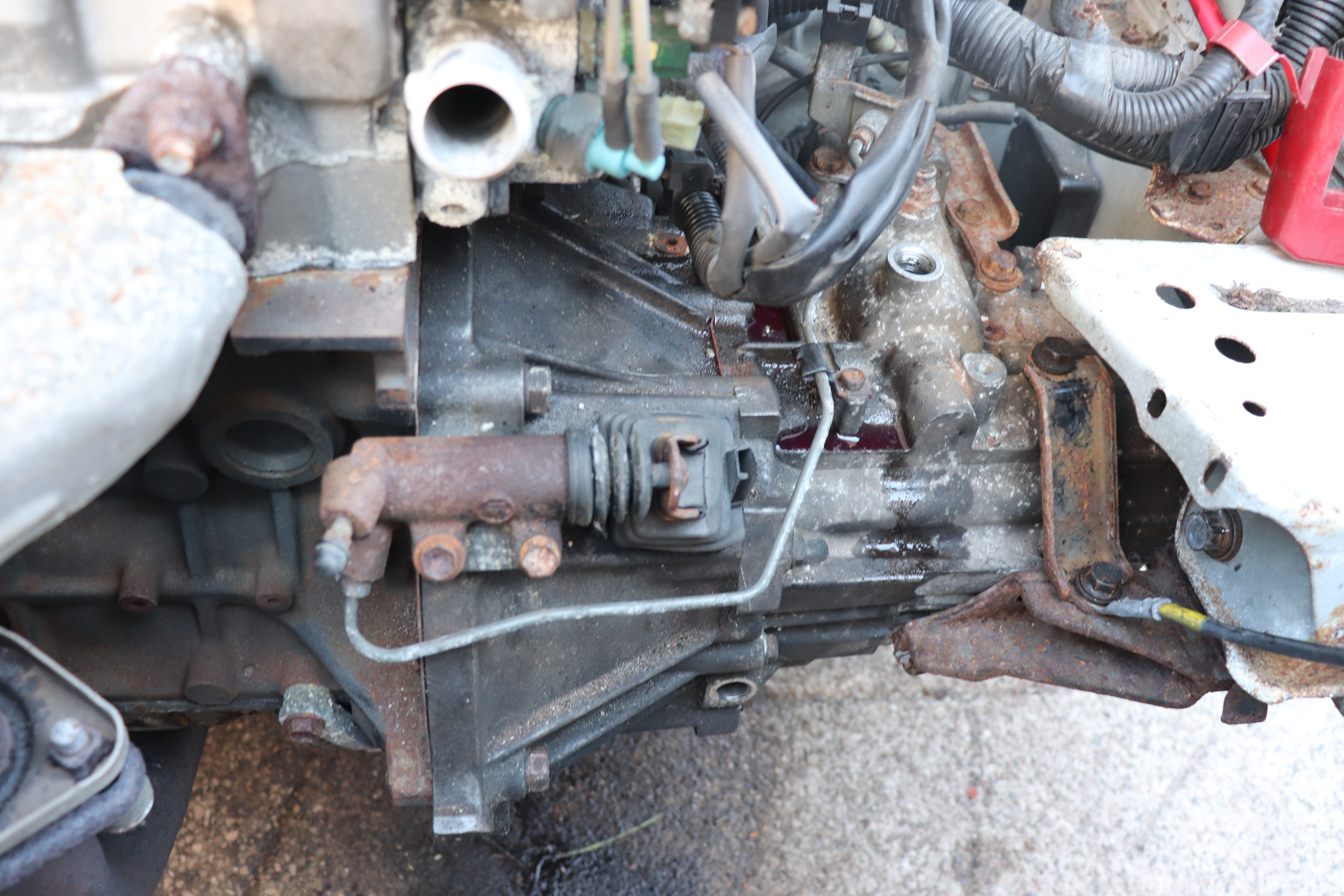

e11 4efe g6 c60 6speed gearbox installed with the 3e 5kg alloy flywheel and the exedy 212mm (standard clutch is 200mm) low inertia paddle clutch.
also some new gear oil, which will be change in 3kmiles.
also new coolant in and air filter.

the gearbox set off wikki.
there is some discrepancy on the ratios going off this and the 6 speed series.
what dan is feeling/describing is the 3.9:1 final drive compared to the 3.7:1 on the starlet. this will affect the top speed/cruz engine rpm at 70mph, and increase acceleration. toyota will have done this because the 5e produces around 20 to 30% more torque threw out the rpm range on the 4e. this will increase speed in all gears, bringing back the top end speed/motorway cruzing rpm at 70mph
C150[edit]
A 5-Speed Manual Transmission for FWD cars.
Gear ratios for this transmission.
1st 2nd 3rd 4th 5th Reverse Final Final Echo Final Paseo Final Starlet & Tercel Final toyota Probox C150N (japan only)
3.545 1.904 1.310 0.969 0.815 3.250 4.058 3.526 3.941 (17/67) 3.722 3.526
Applications:
gearbox fitted.
C161/C162[edit]
1st 2nd 3rd 4th 5th 6th Reverse Final
3.166 1.904 1.233 0.969 0.815 0.683 3.250 4.529
Applications:
even thew the gearboxes we have been fitting out of the g6 and g6r clearly do not have a 0.6 overdrive 6th. after working out the ratio off engine rpm wheel size and road speed.
this more lines up with what we are seeing
C60[edit]
3.166 2.050 1.481 1.166 0.916 0.725 3.250 4.529
Applications:
C60-02A= Without LSD C60-02B= With LSD
we know its not the levin gearbox because the gear sets are wider, leading to alonger gearbox casing.
Edited by Sam44

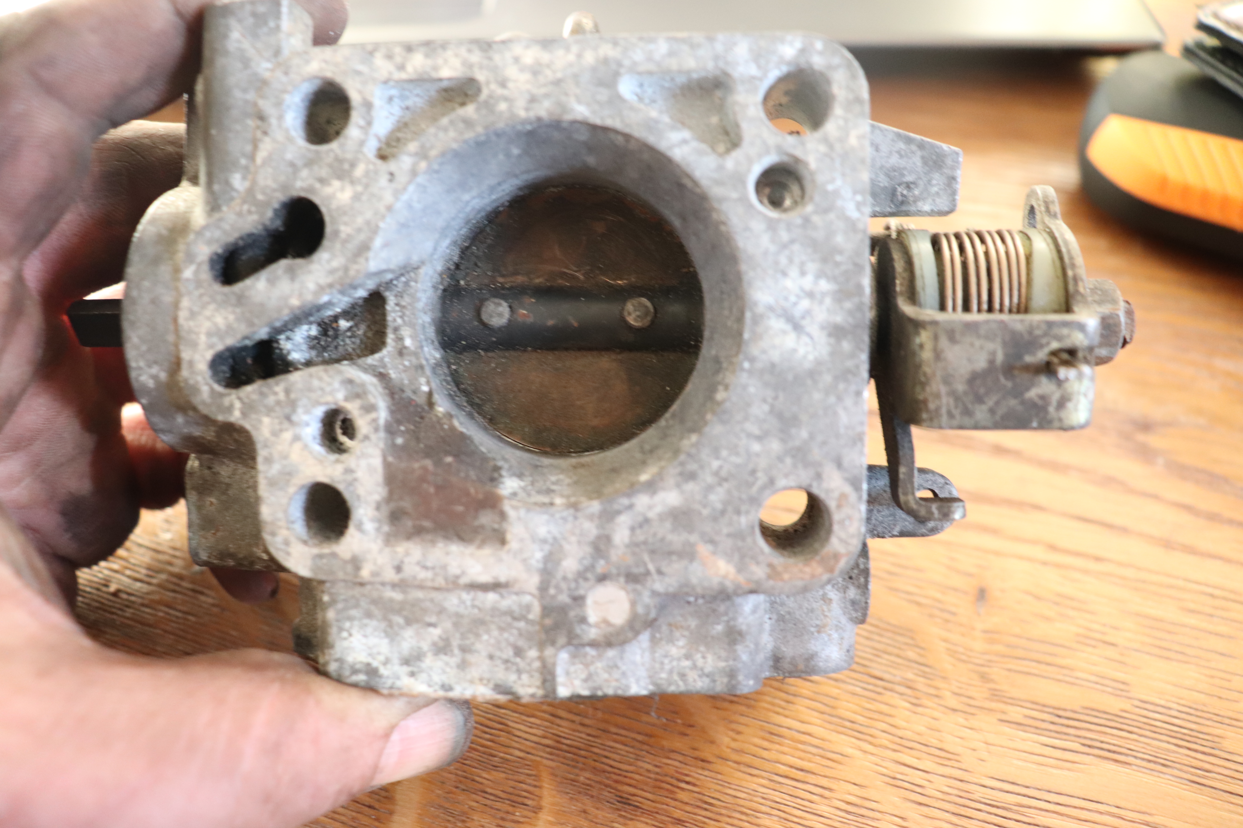

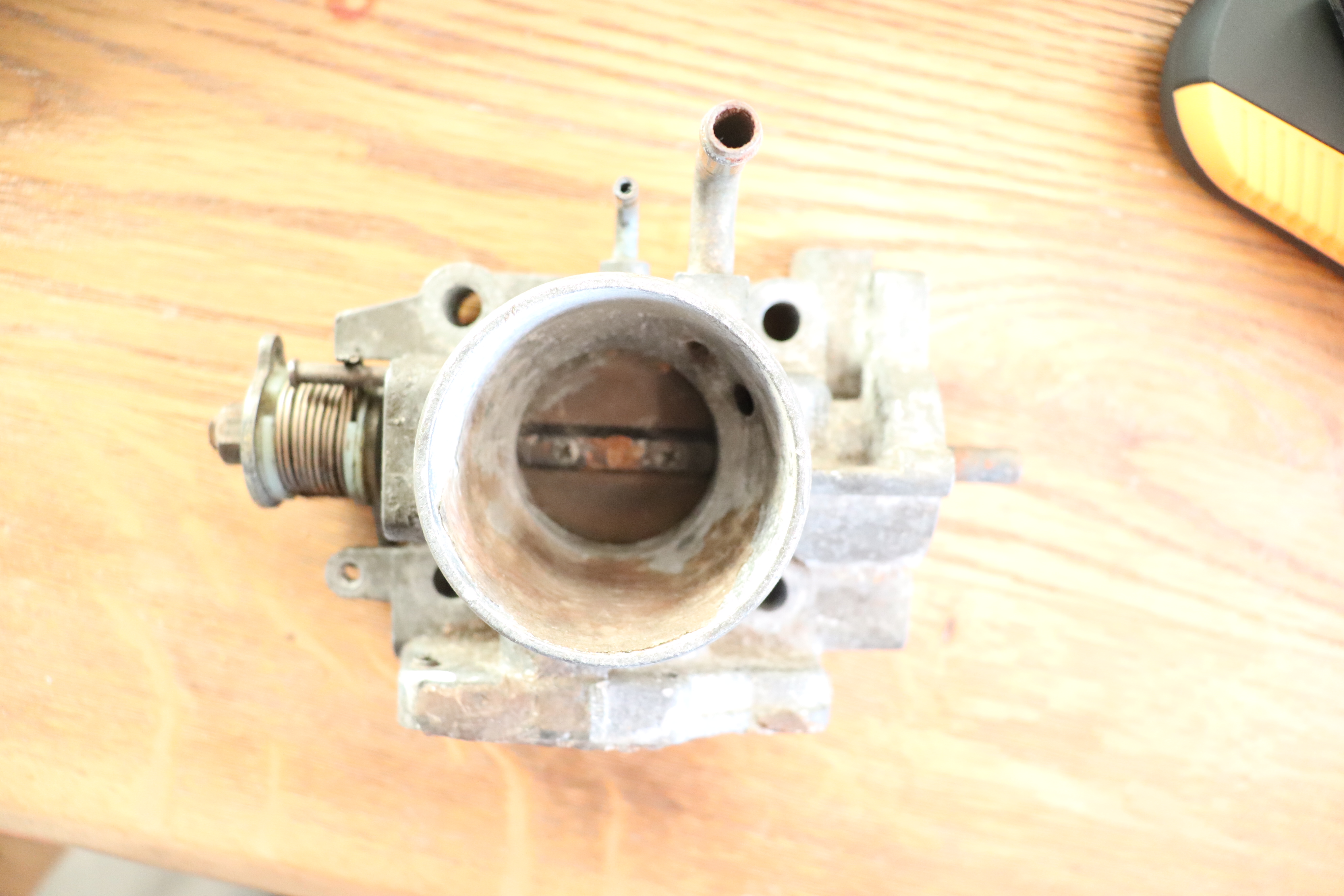

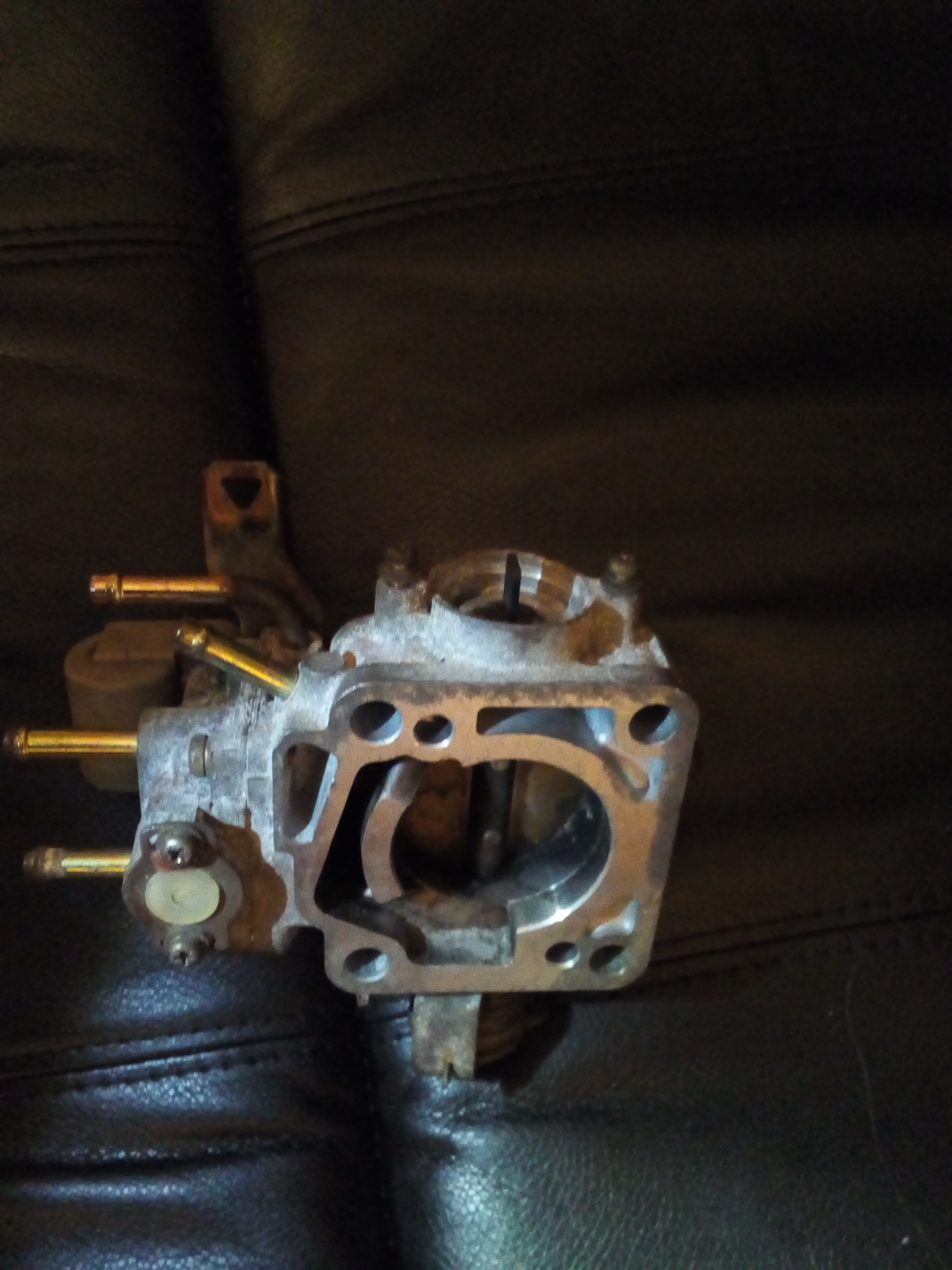

the 35mm throttle body can also be found on the gen1 4efe corolla ae101. this also uses the power inlet 88hp output.
option two would be to install the uk 4efe ep91 lower lift inlet cam. this will then aid low rpm inlet velocity but it will impact peak power/torque output big time. with this being a 5e engine that produces good torque the room might be there to have a play with the cam the inlet will produce a good topend power increase. there are afew options here. dan has also lenghtend the map sensor pipe by around 12 inch to help get the fueling right this was better than droping the fuel pressure. he tried both.
this is only whilst tuning for best normally aspirated power delivery for great usable power (street tune). when the fast spooling tfo35 hyb goes on the turbo will deliver the low rpm air to the engine allowing me to go big with everything keeping the engine building power right till red line. this is when the big throttle and 5ehfe cams go in. what will be felt here will be a constant hard pulling power. hard for any other car to deal with. all these big options will also impact the turbos ability to come on delaying the boost build till later in the rpm range why ive chosen the tfo35 hyb all because low rpm inlet flow rates will be reduced. as we here all the time its a balancing act but the perfect tune is out there.
this will be the direct oposit of my starlet setup but with the same aim targeted, because this engine delivers better low rpm torque and the 4e is a little hp giving rev box, i can do this on the 5e. the main thing for me to watch out for is how restrictive the turbos waste gate affects the engines ability to breath at peak rpm. this is were a large diameter external gate might be needed. the other area will be fuel efficiency. using a fast spooling turbo will impact fueling in stop and start traffic coming in when im not really needing it to. this is also why i use the six speed box and why the starlet is setup with a bigish hyb turbo.

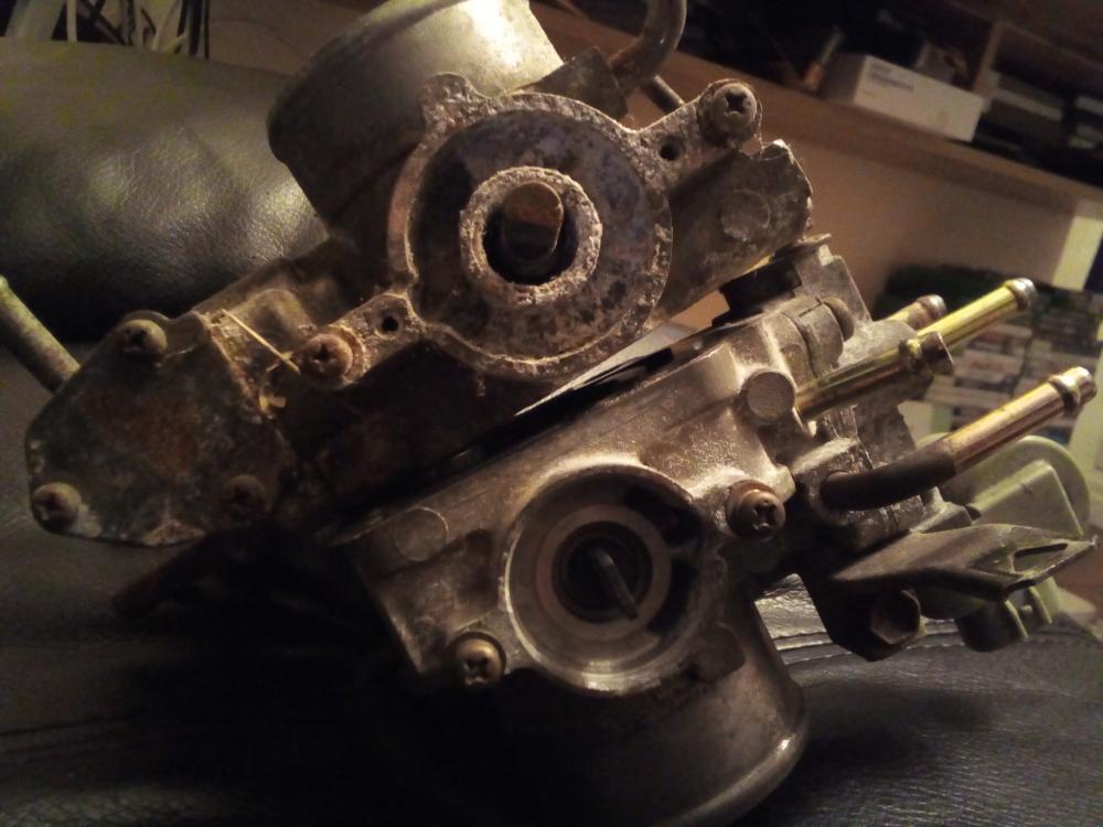

the 35mm throttle body i got with a 4efe ep80 gi engine it also came with the gen1 power inlet.
it needs a clean up.
what i need to do is to swap out the flap spindle shaft so the gen1 4efe throttle body can house the paseo 5efe. it looks very do able.

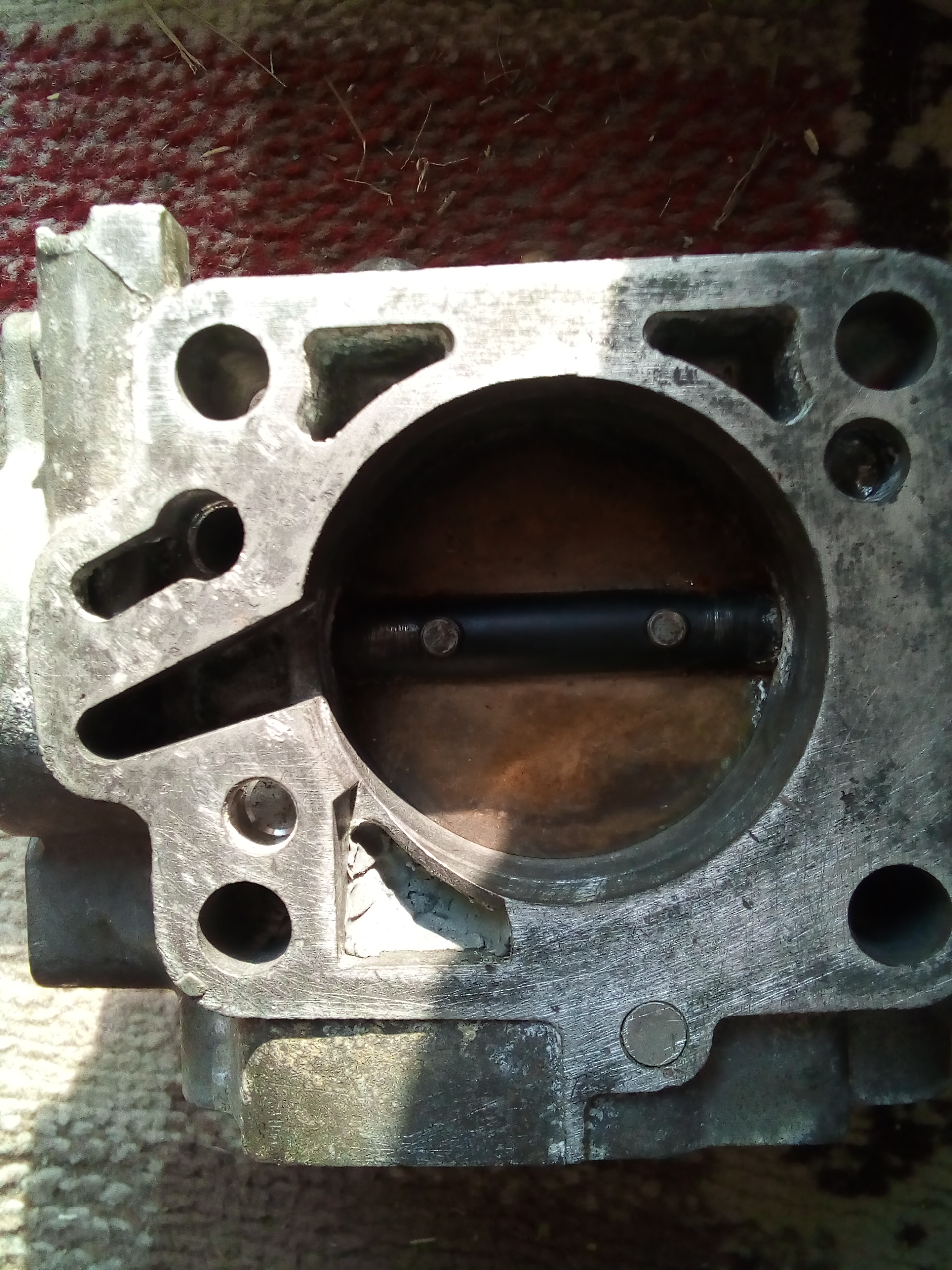

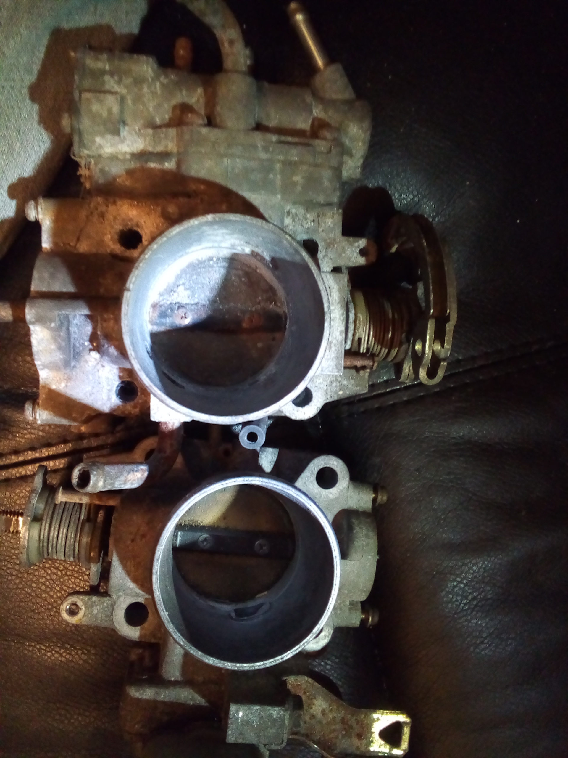

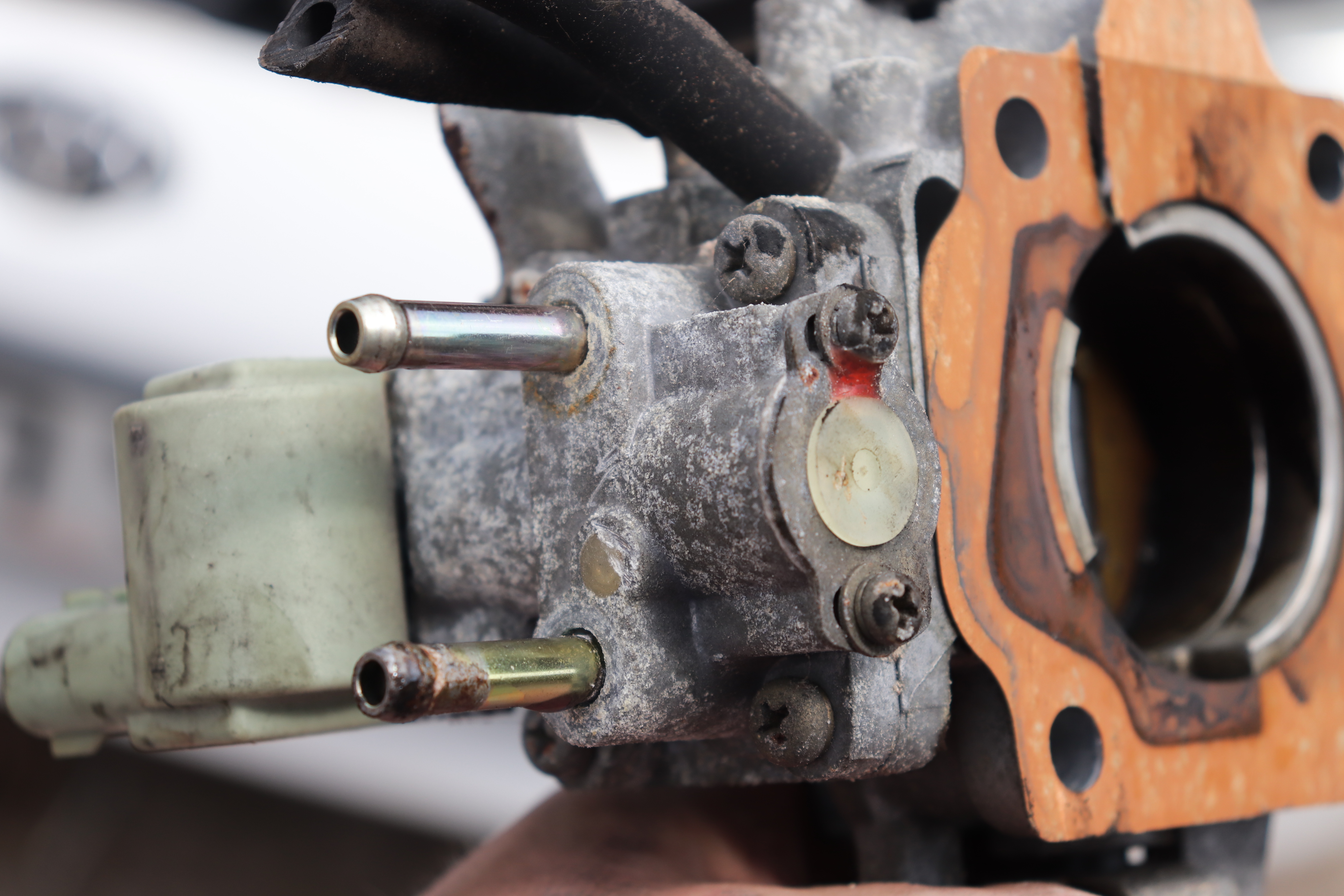

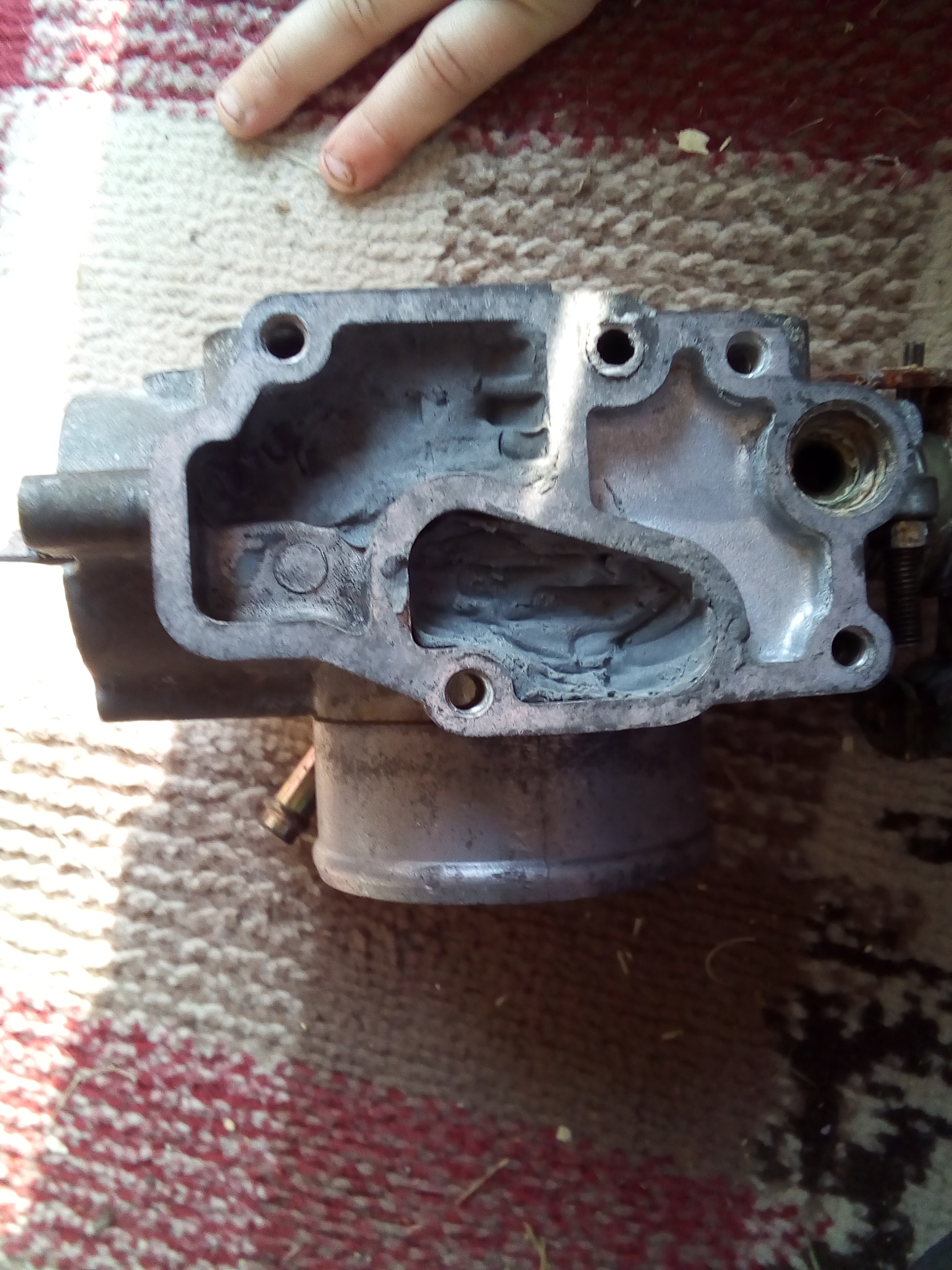

So after doing some runs  with the new setup we have decided to go with the larger 4efte 50mm throttle body. In order to do this on the 5efe ems we will need to swap the throttle flap shaft from the 5efe throttle body into the 4efte 50mm throttle body. This is because the 5efe ems requires the potentiometer tps. This is do able the shafts are the same diameter.
Here you can see the 5efe throttle flap shaft with the tps key way (flat type)
Note the tps mounting points.
Difference in the shaft key ways on the tps sensors the largest 4efte throttle body (top) has the mounting points for the 5efe & 4efe potentiometer tps.
By doing this we will increase top end engine air volume potential but this will need  a progressive accelerator control in order to hit good peak hp figures.
Every thing on the inlet side just got big requiring good throttle control.
Difference in size can be see here the top unit is the 4efte.
The 5efe idle valve will be made redundant and I will set up the idle on the 4efte throttle using its idle screw.

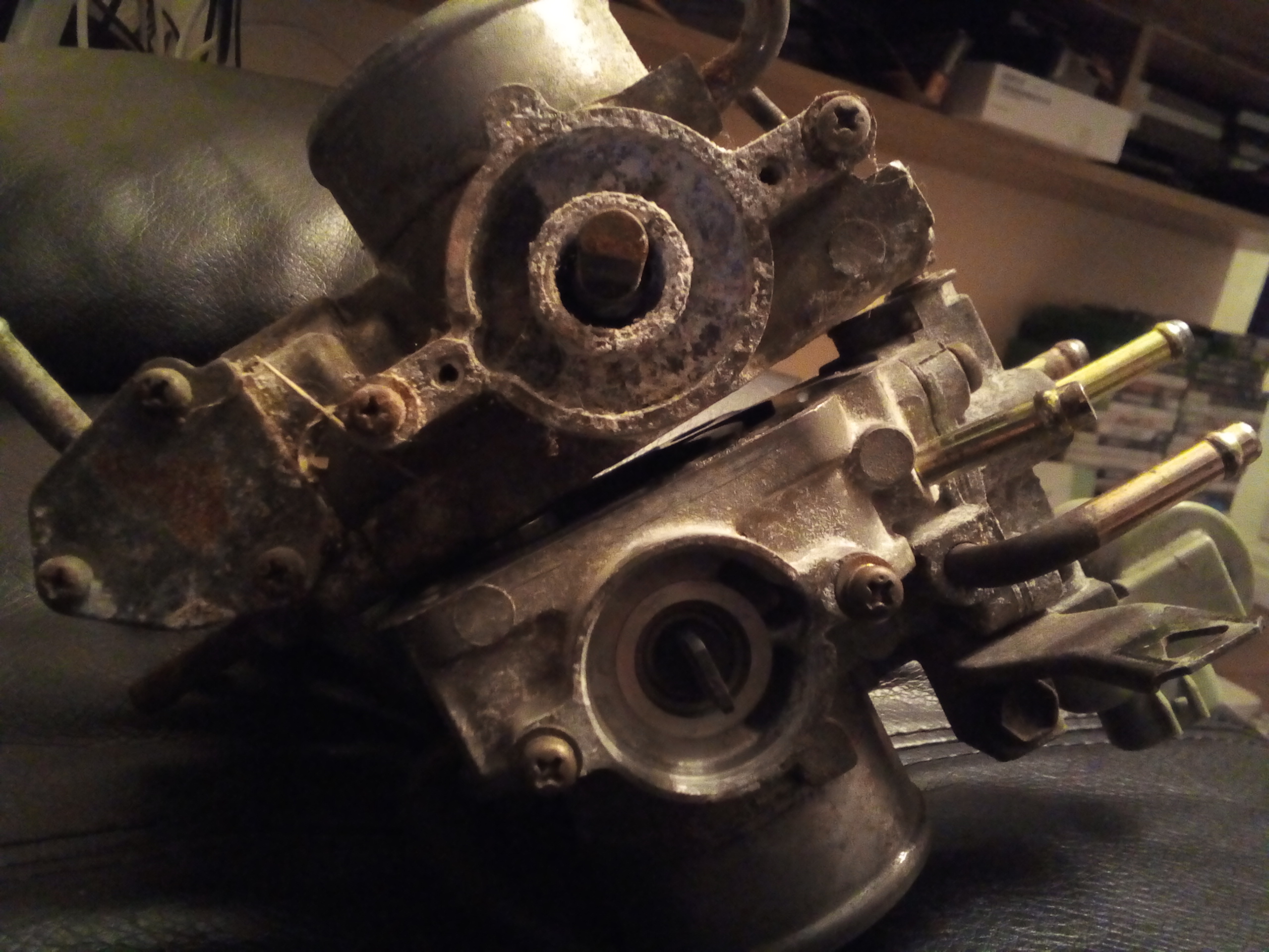

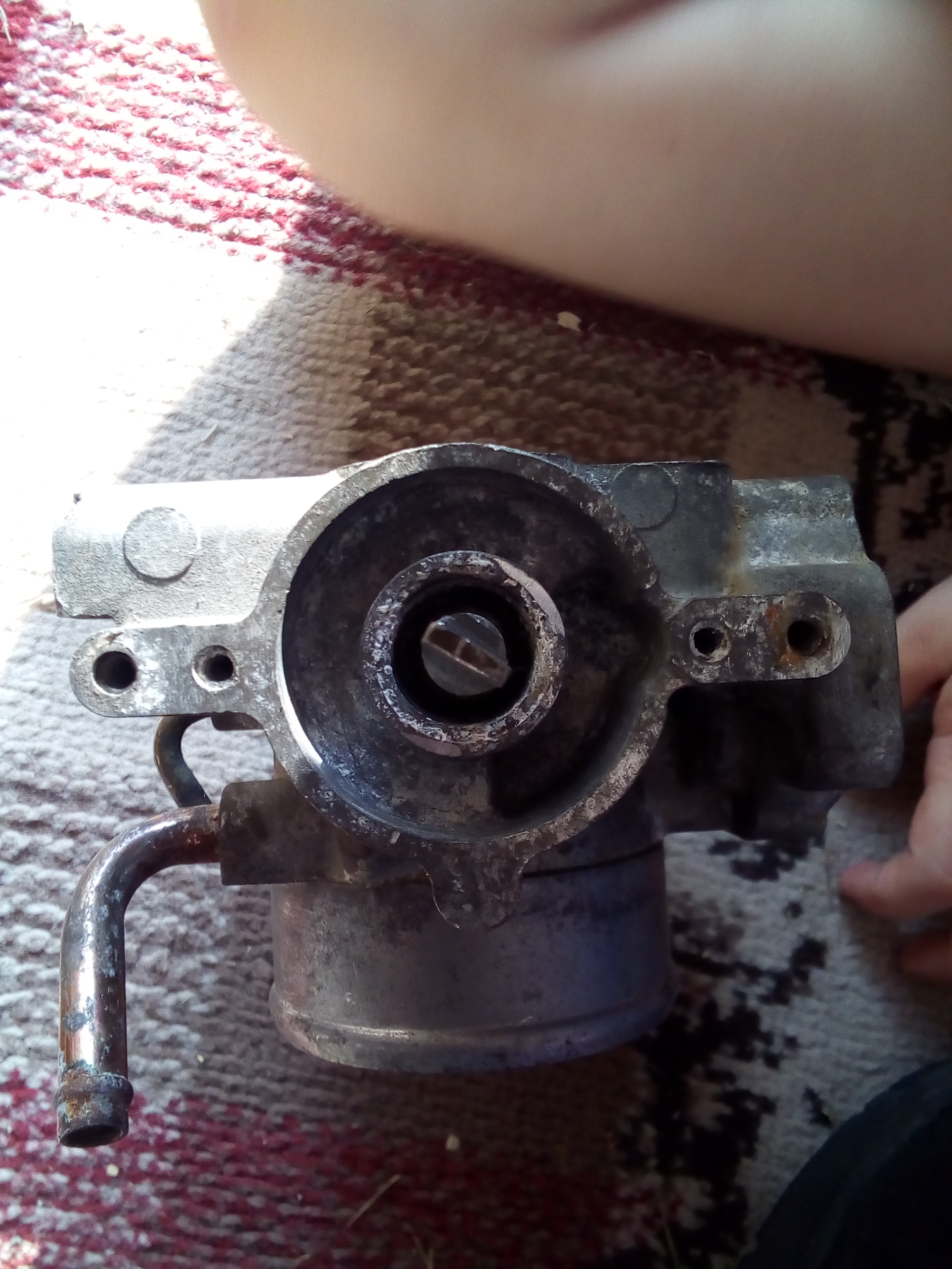

after taking some measurements of the center shaft/flap shaft. it quickly became apparent that these shafts are to different to swap.
differences
1). the overall length. this is because we have a 45mm throttle body and a 50mm.
2). the placement/distance between the flap mounting screws to the shaft, again its because of the flap diameter.
i have decided its much easier to have the 4efte throttle center shaft tps end made to fit the 4efe/5efe tps.
Here we go moding time.  Ported out 4efte throttle. All machine edges removed and port lips. Ported out as a cone thinning out the throttle outer edges. Smoooooth air flow. All I need to do is smooth out the liquid steel putty that I've blocked the idle up valve ports, this part of the throttle has been thrown away.
4efte tps key way modes to suit the 4efe/5efe tps.

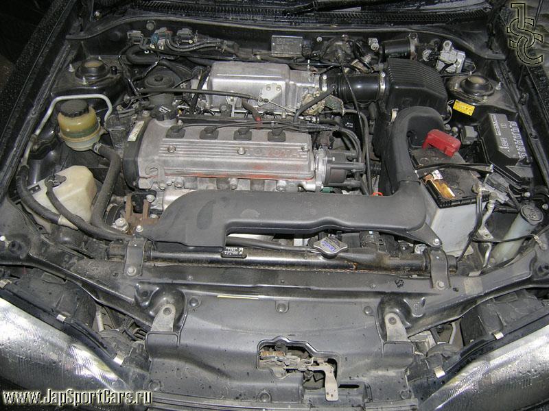

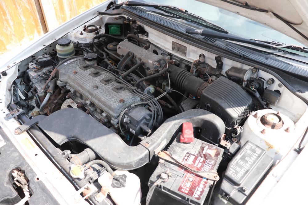

below is a Toyota sera 5efhe engine bay picture note the gen 1 also the 4efteh power inlet and large throttle body. other differences are the compression ratio, cam profiles and exhaust system.
one thing to note here is the maximum torque difference of the two engines i think you will be surprised. i hope we will hit around 100hp+ ready for boost at this point the 5efhe cams will go in.
the 5efe engine bay pic
See the source image

this is down to the very famous dual runner acis inlet manifold. this manifold increased low to high rpm inlet gas velocity/speed by passing it threw long narrow manifold runners at around 5.5krpm flaps would open up in the manifold accessing large shorter inlet runners increasing peak rpm power output. the two combined increased max output power.
this design is much nicer to drive
Edited by Sam44
The paseo is booked in for a dyno run. at the end of next month.
dan has set it up on a adjustable fuel reg and adjusting the dizzy for optimum performance, adjusting the length of the map sensor pipe. (road tuning)
spec so far:  alloy 3E flywheel 212mm low inertia paddle clutch, 4efte/gen 1 4efe, sera 5efe power inlet manifold &  50mm 4efte throttle modded body, 7afe pink 230cc+ injectors, g6 corrola c60 6speed box, engine earthing kit, kemso uprated fuel pump.
the 5efe took the 7afe injectors well with the fuel pressure set at 2.8bar base (vac line on)
he tells me the exhaust needs work now its restricting the power.
he tells me it comes alive after around 4.5krpm there is a big hit of hp right to red line 6.7krpm
he is estimating around 115hp
he is bringing the car back to me this weekend.

spark plugs replaced
dizzy cap and rotor arm replaced.

Same as the celica with the tvis/acis system,  opened up at 5200rpm then the fun started,  comparable to a power band on a bike seeing as it is a Yamaha engine lol
Good reading Sam keep at it bud  :)
hope all is well your end SKINY.
its alot nicer to drive these engines that have these intake systems on the road (daily use, your not banging out the rpm at red-line to access good torque). im not talking racing here.
they also help reduce engine wear. keeping engine rpm in the low to mid level hitting target speed at a nice pace.
they also make for a higher potential peak power.
ive been driving the paseo around the past couple of days, im not going with the 5ehfe cams until i fit the turbo small fast spooling tfo35 hyb.
the paseo drives really well, great mpg, with this setup im still in the high 30 to mid 40mpg
 great low centre of gravity, it eats up round abouts. driving positions not the best (at my age). rear axle feels very unstable (loves to wiggle its bum instead of slide near the limit).
the 5ehfe cams i fear will push the torque band to high in the rpm range. the torque at present hits around 4.3krpm till redline, the saving grace with this setup is the close ratio 4+:1 final drive gearbox really softens the impact of the higher engines rpm power band, allowing a near normal road drive with a hard hitting high rpm ability. i think any more on the cams will make me not enjoy driving it as a daily.
next set will to to free up some exhaust back pressure.
full custom 2.5inch system, then dyno-run.
i have been working on the paseo today just tidying up a few things.
ive ordered a full rocker cover gasket set as well as cam seal. (there is an oil leak in the rocker cover and running into 3 of the 4 spark plugs, also in the timing covers coming from the top, but settles in around the bottom cover sump area).
ive done a plug read, there are signs of det on them so ive pulled the ignition timing back 1deg retarded and cleaned off the plugs ready for another run & read. ive also added 1psi more fuel pressure (there a nice brown tea bag colour but there starting to turn white).
CLUTCH BLEED PROCEDURE.
ive bleed threw the clutch fluid and cleaned out the clutch reservoir (it was full of sludge). there is a nack to doing this using the adjusting screw on the rear of the clutch peddle. you have to adjust this to remove any and all of the free play on the peddle, but making sure you do not start to move the clutch master cylinder piston inwards (so basically just remove the peddle free play) this way you get full stroke of the cylinders (both master and slave). you then adjust the peddle for best clutch bite point after bleed.
doing this along with the steering rack and pinion preload, and throttle cable adjustment makes a hell of a change to control.
ive also removed some free play from the cam belt.
Edited by Sam44
