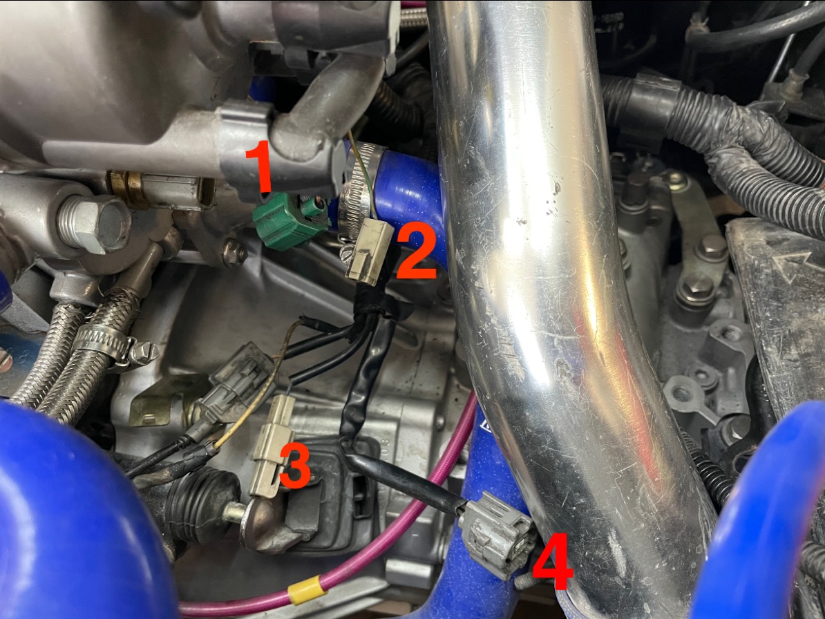

I’m struggling to locate what each of these wires are for on a ep82 gt turbo 1994. Is someone able to help me identify them please.

1 - coolant sensor
2 - coolant gauge on dash cluster
3 - for AC sensor on thermostat housing, you no longer have it, there is a bolt there instead. (Irrelevant)
4 - cat temp sensor (irrelevant)
Should be a green coolant temp sensor for the green plug 1, your sensor is grey. Does it fit?

1 hour ago, daniel_g said:
1 - coolant sensor
Thanks Dan, I wasn’t sure either so 1 plugs into the coolant temp sensor but it’s grey and green.
For 2 where is the other end for this to plug into or is it meant to be on the thermostat housing?
The thermostat housing is from a glanza V and my looms are ep82

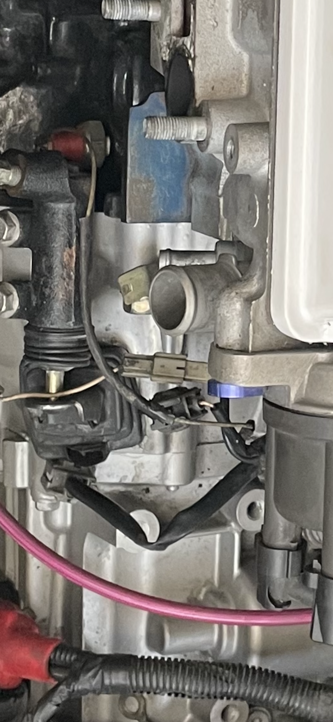

On 4/27/2021 at 7:51 AM, daniel_g said:
2 - should be in the thermostat housing aswell.
It is only for the cluster temp gauge.
You could fit an aftermarket coolant temp gauge.
Managed to get hold of the correct thermostat housing so will replace it.
Do you know where this single wire goes that is going over the master cylinder? I’ve just earthed it, is that right?
