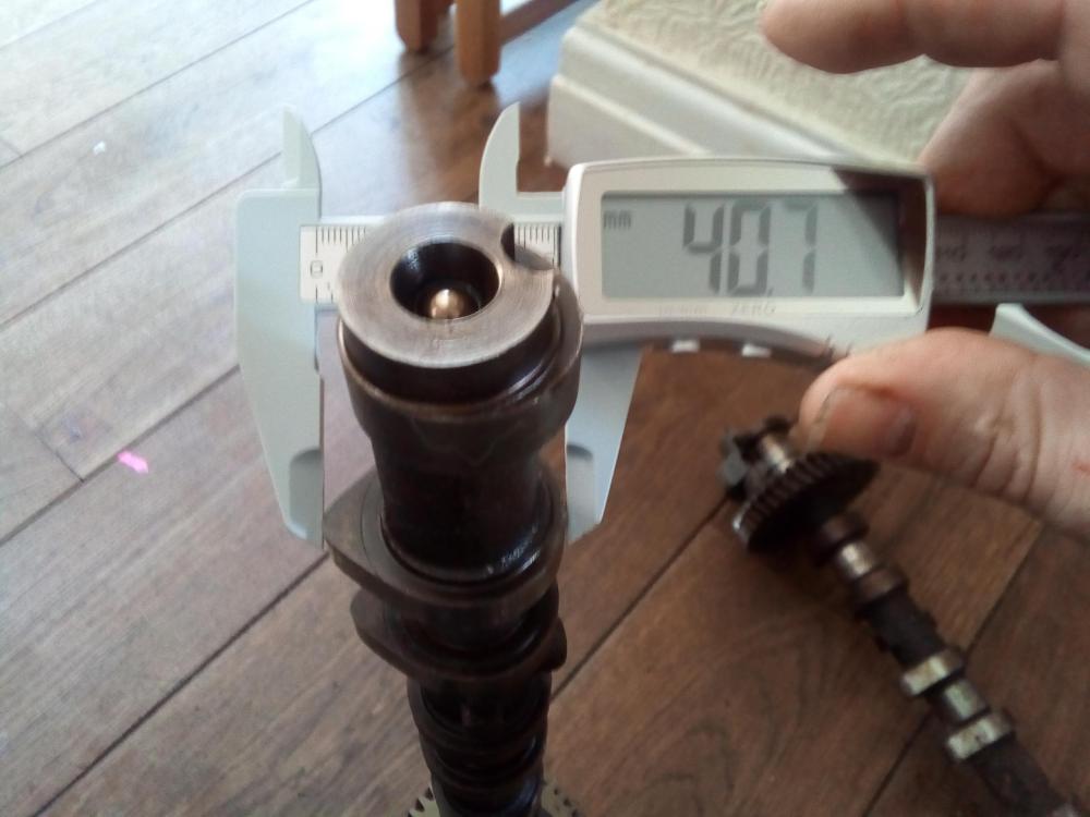

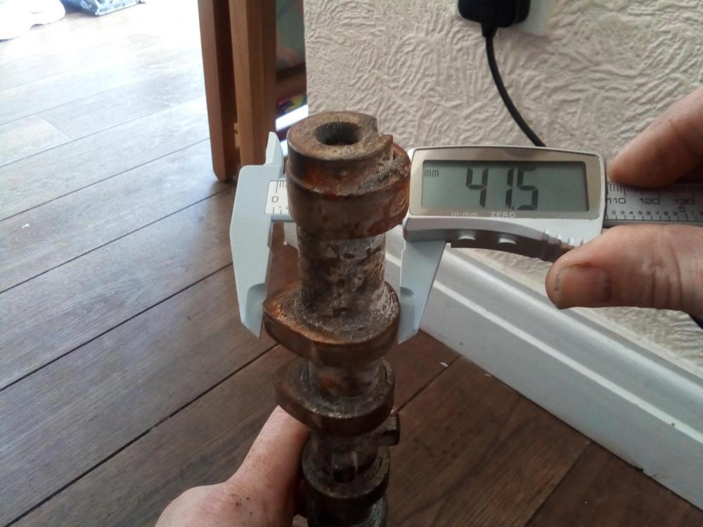

Thanks for the info, do you have the base circle dimensions for the cams so I can work out the actual lobe lift?
gen2 4efe = 40.7 - ??? = lobe lift
4efte & 5efe = 41.5 - ??? = lobe lift

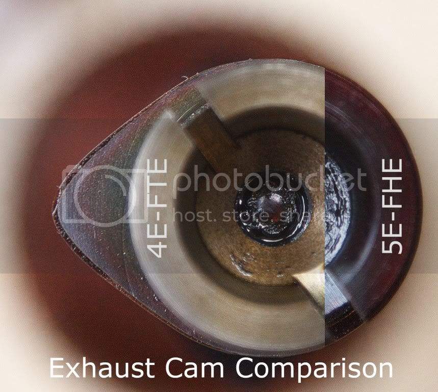

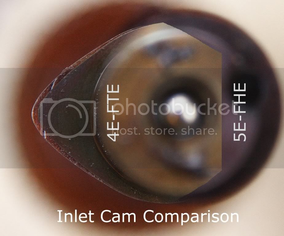

Also is there any info regarding the duration of each cam and overlap of these cams with their original exhaust partners or the 4efe exhaust cam for all? We know that generally speaking turbo cams have little to no overlap compared to N/A's which like some overlap up to a point. Would be interesting to see if the higher revving N/A cams had different duration / overlap to the low rpm N/A plodders torque monsters.

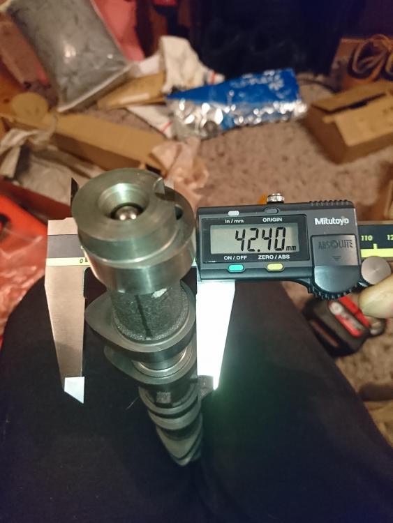

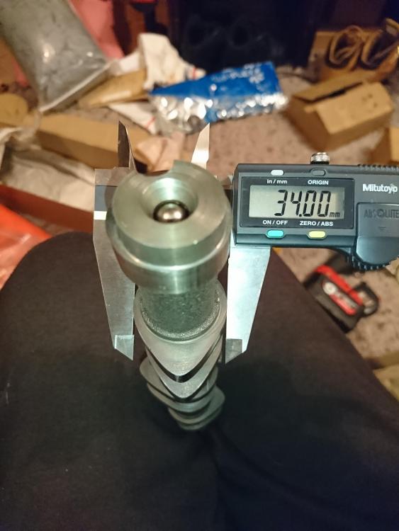

Found the 5efhe inlet cam base circle dimension from the pics Trevstar posted on your build thread.
5efhe = 42.4 - 34.0 = 8.4mm lobe lift (thanks @trevstar)

I'll use Enzo's dimensions from the second thread link as they're complete and virtually correlate with yours and the other threads:
gen2 4efe (small) = 40.85 - 34.05 = 6.8mm lobe lift
4efte & 5efe (medium) = 41.6 - 34.05 = 7.55mm lobe lift
5efhe (large) = 42.4 - 34.0 = 8.4mm lobe lift
To be honest it looks like the factory base circle is around 34mm from all the threads I've researched but you still need to know the actual dimension for the one you're measuring to be certain.
