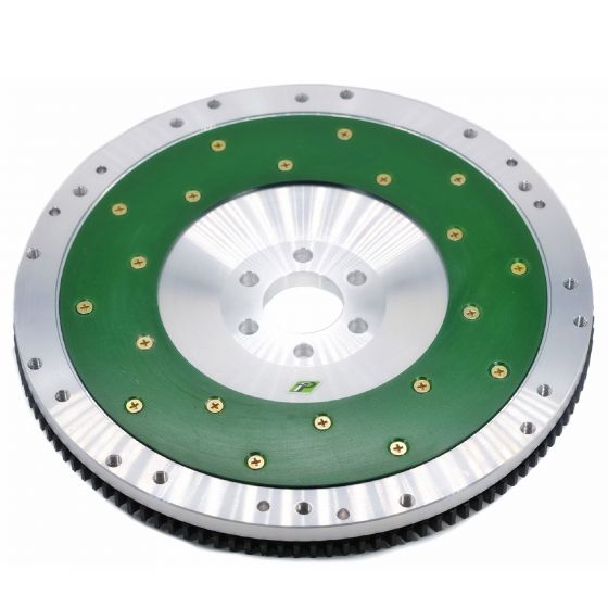

I'm using the fidanza brand the lightest I can find. Around 3.61fid_fidanza_flywheel_top_angle_mar20.jpg.0d0c97a317ab1cfbc27f3010a0fb855d.jpgkg this allows the engine to increase rpm sharply with little resistance. The clutch also does this (low anertia) in relation to the engine it is the time taken to accelerate from say 850rpm (idle) to 7krpm (redline). These two units help the engine achieve it in a faster time.
The standard ep91 4efte and 4efe flywheels are around the 15kg mark. With the larger 212mm clutch and pressure plate a few kg more than the 200mm. So choose carefully. It does make a difference. With the larger 212mm clutch having more mass/weight further way from the center/larger diameter, taking longer to overcome anertia (accelerate slower), but handles more power over the smaller 200mm unit. The balance again has to be struck.
There are some draw backs using the very light alloy flywheel.
1). Is that it has a steel plate (clutch contact surface) screwed to the alloy flywheel. Were these screws are positioned on this surface removes/reduces the friction plate to flywheel contact surface area.
2). Because of the very low weight of the flywheel the force/energy stored in the flywheel is significantly reduced. This means off throttle when clutching and changing gears the engine rpm drops sharply. This is not a problem when clutching fast/racing but can be a problem in slow moving traffic.
3). Because of the reduction in weight acting against the thrust movement of the clutches pressure plate. If you start gearing hard/fast (kicking the clutch) crank walk can happen with alot of engines. You have to learn to gear fast but smooth, not agresive. One of the reasons why the 4efte engine comes with a very heavy front pully.
The difference in design and weight now depends on how fast you want the engine to increase in rpm (the lower the weight the better) engine deceleration off throttle = increase in weight to store energy. power the clutch has to handle and how you are going to drive it.
