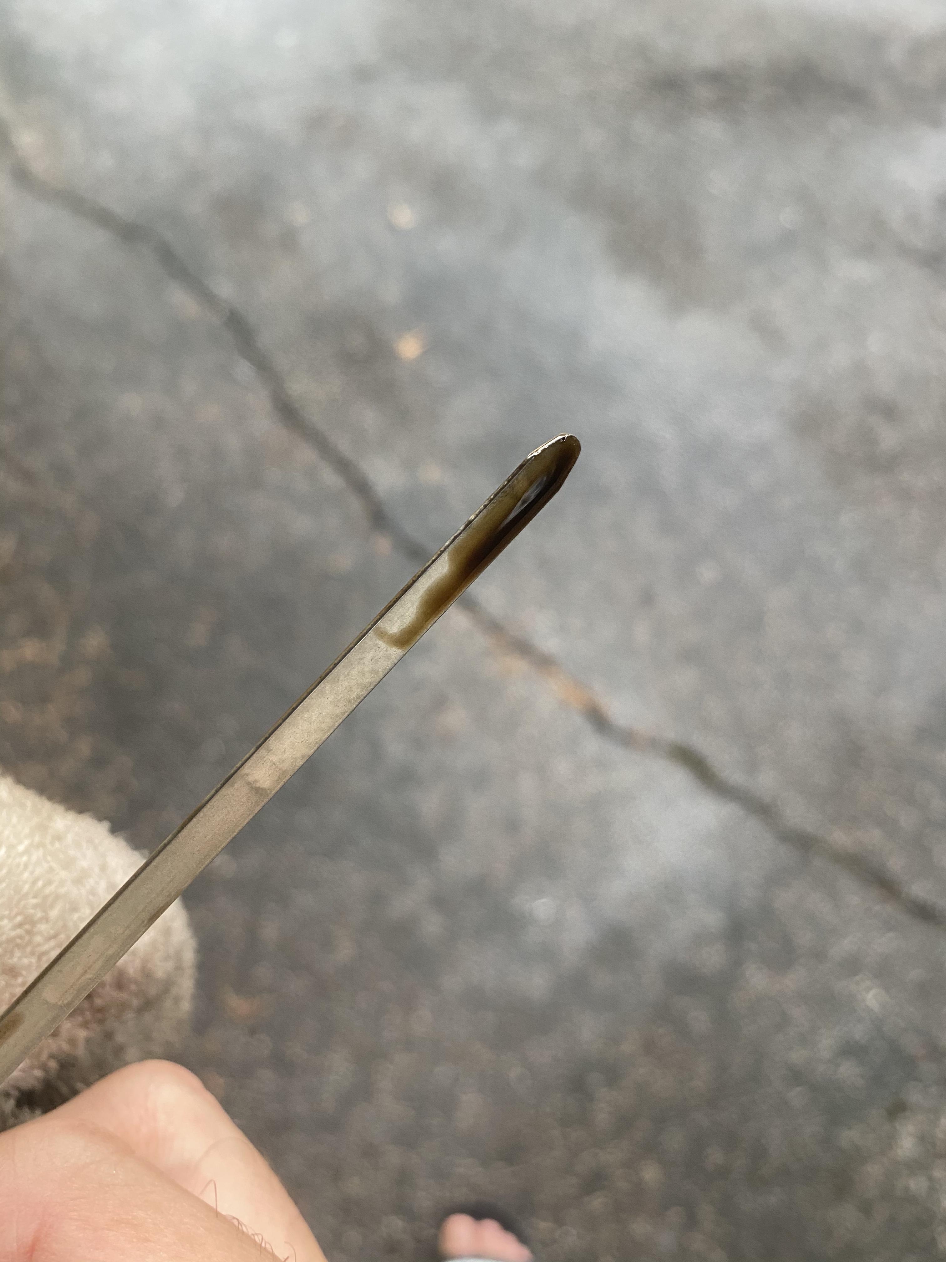

Frankieflowers Posted July 4, 2022 Author Share Posted July 4, 2022 I agree. I checked the piston heads taking out the spark plugs and nothing seems different as usual. Hi drowned the water system and it was clean without any oil. I put new liquid coolant and leveled it. Went for a drive and after two hours I checked the level that was already down. I drove home and had to put at least 100 ML liquid. There is no area where I see sugar or leak tracks. Consider that external temperature right now is around 34°. The water pump is new because I did everything I could to refresh the engine before the swap. If it happens suddenly it means that something changed. I also checked the oil and it doesn’t seem contaminated. It could be the radiator but it doesn’t seem to show signs of leak or areas of evaporation. The radiator cap seems to be perfect and the spring works well. If the water would be in the oil then the oil would be foam. Right? tomorrow I should be able to go to my mechanic and try the water system pressure to understand more about this leak. I really don’t want to destroy the engine. Quote Link to post Share on other sites

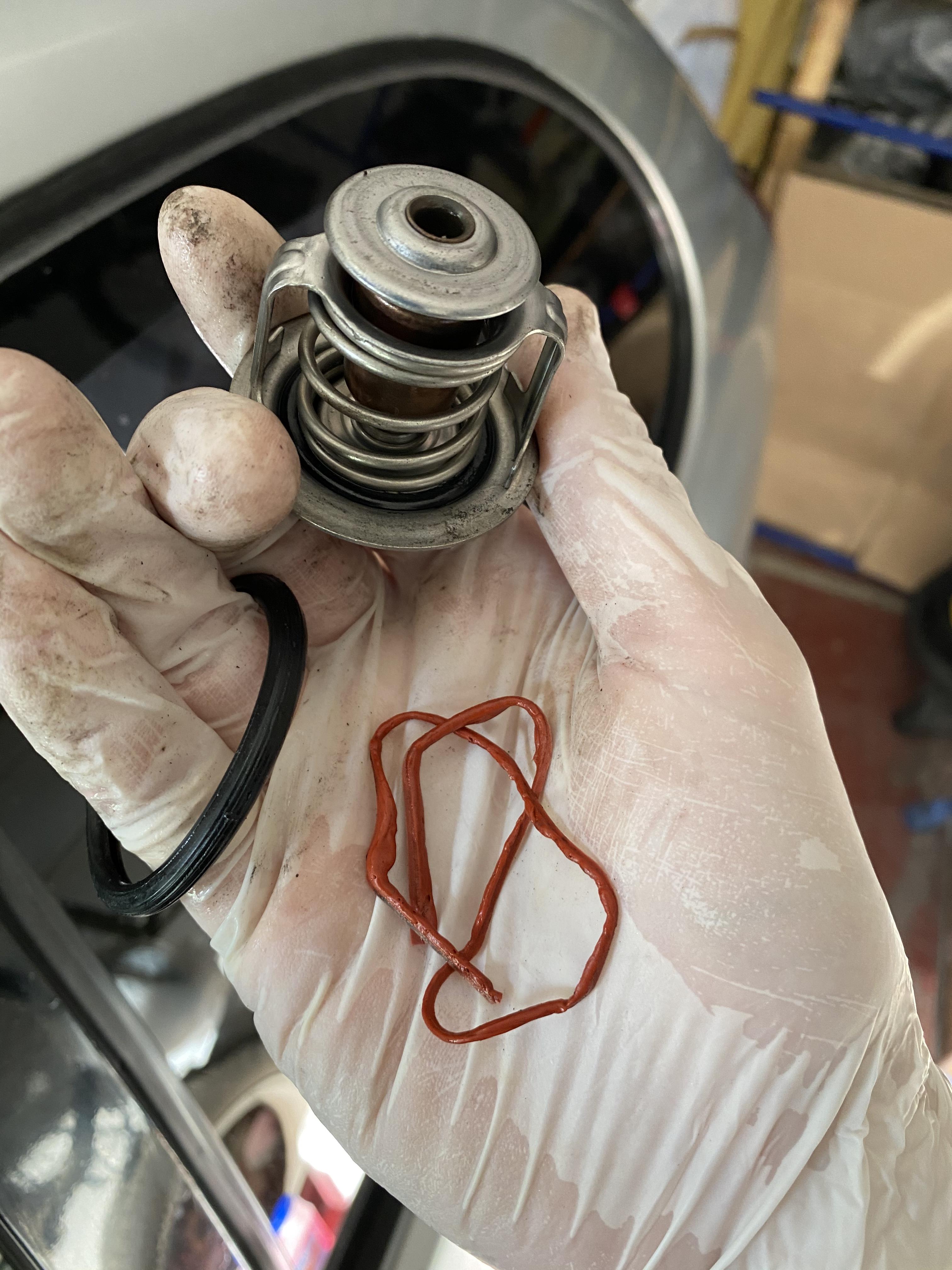

Frankieflowers Posted July 4, 2022 Author Share Posted July 4, 2022 (edited) Found it... IMG_8271.MOV Edited July 5, 2022 by Frankieflowers Quote Link to post Share on other sites
Claymore Posted July 5, 2022 Share Posted July 5, 2022 9 hours ago, Frankieflowers said: Found it... IMG_8271.MOVUnavailable Can't see the movie. Glad you found it, where was the leak? Quote Link to post Share on other sites

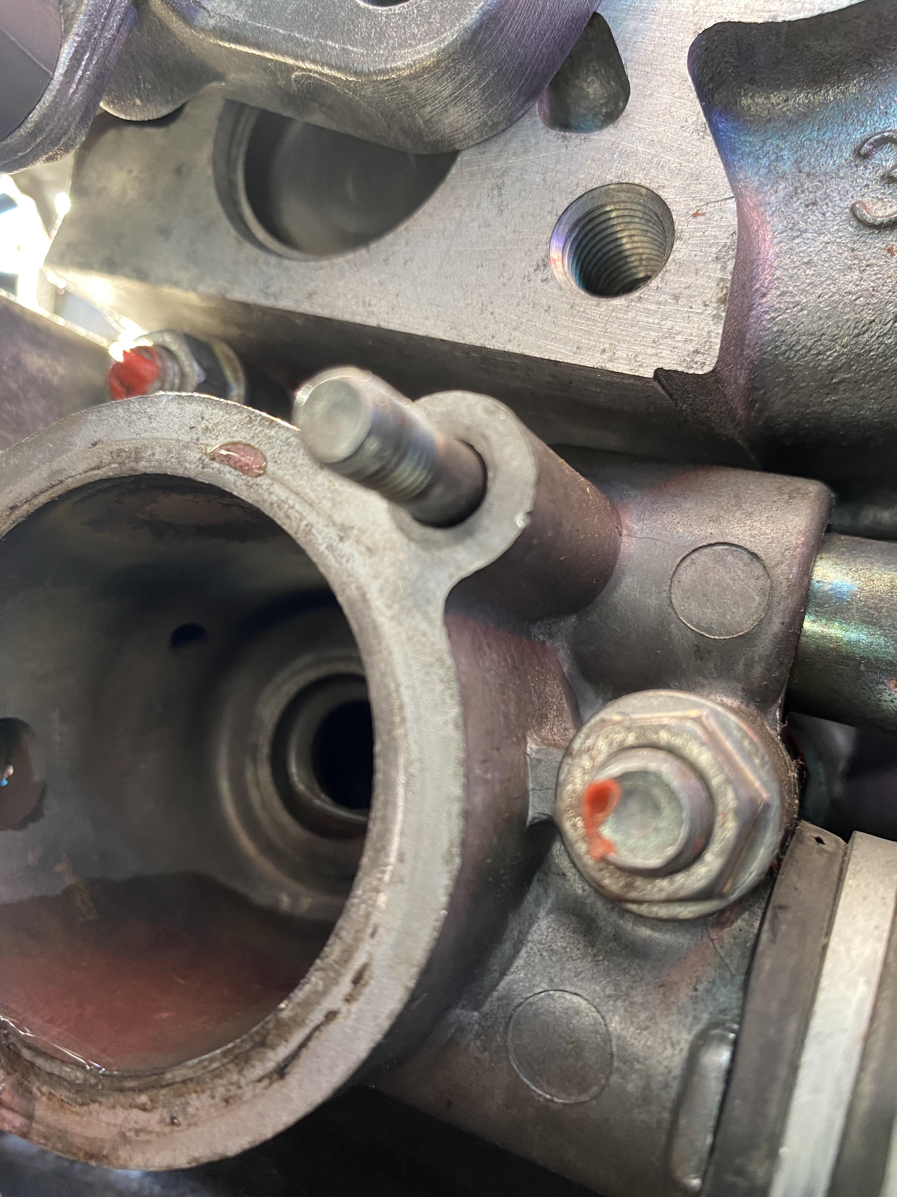

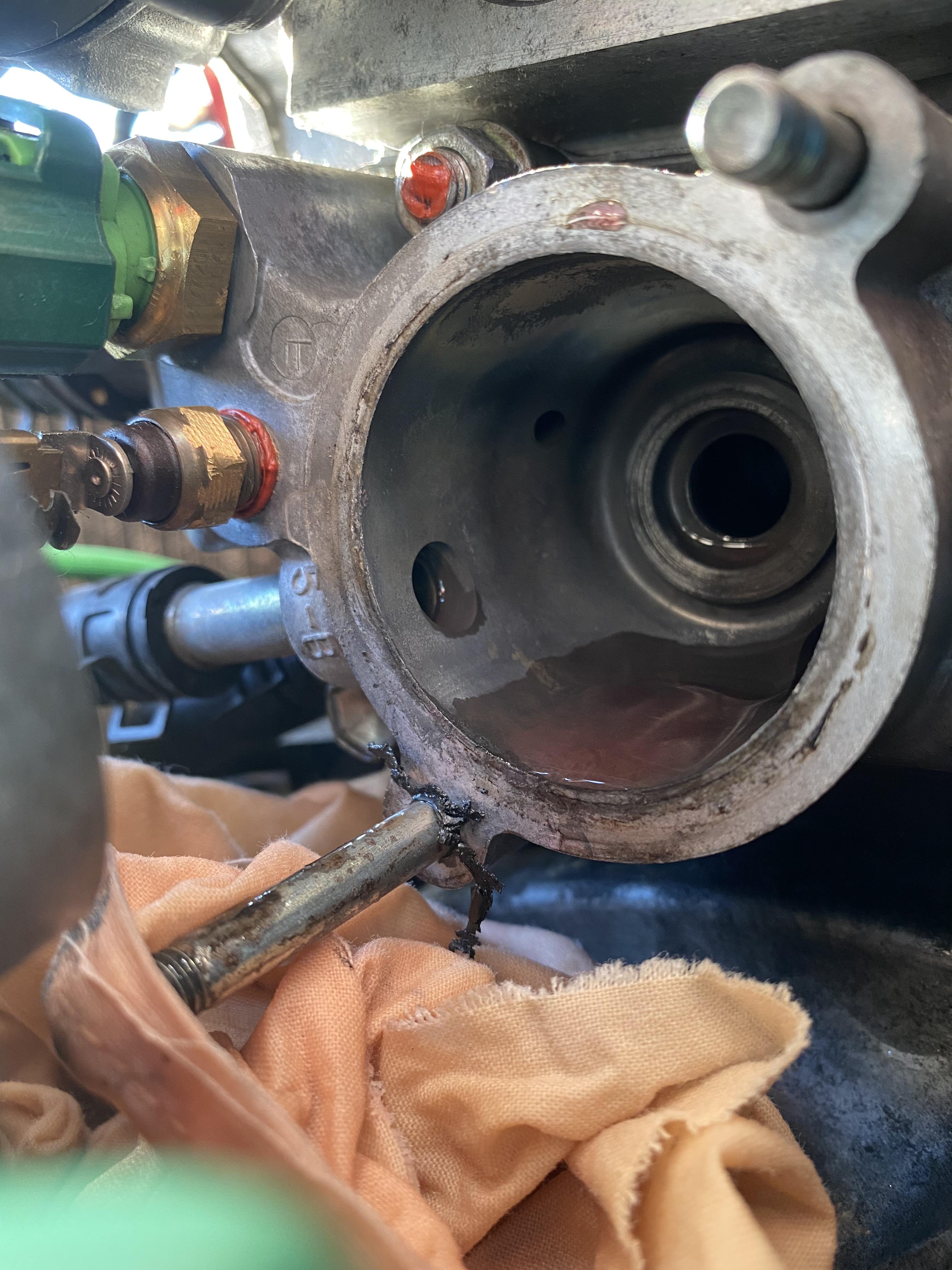

Frankieflowers Posted July 5, 2022 Author Share Posted July 5, 2022 (edited) The liquid is getting out from underneath the thermostat cup. I tighten the bolts but after I went for a ride I noticed that it was still leaking. I will have to check again and I really hope it’s not a crack in the engine head. The lower bolt was loose but then I tightened it and it’s still leaking. Edited July 5, 2022 by Frankieflowers Quote Link to post Share on other sites
Frankieflowers Posted July 5, 2022 Author Share Posted July 5, 2022 I hope it’s not the head gasket leaking externally. Quote Link to post Share on other sites

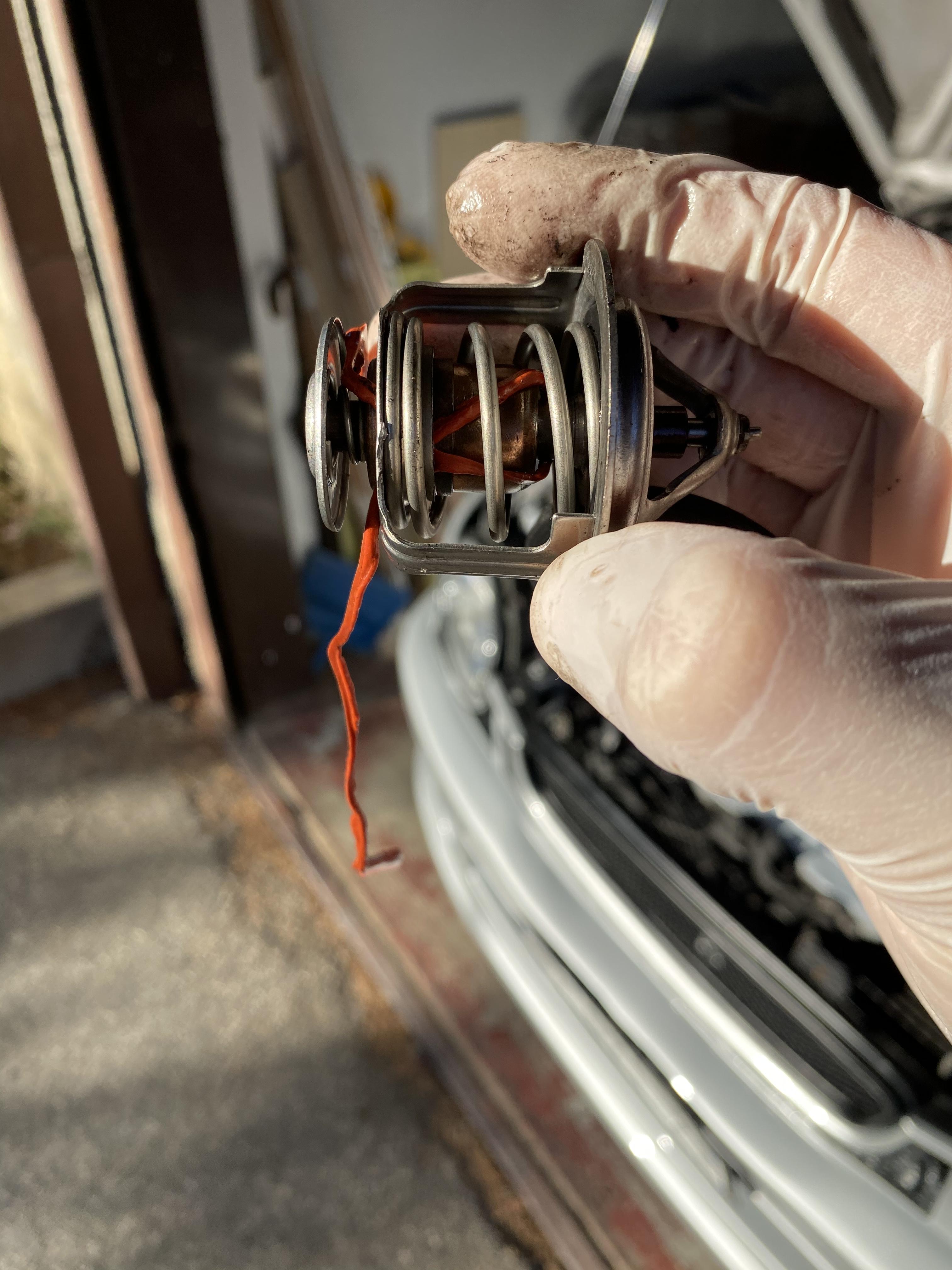

Claymore Posted July 5, 2022 Share Posted July 5, 2022 (edited) The orange "string" looks like gasket sealant used to seal the thermostat housing to the head? Too much sealant can come off and then got stuck in the thermostat I guess. Hope the heads ok. Did you use a Genuine Toyota head gasket for the rebuild? Edited July 5, 2022 by Claymore Quote Link to post Share on other sites
Frankieflowers Posted July 6, 2022 Author Share Posted July 6, 2022 5 hours ago, Claymore said: stuck in the thermostat I guess. Hope the heads ok It came from the new water pump 😂 Yes I did use all genuine parts Quote Link to post Share on other sites
Frankieflowers Posted July 6, 2022 Author Share Posted July 6, 2022 I think that the reason ehy it leaks is the loose thermostat gasket. Quote Link to post Share on other sites

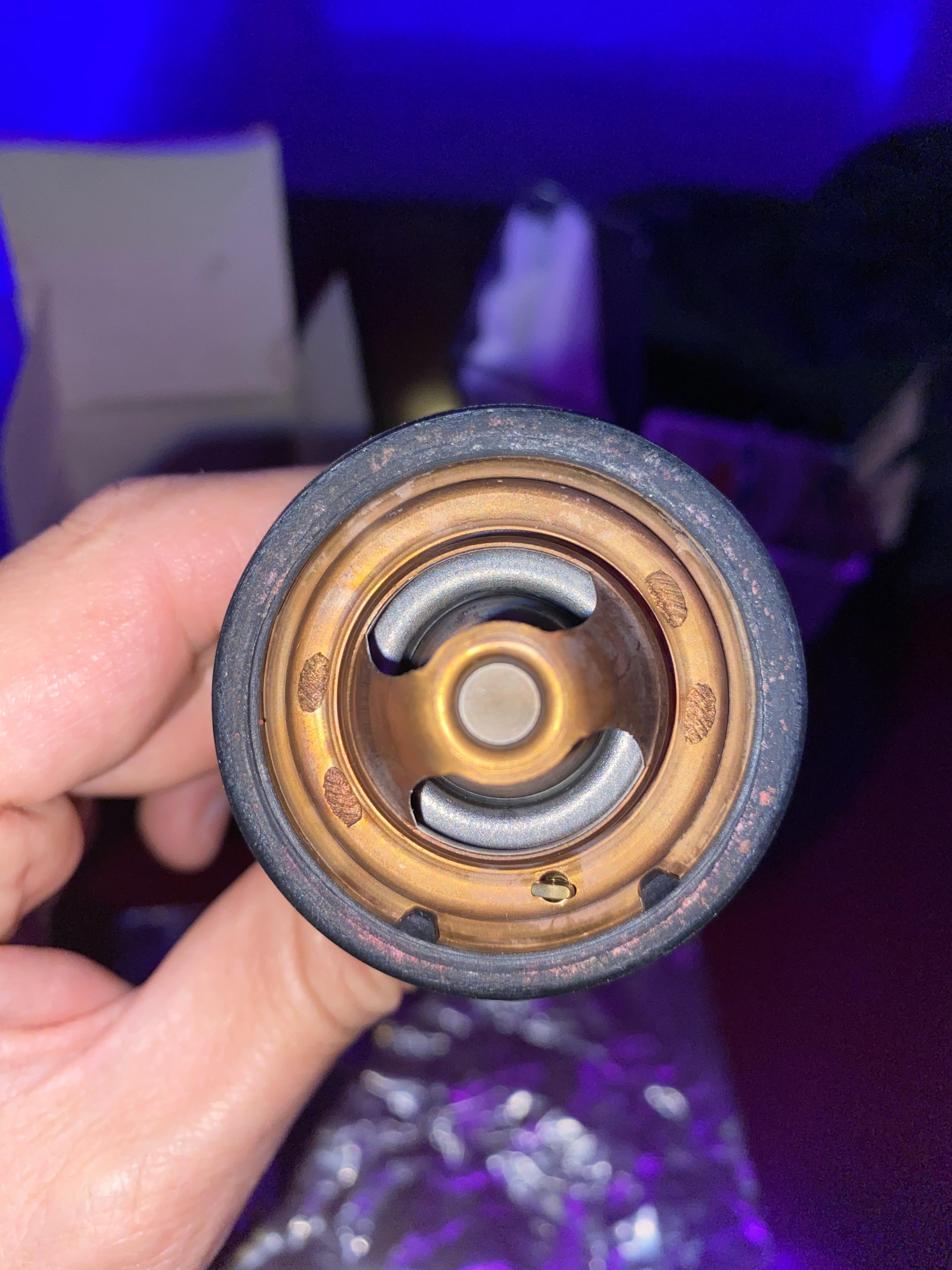

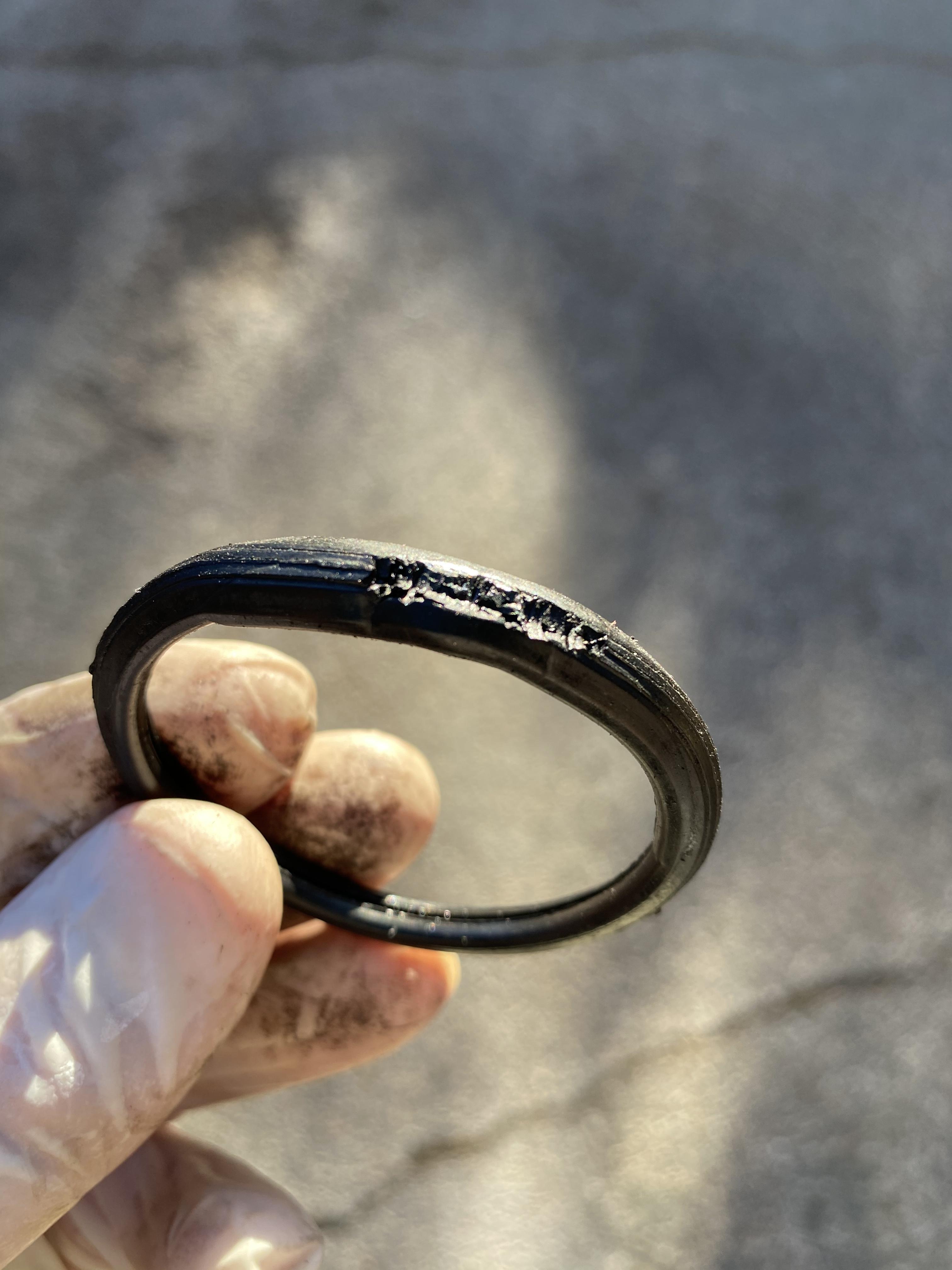

Frankieflowers Posted July 7, 2022 Author Share Posted July 7, 2022 Just now, Frankieflowers said: I tookfrom the box the last thermostat I had in the engine before changing it with one that opens at a lower temp it was someone’s advise (don’t remember who). with the smaller ring thermostat and perfect gasket it went perfectly in sight and it stopped leaking! Quote Link to post Share on other sites

Frankieflowers Posted July 9, 2022 Author Share Posted July 9, 2022 @ClaymoreI solved the problem changing the thermostat. The gasket was loose so the cover wasn’t sealing properly. This happened I think because are used a different thermostat that I don’t remember who suggested me was better to keep the engine temperature lower for the reason that the spark plugs were white gray. So I put back the OEM thermostat I had in the box and no more leak! Thank you for your help. Quote Link to post Share on other sites
Claymore Posted July 10, 2022 Share Posted July 10, 2022 17 hours ago, Frankieflowers said: @ClaymoreI solved the problem changing the thermostat. The gasket was loose so the cover wasn’t sealing properly. This happened I think because are used a different thermostat that I don’t remember who suggested me was better to keep the engine temperature lower for the reason that the spark plugs were white gray. So I put back the OEM thermostat I had in the box and no more leak! Thank you for your help. It was Sam44 that suggested you use a low temp. thermostat. I just supplied the part number in case you wanted to try it. I personally don't like them and only use the normal one for the engine. In your photo it looks like the seal got pinched and cut the bottom off it. Happy that it's all sorted now. Quote Link to post Share on other sites
