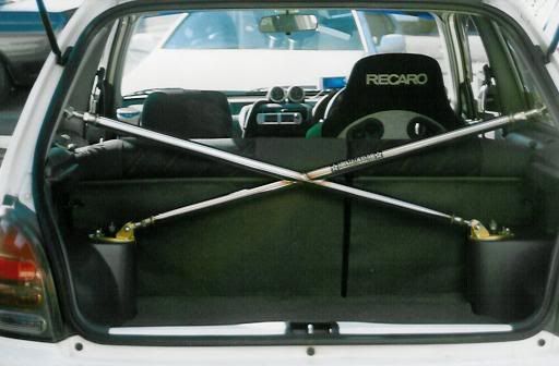

Guest Enzo Posted October 26, 2005 Posted October 26, 2005 yea you get them for skylines ectyea i have heard of something similar for the starlet but instead of a u bar there are a total of three bars...cant seem to find a pictwo that link up to the front bottom cross member to the bottom of the sruts then the tie bar links the middle together.was in the proces of writing an article on chassis strengthenging before the old site went down..there are loads of other types of bars toofor those of you that have not seenlike one to link up the c pilarto kill two birds with one stone you could invest in a miracle cross bar like belowyou can also get a floor bar for the the floorwell but im sceptical about how much flex it would stop...every little helps i spose
glenn Posted October 26, 2005 Posted October 26, 2005 would love that miracle cross bar but i need my speakers on rear shelf so i will buy the cusco jobie & the toyota rear strut does anyone have the price from toyota looks expensive

potge Posted October 26, 2005 Posted October 26, 2005 Miracle`s cross bar is really a good choice (i can`t see the pics am i the only however i have seen the bar in a jap auction) but for someone wanting something let`s say more practical i think toyota`s three point rear strut brace or zep-rm`s (i dont know if they ship to Europe i tried to contact but they haven`t replied) three point again rear brace (in reality a a simple rear strut brace and two additional bars) and for that extra rigidy back and high a pillar bar above the seats would probably be equivalent to miracles cross bar and more or less about the some money. ideally a cross triangular brace pillar combination would be perfect but then we tend to a roll cage solution.
