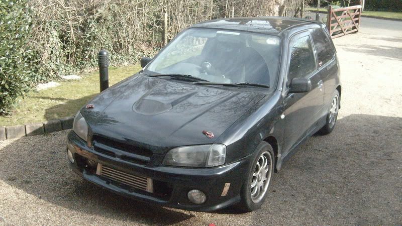

StarletRick Posted September 19, 2008 Posted September 19, 2008 bonnet is black, without the scoop. and has bonnet pins. no dents or marks, youll just have to get it sprayed. Quote
iamlegend Posted September 19, 2008 Author Posted September 19, 2008 bonnet is black, without the scoop. and has bonnet pins. no dents or marks, youll just have to get it sprayed.seems kool, do you have the picture of the actuall bonet thow ? cheersyou want 50 quid for it as well ye? Quote
SiCaln Posted September 19, 2008 Posted September 19, 2008 that is the actual bonnet! Just wont have that reverse scoop in the middle Quote
iamlegend Posted September 20, 2008 Author Posted September 20, 2008 Here ya go matethere in great condition y r u getting new ones thow? these look newish60 del yee? Quote
Sparky Posted September 20, 2008 Posted September 20, 2008 Yea they look fine!!!Compared to mine anyway Quote
iamlegend Posted September 20, 2008 Author Posted September 20, 2008 you kno the bumper how it wont have the scoop in the middle does that mean itll have a big hole in the middle?will i have to buy a scoop? Quote
