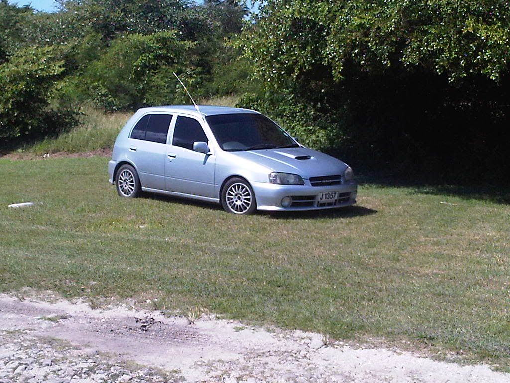

Flipside Posted September 14, 2009 Author Posted September 14, 2009 The car is really low, I'm afraid of side skirts lol Quote

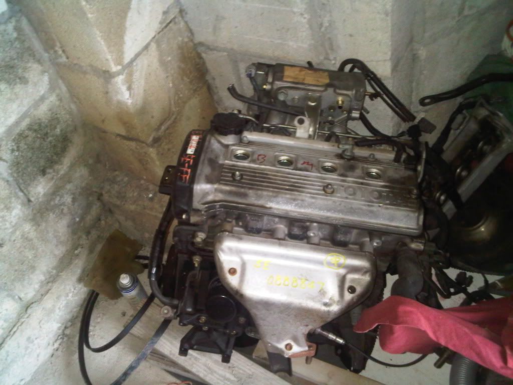

Flipside Posted November 3, 2009 Author Posted November 3, 2009 5efe ready to rebuild. Also have 4efte pistons and trying to get 5efhe rods. Quote

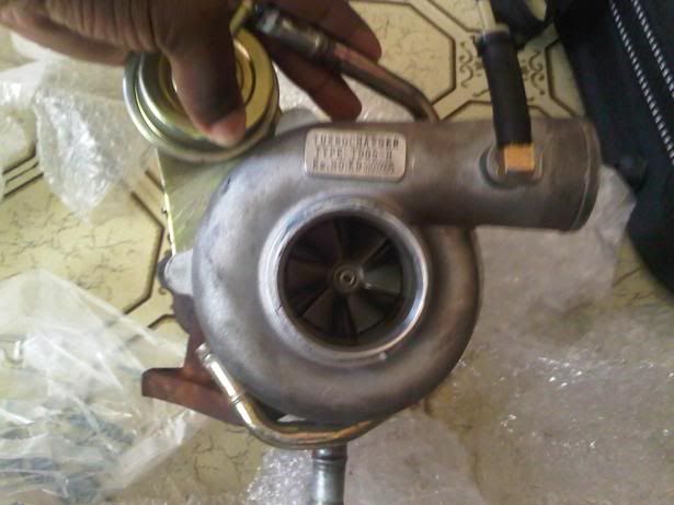

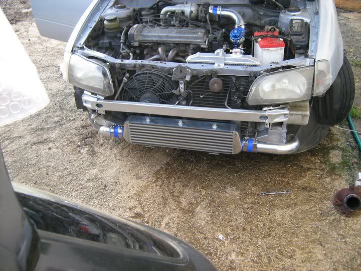

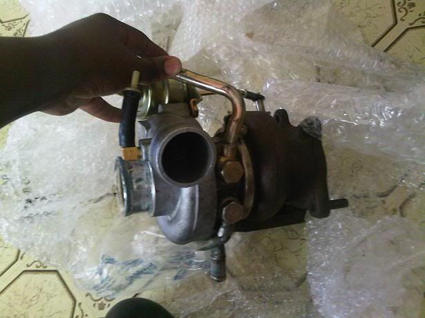

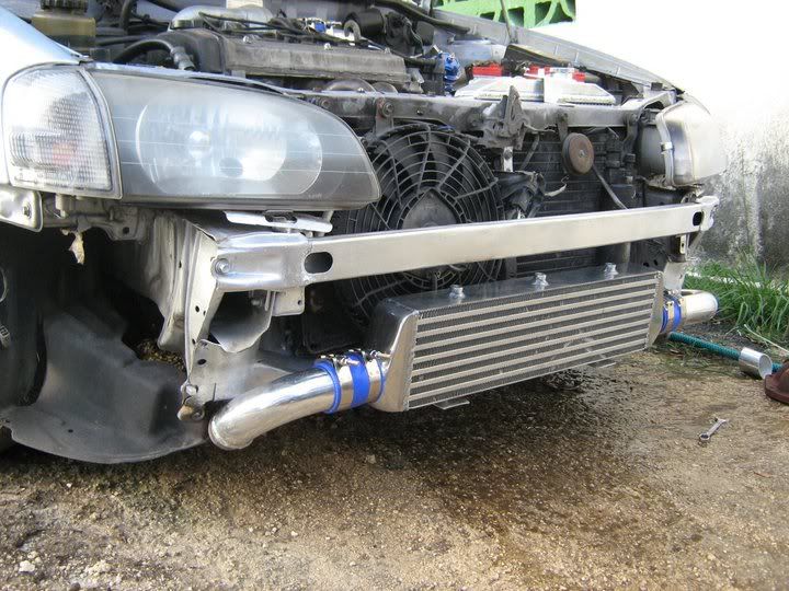

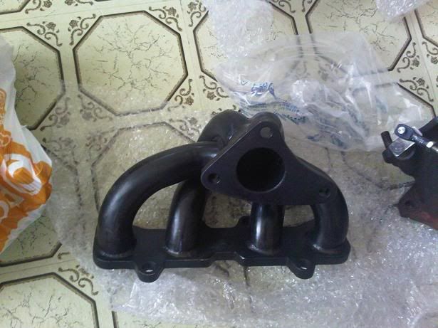

Flipside Posted February 22, 2010 Author Posted February 22, 2010 UPDATE5efe motor rebuilt with 4efte pistons and 5efhe connecting rods.Parts AcquiredTD05 turbo Speedvision exhaust manifold.EP82 gt turbo gearbox Greddy turbo timer The standard 4efe engine is out, took about 2 hours. 5efe should be in soon and will be breaking it in n/a on the standard computer. After about 500km will change oil and filter and fit the turbo bits as well as the megasquirt. Will keep you guys posted on the progress. Quote

whiteglanzav Posted July 7, 2010 Posted July 7, 2010 Good work dude - looks awsome,not seen a turbo set up with a corrola manifold before - will be interested to see what kind of results you get what management are you gunna be using Quote
Flipside Posted July 8, 2010 Author Posted July 8, 2010 I'll be using a megasquirt ecu. Thanks for the comments. Quote
