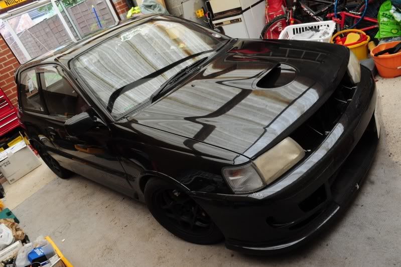

BAZ2CRAZY Posted November 7, 2010 Author Posted November 7, 2010 Nothing was up with it as such. it just needed setting up properly. Took it to Tracktive solutions who were just awsome, friendly bunch .No longer rubs my front arches (as bad) just over 1 degree of negative camber, grips much better.Mitch Quote
LukeSR Posted November 7, 2010 Posted November 7, 2010 Glad you finally got the suspension sorted dude,Pics of front bumper? Quote
Liam_D Posted November 7, 2010 Posted November 7, 2010 Ah so it was our fault all along then, would be interesting to see there print-out if you have one mate?Would love to know what we were doing wrong. Quote
BAZ2CRAZY Posted November 7, 2010 Author Posted November 7, 2010 They set the top mounts in a symmetrical position then adjusted the camber at the hub along with the toe. .I think ive got 5 minutes negative toe and something like 1.05 negative camber. My rear toe is still a bit random along with the front caster,40 minute difference between left/right.Mitch Quote
