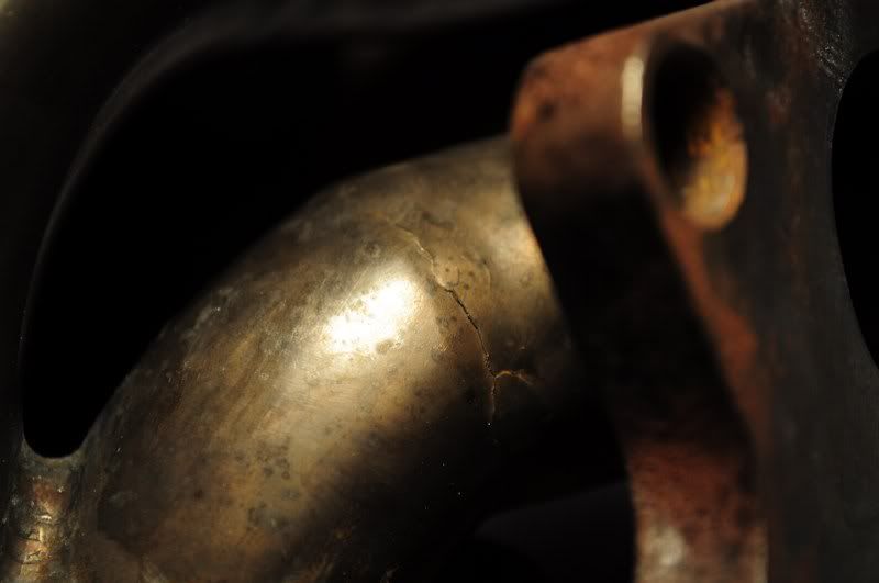

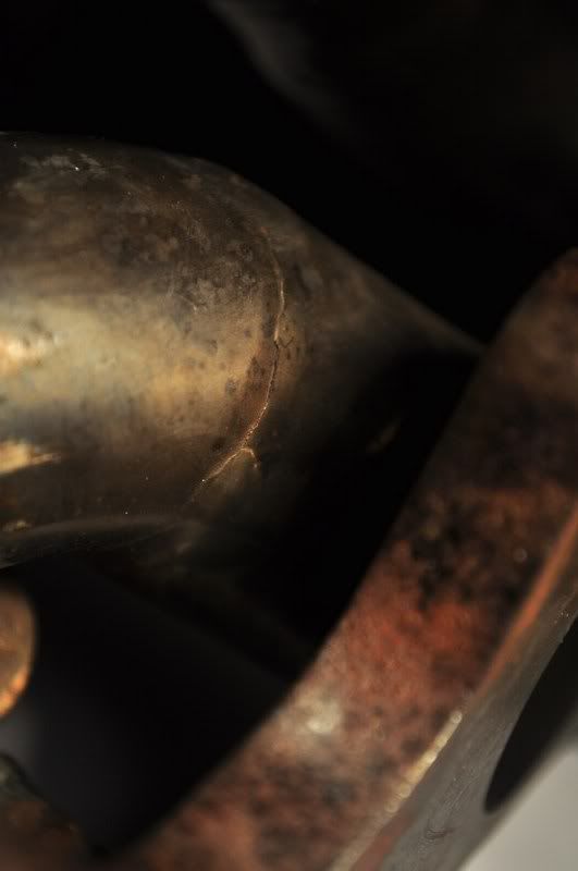

BAZ2CRAZY Posted April 13, 2010 Posted April 13, 2010 HelloooNeed advice from someone with experience with there manifolds cracking etc...Basicly ive found a couple cracks... removed it from the car and welded them up... Only, after it had cooled etc i found that the heat stresses had caused it to crack in several other areas...My question is;If this crack ive found a problem? or should i risk it and try re-weld it..This is the second runner by the way (number 2 cyl)(same crack)The thing thats pissed me off is that its probably worse than the crack i found in the first place!There are also a couple more tiny cracks.. but i dont think i shall bother with those.CheersMitch Quote
WallaceGlanza Posted April 13, 2010 Posted April 13, 2010 Personally I'd get rid of it and get a decent one. Quote
BAZ2CRAZY Posted April 13, 2010 Author Posted April 13, 2010 I was afraid someone would say that.Ok, so. If i was to keep it for say a couple months... the crack wouldnt be detrimental to the engine would it? say.. if it blew slightly?Mitch Quote
WallaceGlanza Posted April 13, 2010 Posted April 13, 2010 No, you'll just lose a bit of power and it will sound crap. Quote
BAZ2CRAZY Posted April 13, 2010 Author Posted April 13, 2010 Im not fussed about that really, just dont want to pap my engine.I may aswell have a go at welding it again.Mitch Quote

Steve GT Posted April 13, 2010 Posted April 13, 2010 new one matethe weld will never hold in my opinion you can weld it all you want it will keep cracking Quote
Spanner Posted April 13, 2010 Posted April 13, 2010 ok if u weld it,drill a small hole each end of the crack to stop it spreading, then heat it up with a blowtorch and weld it quickly! Quote

BAZ2CRAZY Posted April 13, 2010 Author Posted April 13, 2010 Narh, i believe its an original sps.. Ryno will know.It must be around 3 years old... at least. I welded nowhere near where the current crack is lol!Il just weld it, heat it a little, relieve some stress. Then start saving for a new manifold.Any one got any recomendations for mani's?Mitch Quote
