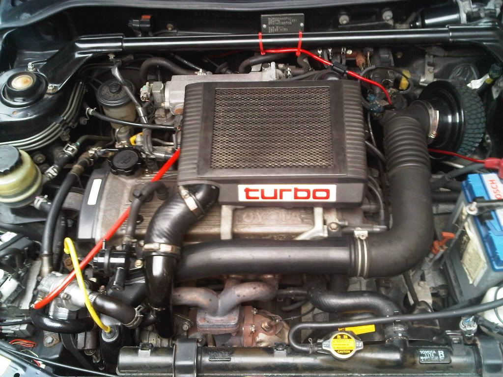

james@cjperformance Posted September 15, 2010 Posted September 15, 2010 throw up a decent pic of your engine bay, if your actuator arm is moving easy id suggest getting a hks one, the standard springs are crap in actuators,there should be quite a bit of resistance in the actuator which in turn holds boost properly. Quote

BoGlE Posted September 15, 2010 Author Posted September 15, 2010 throw up a decent pic of your engine bay, if your actuator arm is moving easy id suggest getting a hks one, the standard springs are crap in actuators,there should be quite a bit of resistance in the actuator which in turn holds boost properly.Here you go... Quote
