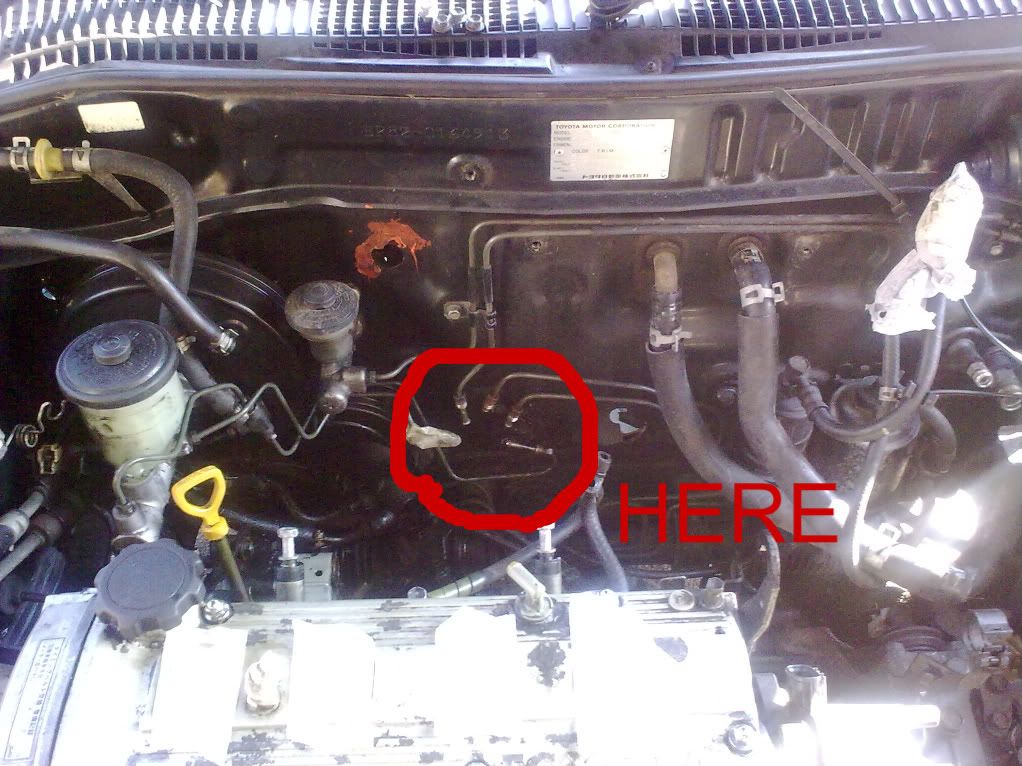

shorty Posted October 7, 2010 Posted October 7, 2010 does it have a brake bias control under the car for front/rear balance? could be on its way out. mine went last month on my caddy van, very simlar symtoms, then wen it finly went completly it shit fluid everywhere Quote
miib14 Posted October 7, 2010 Author Posted October 7, 2010 brake bias control?where would that be located? Quote
steed Posted October 8, 2010 Posted October 8, 2010 it's normally and aftermarket fit on these car, very unlikely that your corolla has a brake bias control as it should already be built into the master cylinder. Quote
rob_bower Posted October 8, 2010 Posted October 8, 2010 the brake bias control valve is bolted to the bulk head and i dont understand why it would be after market?!?! all cars require brake bias i guess you mean an ajustable bias control valve?!?! the stalet/paseo one is located here and i would imagine the corolla one would be in asimilar position!!if it is this i have a spare here!! Quote
miib14 Posted October 8, 2010 Author Posted October 8, 2010 thanks will go out and have a look.. Quote
