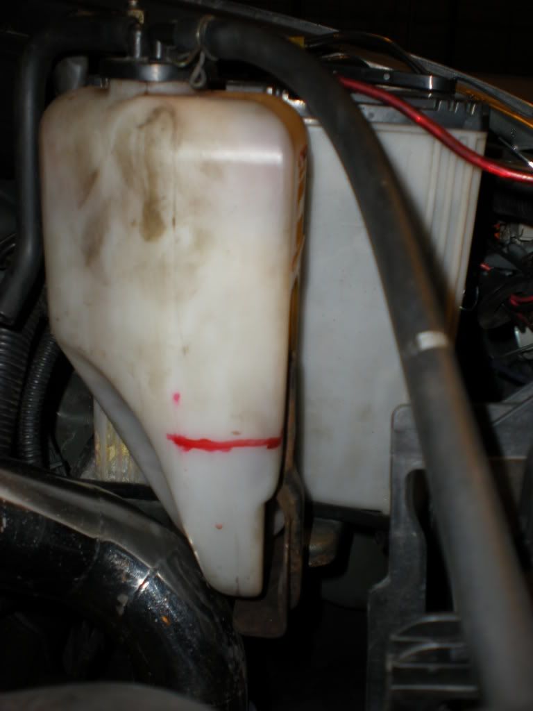

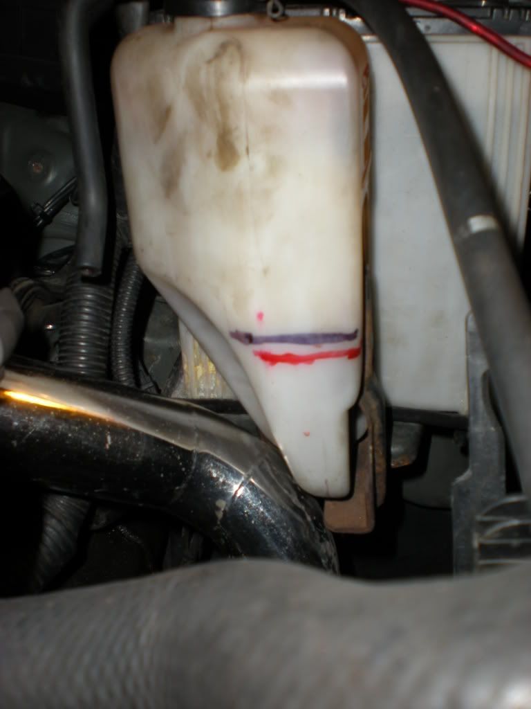

miib14 Posted February 4, 2011 Author Posted February 4, 2011 well i went out today and its fine now.. dunno what was wrong with it... seems to have sorted it itself..this is what did to check if it was rising..when car was warm..on and off boost (stayed the same)just hard booostleft it to cool down, came back after 2 hours and it had gone down to just below the red linevery strange Quote
