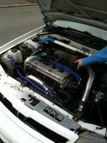

nazzurro19 Posted February 21, 2011 Author Posted February 21, 2011 well here is the product of the topichttp://i256.photobucket.com/albums/hh181/n...19/0ef1ef0f.mp4sounds awesome ;) Quote
string Posted February 21, 2011 Posted February 21, 2011 good wire up glanza cl. sounds good nazzuro Quote
nazzurro19 Posted February 21, 2011 Author Posted February 21, 2011 good wire up glanza cl. sounds good nazzurocheers dude ;) Quote
