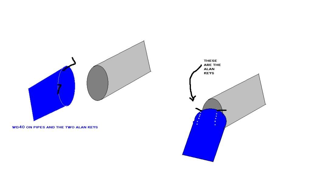

TrisK Posted March 10, 2011 Author Posted March 10, 2011 ok, so ive bought hosesand im having problems getting the 51-57 staight onto the alloy pipeive got the elbow on, but i cant get the straight silicone pipe onto the alloy pipeive tried vaseline, heat gun, and soaking in boiling water. anybody got any good tips?thanks Quote
k1r4n Posted March 11, 2011 Posted March 11, 2011 ok, so ive bought hosesand im having problems getting the 51-57 staight onto the alloy pipeive got the elbow on, but i cant get the straight silicone pipe onto the alloy pipeive tried vaseline, heat gun, and soaking in boiling water. anybody got any good tips?thanksyou need 2 people and 2 alan keys and wd40- i know what your thinking .....WTFi had the same issue so i wd40'd the pipes, then pushed half the pipe half on using the alan keys like levers, and having another person pushing on the pipe,you will get it oni did a quick ms paint doc but its on my phone so no comments on how ridiculous the pic looks,i'm only trying to be helpful lol Quote
k1r4n Posted March 11, 2011 Posted March 11, 2011 or do the same thing i did with my td04 but for your ct9, its not perfect but less bends lol - i know mines an apexi and urs is a mushroon but principle is the same Quote

k1r4n Posted March 11, 2011 Posted March 11, 2011 ^Nice tactic lolI had a fun time connecting up my FMIC last time cheers.lol i had issues too, and i swear screw drivers and levers weren't cutting it, as soon as i tried alan keys.....successits random but tried and tested lol Quote
Amjad Posted March 11, 2011 Posted March 11, 2011 How thick were the allen keys? Sounds really anal but might be key to the success Quote
TrisK Posted March 11, 2011 Author Posted March 11, 2011 see i tried vaseline and a butter knife, is that the same thing?i hate this freaking hose. especially as i got the elbow side on, so i know it fits, just cant get the straight reducer on....im now dreading having to do my fmic haha Quote
k1r4n Posted March 11, 2011 Posted March 11, 2011 How thick were the allen keys? Sounds really anal but might be key to the success 2mm Quote
