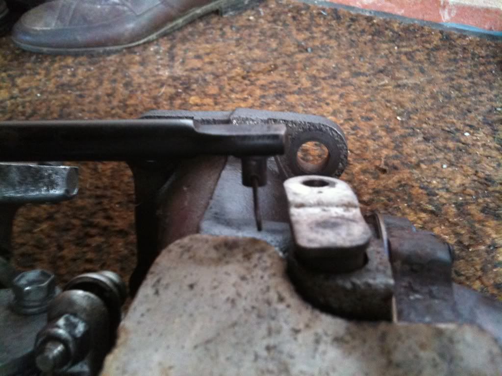

N80Jamie Posted February 26, 2011 Posted February 26, 2011 Well some of you may of read yesterday that i needed to rotate my turbo slightly. This has been done by about 6mm but now i cant fit my actuator! When i bolt it onto the turbo it doesnt reach the flap to open and close the wastegate.. I think im right in saying that if i adjust the actuator i upset what boost im running? How else can i sort this if i cant adjust the actuator?Cheers! Quote
string Posted February 26, 2011 Posted February 26, 2011 pics mate. is it inline still or out of sink due to rotating the compressor side. Quote
N80Jamie Posted February 26, 2011 Author Posted February 26, 2011 It doesnt seem to reach it anymore or be inline! Heres a couple of pics: Quote
string Posted February 26, 2011 Posted February 26, 2011 adjust it so u have to pull the actuator arm a tiny amount to get it in the hole. then use a boost controller to up ya boost back up. hope that works. Quote
nastyrash 2003 Posted February 26, 2011 Posted February 26, 2011 121mm from the base of the actuator to the stud that goes into the waste gate arm is 14.5psi (1bar) i think 125mm is standard booste but check this the figures are on the site some wer, that is for a HKS. just pull the arm to slot in if the measurments are correct. Quote
N80Jamie Posted February 26, 2011 Author Posted February 26, 2011 Cheers for the help guys! Its all on now but im only running 0.3bar boost ;) lol. Is the only way i can get it back up to 0.8 a boost control? Quote
keirz Posted February 27, 2011 Posted February 27, 2011 is it a hks actuator? is so then shorten the arm.if its a stock actuator then you could space it out by putting some washes between the compressor cover and the bracket to provide more pre load. but would be better to buy hks Quote
N80Jamie Posted February 27, 2011 Author Posted February 27, 2011 It doesn't say hks anywhere on the actuator so I'm guessing it's not. I didn't think the stock actuator had a thread on it to adjust the boost though? At the minute it's set as far up on the thread as possible and that's only 0.3bar. I can't twist it any clOser to the housing of the actuator due to me rotating the turbo. Quote

bucketep91 Posted February 27, 2011 Posted February 27, 2011 get a pic of the whole unit mate, hiow much did you rotate it? you might need to get a bracket made up to suit Quote
N80Jamie Posted February 27, 2011 Author Posted February 27, 2011 get a pic of the whole unit mate, hiow much did you rotate it? you might need to get a bracket made up to suitI can't get a picture at the minue but I'll get when asap. It was rotated about 6mm just to make the intercooler piping clear the manifold. How much would the brackets cost and what are they used for? Quote
bucketep91 Posted February 27, 2011 Posted February 27, 2011 it will have to be a custom bracket, give it a go yourself, just try and have the actuator arm sitting straight, if its at an angle it will be a pain in the arse the set the boost Quote
N80Jamie Posted February 27, 2011 Author Posted February 27, 2011 it will have to be a custom bracket, give it a go yourself, just try and have the actuator arm sitting straight, if its at an angle it will be a pain in the arse the set the boostSo your on about the bracket on the actuator? If so I'll have a go myself ;) Quote

N80Jamie Posted February 28, 2011 Author Posted February 28, 2011 Well after numerous runs i cant get the boost up to 0.8 anymore At a guess i need a new actuator? I keep on winding and winding it up but can barley get over 0.5! What do you think would of caused this to happen? Before the turbo was rotated the car was boosting at 0.8 perfectly. Quote
bucketep91 Posted February 28, 2011 Posted February 28, 2011 its because now uv rotated the turbo the bracket has moved so the actuator isnt mounted properly. U need to get a new bracket made up so your actuator sits how it did before u rotated the turbo Quote
N80Jamie Posted February 28, 2011 Author Posted February 28, 2011 I'll try and sort the bracket out as soon as ive got some spare time I'll post up on here what happens! Cheers for all your help bucket Quote
