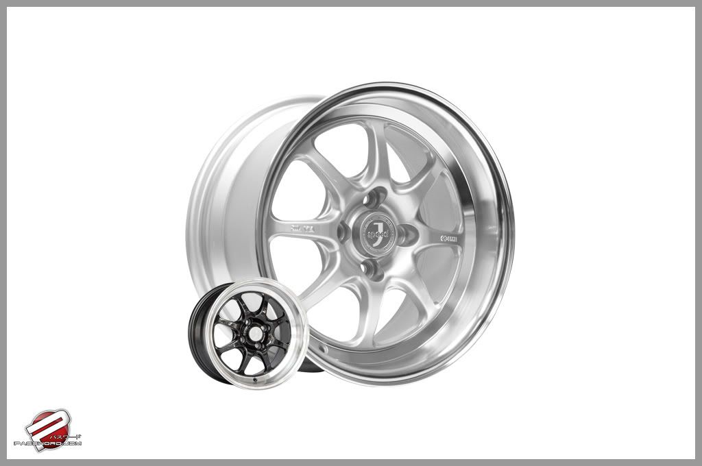

lew777 Posted April 24, 2011 Posted April 24, 2011 fallen in love with these Enkei'swhat do people think?need to know what offset i would need. got 10mm hubcentric spacers already to fit over my wilwoods15x7 / 4x100 / et2515x7 / 4x100 / et3815x8 / 4x100 / et25 not sure if these would be too wide Quote

Glanza_cl Posted April 26, 2011 Posted April 26, 2011 might need 5-10mm spacer to clear the callipers, with the spacers you would end up with an offset of ET28 or ET33 dependant on size of spacer.simply put 15x7 ET38 are safe, will fit in the arches but have not poke or stance at all. (less then your current ones)15x7 ET25, much better stance and poke but if you need spacers your offset will get low and arch rubbing will become and issue i think.15x8 ET25, much better grip due to the wider wheel, will look awesome and fill the arches but most likely will cause scrubbing issue with arches Quote

Sparky Posted April 26, 2011 Posted April 26, 2011 I can't remember what offset my wheels are but there 8 inches wide, I wouldn't say there too wide at all! If you still have those black grids they deffo aint 8j, more like 6.5jMy Enkeis are et38 and clear my willwoods better than my Final speeds, so I would get 15x7 et38 Quote
