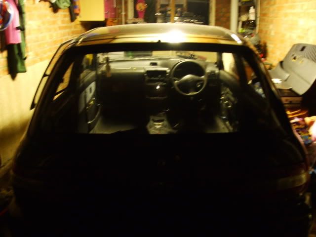

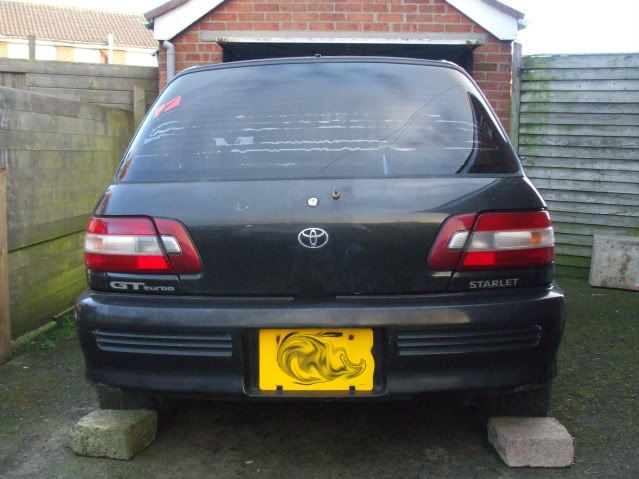

steviet Posted March 10, 2012 Posted March 10, 2012 I have been in the process of removing the black tint film from my rear window,but have been left with the stickness from the film on the glass,any tips on how to remove it,i.e cleaning products for glass.cheers stevie Quote

steviet Posted April 10, 2012 Author Posted April 10, 2012 What a job it was,removing it white spirts,auto glym tar remover and packet of scrubing pads done the job,wont be rushing to tint any windows incase i change my mind. Quote
