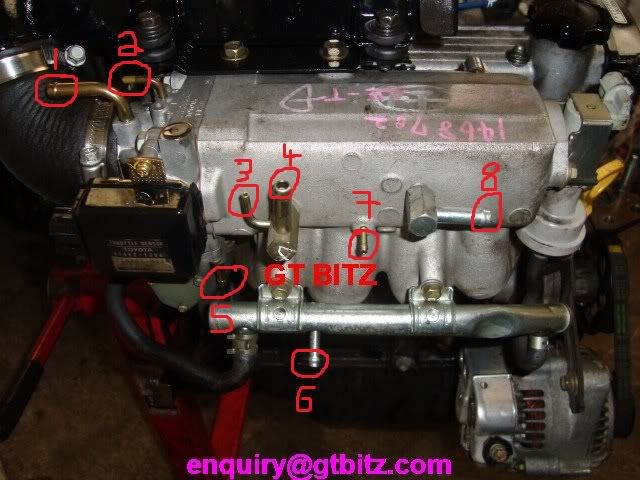

Taggy Posted August 13, 2012 Posted August 13, 2012 Can someone tell me what this black square unit does on the left hand side in the picture, mine has taken a wallop while fitting and everything inside is bent to hell, what does it do? Quote
Whitegv Posted August 13, 2012 Posted August 13, 2012 The tps? Mounted on the side of the throttle body?If so its called the throttle position sensor. on starlets i was told that it only really tells the ecu when you've let off the accelerator. this tells it to stop adding feul special you aren't popping and banging as you engine brake i spose is the best term. it will run without it however obviously Toyota didn't put it on for fun so best get one sorted asap Quote
Taggy Posted August 13, 2012 Author Posted August 13, 2012 (edited) yeah thats it, well the contacts inside are all bent touching each other, when i start my car (which is ok) when i touch the acellerator at idle, it nearly cuts out then starts to rev up then cuts out then starts to rev again and keeps doing this yo yo thing with the thottle turning on and off all the time, do you think thats causing it? Edited August 13, 2012 by Taggy Quote

Taggy Posted August 13, 2012 Author Posted August 13, 2012 yeah i just unplugged it and its made no diference, so i dont think thats causing the problem.It wasnt doing this yesterday though so somthing i have touched has caused it! Quote
Whitegv Posted August 13, 2012 Posted August 13, 2012 Is there no engine warning light on? if its hunting up and down the revs try cleaning the idle control valve. (unit on right hand side on the end of inlet mani if looking at pic) there's a guide on tgtt Quote
